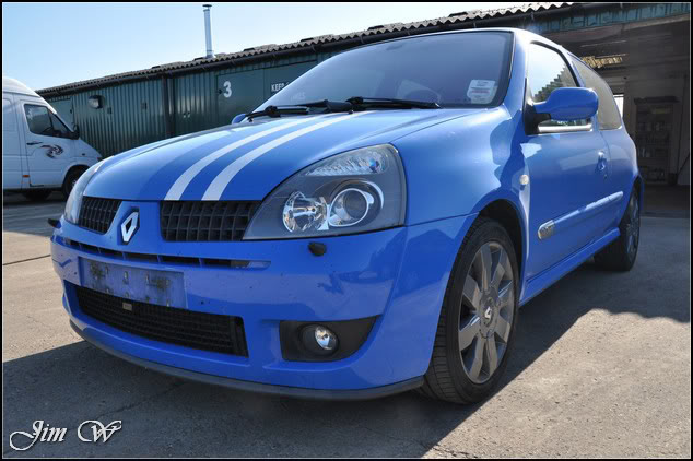

On arrival: (vehicle had just driven from Cornwall, hence the bugs!)

For the owner, this was a new car - picked it up some 5 week ago. The vehicle is a 54 plate with 54k miles on the clocks.

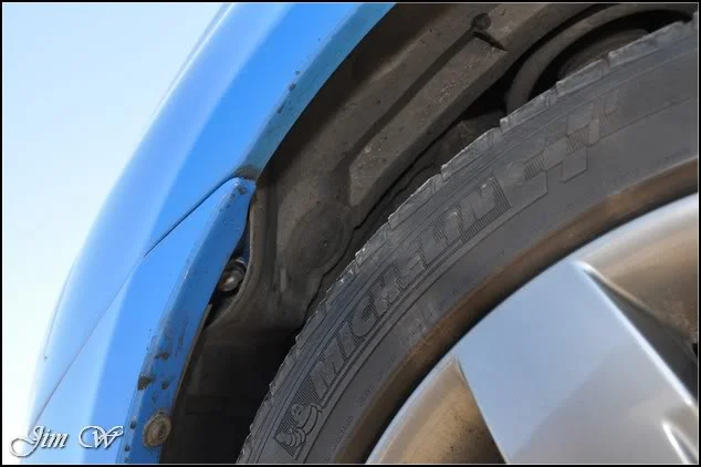

It was hot today. An early start (8am) allowed the best part of the ‘wet-work’ to happen before the sun got too warm… First up, wheels and arches.

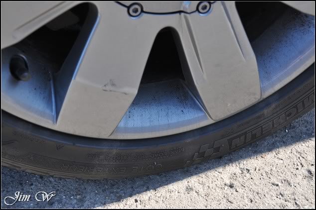

Tar deposits removed from wheels and arch-linings with AS Tardis:

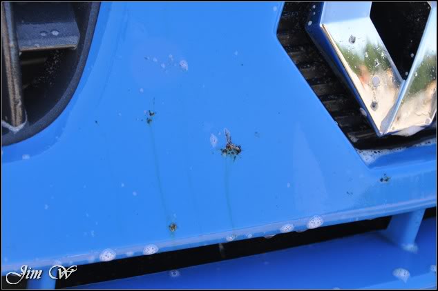

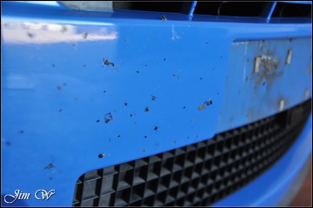

Bug carcass’ being softening up in readiness for pressure rinse:

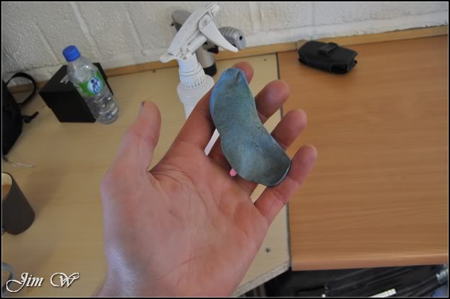

Vehicle pulled into the shade for claying to commence; usually, decontaminating the paintwork is a drawn out process – if still working outside in the full sun, you’re pretty much guaranteed to have water marks appearing.
Clay bar after the back end of the car – certainly a worthwhile job today…

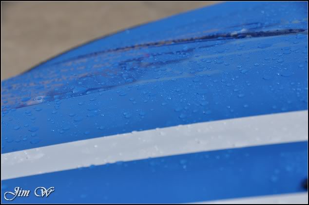

With the car fully clayed and tar deposits removed, it was back outside for another rinse and water ‘sheeting’ session.
Rinsed, but lots of standing water:
After sheeting the water over the (contaminant free) panels, we’re left with very little remaining water to chase with our drying towels:

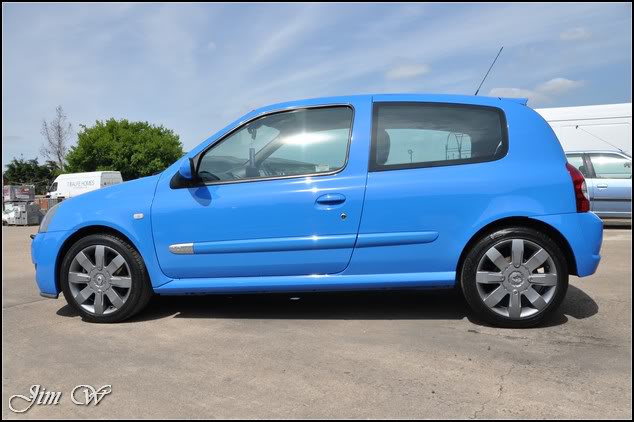

The sun now showing the car’s true condition:
From 5ft away, great!

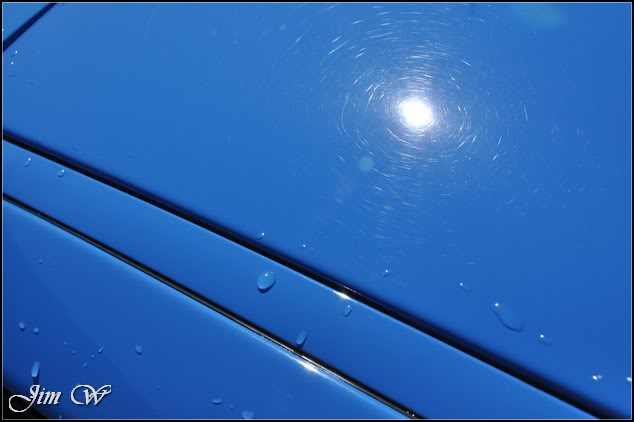

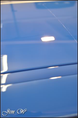

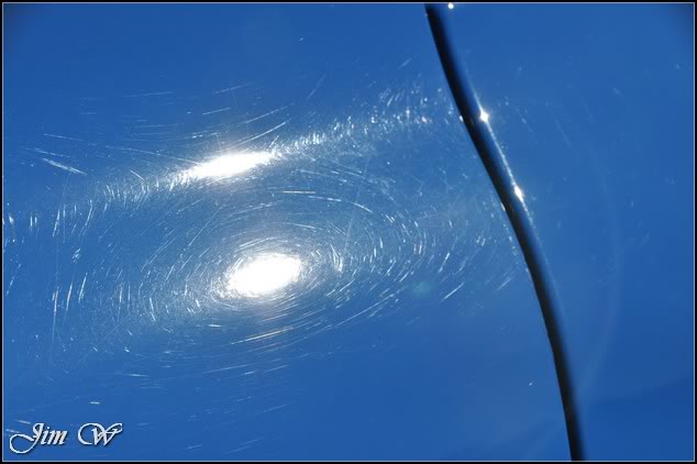

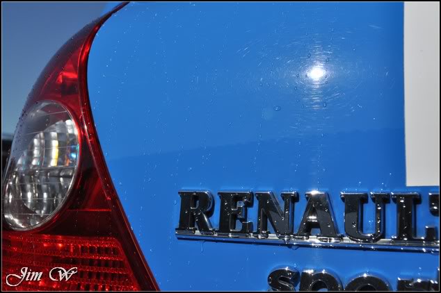

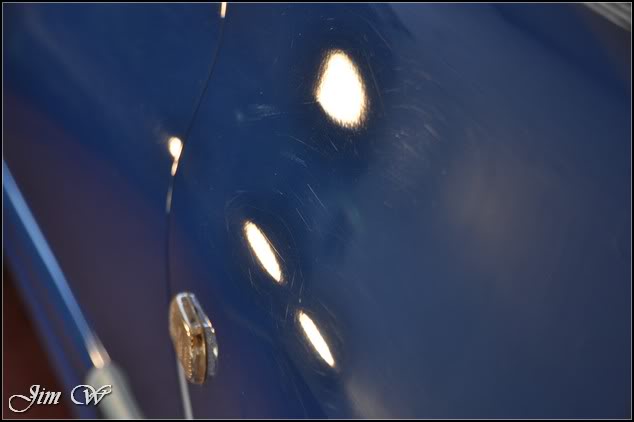

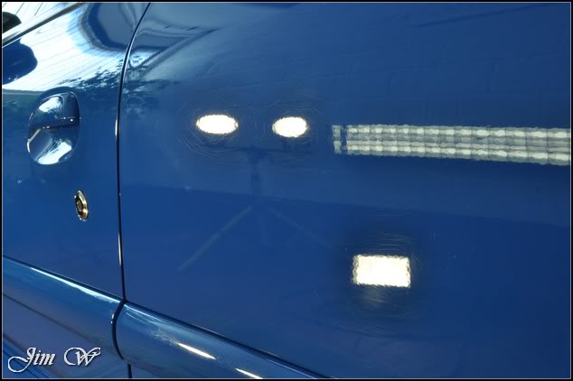

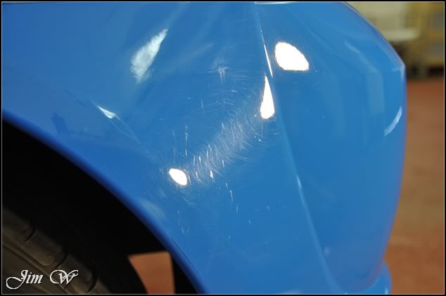

But get in close, ooh..

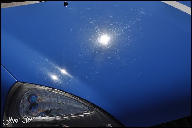

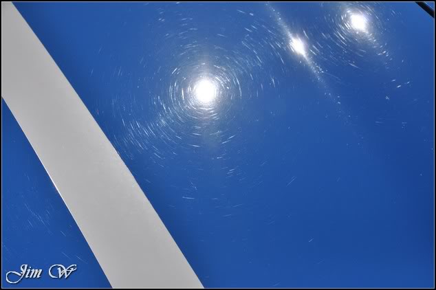

Lots of swirls to tackle, but, more worryingly, a decent spread of random deep scratches, too…

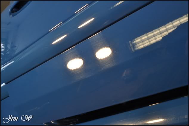

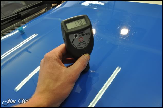

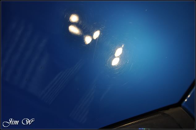

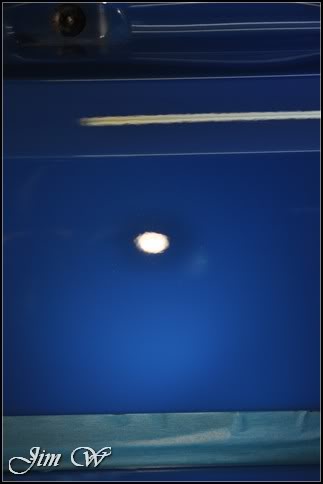

Bonnet under halogens:
Showing possible signs of spray work:
After contacting the previous owner to learn a little more about the vehicles history, they knew nothing about any repair/bodyshop doings but he had brought the car from a Dealership, so, it could have been them that blew over the front end (bumper included) to fix any stone chips etc before selling the car on.

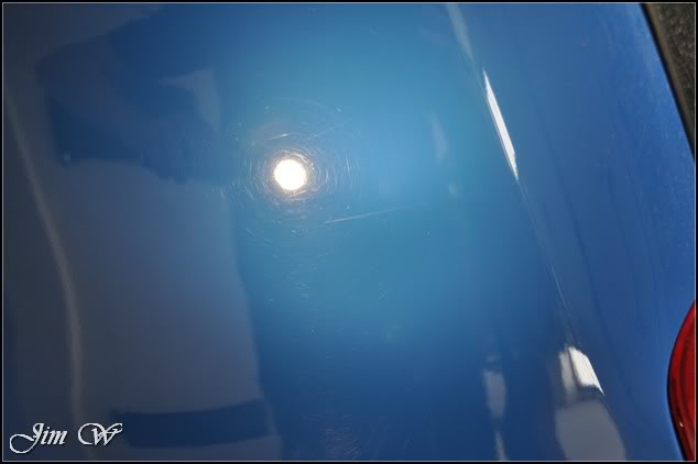

The defects were deep. Typical ‘soft’ Renault paint proving a bit of a nightmare to work with… Quite a challenge to dig down to remove/reduce some of the worst of the defects.
Correction before refinement:

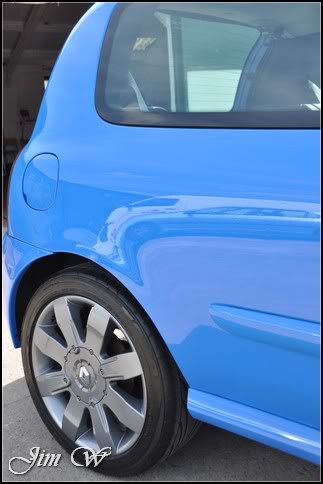

O/S front wing before/after:
O/S door before (under bump-strip)
After (above bump-strip)

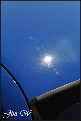

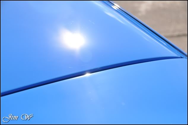

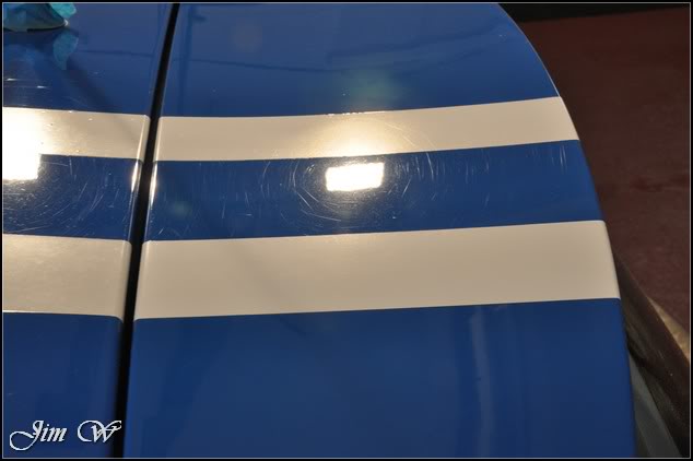

Much like the bonnet, the roof was suffering from some heavy scratches…
50/50:
Note correction levels; one or two deep nicks remain.

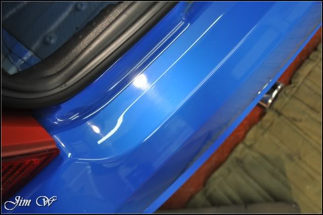

Bootlid before/after:
The boot lid, roof and bonnet proved to be a tricky and timely process… (working around the racing stripes!)

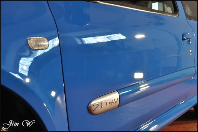

With the front door open, the sun poured in to the unit giving this before and after:

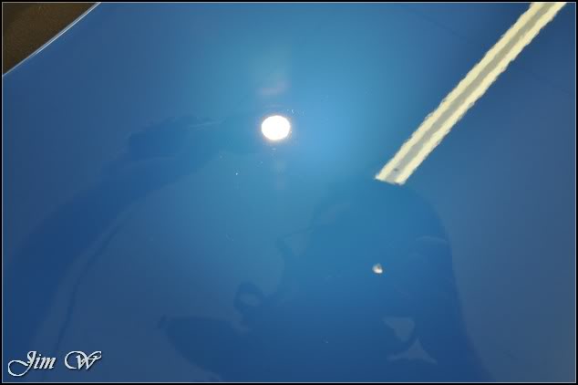

Area on roof before correction:
And another area after..

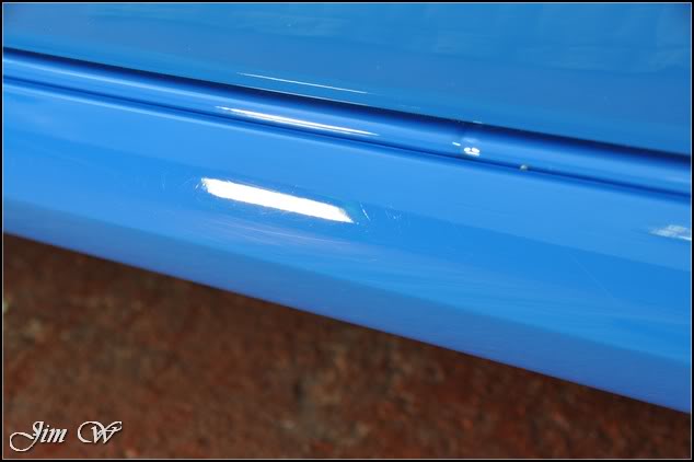

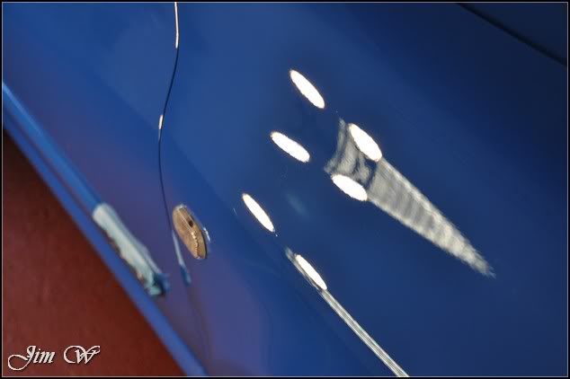

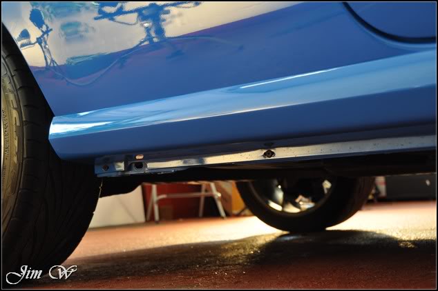

Improving things slightly on the sills:
N/S door:

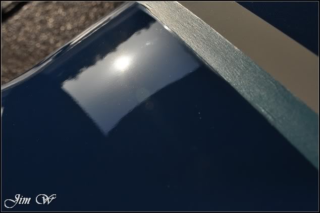

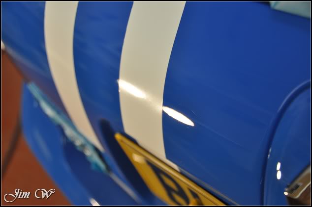

Another before/after shot of the striped area on roof: (required patience, a steady hand and lots of tape!)

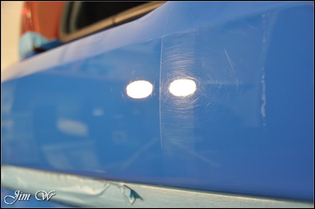

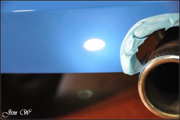

The striped channels on the bootlid were tough… The area was tiny; overlapping correction passes in the same spot over and over soon leads to heat build-up.
Ah-ha! Putting Dodo’s mini wool mop to the test!
Although it hologramed badly (to be expected (esp. with my approach)) heat wasn’t an issue and was refined down effortlessly afterwards with a 3m yellow spot pad and more Menz 203s.

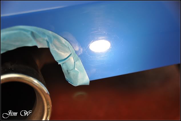

Lip before/after:

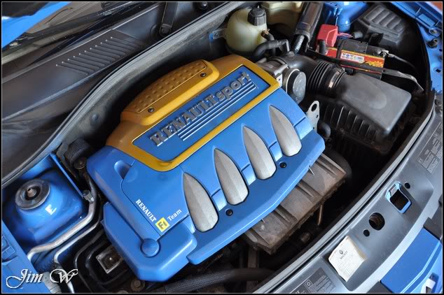

Whilst out for the final rinse, the engine was dealt with. Megs Super Degreaser and various brushes to agitate stubborn grease and muck. Later dried and dressed leaving this:
Before/After:

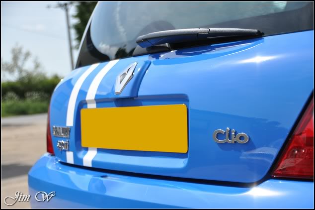

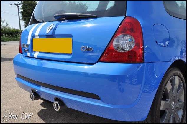

Paintwork protected with Dodo’s Supernatural wax. Glass with 3M’s glass cleaner. Exhaust with Belgom ALU. Wheels with ChemGuys JetSEAL. Britework with Jeffs Prime. Plastic trim with G-Techniq C4. Tyres with ChemGuys New Look trim and a concluding wipedown with Zaino Z6 the following day before collection.
Photos.
Remember this?
Bling!
And last one…
Owner was over the moon!

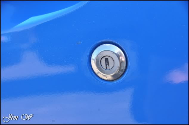

Was it Jeffs Prime you used on the door locks? Just used a little bit on a MF? Mine are in a right state, need to get them done.

sorry, yeah, jeffs prime for the locks (after some 'toothpickery' work to remove the crap)

Jim, how do you get the door locks tip top? I've tried everything I can think of. Autosol, autosol on a toothpick, Prime, wet+dry and autosol. They're too fiddly for me.
  Audi A4 AVANT 1.9TDi
Hi Jimbo,
Sorry for late responce.
Er, usually, I never have to use anything more than Jeffs Prime and a cocktail stick? Seems you nay have an extreme case going on here. Can you photograph it at all for me?
