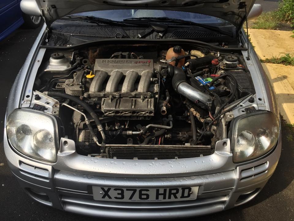

Thats how mine looked while doing it haha theres 2 screws at the top corners of the grill plastic, and then 2 in the bottom corners through the bumper, in them 2 holes you can see next to the headlights, then it just pulls off.
I would do, but depends when you're doing it pal :up:
Nice one, didn't even know the grill came apart like that, just always taken if out as one.
