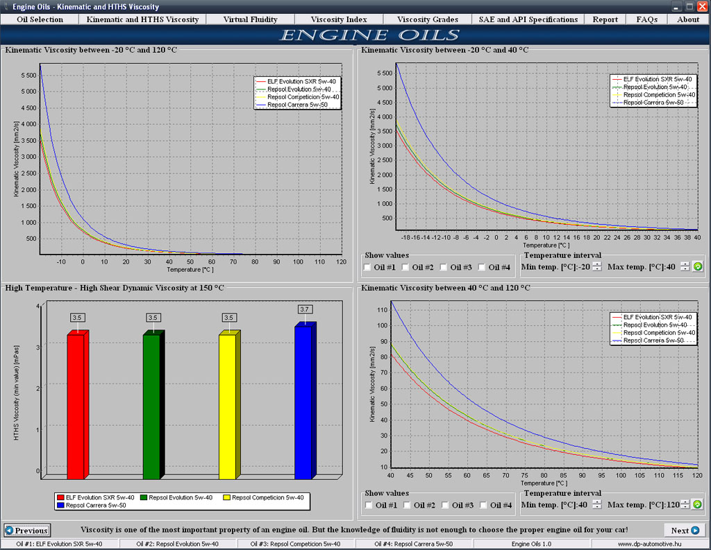

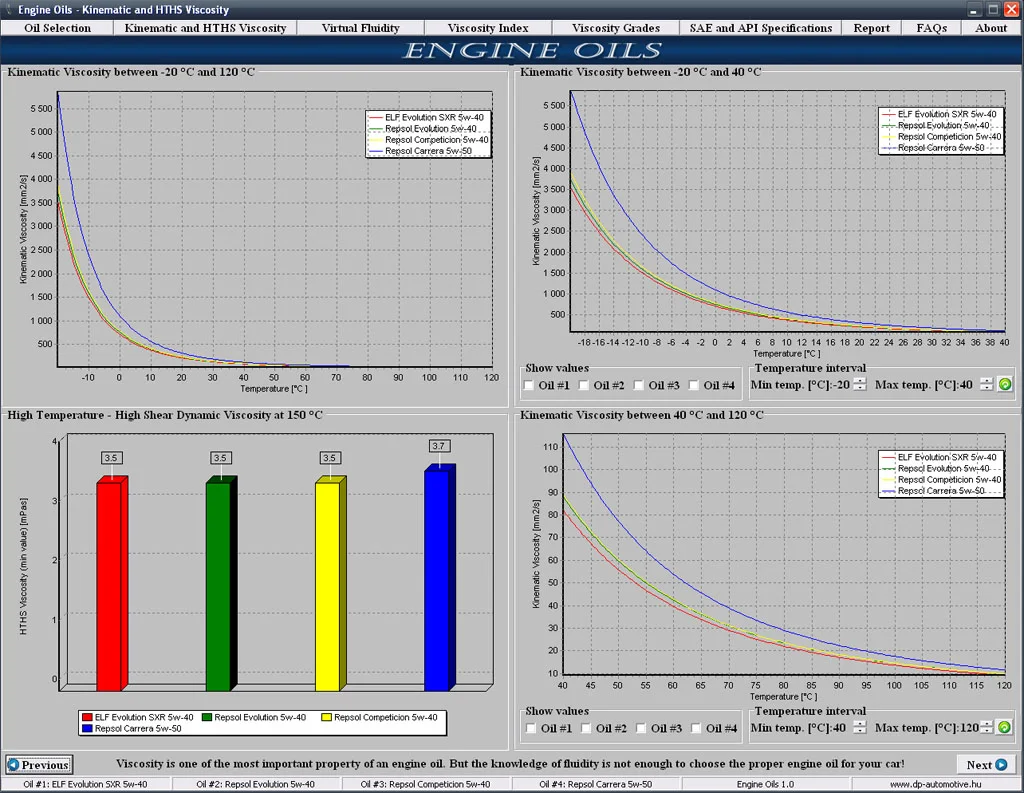

Hope this direct viscosity comparison will help. Here is the viscosity charts of the 4 oils: ELF Evolution SXR 5w40, Repsol Evolution 5w40, Repsol Competicion 5w40 and Repsol Carrera 5w50 (I can't find the tehcnical datasheet of Repsol Elite Faster 5w50. I quess the Carrera's viscosity is close to the Elite Faster's property):
Both 5w40 Repsol engine oils are bit thicker at all temperatures compared to the ELF Evolution SXR. 5w50 oil is way thicker at all temperature, of course (despite it's 5w). If I were you, I would choose Repsol Competicion 5w40.
