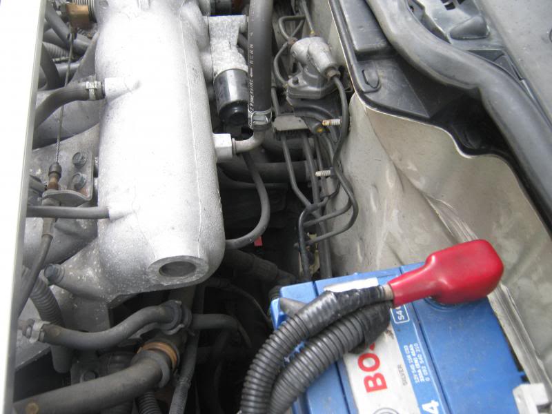

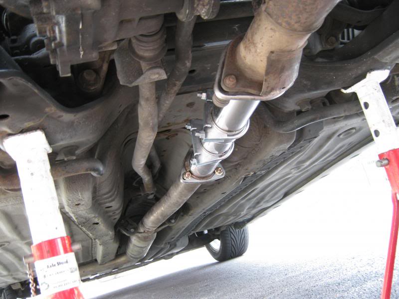

ive bought 250mm of 3.5'' stainless of ebay to get it tucked right behind the headlight and im also goig to sort a cold air feed too eventually
... pipe came today so filter removed, airbox bracket removed, area degreased -
pipe chopped, filed, painted, fitted -
much better -

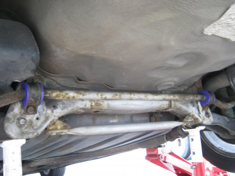

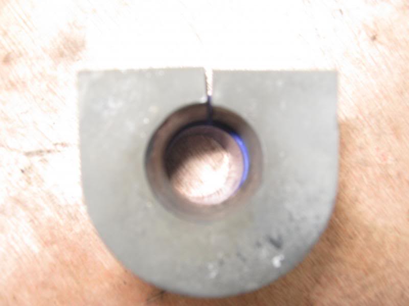

RARB polybushes arrived the other day, so old bush vs new polybush -
the old ones are either the ones meant for a 98spec or just that worn they've oversize 1-2mm lol...
new ones fitted -
car feels a lot tighter now at the rear as it felt rather 'loose' before... still very soft tho due to the 4 1/2 year old coilovers that arnt damper adjustable... new coilovers shall be ordered soon once ive been for a proper b-road blast to make up my mind as atm it feels like itll be pants on track with how soft it is

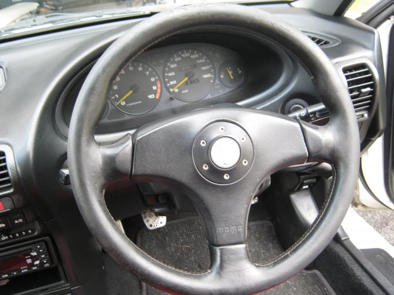

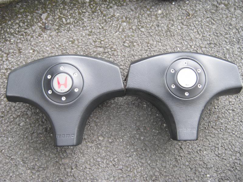

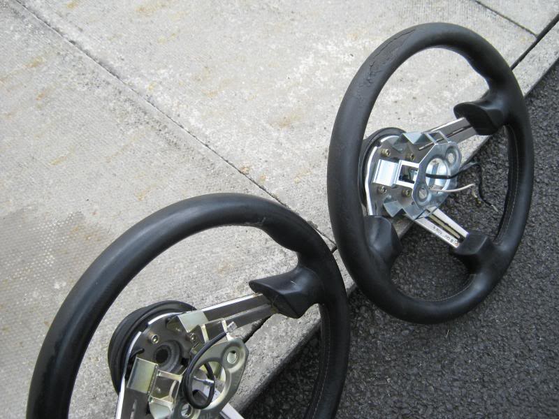

got a couple of key parts that were at the top of my list, firstly a steering wheel that's in a hell of a lot better condition that mine is/was...
so, old -
compared with the new one, see the wear on the top of the old one and how faded it was -
much better!

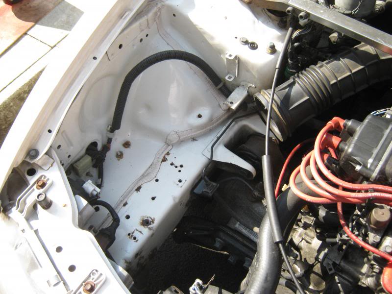

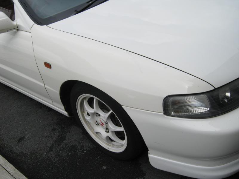

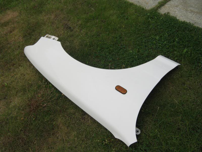

also got an OSF wing...
...because the one on the car is cream and full of deep scratches, cant really tell much in the pics but it stands out a mile in person
will be swapping that sunday!

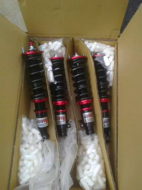

I've just ordered a set of Meister Zeta S Coilovers, they have 8kg/447lb front and 6kg/335lb rear springs so shouldn't be too harsh but still a lot stiffer than it is atm with dampening adjustment!
  JDM Dc2

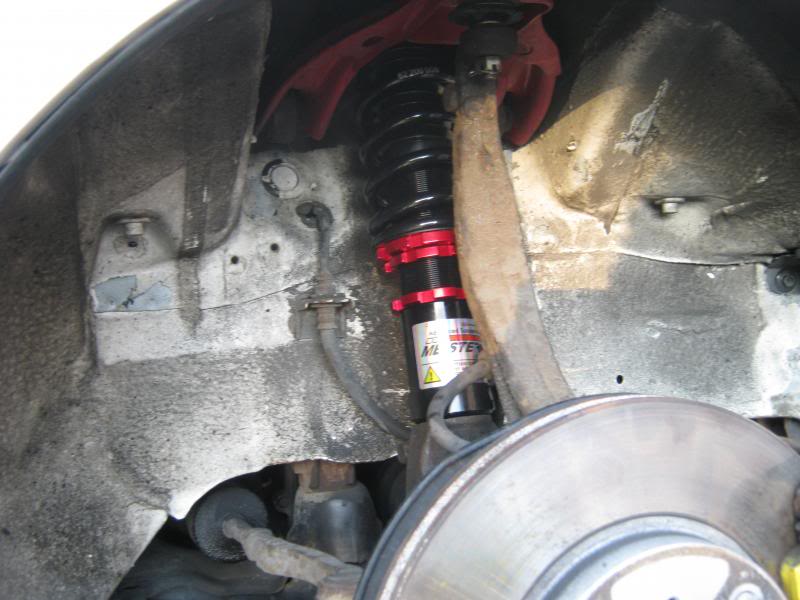

coilovers came today whilst I was at work

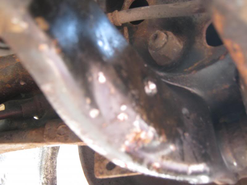

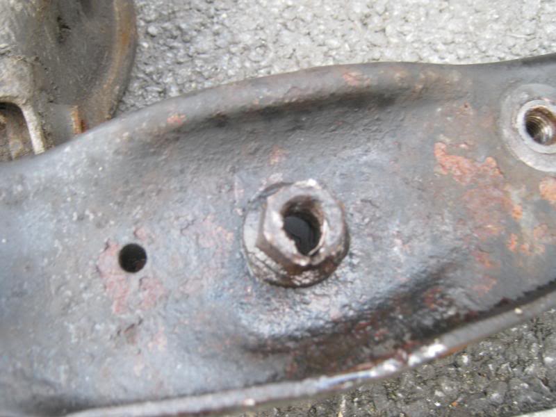

wasted no time fitting them, got the rear jacked up and wheels off, then the very first bolt I went to undo snapped, great, drilled it out about then managed to get the shock past the control arm, heres the bolt snapped, on the other side is a capative nut -
spent around an hour drilling it out, got it out in the end but damaged the capative nut and I don't have a spare bolt, had a route through all my old bolts from the fiestas and none of them had the same pitch thread so ive just had to jam one in and im going to change the lower arm and fit a proper bolt
forgot to take a pick of the rears fitted, heres one I got of the fronts -
luckily had no trouble undoing or removing anything else after that one first bolt
I just guessed the height and set them the same on the coilovers but lowering it back down to the ground,
looks at a decent height tbh just thing the rear needs raising a tad, when doing that it'll take some of the camber out too

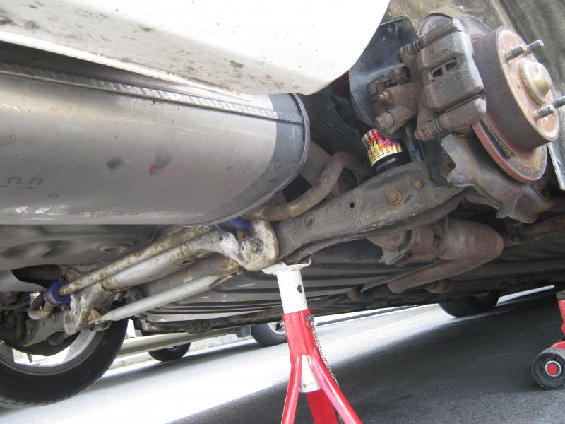

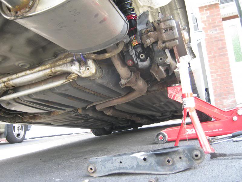

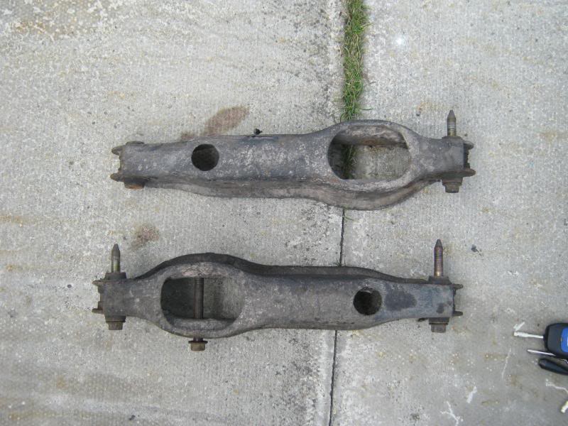

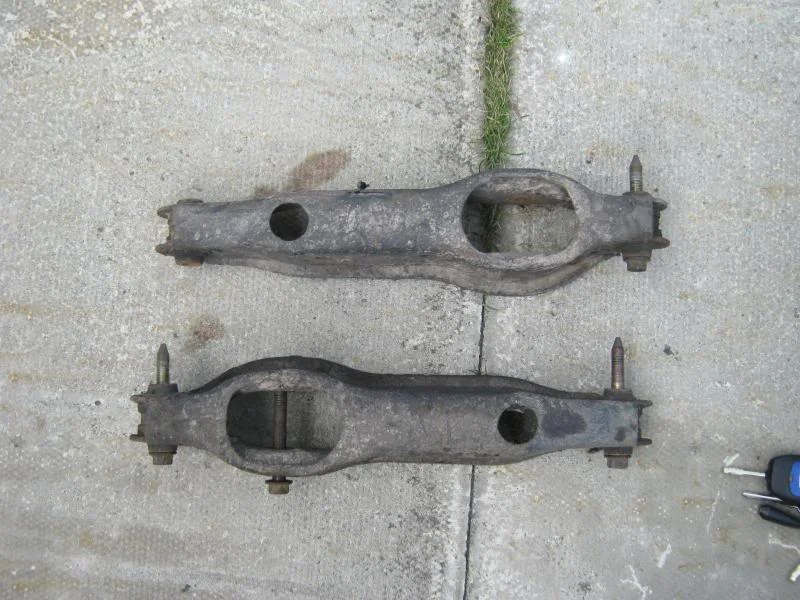

got a pair of rear lower control/trailing arms and afew spare bolts -
control arm removed with the damaged capative nut from drilling the snapped bolt off/out -
new arm fitted -

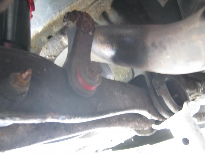

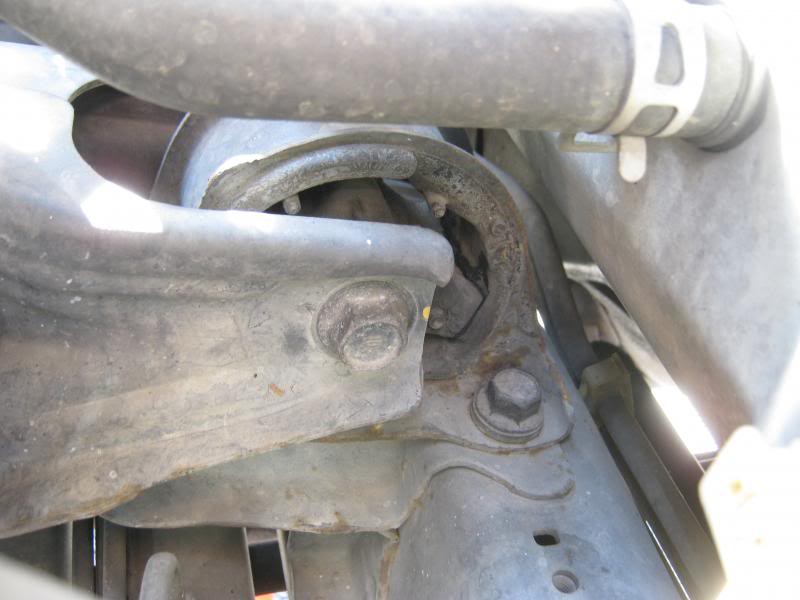

also noticed the other day that it has polybushed RARB linkages -
I was thinking of polybushing the rear trailing arms ive just got but thought i'll leave them, as I don't want it solid, ill only do them if they need replacing in the future

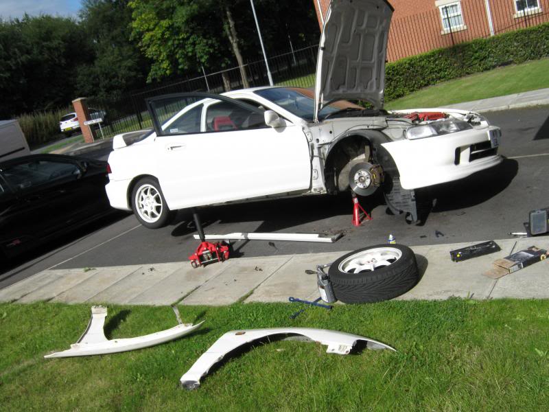

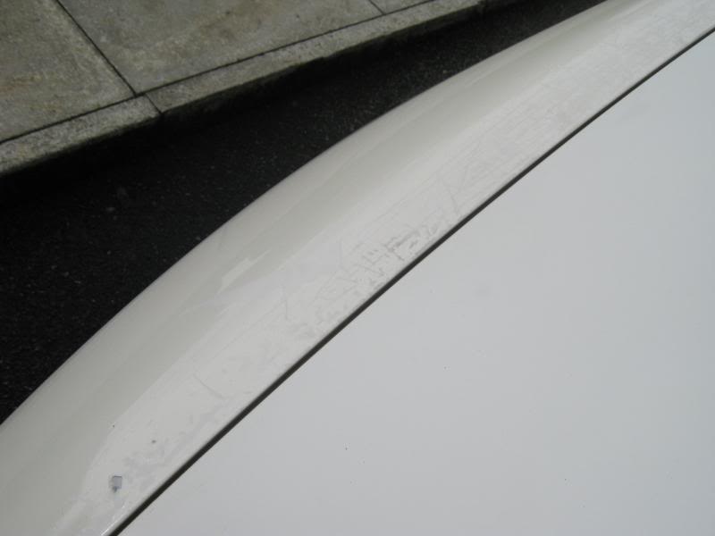

changed the wing Saturday after a mate saying 'we doing the wing then' after me just planning to wash it and go for a drive... so I thought 'YES' while I had a 2nd pair of hands...
so got the car up in the air, removed the wheel and side skirt, pulled the bumper back abit to get to the 2x 10mm bolts behind it, undone the other 6x bolts and one wing removed -
new wing fitted and car cleaned -
that's more like it, no more cream and scratched wing!

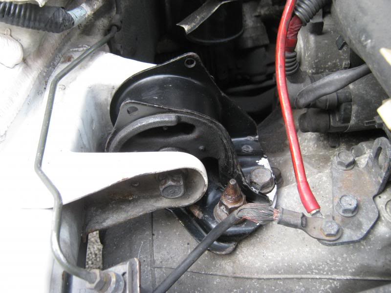

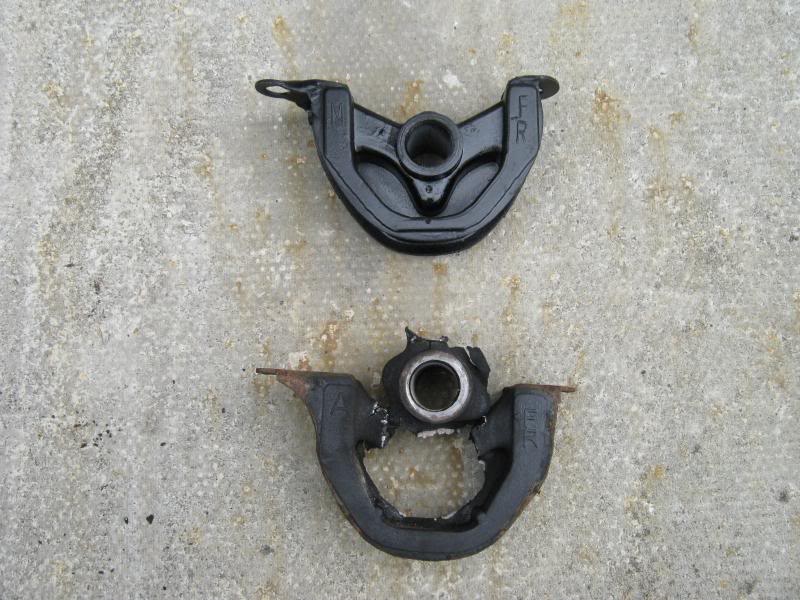

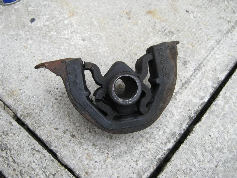

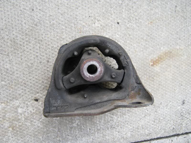

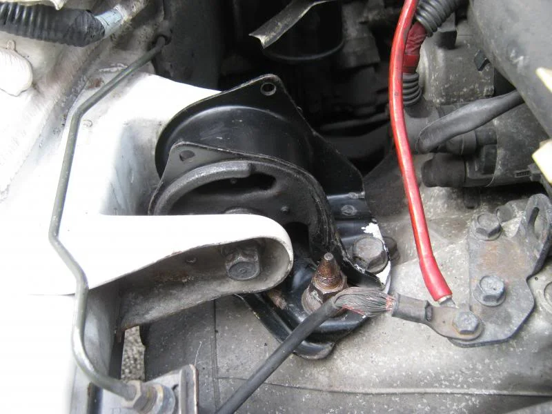

so, driverside new vs old torque mounts -
old passenger side one -
new, lined up -

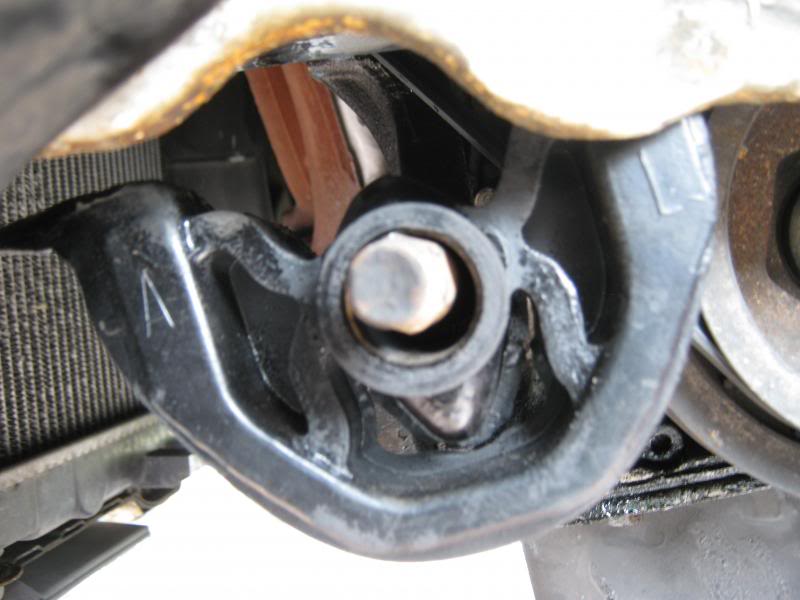

I thought 'wtf' at the centre hole as to why its so large and theres no insert of any sort, spoken to the guy at the breakers who ive got afew parts from and he undone afew old mounts whilst on the phone and said 'nope, none of them have inserts'... brilliant design there Honda...
so fitted and tested the car, still doing the knocking nouse just not as bad, then got the car on axel stands and ran the car in 3rd gear with using a battery to hold the accelerator down slightly and I got underneath and the part that's knocking is nearside driveshaft where it slides into tha part mounted onto the back of the engine :evil:

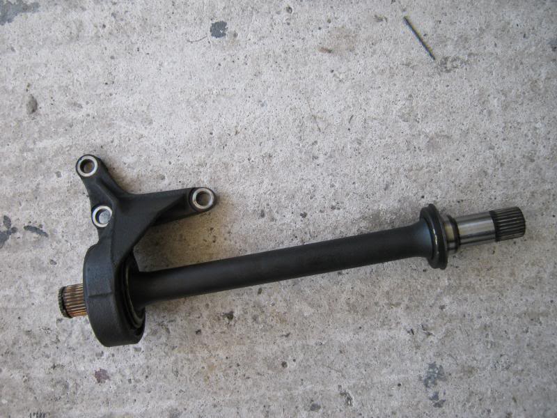

got a halfshaft from a breakers yesterday -
so just changed that, tackling nuts and bolts that hadn't been undone in 17years isn't fun but taken around 90mins, started it up on the axel stands and it was quiet, a little movement in the bearing in it but nothing like the old one and no noises coming from it, but theres still a noise and slight wheel wobble there so ive ordered new shafts from Tegiwa along with a new rear lower engine mount as I noticed mine has collapsed -

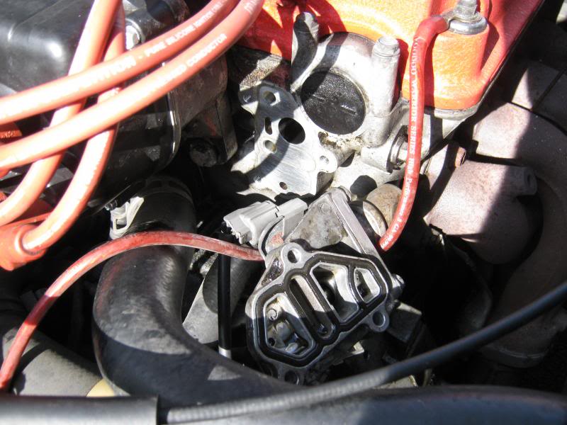

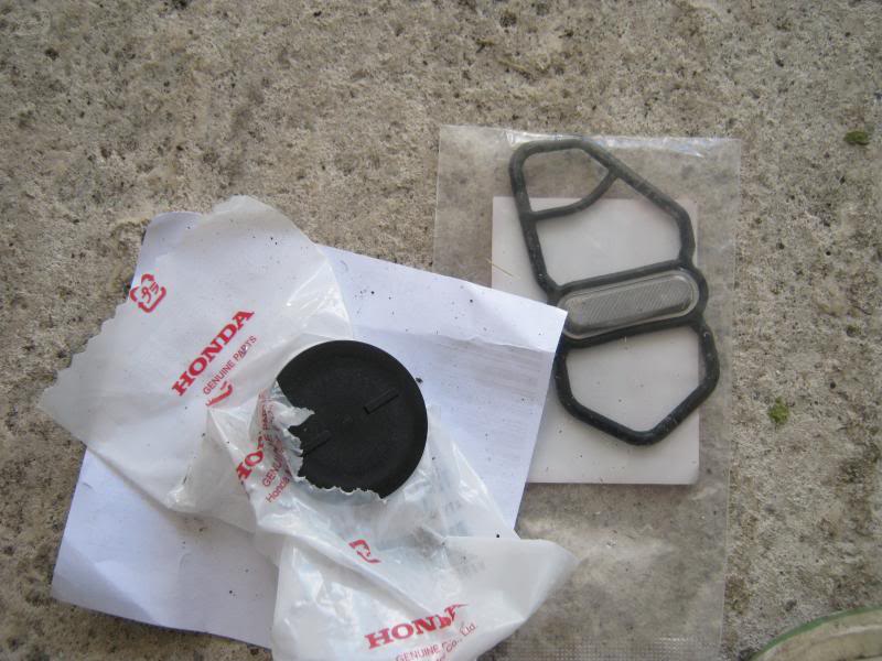

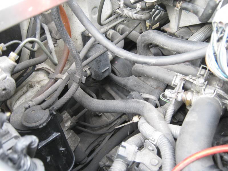

when I ordered the torque mounts I ordered a vtec solenoid gasket to go with the new cam cap I got from Honda afew weeks ago -
so changed them, easy job for one only taken 10mins to do both -

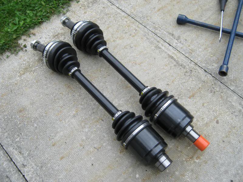

new shafts came today -
only taken around 30mins per side to change all in, got away without undoing the track rod ends or ARB

old mount -
it was literally sat on the bottom so imagine that flat on the bottom that's like 10mm lower so that wouldntve helped the angle on the shafts either

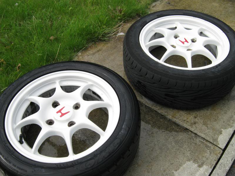

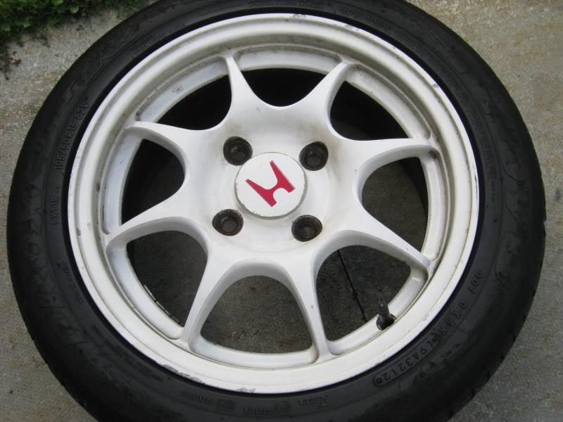

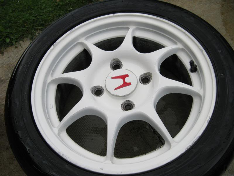

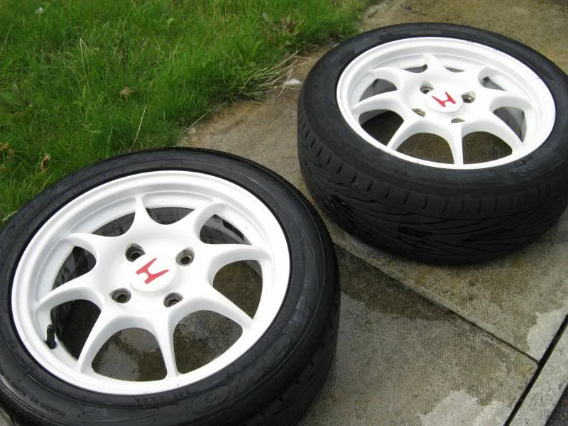

front wheel before -
after -
attacked them with some masonary acid haha, they were cream and had blobs of old brake dust on, they could really do with a respray but they wont be getting done in my ownership

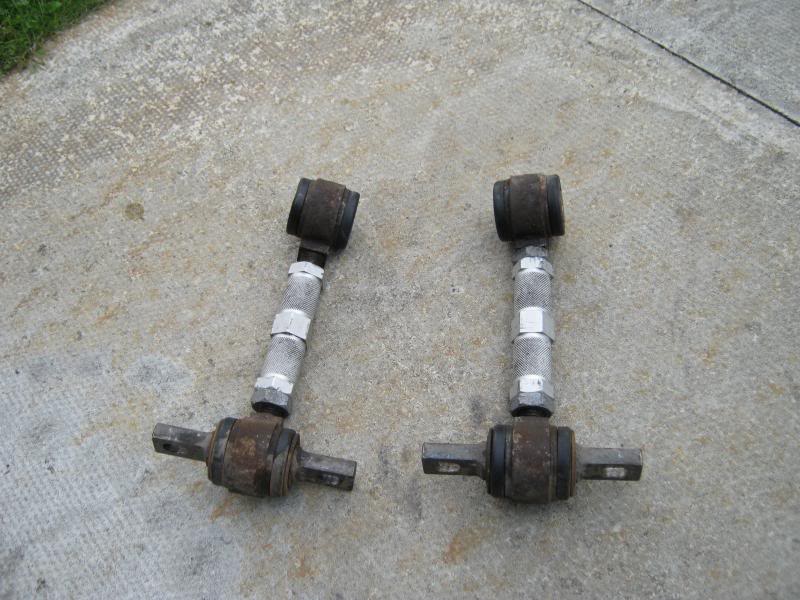

done the rear wheels too after I fitted these, skunk2 adjustable rear camber arms -
noticed one of them hasn't got a locking nut but it seems rather tight I was struggling to undo that side

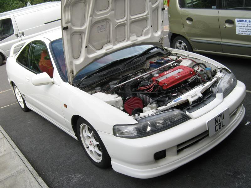

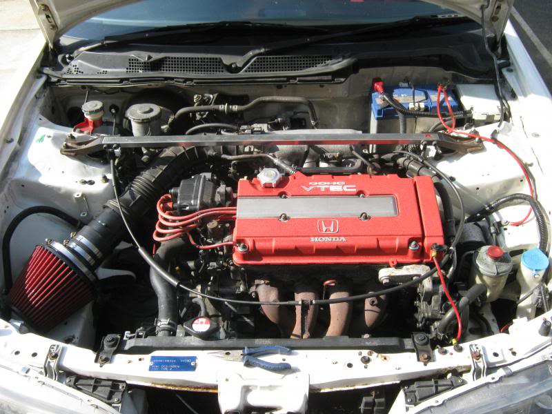

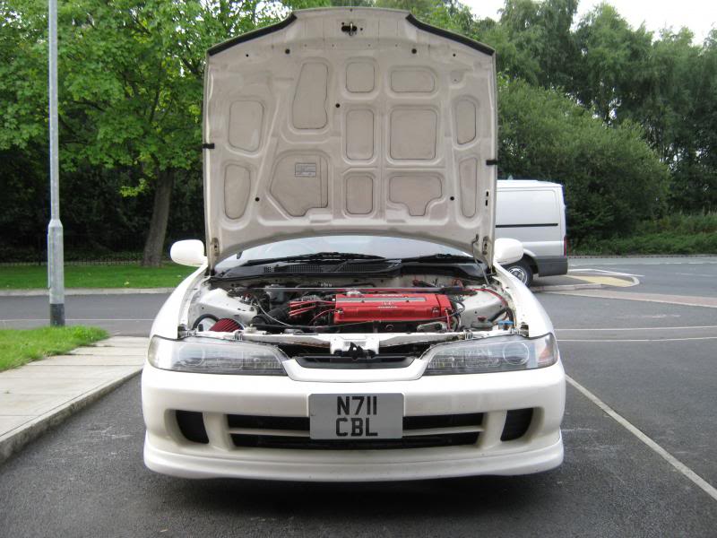

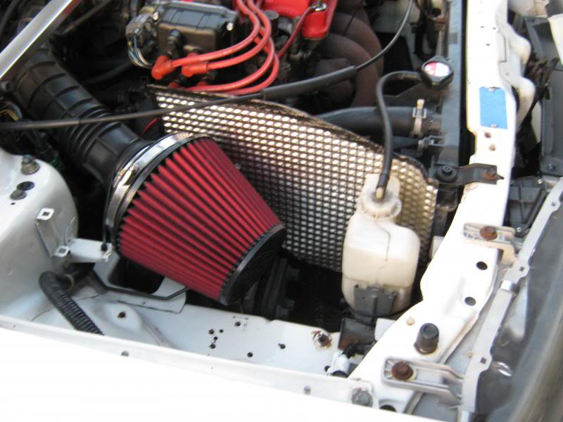

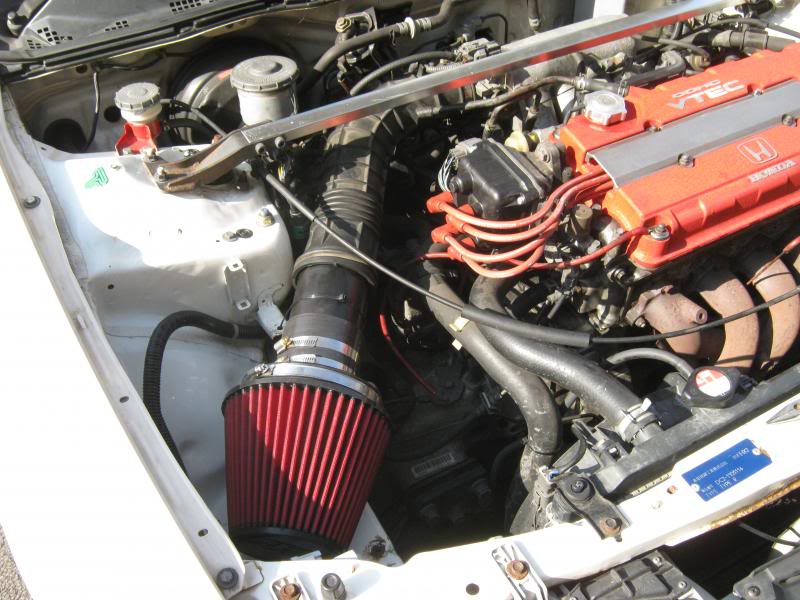

removed the piece of pipe on the filter the other day so now the velocity stacks right in the intake hose rather than a further 150mm away with the old pipe, sounds a tad louder now and will probs be better for it being abit shorter as the air has a shorter distance to travel and the intake hose isn't bent anymore either

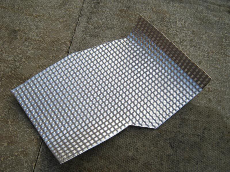

ordered a 400x300mm piece of heatshield off ebay the otherday, came today, cut to suit -
bent it a tiny bit more since this pic, filed the edges and put some ducktape around them, fitted -

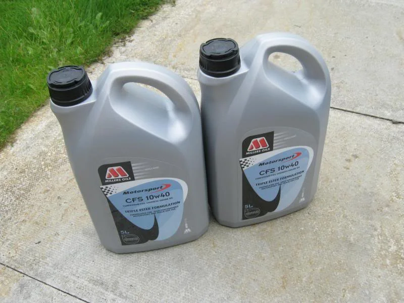

Booked my first trackday for the teg for November Saturday 16th at oulton park, cant wait to get it out there!
only plans before then really are some proper oil so ive ordered 10l of MIllers CFS 10w40 and maybe get a 98spec manifold

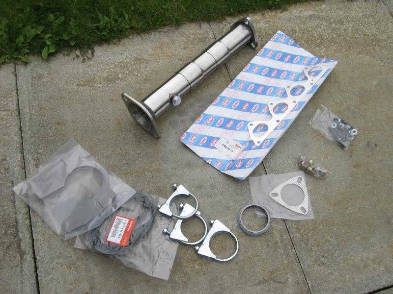

new goodies -
Tegiwa Baffled plate kit
Genuine Sump gasket
Tegiwa 2.5'' adjustable de-cat
New Donut washer
New triple layer Manifold Gasket
Manifold stud kit

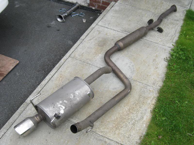

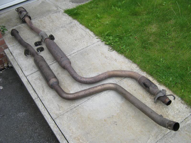

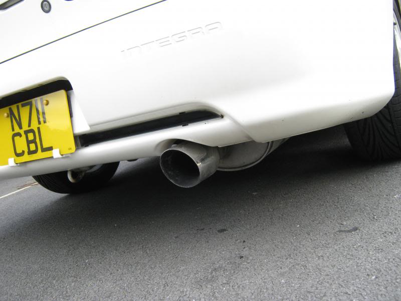

Mongoose 2.25'' Exhaust system

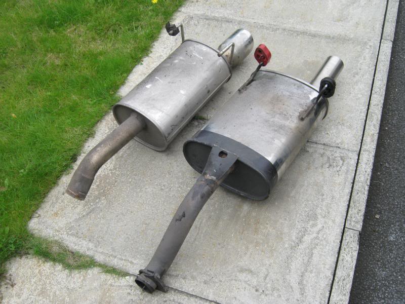

so... Remus vs Mongoose backbox's -
centre sections -
you can see how much better mongoose is, didn't like the oem centre section and how it was adapted for the 2'' pipe for the remus backbox
fitted the system and it lined up perfectly on the hangers and the cutout in the bumper...
not a huge fan of large tips but I think it suits it/fits so well I might leave it...
decat fitted -
started it up and its boomey on start up as with these the revs start high at 1750rpm and as they warm up it lowers obv, sounds the same at 900rpm, sounds nice and raspy when I revved it, didn't take it out for a drive tho I just checked for leaks and jacked it up ready to drain the oil...

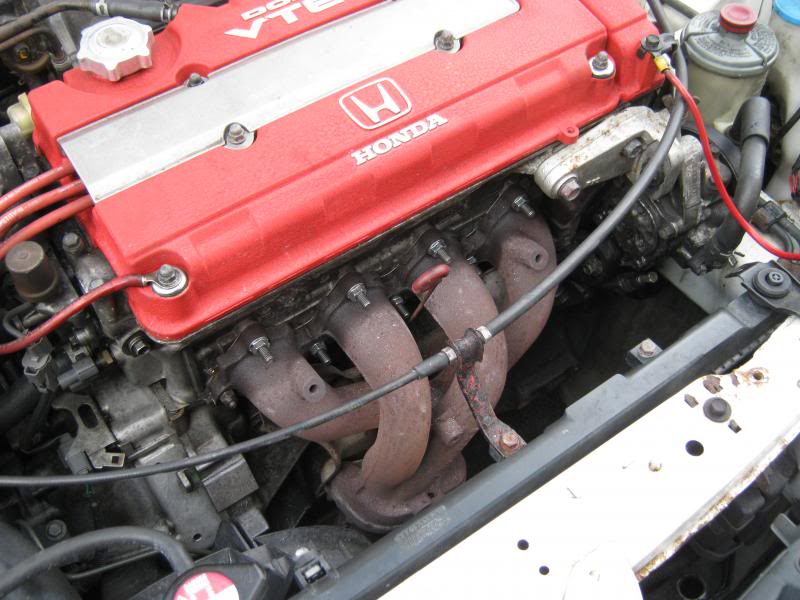

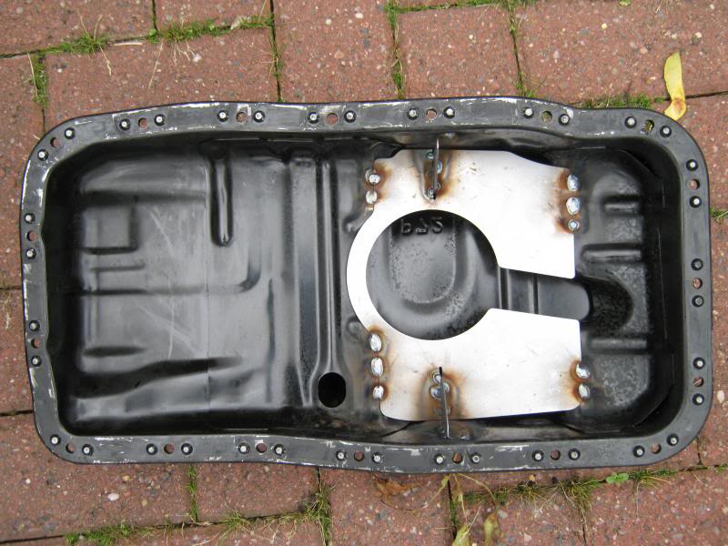

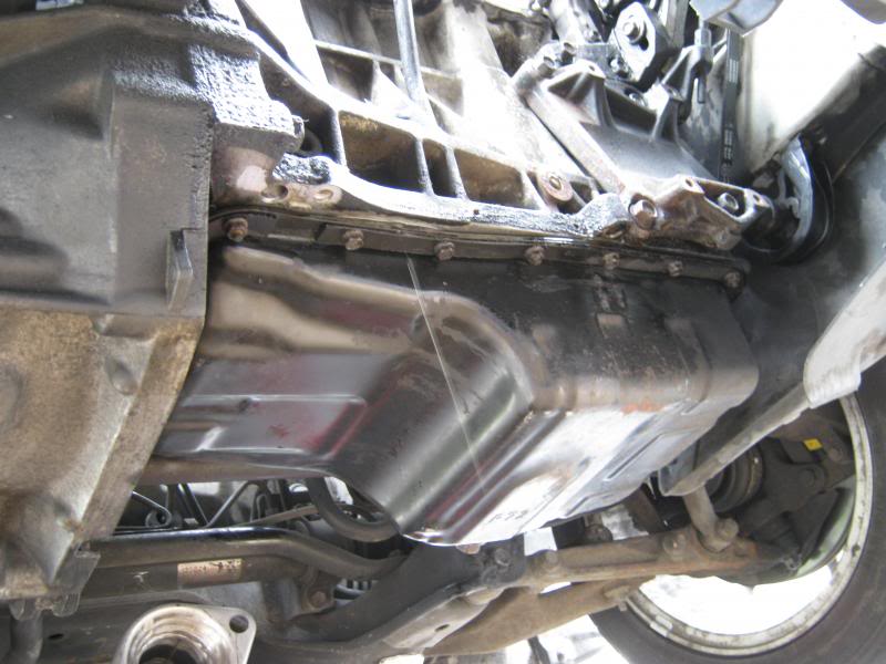

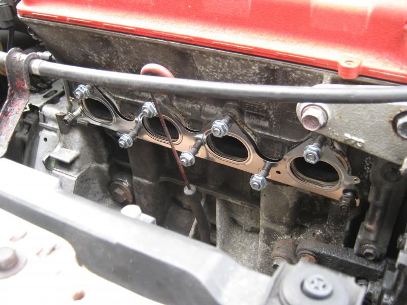

drained the oil, removed the exhaust manifold without any problems then removed the sump and spent nearly an hour removing the old gasket and cleaning all the oil out of it ready for a mate of a mate to weld in the plate for me tomorrow
new stud kit fitted and gasket ready to be squoze -
more tomorrow!
  JDM Dc2

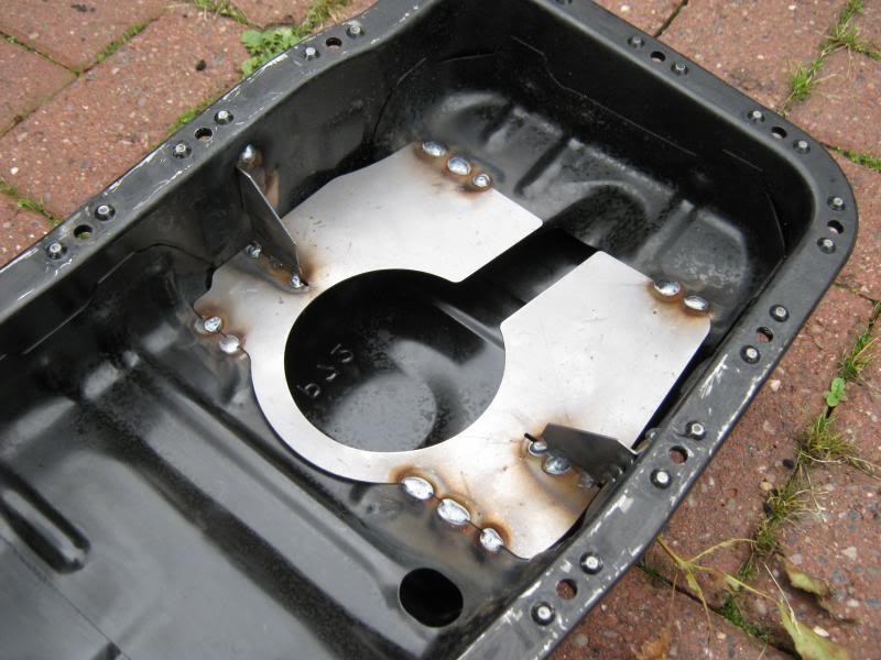

mate welded in the baffle plates in for me tis morning -
sump and manifold re-fitted -
