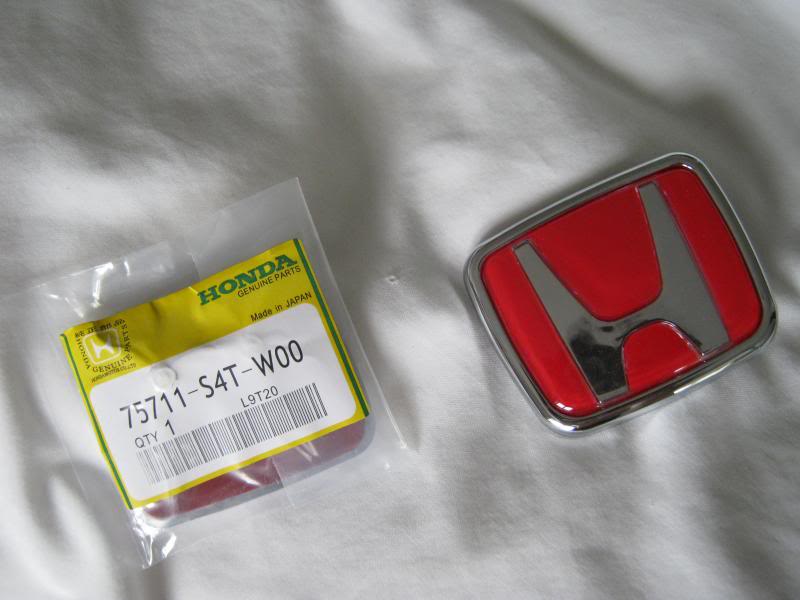

rocker cover gasket and new badges have arrived!

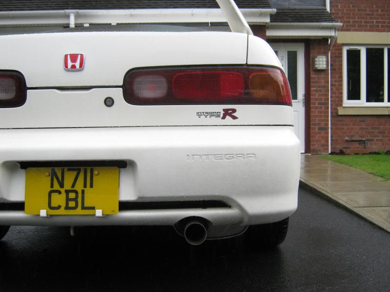

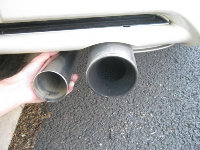

ordered 1/2meter of 2.75'' stainless for a new tailpipe to replace the 4'' inwardly rolled

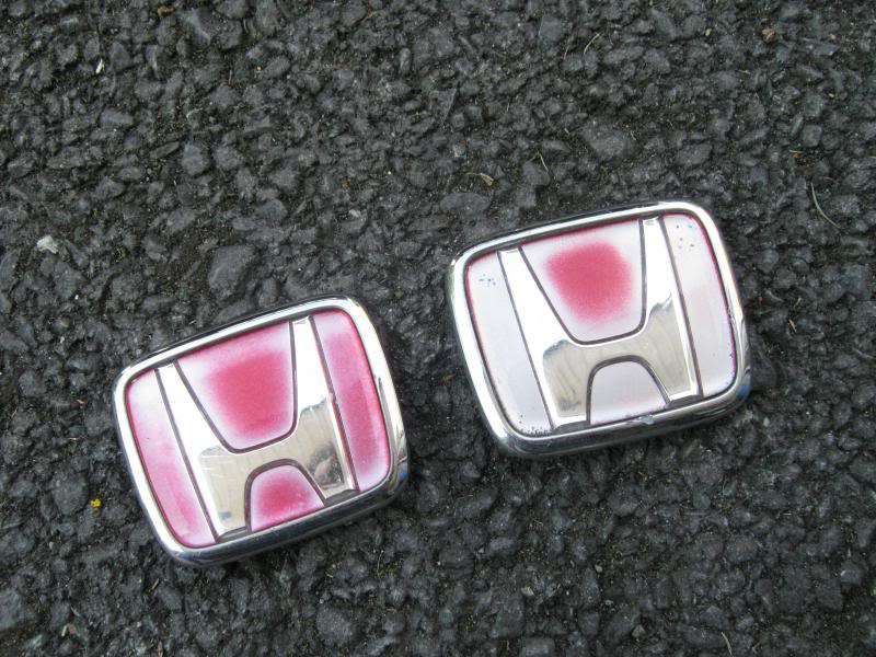

old badges -
new badges -
fitted -

oh and the 2.75'' stainless arrived yesterday, size difference -
cant wait to get it swapped, will probs do it over the weekend or next week when my mates free!

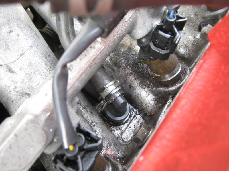

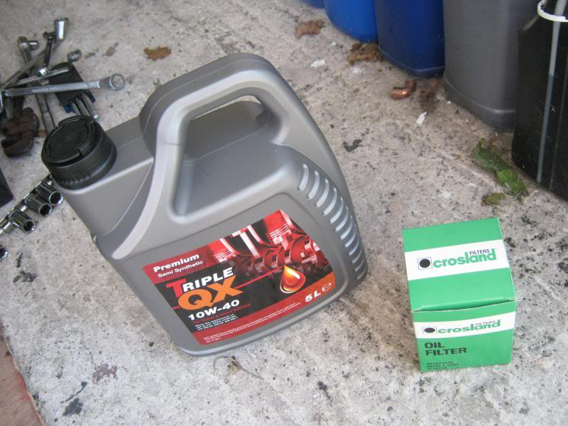

service items, only cheap ones for now as im gonna see how it runs on 10w40
as the oil's leaking from the headgasket slightly, not running out and dripping
on the floor, just seeping out around the front left corner/3/4'' along the
front -

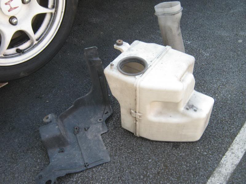

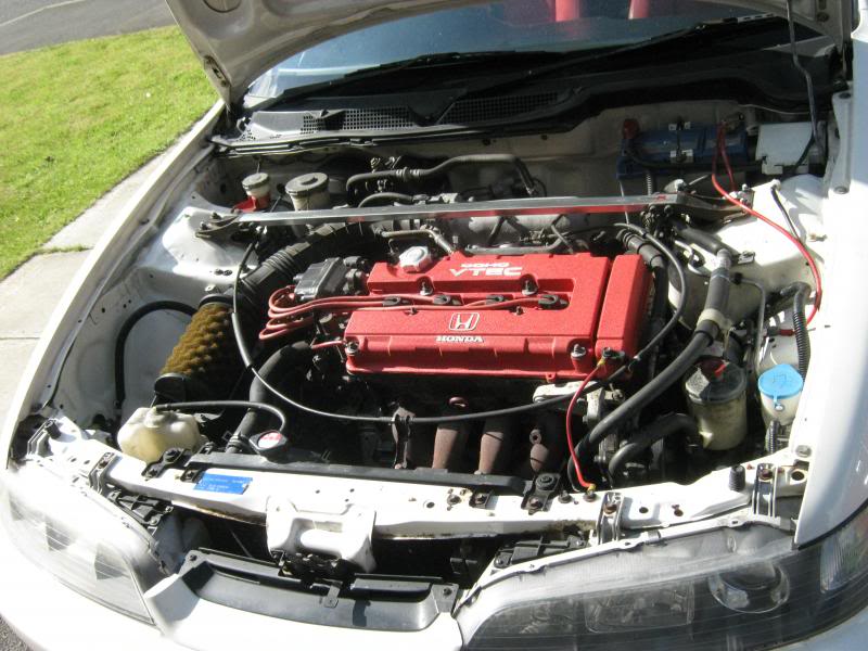

whilst the car was up in the air I removed the air-resonater box, quite heavy -
then de-greased all the painted white areas in the bay -
then gave it a bath now its on the drive not sat under trees now the fiestas
gone :)

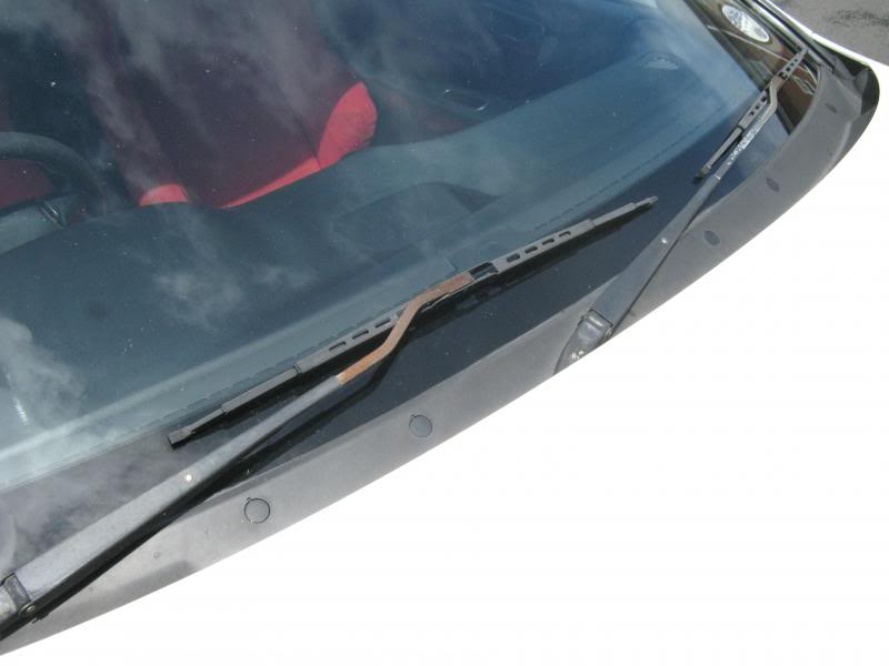

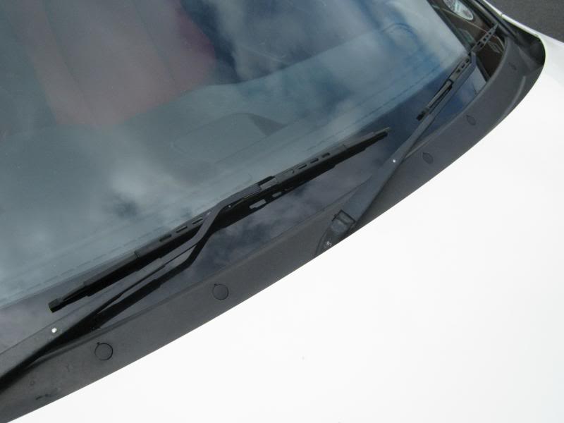

been faffing today, wiper arms before -
after -

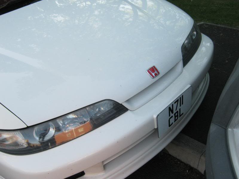

drained abit of oil as I overfilled it abit, then thought id take a pic of this bit of jdm'ness my mate noticed the otherday -
removed this as the position of it was doing my head in as its not central so ive ordered some new ones off ebay -
looks alright without but not as good as itll be with a new one correctly positioned -

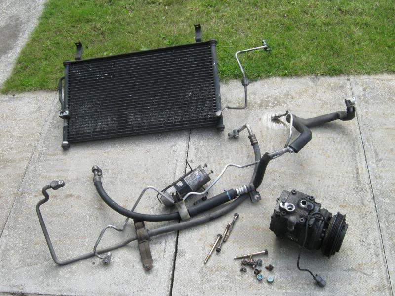

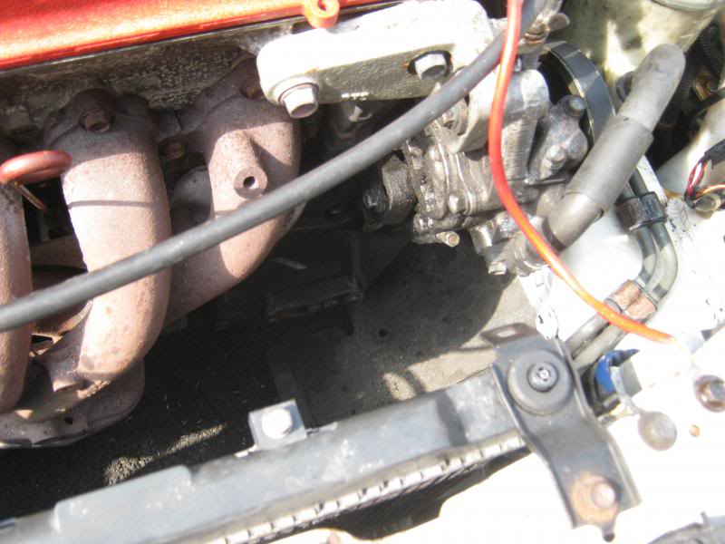

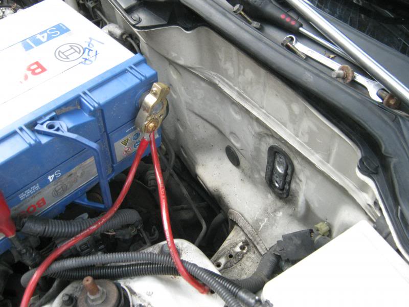

Going to remove the Air Con this week and get the new tip done!
  JDM Dc2

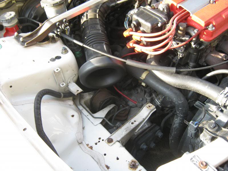

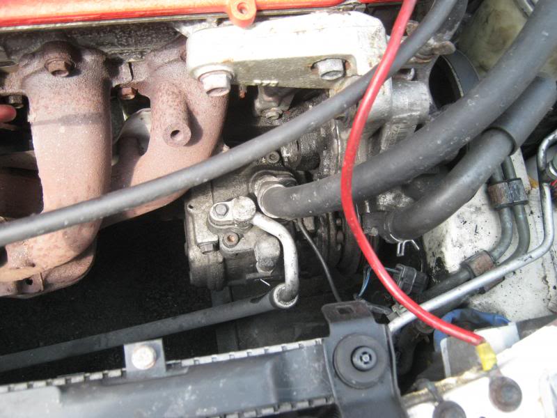

so, before -
where the AC pump was -
without -
battery tray removed and pipes removed right back to the bulkhead all removed undamaged or bent -
how the bay looks now -
everything that came off -

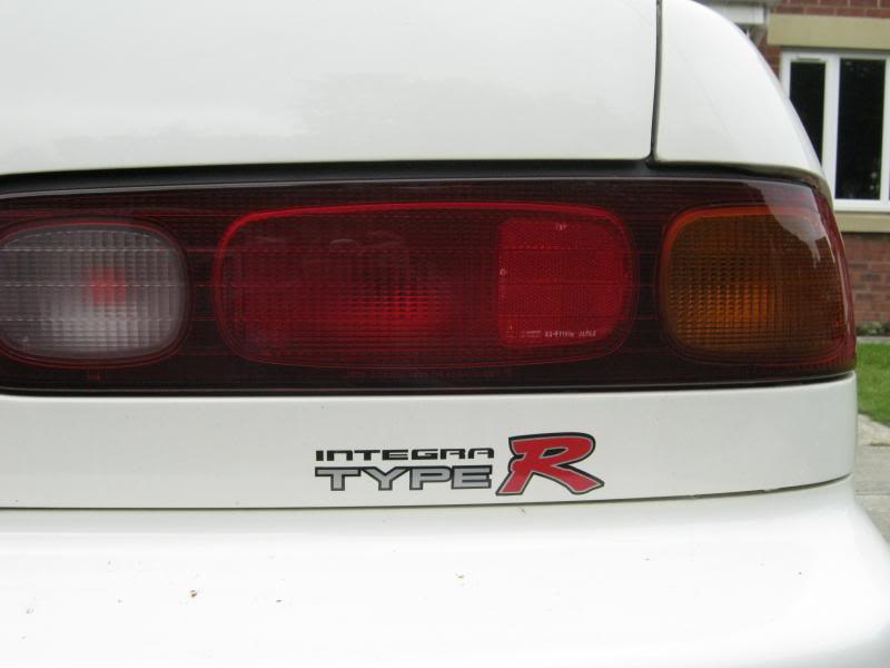

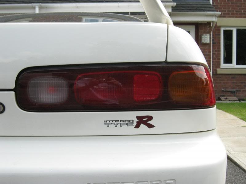

new sticker's came too, looks better central but im abut pissed off that the R isn't red -

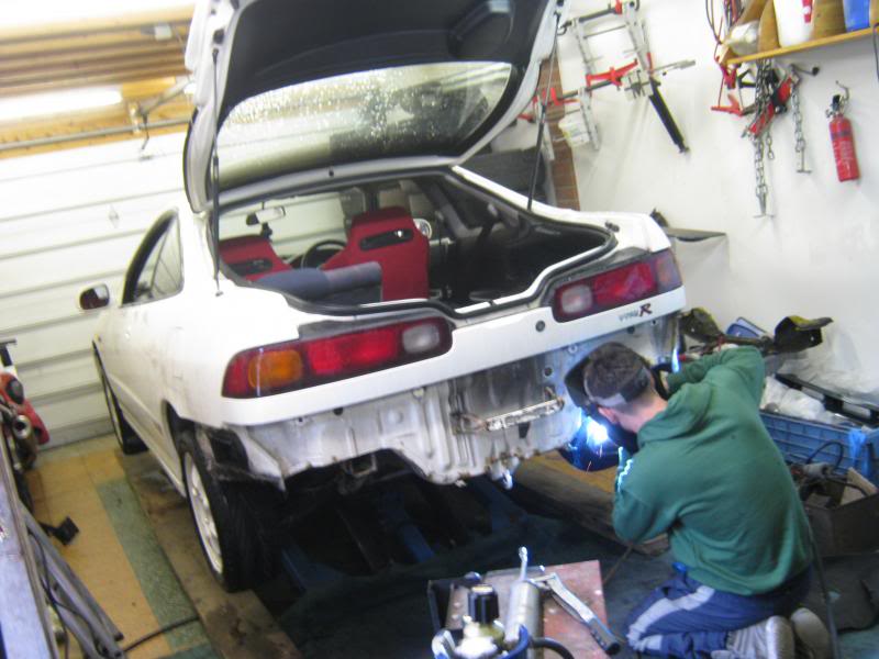

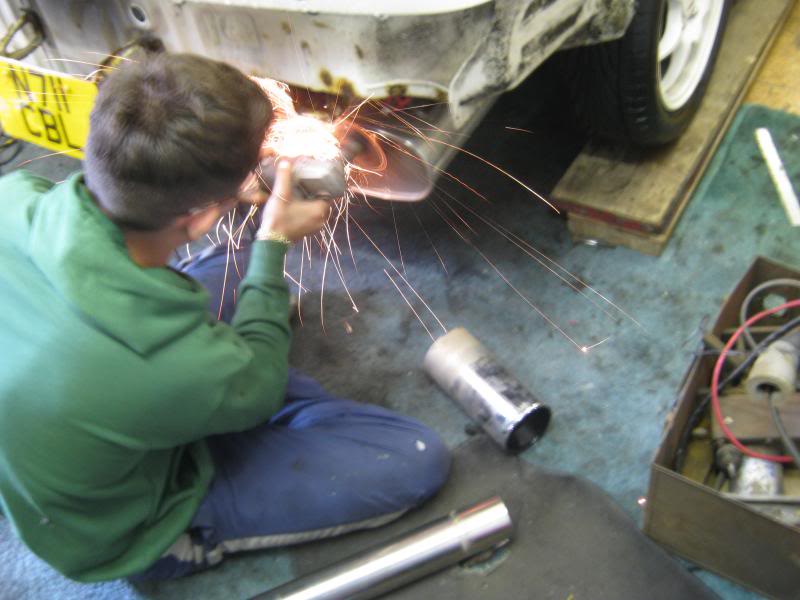

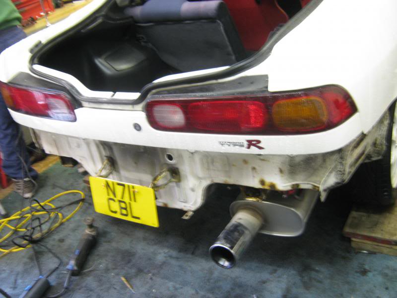

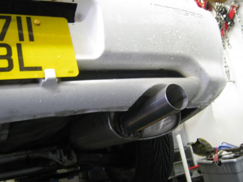

so, bumper off, tip ready to be chopped off -
ta da -
took the car up on the ramp, new one chopped to the right length then welded on, great when your best mates handy with a welder -
finshed and bumper back on, much better -

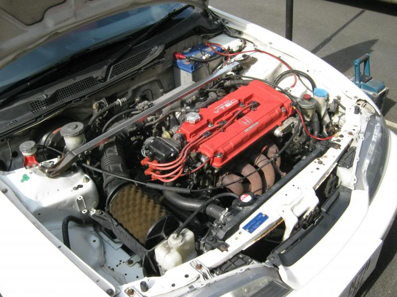

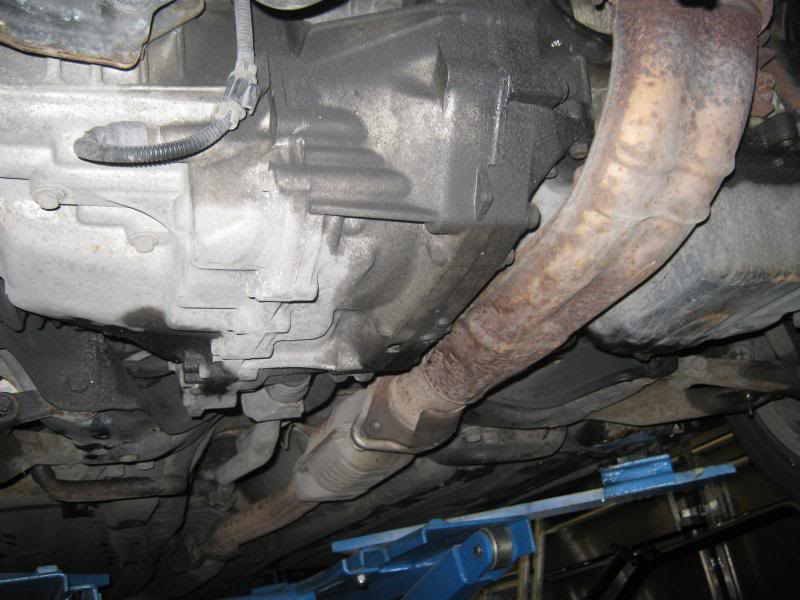

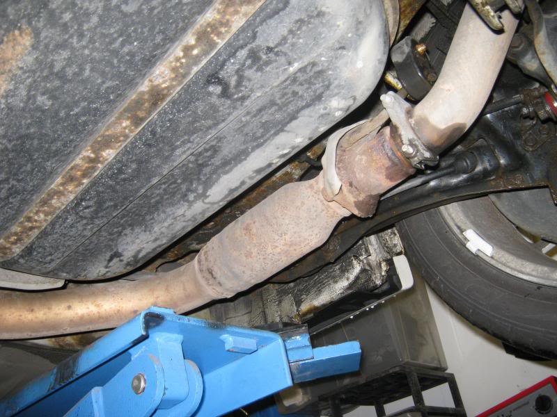

random pics, standard unhit manifold altho the sumps rather scraped haha and standard cat -
and the second centre silencer looks like its been bodged in for some strange reason I don't know why when it has a large centre silencer as it is and a large back box -

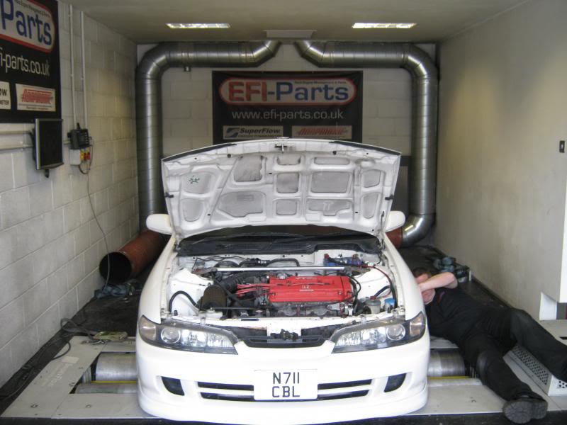

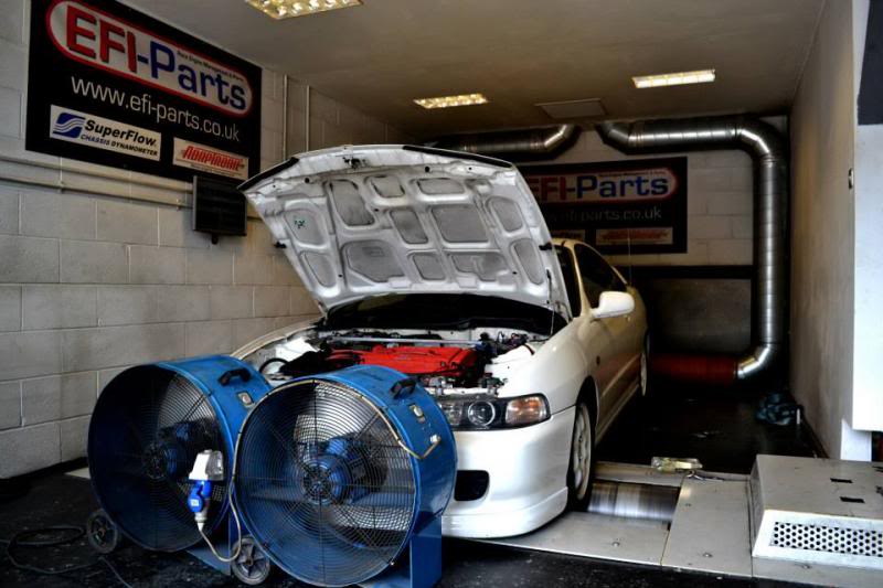

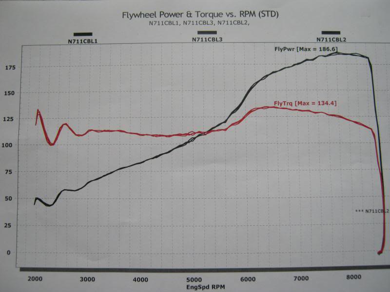

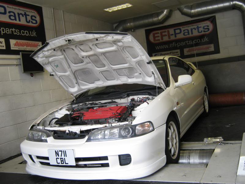

may de-cat it but going to see how the fuelling is first after the rolling road session at EFI sunday!

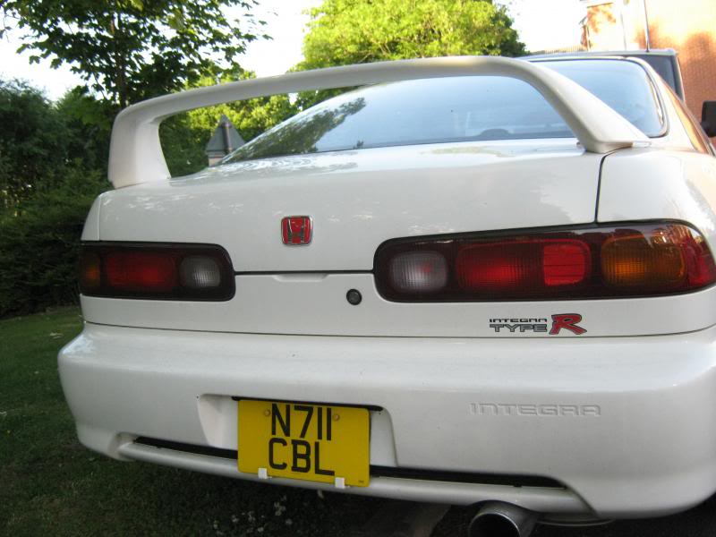

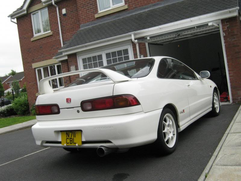

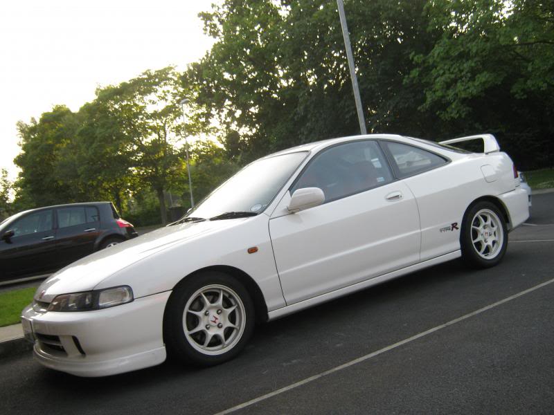

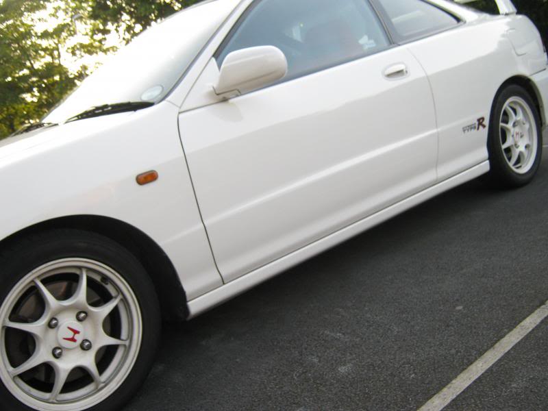

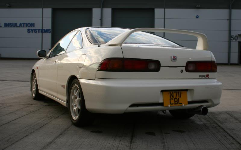

few more better pics from sunday, I fitted the new matching ITR stickers on the sides now too to match the one on the rear which I changed last week -
ive lowered it 5mm on the rear and 10mm on the front since these pics, I will be changing the suspension for dampening adjustable coilovers in the next 2-3months before i'll be taking it on track

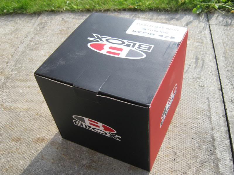

ive also bought a Blox Velocity stack air filter kit from America hopefully that'll be here before next weekend, if you don't know what one of these is here it is - http://cgi.ebay.co.uk/ws/eBayISAPI.dll? ... OC:GB:3160
meant to give the maximum gain over any filter/airbox on these

my mate had his ep3 on the rollers on the same day, 02plate with just a hks backbox and a k&n induction kit which is placed right next to the exhaust manifold haha, it hade 196bhp 143lbs ft, I had a go with it on the way there and I pulled away and I had a passenger, I was surprised but it must be purely down to the extra ~250kgs they have and the extra 500rpm these have

Where abouts is that mate?
I would hope mine has a little more with a straight through, n1 backbox and the hondata airbox mod.

Runcorn mate on the industrial estate there ive forgotten the name of it!
probs say 200bhp with that and just being down to the airbox as the K&N on my mates is dreadful, great for vtec roar but such a bad design kit!

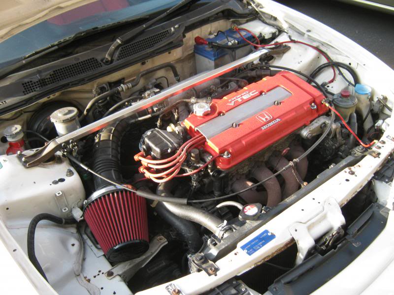

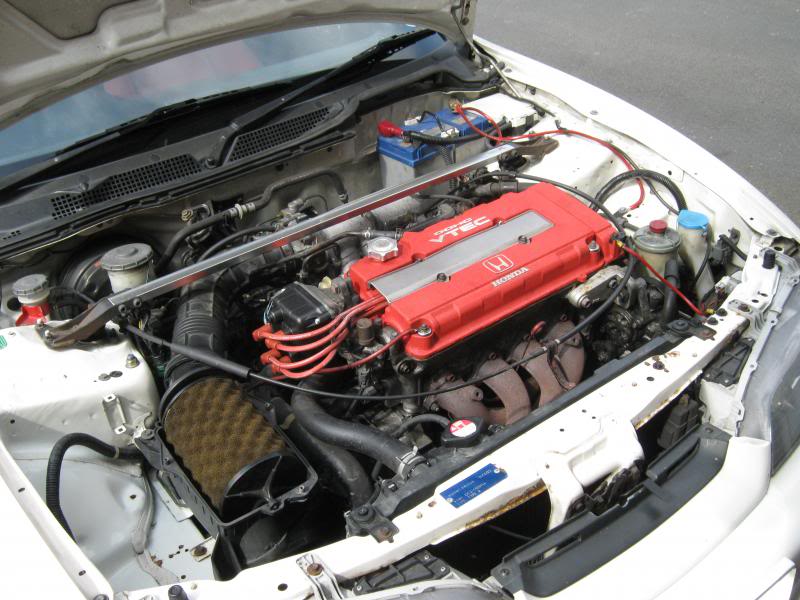

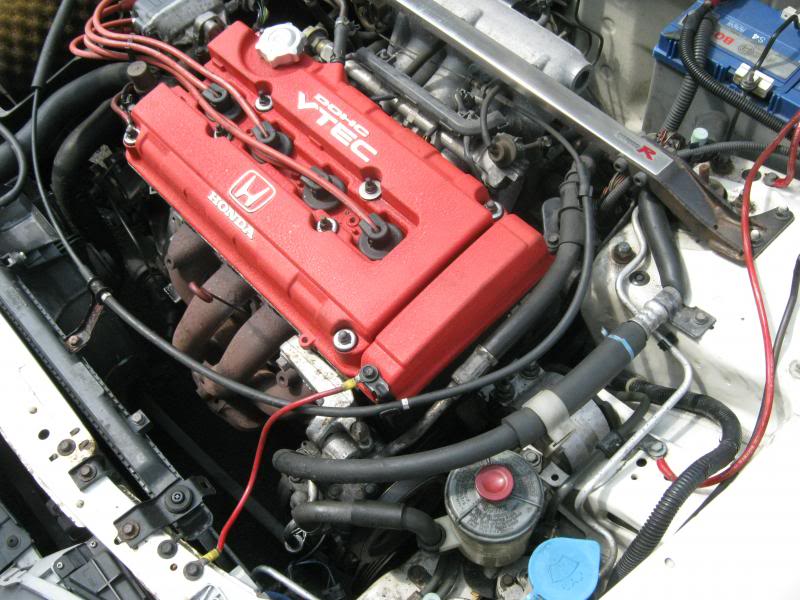

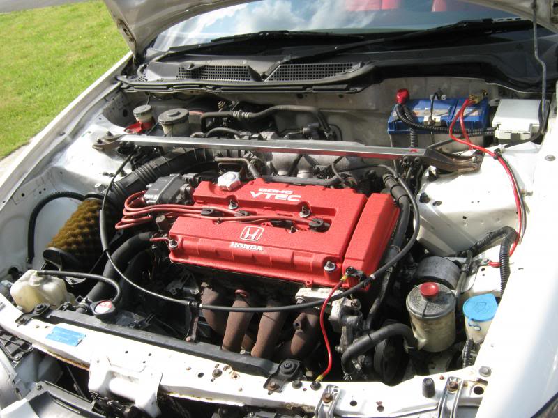

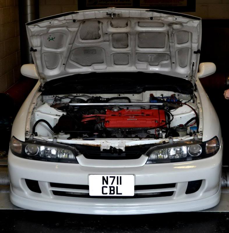

I went to a dc2/ek9 breakers yesturday to get a parcel shelf as the car didn't come with one, whilst I was there I got a spark plug cover, fitted it when I got home and removed the expansion tank too -
cant wait for the new filter kit to arrive
I also got a new pcv valve while I was there as I snapped mine when trying to remove it to clean it as its meant to reduce smoke on vtec , notta clue how but yeh, I tried and failed to remove it so I got one for a 5er from the breaker (160+vat from Honda lol), taken a good hour to fit it with getting the old one out with the ball ache of a position its in -
..and the crap long-nose pliers I have haha

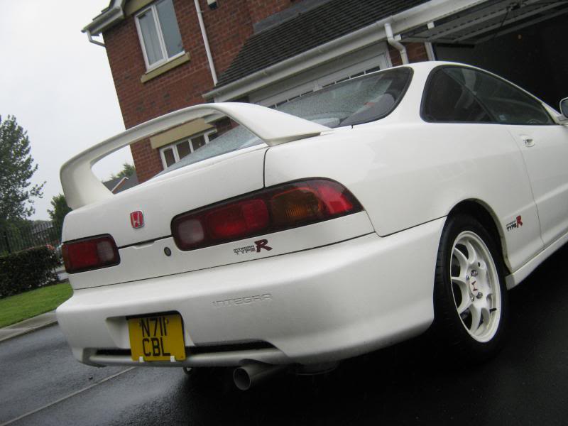

proper fresh pics after fitting all new stickers, badges and lowering it a tad -

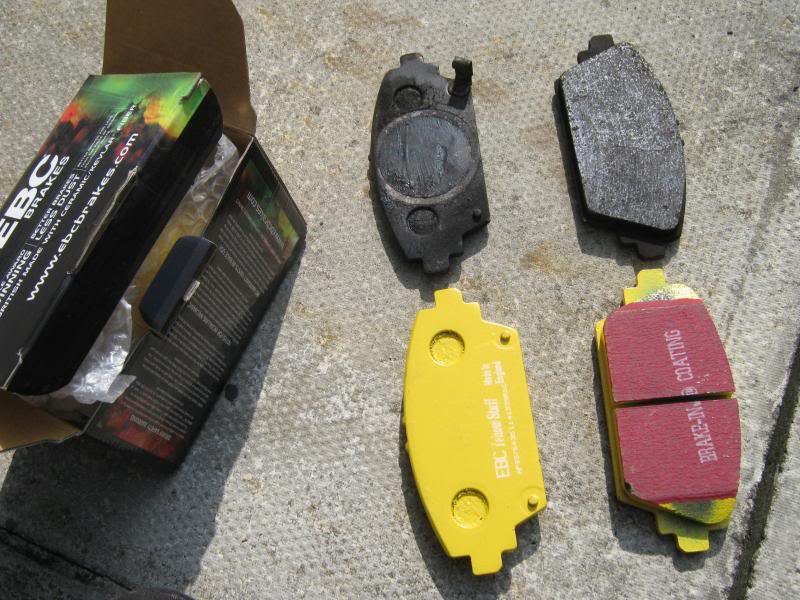

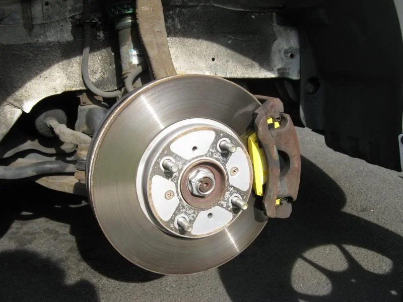

returned the pads yesterday and in return I came away with some yellow stuffs as they don't do ds2500's for these calipers and a 95quid refund too...
so, pads that are the correct size -
fitted -
theyre awesome, they were even reversing off the drive nevermind after bedding them in and giving them some stick haha
also this box came yesterday -
so, airbox and spoon filter removed, velocity stack fitted -
filter fitted -
sounds mega and it definaty feels abit better, ive bought 250mm of 3.5'' stainless of ebay to get it tucked right behind the headlight and im also going to sort a cold air feed too eventually
