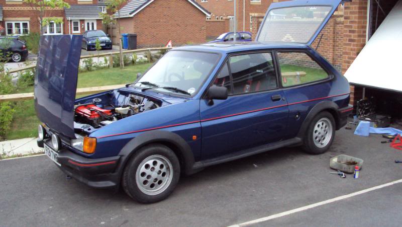

Just been out ont he car for the last 3 hours taking advantage of the good weather...

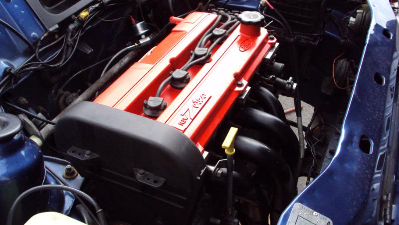

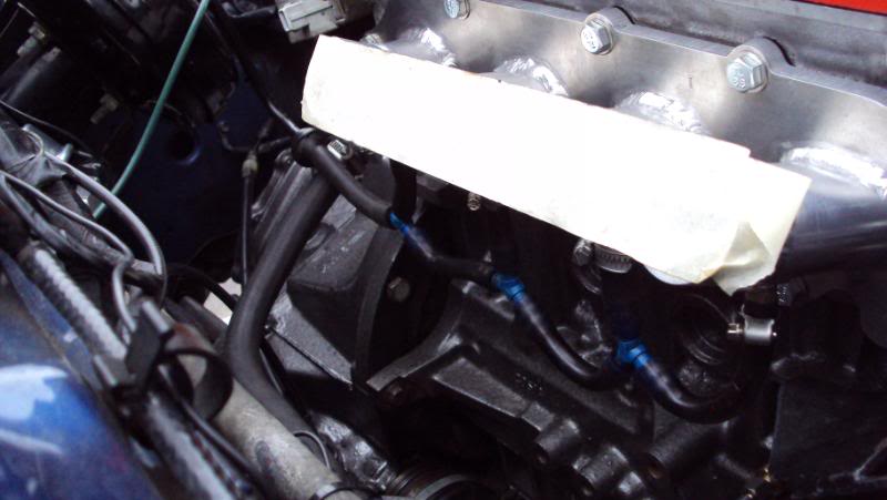

Vacuum hose to all 4 inlet primaries done -

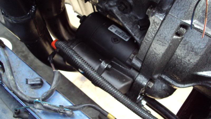

XR2i starter motor on -
Ashely 4-2-1 manifold on -
Lower arm/ball joint/anti roll bar back on -

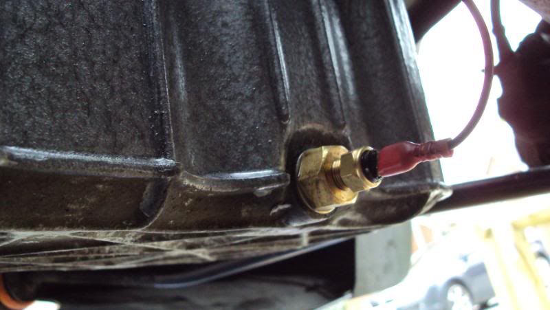

Oil temp sensor -
also did the pressur eon but forgot to take a pic lol...
wheels on and car back on the ground -
the tightened the HUB and wheel nuts.
Can tell the zetecs a lighter engine as the car sits like 10mm higher ta the fornt than it used to lol
The trackings a mile out so going to get that done once i get the new tyres on and the wheels checked out to see if they're buckled or not.
More soon :D

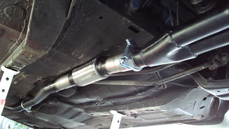

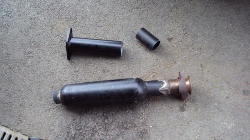

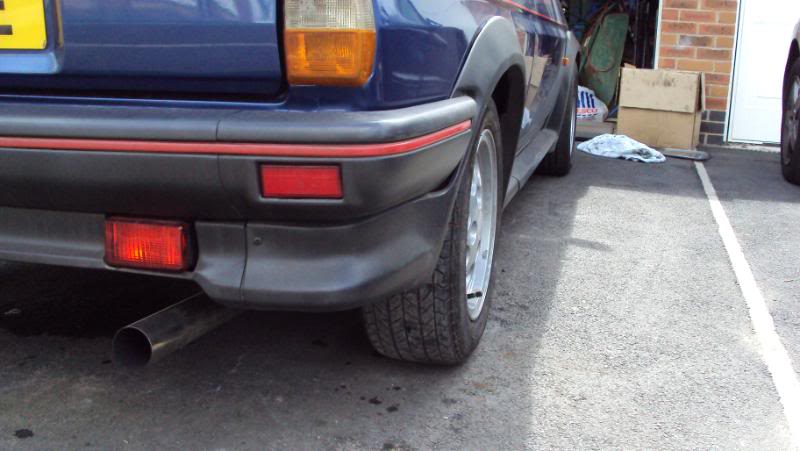

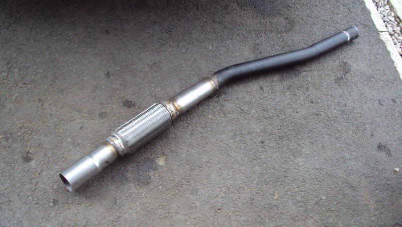

In the rain i cut up the exhaust last night and measured up for the section that i needed making as Pipewerx aint open on saturdays so i neede dit doing
so cut this lot out/off -
went to Pipewerx on my way home from work and had this made -
fitted -
the sleeve and all the measurements are spot on aprt form one thing... as you can see the flexi joint is hitting the shell slightly underneath so that'll be ittirtating vibrating whilst driving so once its all up and running and mapped ill shoot back upto Pipewerx and get it sorted and also get them to make me a 3rd hanger

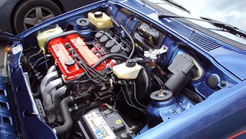

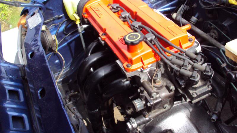

bit more progress

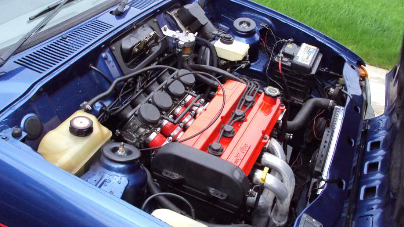

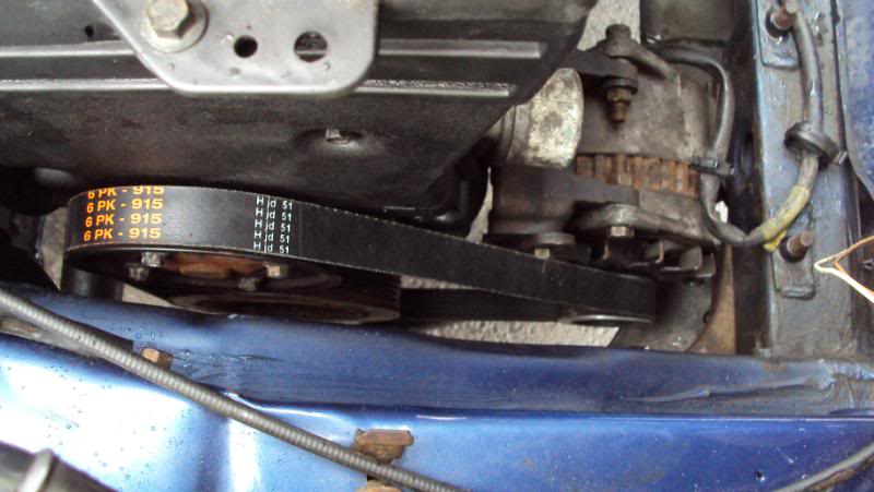

went and got a auxuilery belt this morning, got back fitted that and the alternator -
This image has been resized. Click this bar to view the full image. The original image is sized 800x451.
then fitted the throttle cable making sure im getting WOT when the peddles all the way down -

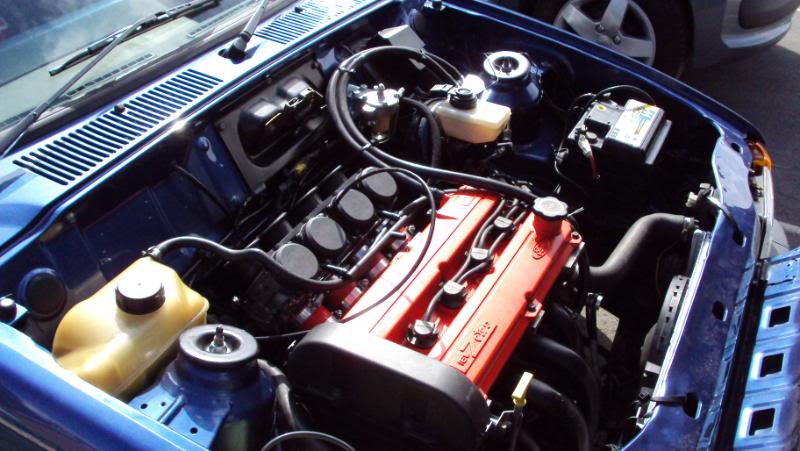

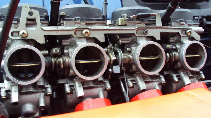

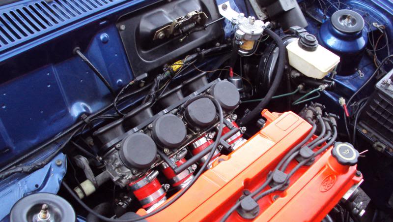

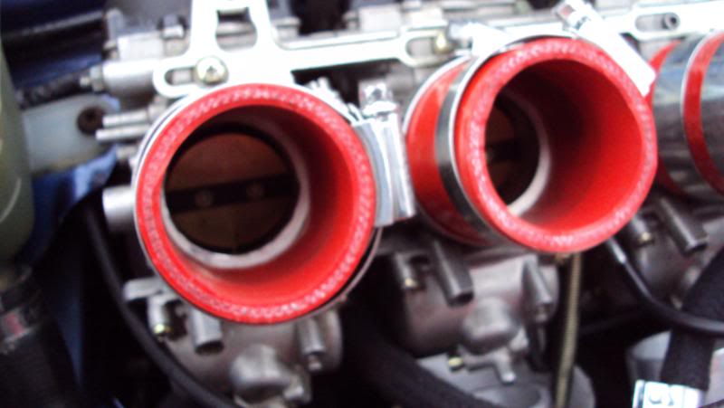

then cut down the carb hoses to 50mm and fitted the carbs -

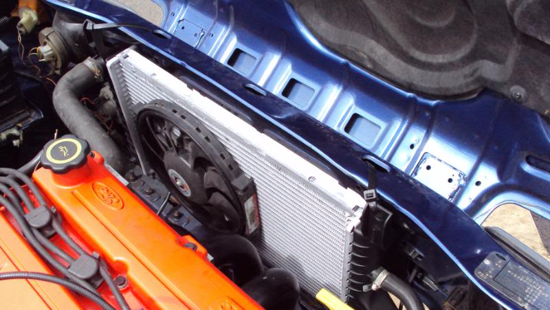

then fitted the Rad, Fan, header tank, coolant hoses then filled it up with anti freeze/coolant ready mixed stuff form halfords -
Then filled the engine up with some 5w30 oil and the gearbox with 75w90.
Then fitted the clutch cable

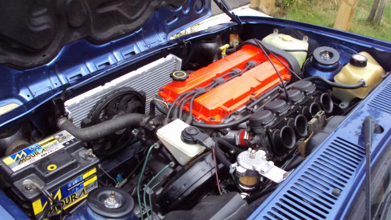

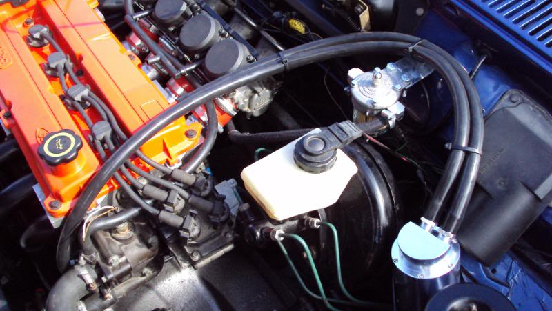

then fitted the oil catch tank -
and there we are ready for the omex to be fitted then hope it all runs fine

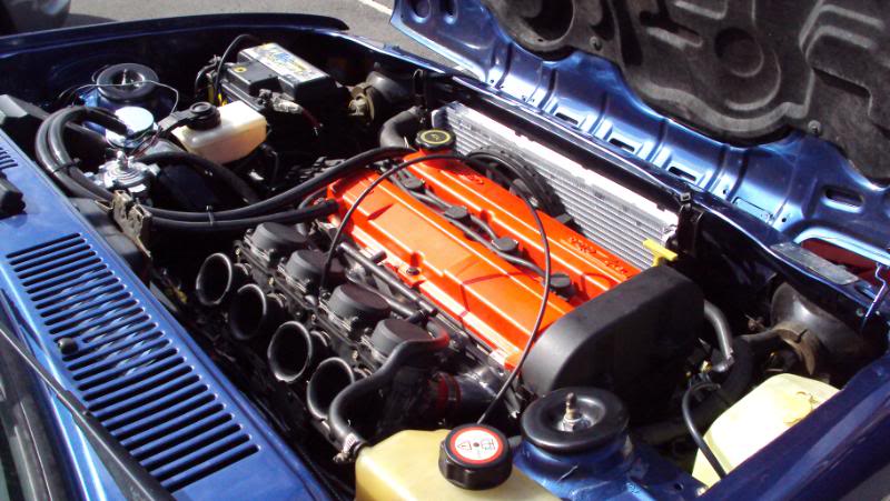

Omex is wired up now after ALOT of pissing about with problems etc...
drove the car before, after bedding in the cams and once the coating burnt off the manifold lol... can definaltly feel the powers there but i couldnt really feel the power in 2nd as the gearbox REALLy doenst want to go into 2nd or reverse... ive tried about 5 different positions on the gear linkage and top chucked an extra 1L of oil in... still no 2nd or Reverse... gonna go for a drive later and see if it gets any better hope so after paying 150quid for a gearbox which could/seems to be useless to me now :(

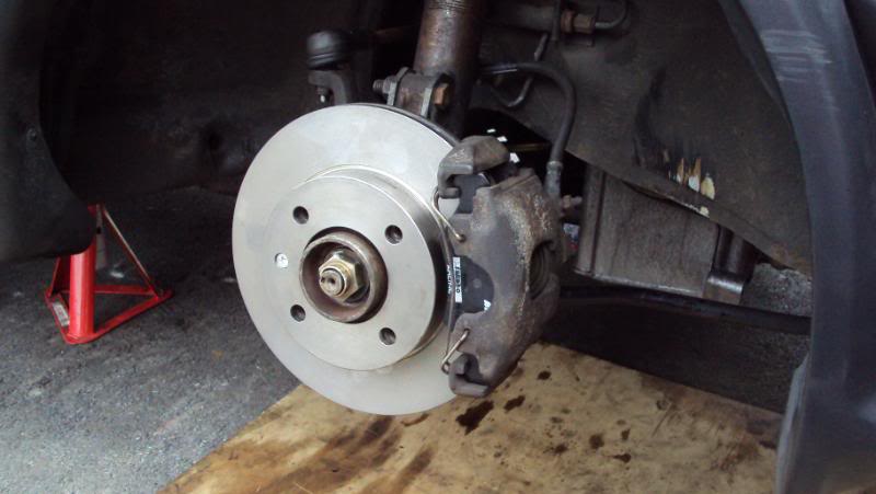

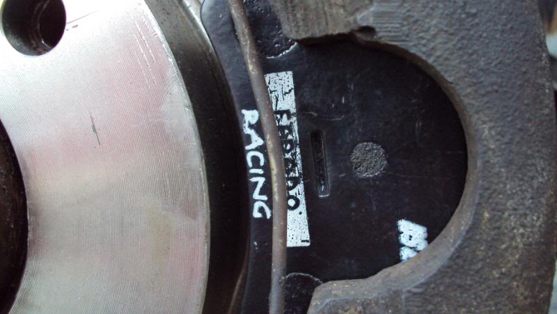

whilst the car was in the air thought may aswell fit the new Brembo Discs and Ferrodo pads so they're done with -
not drove the car today to bed them in will tmoz tho

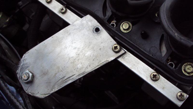

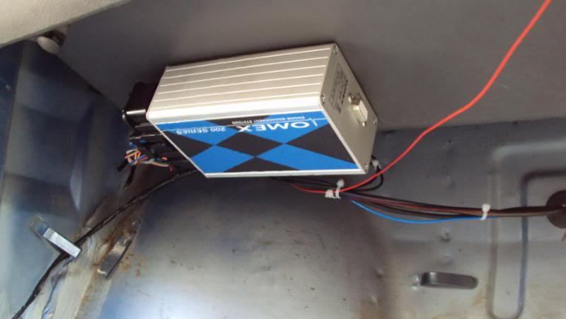

quick pic of where ive mounted the Omex 200 too, as you can see the 25mm hole i drilled then fitted a grommet to feed the wires into the bay at the right height etc -

Bedded in the brakes yesterday, they're awesome, think the system needs bleeding tho so going to do that once ive done the rear beam as you need to disconnect the rear brake lines to get the beam off.

carbs jammed last night whilst driving 'enthusiastically' last night causing it to go straight to the limiter...
just had a look at them and the problem was this screw had popped out so there wasnt enough slack on the return spring, which was causcingt he butterflys to be around 1/4 open -
so just found a screw to suit, fitted the carbs back on started the car, sweet as a nut, was expecting the worst tbh but glad it was only minor!

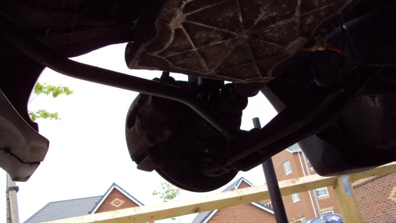

big thanks to jord again who came down to give us a lift fittingt he new beam on nad helping bleed the brakes...

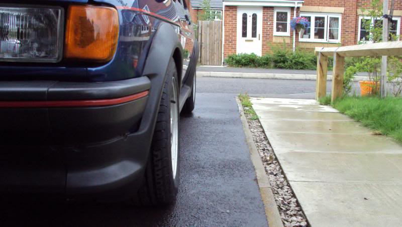

now no more positive camber
the rear wheel was ridiculous how bent it was, so swapped both offside wheels over the the 2 silver ones i got a few weeeks ago

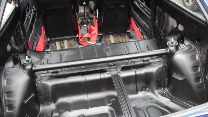

Washed the car earlier first time in about 5 weeks -
then decided to paint the rear of the car in Satin black, will do the front next week probs, just looks alot tidier as it is tbh -

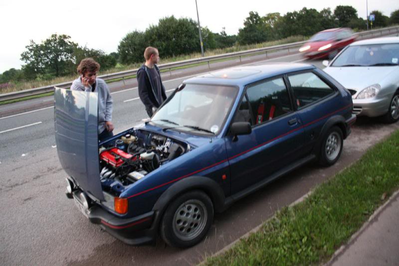

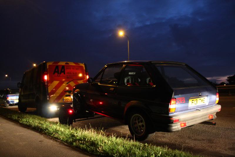

had a couple of problmes tho on thursday and friday...
on the way to a mates my exhaust fell off... where the 2-1 part joins the 4-2 on the manifold, just slid off even tho i hammered it on originally and used lots of silicone sealent
, so bren brought his jack and axel stand out and i fitted it back on just as tight as i could get the brackets on, just checked it and its slid back off another 5mm too (FFS), so again just undone it and tighetend the clamps up as much as possible, going to ask andy very nicely will he weld it together on monday for me as it needs to come off to get the sump off to check the oil pump, if he'll do that for me then theres no chance of it slipping off again then, good old ashley!
then started the car last night to go out, then the revs just dropped faster than usual and cut out after like 20 seconds, tried to start it again and the fuel pumps not priming and theres no fuel in the filter king there usually is after one prime of the pump, all fuses are fine and the relays clicking but just no fuel in the filter king, so must be the pump... so got a new fuel pump, tested it before i bought it, it works great, fitted it to the car wired it up correctly and still nothing, checked all the wiring where i soldered and they're all absolutely fine, relays still clicking...then a quick call to f0xy then realised thatt he realy was wired up wrong but how the hell has it been workinga ll this time? :S so change the wires and happy days it lives again :D

You used silicone sealant on a slide fit exhaust?
/ Facepalm
yeh whats up with that?
pipewerx must be going wrong aswell then LOL

going upto a mates tmoz to check the oil pump as there could be a blocked or the pressure relief valve might be jammed as the oil pressuers pretty high also causing the engine to heat up really quick.
Sounds like its knocking its tits off, coupled with it smoking like a tropper, you sure its not fooked?
I need to come to this "private runway", looks like a good bit of road. Awesome noise btw :)
its not knocking just tapping, somtimes its really smooth otherimes its like that in the vid, in-consistent car ftl

It's not the first thing I'd use, and it probably slipped off because to cure well enough to hold pressure it needs 24 hours.
everyone i know uses this, its not to hold the exhaust its just a back up incase of any tiny holes as U-clamps are w**k, cant imagine anyone waiting 24 hrs to wait to start the car after fitting a exhaust, as i said Pipewerx must be doing something wrong too
That's what exhaust paste is for though, it hardly breaks the bank lol. I've had the same tube 3 years and done 4 sets of exhausts with it, for about £5! When I had to silicone my brake servo to inlet manifold, after a few hours it still wouldn't seal properly. Left it overnight, job done.
  JDM Dc2
ive got exhaust paste i just think its crap and just flakes off
