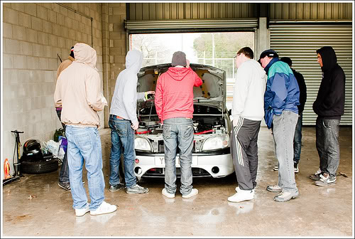

at the end of that session iirc was going around hizzy's chicane went to power it up the hill and there was nothing, sounded like a major misfire/tapping was worse/possibly bottom end.
RAC guy pulled all 4 wire connecters where they go on the injectors, 2 of them cut the car out, the other 2 nearest to the flywheel didnt, so then he said could possibly be headgasked on that side...
fk knows what next, think f0xys gonna help us do a compression test, then gonna take the engione out over the weekend, take the sump off check the bottom end, if thats fked its bye bye for that one.
Overall not happy at all tbh considering it was all built back up 3k ago and bottom end only had 10k on it!!

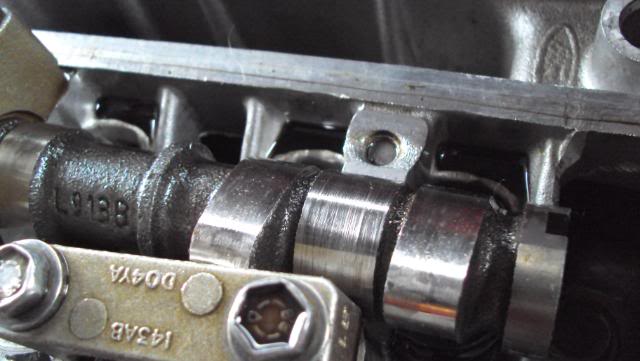

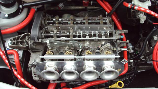

let the games begin...

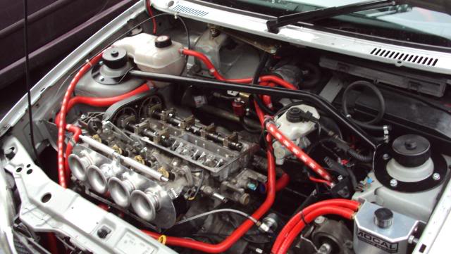

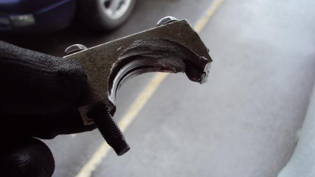

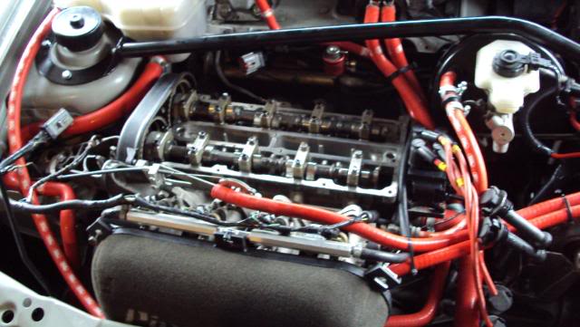

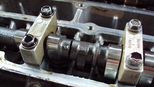

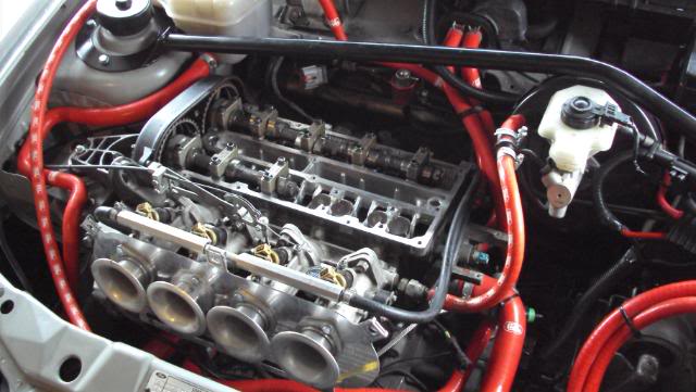

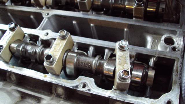

removed the rocker ocver -

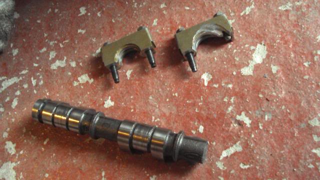

to find, 2 loose carriers and one snapped cam -

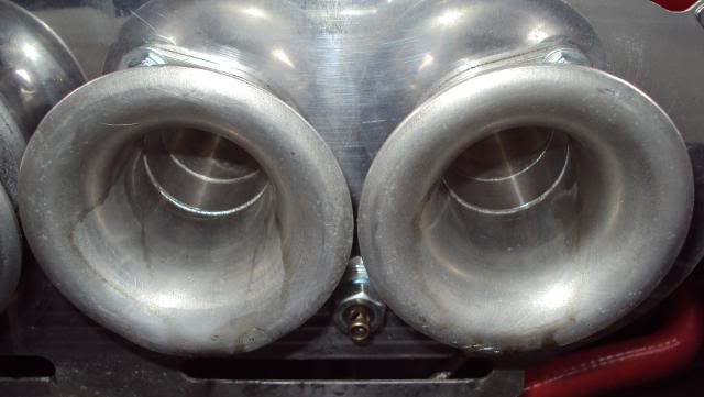

then took the filter off and seen this -
the other 2 were as bling as the other day when i took the bonnet and filter off...

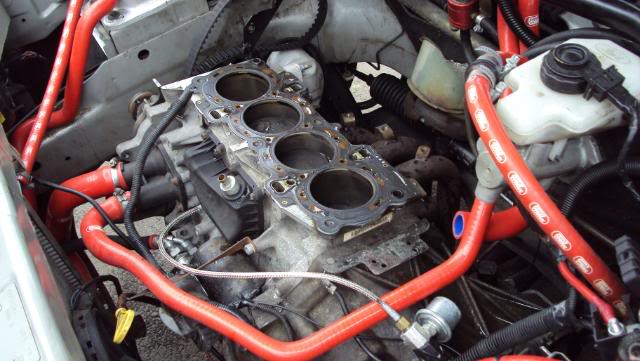

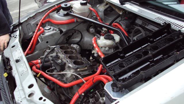

then drained the coolant, disonnected the loom on the bodies, fuel lines, throttle cable etc etc (this pic wasnt talkin after all this was done) -
I checked the oil again beforeand its still on max so now 99% sure its not the bottom end as it wasnt smoking or anything just knocking and surely the knocking was the cam hitting that carrier above as you can hear towards the end of that engine video, probably a few hours work for jon now that everythings disconnected ready to whip the head off, just need to disconnect the exhaust manifold and the aux. belt now, just hope he will do it alot cheaper than normal consideing as now its looking like its all down the the carrier not being tight enough set to the right torque setting, that probably explains the very loud tapping when on idle as its been working sits way loose ever so slightly probably.

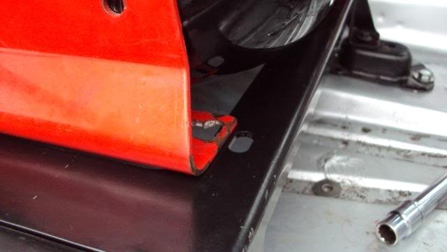

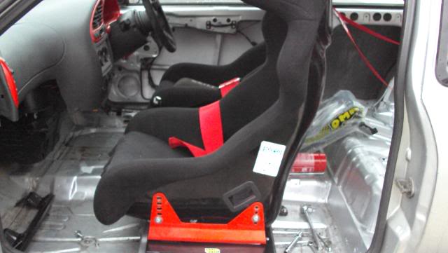

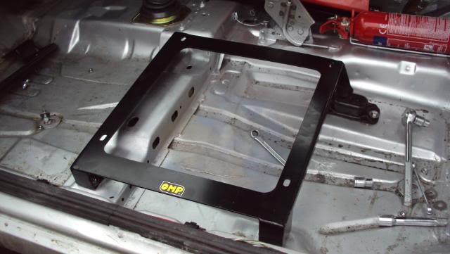

Wel while im waiting on a message form jon now as the heads pretty much ready to come out thought id fit my new seat subframes -
then placed the seat on, the rersult -
1. the seats sitting far too forward (like 90mm further than it was)
2. the holes dont line up, width wise poerfect, lenght not!
some modifying needed!!

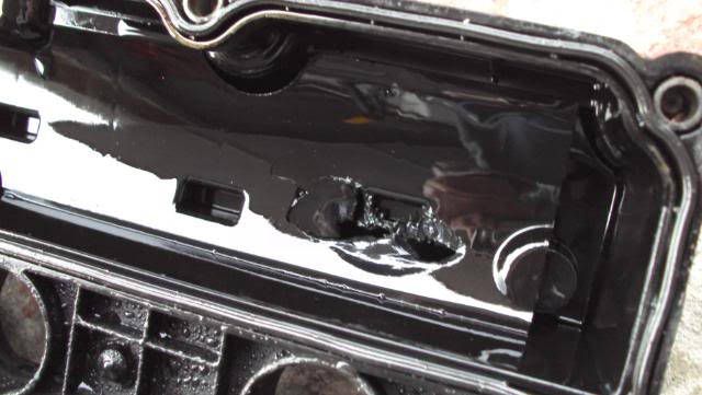

One the rocker covers 'smashed' inside where the carriers been hitting it -

heres how the bays looking now, all thats left is to remove the rest of the carreirs and the cams, slide the cambelt off, then just undo the head bolts, shouldnt take too long....

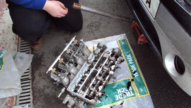

Jon and Dan came a couple of hours ago, got the head off, valves have made contact with piston 4 slightly but the bottom ends fine, turns over perfectly
So jons took the head away with him to sort where the carrier bolts enlarged one of the holes and the others sheared off, valves seem to be fine.
When they left i just drained the oil out of the block and the oil cooler and replaced the filter with one for my 1.25 which i had hanging around.
so so far i think all that needs replaced is 2 carriers and bolts to go with them and another SS4 cam for the inlet, jon said he'll let me know when the heads sorted then he'll sort a date out with me when they can pop back and re-fit it for me.
