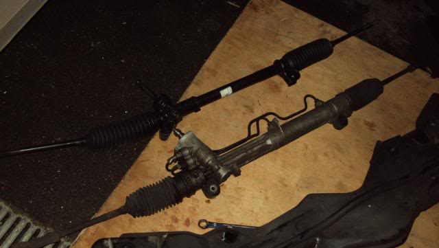

Got home and didnt waste any time so removed the PAS rack form the subframe, side by side to show the size difference -
then fitted the new none-PAS rack to the subframe then got it up on 2 jacks under the car (absolute ball ache as it kept falling off), once i got it to the correct height i slid the manifold between the gap i made then raised the subframe up then tightened it up to the car etc etc... then followed the ball joints/lower arms, gear linkages and the drop links fitted, then tried to do the lower engine mount but cos i bent the cast of the box itself when i fitted the old VT mount with no spacers side by side and now its bent that much i cant even squeexe on in lol, so will have ti just get 2 M10 penny washers and they'll do...

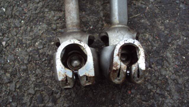

Went to the scrappies to get the bottom part of the steering coloum, on the right compared to the PAS one on the left -
Then got home and fitted it, perfect!

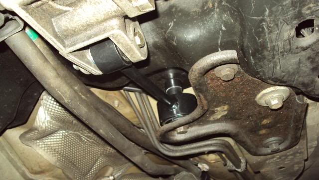

On my way home i nipped to B&Q and got a pack of M10 washers for either side of the VT mount, fitted -

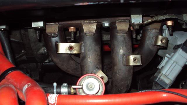

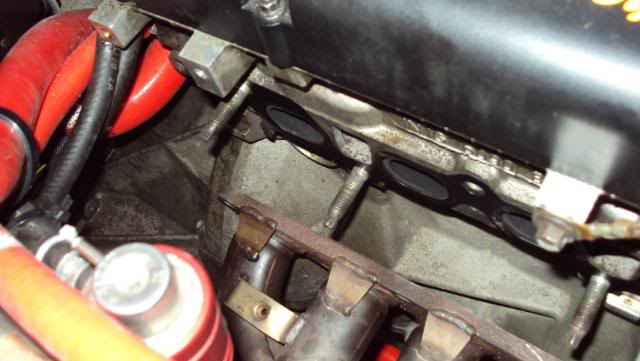

Then onto the manifold... new gasket -
Fitted with the new nuts and bolt, while i was under the car i re-fitted the wire for the Oil-temp snsor too -

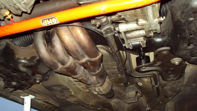

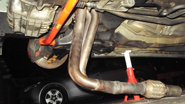

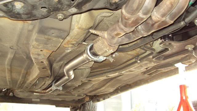

De-cat and system fitted -

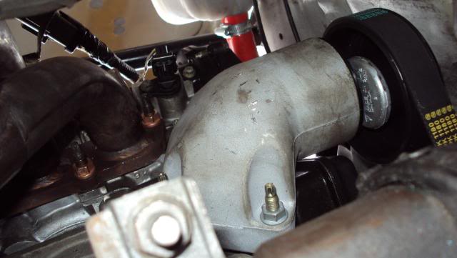

Forgot to take a pic of that new rear tensioner, so here it is as it needed when your doing away with the PAS -

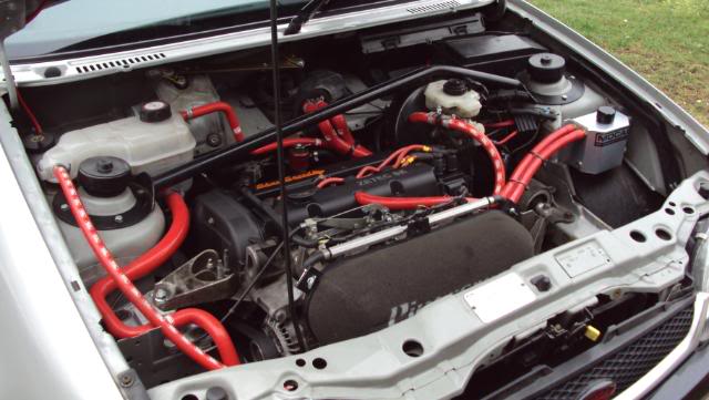

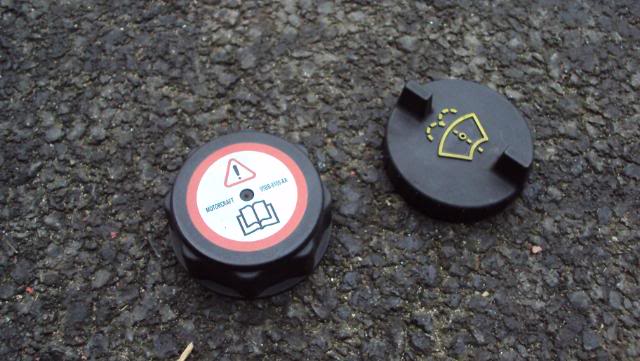

Bay with no PAS and the new windscreen washer bottle and coolant caps on

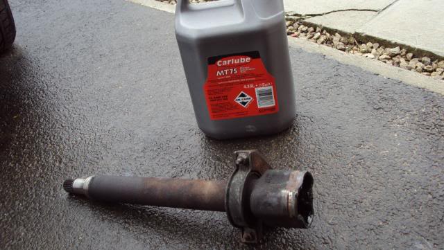

Picked up the driveshaft for the rear of his engine off Adam yesterday as mine got alot of play in the housing and leaks oil for the gearbox side, also got some Carlube Gear box oil -

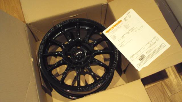

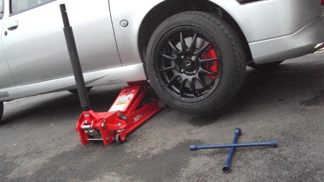

Wheel arrived bang on time today and was at a neighbours house when i got home from work -
then went to the local tyre place and got the tyre swapped over and then i fitted it wehen i got back -

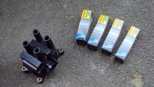

Next on the list is change the coil pack and spark plugs tmoz ready for friday!
  JDM Dc2

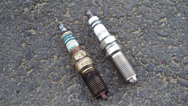

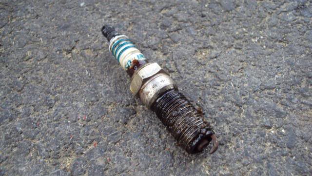

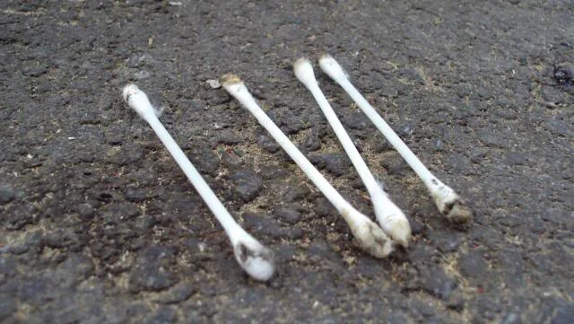

Just changed the spark plugs and coil pack as the plugs needed doing when i got the car 4k miles ago so thought it was about time, just standard ones as there been tried and tested and are well suficient -
Old vs new plug -

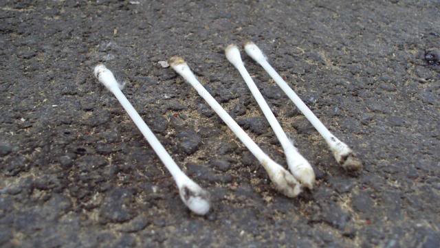

... well that was what 2 of the looked like the other 2 looked like this
god knows why there like that, that was only on the threads tho the pistons were dry, so soaked up the crap form the threads on the head with these lol -
then fitted the coil pack and started first time

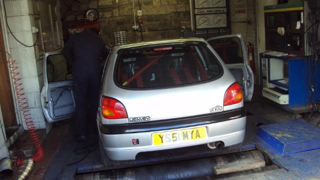

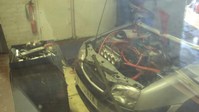

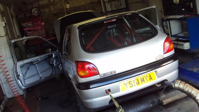

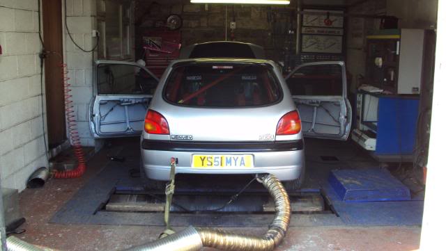

Mapped!...
quick vid of one of the power runs (not the best sound quality) -
http://www.youtube.com/watch?v=SePqq4C-X5A
Made: 157bhp @ 7600rpm
121 lbs/ft @ 5600rpm...
after a mate altering the map ages ago and turning the decel off it feels so much nicer and faster now and picks up really well, and still pops flames too with the decel on as bren witnessed

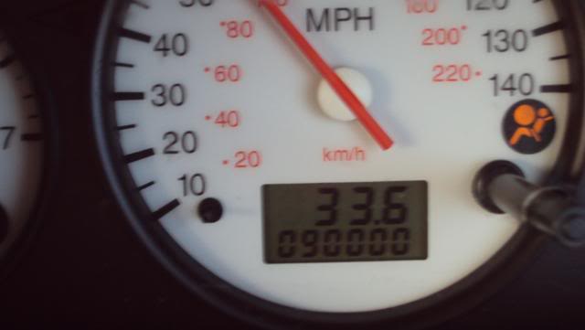

ticked over 90k on the way back too lol
