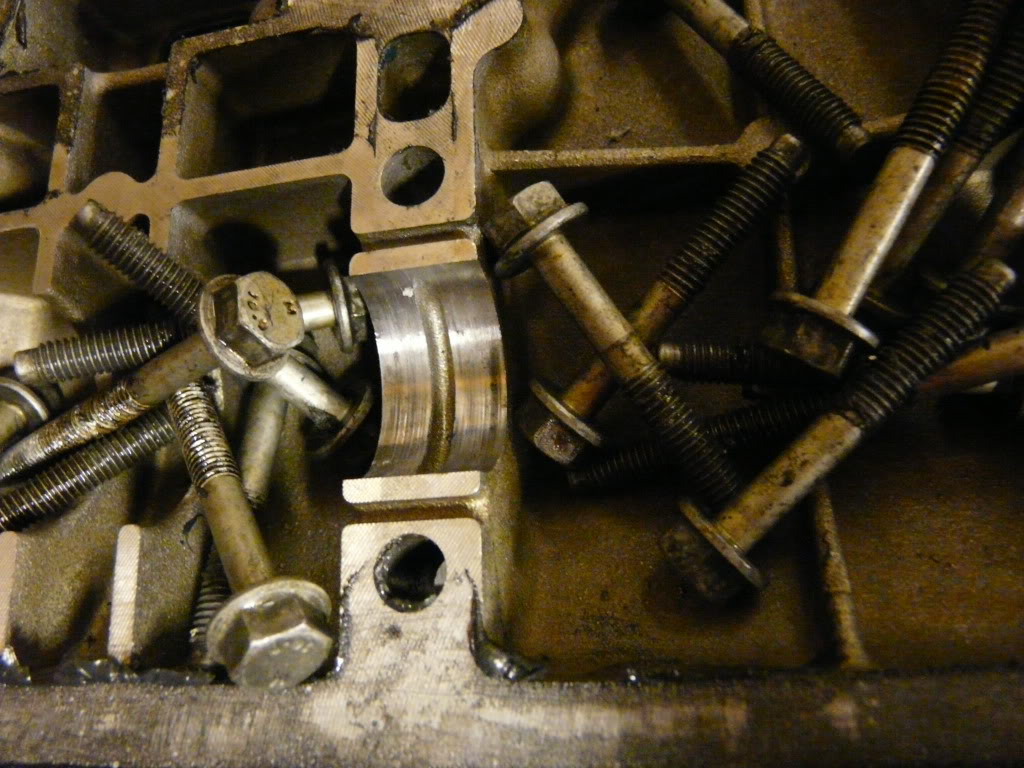

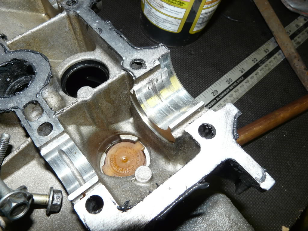

Picked up an engine on Saturday, had the sump off and one of the mains caps to check everything was all good before buying. Turned over fine by hand, decent compression, etc - all seemed good.

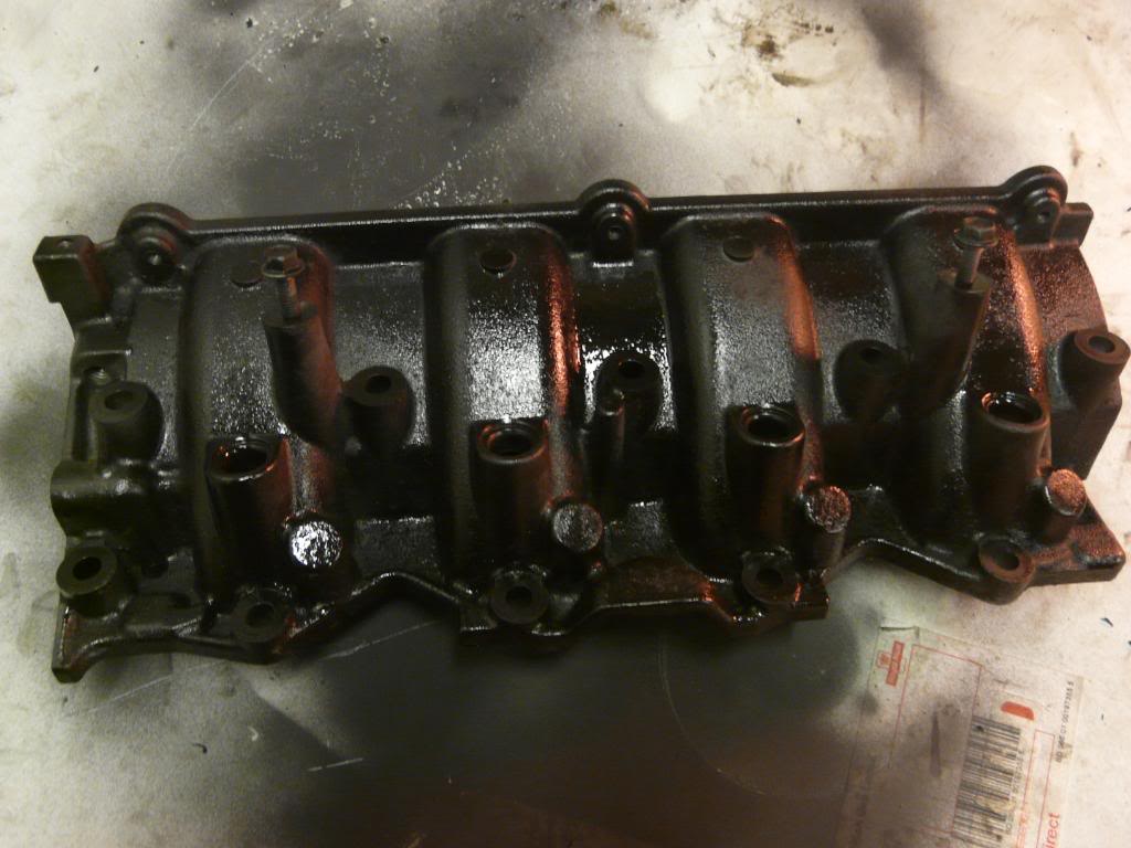

Going from that I think it confirms the rocker cover is the problem - either its not matched for this head, out of shape or just generally f*cked. We must have been lucky to be able to turn it over when we picked the engine up - I still think that was because the rocker cover was 'loose' and not properly torqued, allowing the cams to spin. As soon as its torqued they are pretty much locked solid. Very very weird.
Sooooo at 10pm last night after having the rocker cover on and off four times we went to pick a spare head for the engine - which has its matching cover, cams, etc. So we don't have to f*ck around with the dodgy one that's currently on the engine. That should give a solid engine once built and we will know that its been done properly. I'm glad we took the cover off now to replace the sealant or we would have never found the problem... and who knows what might have happened when it was run.

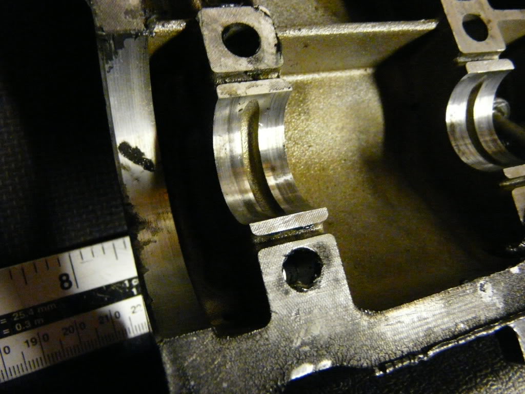

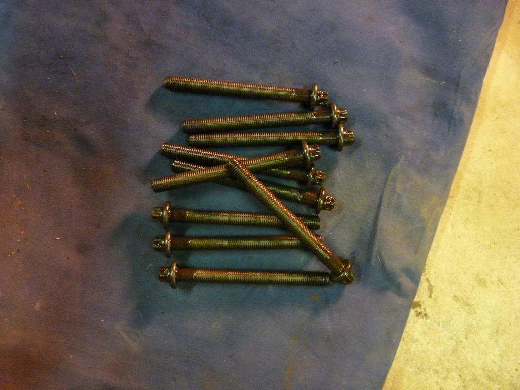

jord what torque wrench/setting are you using, sounds VERY odd
8nm on the four outers as stated in the manual, then 12nm on the rest in the right order, then the outside four to finish to 12nm. Teng wrench...
Must have done the same 50+ times in the past, first time this has ever happened. The bearing journals on the cover look f*cked, but I think its the wrong cover for the head, it really does not seem to like it (think its been rebuilt with parts from whatever was lying around).

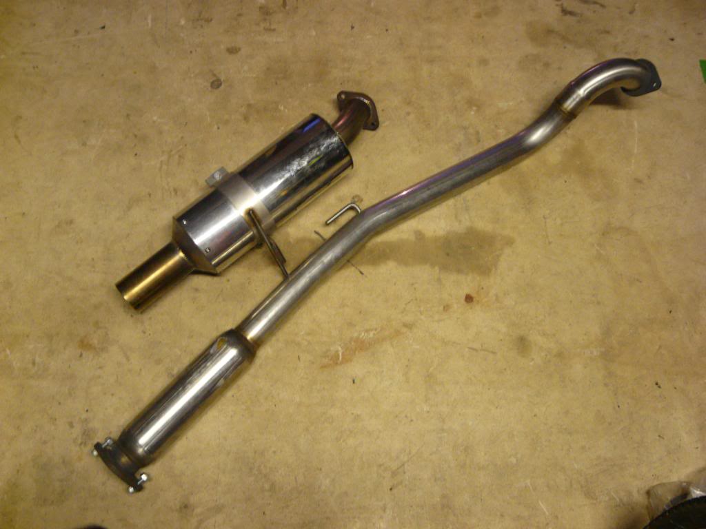

Right time for the updates.... before i crack on ive been meaning to put a few pics up of the yozza thats i bought, the yozza was virtually brand new, the backbox has covered 100miles and the center section is brand new... nd the pics
its has a 2.5" straight cut tip on it

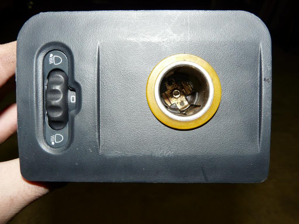

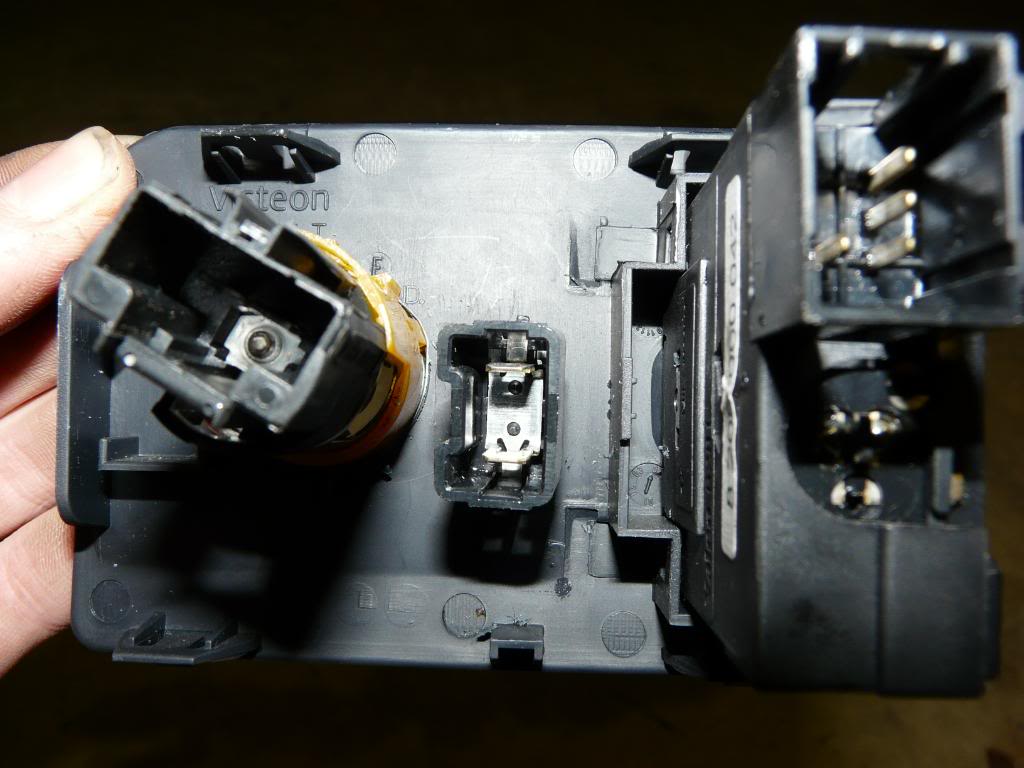

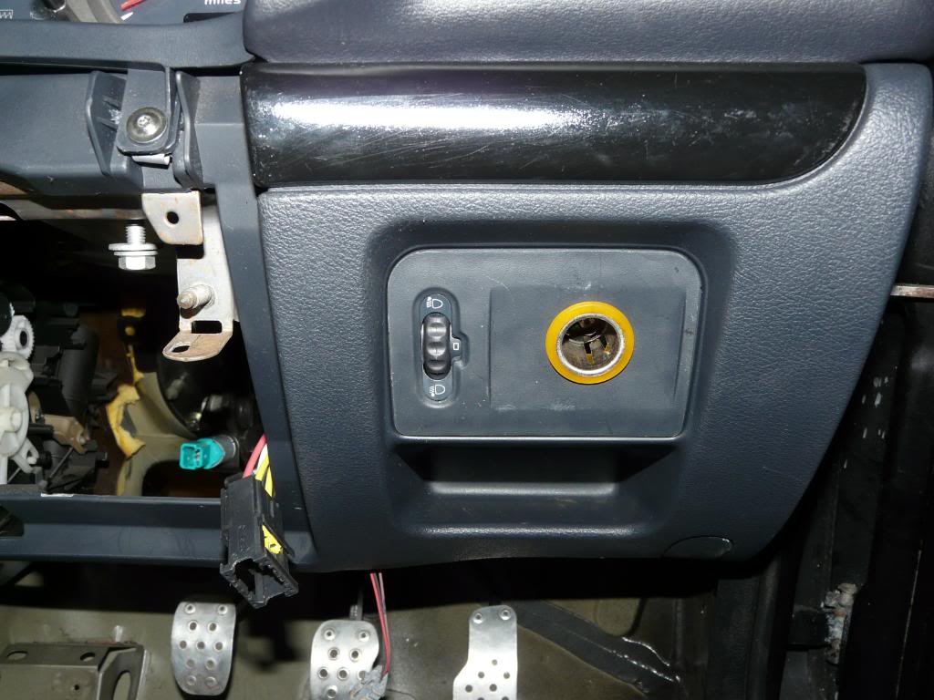

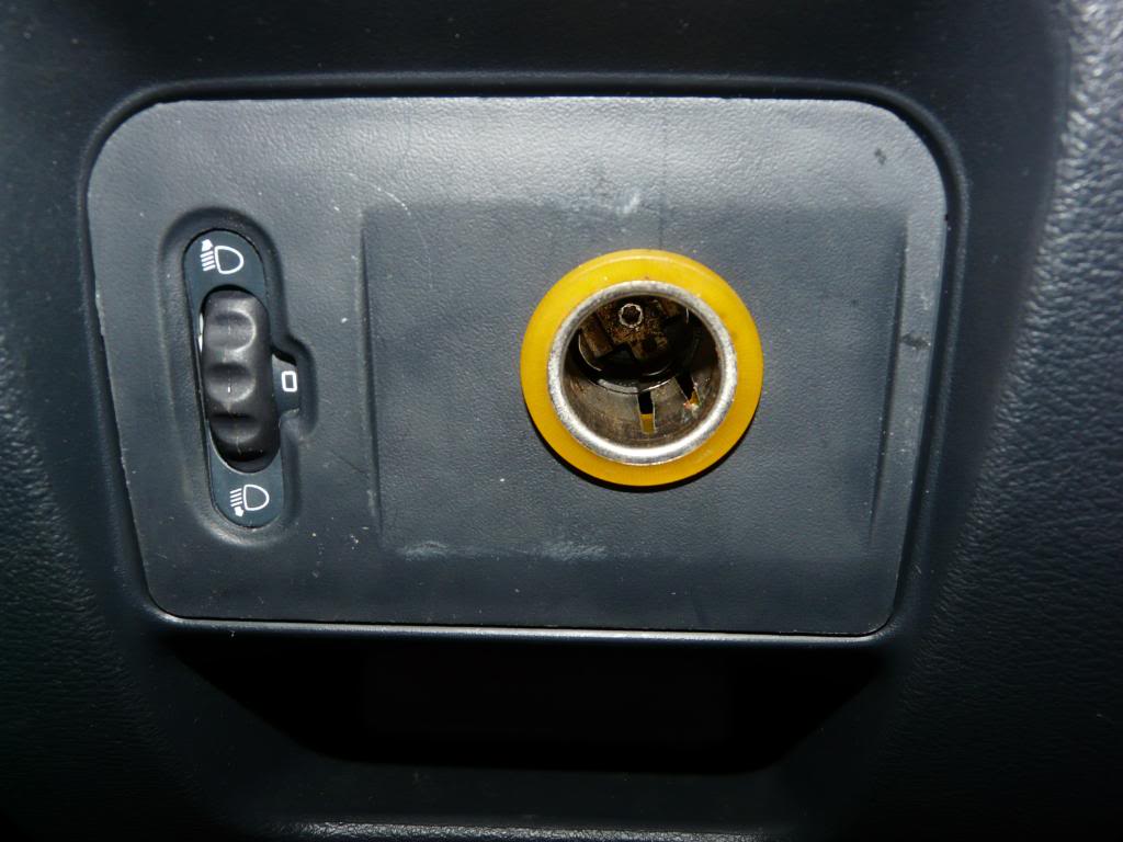

I decided that i had to relocate the cigarette lighter, had a few ideas but i thought it was best to put it where the headlight adjuster goes...

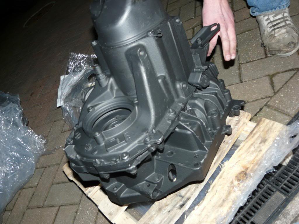

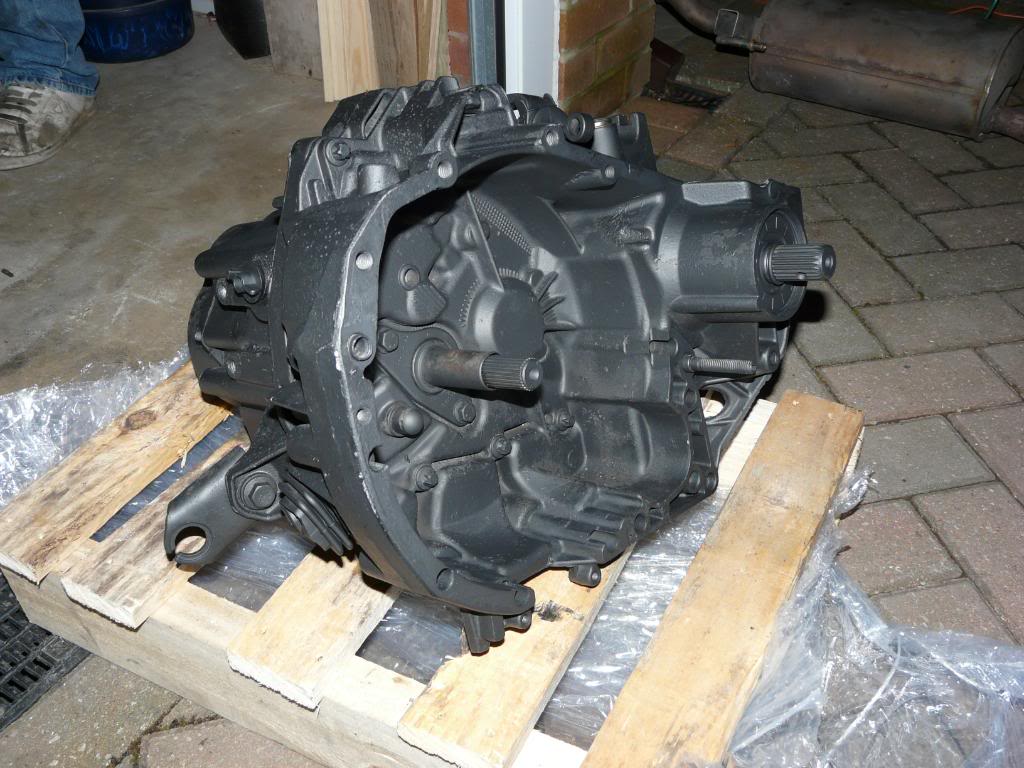

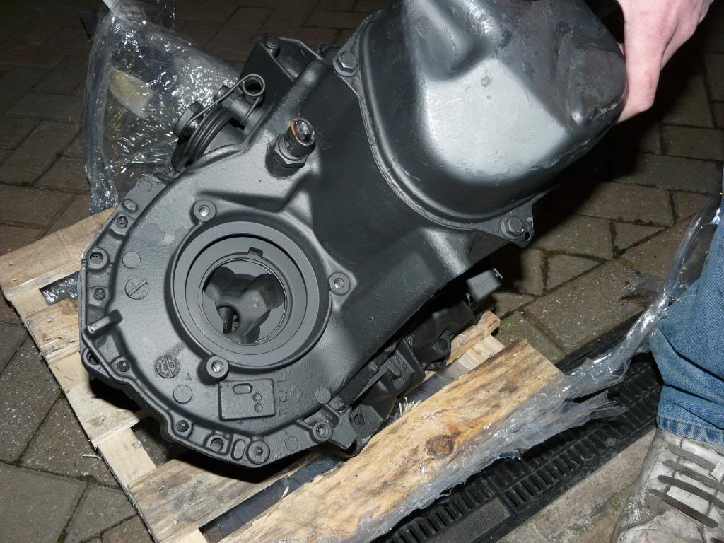

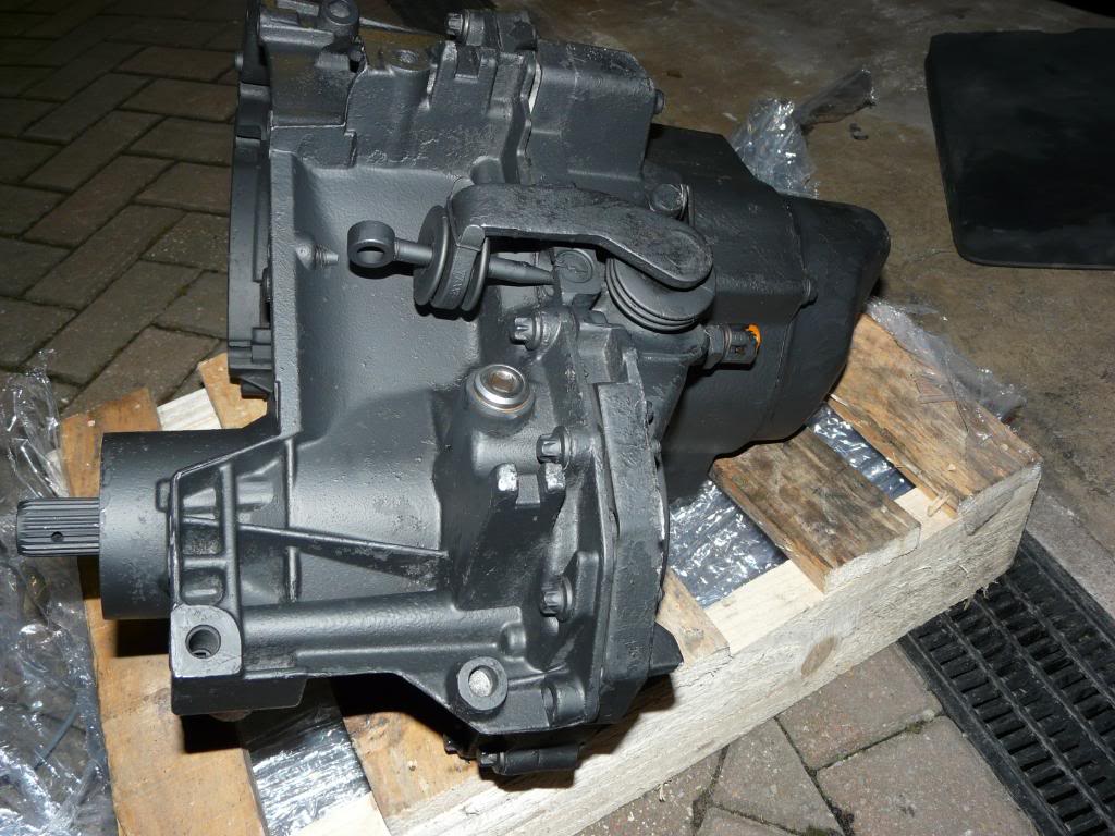

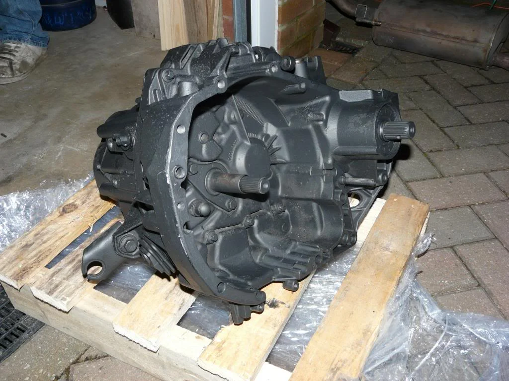

As a few of you know if you have been reading the thread i have had a lot of trouble with the geabox that i got.... well i sent it off to Agency Transmissions and they changed virtually everything but the case, got to say they turned it around in just over a day, really pleased with it.

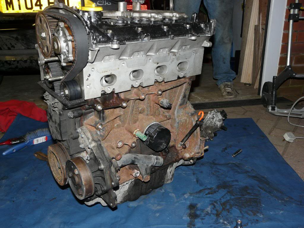

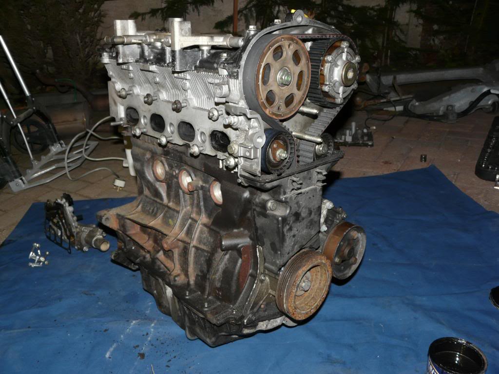

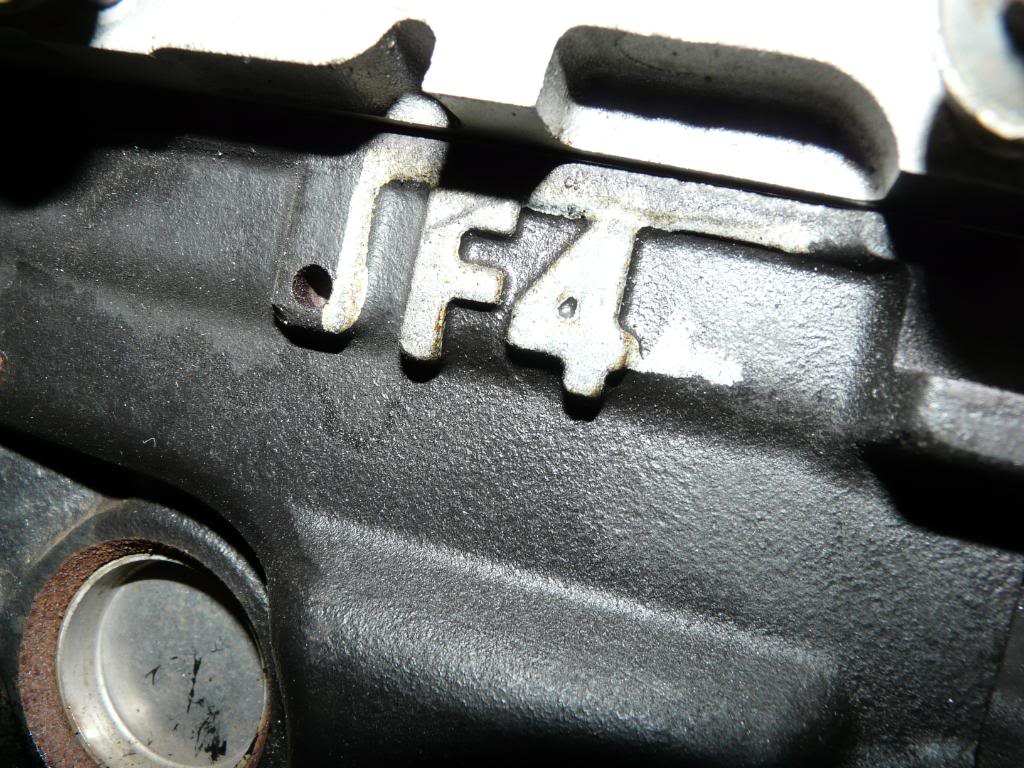

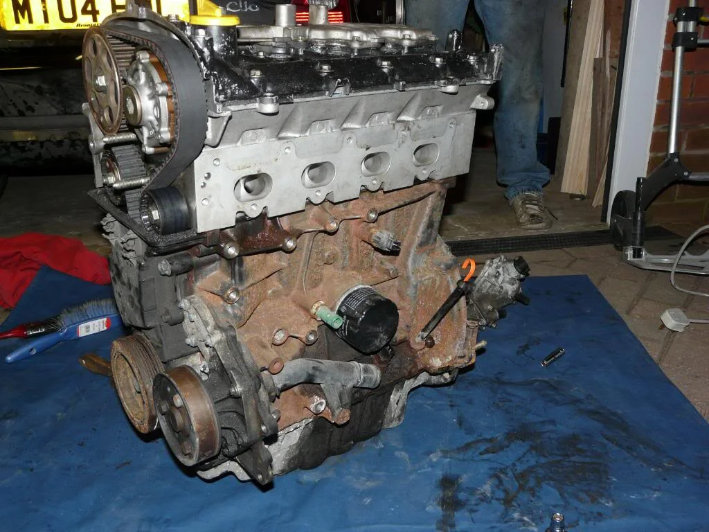

On saturday me and jord (f0xy) went on a 330 mile round trip to collect the 172 engine that we got off the forum, was a long drive but we thought it was well worth it as the engine seemed to be ok...

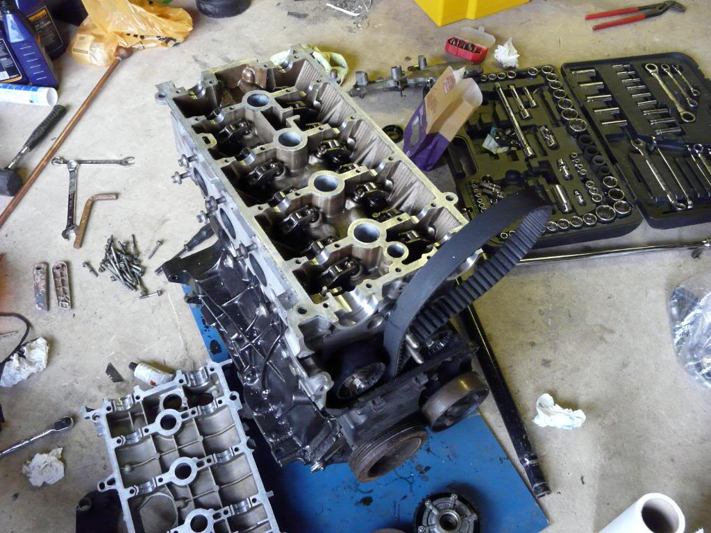

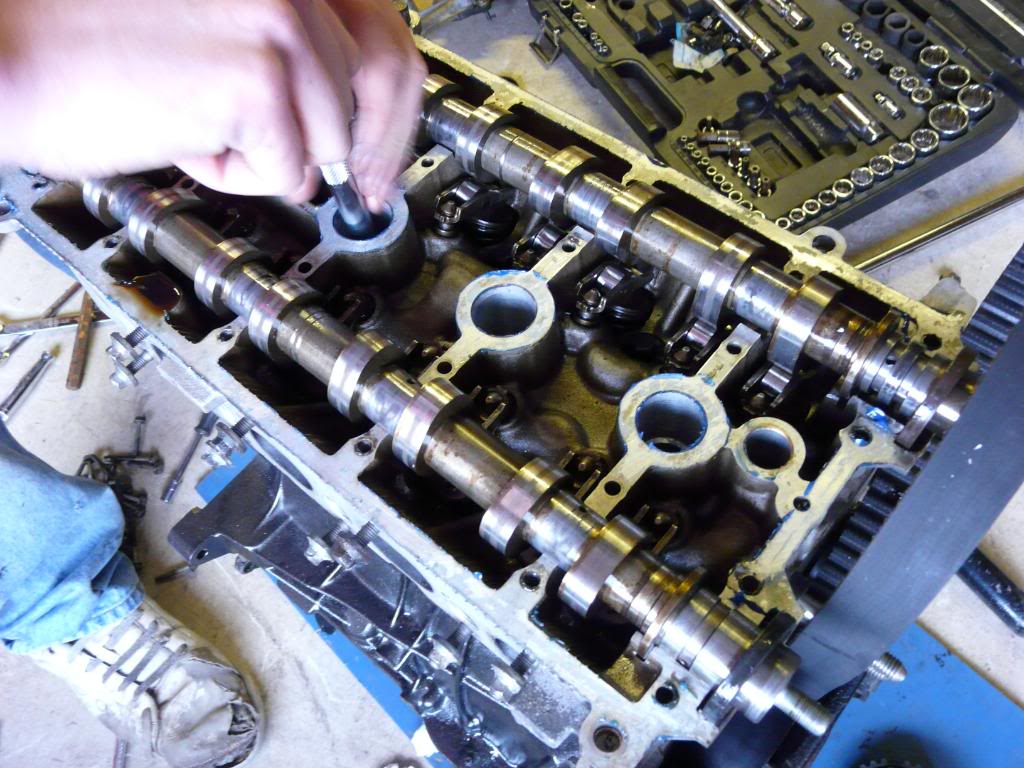

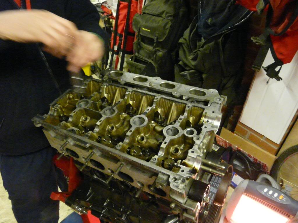

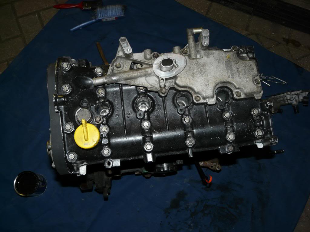

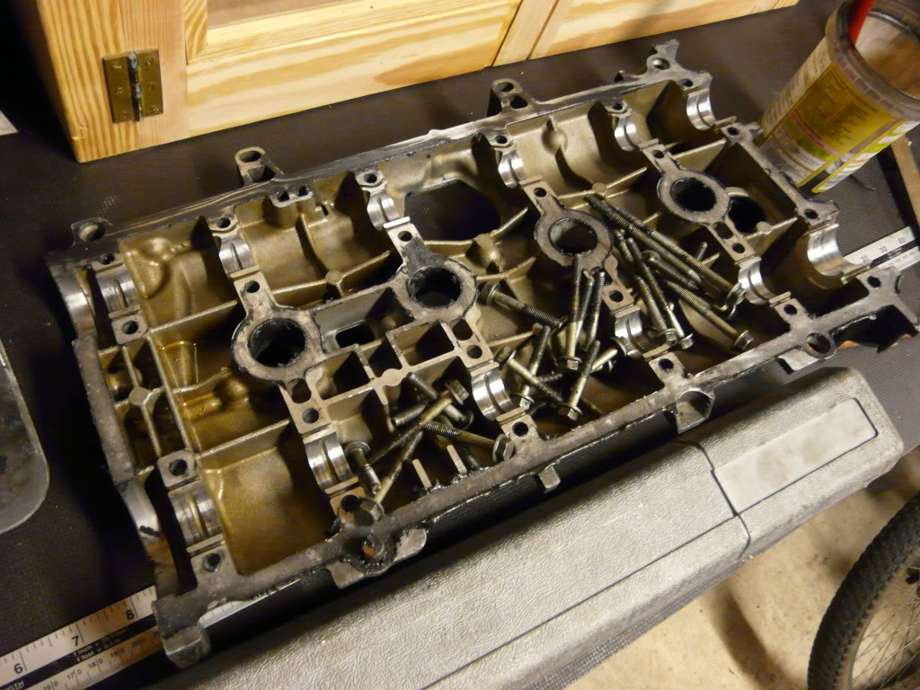

Then the fun began... we decided to take the rocker cover off so that we could re-seal it.... so we removed the rockor cover cleaned alk the surfaces up and re-sealed it up...

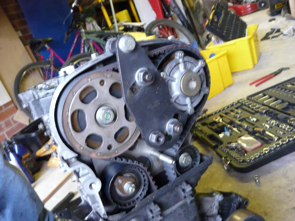

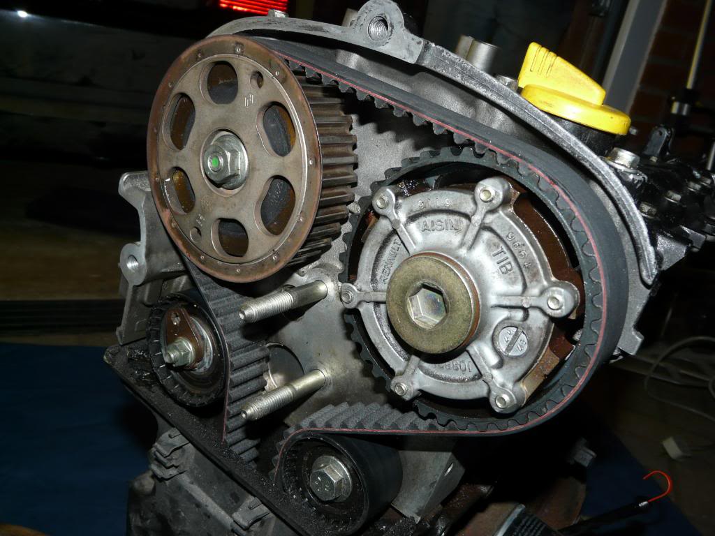

So once it was all back togeather we went to time everything up.... whilst trying to put the timing tool in we realised that the cas would not turn in the head... So we took it all back off again and checked that all the valves move and all the tappets were free. We found 6 tappets that were stuck solid..
So we freed those up and put it back togeather once again only to find out that the cams still wouldnt turn. We came to the conclusion with several other people that the rockor cover wasnt right for the head as when we loosened off the cover bolts the cams turned fine. So at 10pm we drove down to stoke to collect a complete new head. Dont have any pics of this yet as it has been sent off to be skimmed and cleaned.

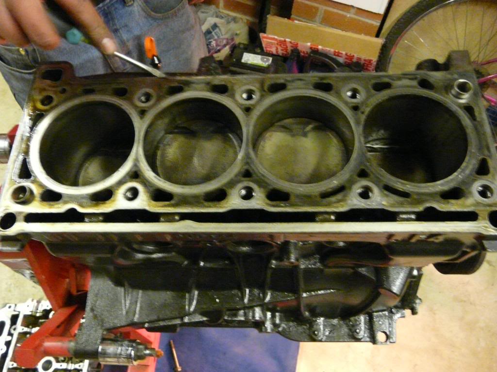

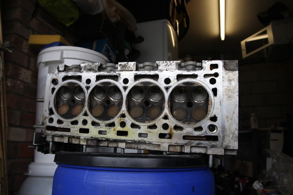

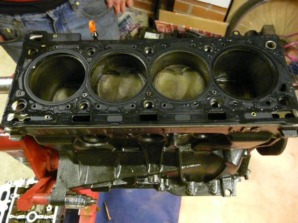

So tonight we set about removing the old head and cleaning the block and sump off.
the rockor cover off ONCE again lol
All head bolts out
And finally the head was taken off

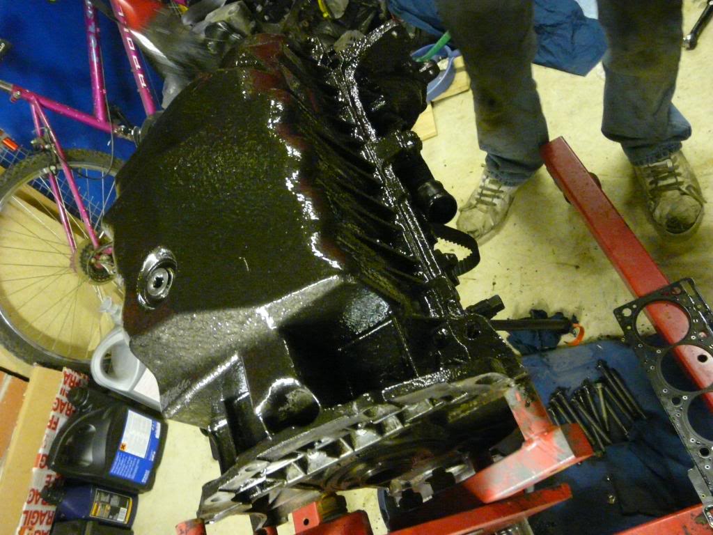

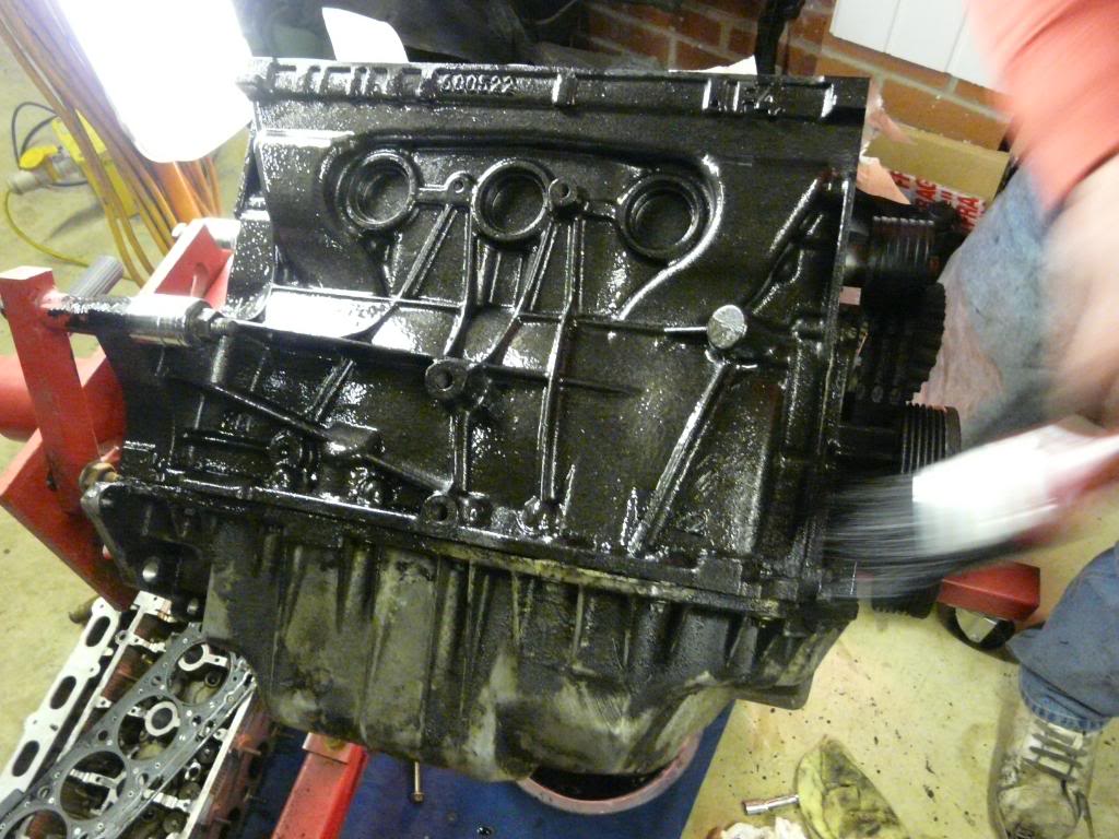

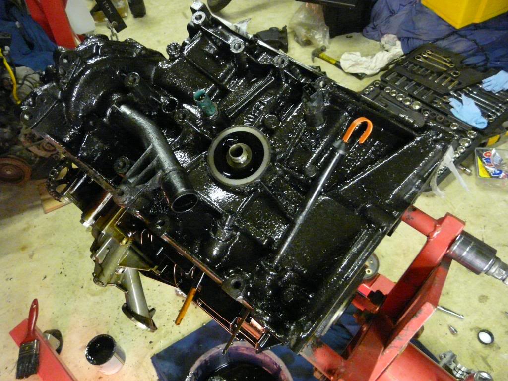

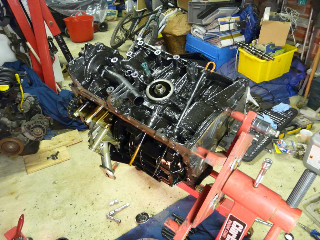

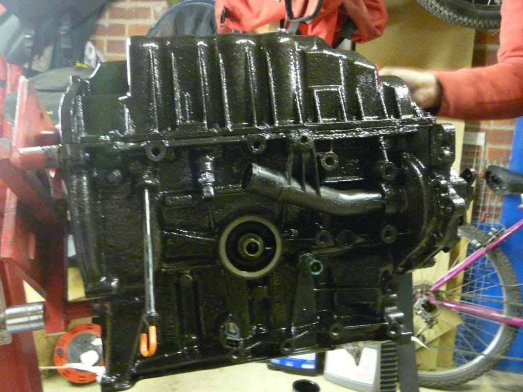

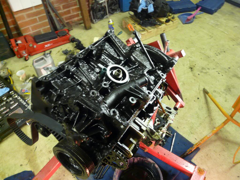

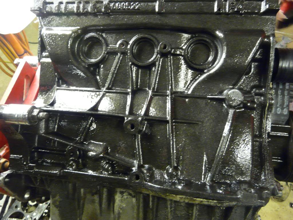

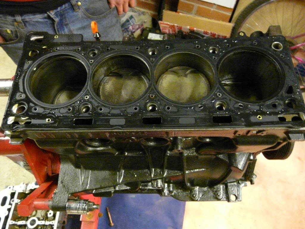

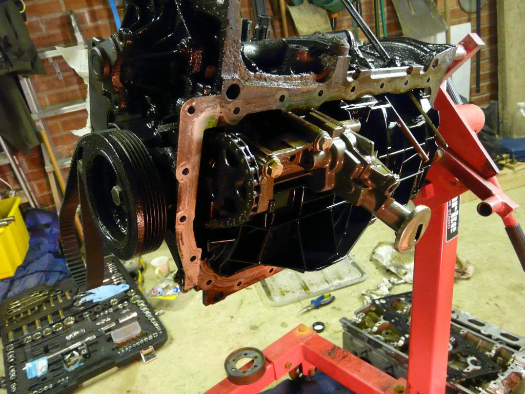

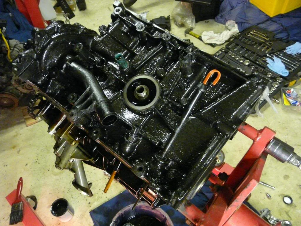

Once the head was taken off we then started to remove bit off the block so that we could clean and paint it. I removed the water pump pulley and gave that a good clean up, really supprised how much dirt there was on the engine.
Next we gave the block a few coats of hammerite..

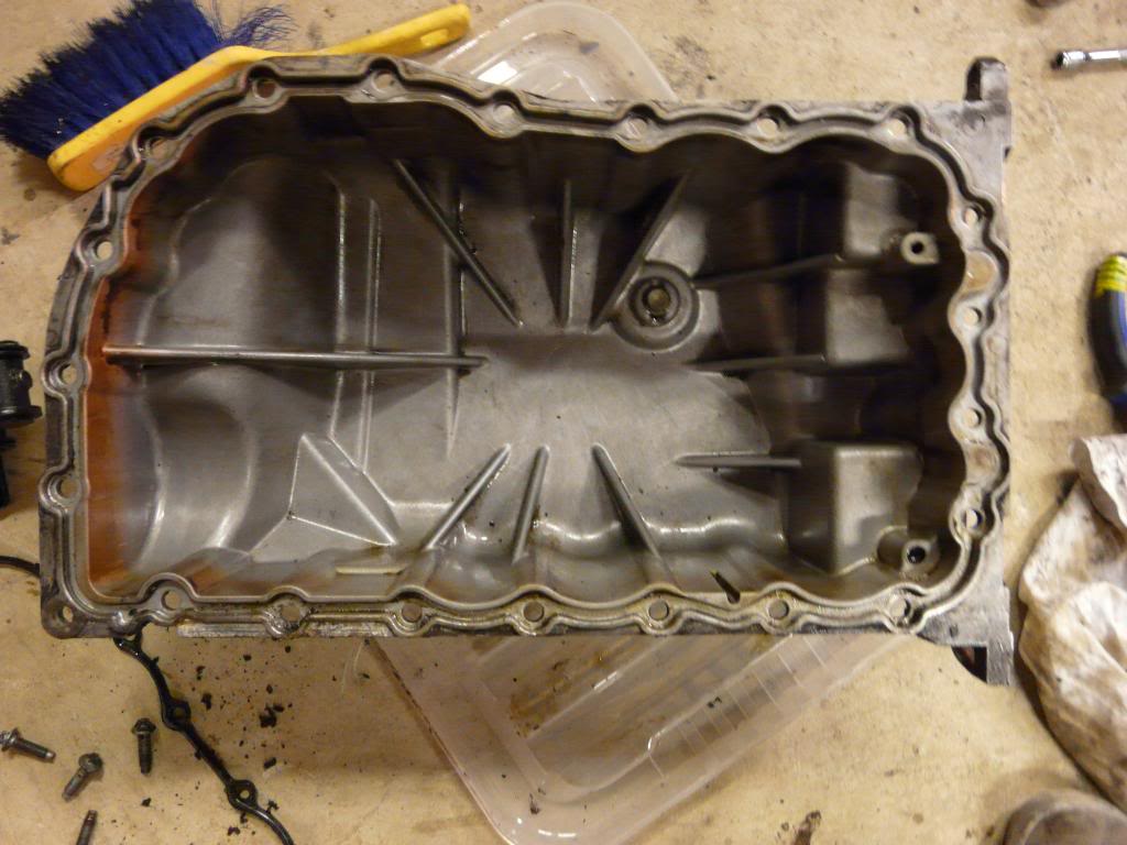

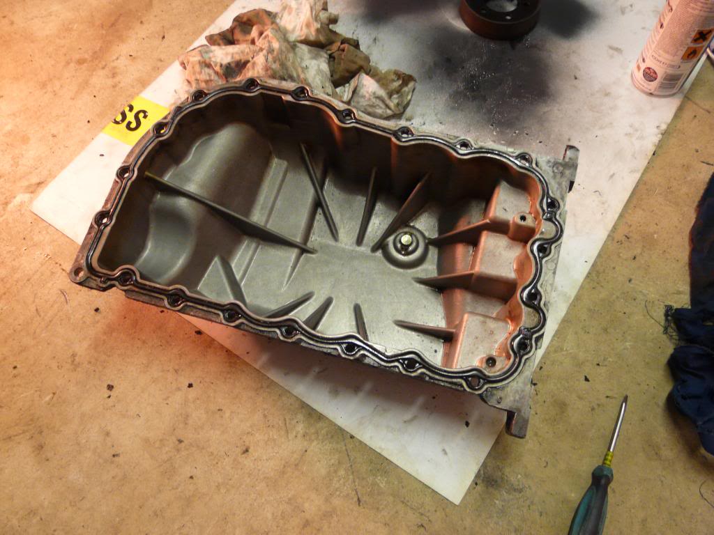

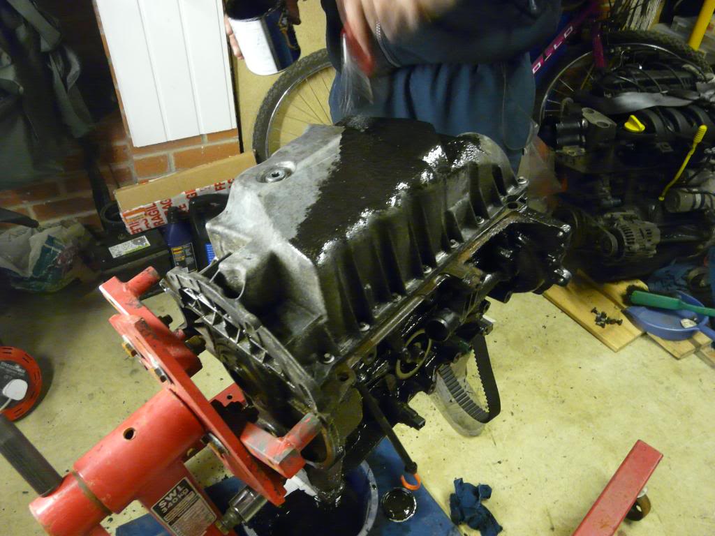

As the sump was really crusty and full of oile and stuuf we removed it and decided to clean that, clean out the oil pump filter and the seating foe the sump seal..
Next we cleaned the sump up, using oven cleaners and general other bits and bobs, came up really well..
More painting of the engine...
lovley and clean sump

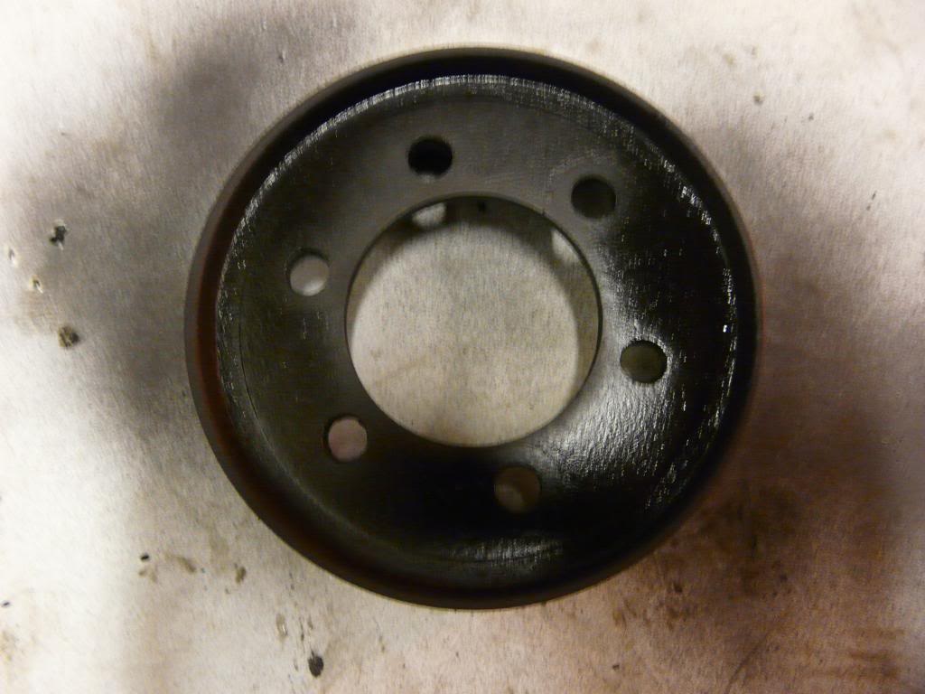

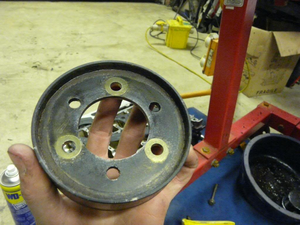

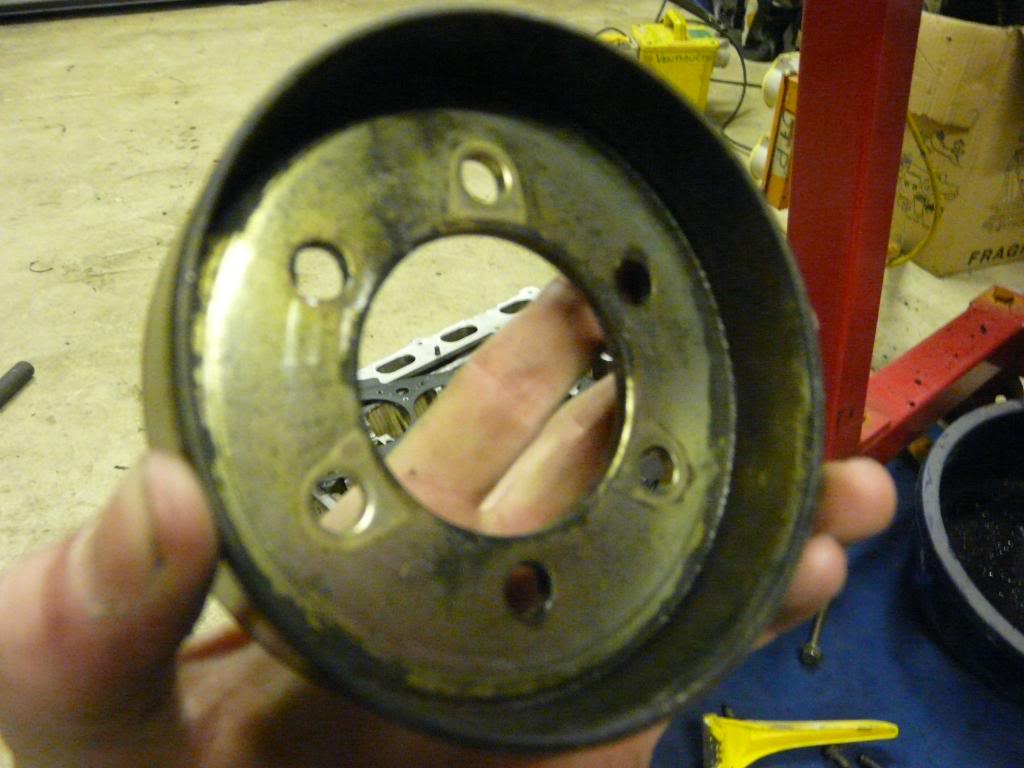

Next was to spray the lover inlet and water pump pulley, ive sprayed all inlets and engine parts that i can with matt black hammerite BBQ paint, looks really good, pictures dont show how good it looks.

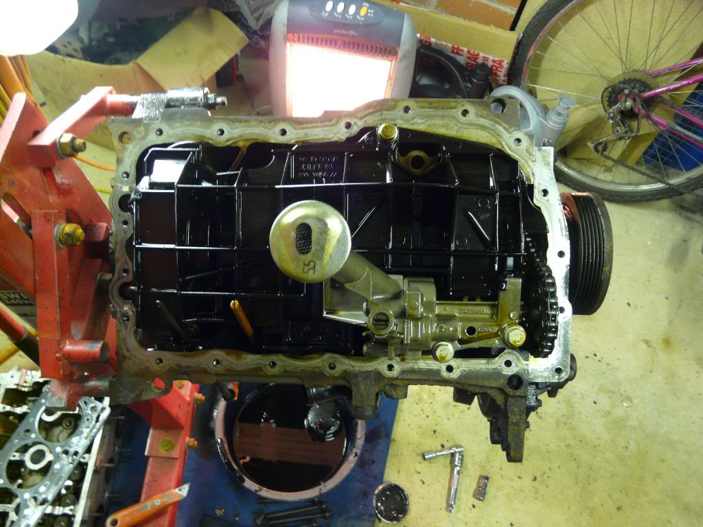

Nest we put the sump back on and gave that a coat of paint

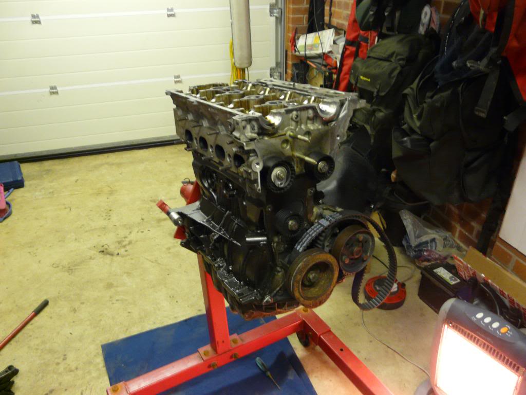

So leave that to dry and its all ready for the new head and head gasket to go on tomorrow. Get it all timed up and that should be that...

Its abit annoying having to do this to a suppose to be perfect engine, but in one way im glad we have done all this as i have learned so much about the engine and how it work and how things go togeather ect ect.... really enjoying this now

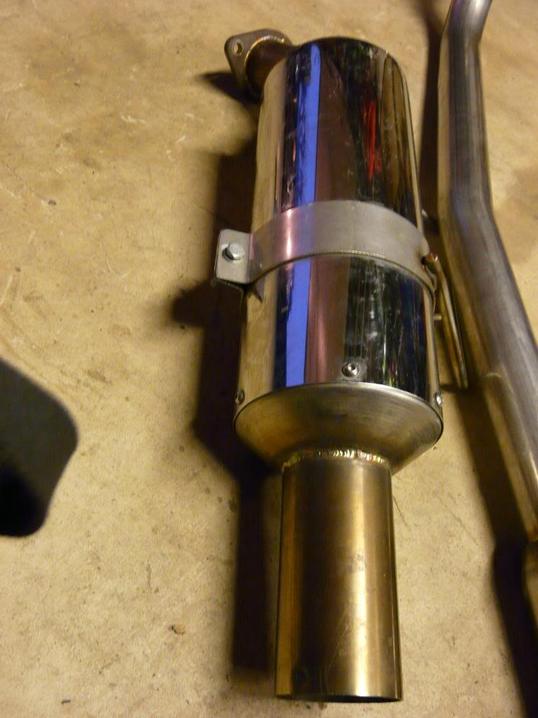

Re: 1.2 Track car Conversion

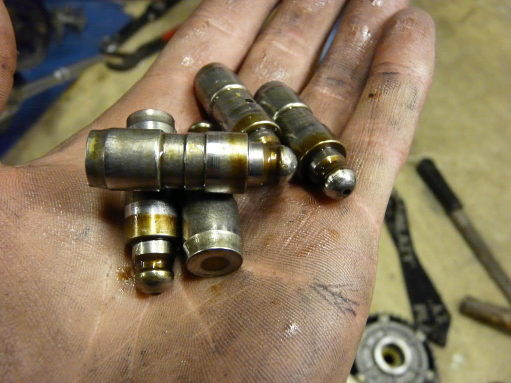

erm what do you mean the tappets were stuck solid?
epic exhaust, who did that to the tail pipe though?
check out the state of those cams! run low on oil at some point?
Aye more than likely, absolute joke. The cam journals on the head itself are OK, but the cover is a lot worse. Wierd how the lobes look worn but the actual rockers look new when removed!
10 of them would squeeze in and out by hand very easily like most others Ive seen before.. He means the others were sort of 'hydrolocked' and would not budge (stuck in the expanded position) unless put in a vice and squashed to f**k, even grips wouldnt budge them..
JP did the tail pipe (for Dave/Mini-Valver)

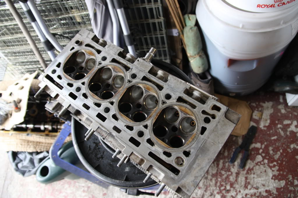

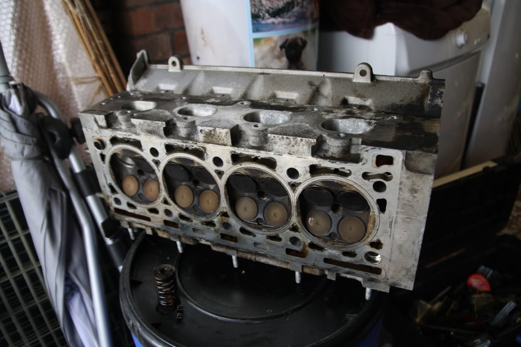

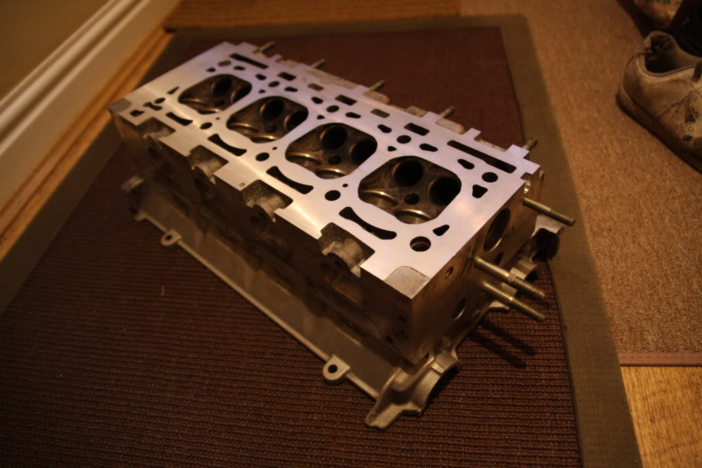

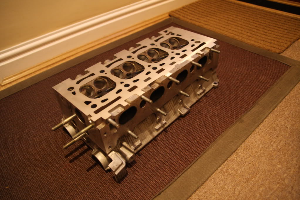

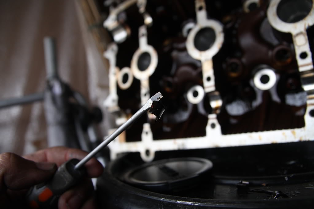

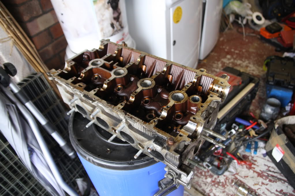

Well as mentioned earlier in the thread we picked up a replacement cylinder head to go on the engine to avoid any more f*cking about - better to do it right than go on hope, I've seen/had it happen too many times in the past.
After the cams wouldnt turn we decided to make a few phone calls and find a head with a matching rocker cover, picked one up cheap off someone I know (and actually trust) last night. It was from an engine that had a cambelt failure, and the inlet valves were bent - no biggy though as we have a full set of inlet valves from the head that was on the engine.

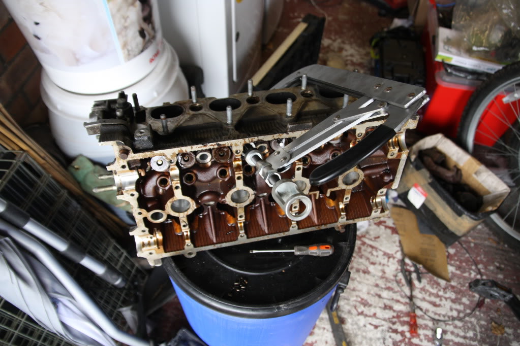

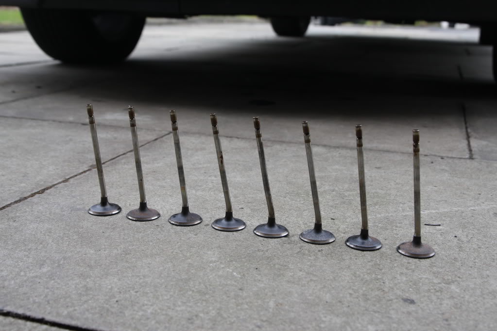

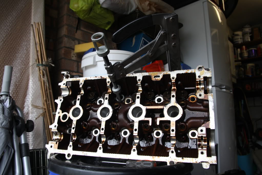

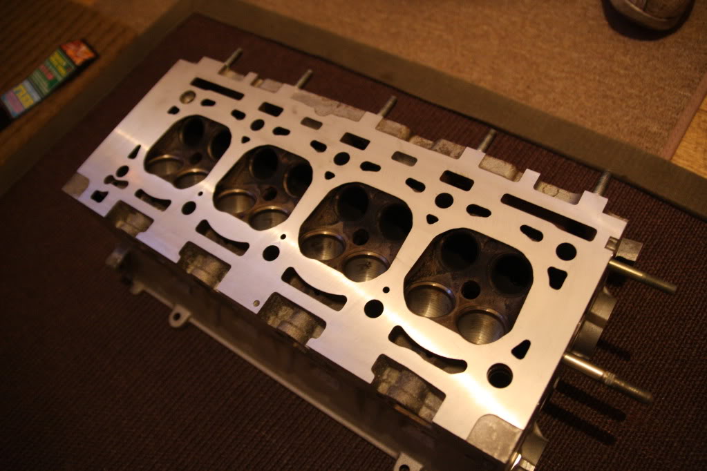

I removed the valves for Rob today and took it down to a guy I use for my machine work to skim it. Also got him to order a full set of valve stem seals (as for some reason Renault no longer do them on their own, only as part of a head set).
Rob decided he wanted new stem seals, headgasket and other bits so its a completely fresh head to go on the good bottom end. May as well do it once and do it right, so everything has been done properly. Even with the added cost of the second cylinder head, machine work, seals and other required bits it still comes in way cheaper than buying some of the other engines that are floating about on here. Luckily the engine was cheap in the first place, if we had paid any more I would not be impressed..
15 mins later...

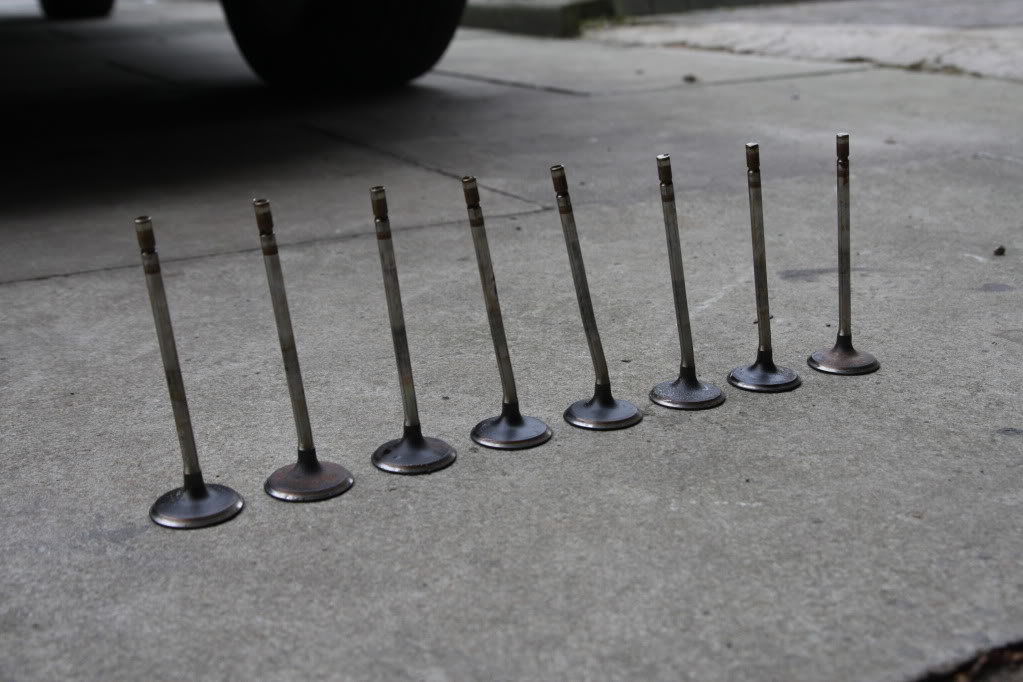

Along with the lovely bent valves which will be replaced with the ones from the other (scrap) head...
Double checked all the valve guides once I got to the machine shop and they are spot on, probably because the valves are bent close down to the heads. With the new valves it should be spot on for a long time to come...
The head will be back from being skimmed tomorrow, along with the new seals and headgasket, ready to be fitted :sleepy:

Here you go Rob - It was perfectly flat beforehand (so would have been fine), but 5 thou was removed anyway to be absolutely sure. All cleaned too in the kitchen dishwasher...
