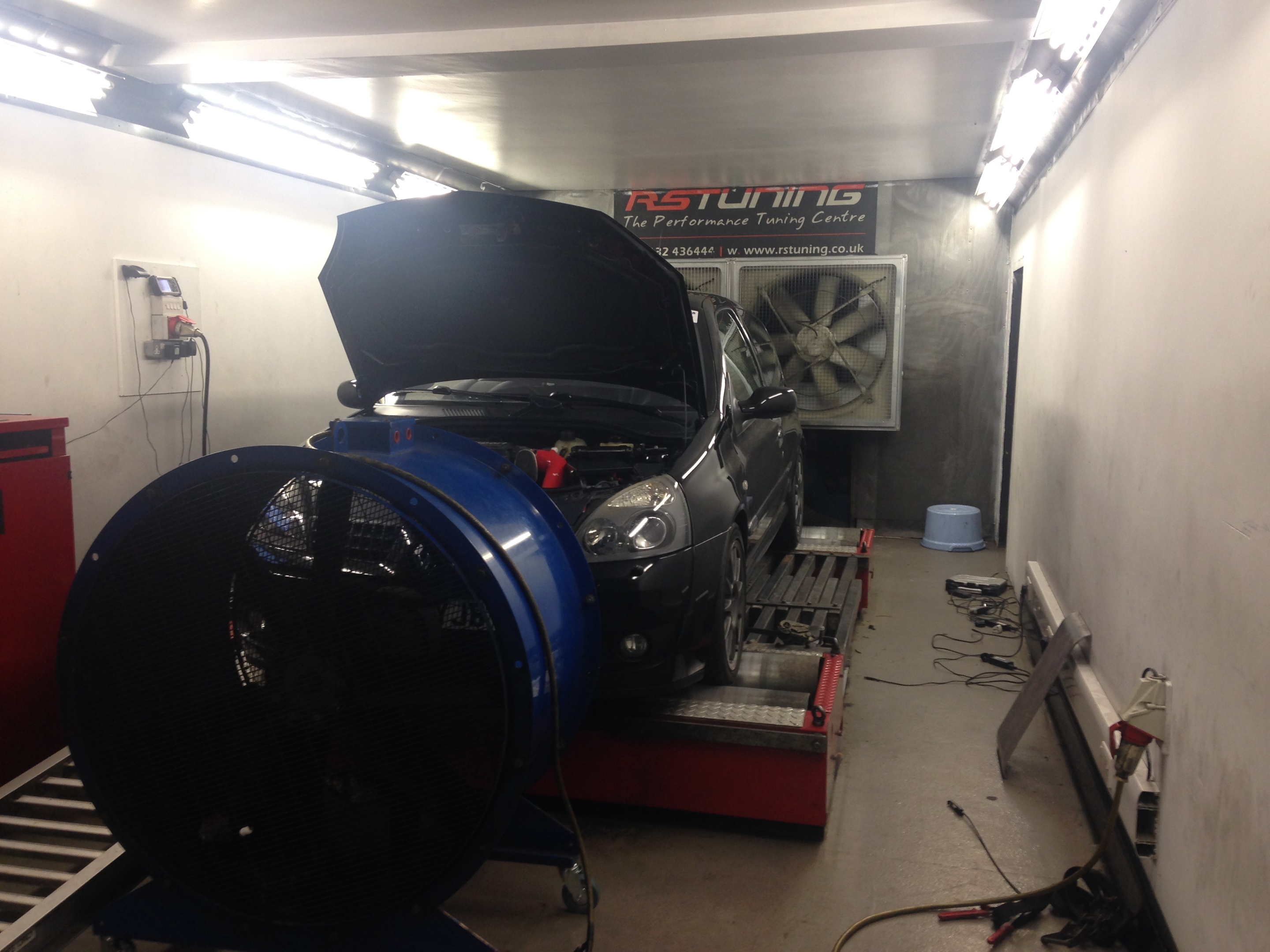

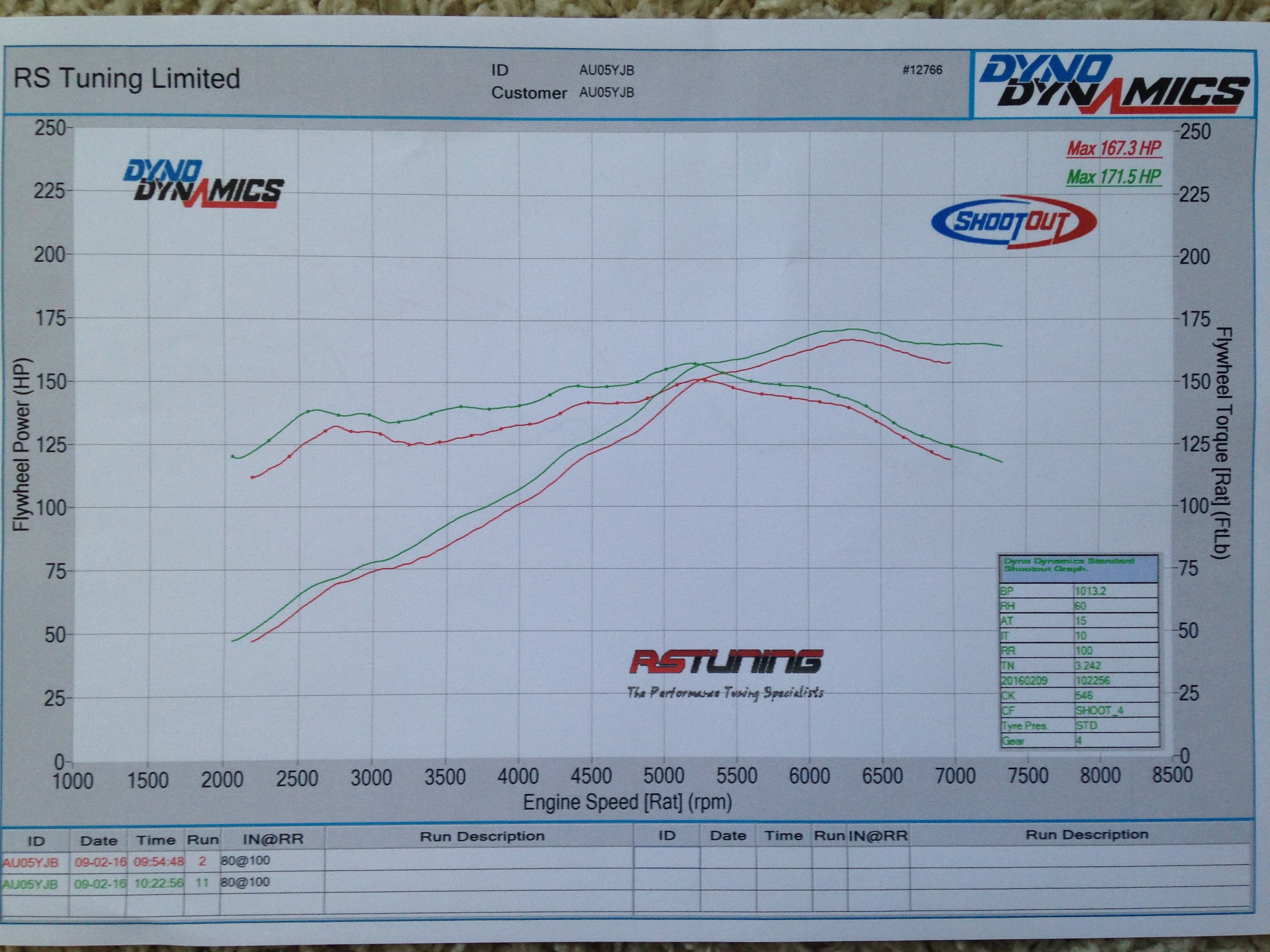

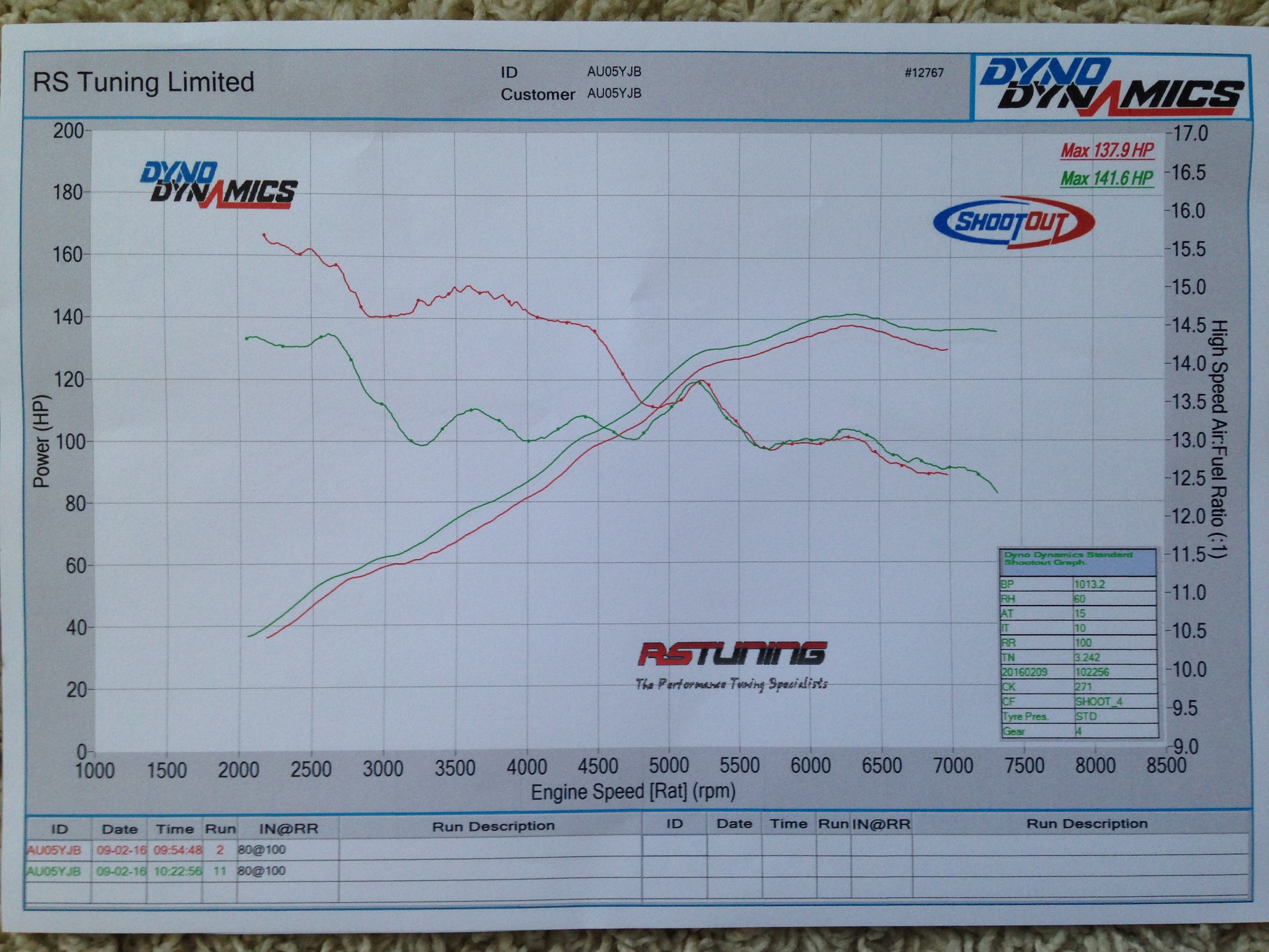

Not sure whether to be disappointed or not?
I've not been around Clios much so my knowledge is pretty limited but I was thinking a Clio 182 was 182PS so about 180BHP but I accept its an 11 year old engine so I replaced HT leads, injectors, coil pack and pre cat lambda sensor just to make sure it was running at its best. Modifications are KTEC induction kit, Matched inlets (It was fitted with an RS inlet standard so I knew the gains would be negligible from this), Milltek Sport Cat and Pure Motorsport Cat-back.
I was expecting about 185bhp but it didn't get anywhere near that.

That's pretty good to be fair.
Hardly any make book power, they're usually around 165bhp plus, for a 172 and 170ish for a 182.
Although the previous figure of 140ish would suggest there was more of a problem, usually timing out if it's that low.
Book figure for the 182 was in the 170's anyway, the 182 in the name is just misleading.

No, they were called 182 as they were supposed to produce 182ps, which is 179.5bhp.
Same with the 172, 197 & 200

The official power figure for the 182 taken from the Clio trophy factory brochure.
2.0 16V (132kW/182CH)
182 CH if a French power rating.
132kw = 177.015 British horsepower
http://www.cliotrophy.ch/trophy.htm
So you car has 5.515 hp less than the official Renault figure.

So its roughly down 5BHP but the peak torque figure is 157Ftlb which I think is more than standard?
At end of day it's an 11 year old engine and I haven't done any drastic power modifications so I suppose I can't really complain.

The official torque is 200Nm = 147.51242986 Ft lb so you have a extra 9.48757014 Ft lb
Yeah it's mapped pal. 167bhp standard 171bhp after map at RS Tuning.
