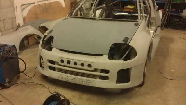

More fabrication work going on. Mounted the fans on the radiator, and fixed the top mountings in place.
Looking like it's meant to fit there now. Or, as someone said on facebook, giant sub looking good!
