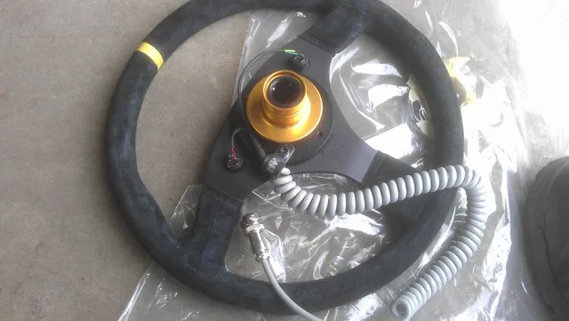

Hi guys. OK, small update for you. Most of the stuff I have been doing recently has been a bit mundane, and not really worthy of pictures.
However, I have bought a nice new steering wheel, and had the top of the steering column machined to take the weld on section of the removable boss.
So a couple of pics of the wiring I have done on the new wheel for the shiny buttons, which will be to activate the launch control and data-logger.
Also I have made progress with the now famous biscuit tin dashboard. Carbon firbre sheet, instruments and switches. Tasty, even if I do say it myself!
