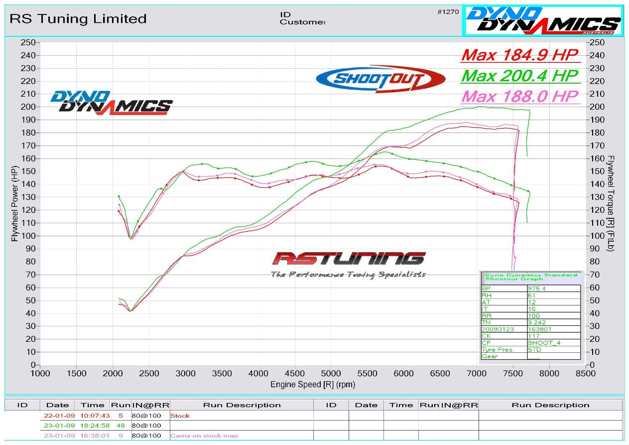

A lot of people i have spoke to chris have had the same problem with the map due to ther decat.
That is what i would look at.

I'm not concerned at all Chris, just trying to point out to you that your torque actually spikes (ie abnormal increase) then returns to where it should be. some powerfull turbo cars do this on rollers when the boost kicks in, they climb the rollers and give a false reading - hence there could be a problem with the rollers that day etc, esp when you put it together with the abnormal atw readings dude. Compare your graph to the one from the same rollers on the rr day and hopefully you should see what i mean, you have an abnormal amount of torque low down
Not trying to start an agument dude i'm hoping to help :) it just seems that you are refusing to take on board the opinion of everyone here that there are some strange results on your run

I got a big torque and BHP dip on mine due to it running really lean!! RS Tuner has no ablitly to give you and AFR readout does it??

I'll state it again though, still think its just the scale of the graph, ie each increment on the torque scale is 2lb/ft

im asking why i have a large dip in torque at 3000 rpm
as in, is it a problem with the RSTuner remap?
Yes but whats the point in aswering your question? There's a chance there aint even a dip in torque your results so mickey mouse!

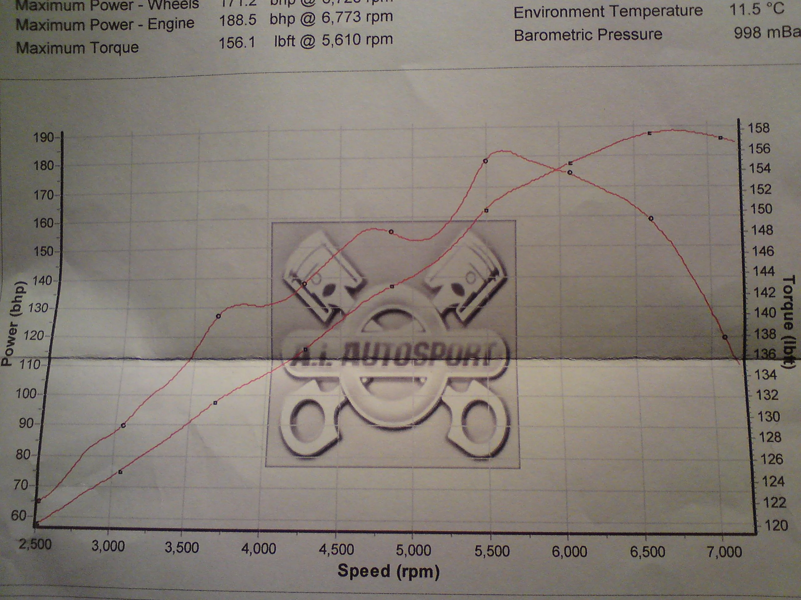

Chris, hopefully this will answer you question, i dont think there is a prob with your map as i have the same dip as you do, check it out :)
hopefully will put your mind at ease
as you see i have the same dip too :)
It does if you get the better version with the option of a wideband lambda sensor (or a UEGO) input.
thank you! finally, a useful post about my question!

TBH it's not much of a dip, it's 4 ftlbs!
Also don't believe a word or graph any RR operator tells you, so far mine made 233, 202 and at last count 211bhp! All i know it's damn quick and i'm happy
