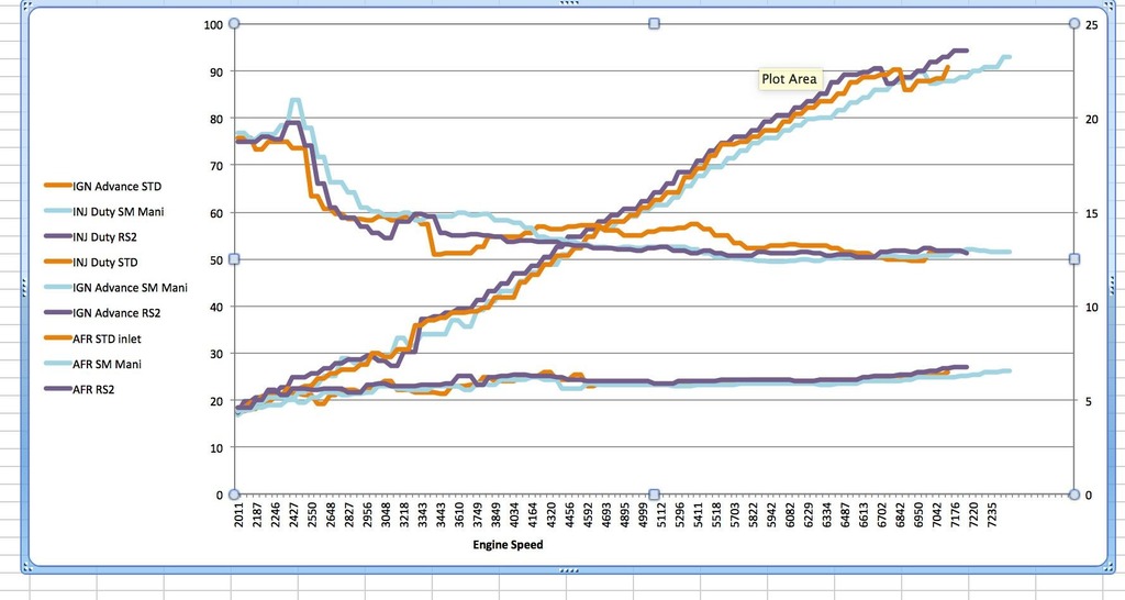

As said they've been datalogged, not dyno'd so its seeing what the AFR's are.
I'll quickly explain what ive done while im waiting for the graph to upload.
Datalogs taken with an RSTuner pro, wideband data provided by an Innovate LM2. These were taken back to back, SM inlet, then the stock inlet (albeit matched with KTR IK) and then the RS2. Datalogs taken of AFR, Duty cycle, IGN Adv, Air temp etc. for the graph Ive narrowed it down to JUST AFR/Engine speed. Figure we'd like to see is between 12.5 - 13.2AFR. Leaner is better (Means more air is being flowed, thus making it leaner, which means the x inlet is better at that point)

These flat out runs then with the ECU in open loop? out of interest when does the Clio drop closed loop, certain throttle % and/or rpm's?
AFR/duty cycle/Engine speed.
Ignore low down RPM as this is the airflow being too low on the tailpipe sniffer. what we're looking for is a low duty cycle line and high afr line. This means its flowing less fuel and running lean, take the STD inlet one as the bench for this, if its higher than the stock duty cycle and is higher than the stock afr then this means x inlet is flowing better than standard. if its below the afr of the stock inlet and lower on duty cycle this means its worse.
Perfect point to pick this out on is at 3600rpm where it looks like the SM is flowing better, but its actually the duty cycle being brought down by lambda control.
Closed loop until 4500 rpm, completely bone stock map for reference purposes. if I was given dyno time I would've taken my spare Gen90 and done them back to back like that.

AFR high and duty cycle high, means its flowing well. if its low and low, then its flowing badly. high AFR and high duty cycle means the car wants more fuel to coincide with the more air its now seeing.
As we see, the RS2 duty cycle is pretty much higher than the rest, yet the AFR is near enough always on top, this means its flowing a lot better.

It looks to me like they are all so close it doesnt make either the rs2 or the sm2 inlet worth bothering with.....

The RS2, it has the highest Duty cycle and AFR after 5500rpm. followed by the stock inlet, followed by the SM.

I'm adjusting ads's timing tomorrow and will do another datalog to show the benefits, it is also being xtra'd but i'll have to do this at the same time but it wouldnbt be a massive change on that alone tbh, this was done at the weekend as I had a spare moment and was curious.

Cool, nah it's a top effort with all you can use at your disposal.
So the line like / is the duty cycle? the line like \_ is the AFR yep? and the flat -- line is the ign?
