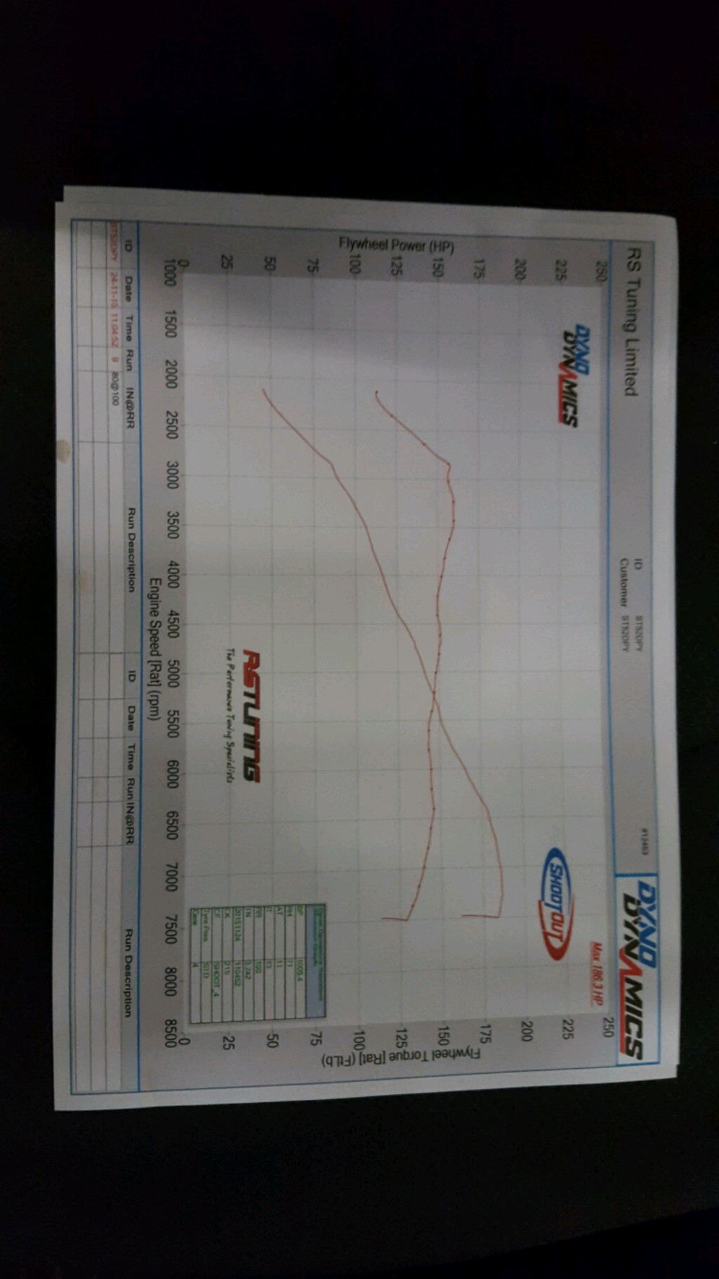

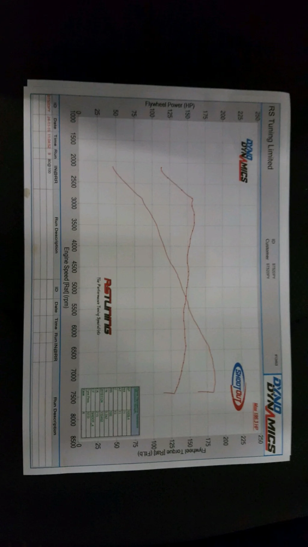

Thats pretty s**t just potentially wasted £850 to make my car slower..... i still think iam going to get it mapped anyway and just see if i can get any sort of improvement. The inlet in staying on now as its only a track car. Not exactly impressed with the rs2 results to be fair as well idont think thats worth the money either, but at least it improves on the stock intake!
Sadly that's the risk taken. The rs2 has made more power, but it'll be how it holds the torque. In driving them back to back you could certainly feel where one was better than the other.
It's not so much about peak numbers, it's the delivery. The rs2'always lost torque (peak) but gained it elsewhere.

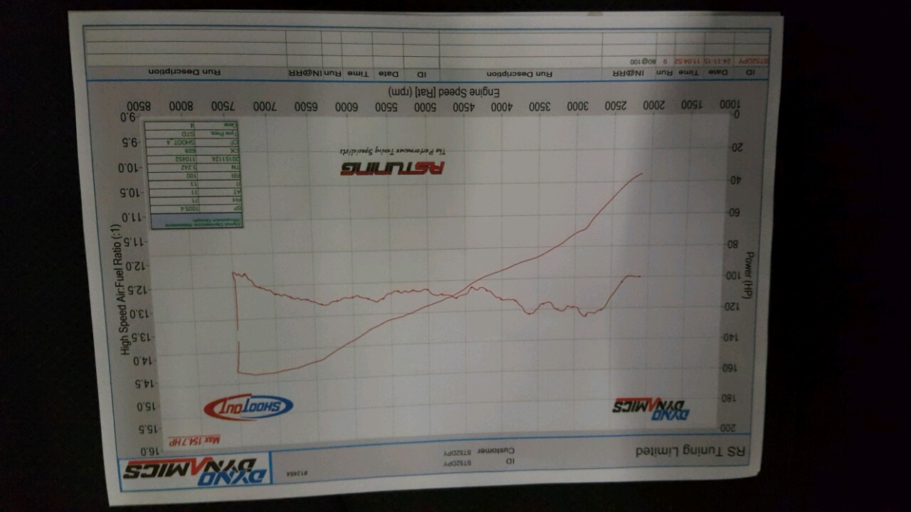

Just curious but how come the duty cycles are different above 4500 if it's open loop? I would have thought once open it'll use the pre-defined values in the map so would be the same for all 3? - The difference in airflow then being directly referenceable by AFR?
I must be missing something though as clearly it's not the case!
It seems the standard inlet is the leanest for most of the graph too?

These cars are strange in the sense that they look at the closed loop corrections then apply the fuel trims globally. Which gives the difference in duty cycles.
Yes the Matched OEM inlet with KTR IK certainly flows well at the midrange, only really over 6500rpm where the rs2 comes into its own. (Admittedly we do have a lower duty cycle, but certainly not as much as the AFR's are being affected by.

Thanks for taking the time to do this dan, to be fair torque is what i was after not a headline bhp figure so if the inlet improves that it wont be a total loss. Going to book mine in at rs tomorrow for 3rd week in november. So when i have results i will put them up.

No it wasnt tested before the inlet was installed but there is a significant increase in standard for sure these cars struggle to make 172 anyway

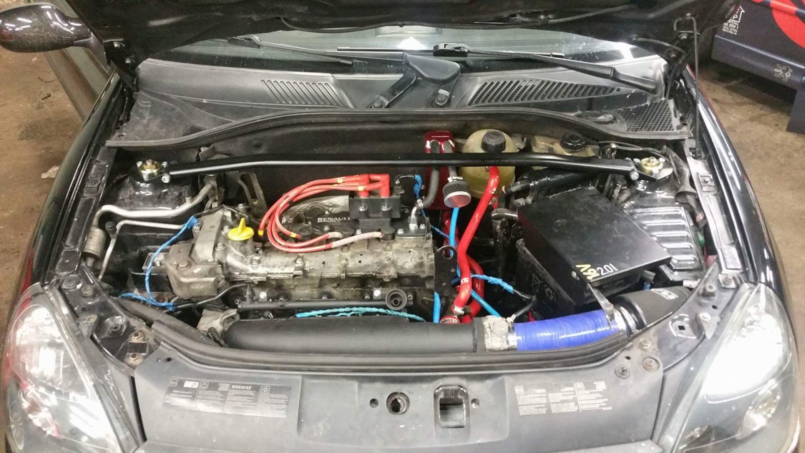

I got my sm inlet kit a while ago but I've not fitted it yet, I noticed people are getting silicone hoses for air filters, does anyone know the length/diameter/bend angle of this hose so I can get one ordered up? Also are people able to keep the battery in place when fitting? The ones I've seen have all relocated it

To the above I got a 5 degree bend had to cut away a bit of the bracket but it's sits perfect above my caf. as for the claims about the inlet my car made 188 and that was with 2 holes in my exhaust and my knock sensor not connected,
After that was sorted made 197 on a local dyno torque was still flat at 150.
Before anyone starts I know dynos are all off.
The car is a lot faster and smoother.
