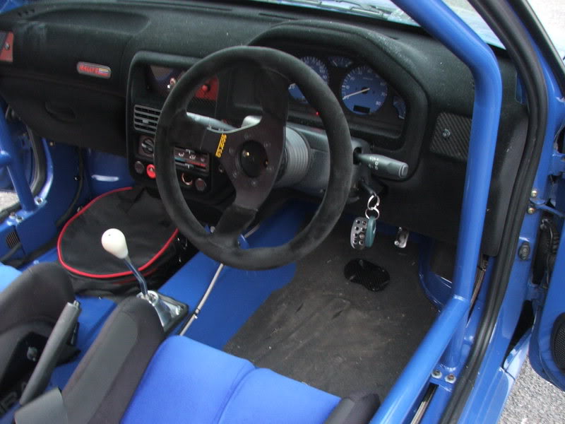

yea was gona do that... but like you said it will scratch... oohhhh it could be poweder coated?
  titanic killer
Footrest look good mate,lol
But i think you could do with a new accelerator pedal;)
All in all i love the way this is coming along,keep up the great work mate

I wouldn't be using the chequerplate, its far to slippy for my tastes. Just use griptape on the floor.

i fancy some of that griptape
could get it from my brother in law as he owns a skatepark :D unless its anything different to what you would use on a skateboard?
  80MPG BEEZA
grip tape from skateboard would sit together pretty seamlessly and also not you can get it in different colours :)
  80MPG BEEZA
skateboard grip tape has to be the best it wont just peel up or bubble if it gets wet either and is easy to put down smoothly
