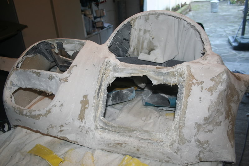

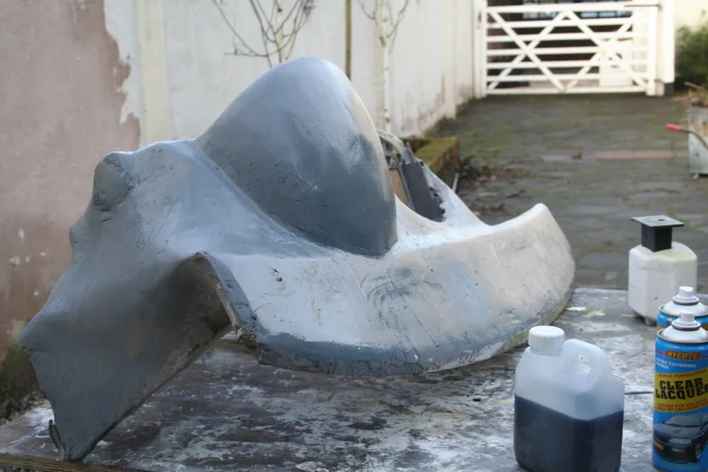

bit of an update.
lastime the dash looked like this..

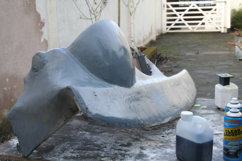

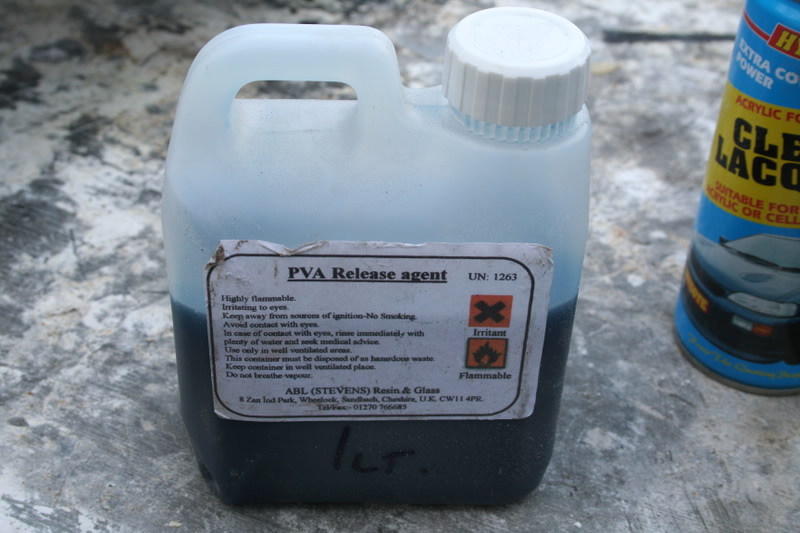

needed some more work LOL...so after lots of filling, sanding etc i gave the mould 2 coats of laquer to seal the filler etc so that it doesn't absorb the next layer of resin. after this had dried.... i took my new PVA release agent, put it in the spray gun and gave the mould a further two coats of this... looked well.... blue LOL

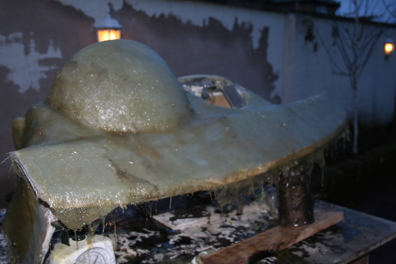

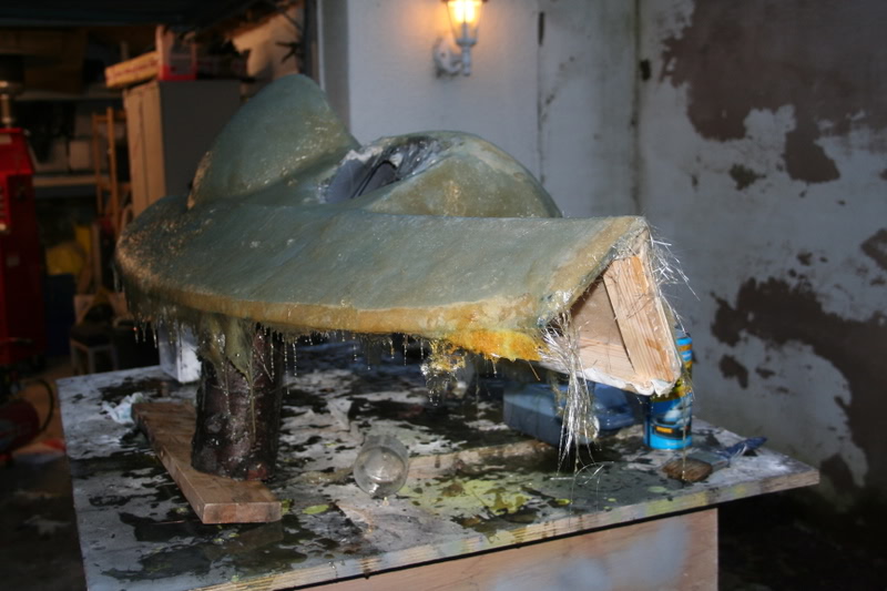

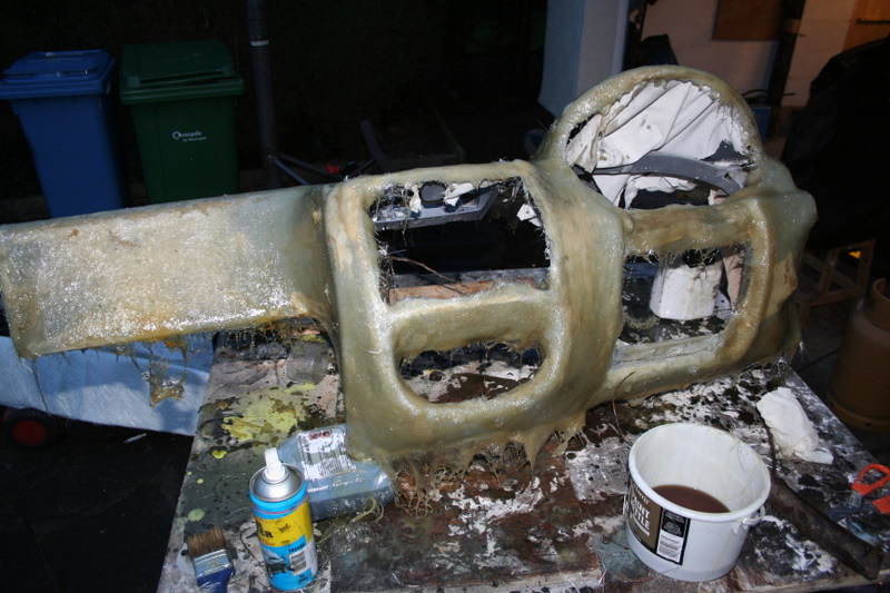

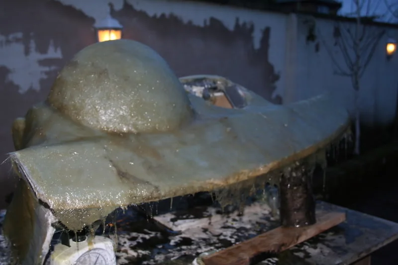

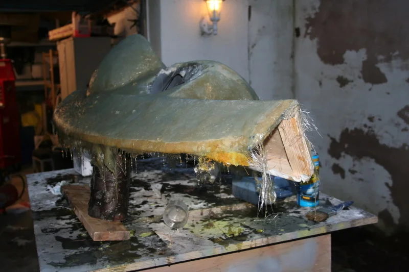

after the PVA had gone off it was time to layup the fiberglass and resin, i have now decided just to make the dash from fiberglass not carbon fibre! but i will be having the FG dash flocked.
that mould is only about 70% flat. there are still lots of bumps etc, which i will sand out on the new mould.....then the foam backed alacantara will take up the rest ;)
heres a few pics with the first layer of FG
left this to dry overnight. i will update through the week.
loads more pics to come in about 40mins just waiting for photobucket.
oh and just for the record... fiberglass f**king sucks! f**king hate this part of the project
good old photo bucket!

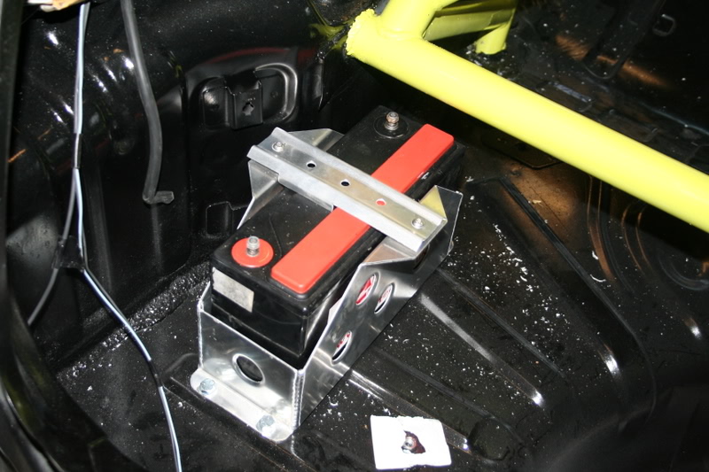

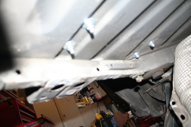

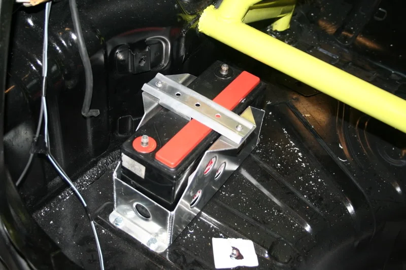

ok so next up was to fit the redtop 30 battery and ally box in thr rear, i chose to mount on N/S rear to balance the small bit of weight from the driver, i lined up the ally box where i wanted it, this part of the boot floor is rasisd up in small sections so there was limited places to bolt it down as there is only two small lips on the box to drill. i managed two lind the rear lip up on a raise but for the front it just fell short, so i used two m8 nuts to space the gap between the box and the floor to prevent bending and damaging the lip.
i then pre drilled the 4 holes and used 4 10.9 grade steel m8 bolts, load spreding washers and nylock nuts to prevent the bolts from coming loose as the battery sits over the exhaust back box.
here is a few pics, (couldnt get the camera to focus on the nylock bolts under the car for some reason)
M
mini-valver
That's where mine is Ben, I'm using a standard battery though because of charging the redtop one's!

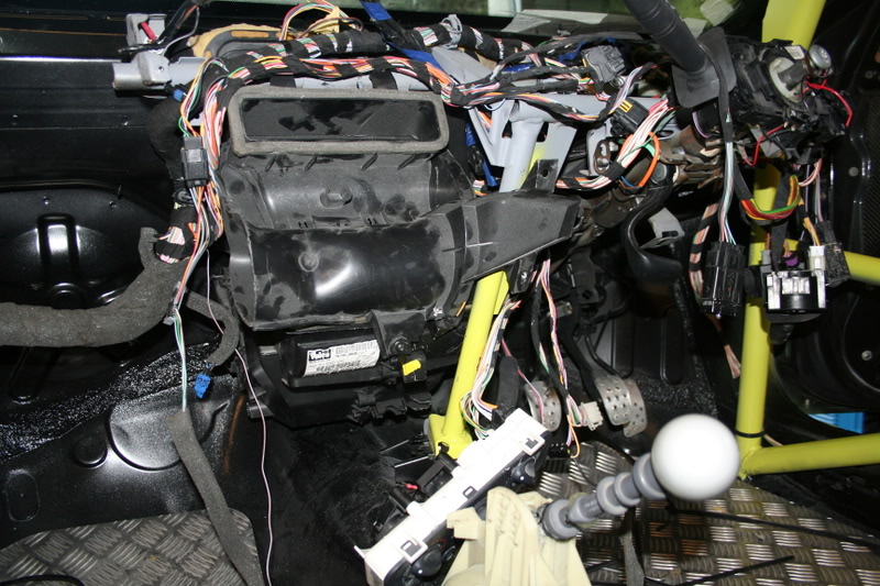

now i wanted to fit the heater matrix back in. I had to make a quick repair where it was damaged when it was removed (on the air part, not the water system LOL) i then began to modife the sides of the box.. removing the tracks for the side vents, rear tracks, front footwell arms also needed to be cut down to accomidate the new shape of the dash! after all this was done i began to fit the heater... only to discover that i needed to remove the bloody dash brace! ahhhhhh! 30mins later and the brace was off! with the matrix in place i tightend up the two m6 bolts through the scuttle pannel in the bulkhead, this kept the matrix in position but after i had cut all the original tacks and arms off it was a little loose on the top... so i decided to use some spare screws - poilet the holes and then secure the upper part of the matrix in place :cool:
with the heater martix secure i re-fitted the dash brace nice and tight!
in the pic you can see where the air feeds have been chopped on the sides and bottom!
