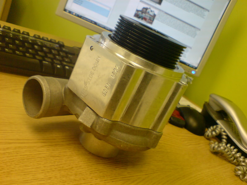

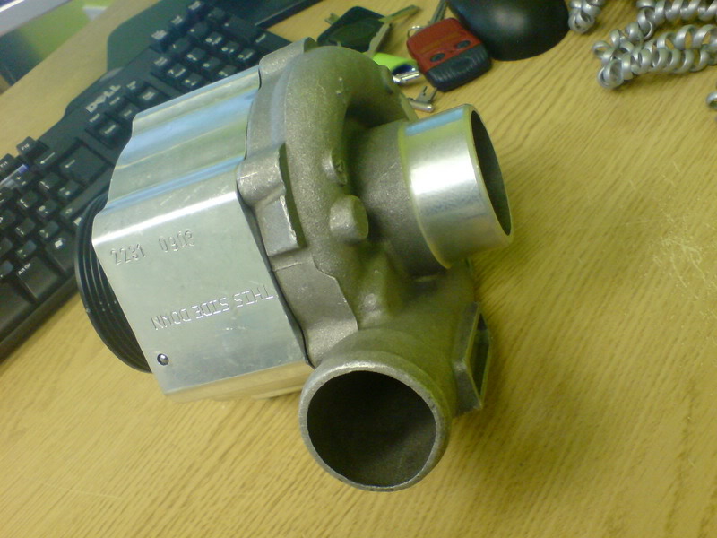

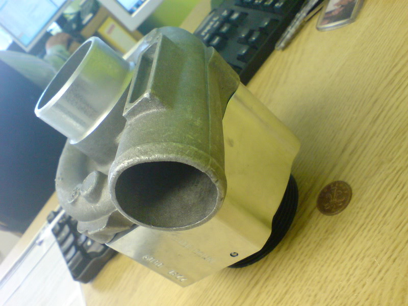

The charger is very compact :cool:
I assume boost is changed by different wheel sizes. Is the bracket going to allow adjustment for different size wheels so you can take the slack out of the belt?

yes it has a built in adjuster.
