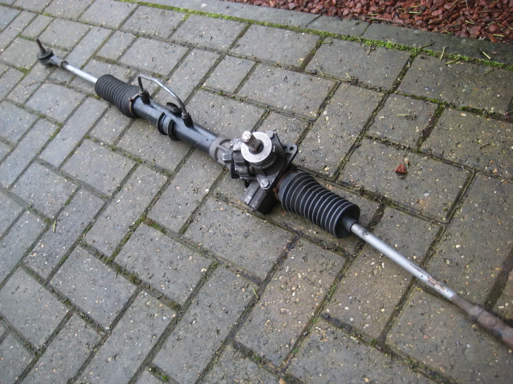

Depending on the weather tomorrow i'll work on the car. The Manual Steering rack is all complete which i am happy with. So we'll see what happens.

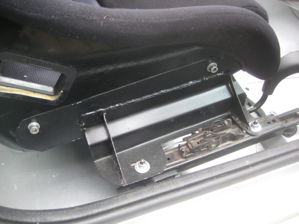

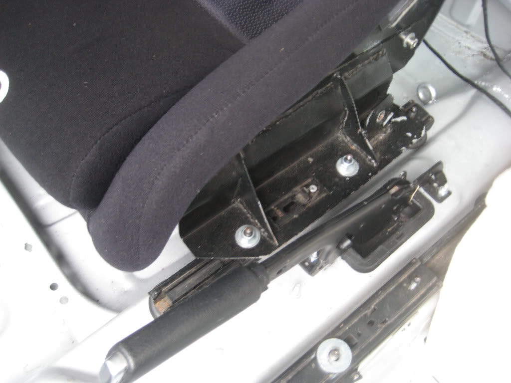

do you have any pictures of your subframes / how you attached your sidemounts to the car?
have fabricated some up but am a little unsure, pics of descriptions or anything will help...lol
Dont know if your still after pics but this is what i have

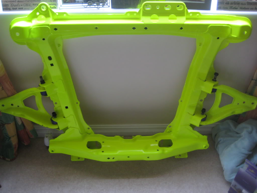

A small update,

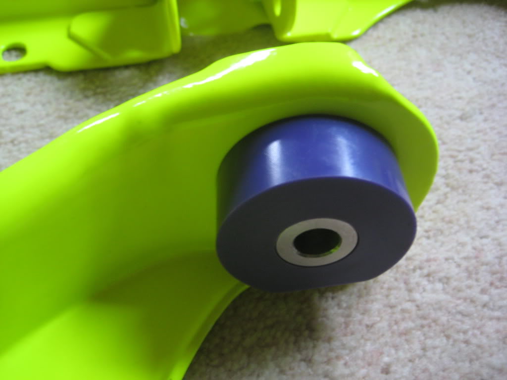

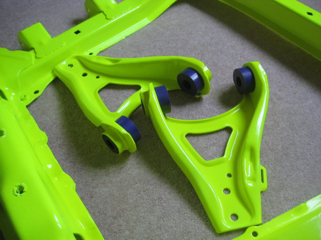

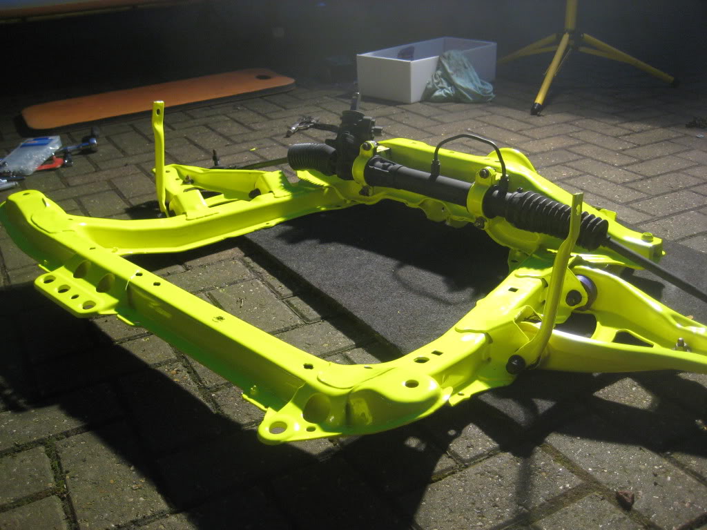

So the other day i started to rebuild the subframe and wishbones.
Firstly i had to press the new polybushes into the newly powdercoated wishbones
Then press the metal tube inside the bush, now this was a bit of a ball ache as the powdercoaters had powdercoated the inside of the metal sleve so it made is slightly harder to be pushed in. I just useded my vice and they went in fine
Sitting nice and flush
I also took all the rust off the bolts and sprayed them black to look a bit nicer
And after attaching the wishbones i called it a day that day

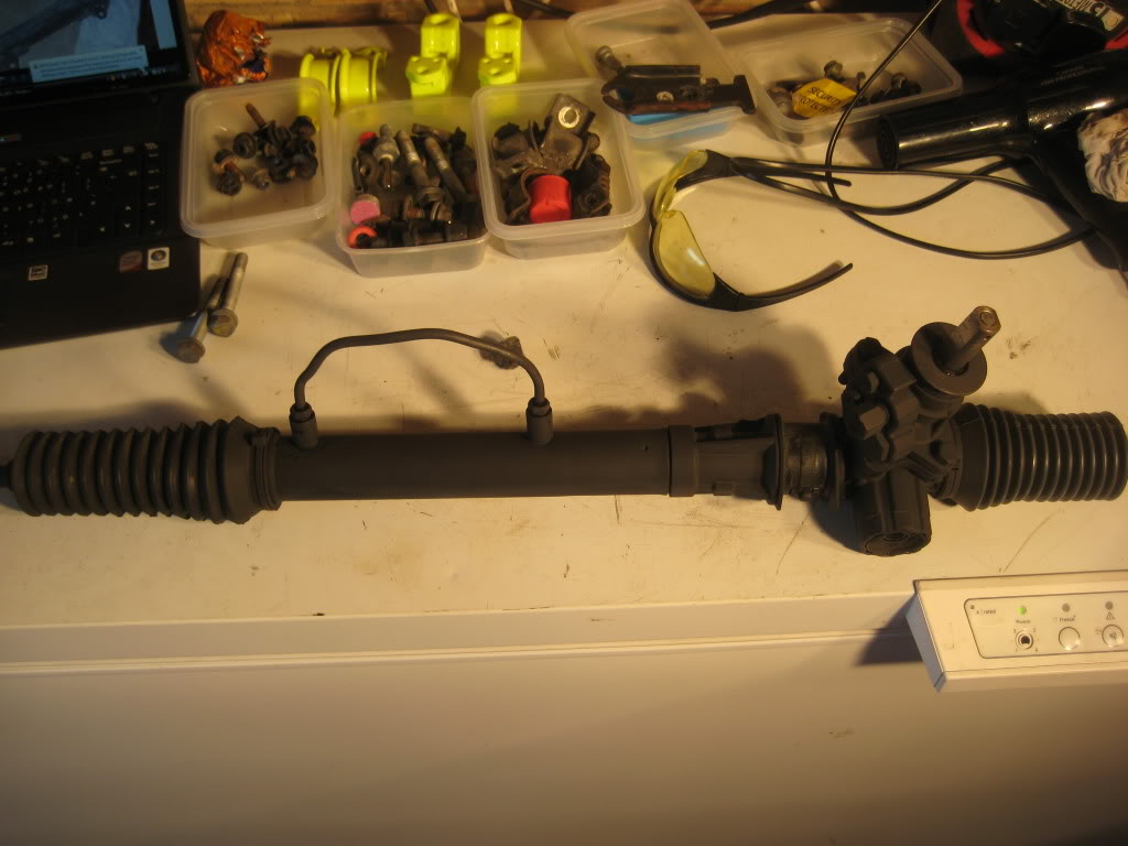

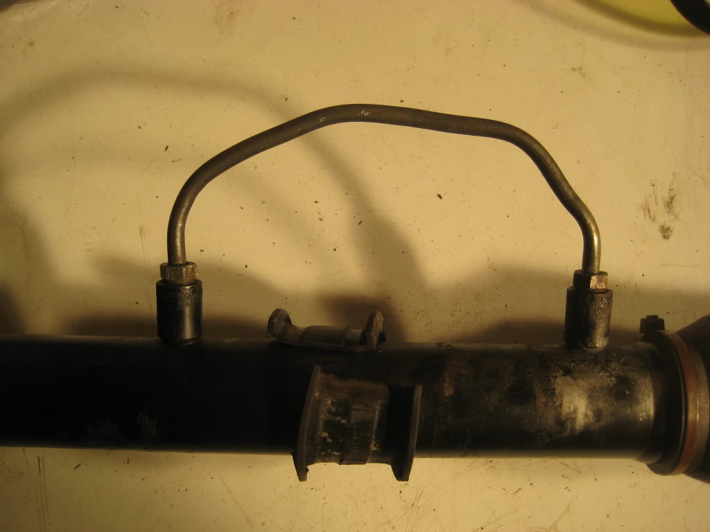

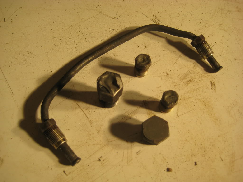

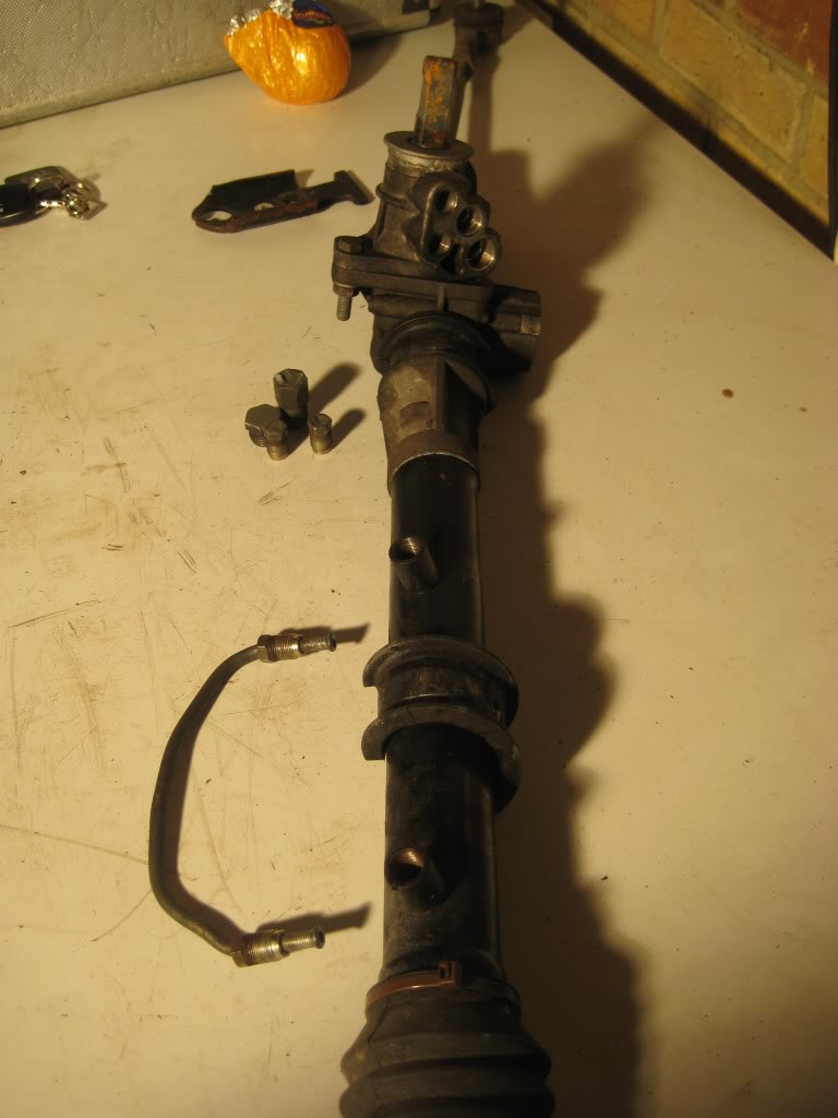

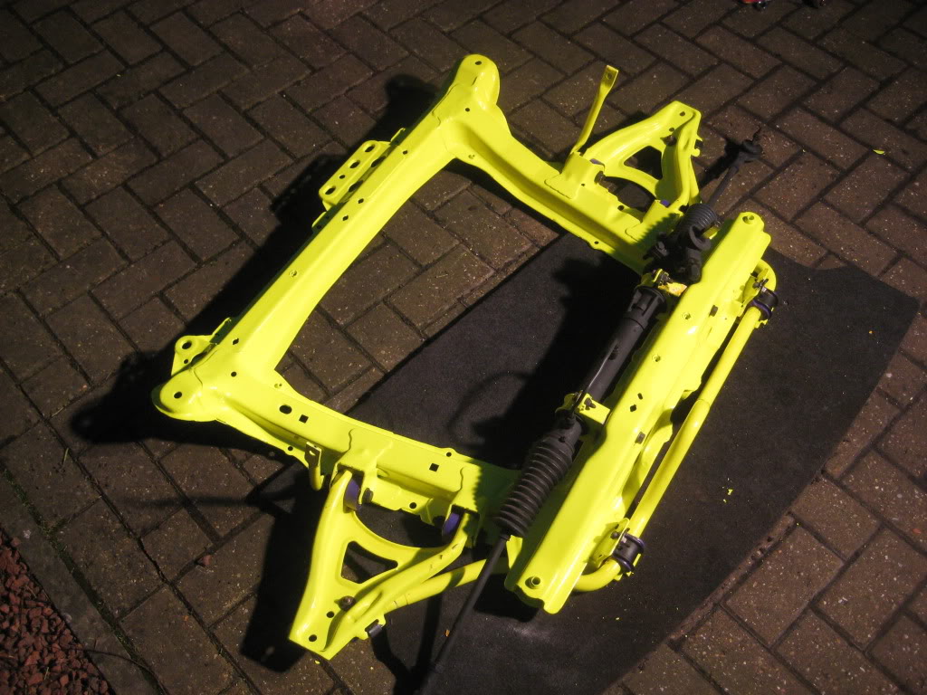

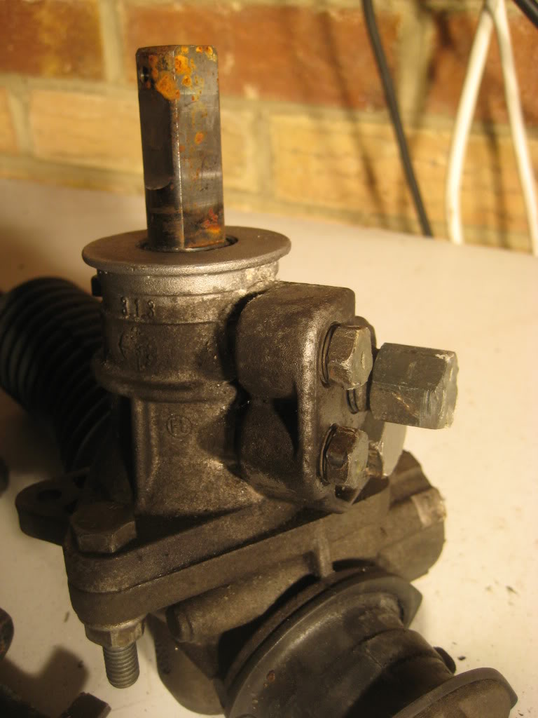

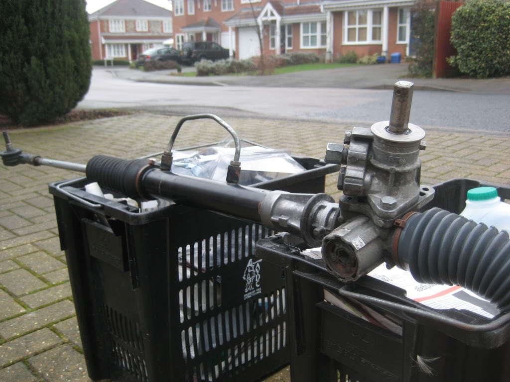

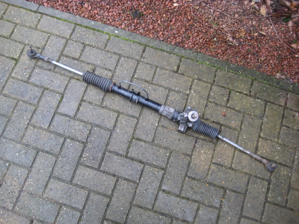

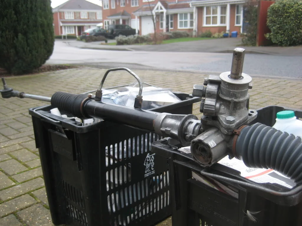

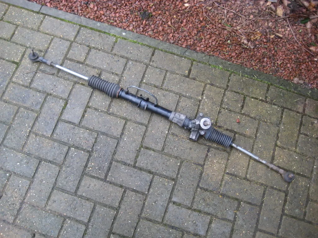

Next thing to do was to get the piece of copper pipe flared to go onto the steering rack. So went round to my mates place and he flared the ends :)
So i now had the 4 orginal pipe nuts (not sure what they are called) filled with chemical metal, and the piece of pipe.
So i screwed the bolts into place to block off the holes
And screwed in the pipe
So it's gone from this
To this
So i gave it a degrease and dryed it off
And then sprayed it black
Couldnt be ar*ed to do any more so called it a day.

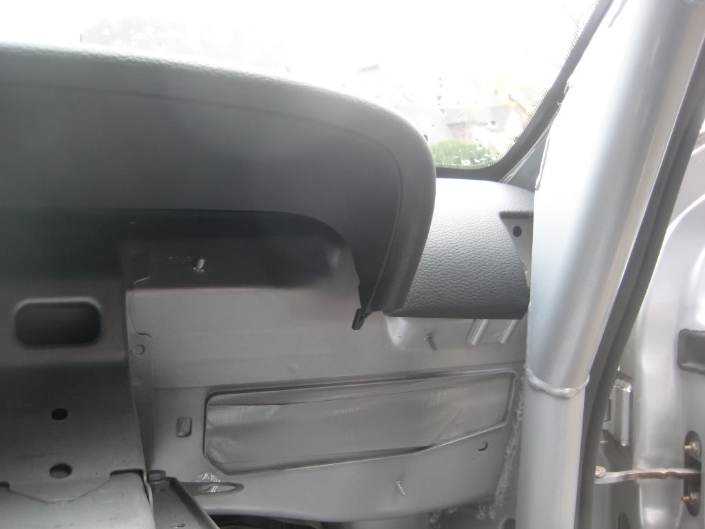

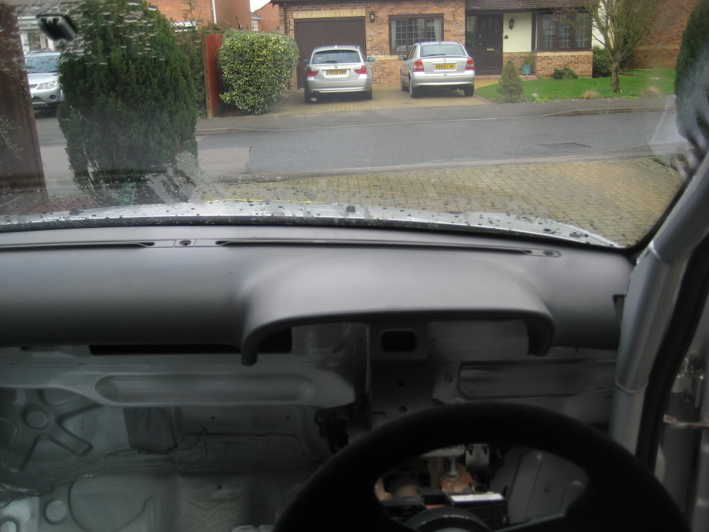

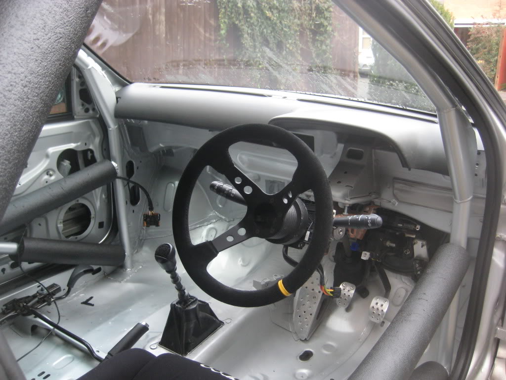

Just thought i'd show my Mk1 dash actually in the car too.

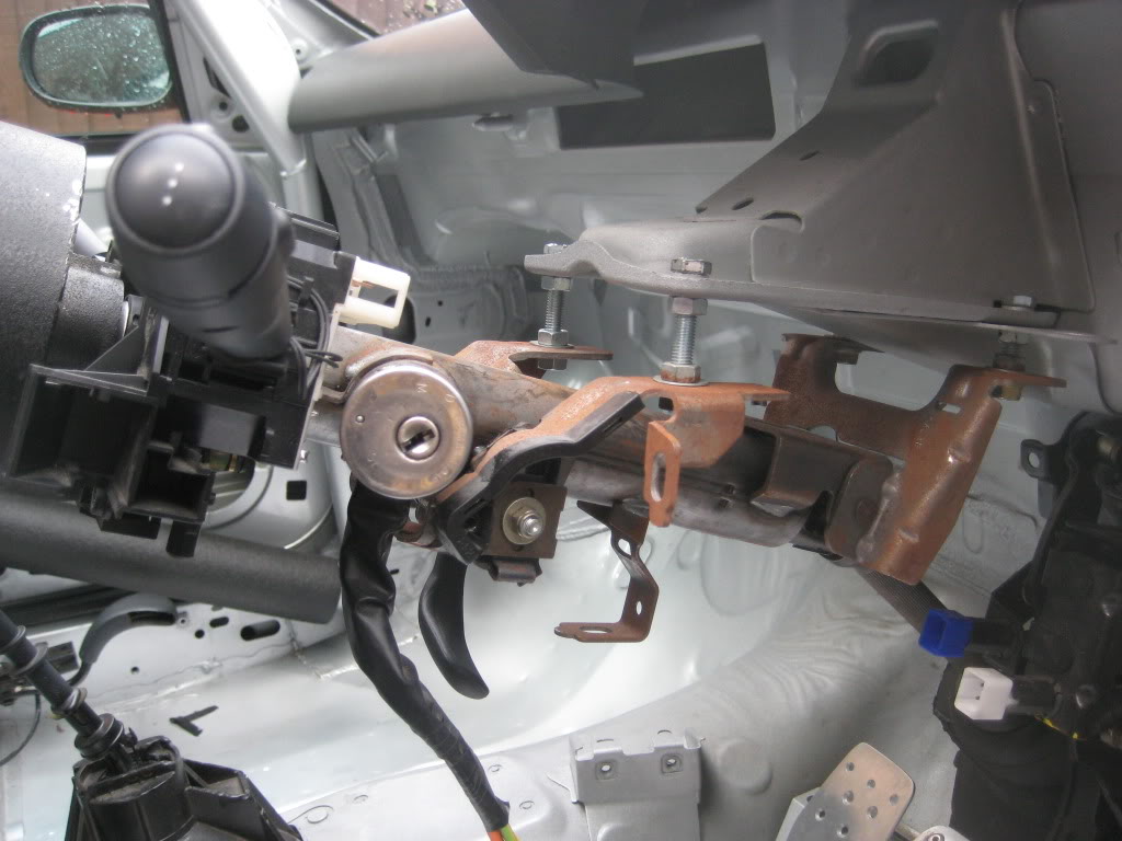

I had to just cut off the corners so it could fit around the roll cage
And i had also lowered the steering coloum a little while ago so its a little lower/closer to me.
Its gona get sprayed at some point so it looks a bit neater

How come you didnt you go with the usual spacer option with lowering the steering column?? looks like it could be a bit wobbly
It doesnt move at all, super stiff. I've seen other people do it that way i have so i thought i might at well do the same as it works for them :)

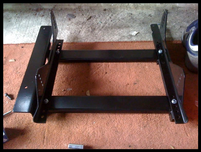

The seats dont flex at all tbh. Flexs a little right at the top of the seat near my head but not much.
I've sat in a few clios with buckets and mine have deffently been one of the lowest seats/subframes
Pah... mine where on the floor, you could drop yours another 10mm~ by removing the original spacers you have between the floor and your frame! ;)

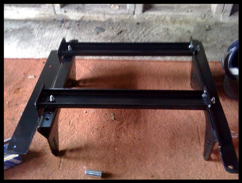

My frames;
My frames;
I want them, they look so much neater than the bodged up ones i bought lol
he better not have his drawings, he told me he didn't... mine will sit lower...lol
crispy work looks good mate, the subframe looks awesome all coated up, really really nice, may have to consider the same when i come to fit all my polybushes,
you only just placed the dash in there? fit quite nicely don't they
The drawings where destroyed after production for security reasons... ;) LOL
Foxy sent me a rough drawing of his frames from his MK2 Clio... I then altered the design slightly and re-drew them on CAD, then got them fabricated.
But I cannot find the file anywhere, not sure what I did with it?!

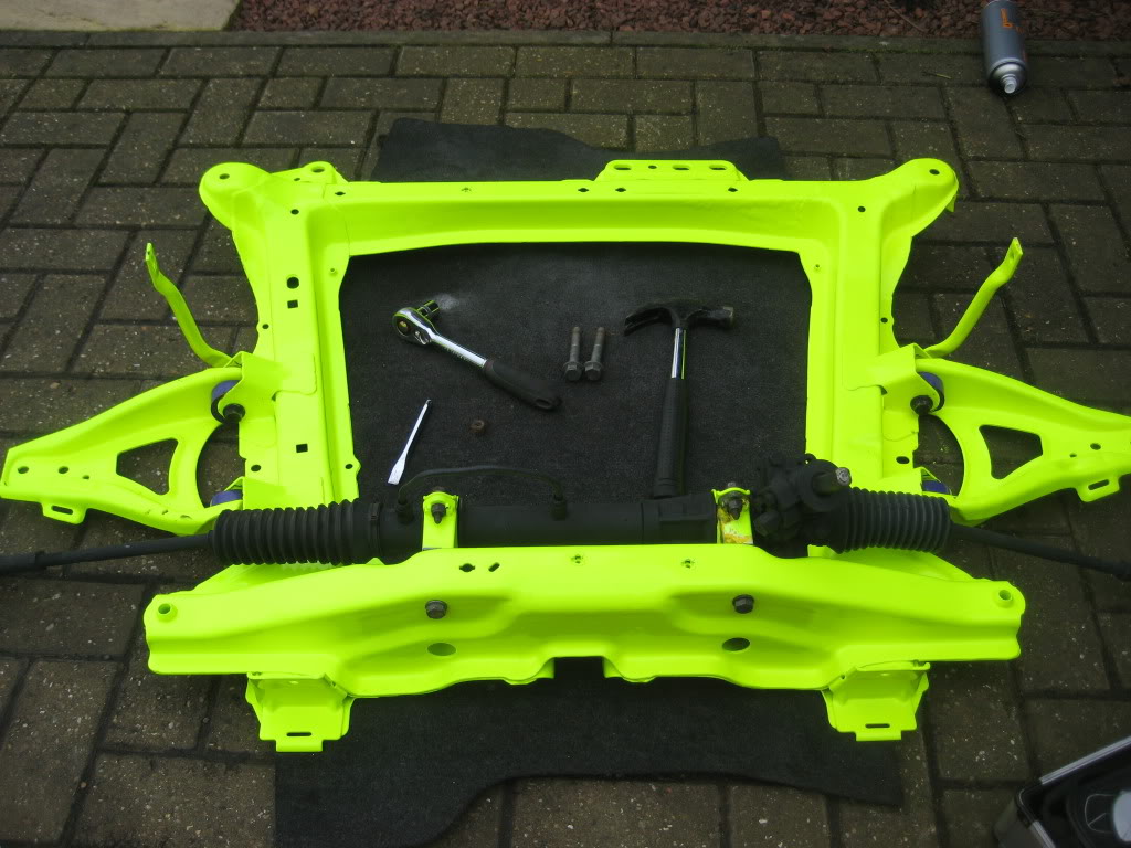

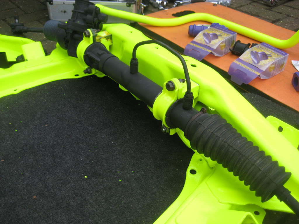

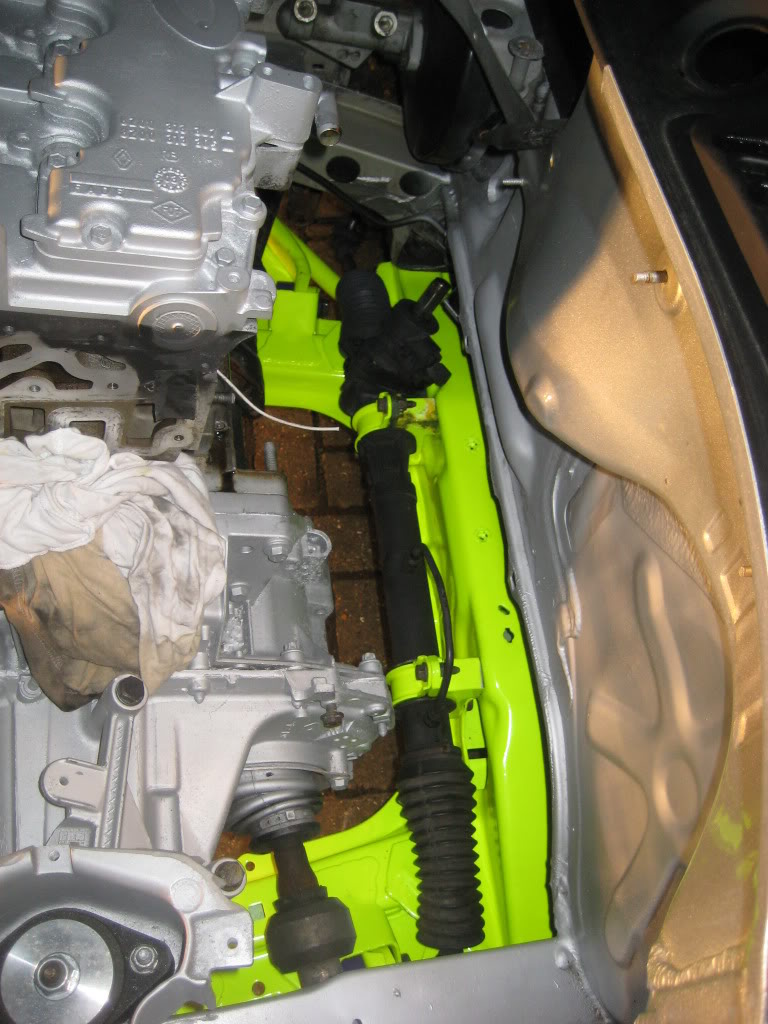

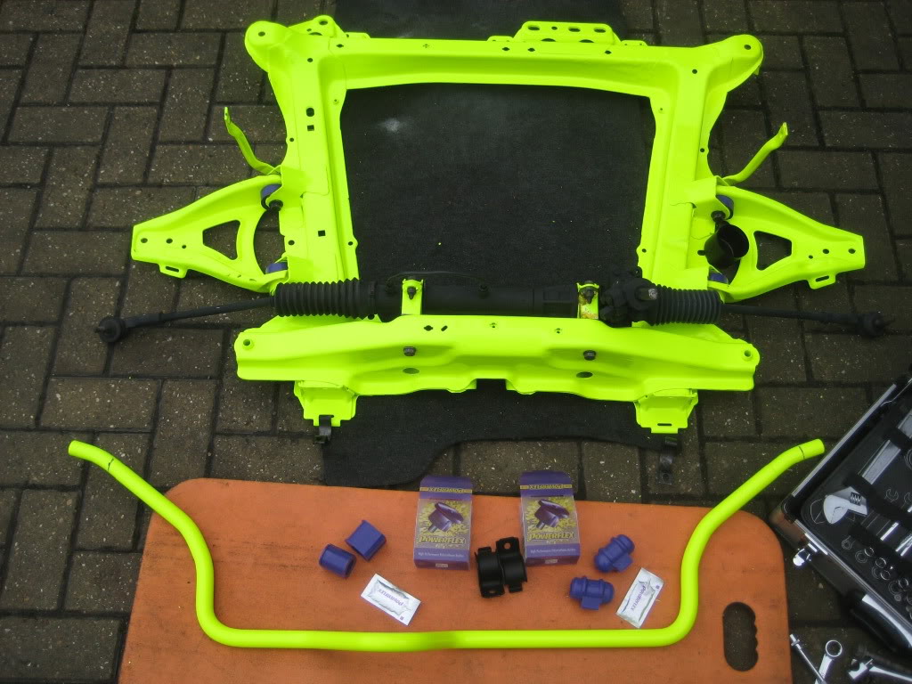

So after spraying the steerign rack yesterday i fitted it to the subframe.
You might see on the rack brackets that i had to use paint stripper to get the powdercoat out of the thread, it did work but made a mess of one of them :(

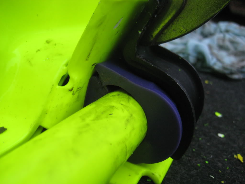

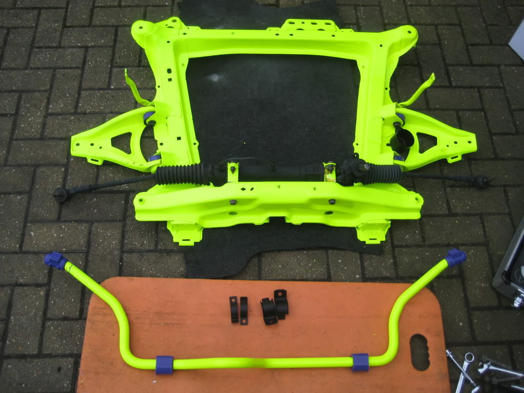

Next was to figure out where the new Powerflex ARB bushes went
Fitted in place

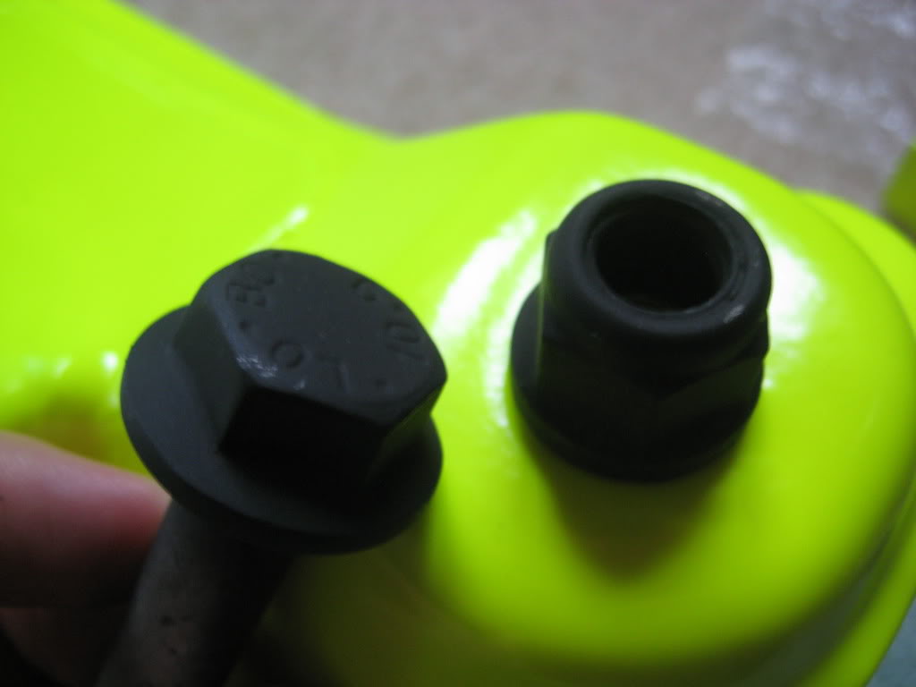

Now I'm not sure but i think i have been hit with the curse again. Now i have attached everything correctly and bought the correct size but this doesnt look right!??
Its the inner bush on the ARB.
The other side looked even worse but i attached it any way can anyone tell me if there's looked completly round or did it deform like a bit*h like mine has done?

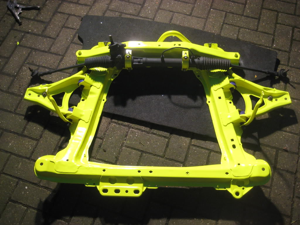

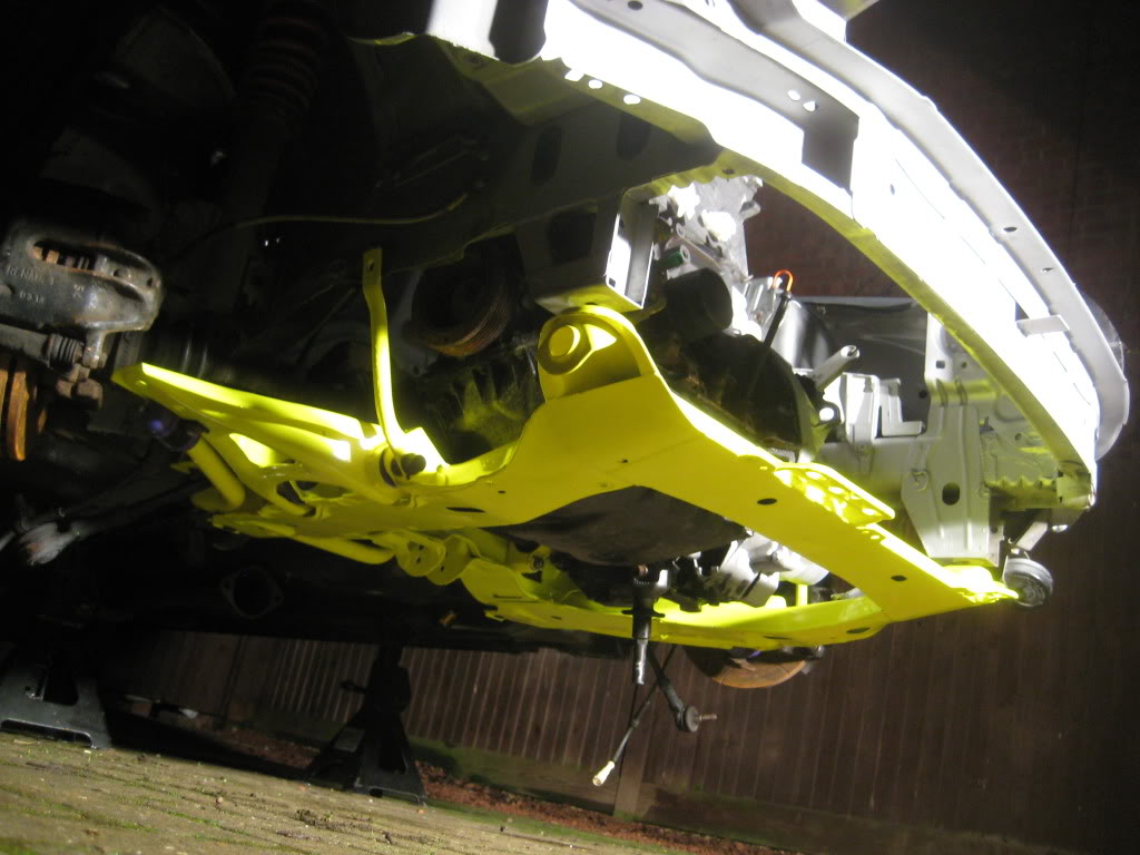

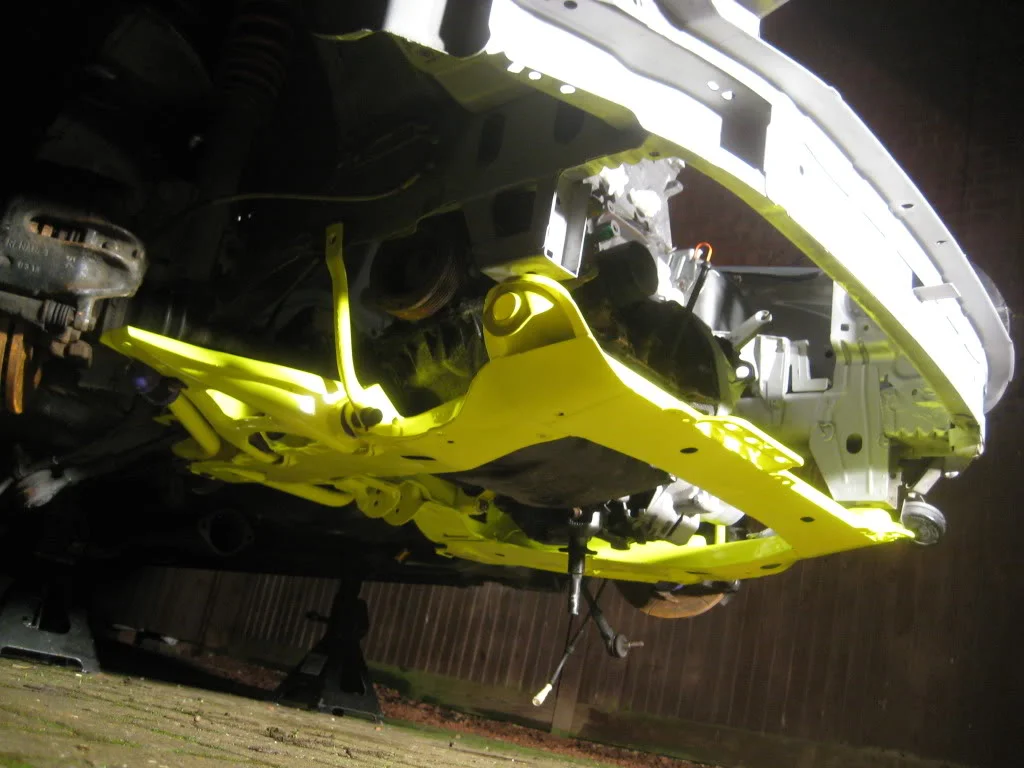

Anyway evenually get the subframe all built up so this is what it looks like

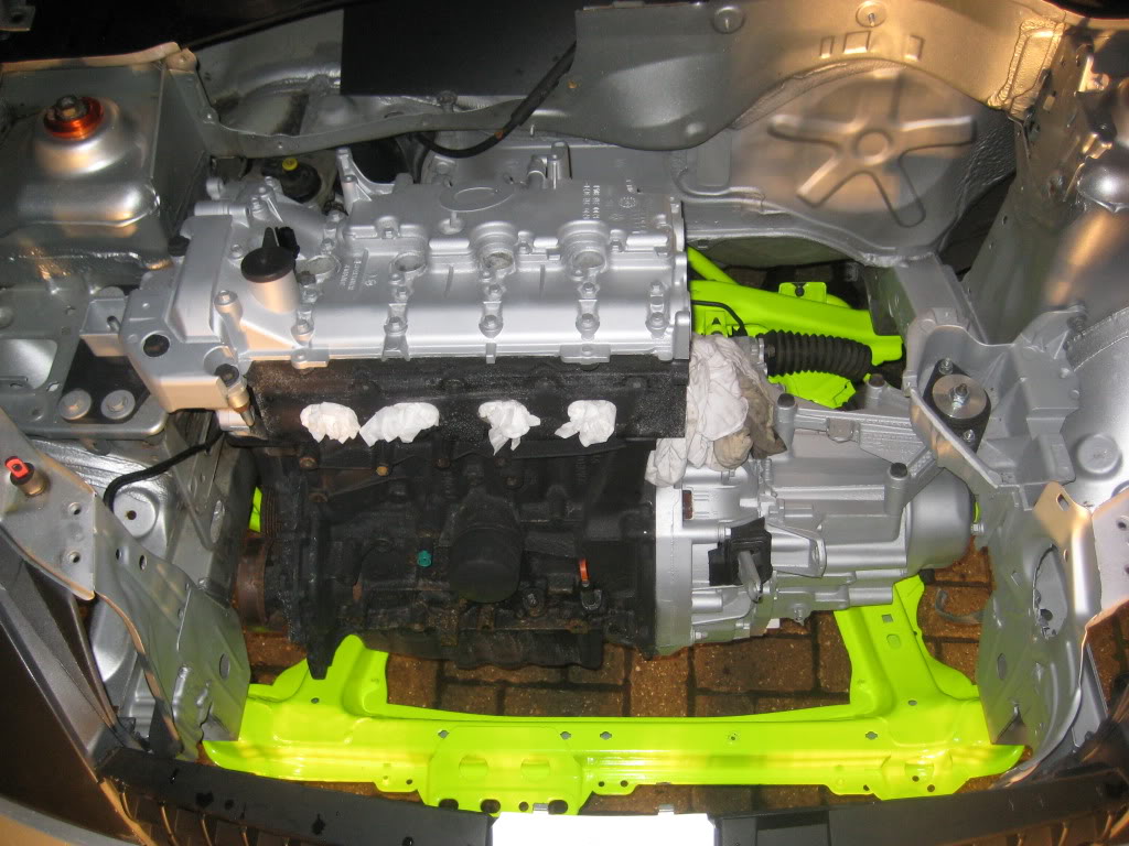

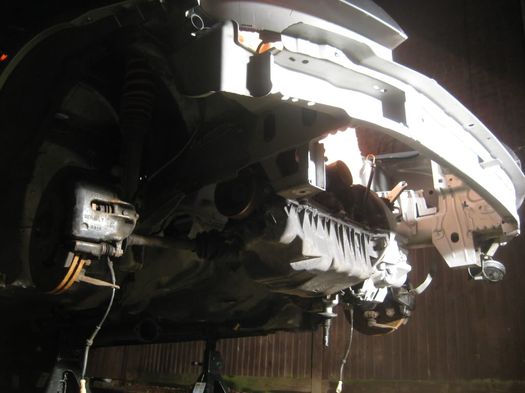

So this is the underside of the car with out the subframe

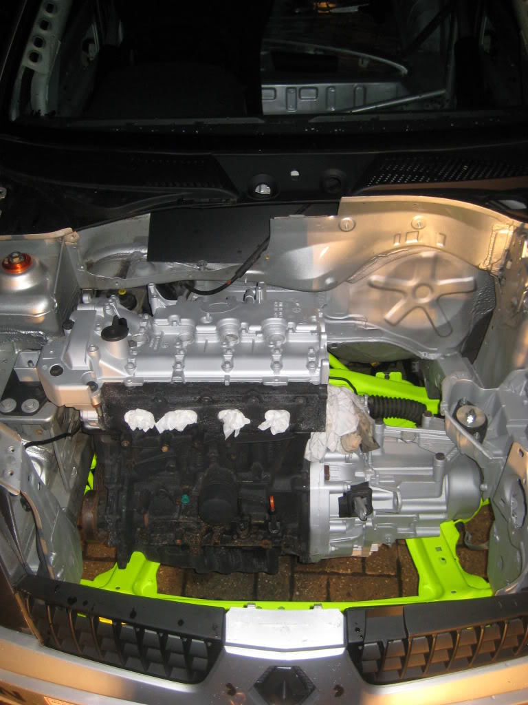

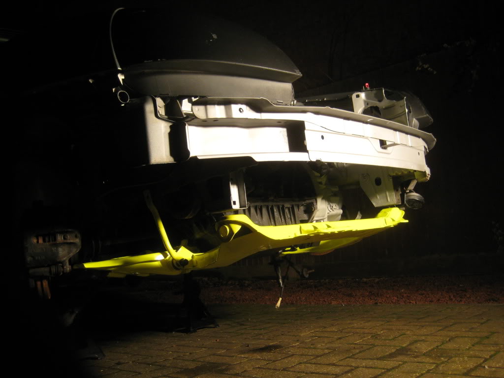

And this is it with it :)
A few pics from above
So thats it for now, hopefully going to order a 172 cup alternator and all my braded bits for the brakes this week coming. I'm please with my days work :)

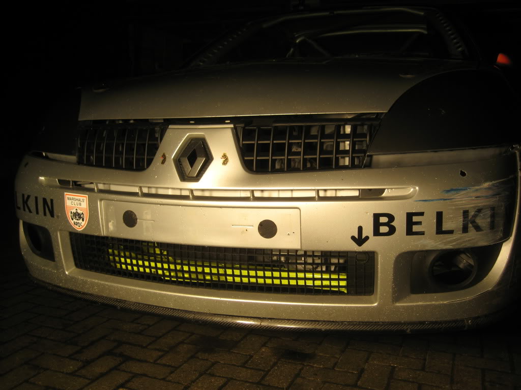

i love how you can see the colour of the subframe through the bumper grille, looks bloody ace!
