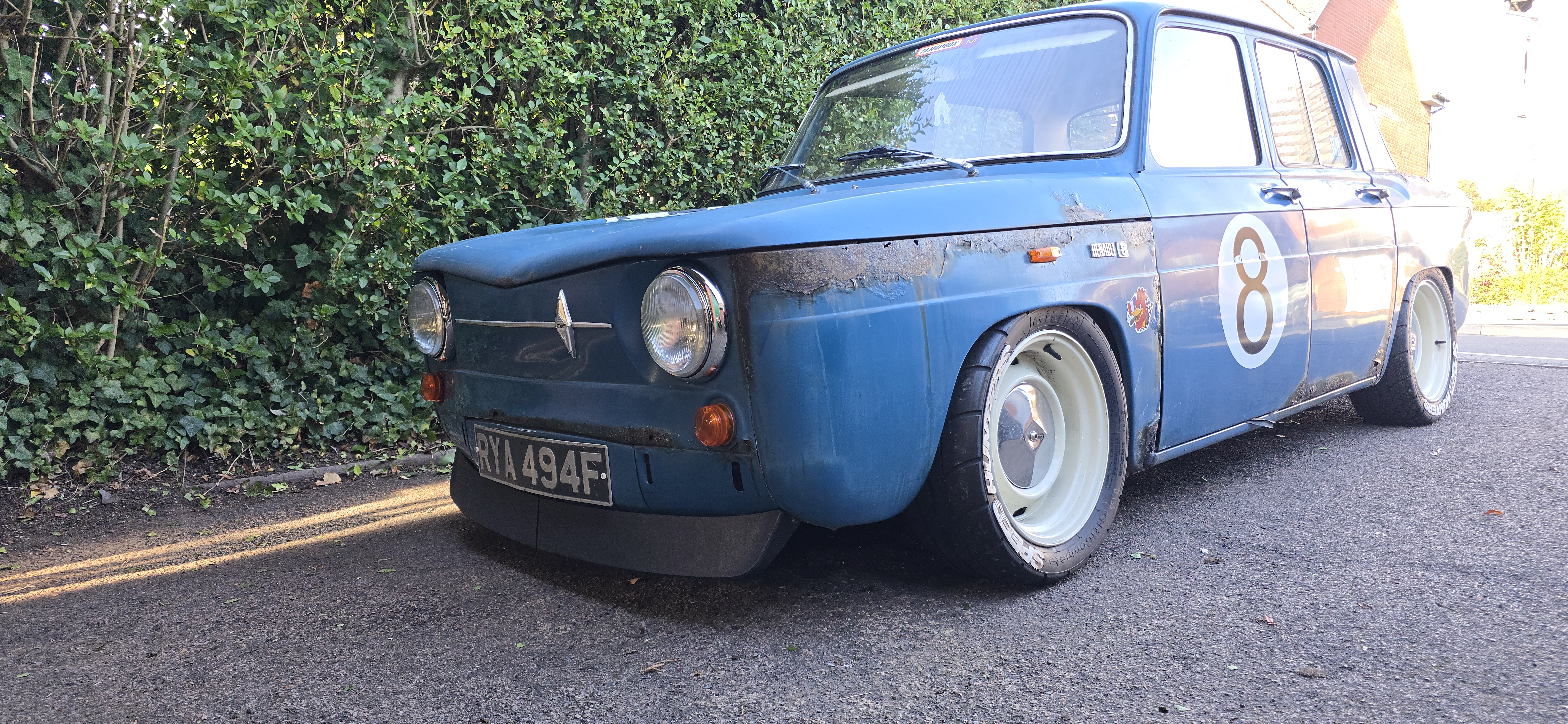

Rusty old 1968 Renault R8

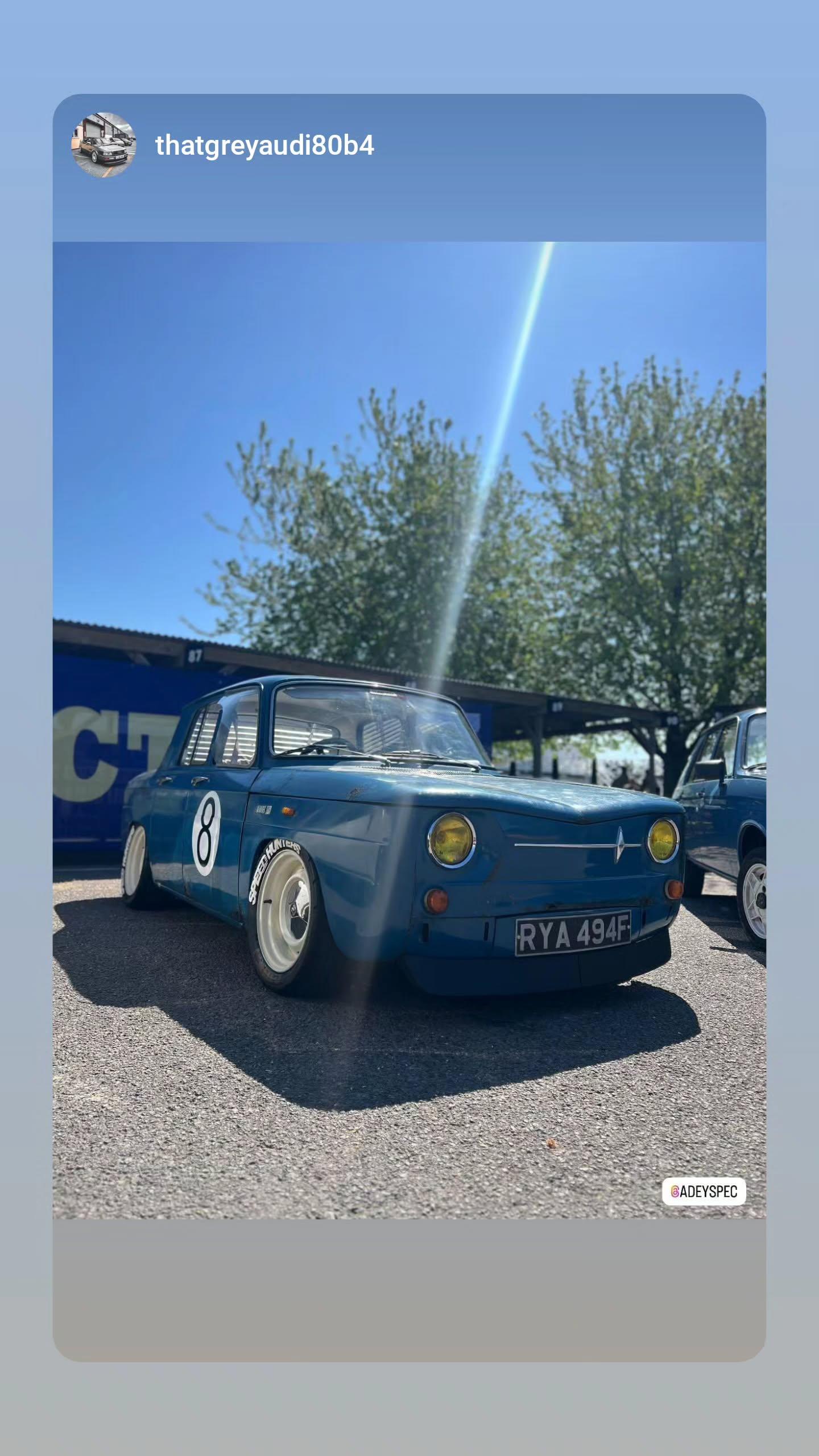

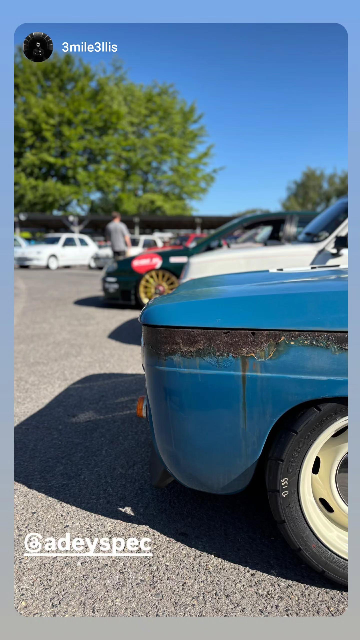

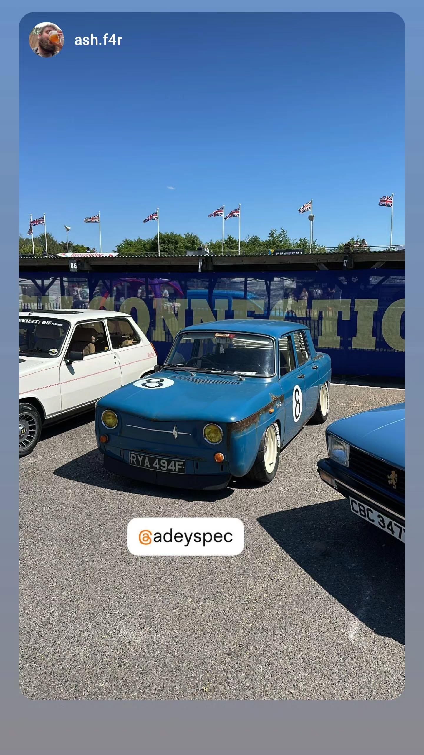

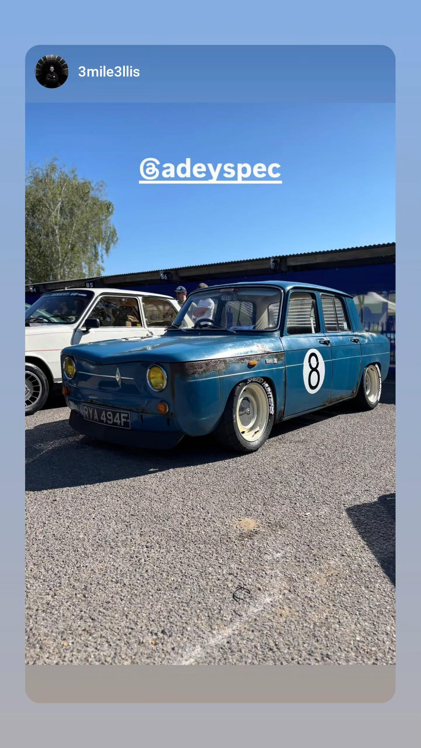

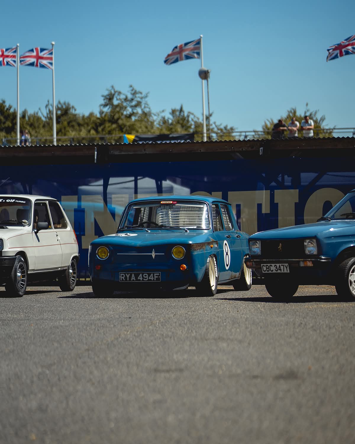

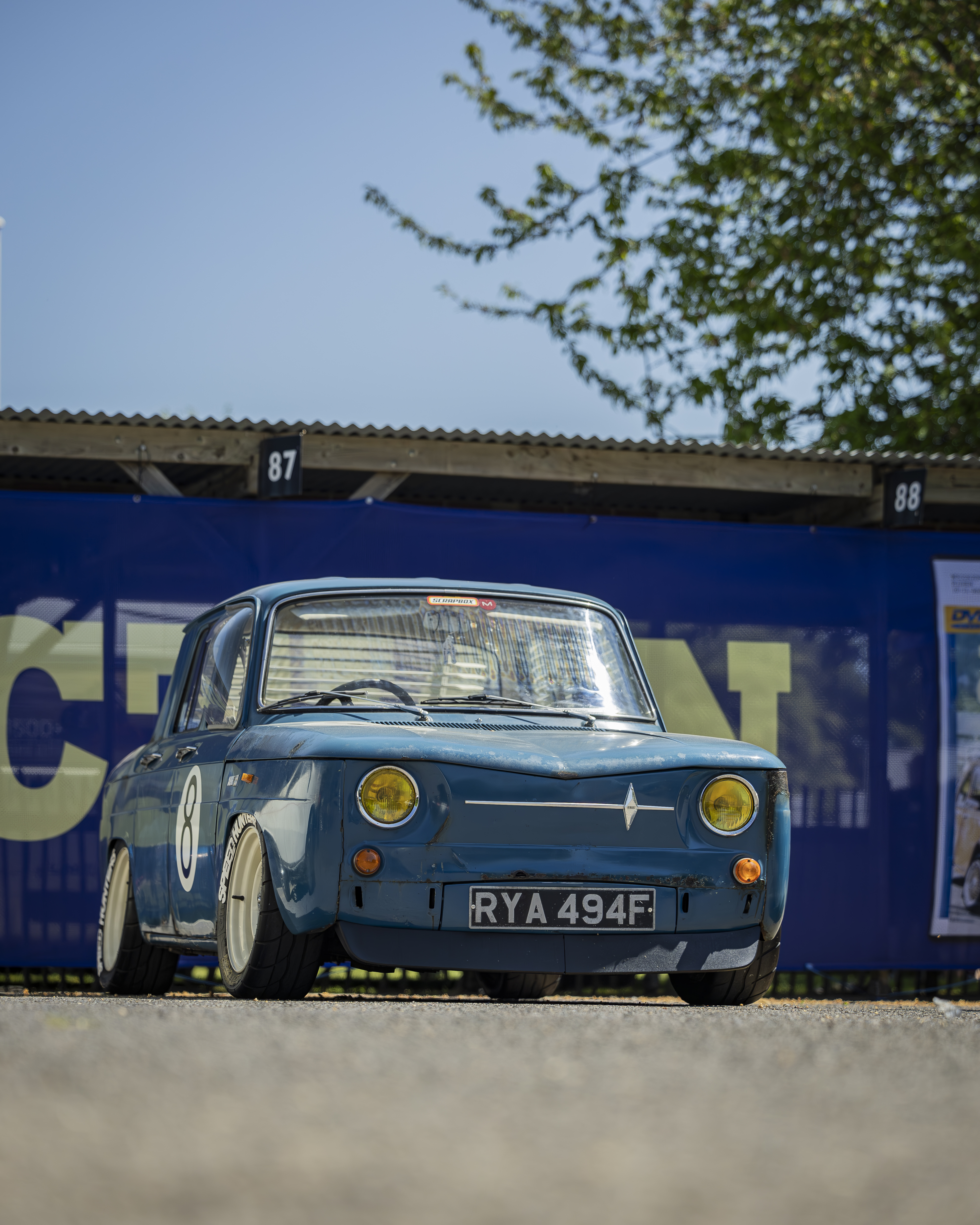

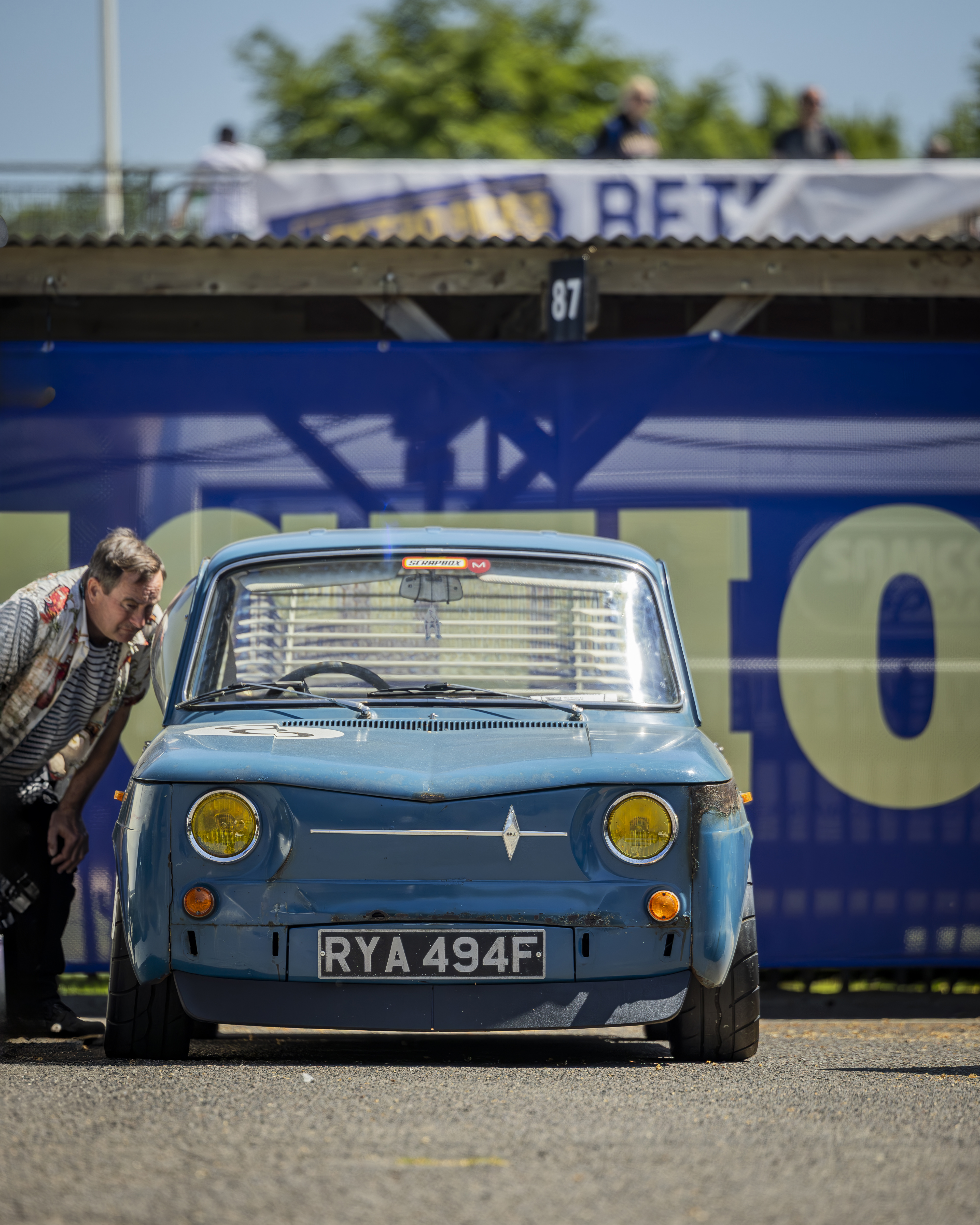

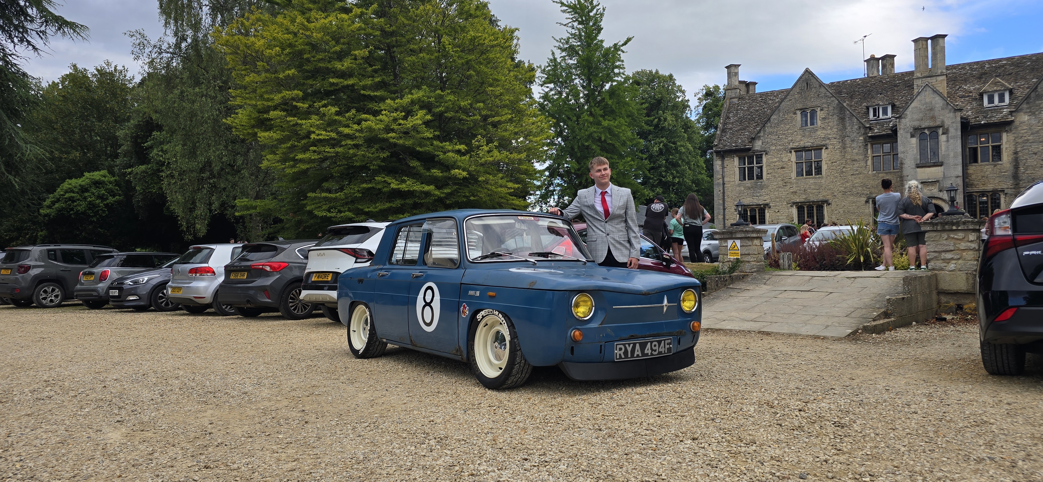

Had a lovely drive out to Goodwood this weekend for the Retro Rides Weekender. The car was displayed in the "French Connection" area along with some other lovely machinery. The show was great and defo one of the best in the year for me.

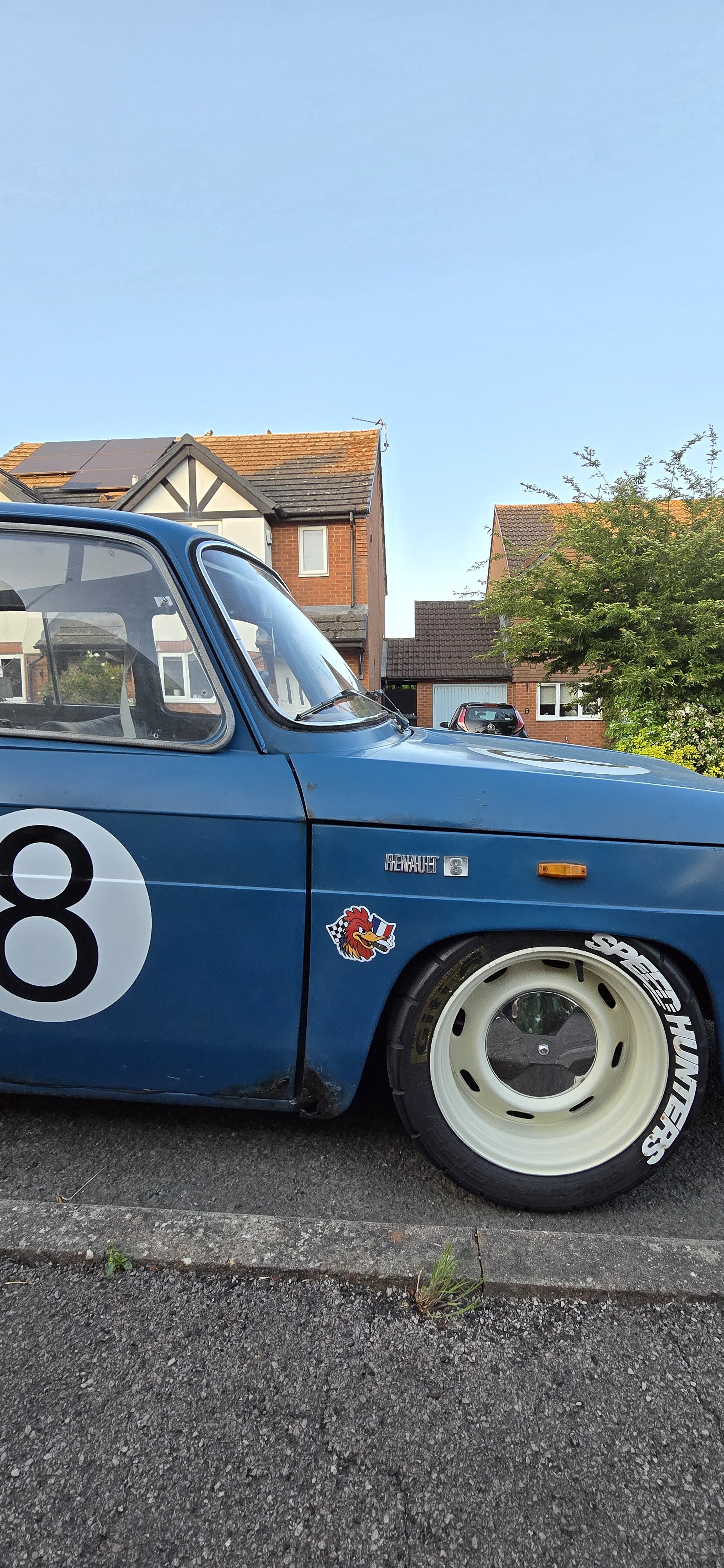

The car was nearly faultless on its 300mile round trip. Clocking around 45 to 47mpg which was nice. Cruised lovely though I really do need to sort the wheels, I think years of skinny tyres and no give in the suspension has defo buckled a few. Cruising speed has a decent wobble, though being so light resting a hand on the wheel steadies it. Also my tracking.... yeah the car pulls left lol.
Any way we drove down on Friday night to an airbnb 30 min from Goodwood. Stopped for a bite to eat at the local Caffeine and Machine on the way there too. Up and out by 8.30 the following morning. Queue in was a bit long but I got the 360 cam out for a laugh.
What a great venue, never been to Goodwood track before (though I've been to the hill climb down the road) properly posh setting with and air field attached. Really didn't manage to get many pics of the 8 but have been tagged in a few so have copied them in. Absolutely loved it though and will defo return in the future, either for a longer stop over or in the quicker car..... 3.5/4ish hours each way is a chore

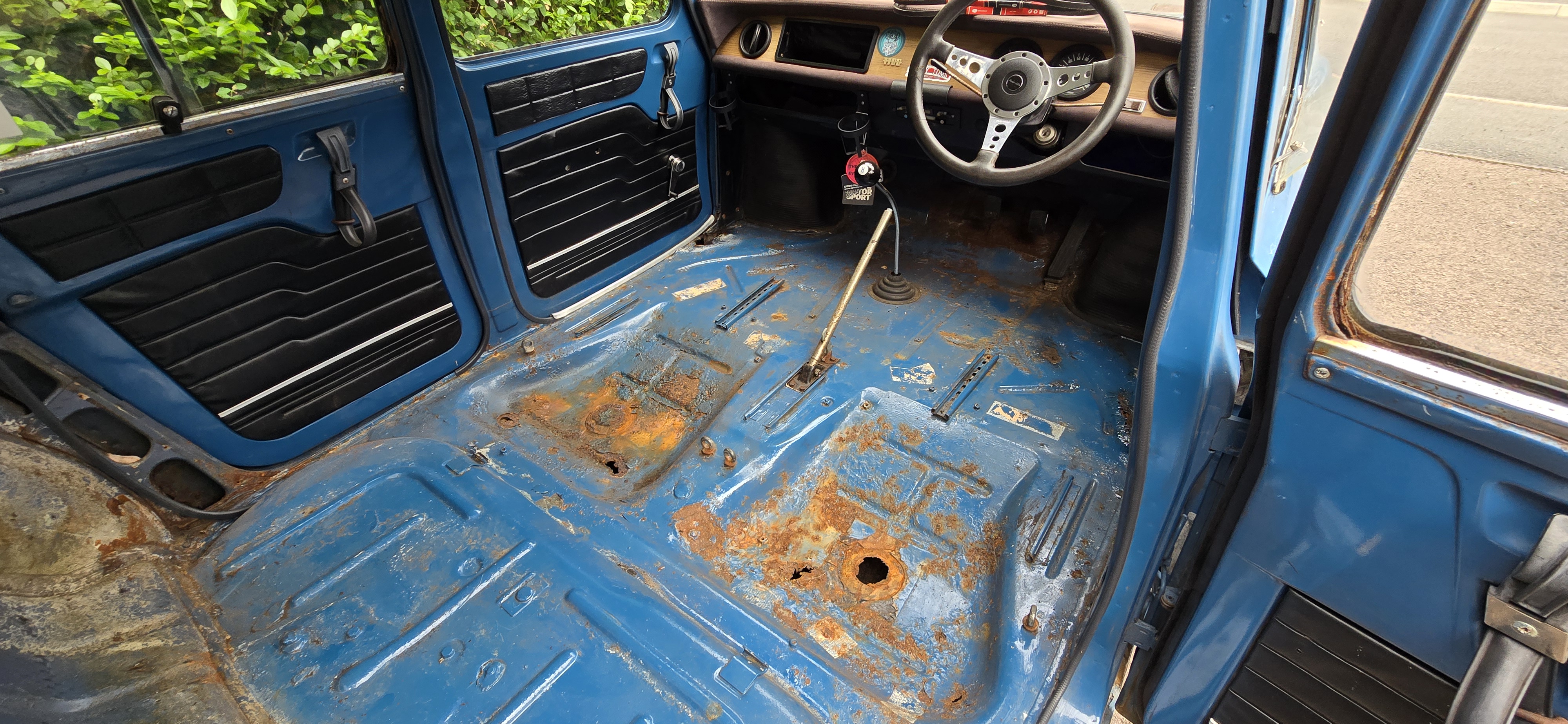

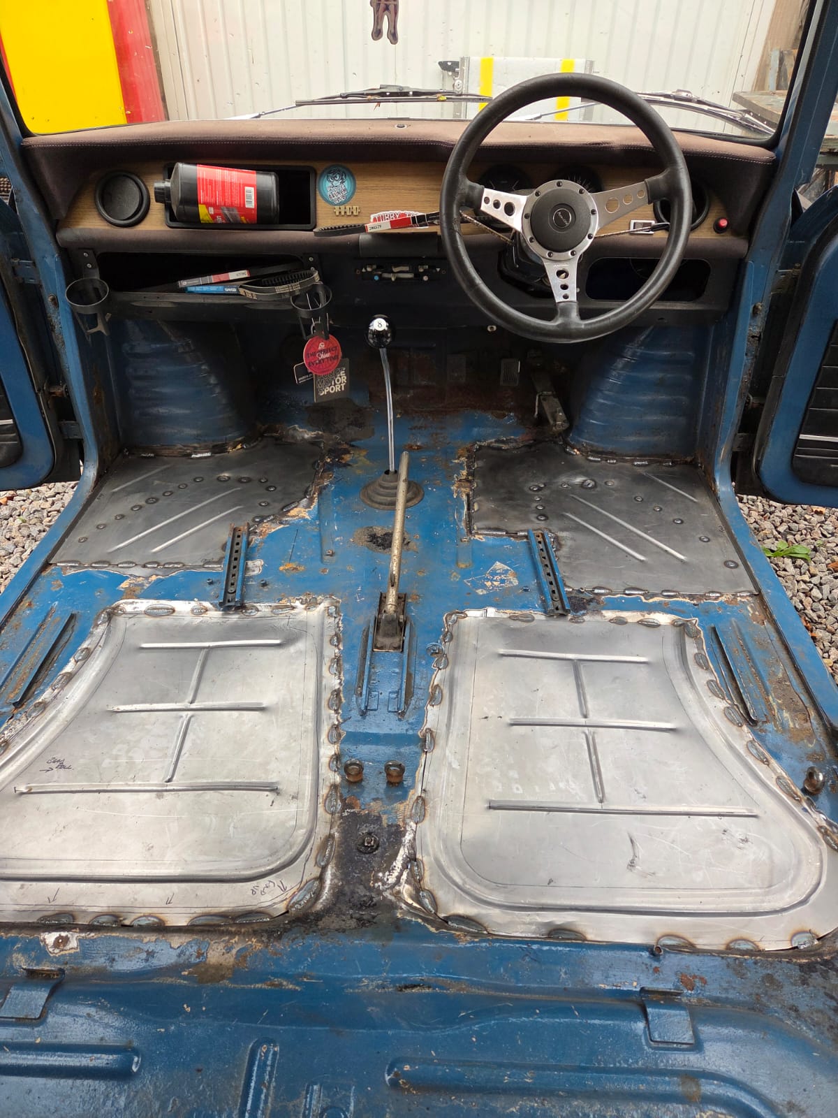

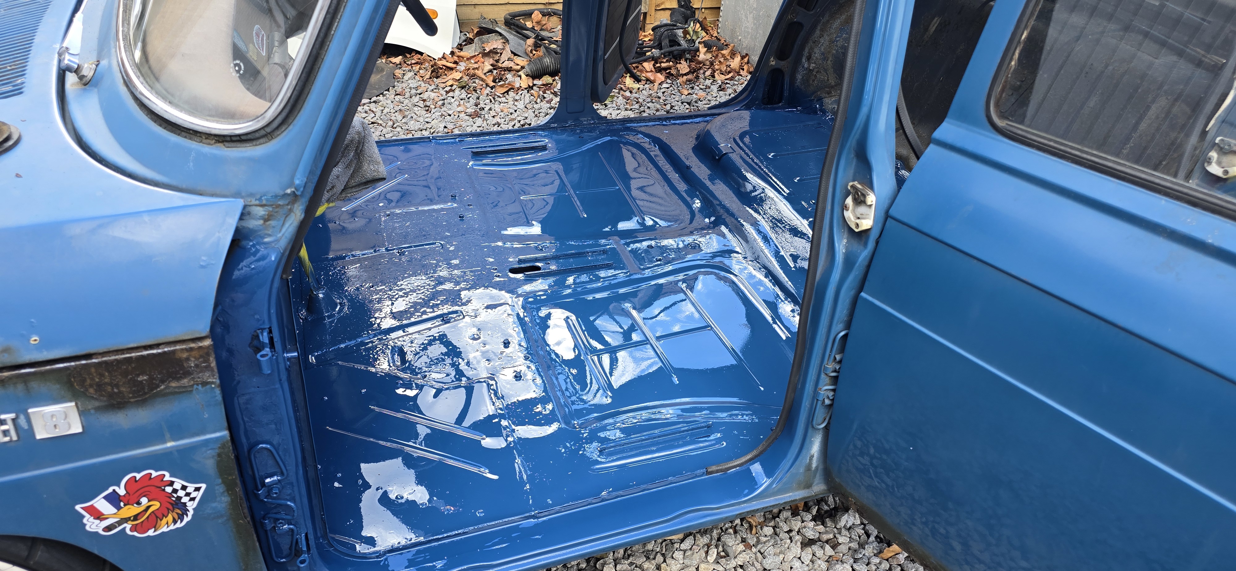

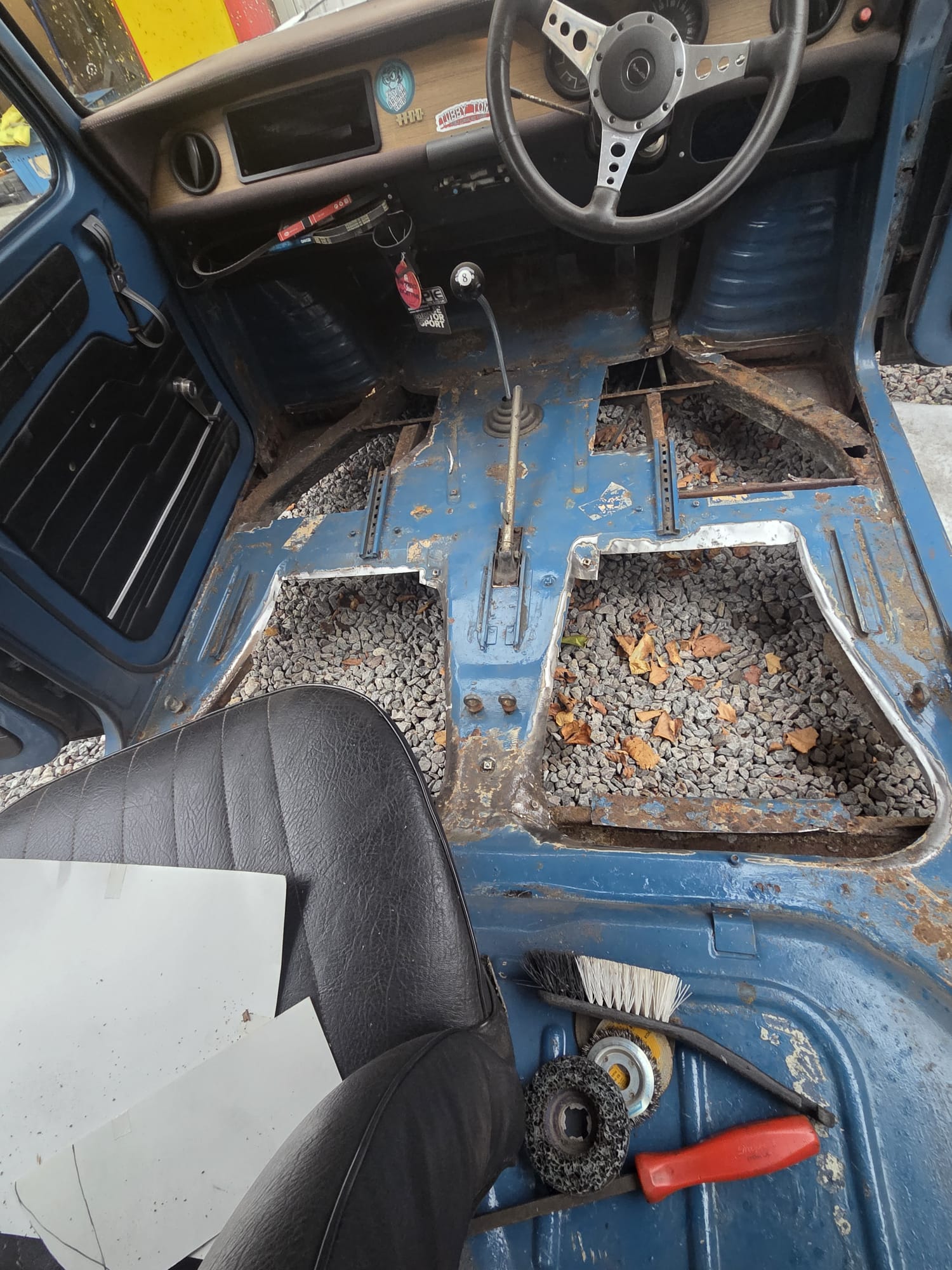

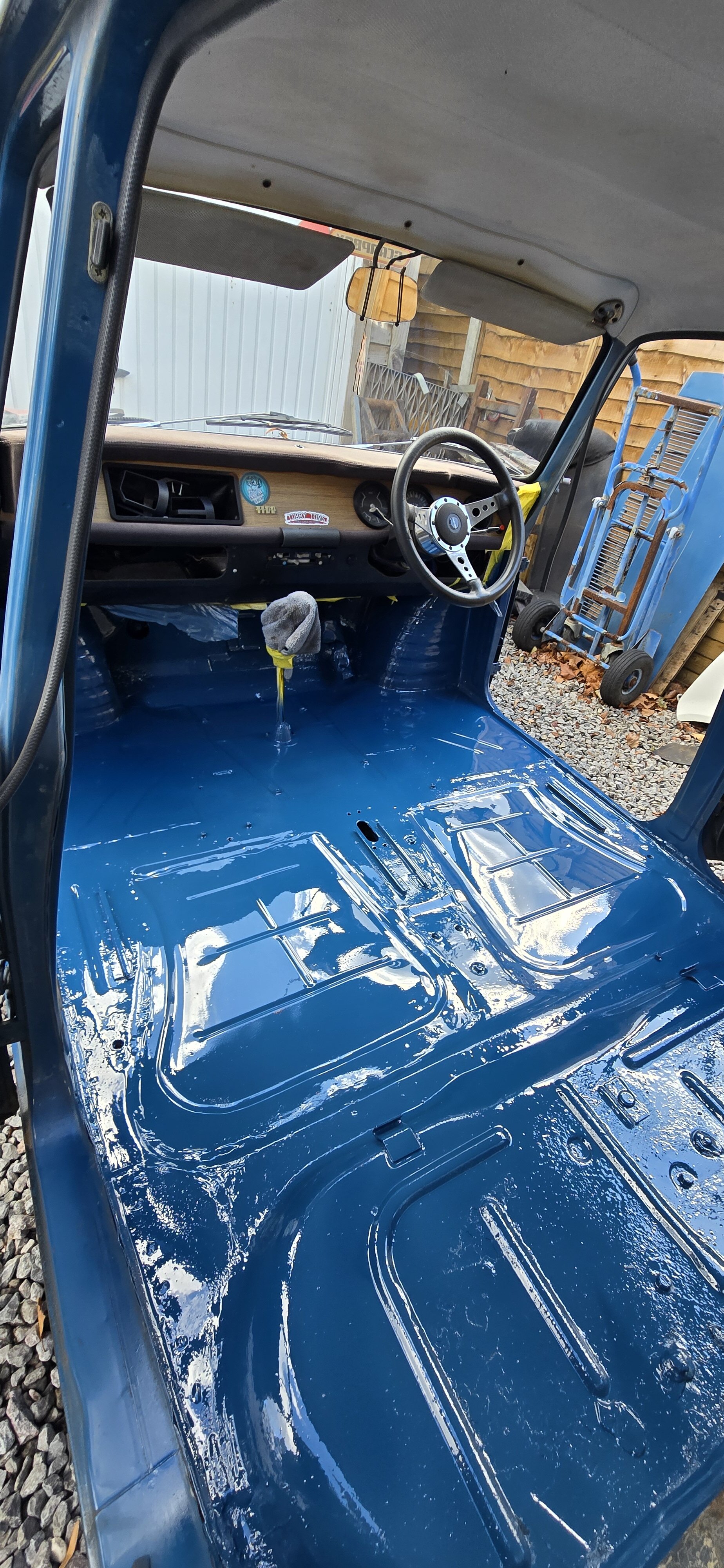

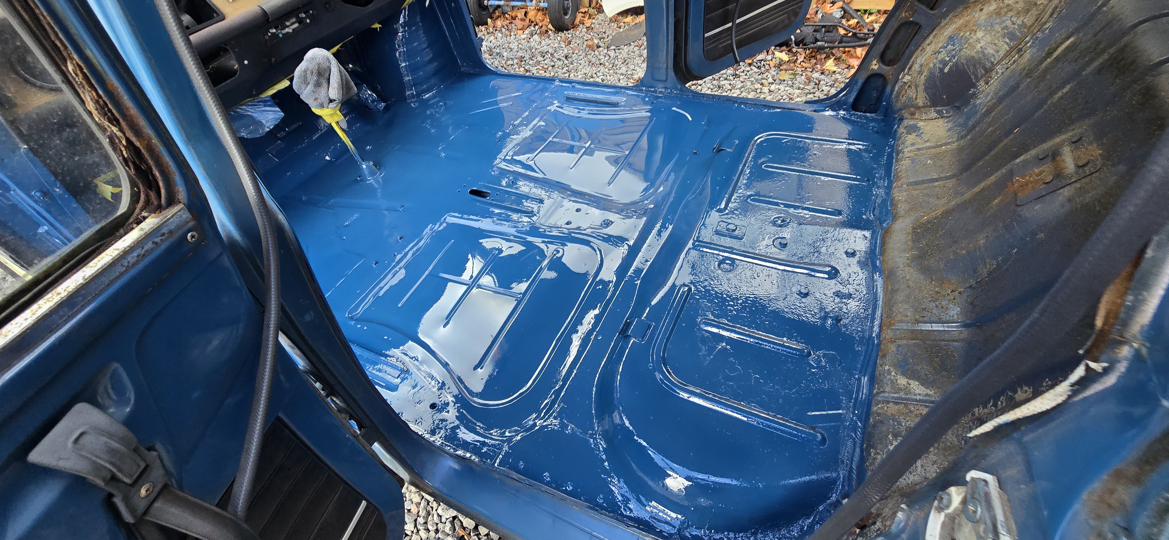

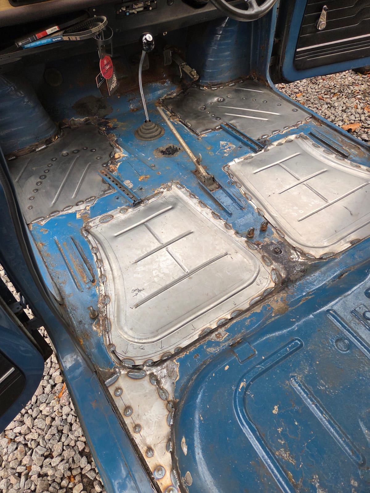

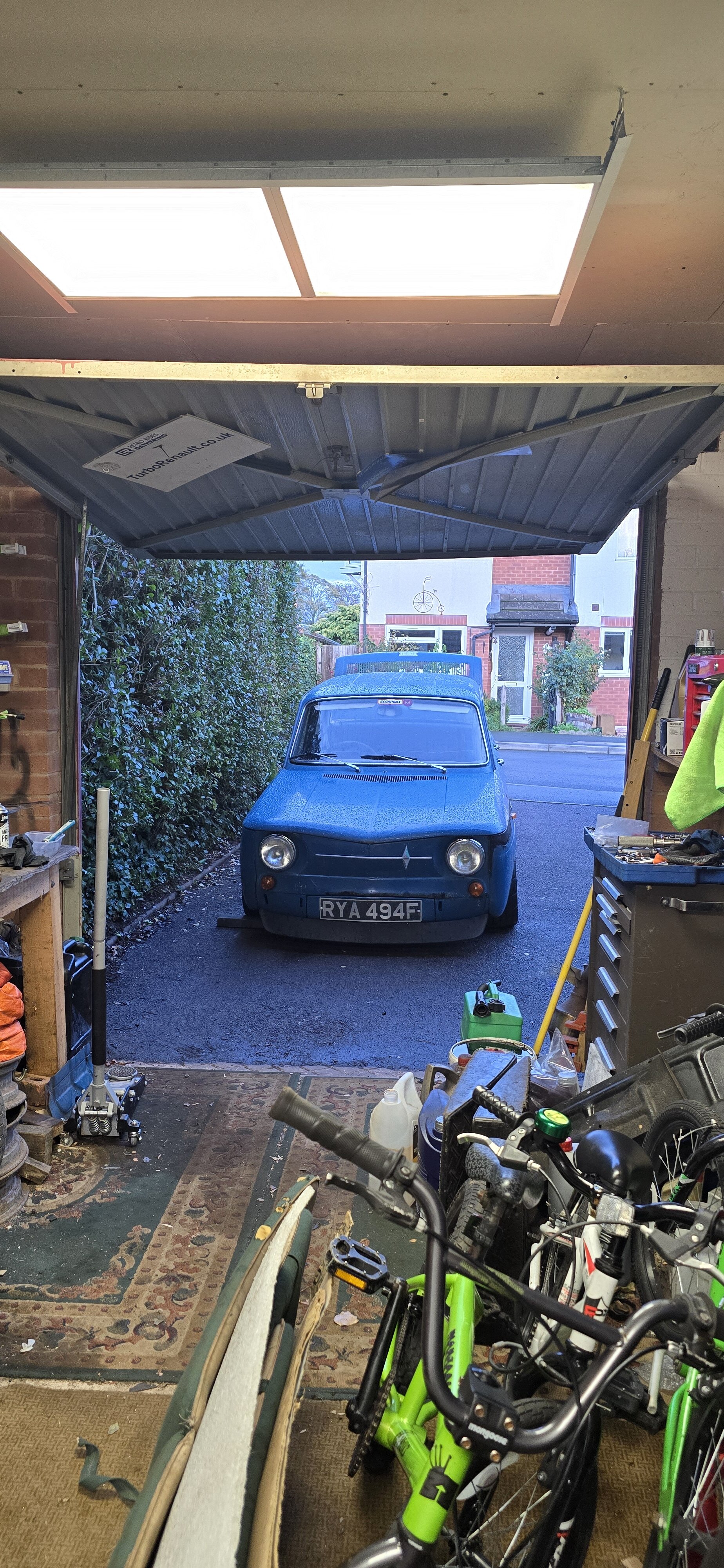

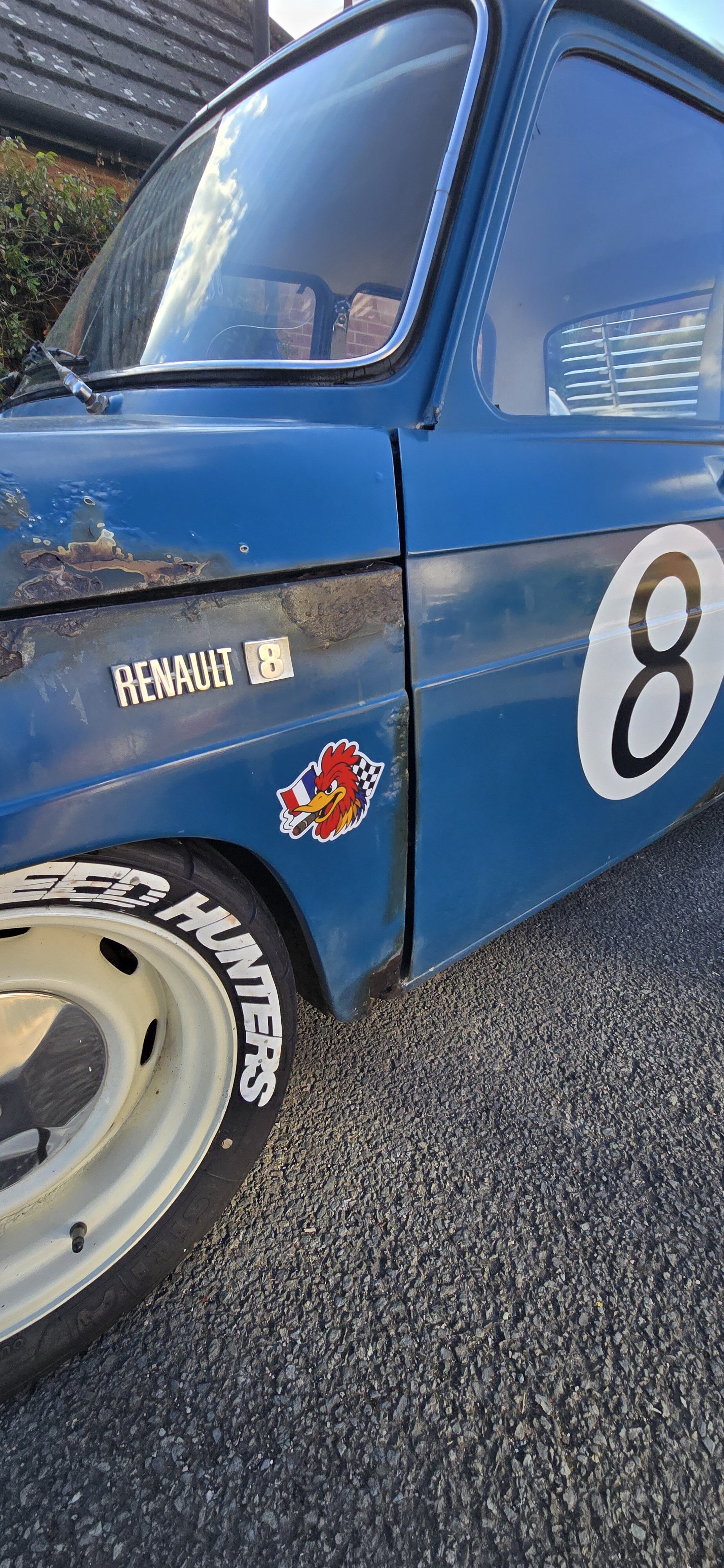

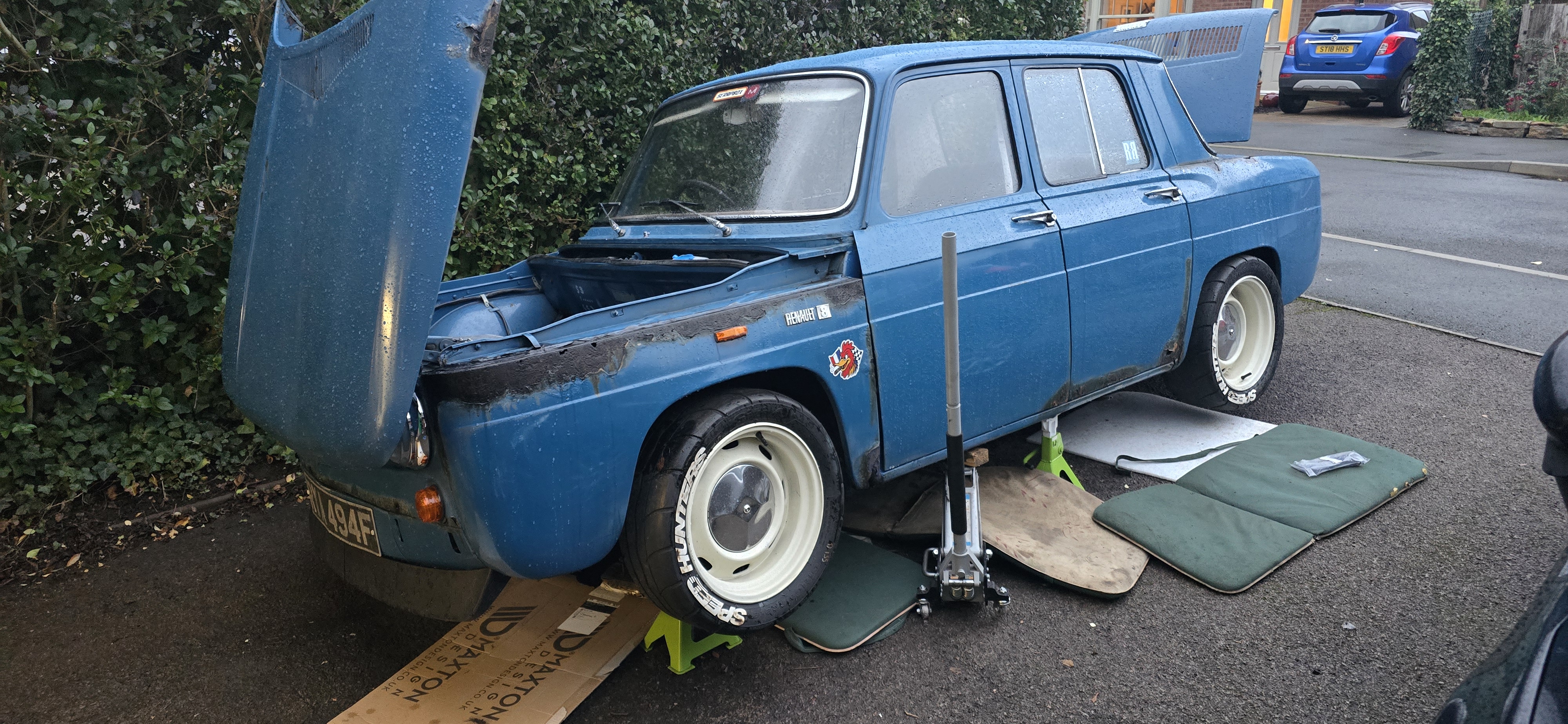

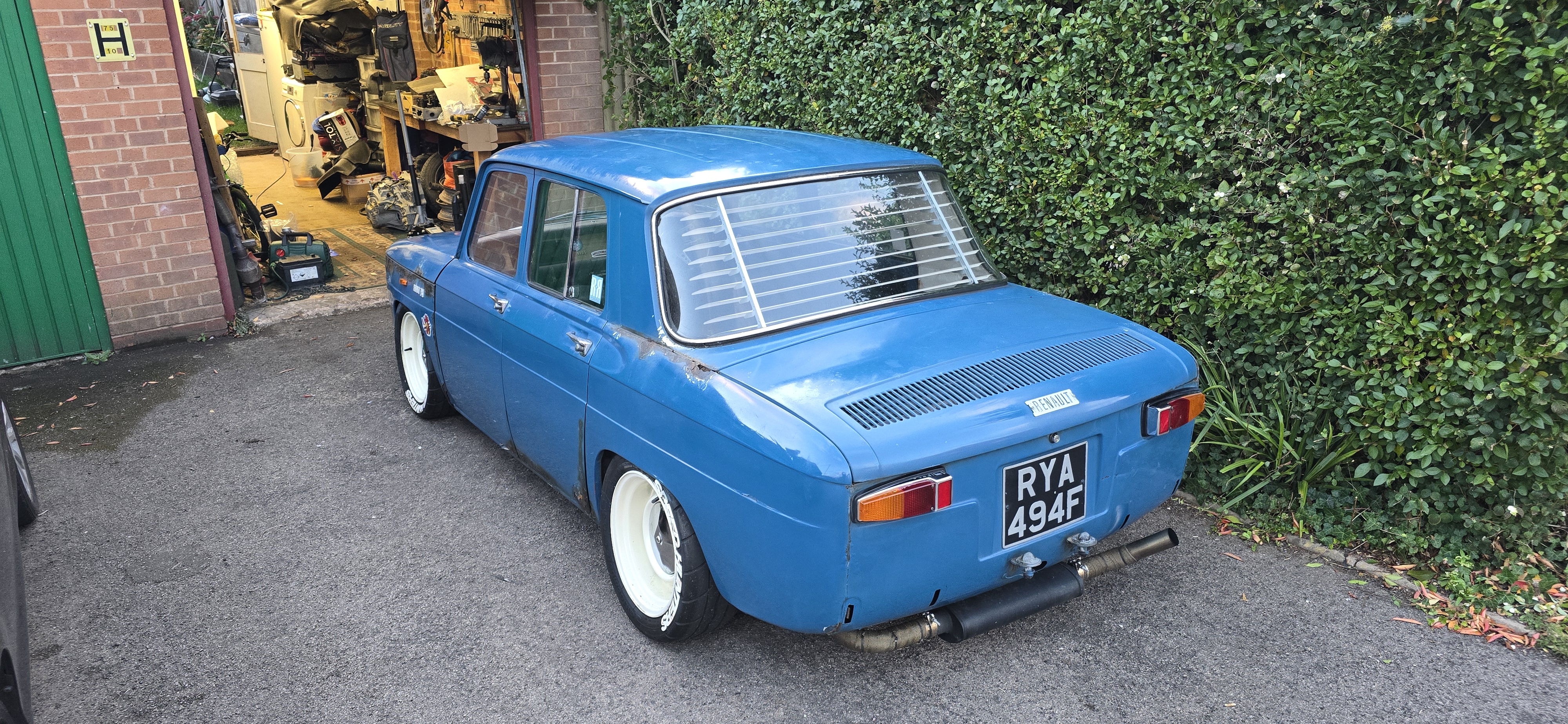

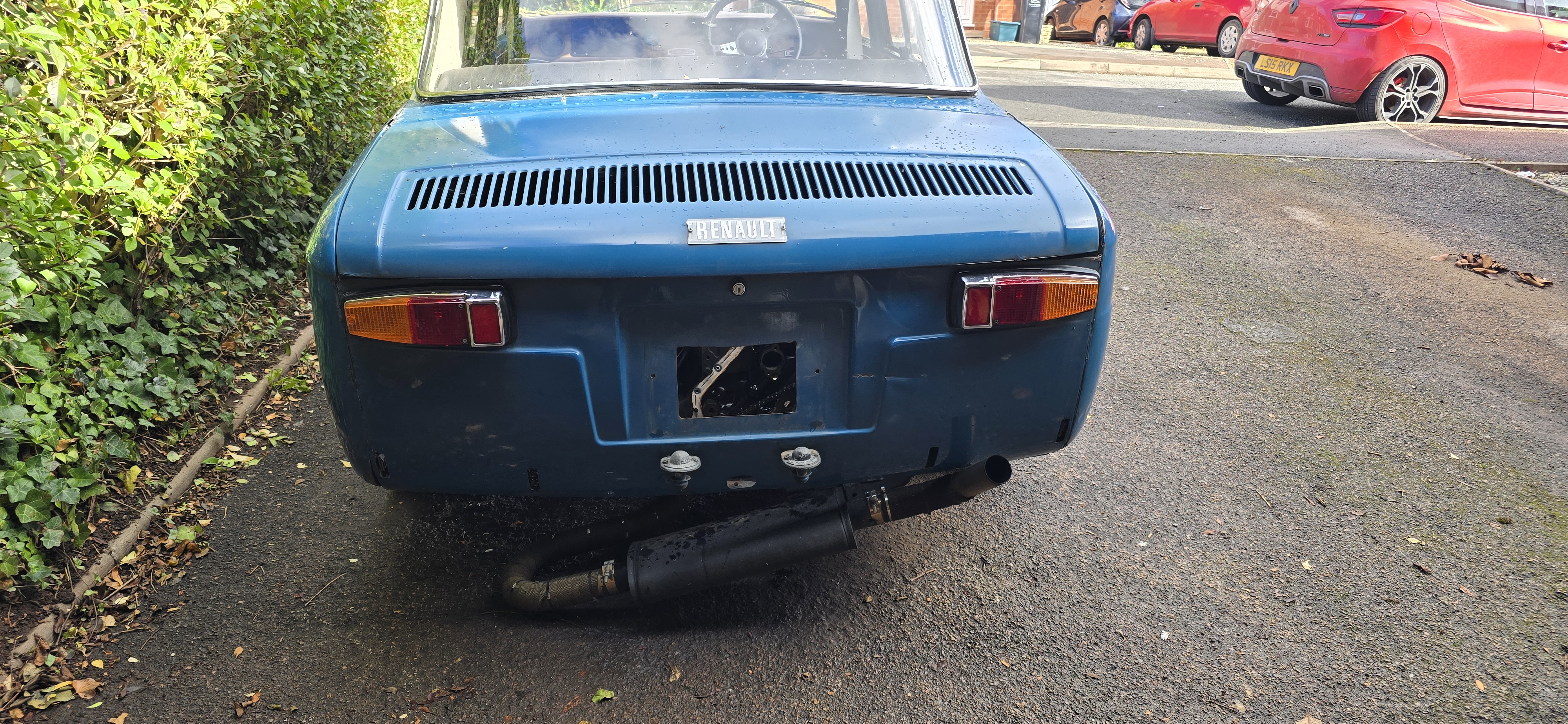

I'm currently recovering from a large parastomal hernia repair, it hasn't gone as well as it should but I'm still on the mend, just slower than expected. On the run up to having the op I decided it would be a good time to get some repair work done to the 8. Now underneath it isn't the worst but equally it isn't the best. From what I can tell the sills are actually pretty good but the floor pan where it has had water sat has gone through in a few places. Luckily for me, Jim, who made the turbo manifold for this is a very good with a welder. He has collected the car and taken it away to cut out and fabricate repair panels. The main ones I needed are NLA. Not looking for a factory fresh finish, its never going to be a pristine car in my ownership but solid safe and useable is what I want. Having it done now has stopped me from tinkering, much to the relief of my wife, forcing me into not doing anything whilst I heal, but this has left me with more time to shop.

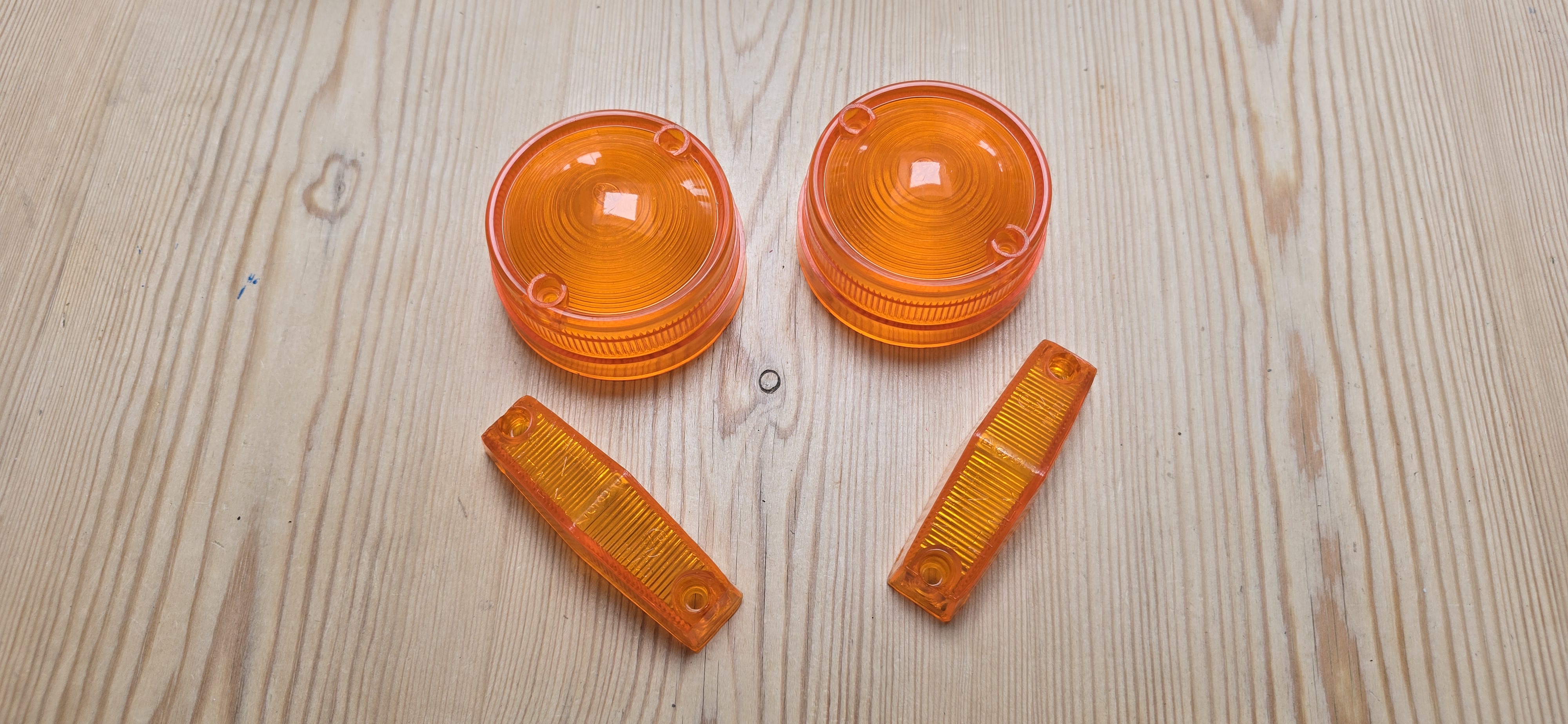

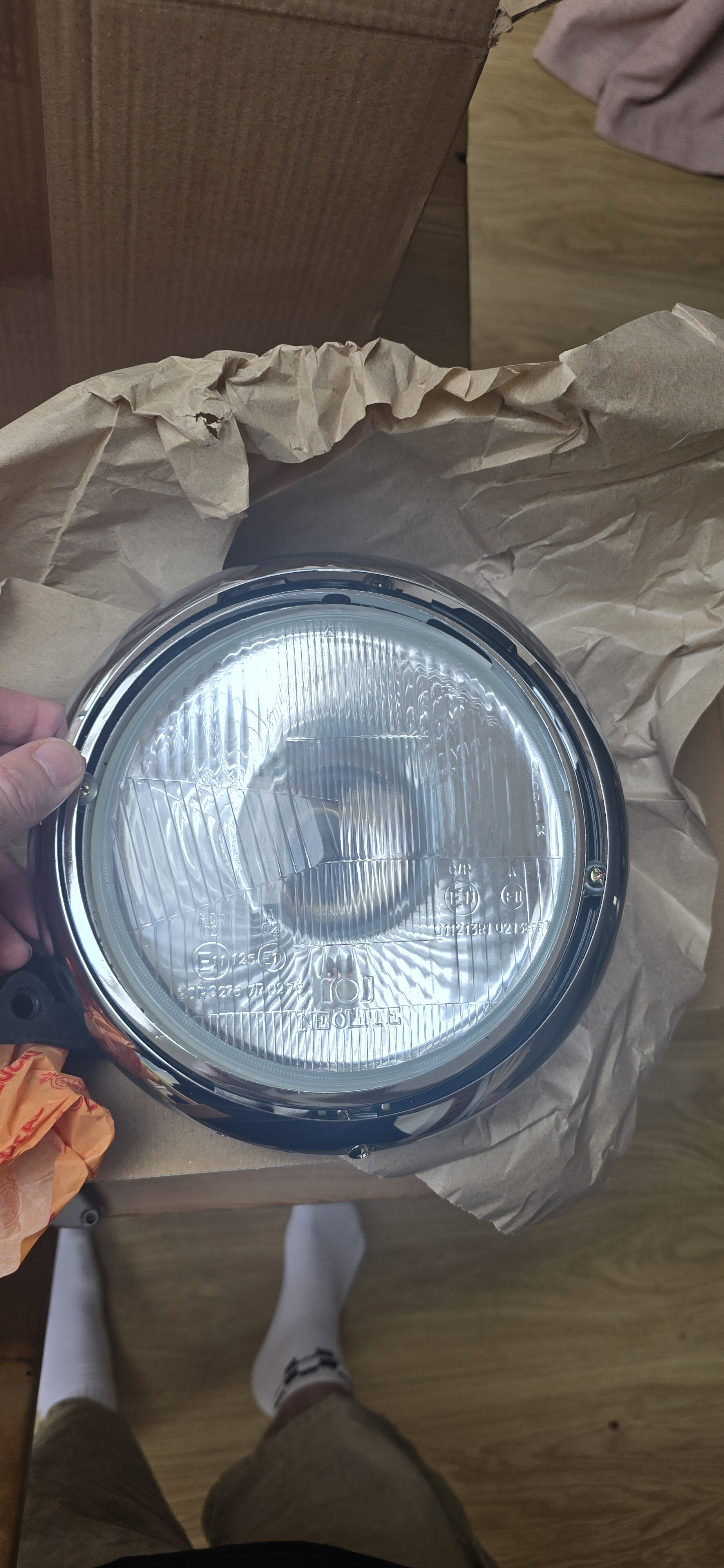

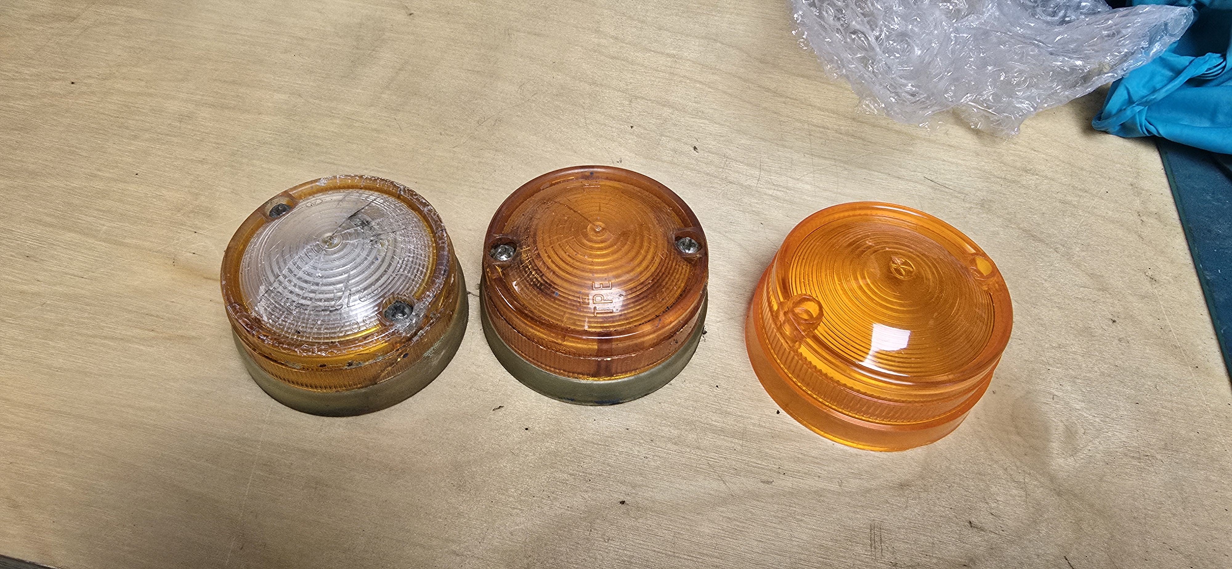

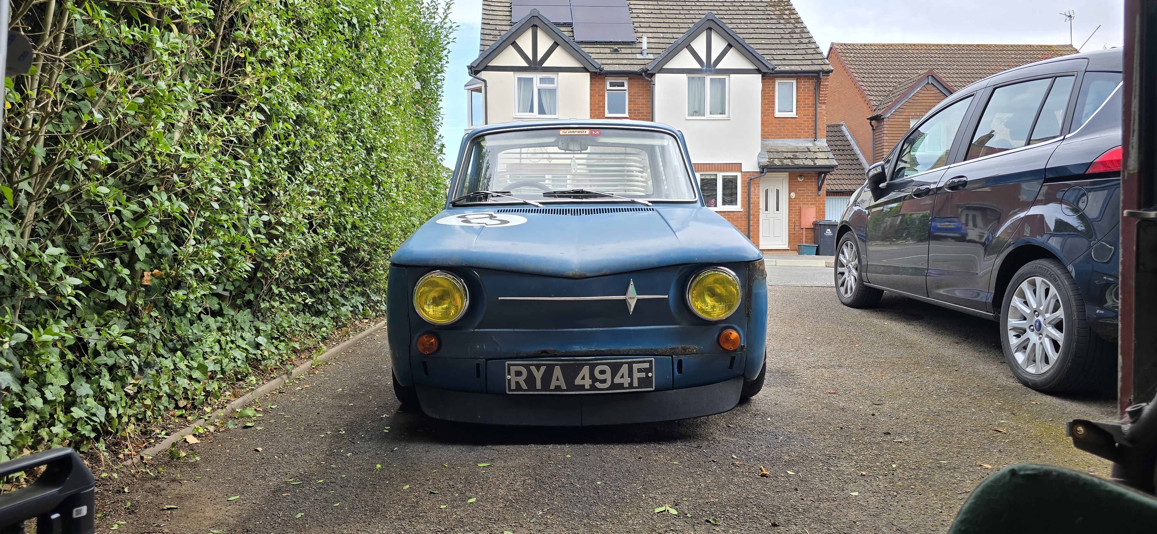

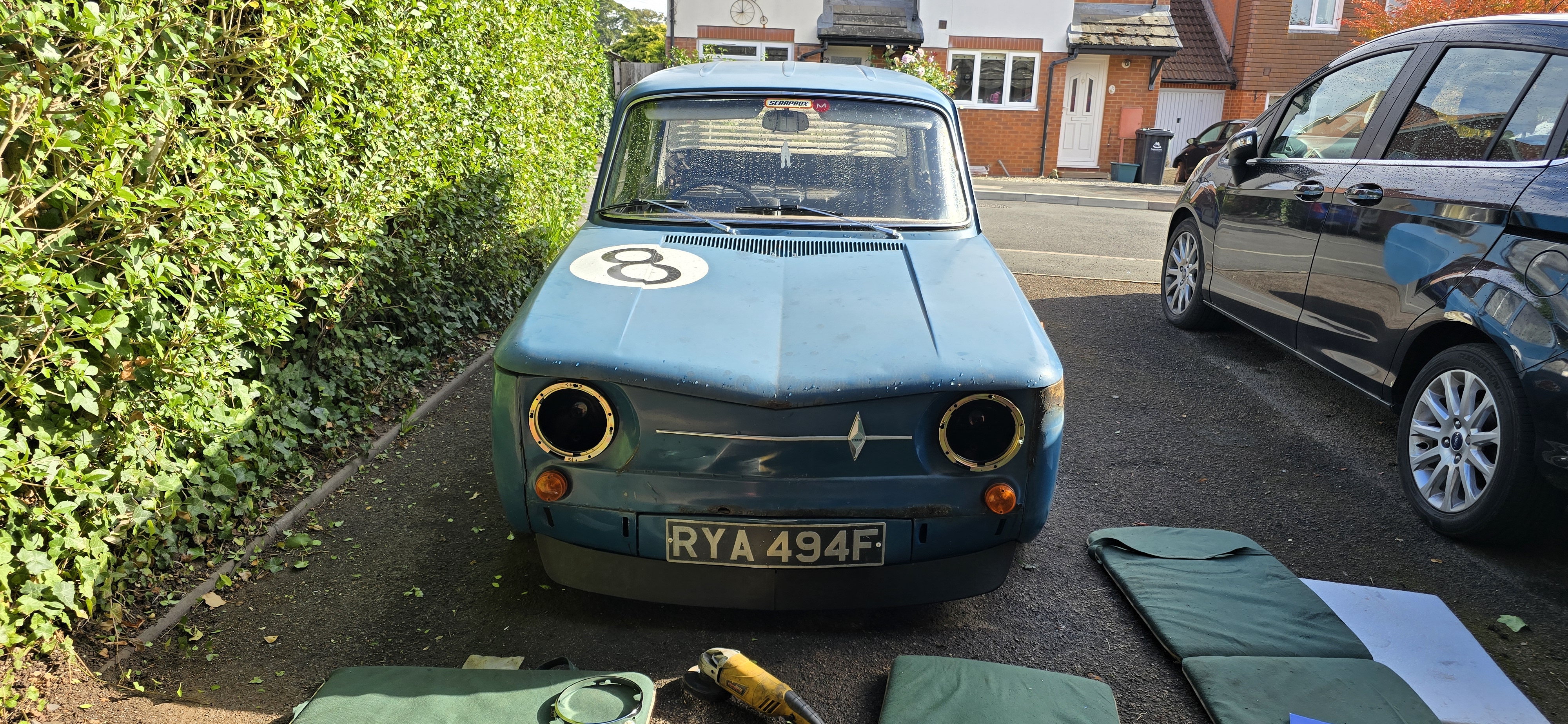

I ended up ordering indicator lenses for the front and side of the car, they are repros but look very fresh, I've also ordered some 180mm bowls from a mini/landrover, shiny rings and managed to find some flat lenses to suit. This should give the me "gordini" look headlights at a fraction of the cost of actual gordini units, and I'm not particularly fond of the convex lenses they have anyway. Looking forward to getting it back in a few weeks to get cracking again. Getting the structural work done will hit the wallet and may put the turbo conversion on the back burner for a little while....

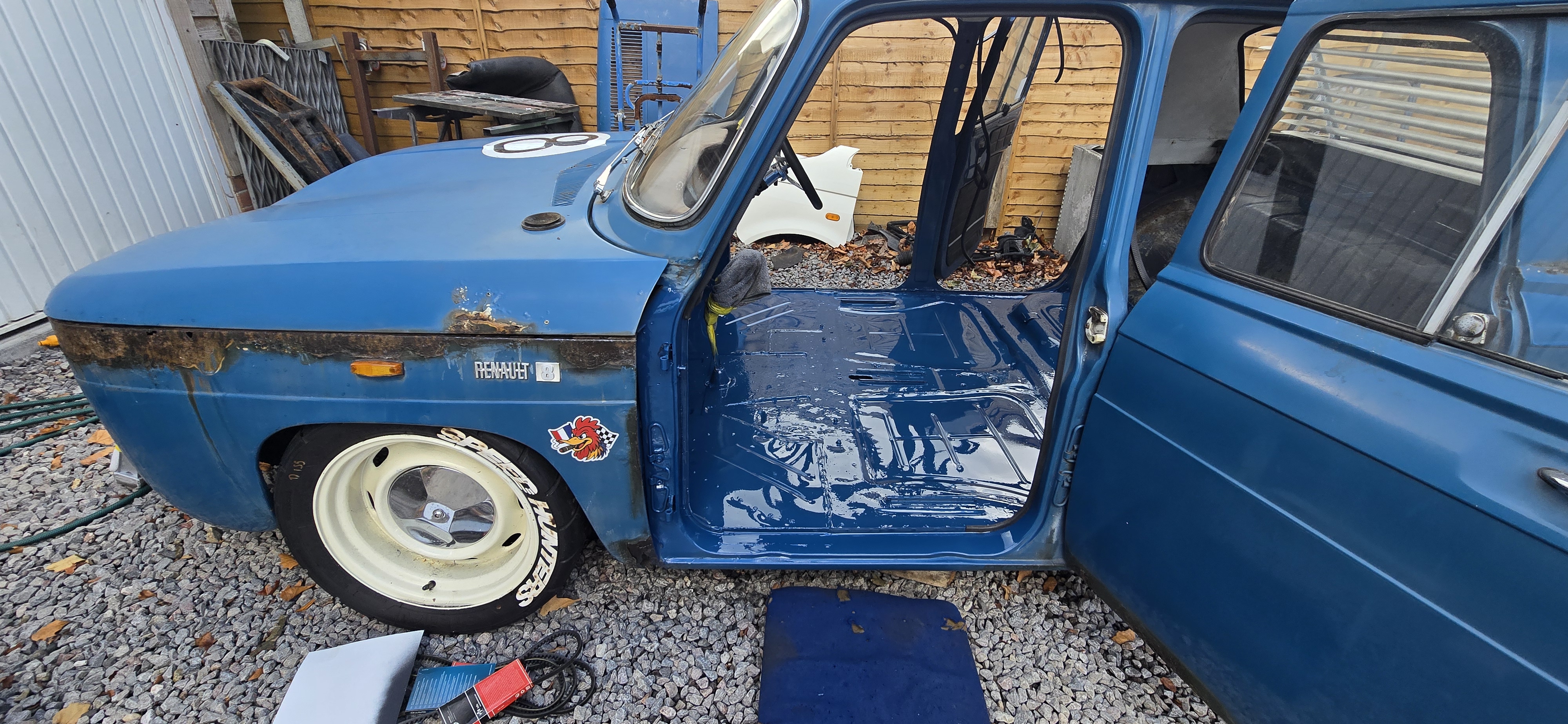

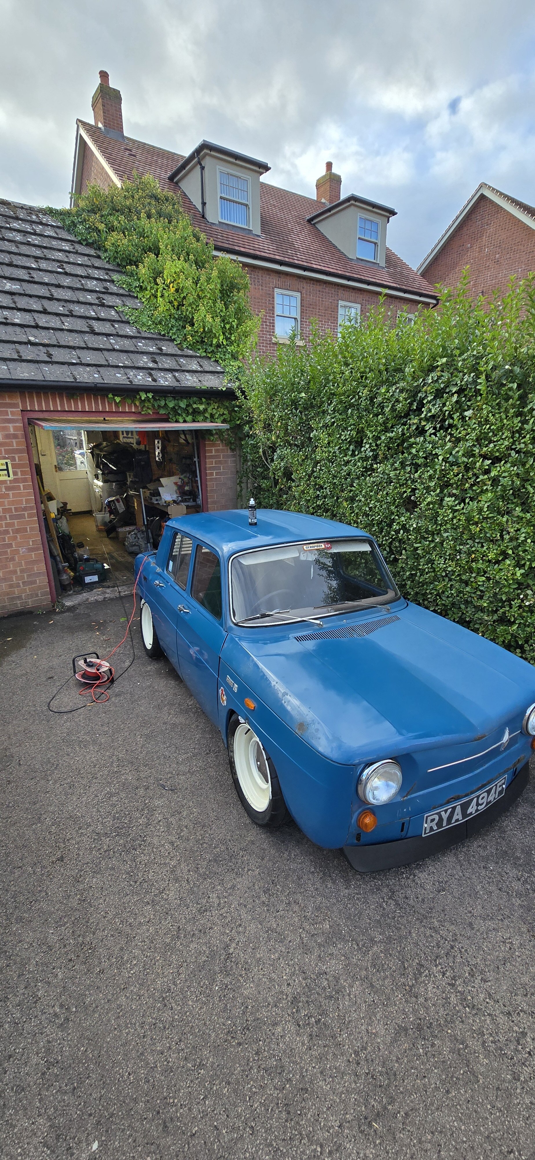

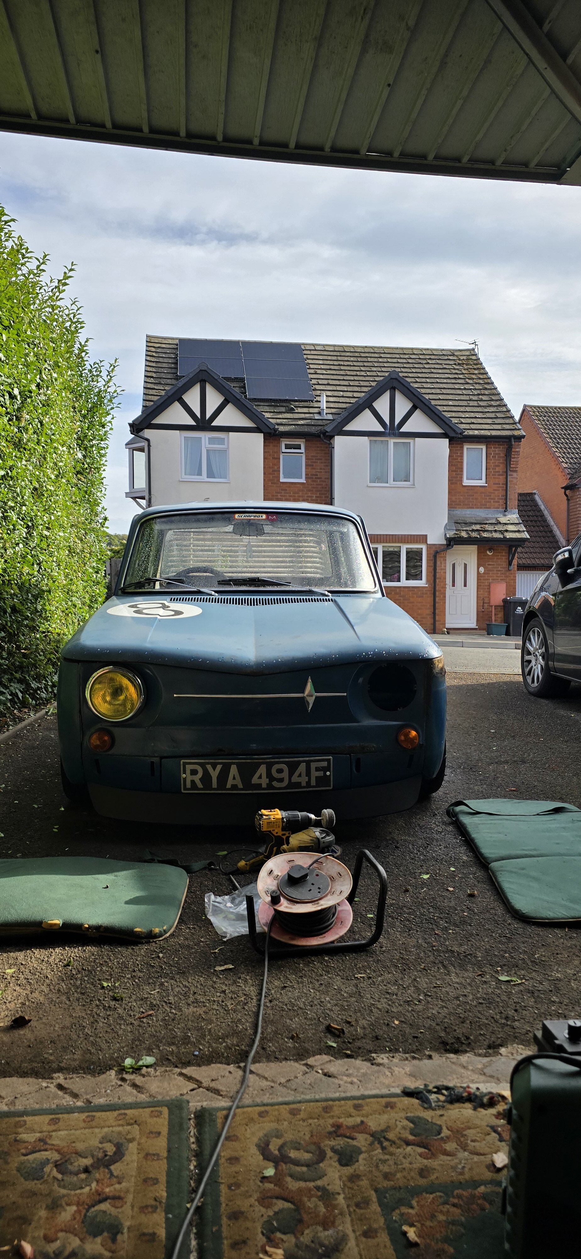

So after nearly 8 weeks away its back on the driveway. I've not started refitting the interior yet but have cracked on with the headlights and indicators. I did originally put yellow tint on the new larger units but decided to remove them as I did a curse word job at the edges. Cars looking boggley now as its had small headlights, Defo like the new larger units though. The new headlights and indicators giving it a fresher look in contrast to the rest of the body work. Defo needs a good clean though, the outside is properly dirty.

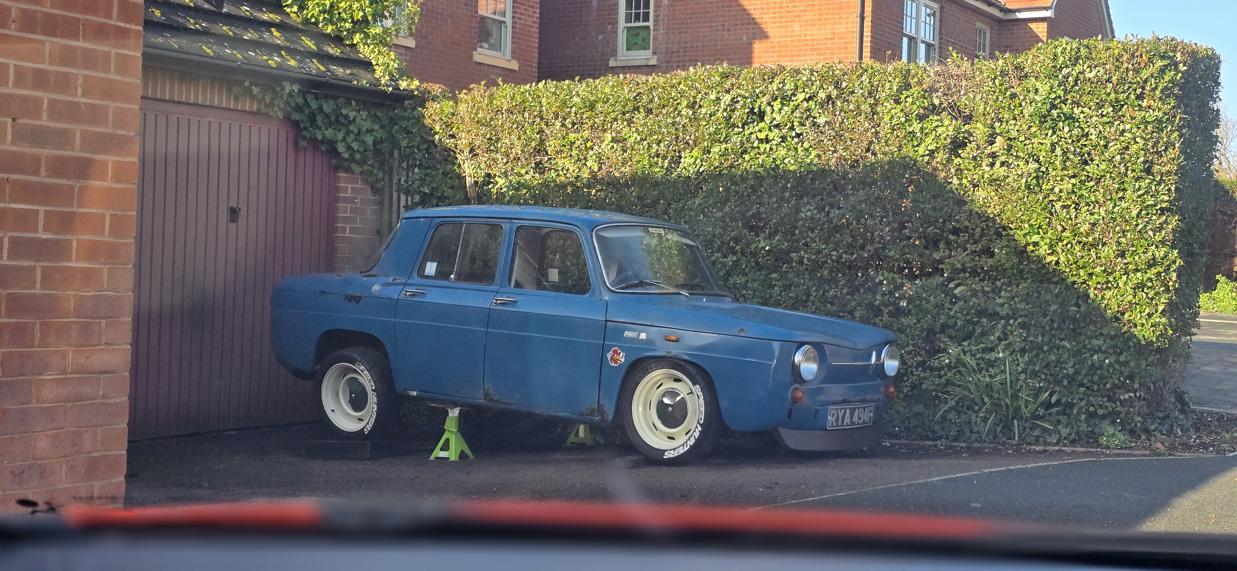

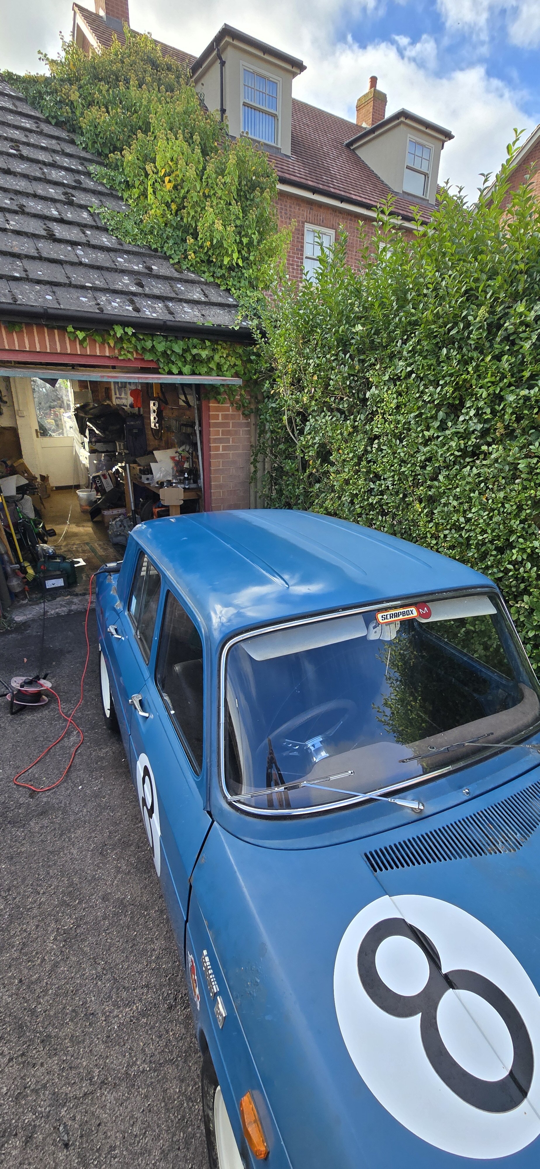

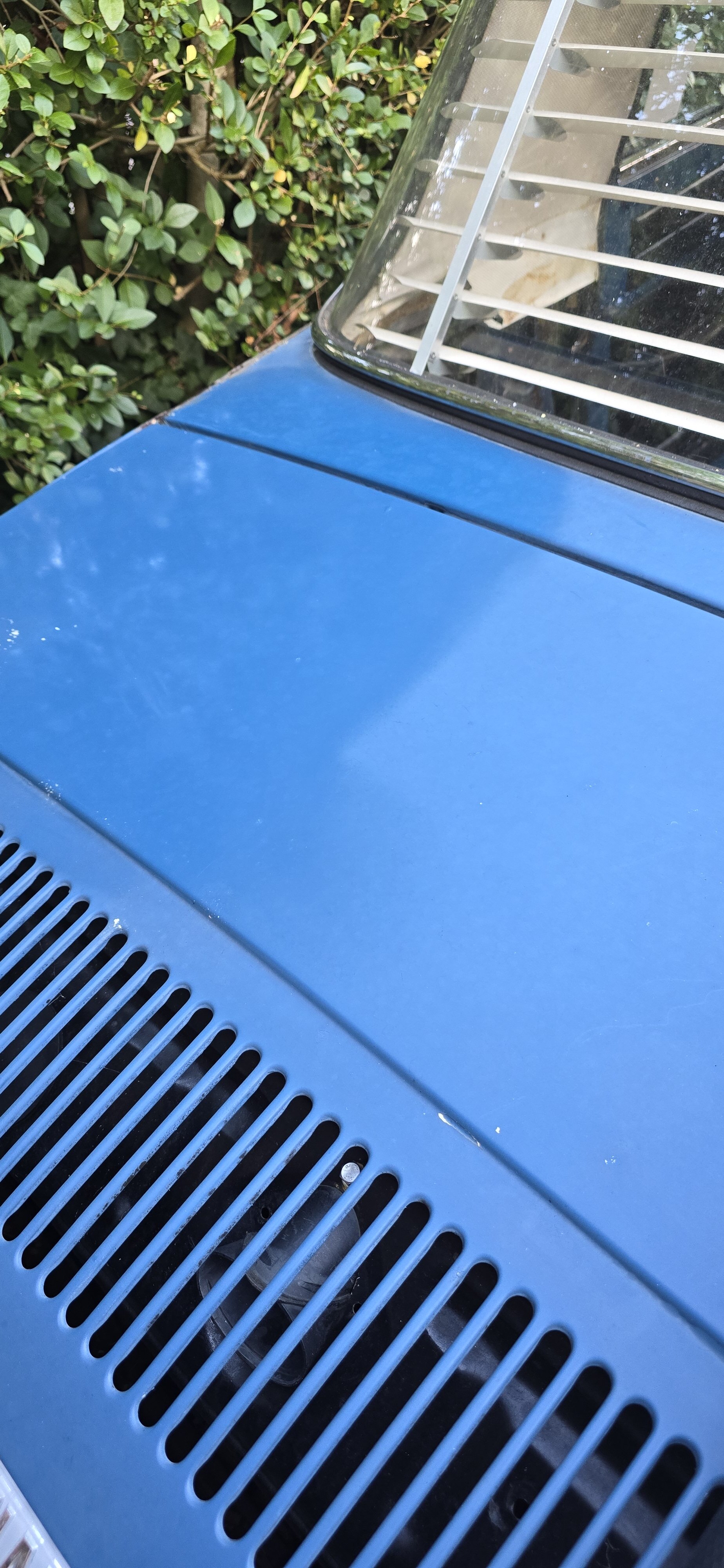

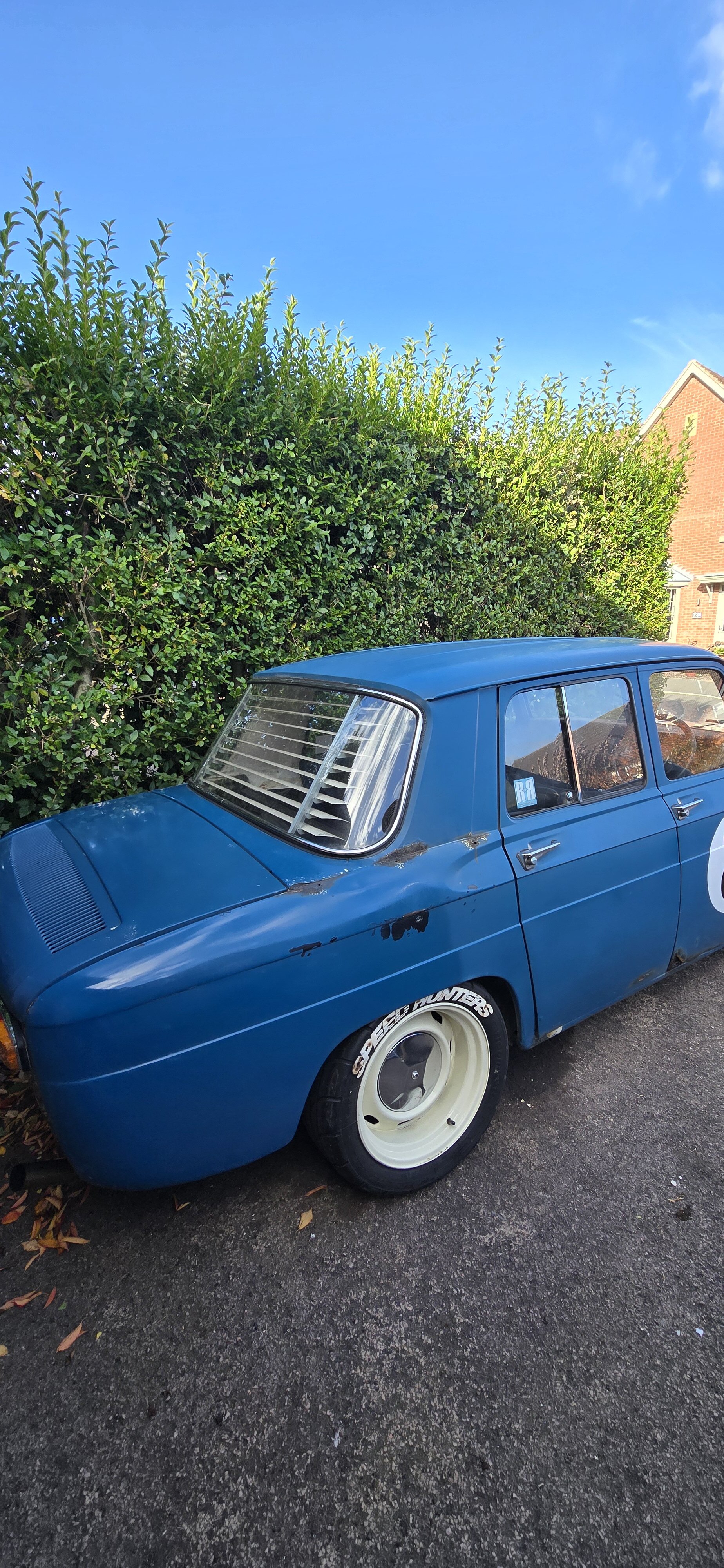

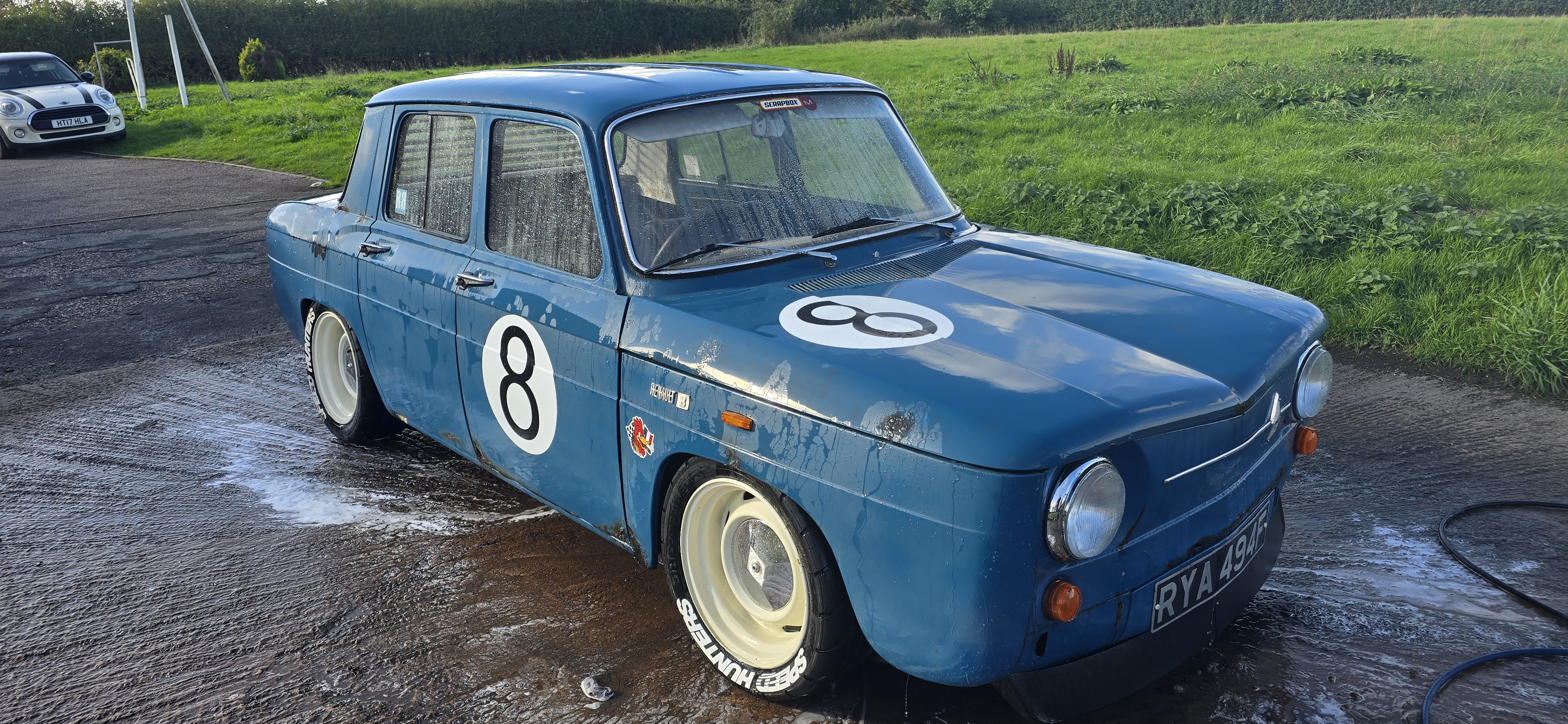

I didn't realise how faded the paint work was, it has been way too long since I've cleaned it. Started with a rinse off at the local car wash then busted out the polisher. Comes up well considering the age, need to get something on there to try and keep it looking like that for longer, any suggestions or tips?
wash at the local garage as I couldn't be arsed to get the pressure washer and the rest of the kit out and setup
Started on the boot lid then worked my way around
then whipped off the roundels and carried on with the rest of it.
inside is full of dust still and all the glass needs a going over so i will try and get that done tomorrow

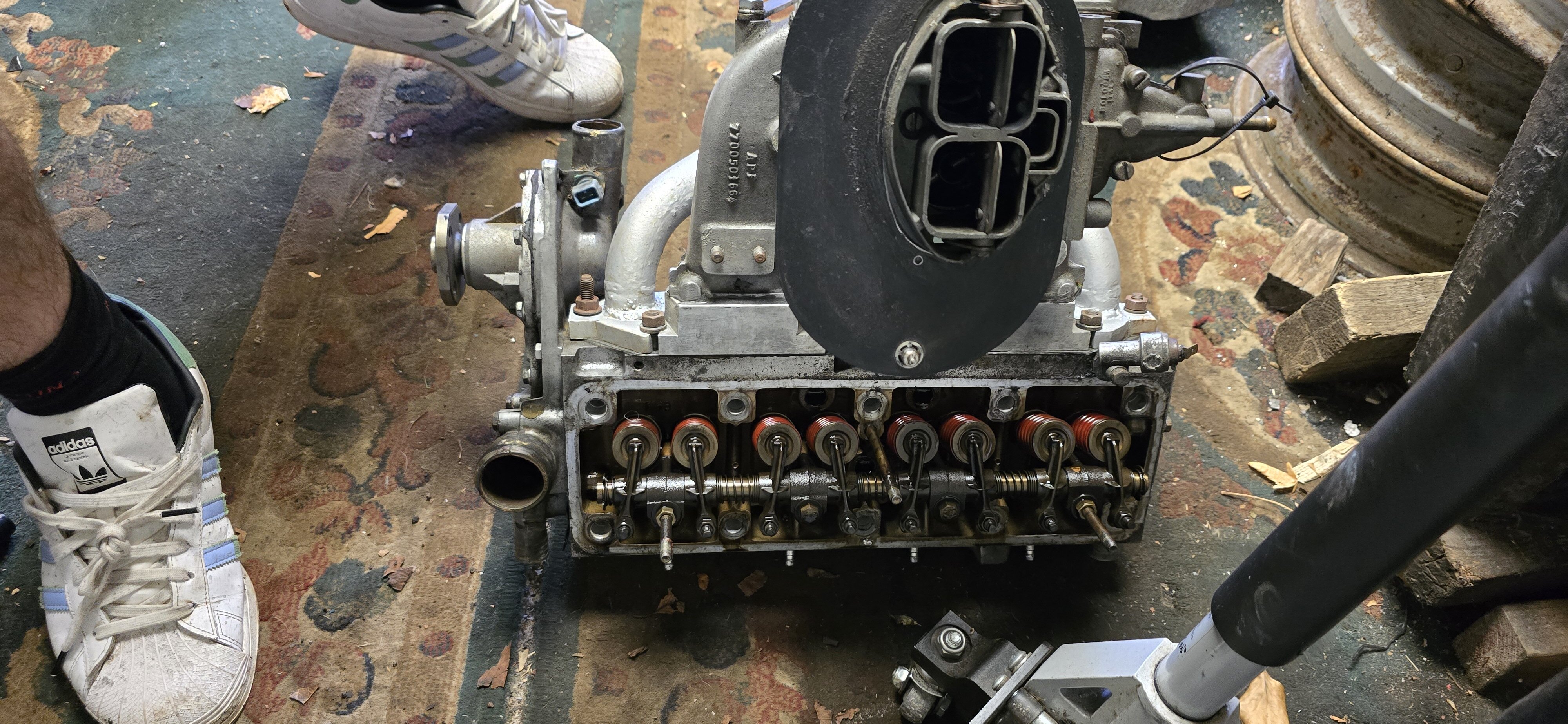

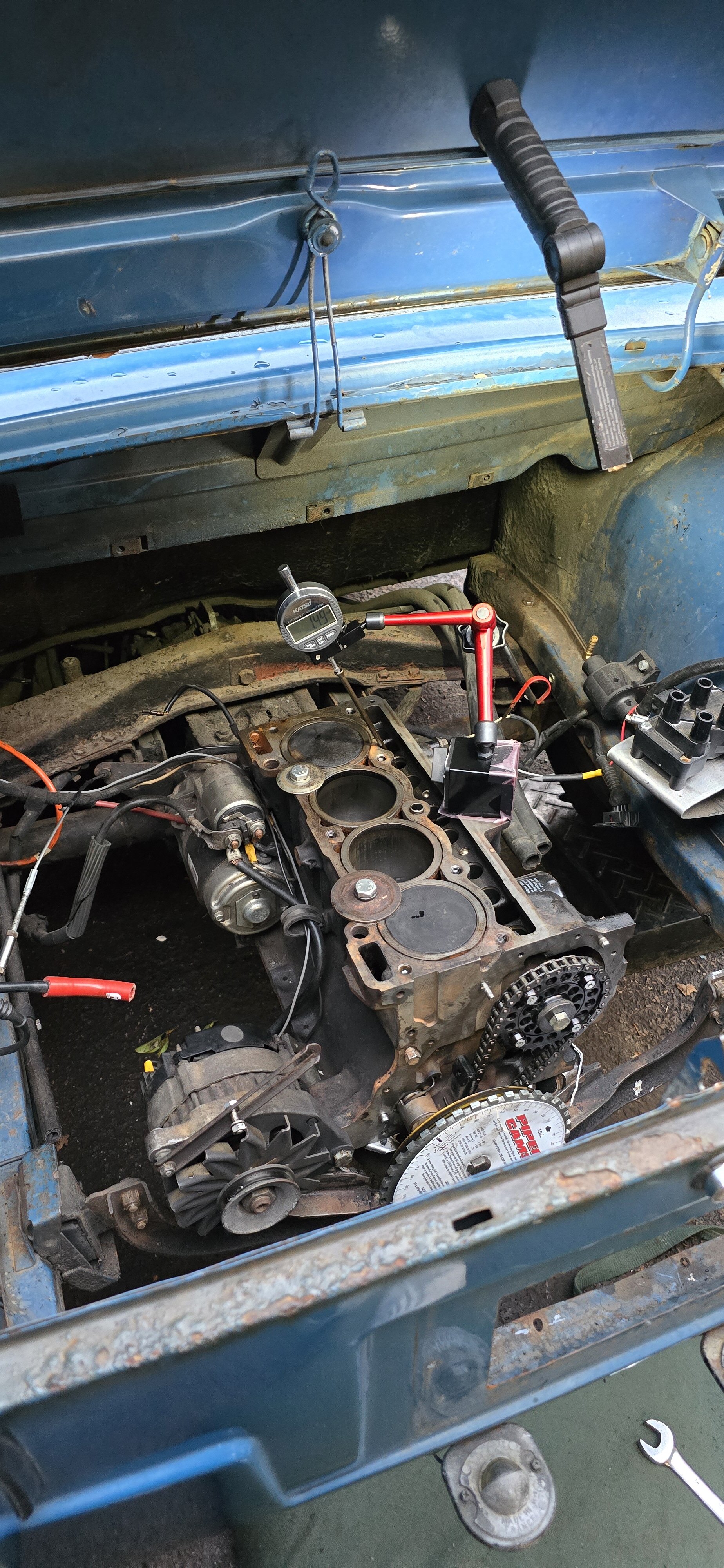

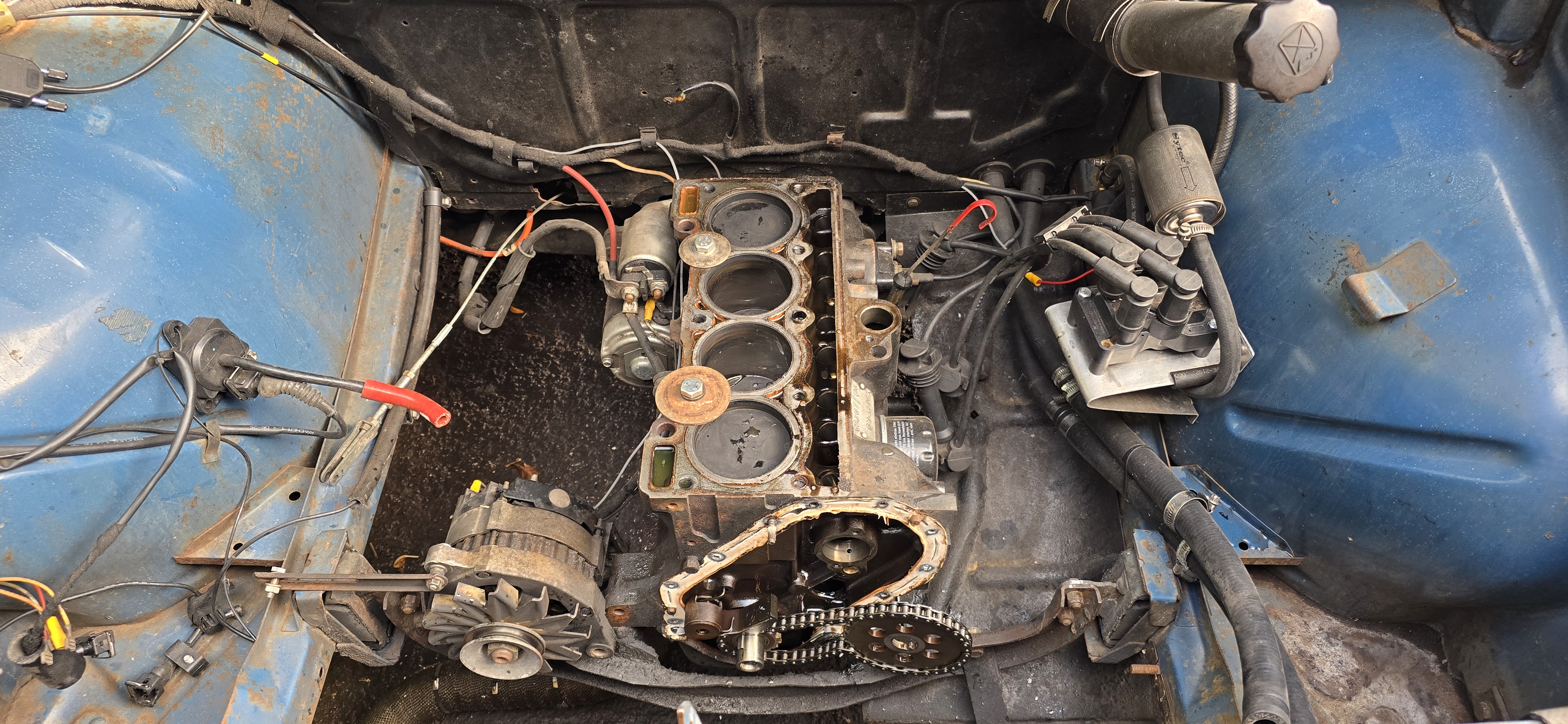

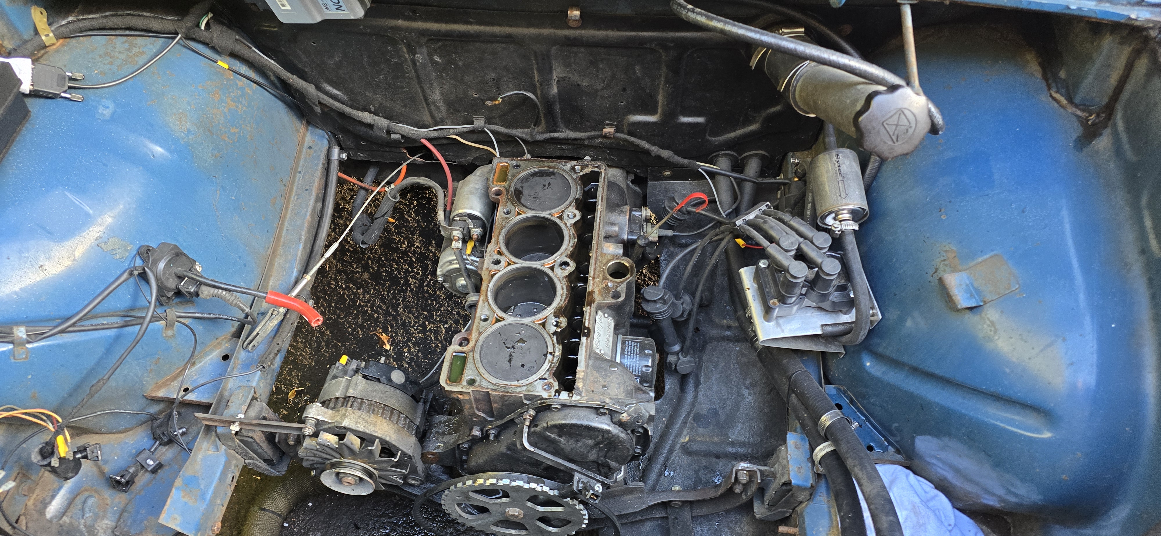

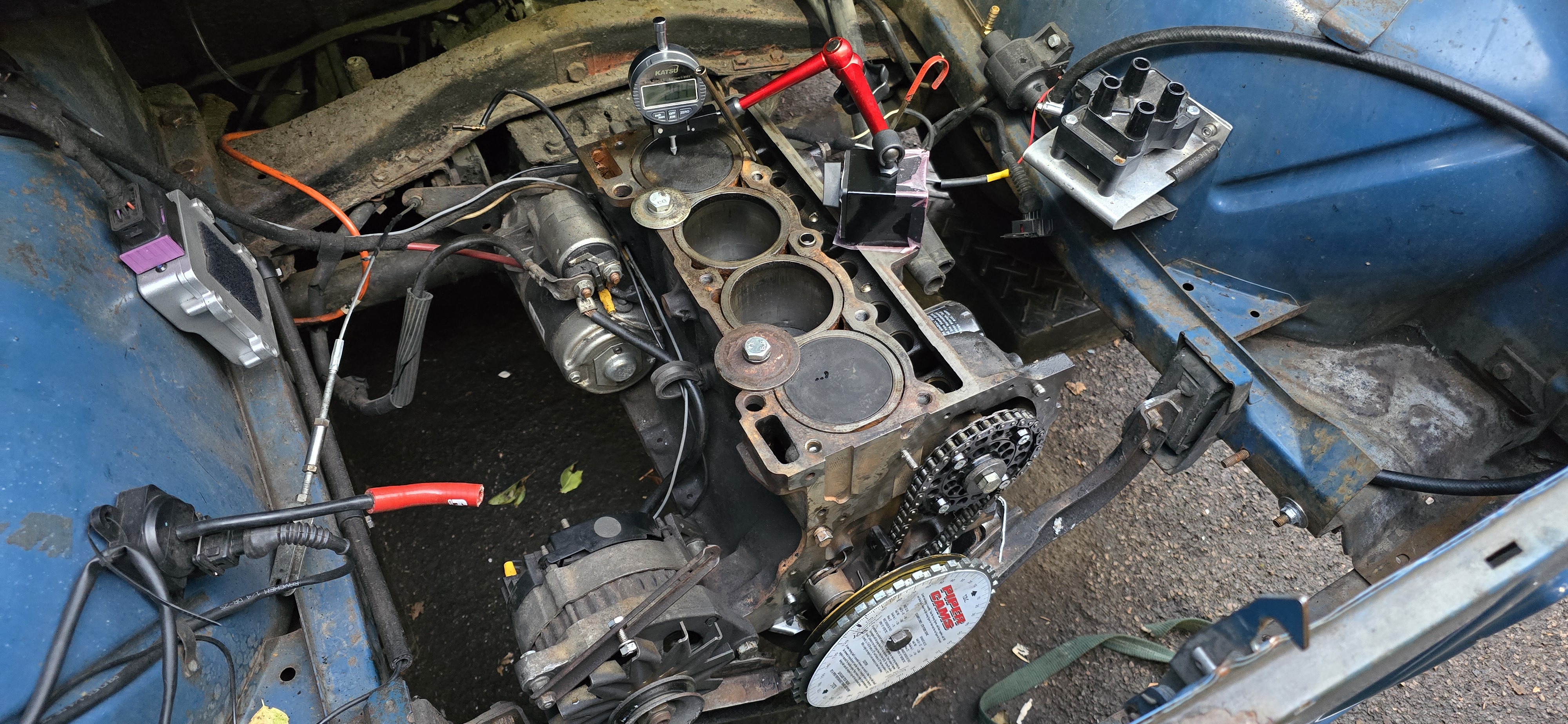

After some chatting to sparkie ref N/A tuning the 1397 I contacted piper cams and asked for a custom grind camshaft. A little back and forth and they have one on grind for me (y) So off with the head and I whipped out the old cam ready for the new one. Cam is a 288 degree with a shave over 10.5mm of lift on both the inlet and exhaust. Along with that I've ordered uprated springs, a vernier pully and the rocker assembly from a gt turbo. The campus engine doesn't have end supports on the rockers, so have added this due to the increased load there will be with the stiffer springs and higher lift (plus revs)

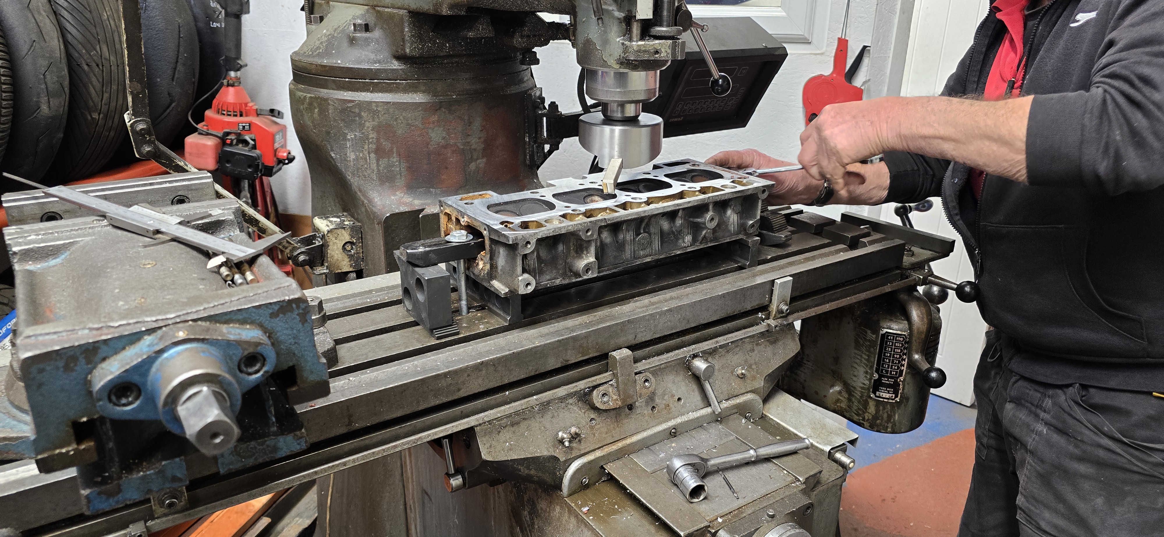

I popped a message to another mate of mine as I needed to remove a chunk of material from the head to bump the compression ratio, Saturday afternoon was spent at his workshop chopping it off on the bridgeport (y) I need to clean up the other mating faces next and reassemble it when parts arrive, I could go nuts still and add in headwork and bigger valves but the whole point of this is to add a little more spice without going fully nuts, or I would just end up in the same position I would with doing a turbo build.

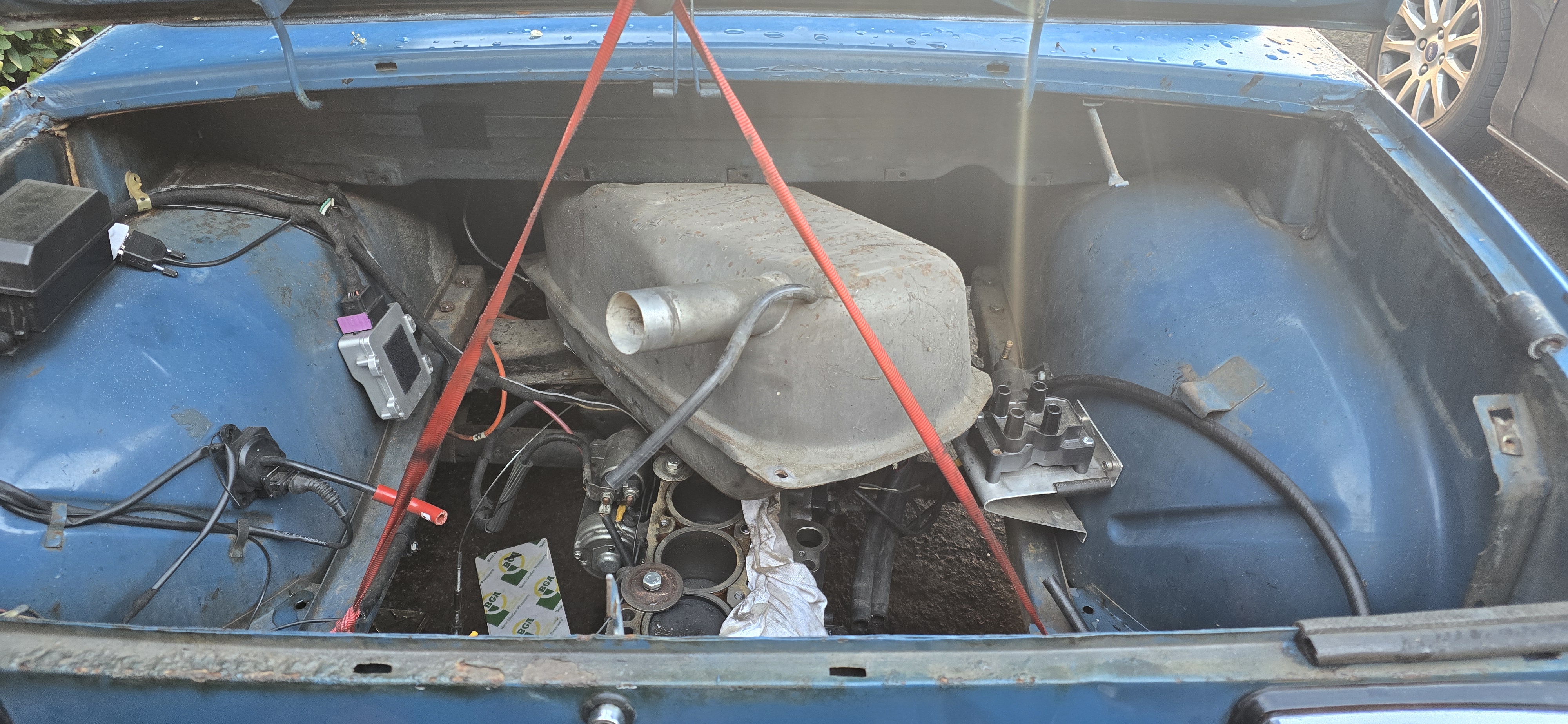

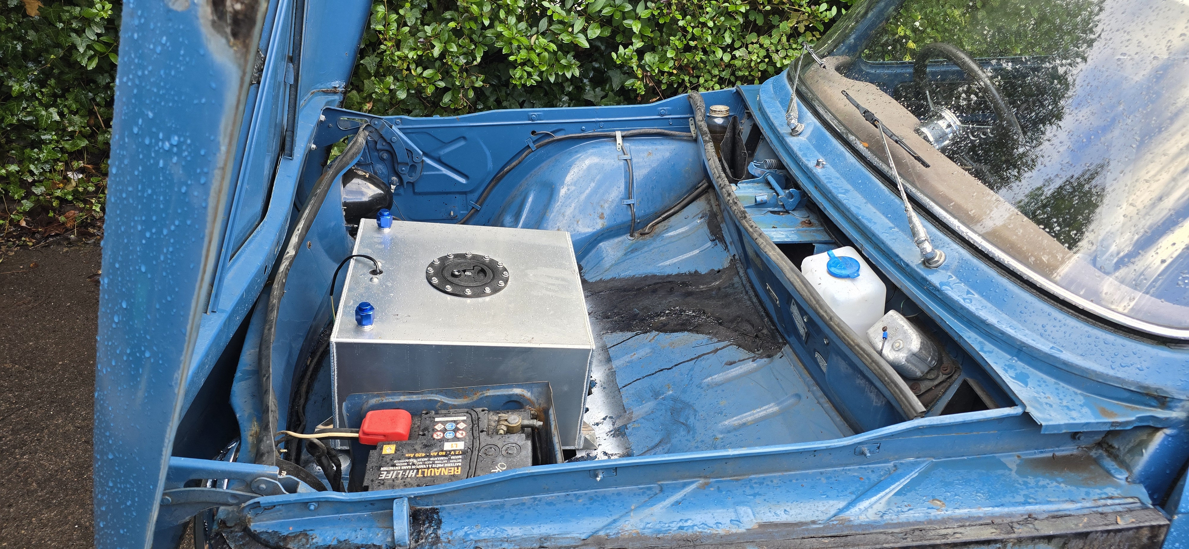

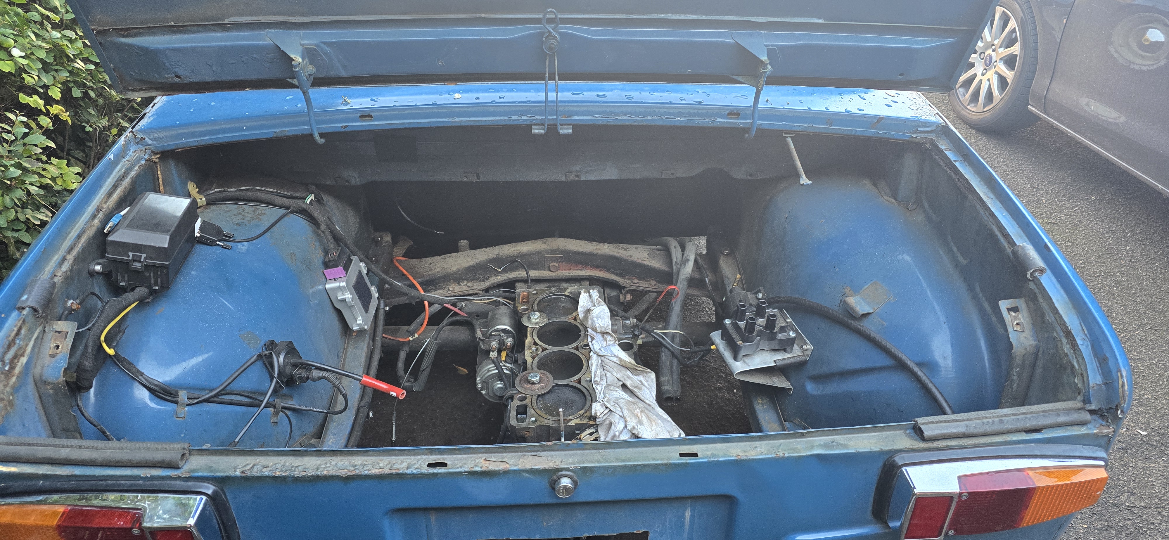

And I have found my new favourite job on an 8..... fuel tank removal. Im sure the Haynes manual told me I need to drop the axle and engine only 2 inches. Yeah I needed alot more than that and I have no head on the block. With some assistance from the wife and kids the fuel tank has now been removed. I can confirm my araldite/Guinness can/duct tape fix on the tank has held firm and shows no sign of letting go. Should have just left the thing in there 😂😅😭
Bags of space now
Super quick service from the guys/girls at piper. Turned up this afternoon so spent some time this evening getting it bob on. Ive left the timing cover off for now. Next up will fitting the valve springs, followed by a test fit of the head, checking for piston to valve contact and making sure the springs dont go coil bound. All being well ive not messed it up, it only needed slight adjustment on the pulley 🤞🏻
And we are in and running! Fuel from a jerry can but I wanted to get it fired up and revved to get the cam bed in and allow it too cool overnight. I can do the retorque of the head and reset the tappets tomorrow along with a oil and filter change.
little tappy and idle is struggling, love that it sounds almost like a rotary when at rest 😍 hopefully it'll be quieter after resetting everything. Will likely need to get the base settings on the ecu adjusted as the trigger wheel is probably off from where it was.
This morning I gave the head a retorque and reset the tappets to pipers values 0.25 inlet and 0.30 exhaust (bit big?). Adjusted the base timing a little on the ECU as the 36-1 is back on in a slightly different place. Ecu has plenty of adjustment though so all is good. Fresh oil and filter on to help flush it just in case, will get some decent stuff ordered up. Comp check is showing 11.5bar on every cylinder (cant remember what it was before, but all equal) idle is lopey, sounds like a cammed up V8! though a little tappy, the camera makes it sound louder than it is in person. Next up is fuel tank mounting and it'll be ready for mapping again (y)
Some oil and coolant on the way from opie, base timing rechecked and adjusted and car running sweeter again. Fuel tank mounted and im now waiting on delivery of a few fittings and some fuel pipe. struggling to get heat into It, unsure if the thermostat is faulty so may need to replace that too. Hopefully that all arrives this week as mapping is booked for Tuesday next week, roll on 80+hp 😆

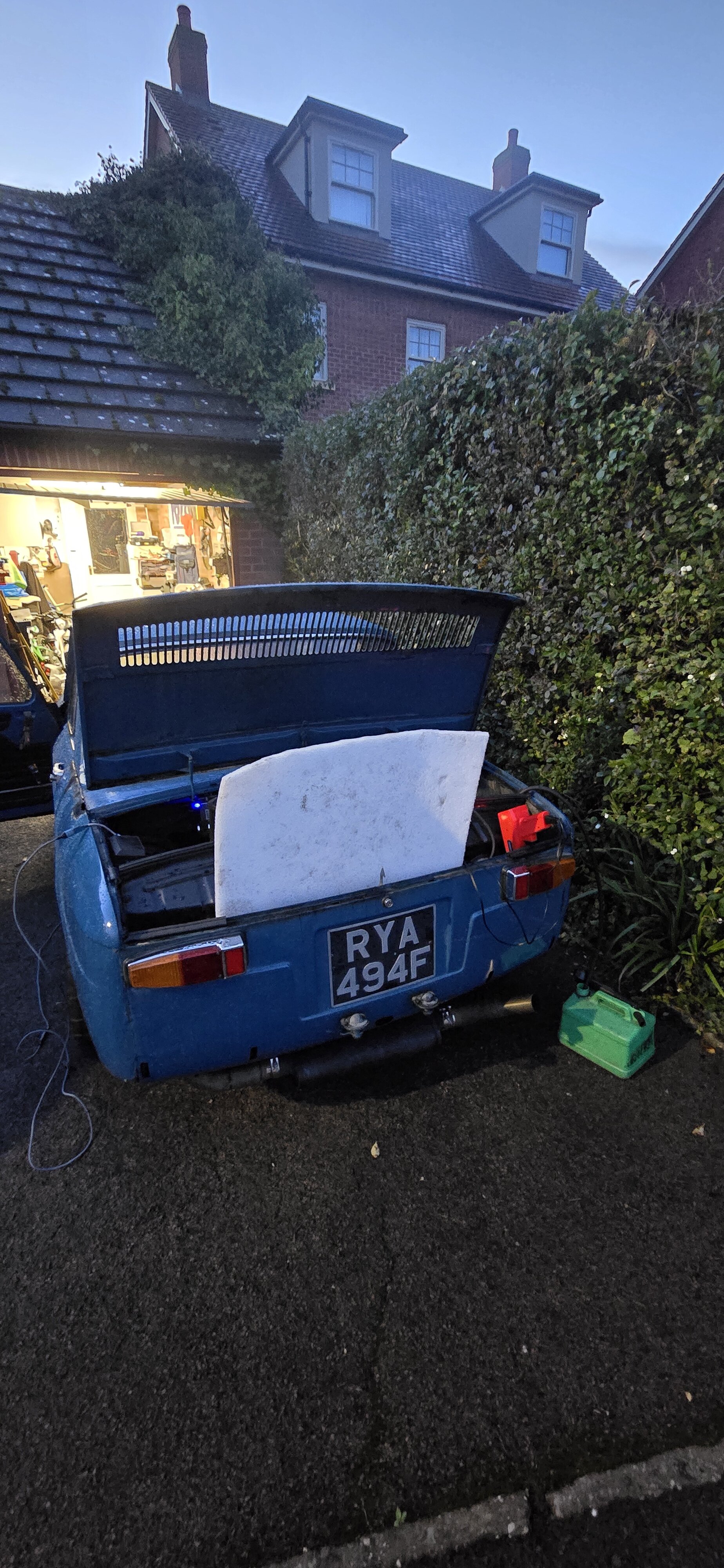

Todays job was to get the fuel line in, ran it along with the heater matrix hoses but will likely replace with some hard line in the future. Rain was coming down hard, wind blowing and the light dimming fast made it very fun to do. Only had about 2ltrs of fuel to test the tank with so Ill grab the jerry can full on the way home tomorrow. Pump primed fine and the car ran with what was there (y) Just another oil change and the coolant to flush left to do, a few gentle test miles and it should be good for mapping (y)

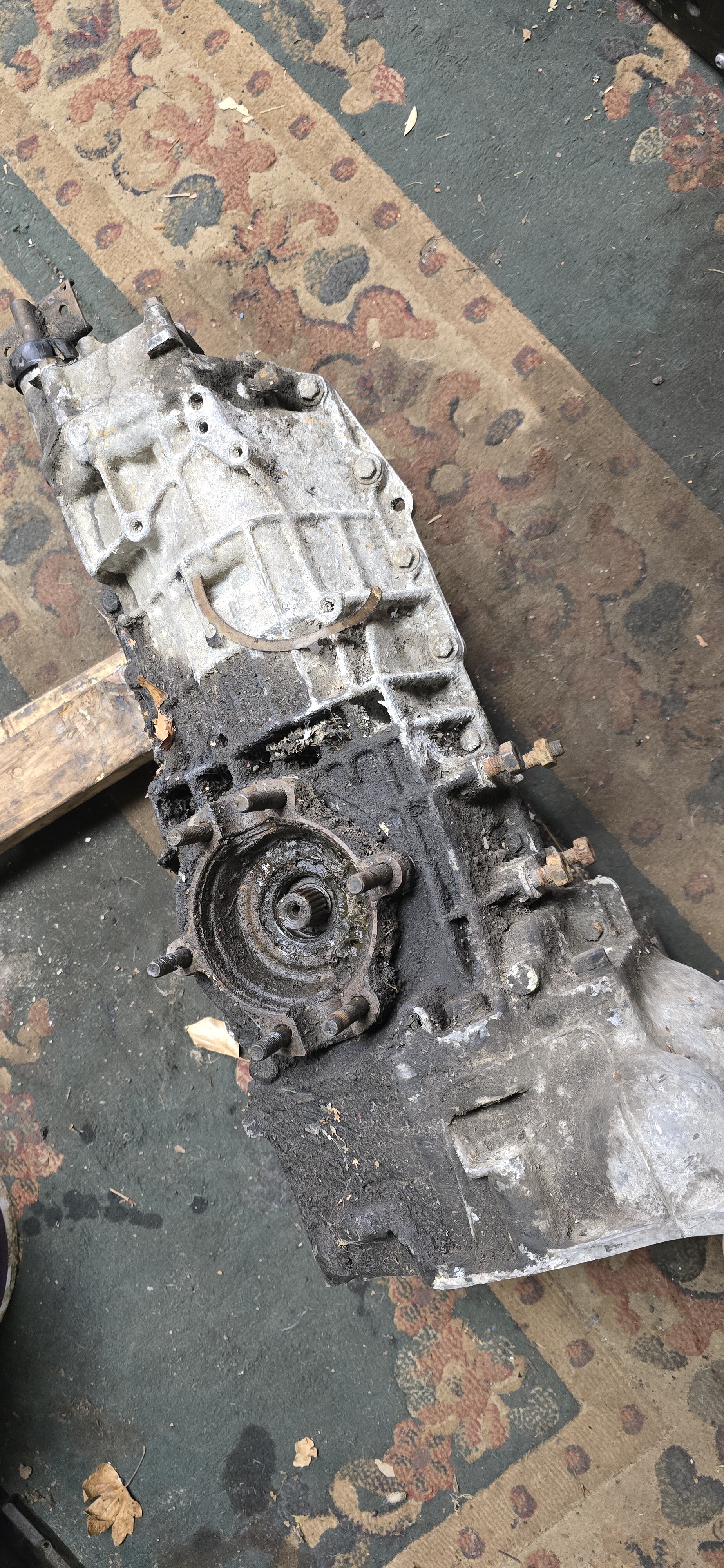

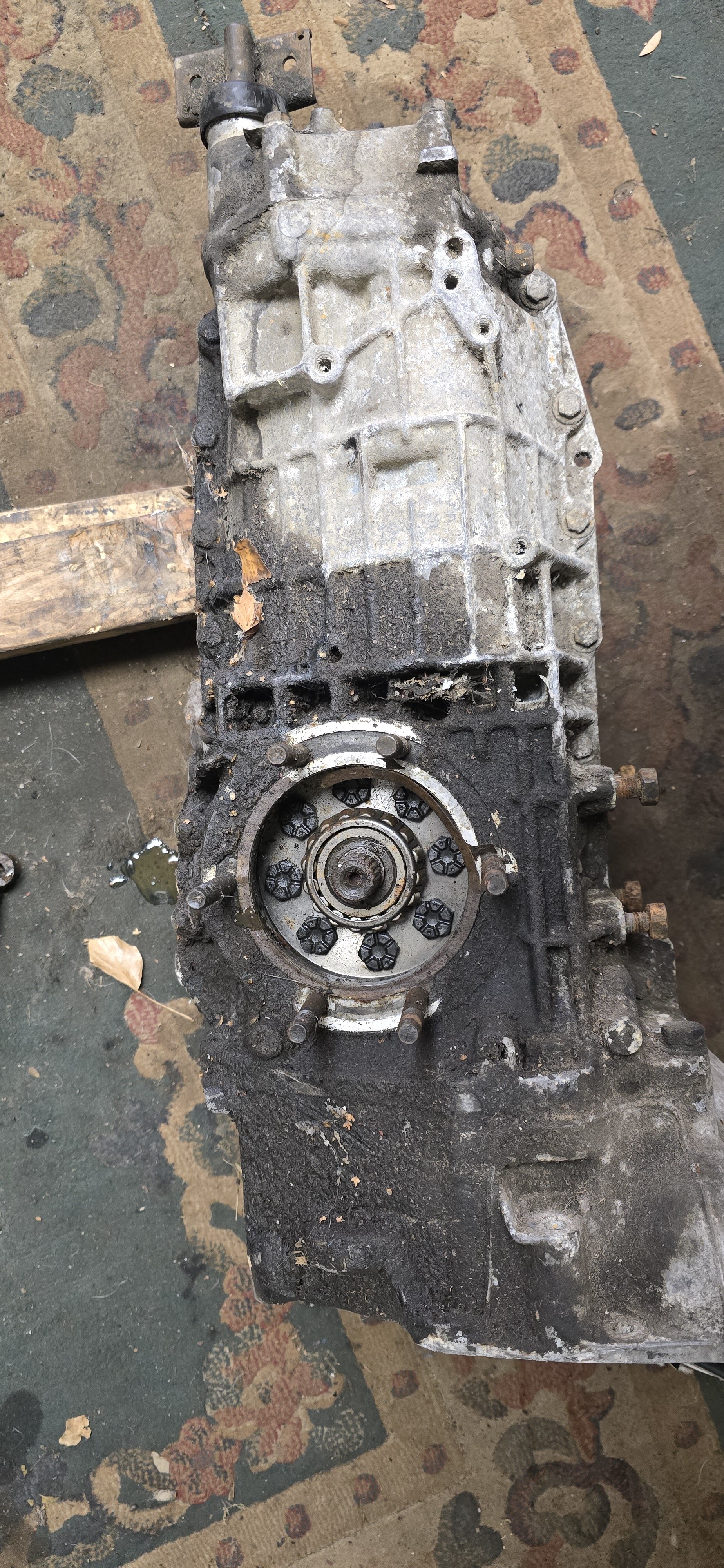

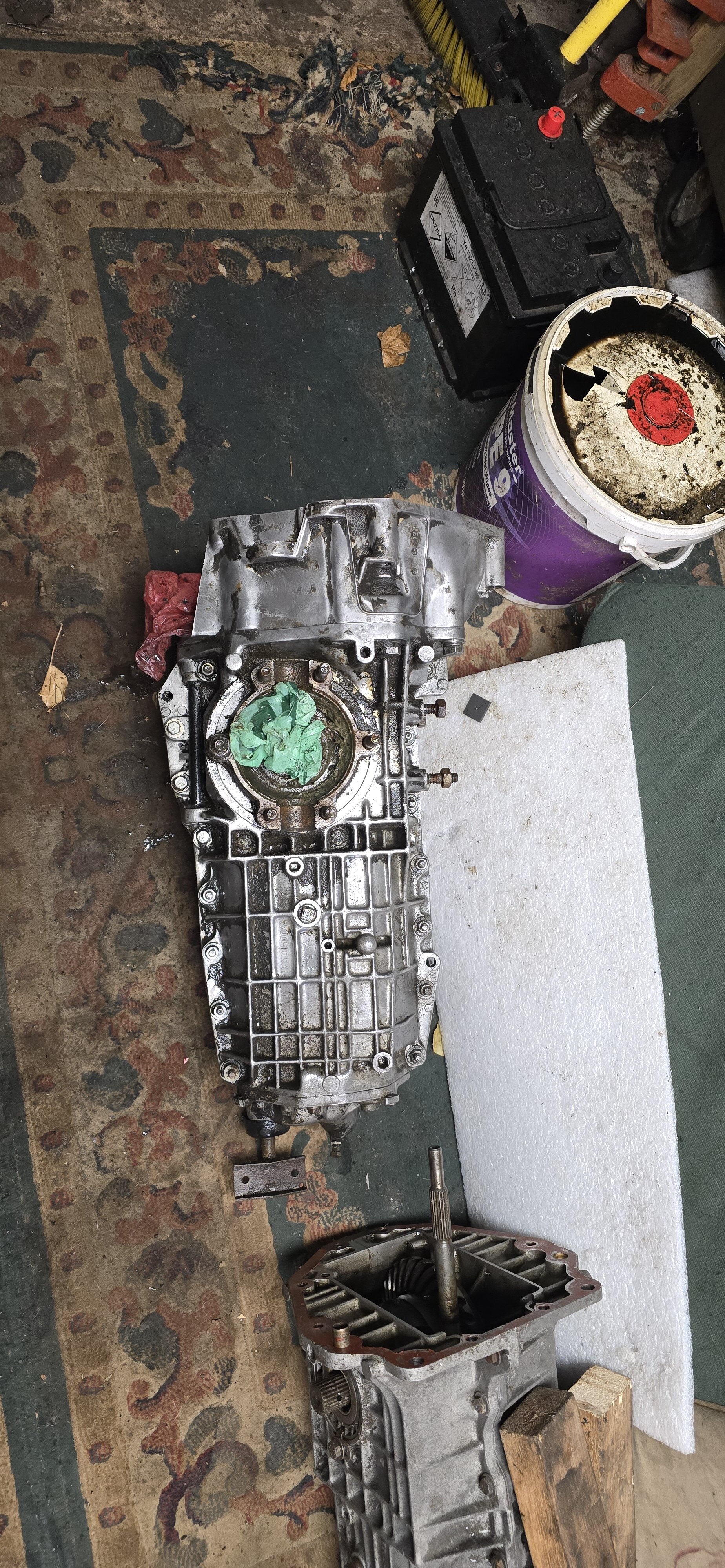

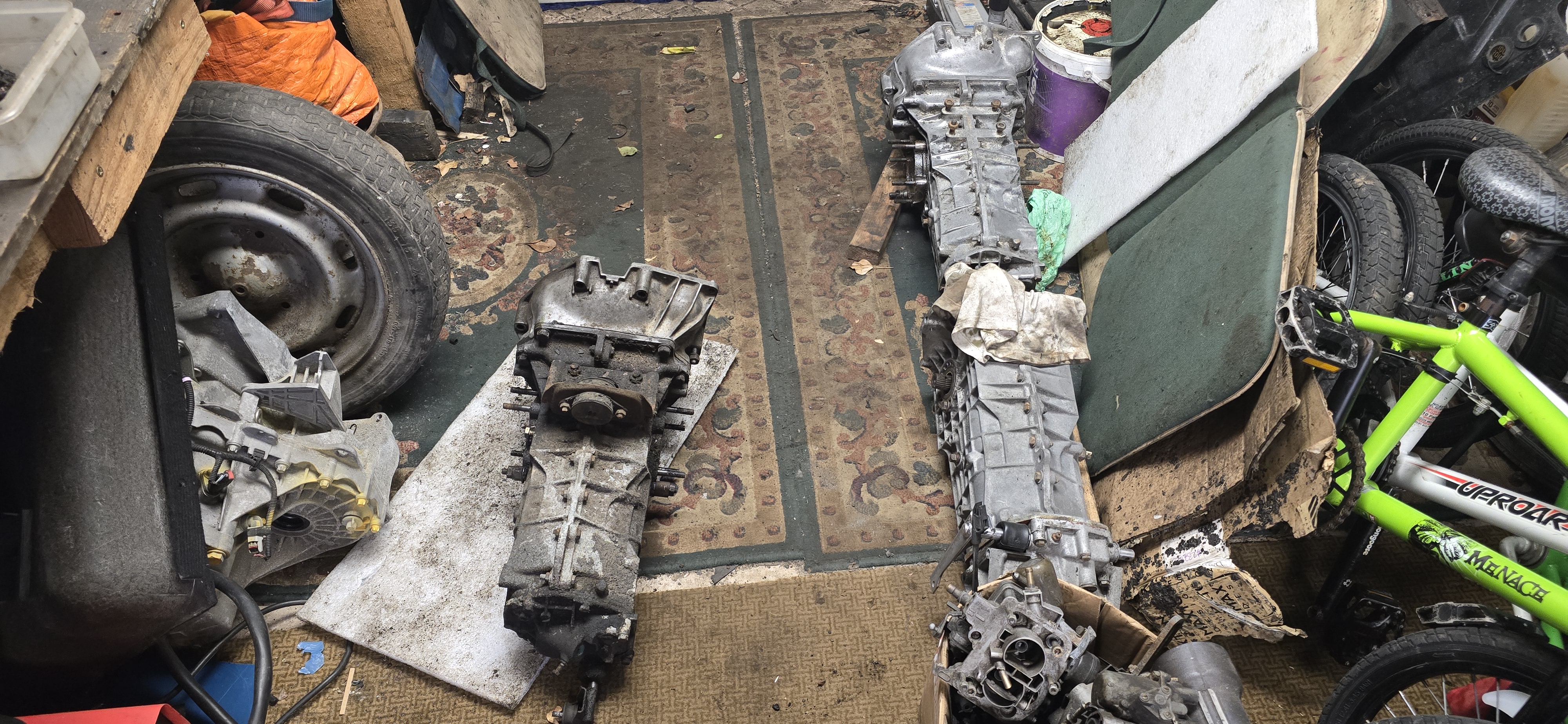

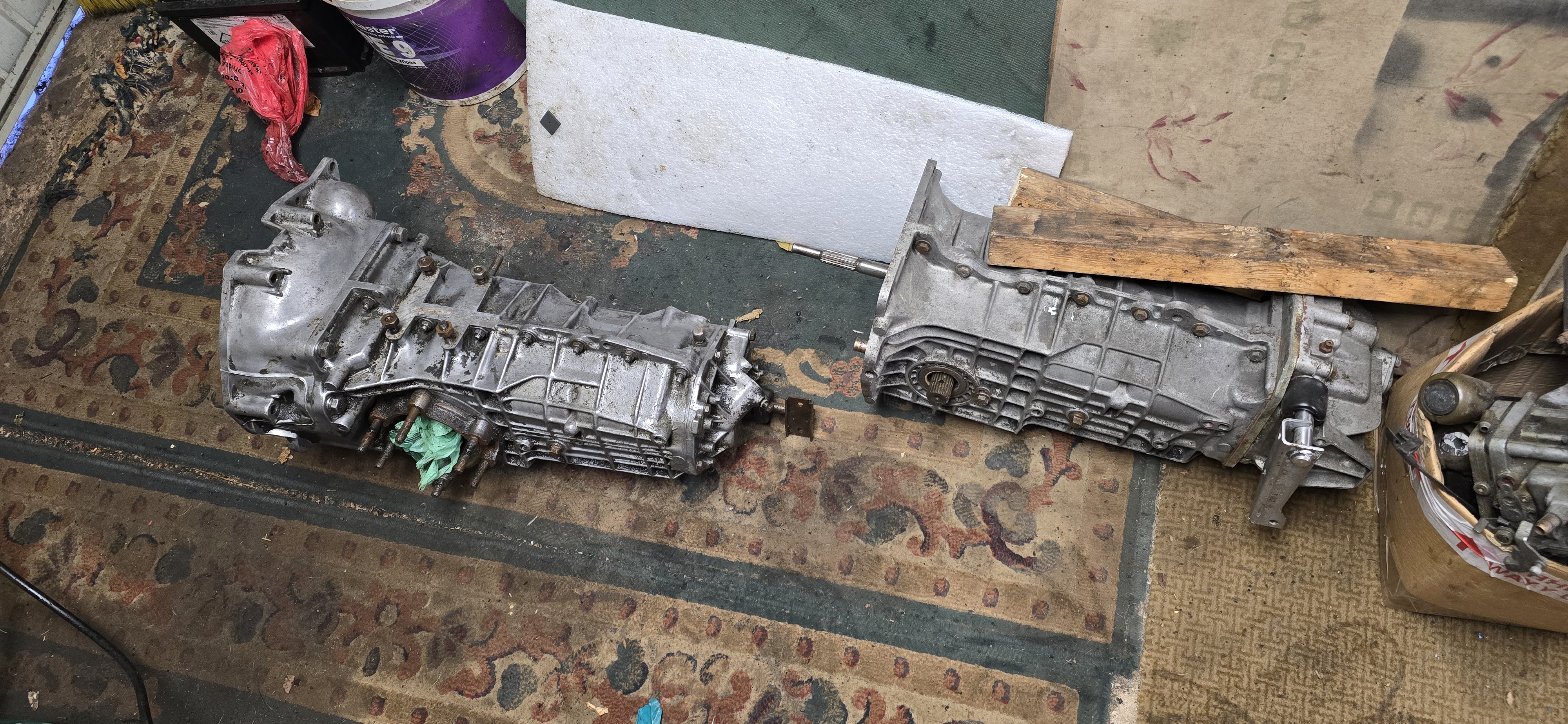

So I managed to get hold a gearbox today, I am told it is a r10 1300 box. Trying to give it a clean up as its very dirty. The cups (cant remember if that's wat Steve called them) are loose, one was off enough for the diff to move about. With them pushed up and turning the input the diff rotates so fingers crossed its ok.... 🤷‍♂️
There's a little story to these and a break down in coms. I was told these were good boxes by a third party, he passed on my details to the owner of the said boxes who contacted me to go take a look. I arrived expecting to see 2 good boxes ready to go but to be greeted by 2 "parts" boxes that the owner thought I wanted just for the casings.... anyway, didn't want to waste a trip so made an offer on the better looking of the 2 and took it home (the other looked to be semi opened up previously and left loose with no cups) thinking about it now I should of got that one too 👀
Have given it a look over and it may go again, so leaning towards giving it a chance as is, with some new gaskets fitted.

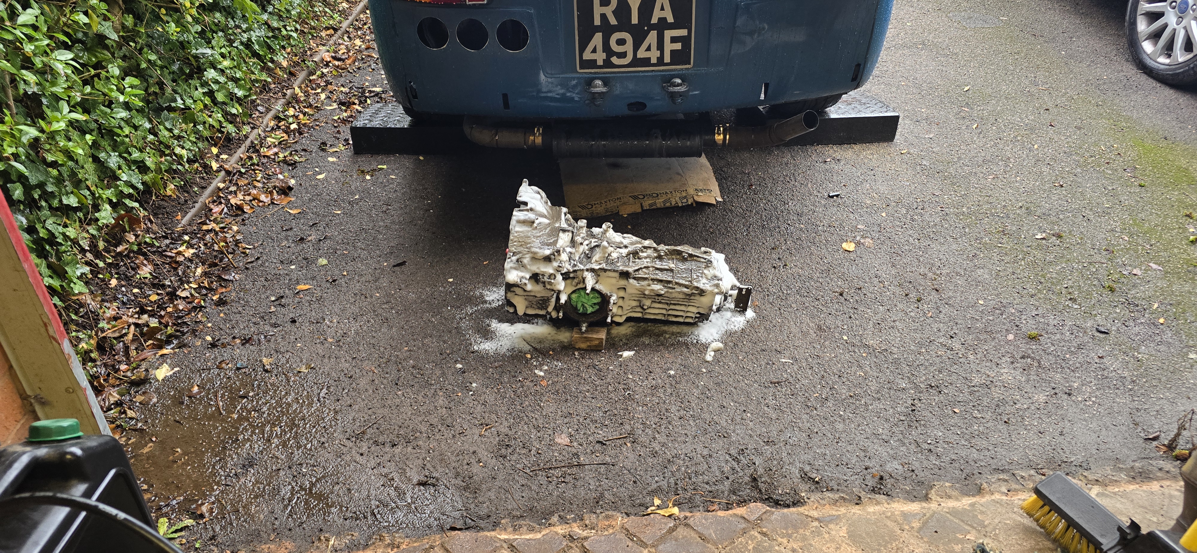

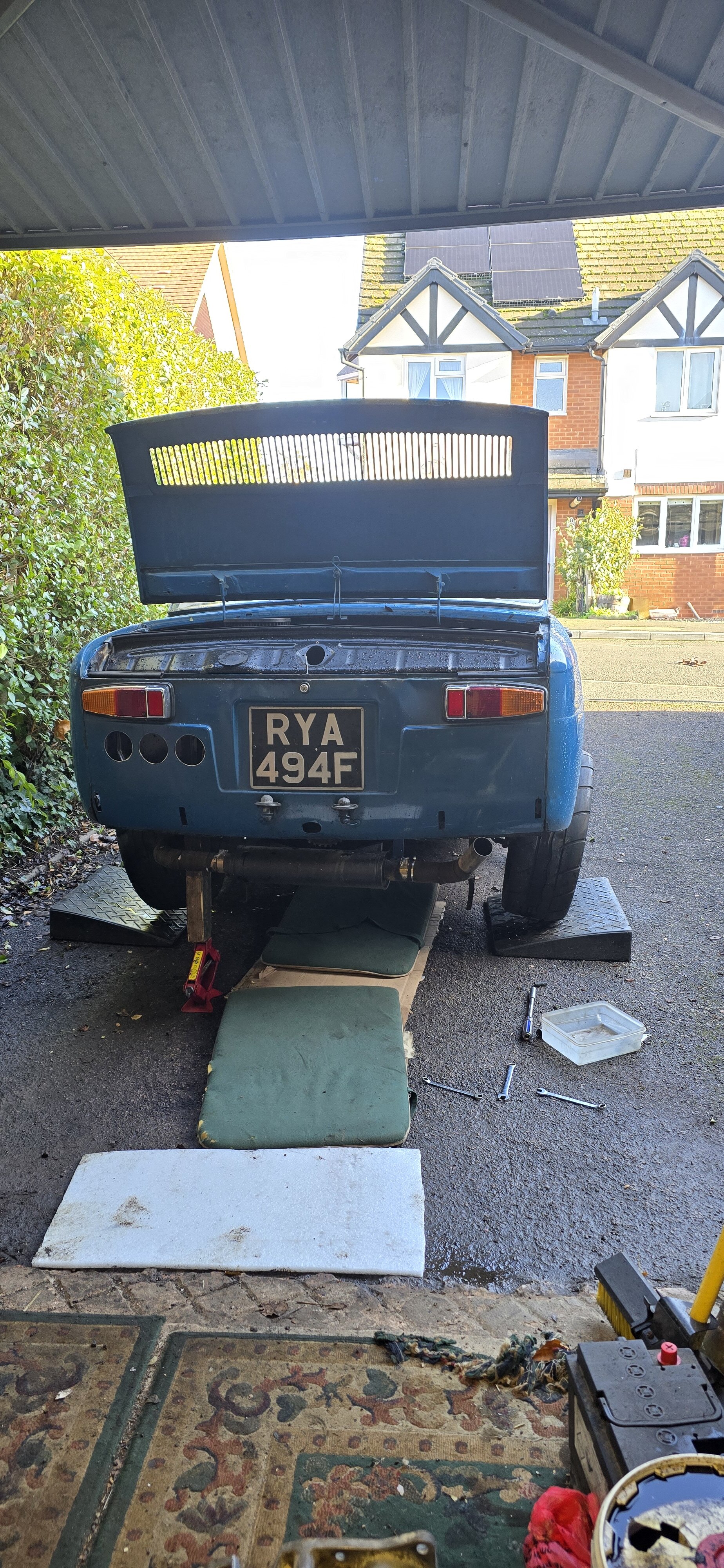

I've come to the conclusion that I'm getting very old, this should have been a simple job and it did me in. Took way too long and that really annoyed me. Anyway, gearbox out and in the garage
