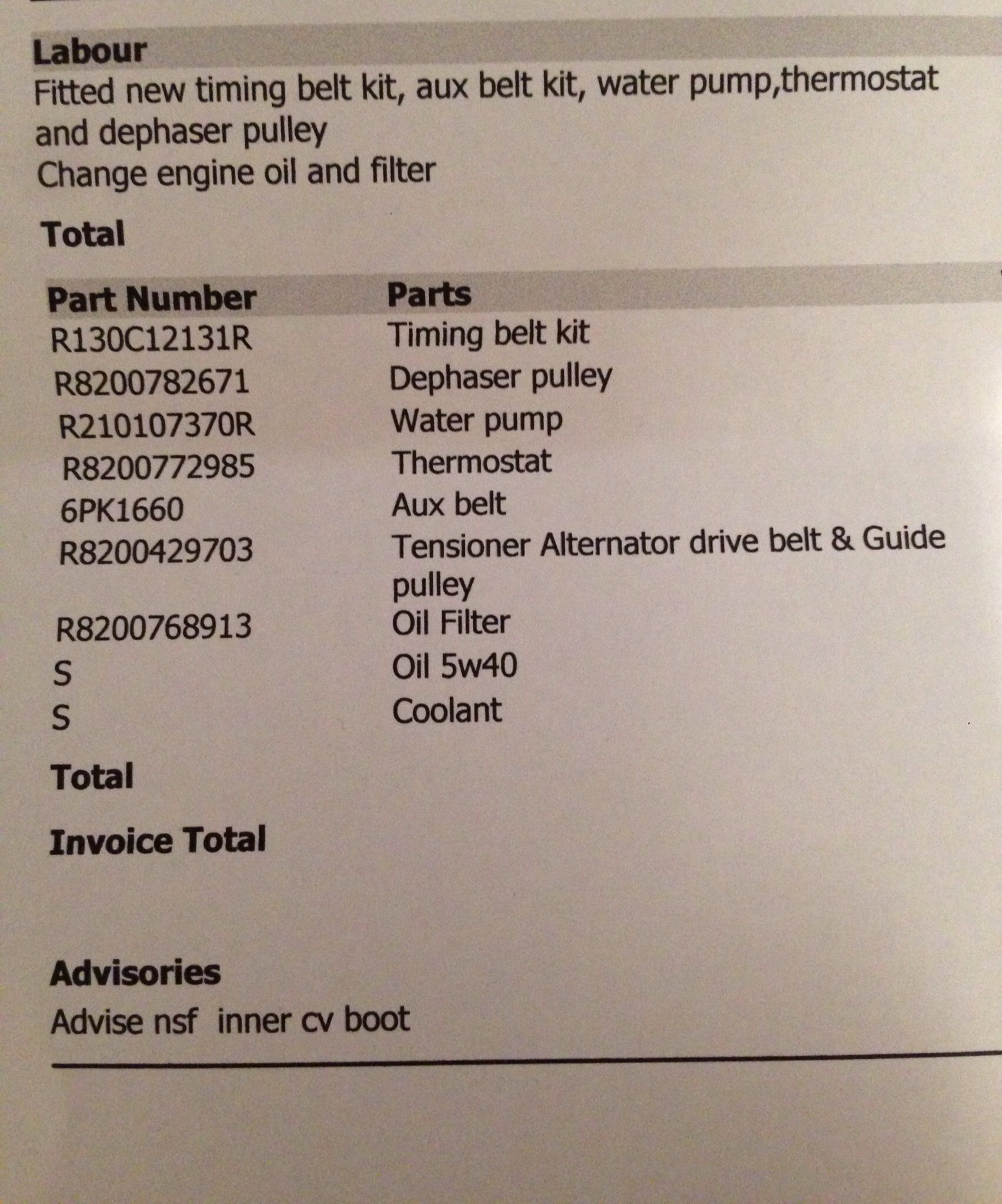

Dropped the car off at SWR today ready for getting the belts, dephaser, water pump and thermostat changed, with some new oil and coolant. Looking forward to having an engine that doesn't rattle like f**k anymore! They're also going to have a look at my oil leak from the gearbox/driveshaft and let me know what the problem is. Will probably fix that myself at some point though and get the box oil changed at the same time.
Pretty dull post, done mainly out of boredom. Looking back at my OP though the car's came on a decent bit since I bought it. Pleased with how it's turning out and will hopefully be even better when I get it back tomorrow night, as I'm convinced the timing was out slightly before as it quite lumpy sounding on idle. Pulled well though (even with a worn dephaser) so I'll have to wait and see how it turns out!

Another couple of jobs down! Timing was slightly out according to SWR. The car does feel like it pulls a bit harder higher up the rev range now, but more importantly the engine is quiet for once!
Temp gauge is now going up to halfway too, so it's good to know the thermostat change was worthwhile.
Got the gearbox oil leak looked at too, which is just the cv boot that's leaking, so I will be ordering a new one soon and some new gearbox oil. Shame to finally have everything sorted on it and it's the end of the year. Have to wait a few months before I can get it on track now.

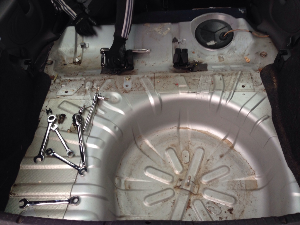

So this happened at the weekend
Ripped out the whole rear interior. No idea on just how much weight it's saved but I'd guess it's about 20-30kg. Probably not enough to make a noticeable performance difference but every little helps.
Will be attacking it tomorrow with some strong degreaser and APC to hopefully clean it up slightly.

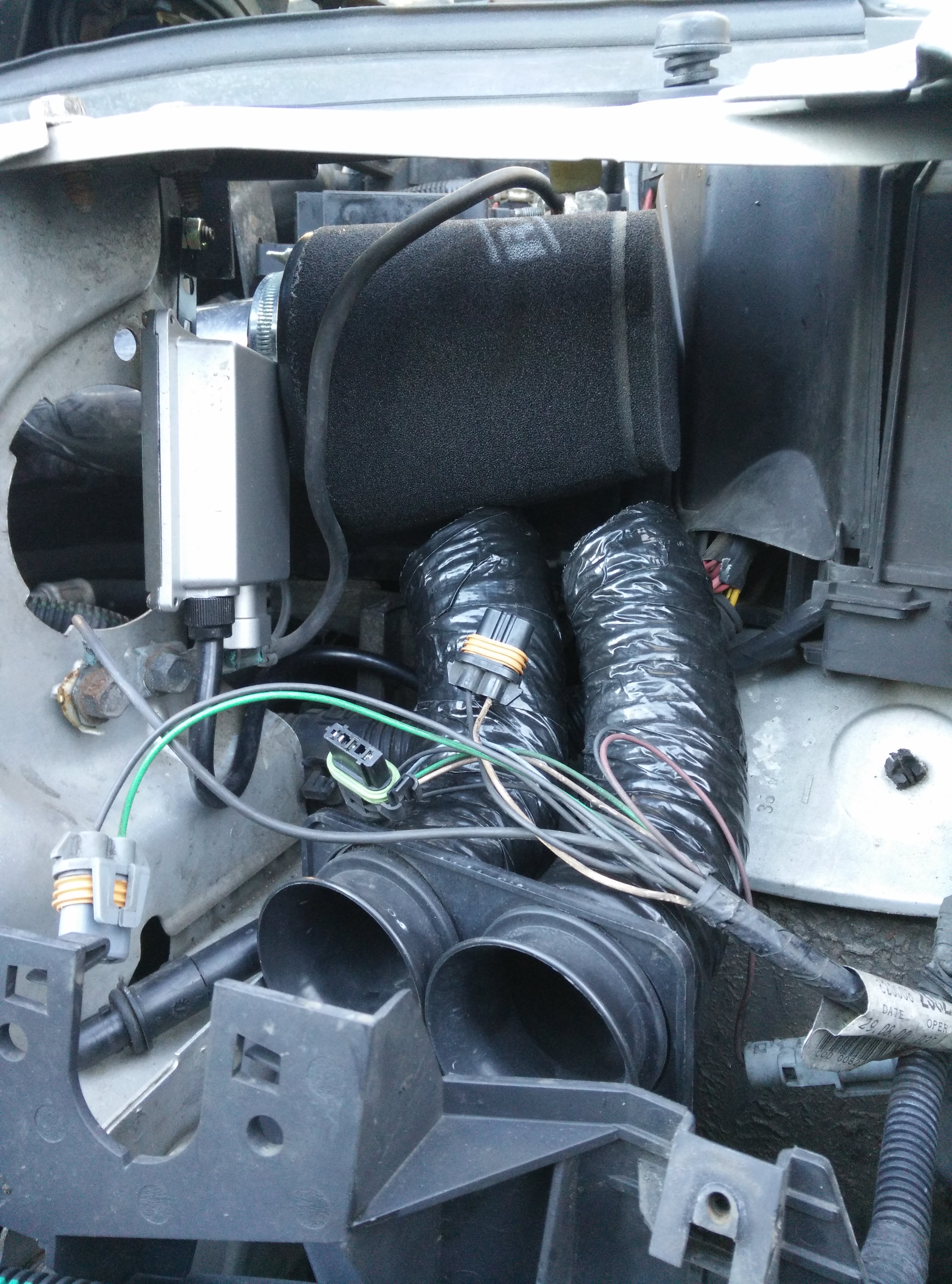

I did manage to sort out my cold air feeds for the induction kit the other day though, so they now look like this

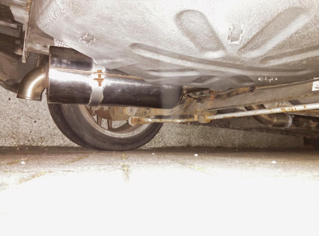

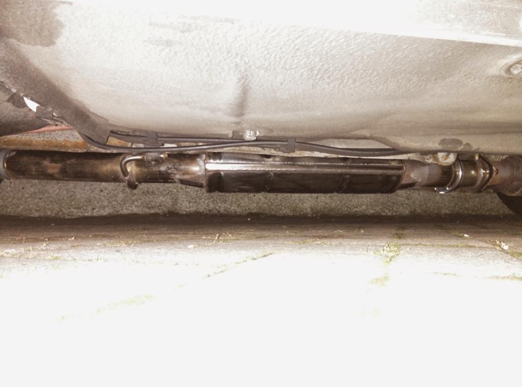

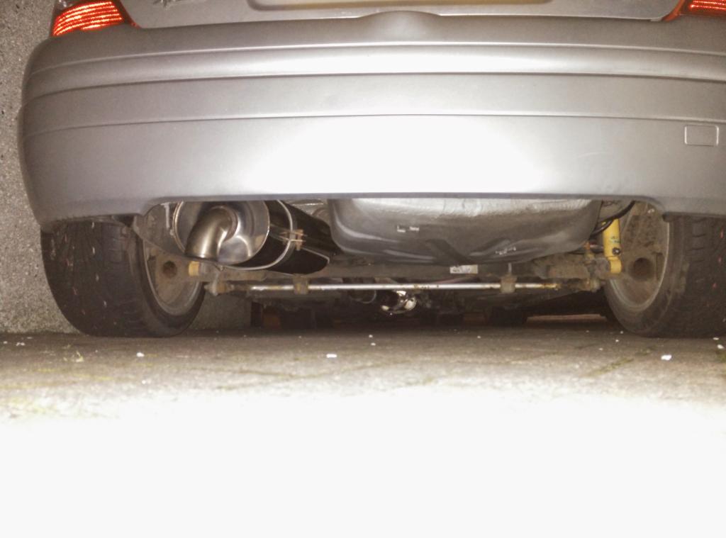

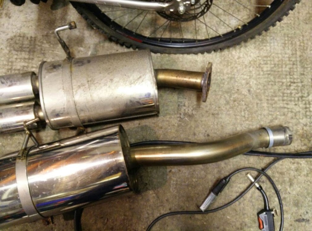

An update! Got myself a ktec centre section last week (cheers @J9HHY!) and decided since I now had that and the backbox, I'd fit it tonight. The old exhaust was a proper c**t to get off. Had a flanged connection to the backbox section and the bolts in that were rusted so so badly. The cat flange wasn't much better, and after rounding a bolt head had to get the angle grinder on it and cut the side off one of the nuts to get it off. Got there in the end though.
The hanger on the new centre section had broken off, and unfortunately I had a welder but no stainless welding wire! Plus any wire I could find wasn't flux cored, so needed gas...sigh! I decided I'd just weld it with the mild steel wire I had for now though since it'll hold but just rust and crack easier. Ended up with probably the most over-engineered weld ever, but it'll certainly hold it!
Once it was all sorted, fitting took all of about 20 minutes. The result is SO much better. Can't even describe how much quieter this exhaust is than what was on it. I can kind of see where people were coming from when saying it was droney but Christ, you lot should've heard it before! 😂 I did notice that the old exhaust had a split on the centre box though, so that certainly wouldn't have been helping matters.

Old vs new!
Old system looked like it was only 2.25" bore.

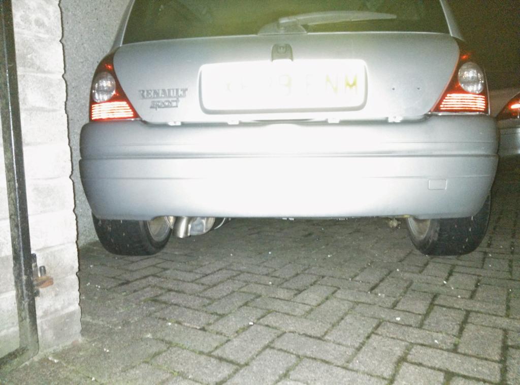

And fitted. Tidies up the back of the car so much.

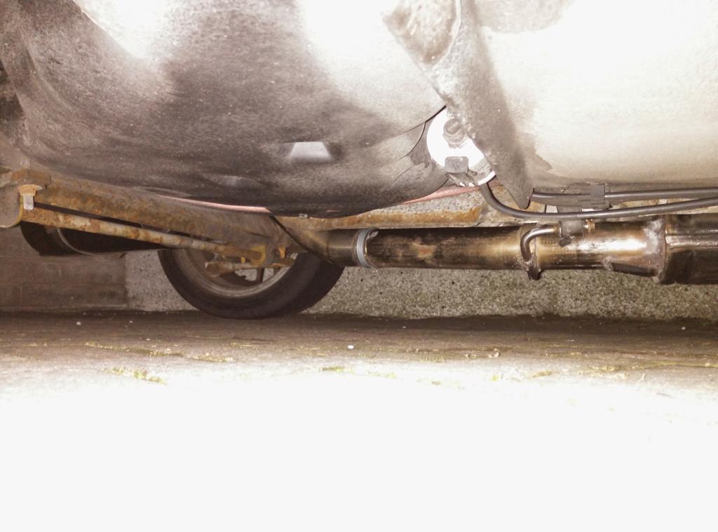

Aaaand my brilliant exhaust clamp for the rear...yup, a jubilee clamp...
Only managed to get one proper clamp for it just now but will be getting another in the next couple of days.
The centre box looks a bit low just now as well. It's the same height as the cats are off the ground but the positioning of it is probably gonna ground me on speedbumps now lol!

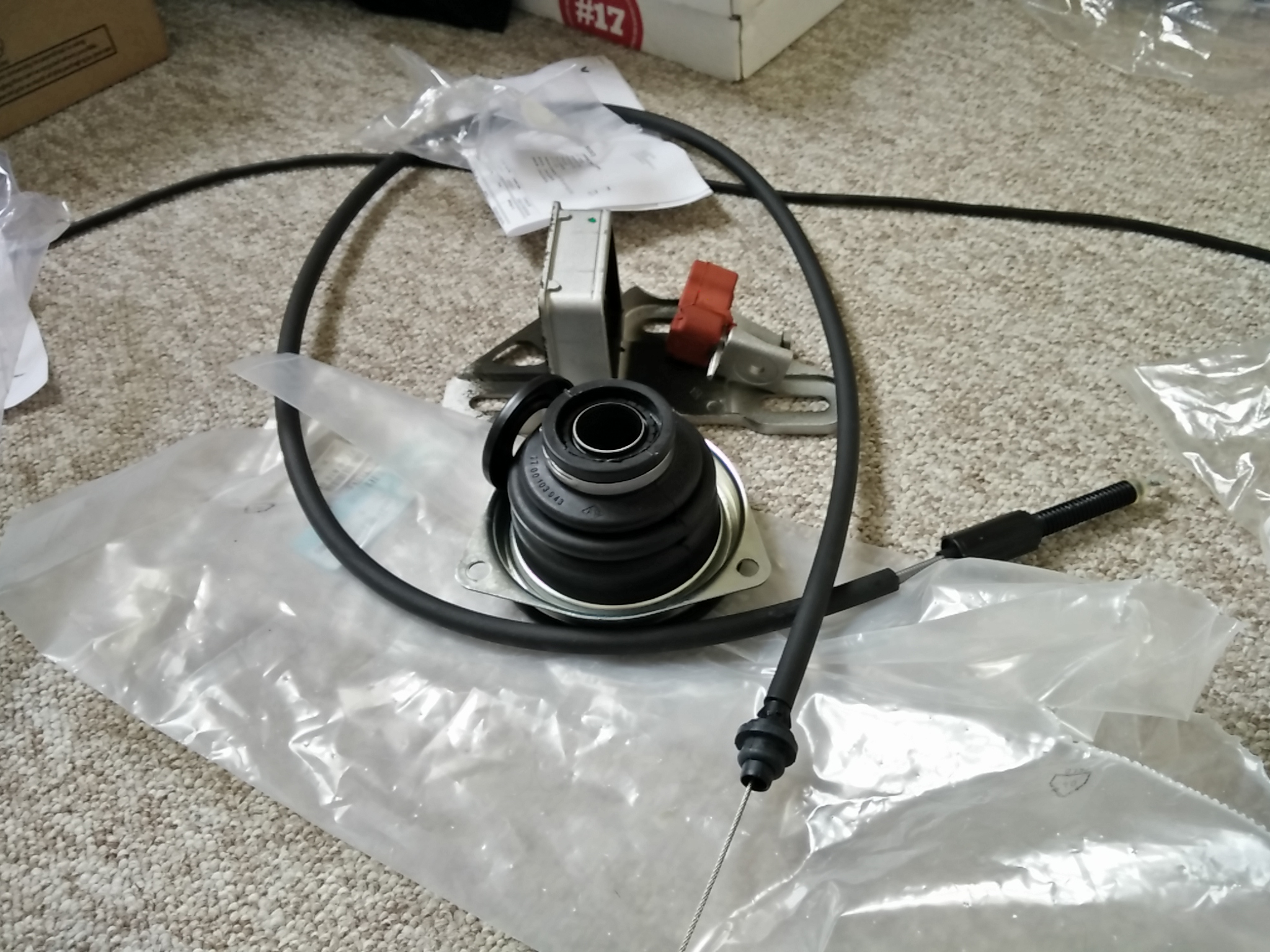

Part have arrived! The track prep begins...
New exhaust hangers, throttle cable and a new ns inner cv boot. f**k knows how I'm going to fit the cv boot. Need gearbox oil first! But it looks like it needs pressed in so will probably be a garage job.

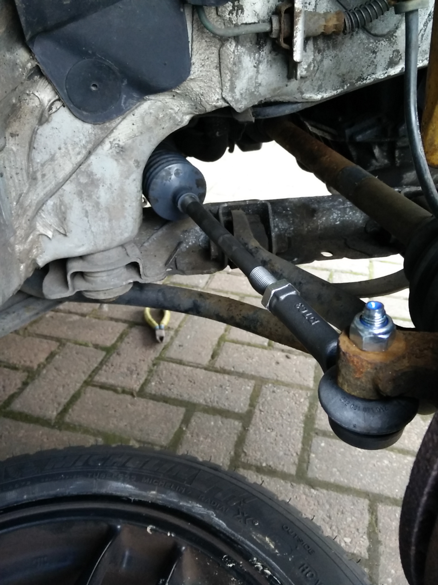

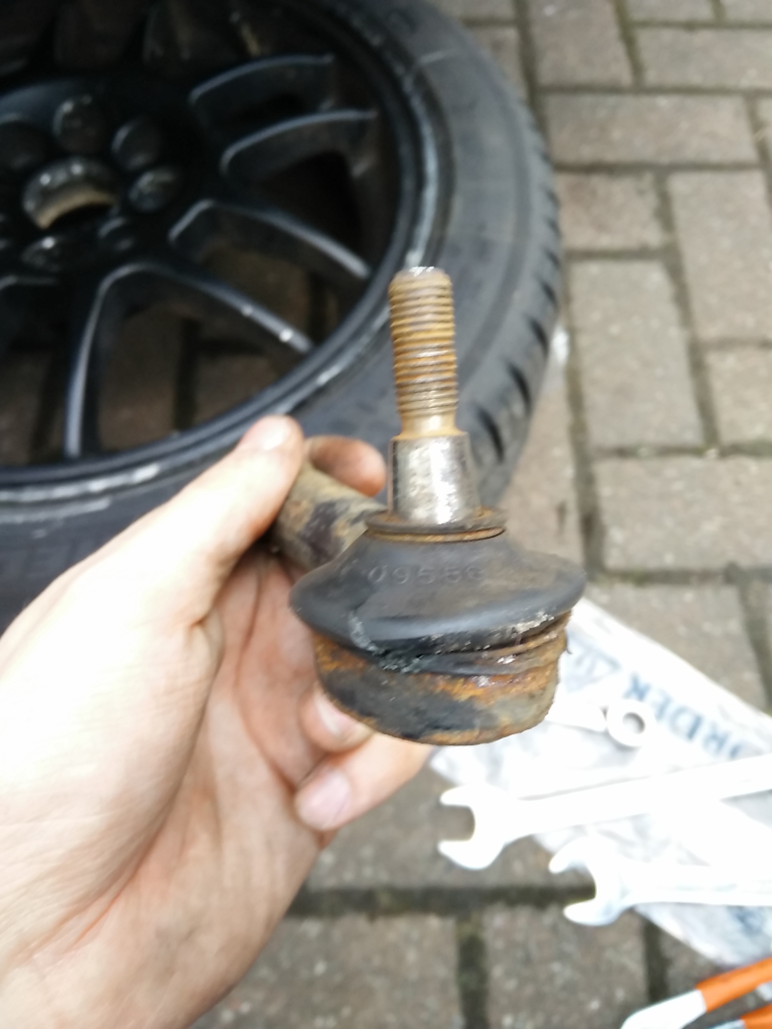

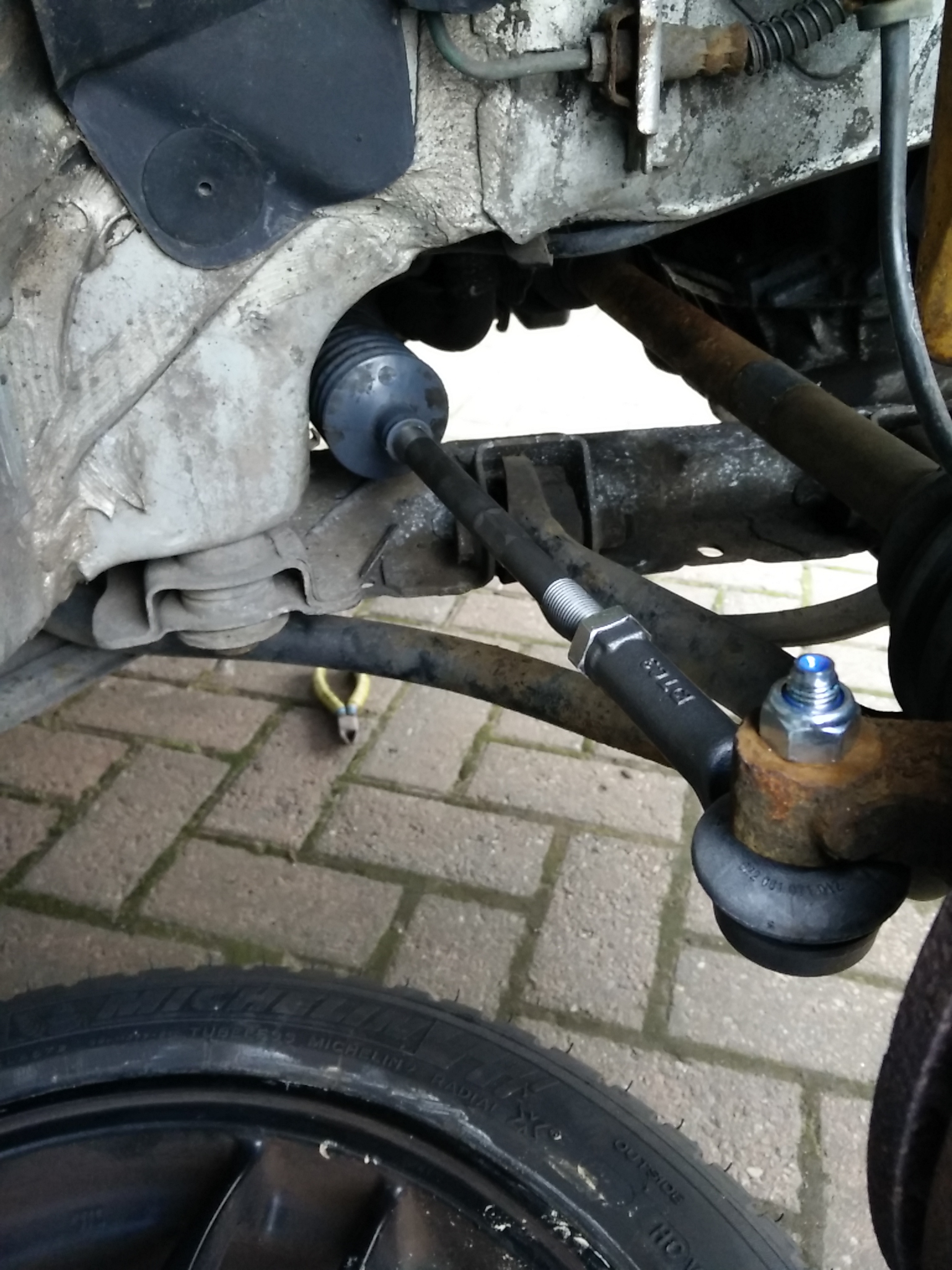

Part 1 of this weekend complete... Got the tyres fitted, and started work on the track rods/ends and ball joints.
Track rods are a pain in the hole! Had a tool for removing them but it turned out to be as useful as a f**king ashtray on a motorbike. So binned that idea off, went to halfrauds and came back 10 quid lighter with a 32mm viscous fan spanner that soon got attacked with an angle grinder to cut one end off and make it fit in the little space that was available.
End result, a nice shiny new track rod and end setup!

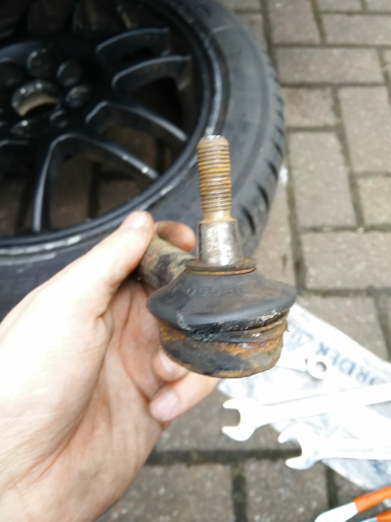

The old TRE was looking a bit worse for wear...
Tomorrow will hopefully see the other side done, as well as both ball joints. Hopefully the tracking hasn't been knocked out too much for now. Only way I can think to check is measure the distances between the front edge of the front wheels, then the back edge of them and get it as close to being the same to get them running straight, since I don't have enough axle stands to do the string method.

I did the exact same with the viscous fan spanner cut in half, worked a treat! Get those threads caked in copper grease though will save a lot of time and effort if you need to alter anything at a later date.
Yeah, apart from ripping my arms apart on the subframe trying to get into one side to get the boot back on, the inner rods ended up fairly easy with that tool haha. Also completely forgot about copper grease! Will only ever be my local alignment wizard that's playing about with it but it would make his job a lot easier in future lol.

What inner track rod tool did you buy? Do you know the size? I keep forgetting to measure and want to buy a tool lol
sburrell93
Scotland - South
It's 32mm on the inner track rods, and I know it's definitely DEFINITELY not this fucker you want lol
http://www.ebay.co.uk/itm/Universal...415?pt=LH_DefaultDomain_3&hash=item20f1907bd7
I'm sure I read in a thread that people have used this one before:
http://www.ebay.co.uk/itm/Universal...384?pt=LH_DefaultDomain_3&hash=item1c414dca48
but IMO that'll be too wide to grab the squared off section on the track rod, the exact same issue I had with that first tool there. It just grabs the rounded section of the track rod and gets you nowhere.
TBH though, I'd just go for something like this
http://www.ebay.co.uk/itm/BERGEN-St...378?pt=LH_DefaultDomain_3&hash=item233e94dfd2
only downside is you'll need to get the 21/22mm securing nut that holds the TRE in place off before the tool will go on, but the fact you can put an impact gun straight on that and buzz it off would make lift a million times easier!
