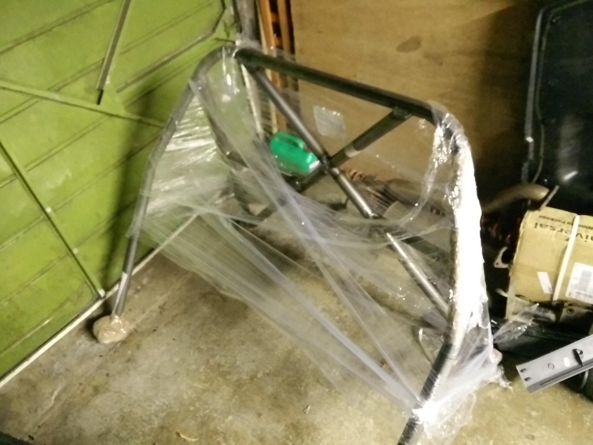

Cage arrived yesterday! Looks decent enough.
Car is away getting the gearbox cv boot sorted just now though. Will have that and some fresh box oil soon enough, then getting it on the rolling road Saturday morning to check it's all running fine. I'm dubious though. Exhaust popped at me the other day and felt like it stuttered a bit. Will soon see how it runs though!

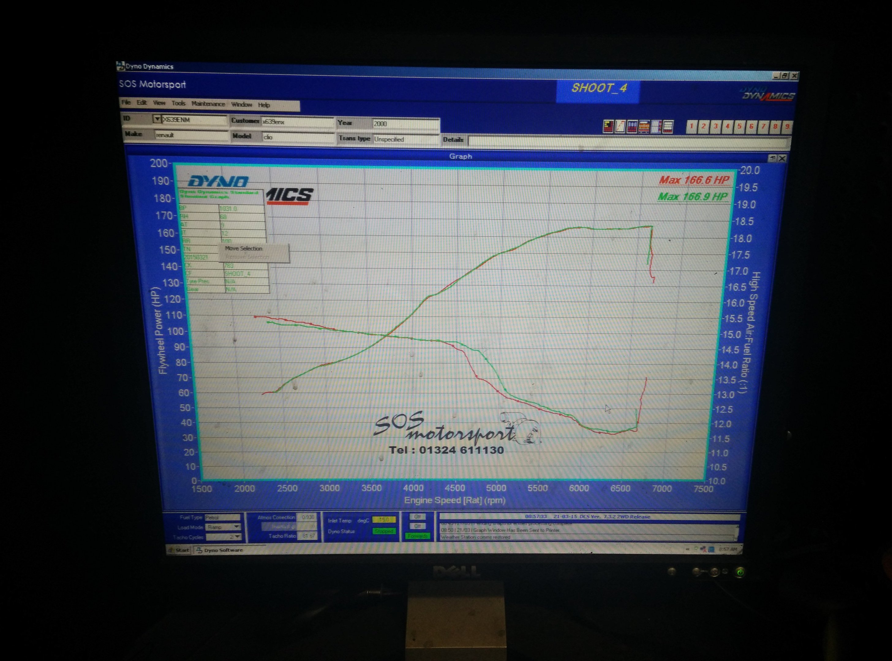

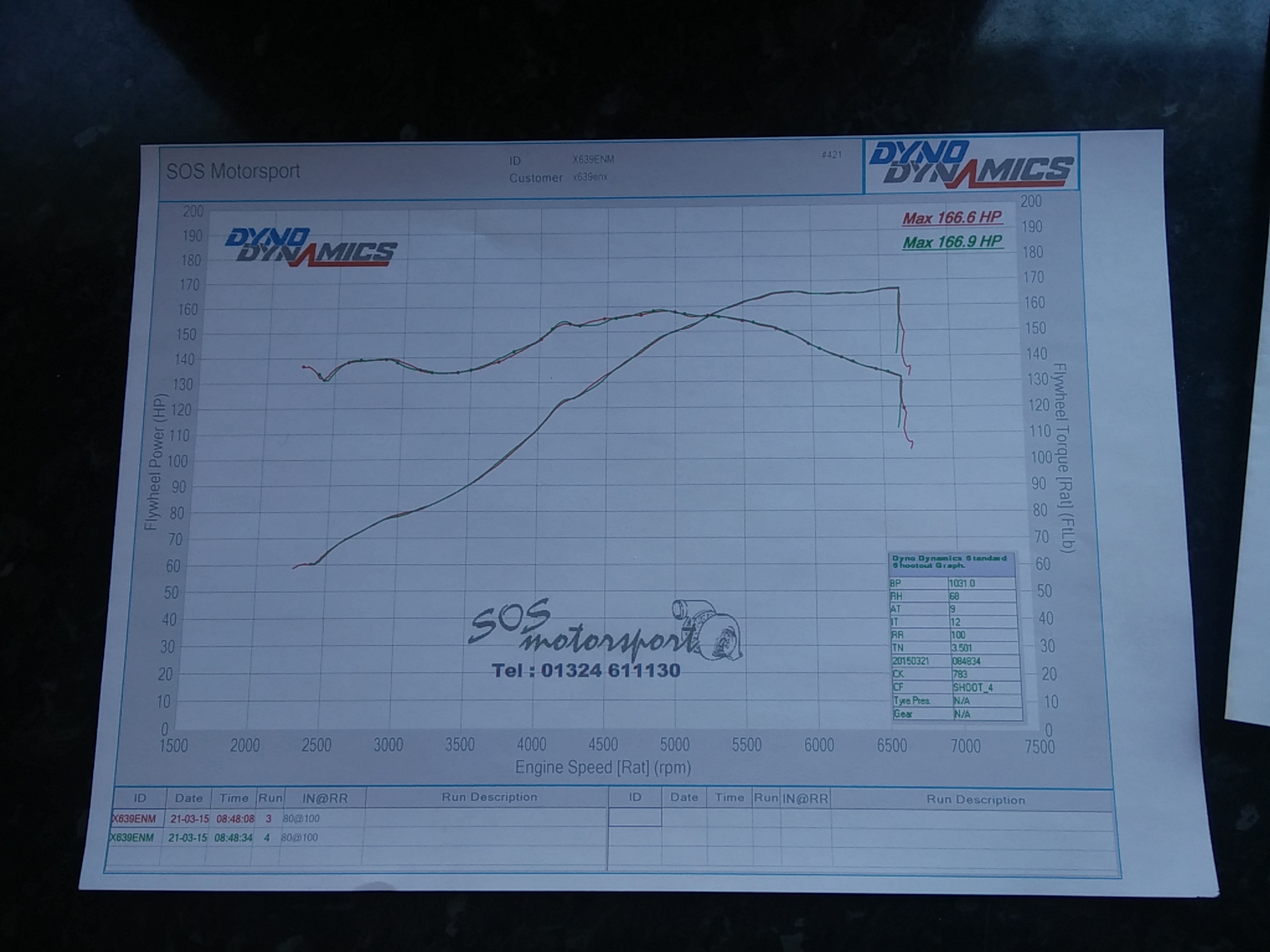

Made 167hp on the rollers this morning, so looks like it's running well!
It's running rich at the top end though. Not sure how much a map could help sort of the lack of any power increase above 6k rpm.

Is that a standard engine? Good if it is. What what improve the running rich?
Yeah completely standard as far as I'm aware! Only things I have on it are a ktec stealth cat back and the diy ktec induction kit.
Would just need mapped to sort it out I think. Apparently they all run rich but mine took a bit of a hike at the top end!

Thats the AFR graph from the rollers. Runs about what I expected up until 6k rpm but then shifts quite rich, which ties in with where the power levels off at the top.

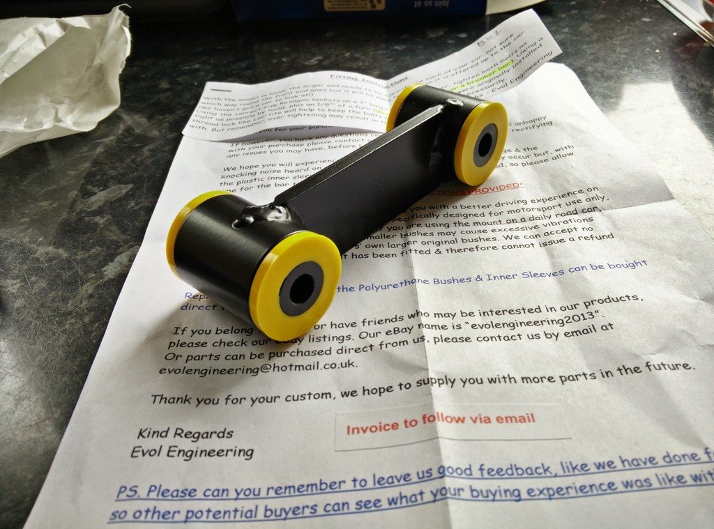

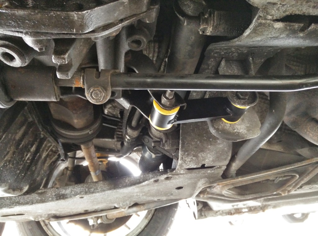

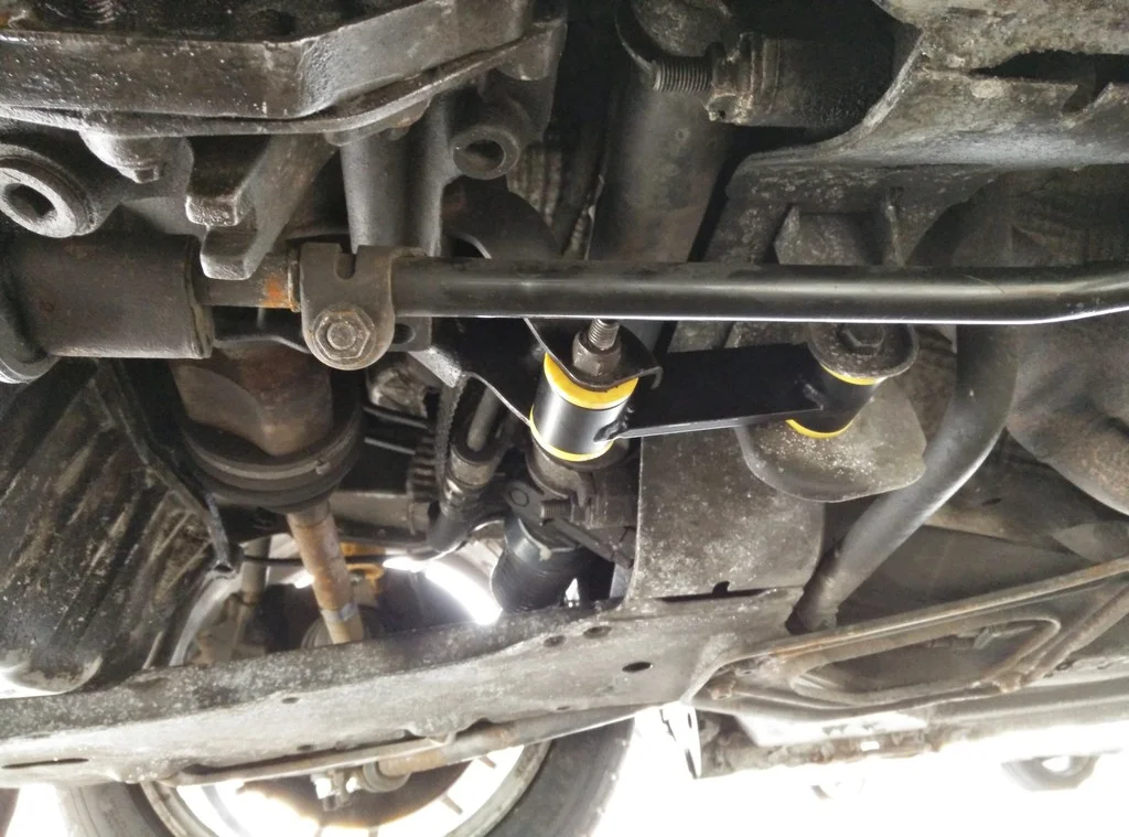

New dogbone mount arrived today

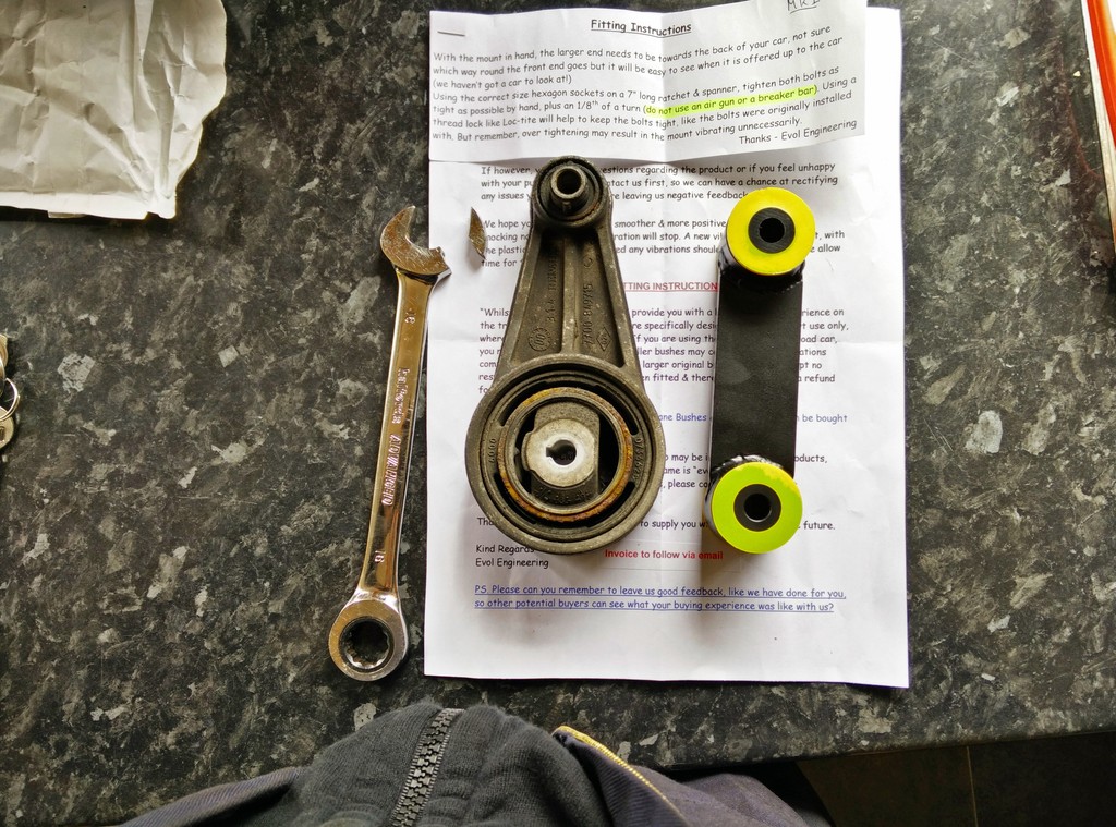

Fitting it went well...as soon as I started, I managed to do this to my 16mm spanner...
Little comparison of the old and new mount too
Halfrauds lifetime guarantee ftw though, getting it replaced when they get stock in. Used the ratchet side and it done the job for today.
Aaaand all fitted
Took longer to jack the car up than it did to fit it! I'll be honest, when I started the car after fitting it I thought I'd broken something 😂 there's a LOT of vibration, but it should settle down a bit with some use. Pleased with the stiffened up gear changes and general lack of engine movement though.

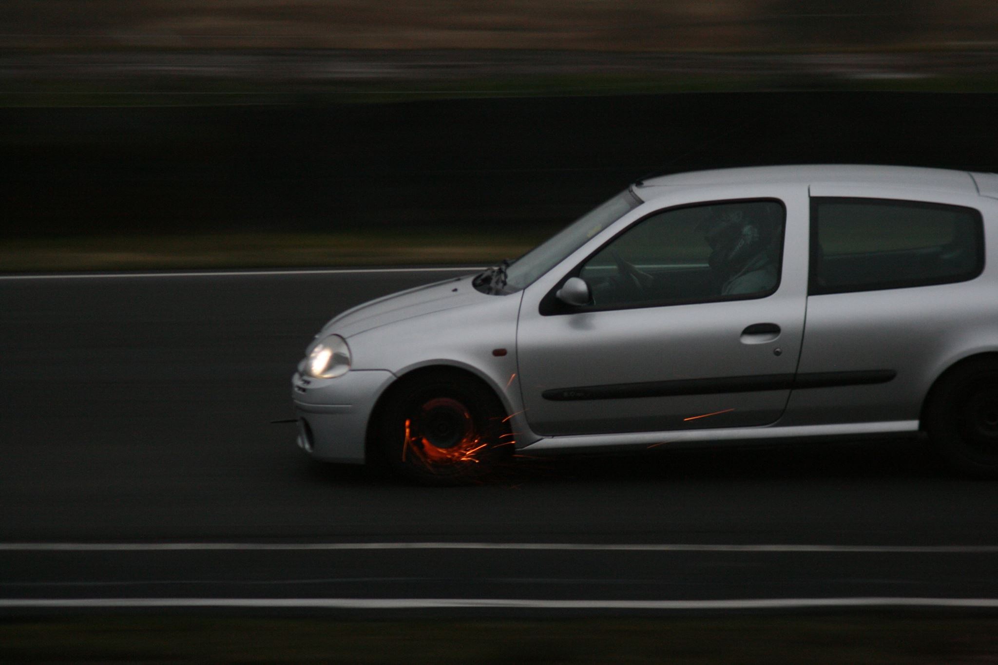

First track evening down, f**king loved it! Whole 2 hour session went relatively well. Started off slowly with the help of @Fraser.J. then just built up pace as the session went on. Managed to shave 10 seconds off my times from start to finish, so as much as I'm not wanting to chase specific lap times, it's good to be able to see improvements.
My brake setup DEFINITELY needs upgraded now though. I got some ATE fluid off @George@RTR_Parts not long ago, so got that in the car yesterday. Also pulled my fogs and arch liners out to help a little with brake cooling, but I was happy with just going out on standard discs and pads. It's what was on the car when I bought it, and both the pads and discs were pretty new looking. They lasted alright, and I wasn't exactly going for any heroics on the brakes either, but I was halfway through a run and just caught something out of the corner of my eye when braking. Never thought anything of it but noticed the brakes starting to fade not long after, so done a cool down lap and came in, only to be shown this picture!
Fair to say, the brakes took a bit of a pounding lol! Ended the session with them doing it on pretty much every braking point, even done it a little when I was doing cool down laps. The pad material on that passenger side had went white, and the ones on the drivers side had started to go a brownish orange colour. No idea what that meant but I'll be taking them off for a look tomorrow.
So apart from a shagged set of pads and discs, the evening went well! I'll see if there's any other photos and put them up. Also got a few videos with my dashcam so might upload a couple of laps.

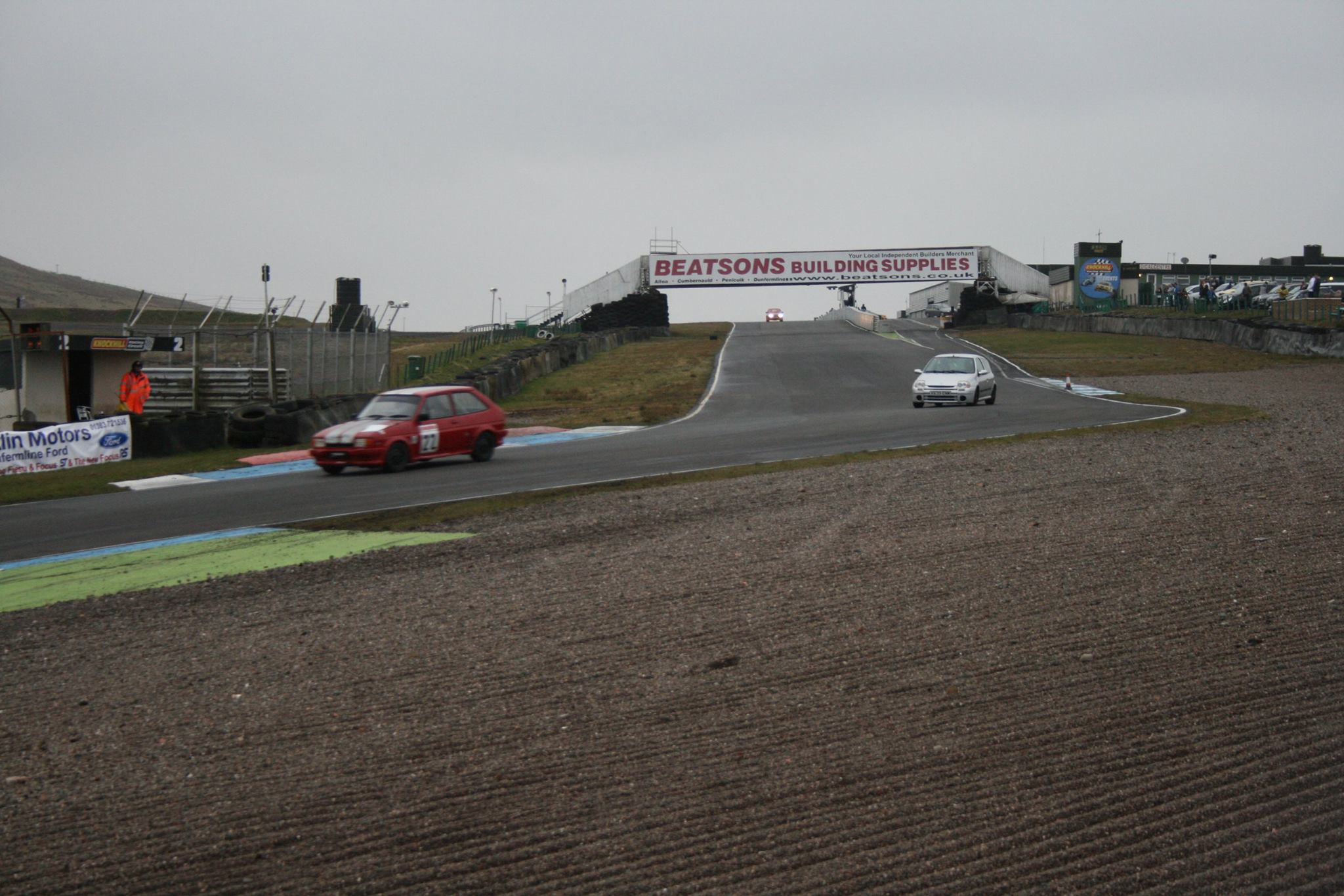

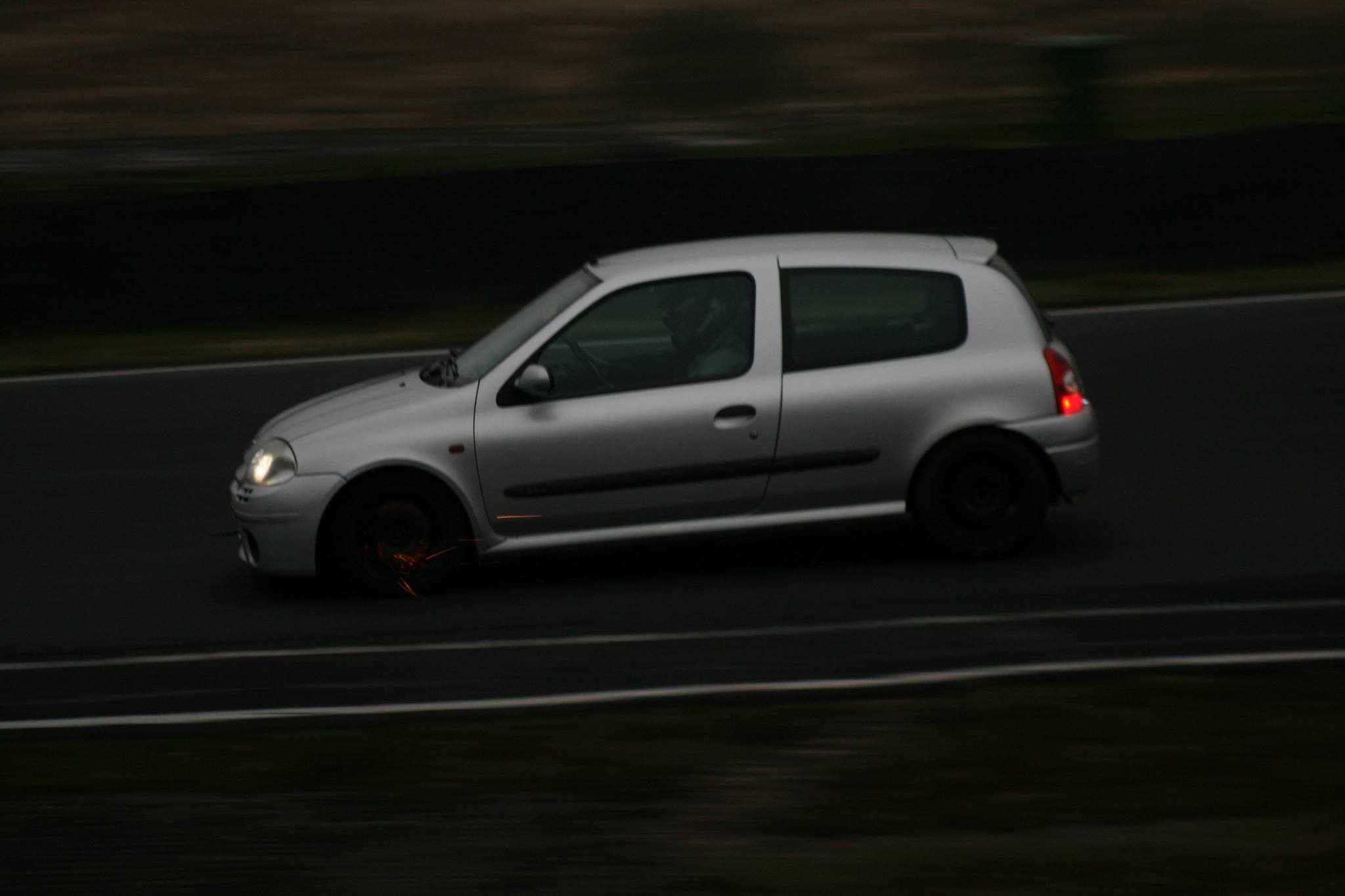

Couple more pics from tonight.
Almost see the brakes glowing again in this one
Quite far away this one, but I like it because I'm pretty sure I passed him a couple of corners later 😂
Darkness drew in quickly as the session came to a close. Went back out with half an hour to go and needed lights lol, so these photos are all a bit dull.
Aaaanndd some more sparking brakes lol!

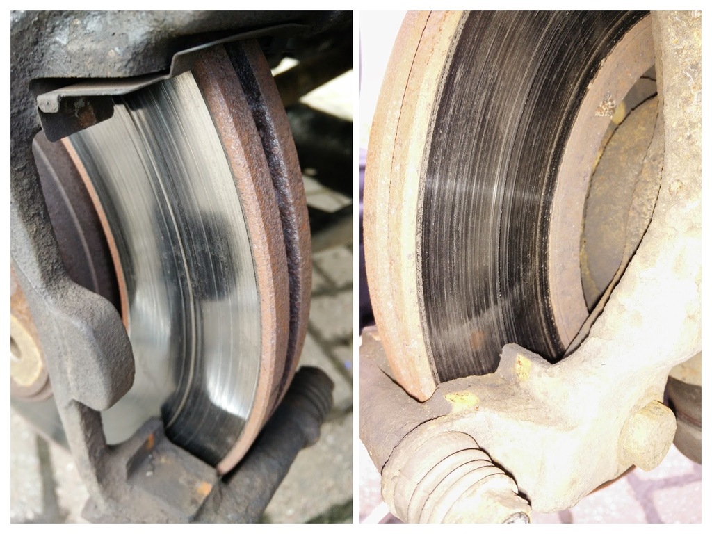

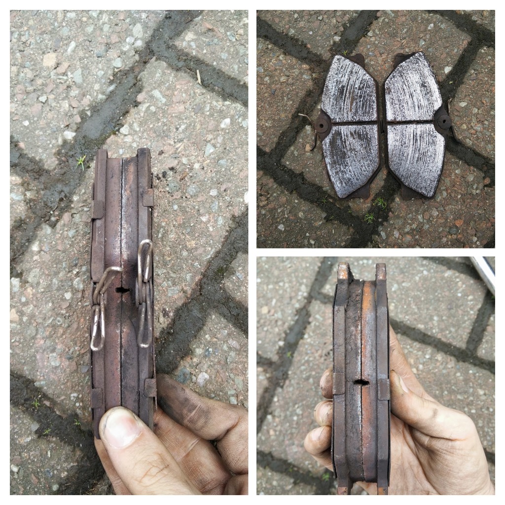

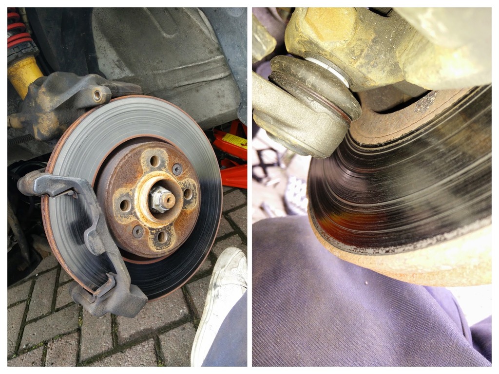

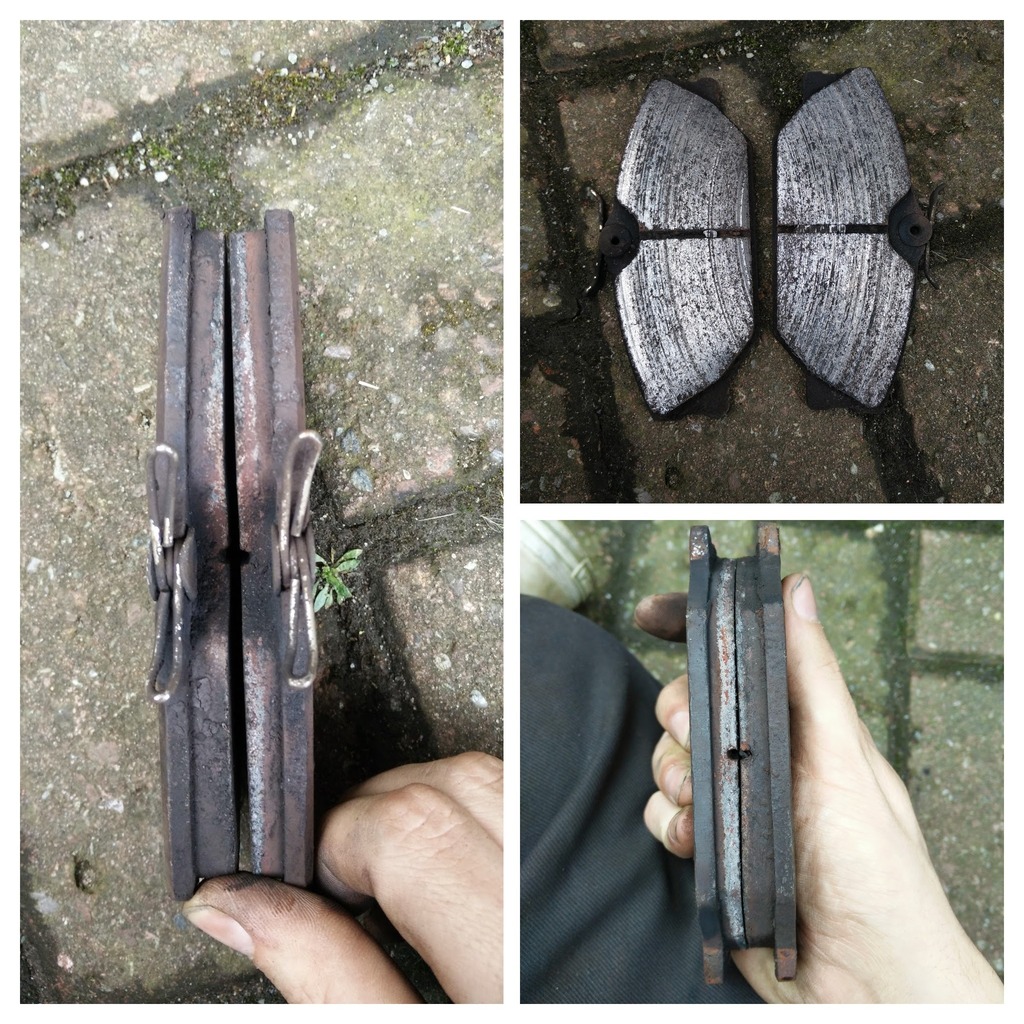

Had a look today at what state I'd left my front brakes in after last night. Surprisingly there was still a decent bit of pad left. I noticed once I had everything off though that my caliper sliders were sticking on both sides. More so on the passenger side. Got another set of calipers there ready to be refurbed and put on so that'll be getting done soon.
I'll let the pictures do the rest of the talking.
Front left pads:
Front left disc:
Front right pads:
Front right disc:
I've no idea what's went on with the pads, but you can see both the outer ones have turned a different colour. Left side outer one has went white/grey, and the right side outer one has went orangey.
Discs seem scored to f**k though lol, but I don't know if that's just pad deposits and would clear with a couple of harder braking runs.

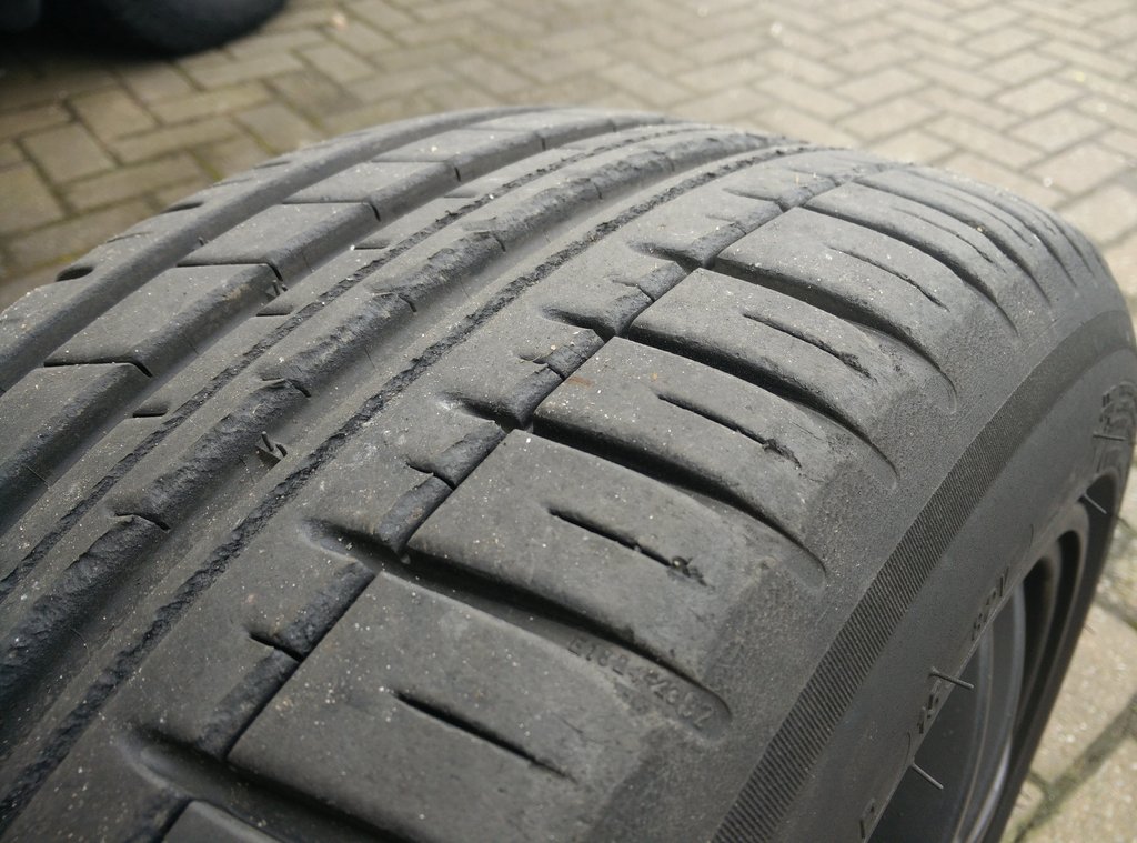

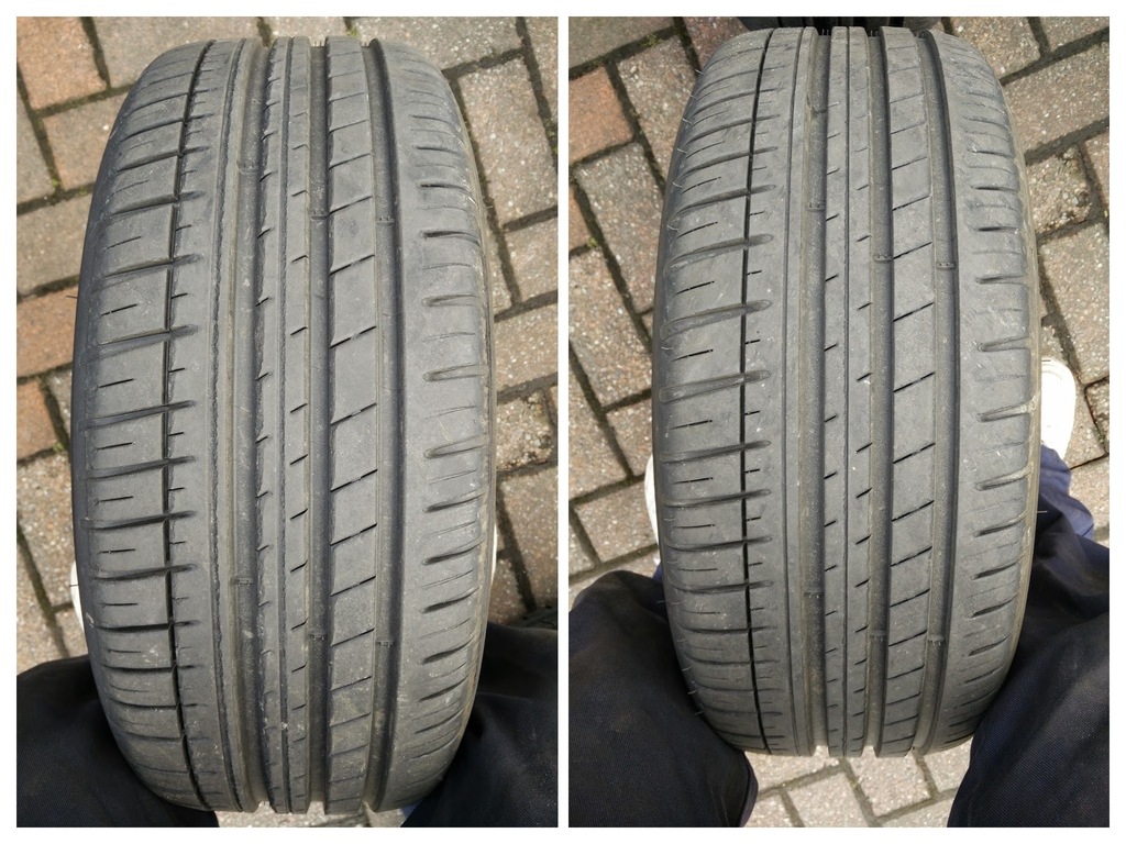

Now for the tyres. I arrived with them at 31psi cold. After a session they'd went up to about 36 hot so I dropped them back to around 32 and ran them at or around that the rest of the evening, which resulted in this:
The right hardly got touched which I expected at a track like knockhill, but the left one started to scrub a little. Better view here of the wear on the left hand one:
Can see it starting to run over onto the sidewall slightly. Not sure if higher pressures would've sorted that, but it gripped well as it was, so I just left it. In fact it never really under-steered at all the whole night.

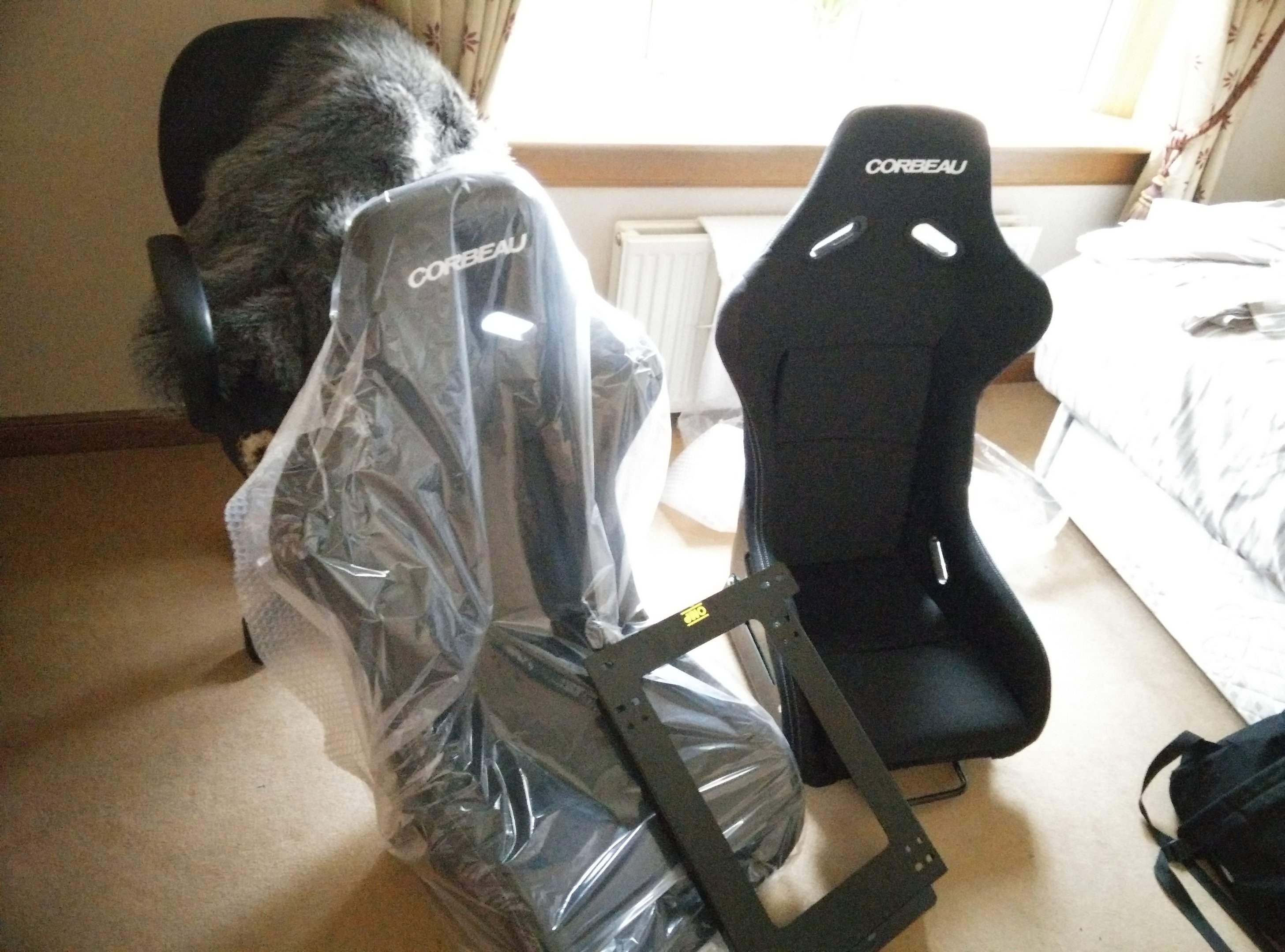

Large boxes arrived today...
Oooh, new shiny things
Can't wait to get them fitted and get the harnesses in. Only problem now is my harnesses will bolt to the floor when I have a cage sitting with harness bars on it! Will be on the lookout for proper 4 points at some point probably.

Look nice, comfy too?
Looks good on track, brakes are nice too lol. Some epic photos though!
Yep! Feel pretty comfy from a quick seat in them anyway. Nice and snug too.
I do love the brake photos, but the fact that's basically the discs crying out for help isn't so good lol! They performed well enough but must have been cheap shitty discs or pads to spark like that!

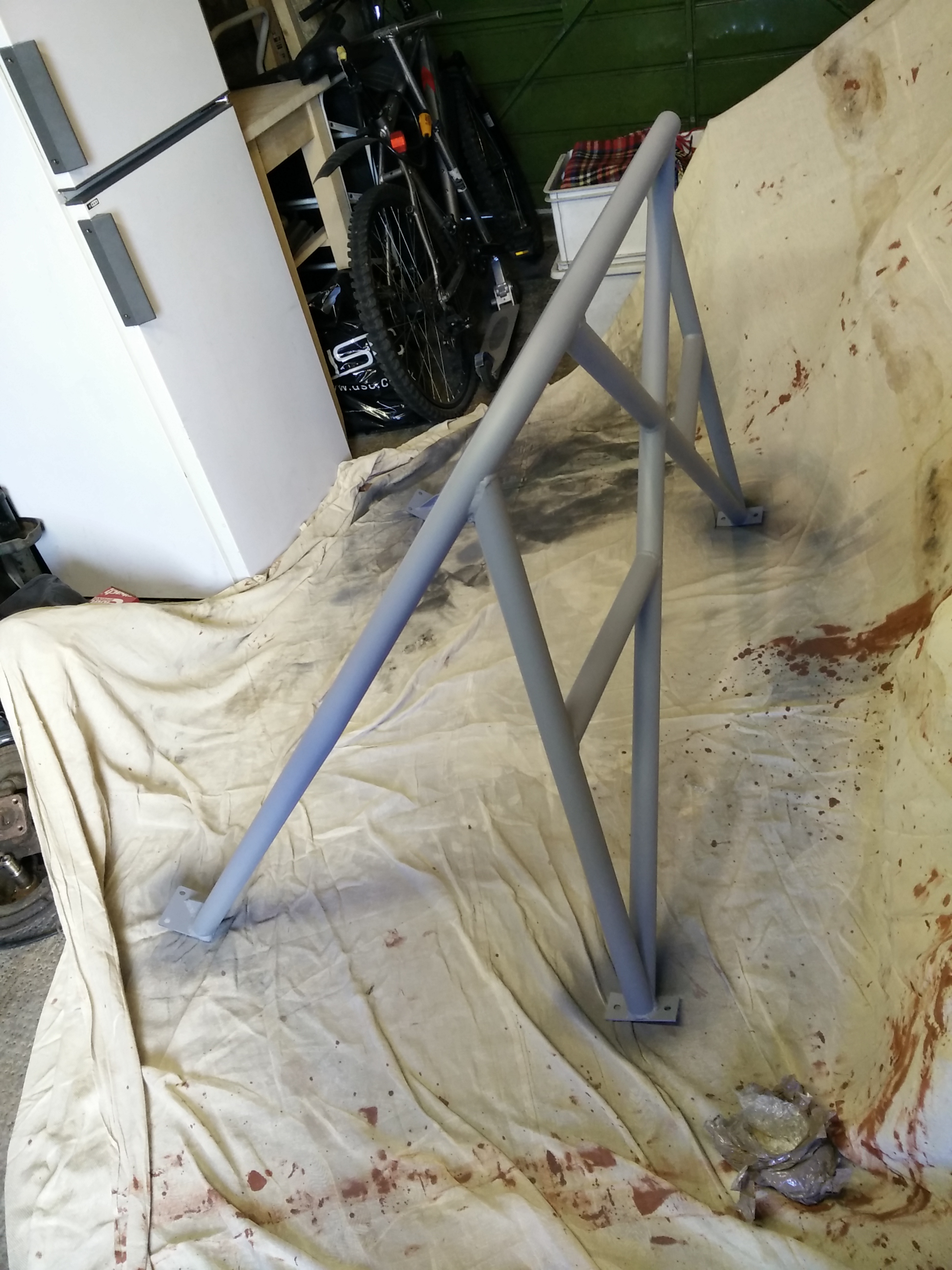

Progress! Decided the cage needed painting before it rusted away sitting outside [emoji23]
Will be going satin black. Well, if I have enough paint... On the second can of primer lol and I only got two cans of paint so I'm pretty certain I'll run out!
