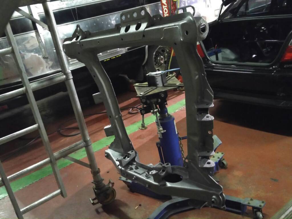

It's for camber mainly, not spacing. I'm maxed out on the bolts and it's not really enough
I know my mate was going to do it. He's ridiculously clever and particularly good at measuring n s**t.
He decisded it was too much hassle.

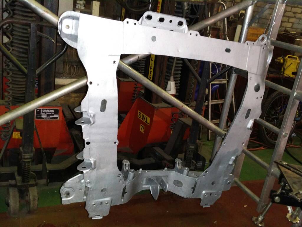

Subframe got a lick of paint at the weekend, so I doubt it'll be getting any sort of alteration done now anyway. I still might try it with the spare I'll end up with just for something to do though.

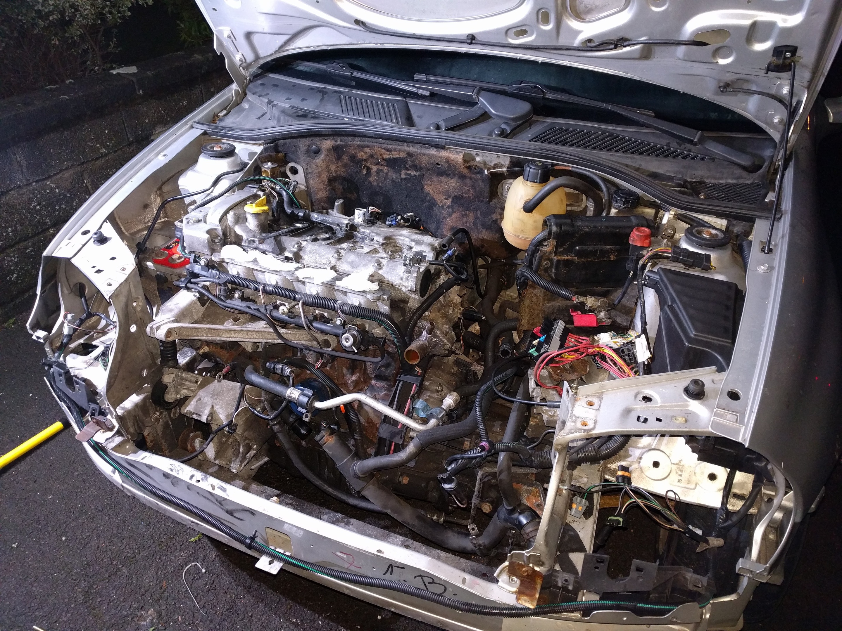

Done some stuff tonight. Got the bumper, headlights, slam panel etc all off. Air con pipes, condenser and pump removed then got the alternator out. Slowly starting to strip it down ready to remove the engine.
Tomorrow's plans are to drain the fluids, get the radiator and hoses all off, then get the inlets etc all off and start unplugging everything. Slow progress so far but the (slightly) longer nights are making it more bearable to work on the car.

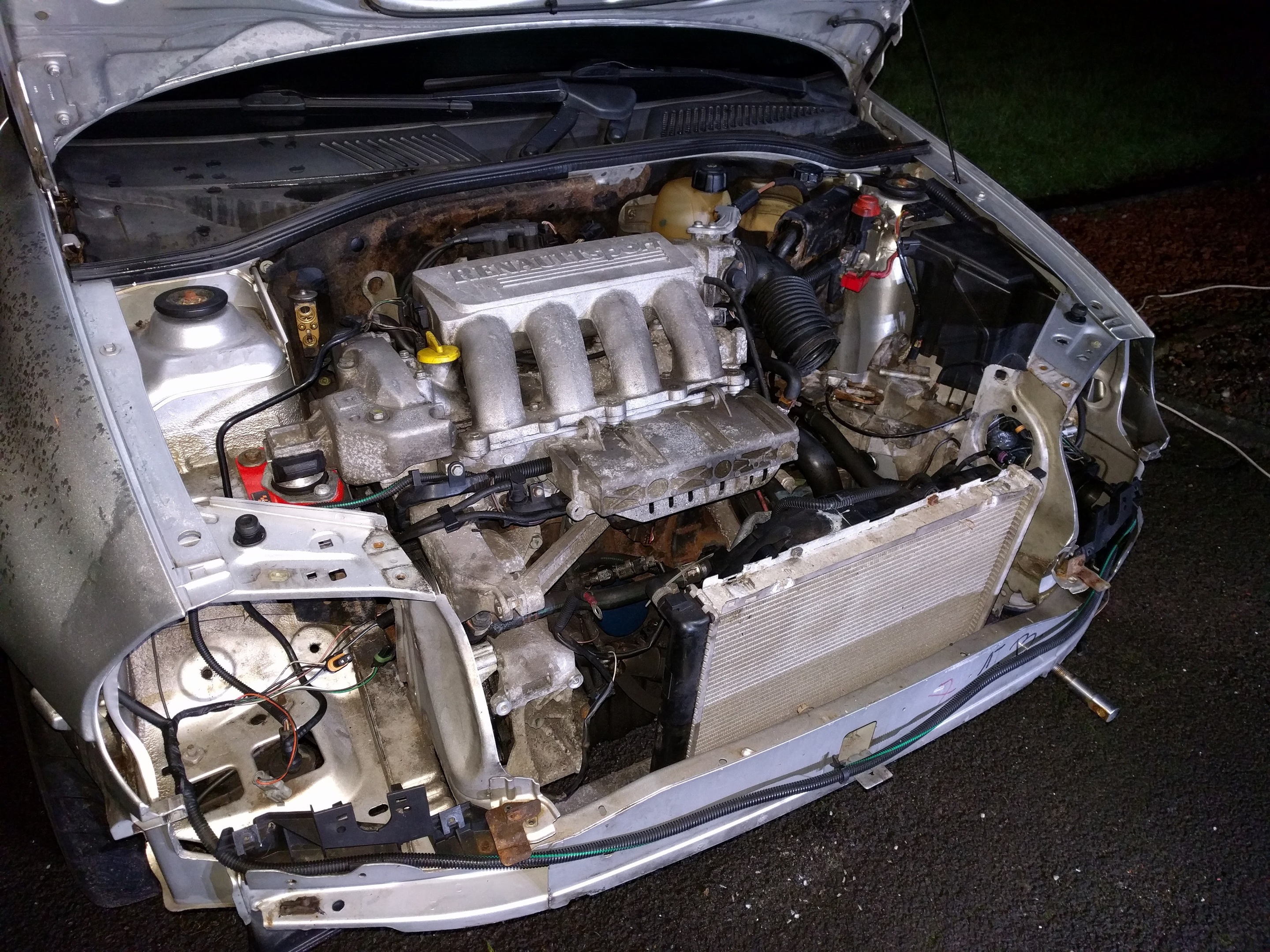

Little bit more progress again last night. Coolant drained, radiator off and hoses moved out the way. Need to get some way of looping out the heater matrix when it goes into the new shell.
Got all the wiring disconnected too ready to lift out with the engine. Thanks @Fraser.J. for pointing out the easier way to do this!
Hoping to get this Friday afternoon spent painting the engine bay in the new shell. Once that's prepped it'll be time to start building it back up. Get the subframe and stuff back on and swap whatever else over that I can while the engine is still in there.
