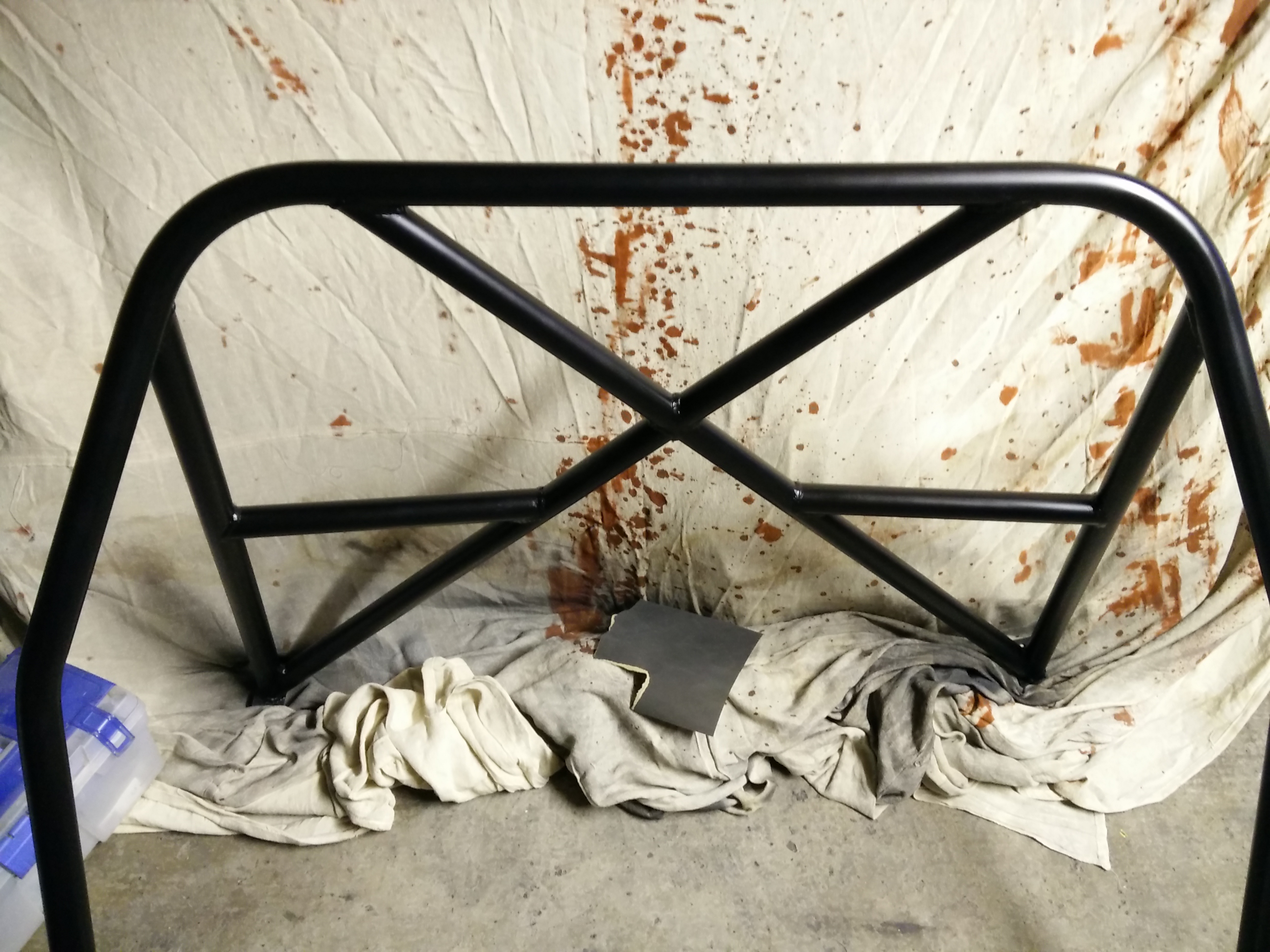

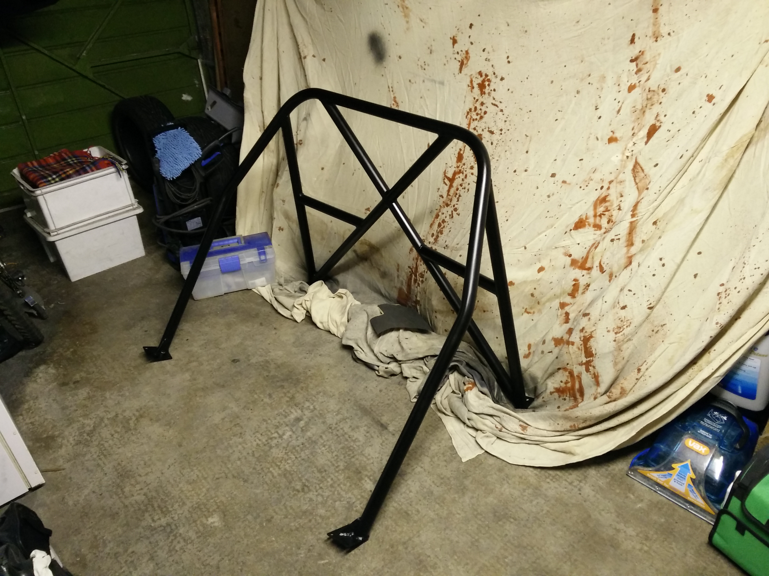

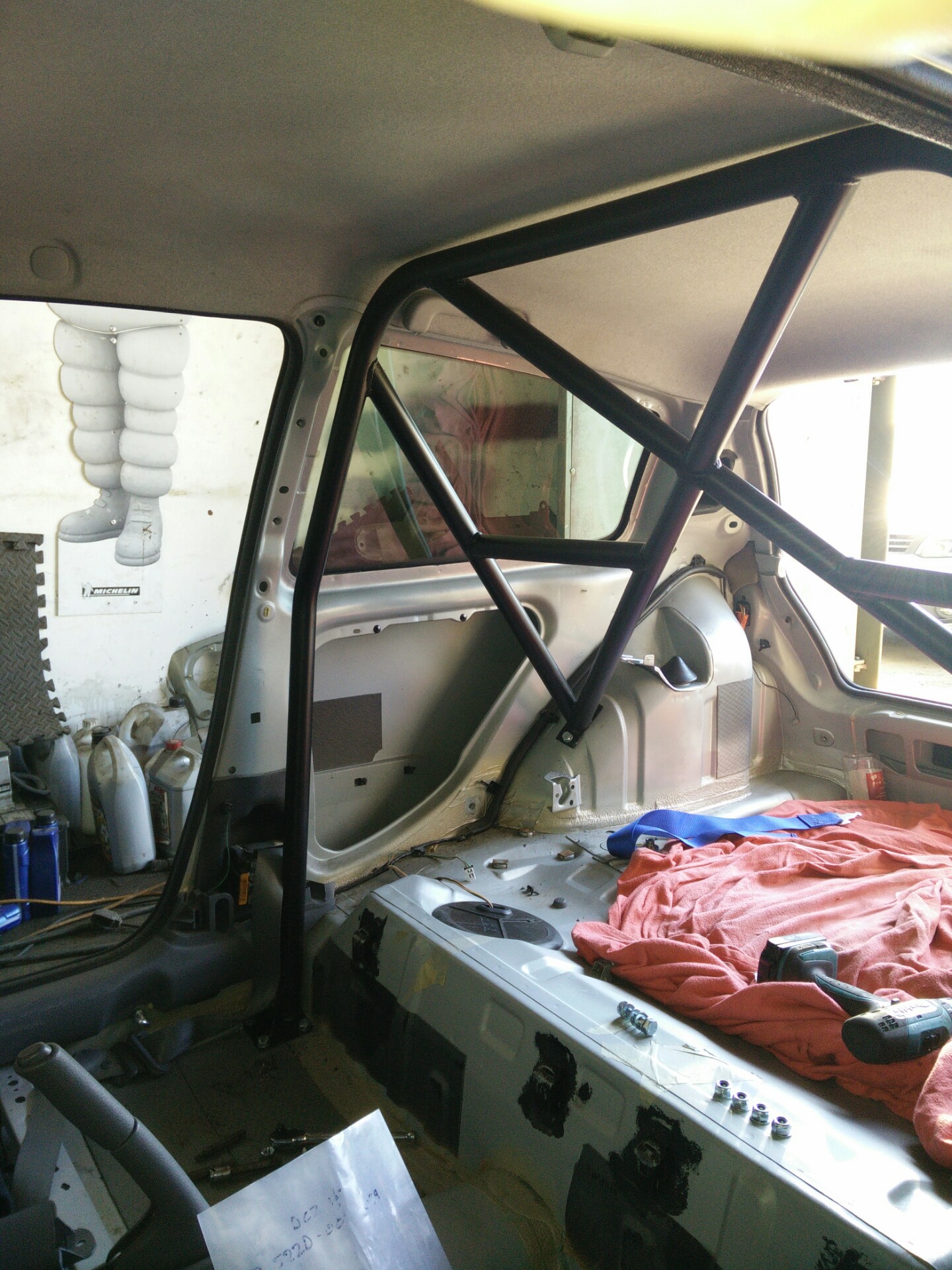

Cage painting complete! Just need some steel plate and bolts to get it fitted now.

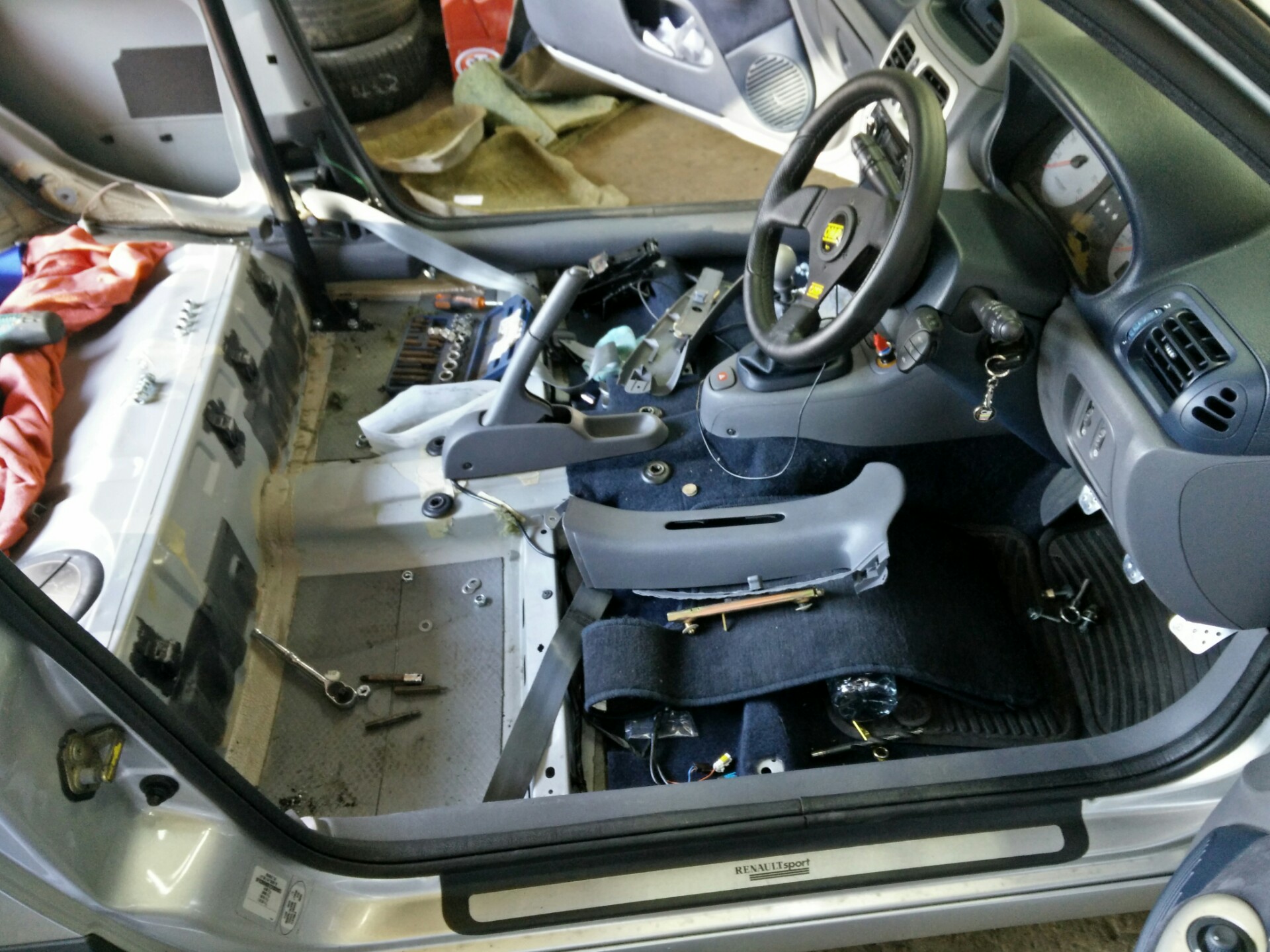

Also pulled a seat out to trial fit my subframes and buckets (passenger side to keep the car mobile lol) but quickly found a shortage of bolts, so that plan died. Gonna hopefully go get some bolts tomorrow morning and try again.

Stu can you stop showing me up by doing such a nice job on the cage.
Looking good matey. Damn I need more funds to put in to mine.

Something like this for the inside to bolt through the subframe and car, M8 size:
http://m.ebay.co.uk/itm/191385019719?nav=SEARCH&varId=490498082684
Also depending where you attach the outside eye you might need the following:
http://m.ebay.co.uk/itm/Seat-belt-harness-eye-bolt-metric-M10-x-1-5mm-thread-/260680326084
Failing this just bolt them through the car with spreader plates I guess [emoji14]
Cheers bud, that's perfect! Single M8 ones are out of stock though. Typical lol! May just buy the pack of 20 and sell the rest on...
Lol, give it a few weeks, there was zero prep work done on that cage so I'm fully expecting flaky paint after a while [emoji23]
The seats are the only thing I've really put a decent chunk of money into, well, and the coilies but they were too good a deal to pass up lol. Everything else is extremely slow progress and buying used things. Hard to believe I've had the car nearly 7 months now [emoji33]

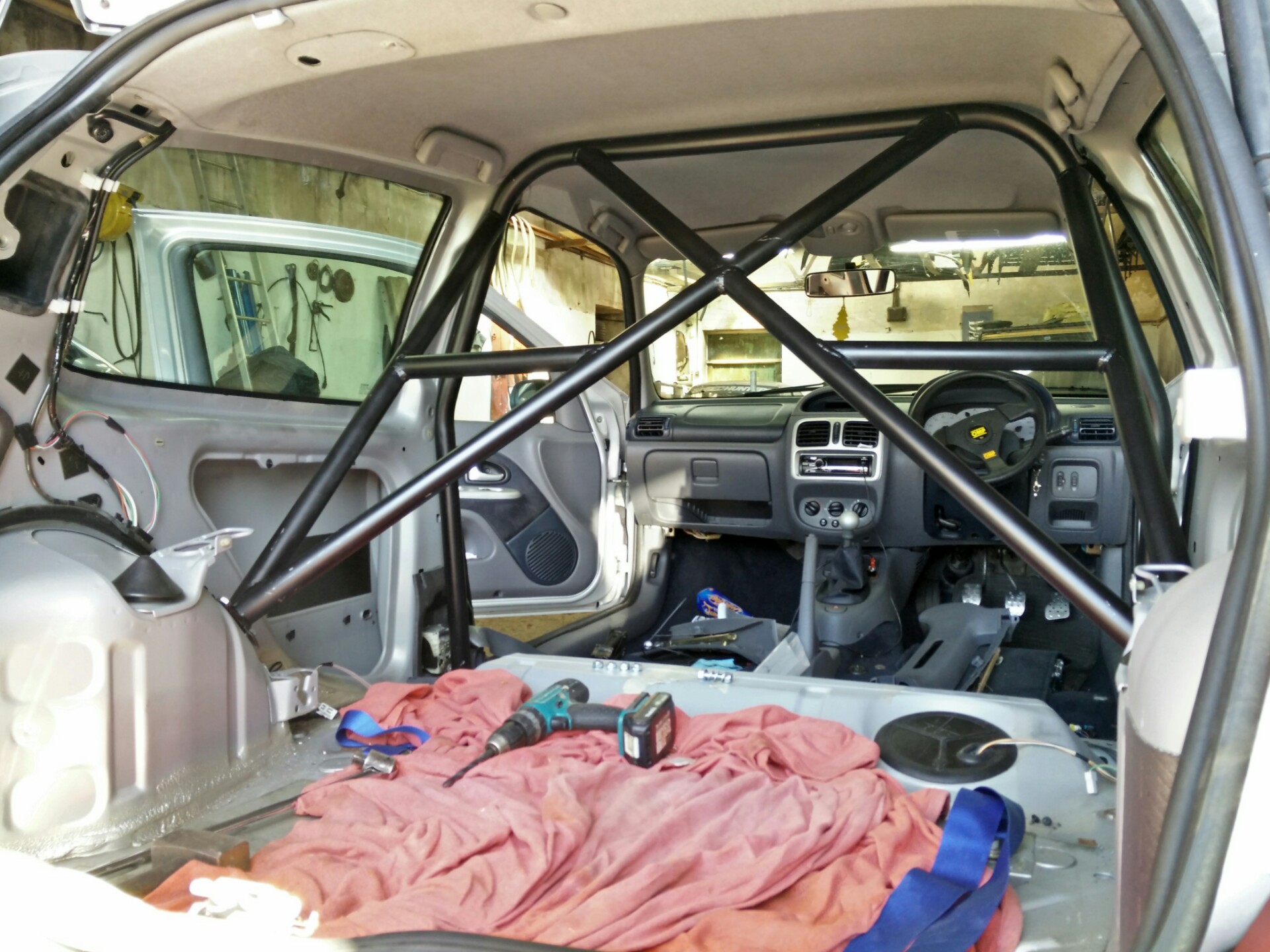

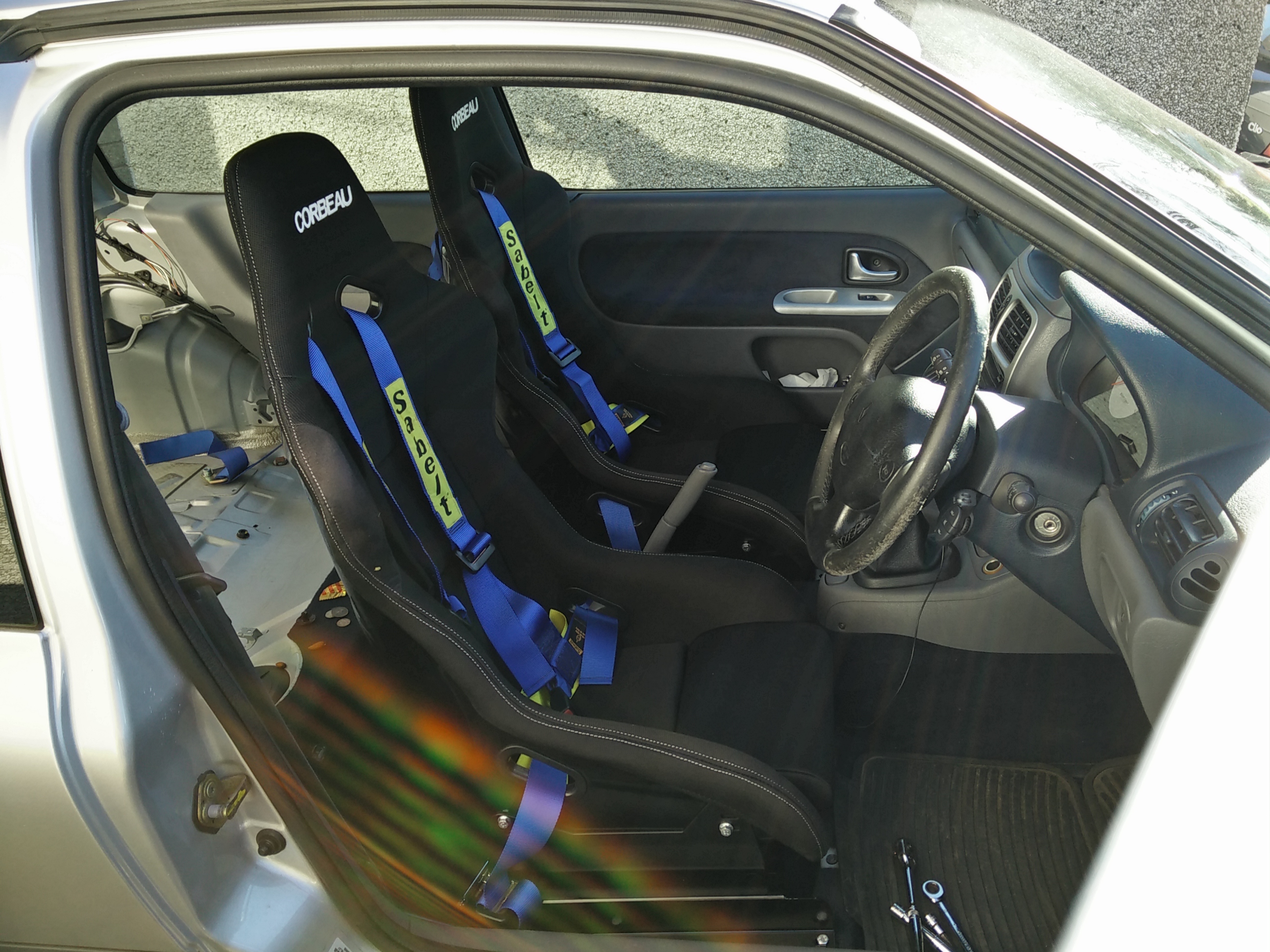

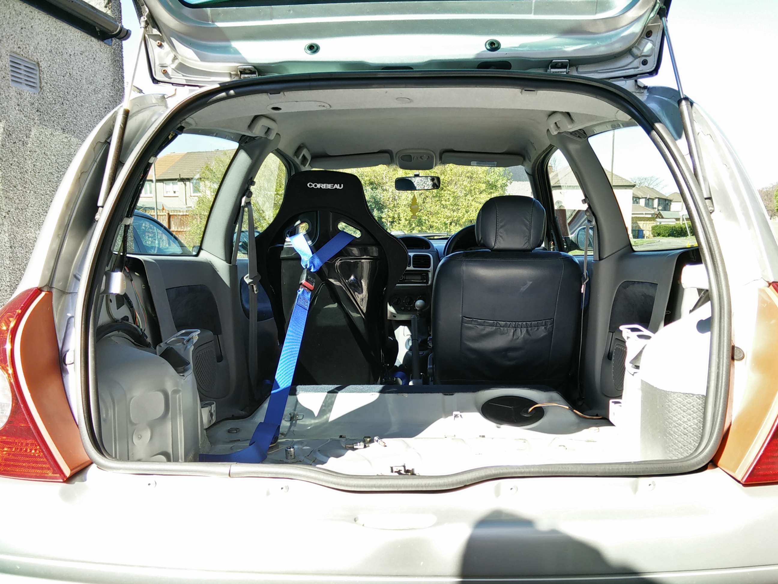

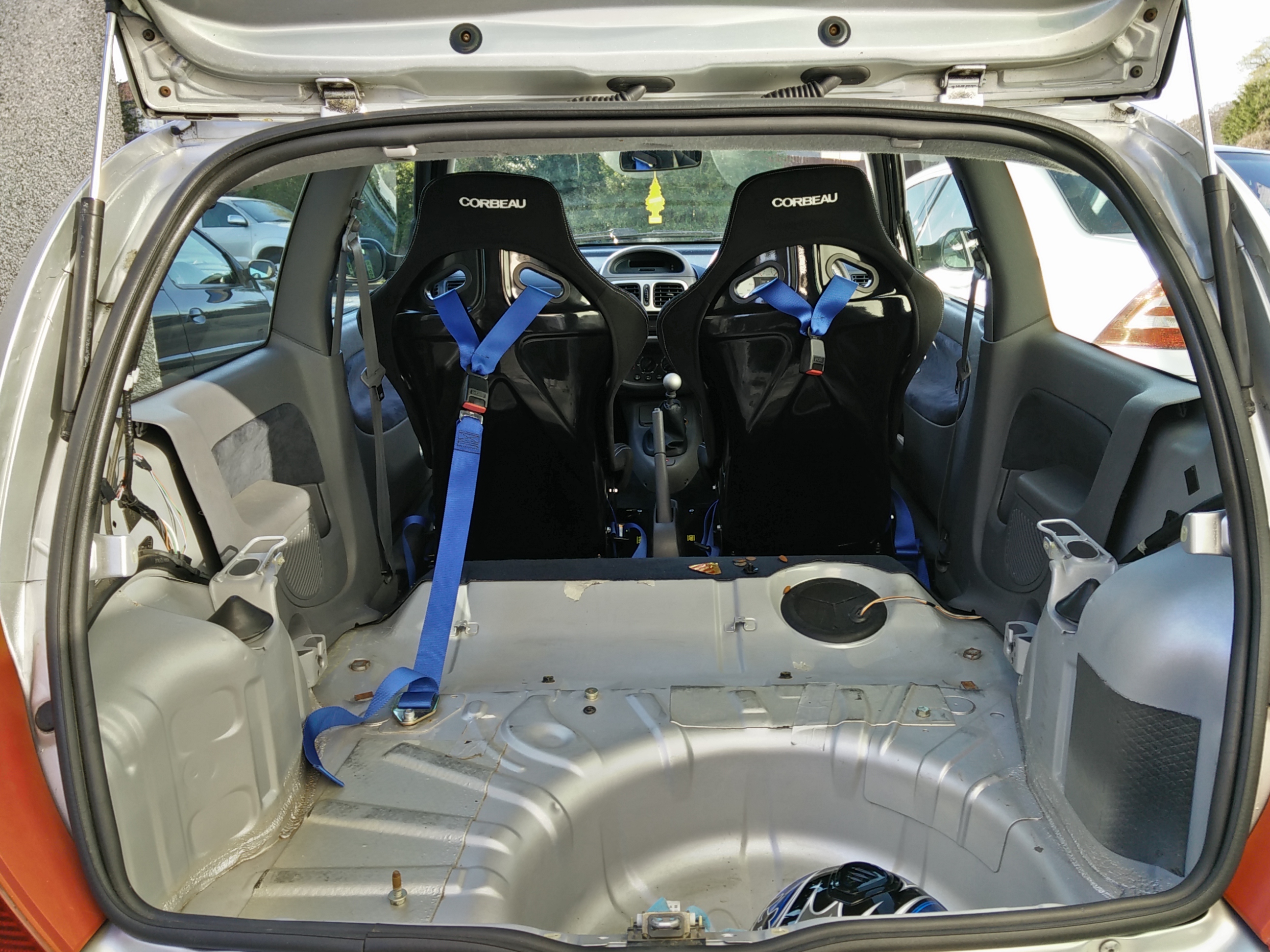

Today was a pretty lazy day. I fitted my seats and gave the car a hoover while I had the old seats out.
I tried to get the cage in place for bolting next week but that was a total disaster. I'll need to take out the carpets and stuff anyway which I didn't really think about when I was trying to squeeze it in!
Seats went in easy though, got M8 bolts this morning from an engineering company down the road from me and cracked on. My only issue now is that the subframes aren't sitting flat. I think I'll need to space them up with washers or something.
Anyway, some pics!
Passenger side trial fit...
And both in
Can see there that they're not sitting flat.
I love the height of the seat now. Its pretty much perfect IMO. Maybe needs tweaked a bit on the subframe as it feels like I'm sort of facing the clutch pedal, so makes reaching the accelerator a bit awkward feeling. Hopefully just squint on the subframe though. Or may be because its not sitting flat.

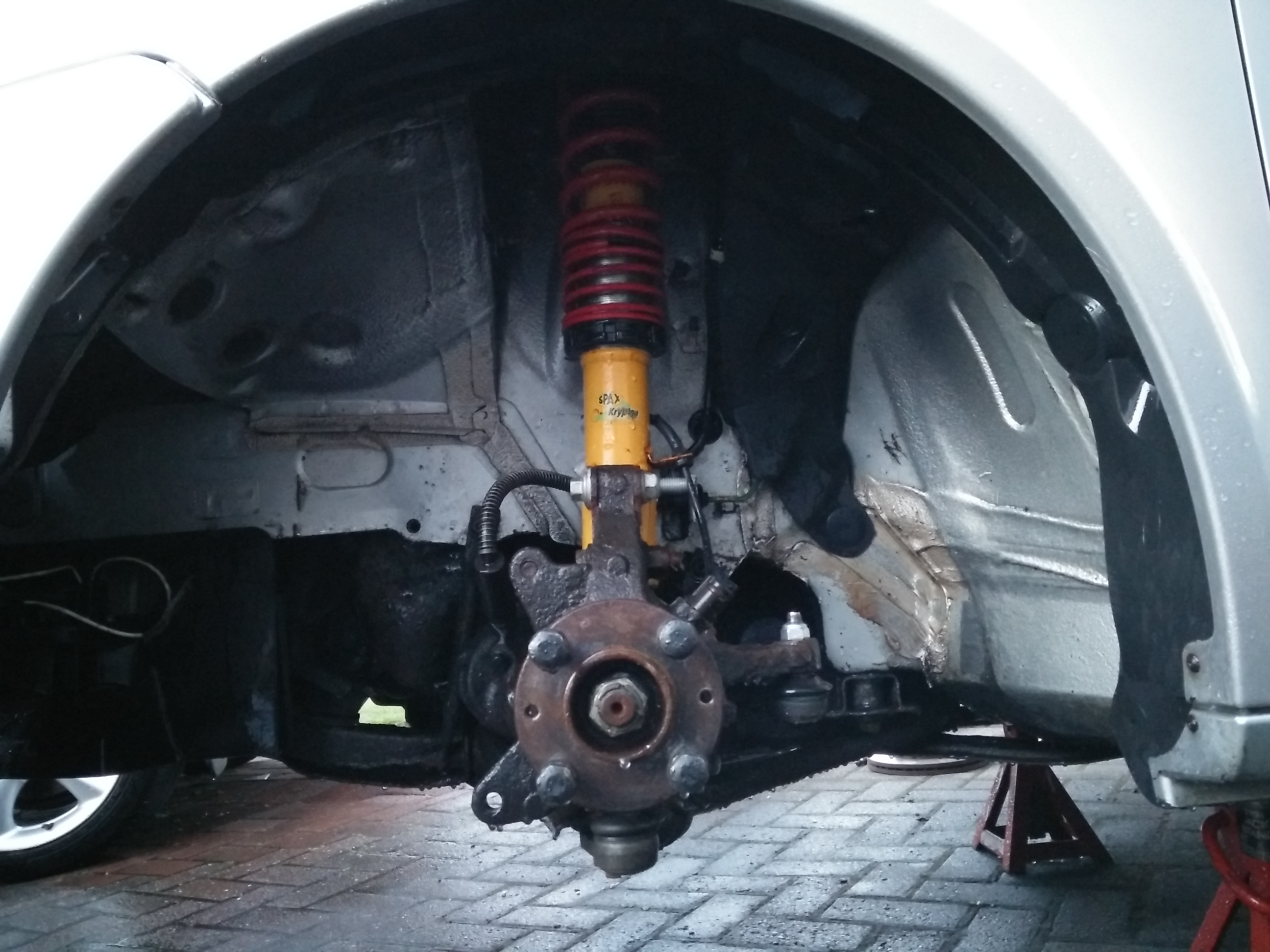

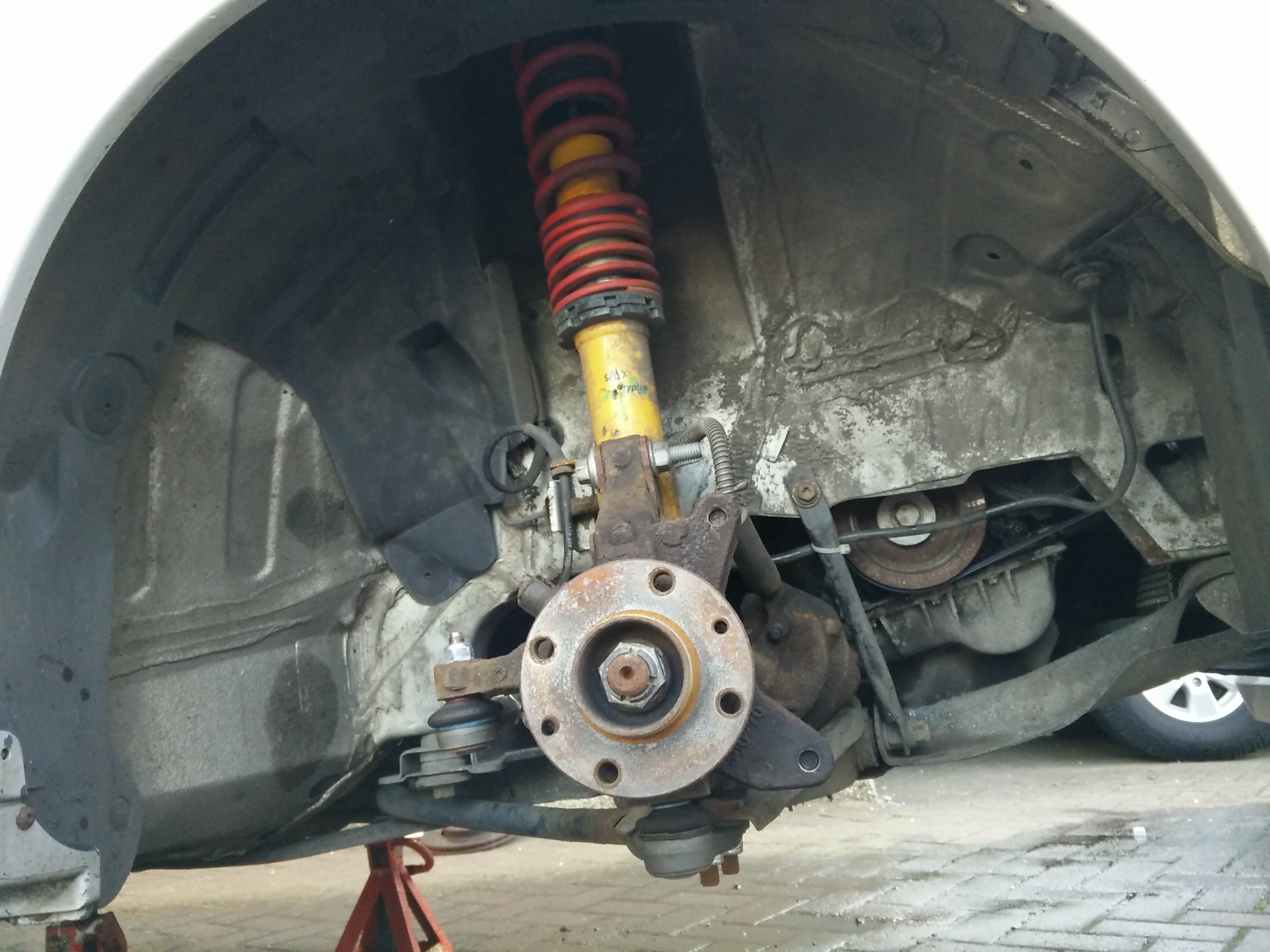

Done some more today. Straightened up my bucket seats. Needed to remove the spacers below the seats on one side to level things off. Eye bolts and everything also arrived today so my harnesses are now fitted in properly.
Made epic progress on my driveshaft replacement too. I've now loosened one more nut and bolt! Successful evening if I do say so myself lol.

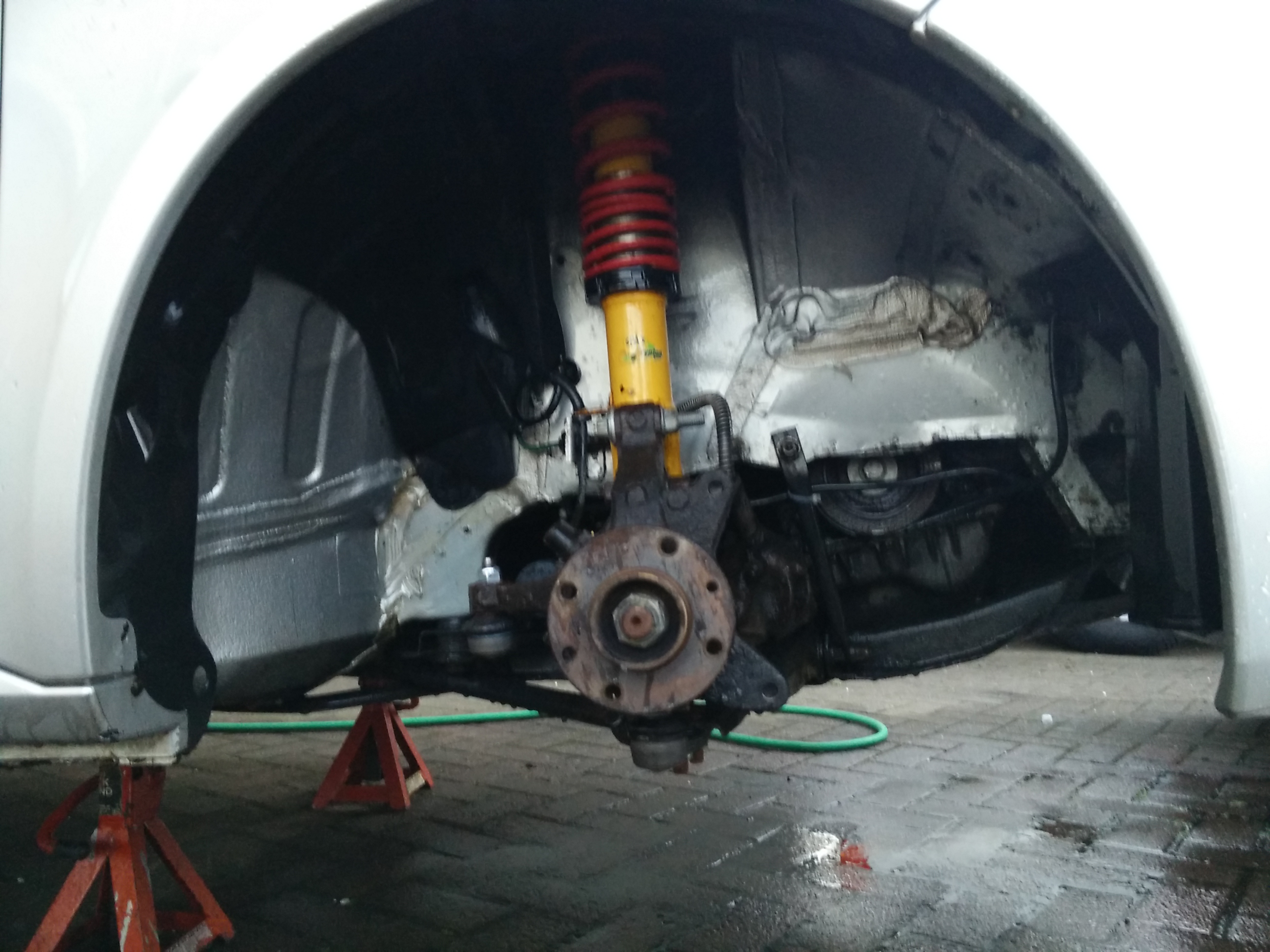

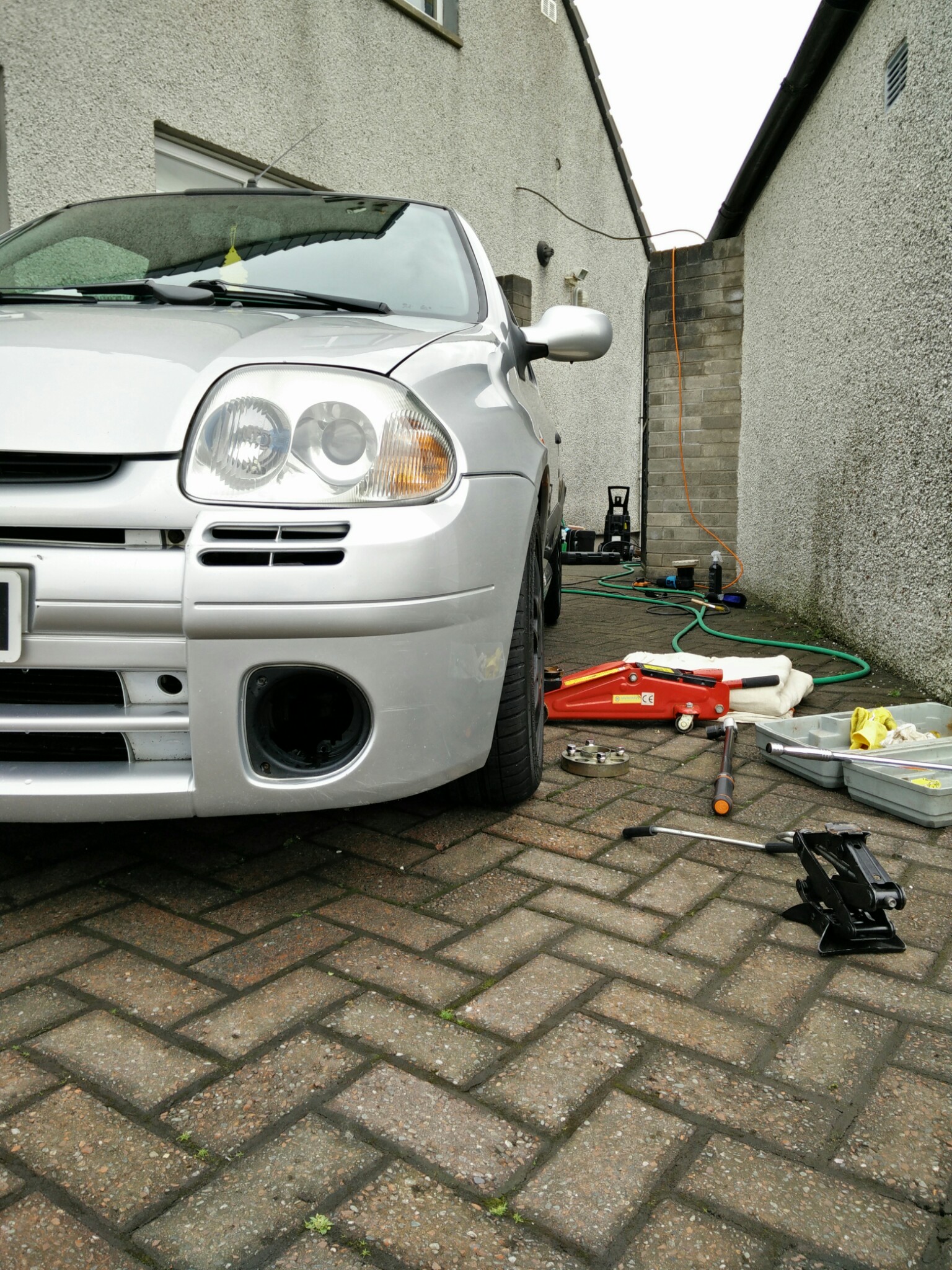

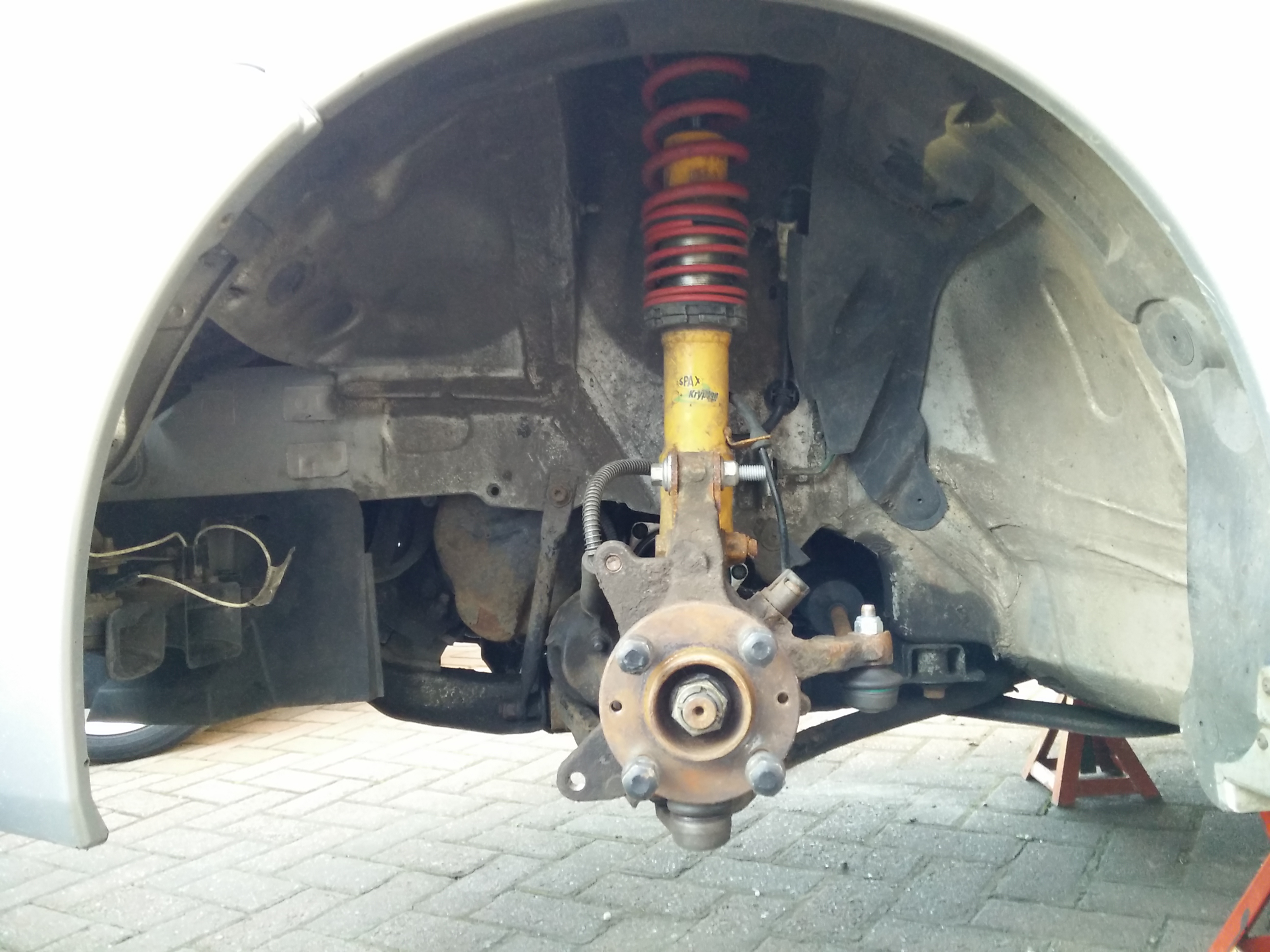

Ordered some Brembo HC discs from George today too, so took my old discs and pads off. Sliders were sticking on the calipers so freed them up and greased them. Temporary measure until I fully refurb my spare calipers, but it at least means the new discs and pads should wear evenly for now once fitted.
Then I got bored with doing real work and decided I wanted to clean up the arches while everything was stripped off.
Went from this
To this
And the other side...minging...
Clean!
Not perfect but I couldn't be arsed going too mental on them. Attacked the grime with some Auto Finesse Verso, rinsed down, then covered the lot in tar remover (Autobrite's Just The Tonic). Will probably IPA the arch liner plastics (or what's left of them) tomorrow and give it a coat with whatever I can find that's suitable.

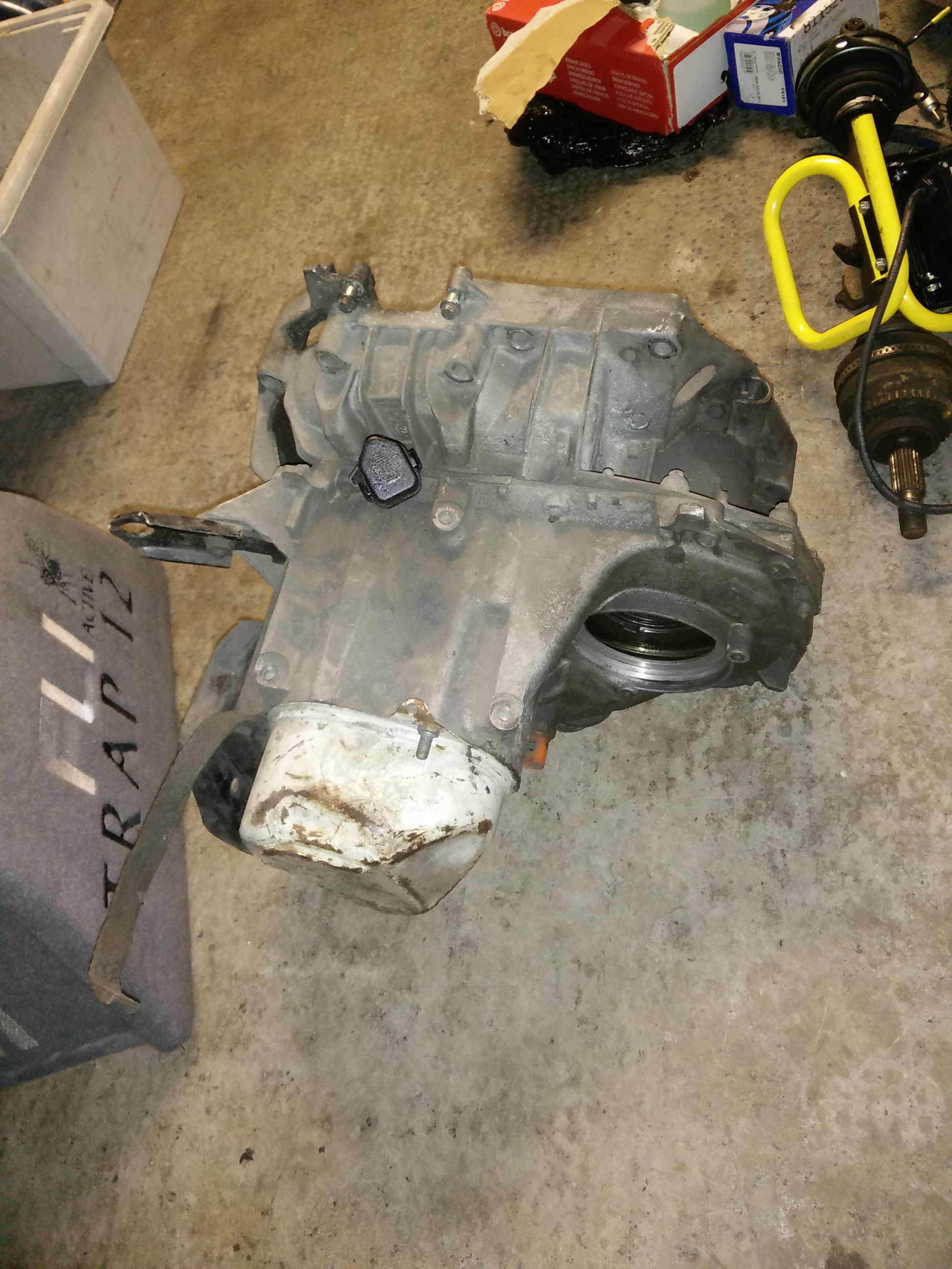

I has acquired another gearbox....
Its a JC5-120 and I have absolutely no clue what car it's originally from, but it has a circlip diff in a better condition than mine, so I'll be swapping that part out tomorrow.
sburrell93
Scotland - South
Only need 4 gears at knockhill anyway 😂😂
This is just essentially the same box as the ph1 but with a couple of different ratios. 1st and 2nd are shorter, and 4th and 5th are longer. Think its possibly a diesel box, maybe from a Clio dci or a kangoo or something. Will at least get the car mobile again!

interesting to see how that works mate....
Won't be using the whole box so no changes to the ratios but I hope that me mucking about with the diff holds up lol.

Good progress sir, Have fun with the box, they are a right pig to take apart and put back together unless you do them everyday.

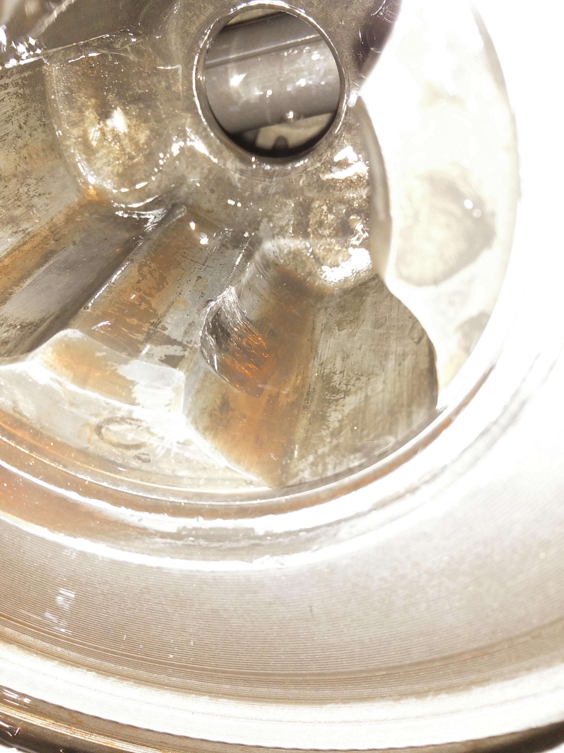

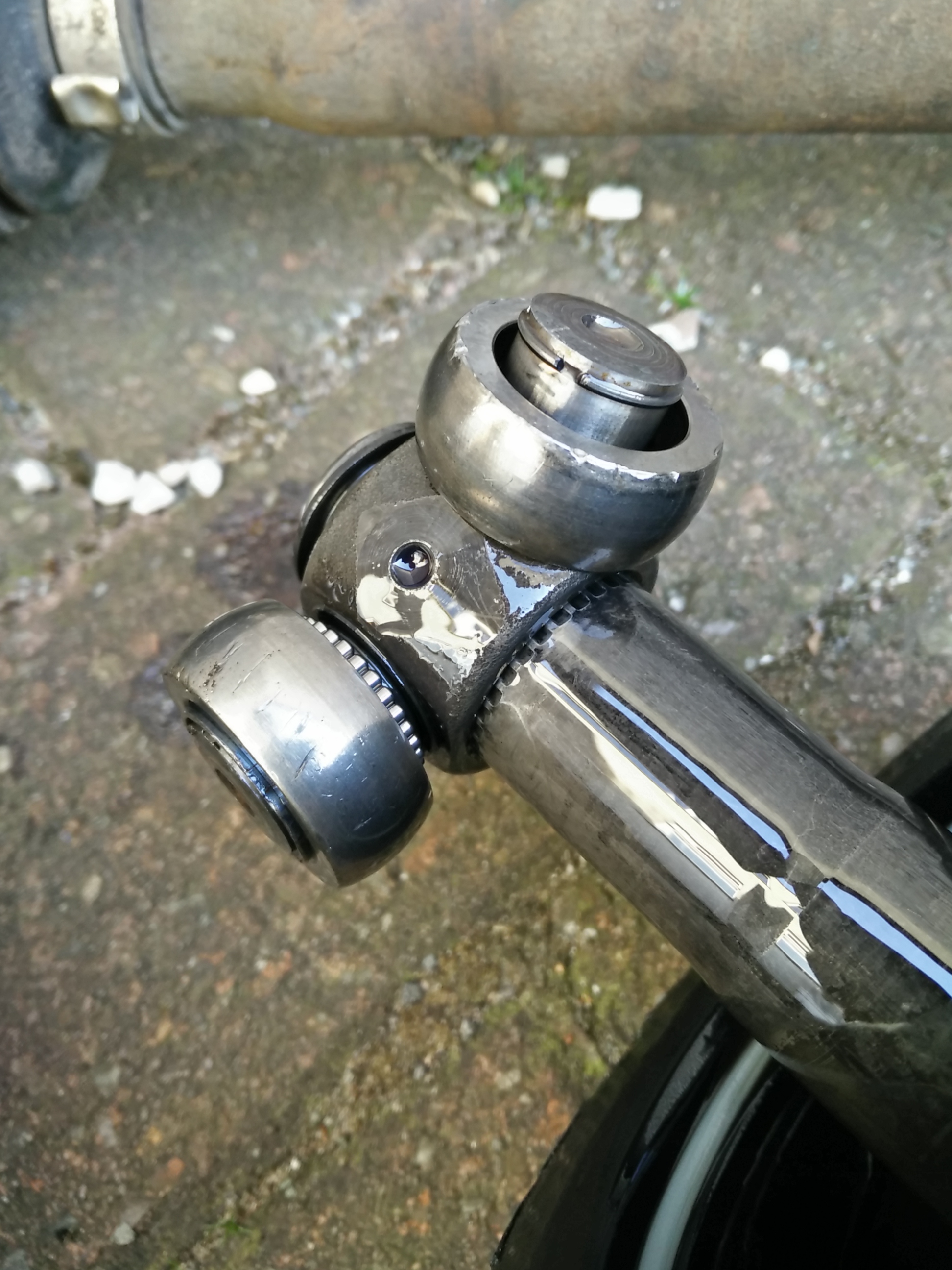

Today has been a long ass day! Acquired new gearbox yesterday, attempted to remove diff cup today. Tried, failed, gave up, and decided to fit another box.
So thanks to @Fraser.J. and @Stu. I got a new box fitted tonight, and all is well again. Got the box out in under 2 hours, and the new one was pretty much back in in the same time but the steering was notchy as hell and felt like it was catching when it all went back together.
Think the rack had twisted a bit, so some further playing with that and it was sorted.
So yeah. Car lives again! In amongst all of this I actually fitted some new front discs and pads top. Will dig through photos of everuthing tomorrow and fire them up when I get a chance. Everything can get to f**k just now though, I'm knackered and going to bed 😂

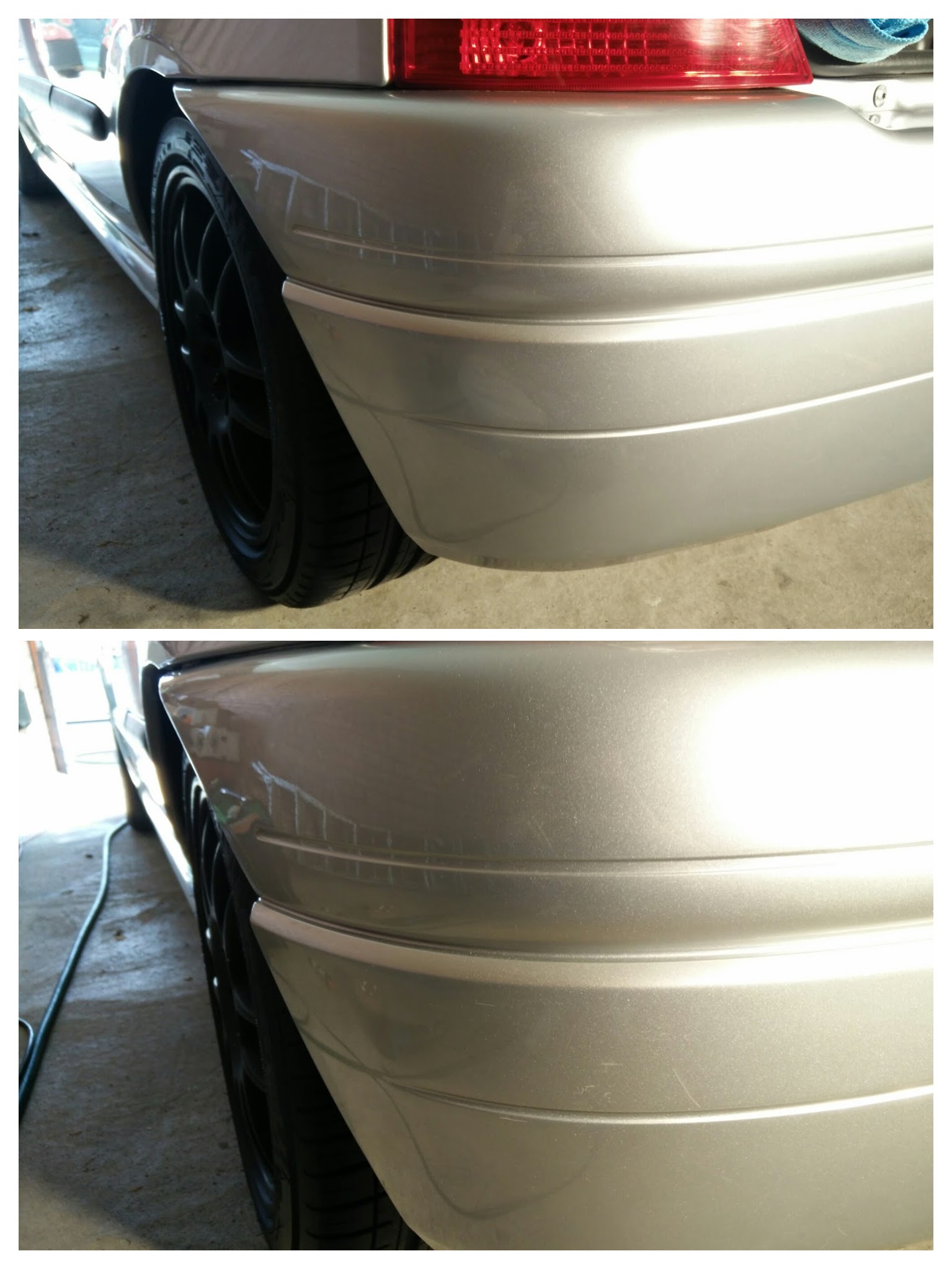

Been a productive week this. Gave the car a proper clean and decon on my bank holiday Monday there. Starting early with the Scottish Car Show prep work lol. Was minging! Tar remover, iron x, the lot...was still a mess afterwards so attacked it with a clay mitt and eventually got it clean. Seemed like it'd ever been properly decon'd in its life!
Note...DO NOT use a clay mitt on areas that still have tar remover on them! Ruined the mitt, and it decided to leave half the mitt material on the car! Came off mind you, but still scared me a bit.

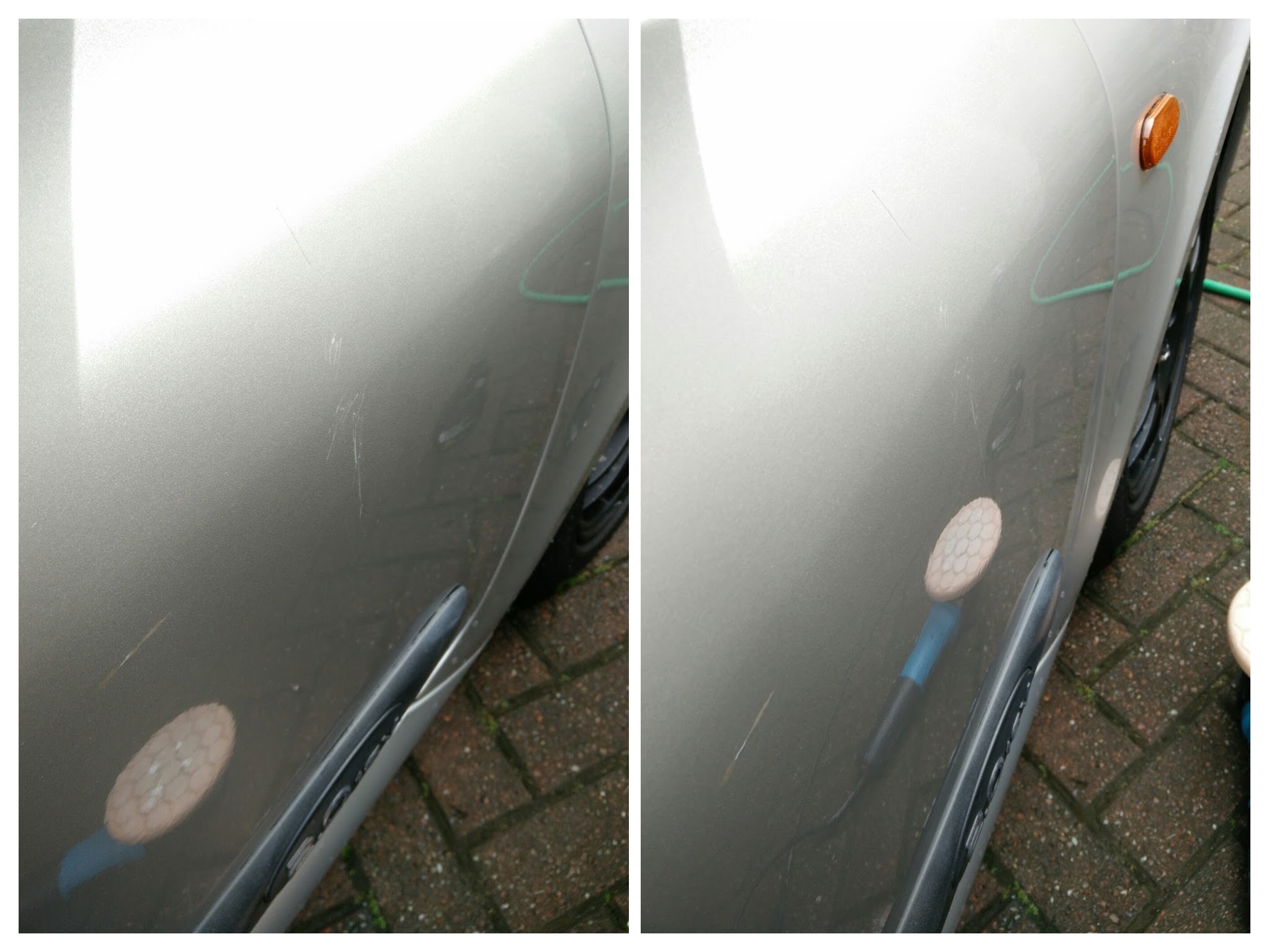

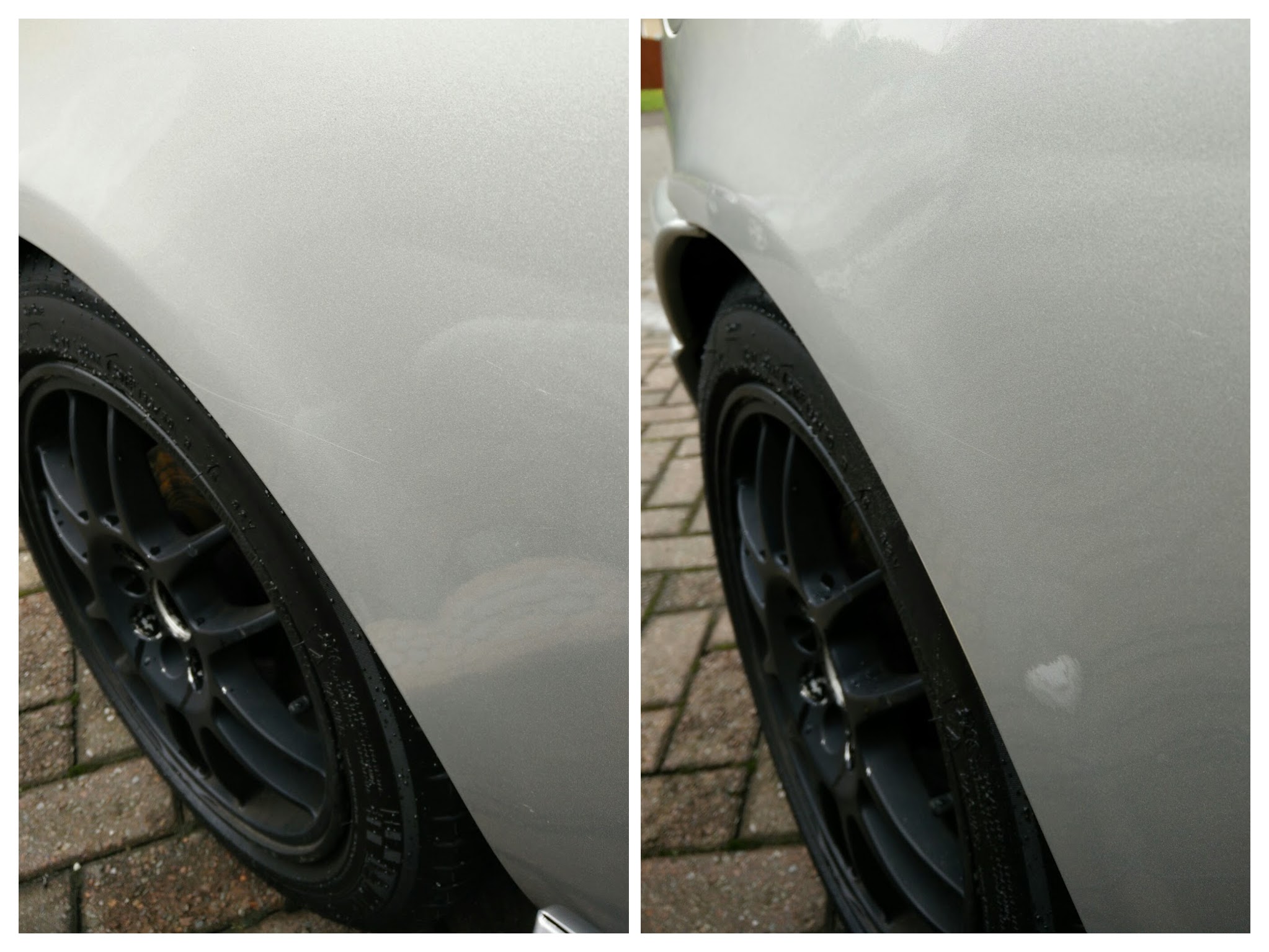

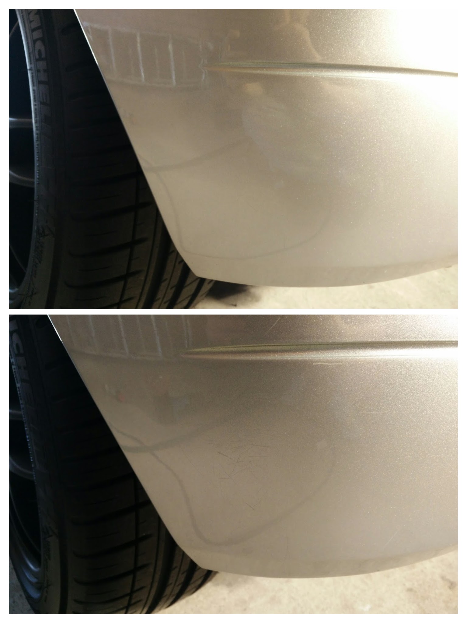

Also tackled a few scratches (of which it has MANY) with the machine polisher. Came up fairly well. Anyway, photo wh0ring time!
Scratch removal. Google+ decided to put the 'after' photo first here for some reason...
So, done that, some other bits on the side panels, the spoiler, and bootlid. All came up fairly well as far as scratch removal is concerned! Will get it under some harsh halogen lights closer to SCS to reveal the proper issues and get started on swirl removal. For now though it's made an awesome improvement. Lol at detailing a track car though! It's a practice canvas, that's my excuse 😂

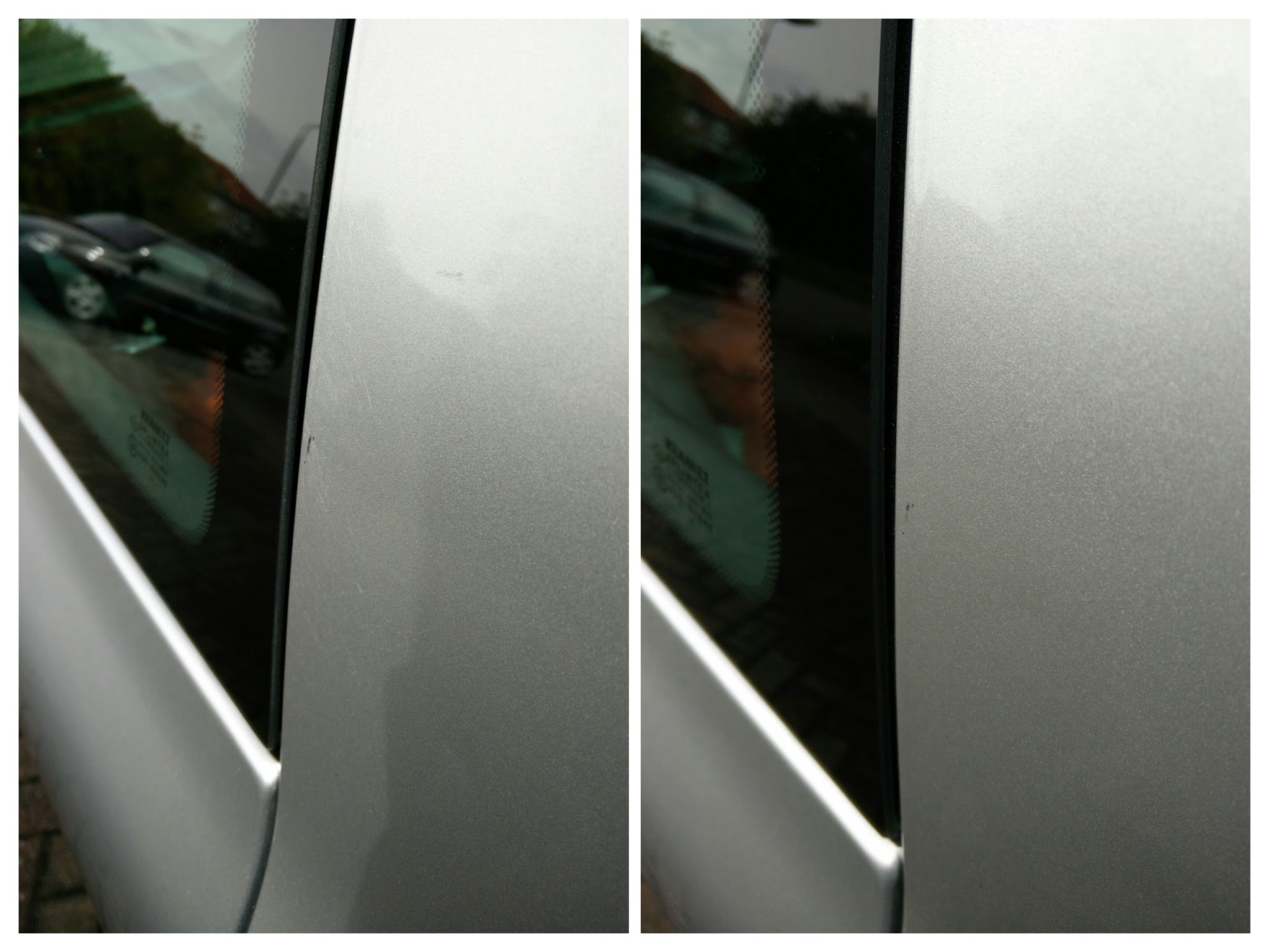

So now this weekend's work. Continued with some scratch removal yesterday afternoon when I got home from work.
This abomination under the mirror was never coming out, but it's been dulled down a lot
Had another go at the scratch from the previous post with some G3 scratch remover. Improved it a little more
Then some marks on the door from rings and keys by the looks of it

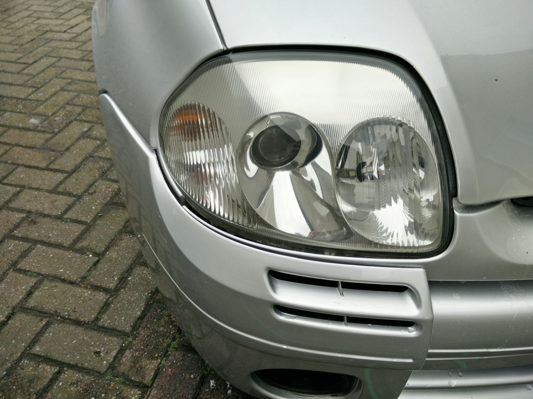

Also gave the headlights a quick going over

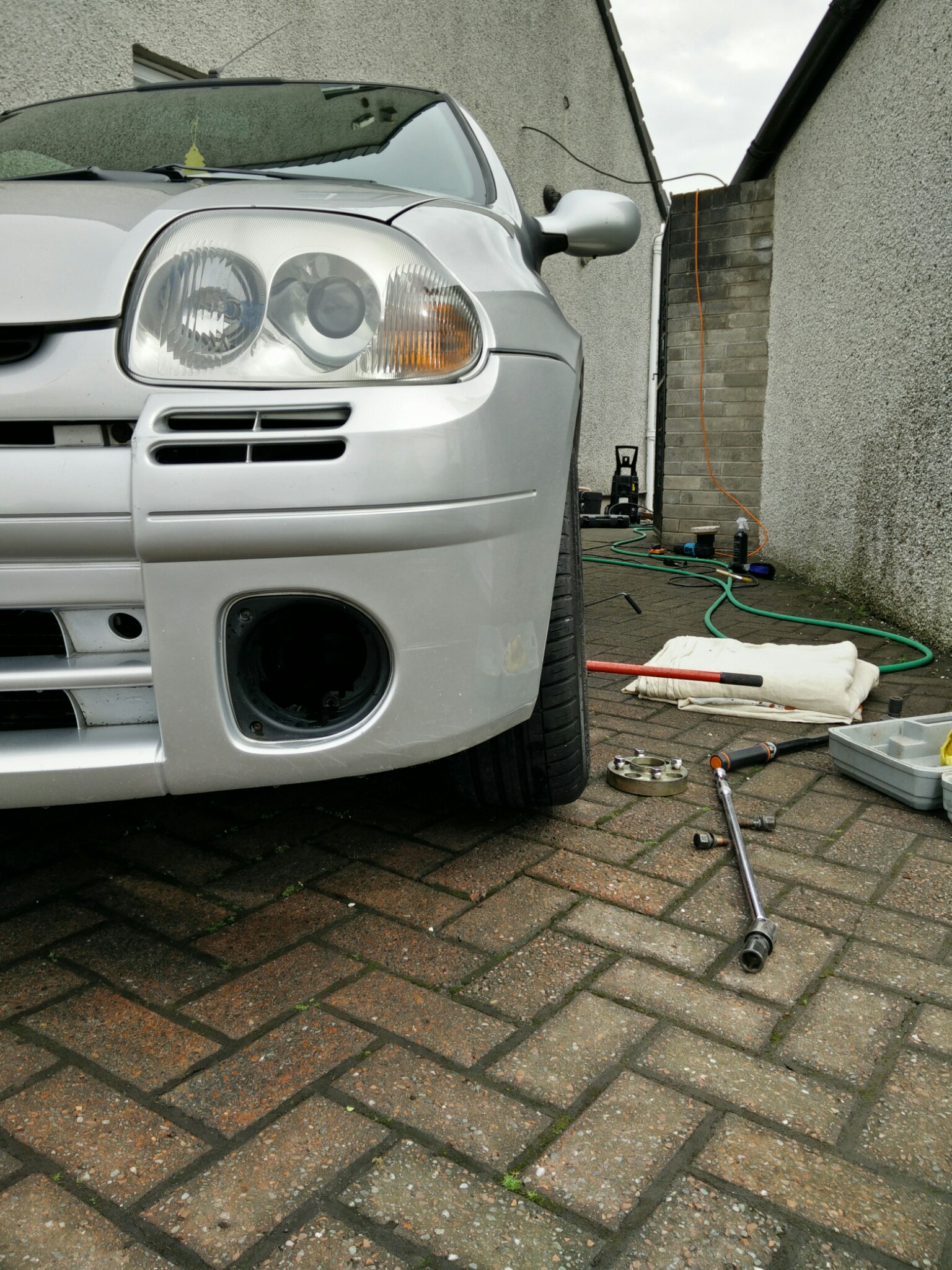

Then I got bored of polishing. So trial fitted my old 25mm spacers I had lying around.
Before:
During. Weird high amounts of camber going on with the car in the air:
And after:
Such an improvement! Will probably sell these and get a set of H&R's or something though. There's a tiny bit of vibration at speed from the wheel balancing not being perfect once they're on and I don't really want that on track. Perfect for road use though.

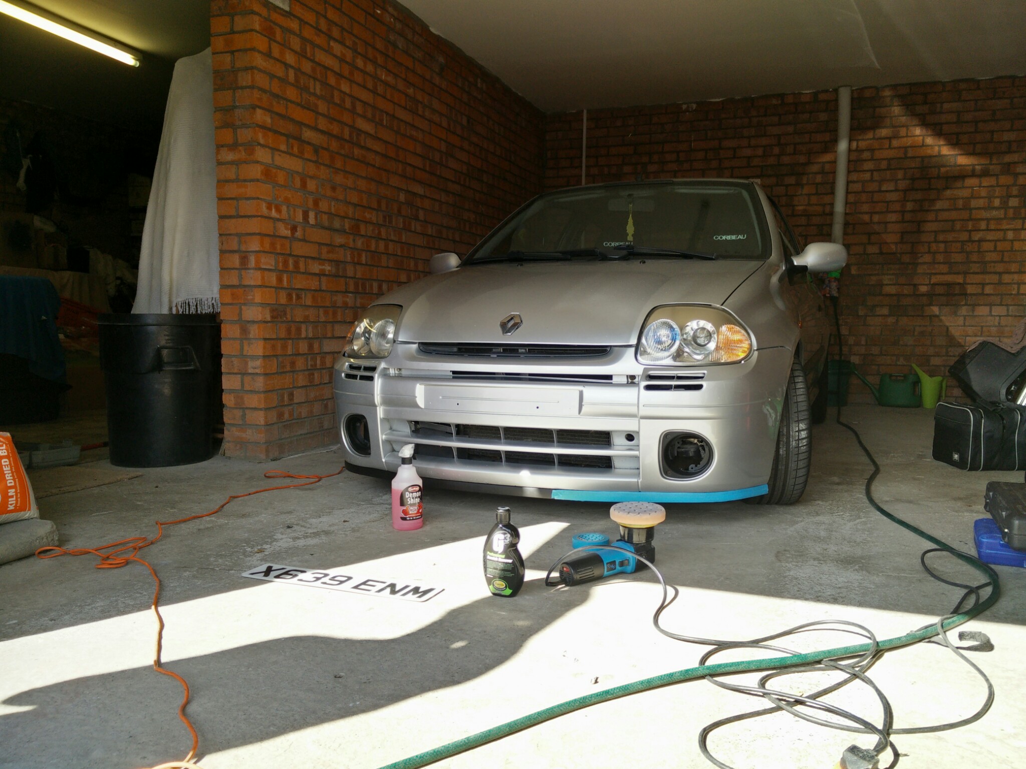

Today, I headed round to @benji93's for some more car things, since he'd just got his back after it being away at a garage for 5 weeks! Got some new exhaust hangers fitted to his 182, then I got mine indoors for some more polishing, and his outdoors for a bit of cleaning.
Panoramic photos ftw
Front end polishing was going well until I caught the number plate and it came flying off...
Although I do kinda like the look of it without a number plate 🙈

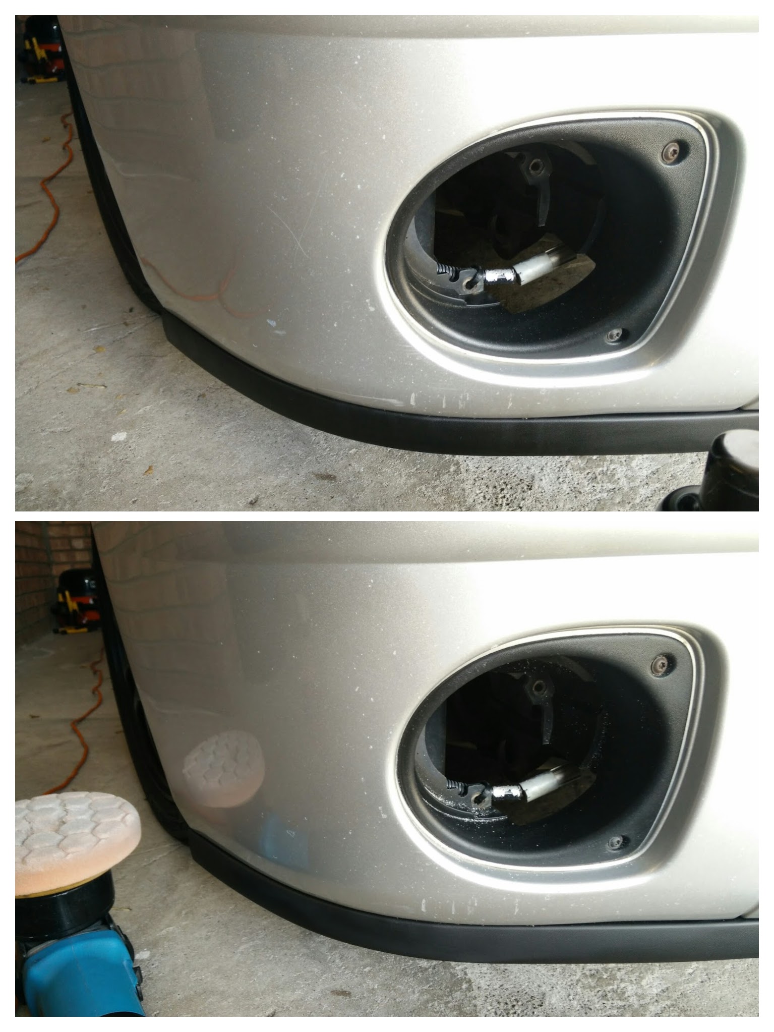

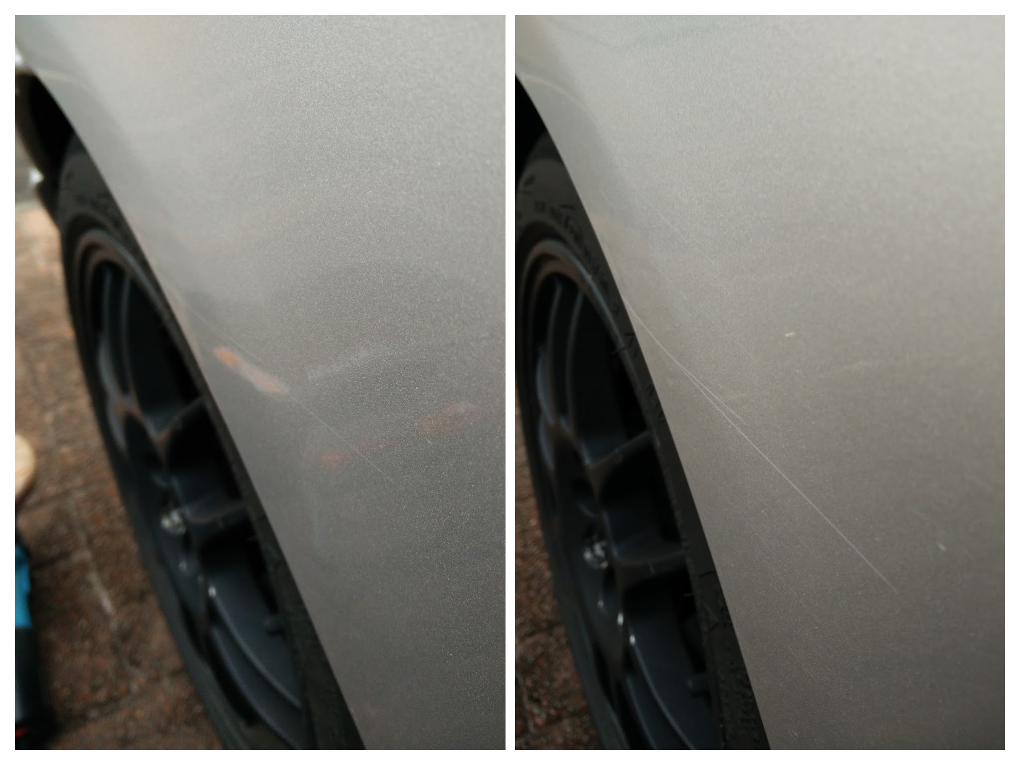

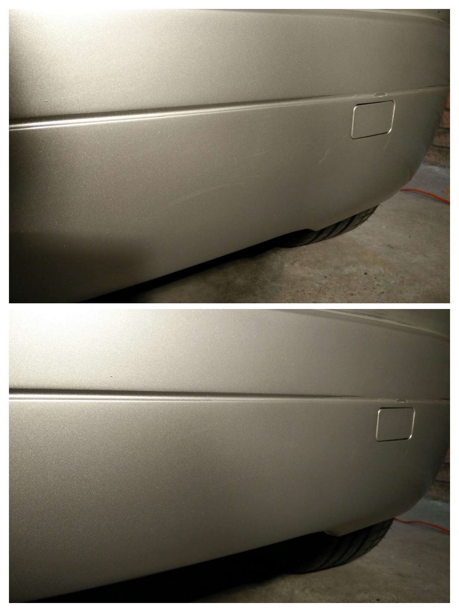

Some more scratch removal shots now.
Front was in a s**t state. Still is, but just a slightly better s**t state...
Back bumper came up well though. Before and after photos are all mixed up again here
That's about it for now. Looking no bad for a 15 year old sub £1000 car!

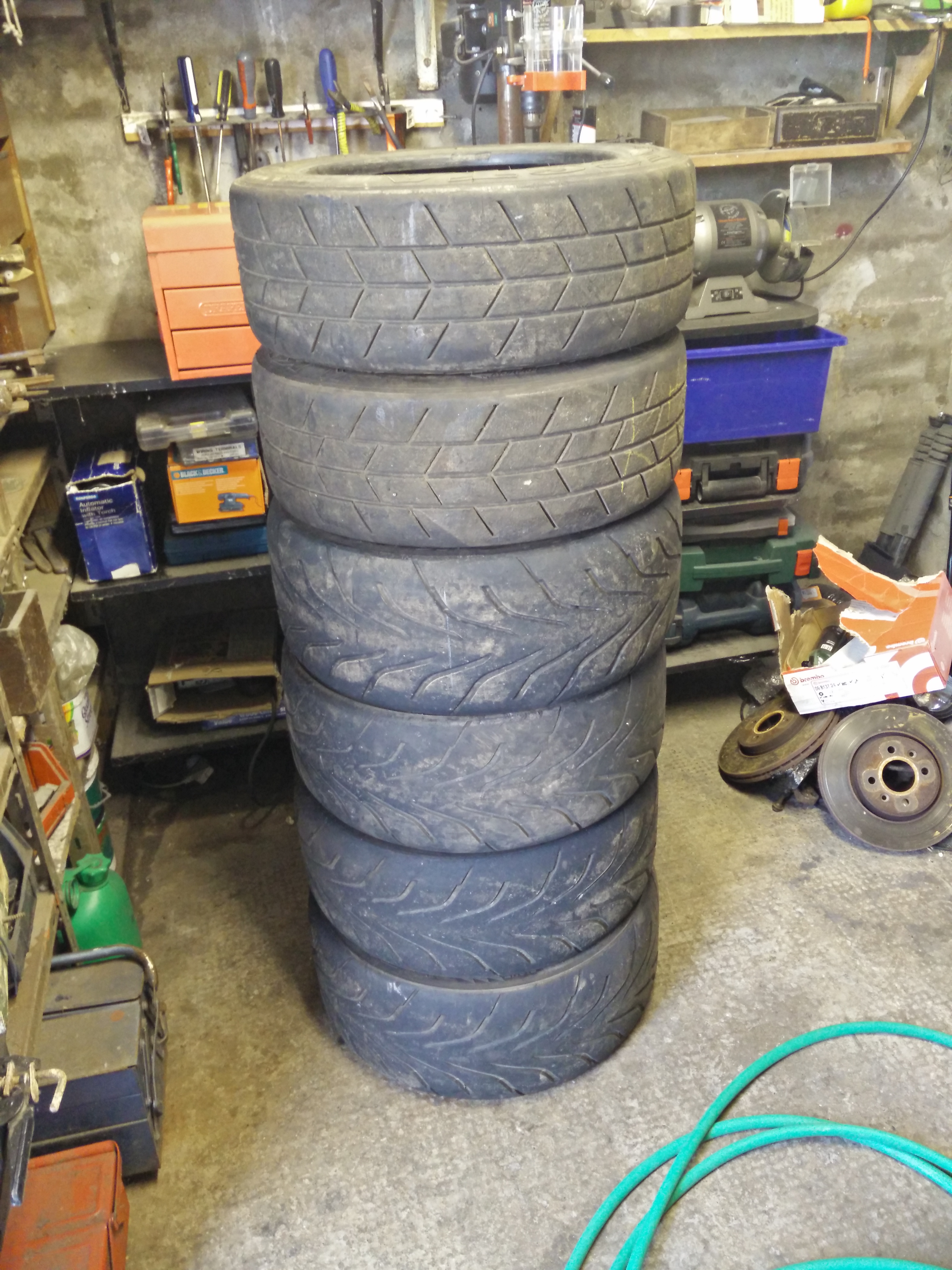

Got some track tyres last night
Set of R888s and a pair of kumho's supposedly used in the clio cup series. Couldn't pass them up at the price, so might try and find another pair and that'll be 2 full sets I have.
Gonna put the R888s on my old 15" dci wheels for now though if they fit. 205 width of a 6.5j rim could be interesting.

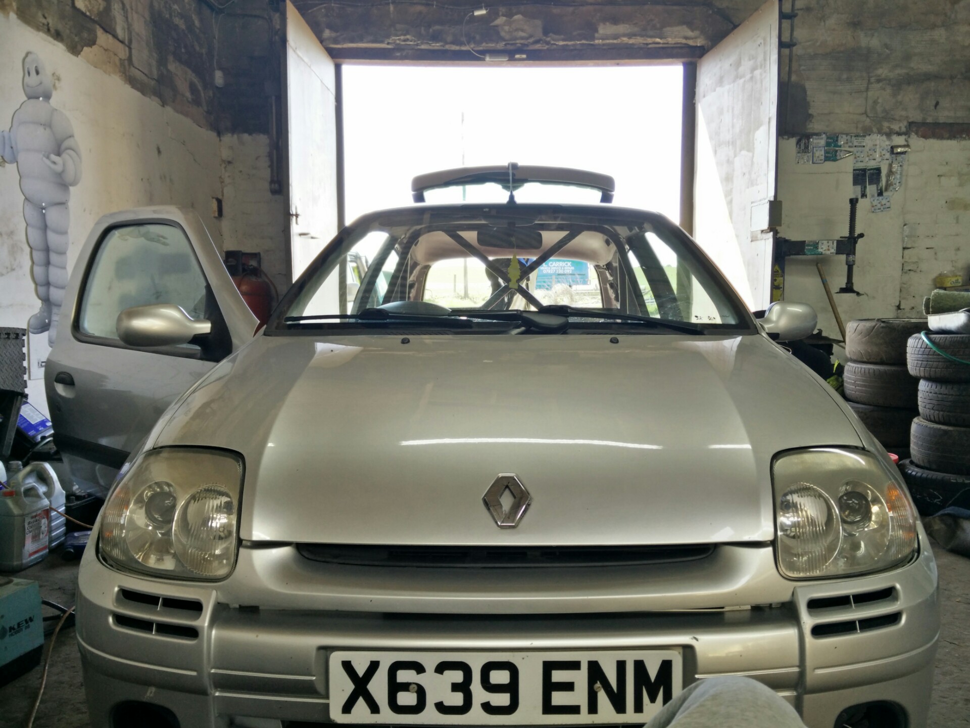

Fitted cage today. Became 10% more racecar.
Still have all the tar to remove :(
And another photo I found quite cool for good measure
Put my R888's on wheels too. Productive day. Just brakes to sort and book up for friday. Oh, and get spacers so the R888's will clear my coilovers.
