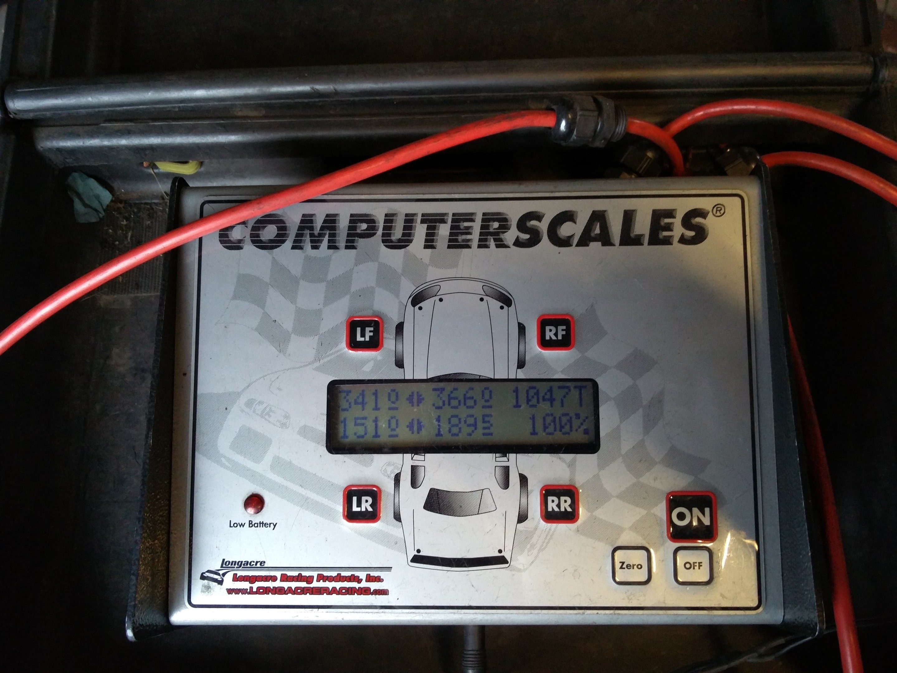

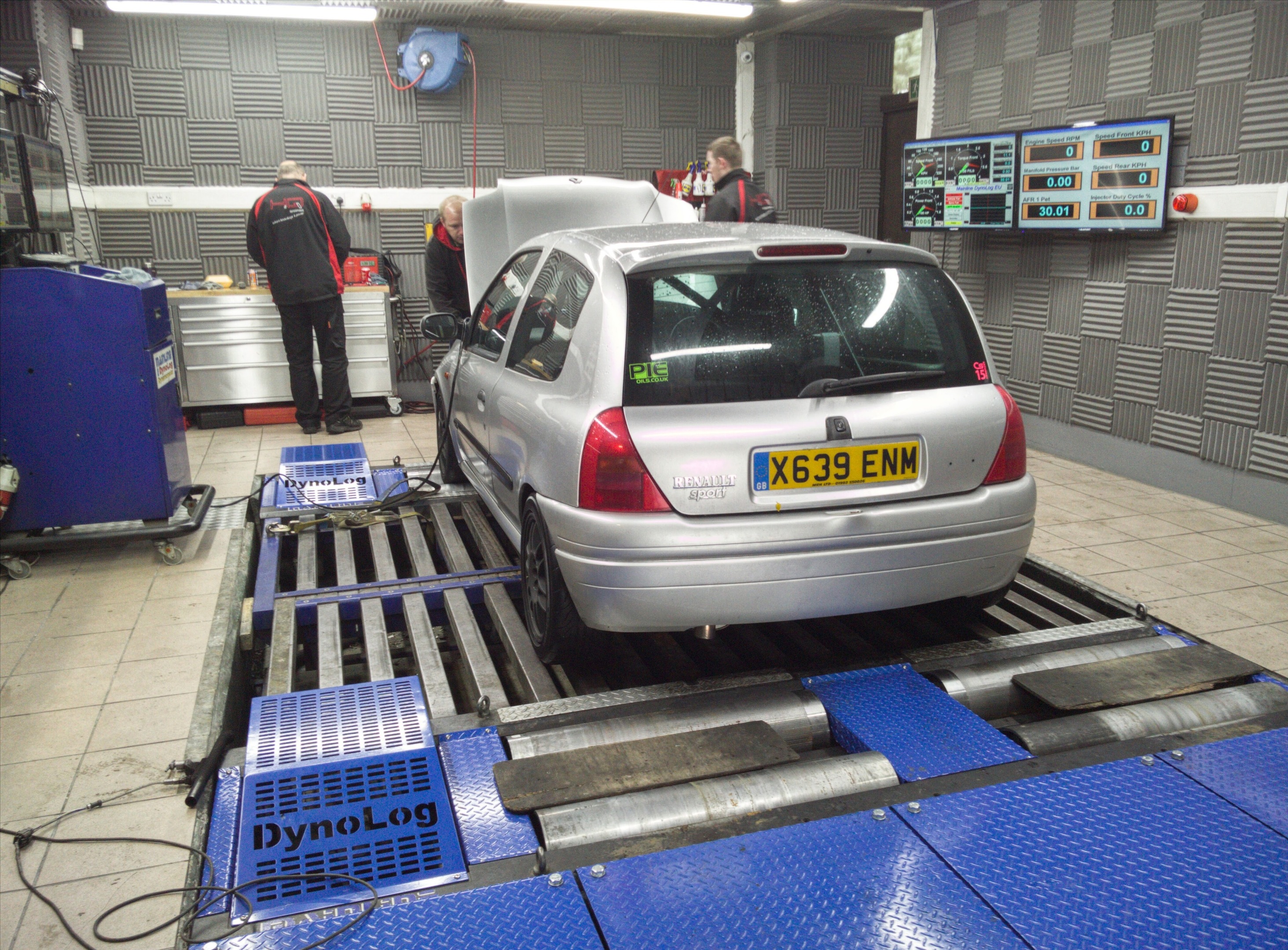

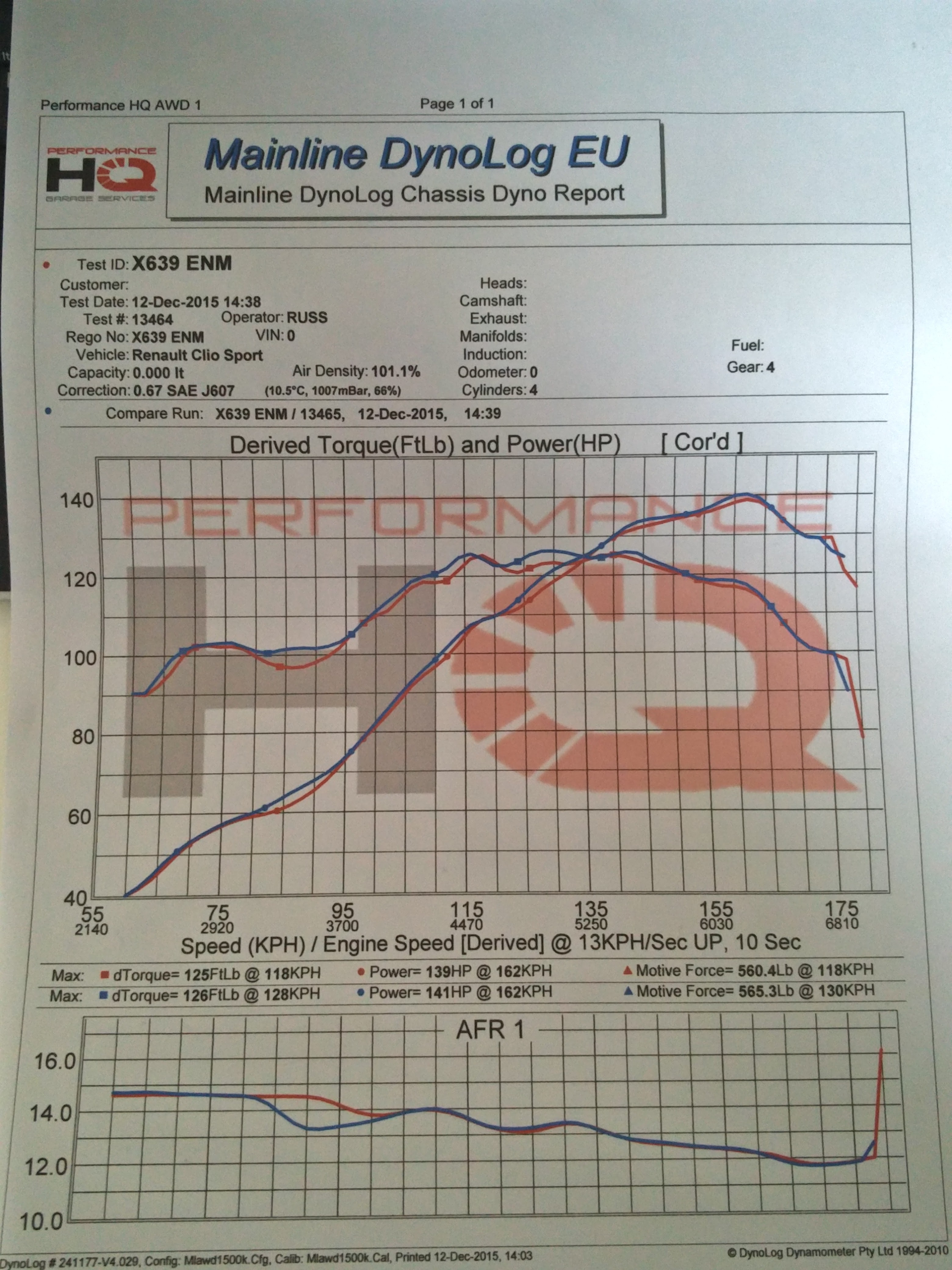

Had the car on the rolling road again at the weekend. Made 141hp at the wheels which is an estimated 167hp ATF. Injectors were running 99.9% duty cycle at the top end so was told it would benefit from being leaned out a bit. Not sure if it's really worth it, but I do wish it pulled better right up to the red line instead of tailing off.
Also got it weighed, which now seems a bit pointless since it's getting reshelled over winter but it was booked already and I was curious.
That's 1047kg with me in it and half a tank of fuel. Was 979kg without me. Had no passenger seat in that day but it's a good figure IMO considering I still have A/C, all glass windows, steel bonnet, standard battery, headlining and tar on the roof, front door cards and everything behind them, a load of shite lying in the car, and a full dash. A decent set of lightweight wheels might've seen a few kg less per corner too.
Hopefully removing the A/C, fitting the ali bonnet, a lightweight battery, and the lack of lower dash or any door cards/skins in the new shell will cancel out the weight of the full cage in it and I'll stay around the same figure for next year!

The injectors shouldn't be anywhere near 99.9% duty cycle, they're good for 200 odd from memory, odd!
Edit - hold on, you got it mapped locally didn't you?
sburrell93
Scotland - South
That's a good point actually, can run itb's on standard injectors can't you?
Never been mapped in my ownership. Wonder if it has been previously...
Or could it be running s**t injectors?

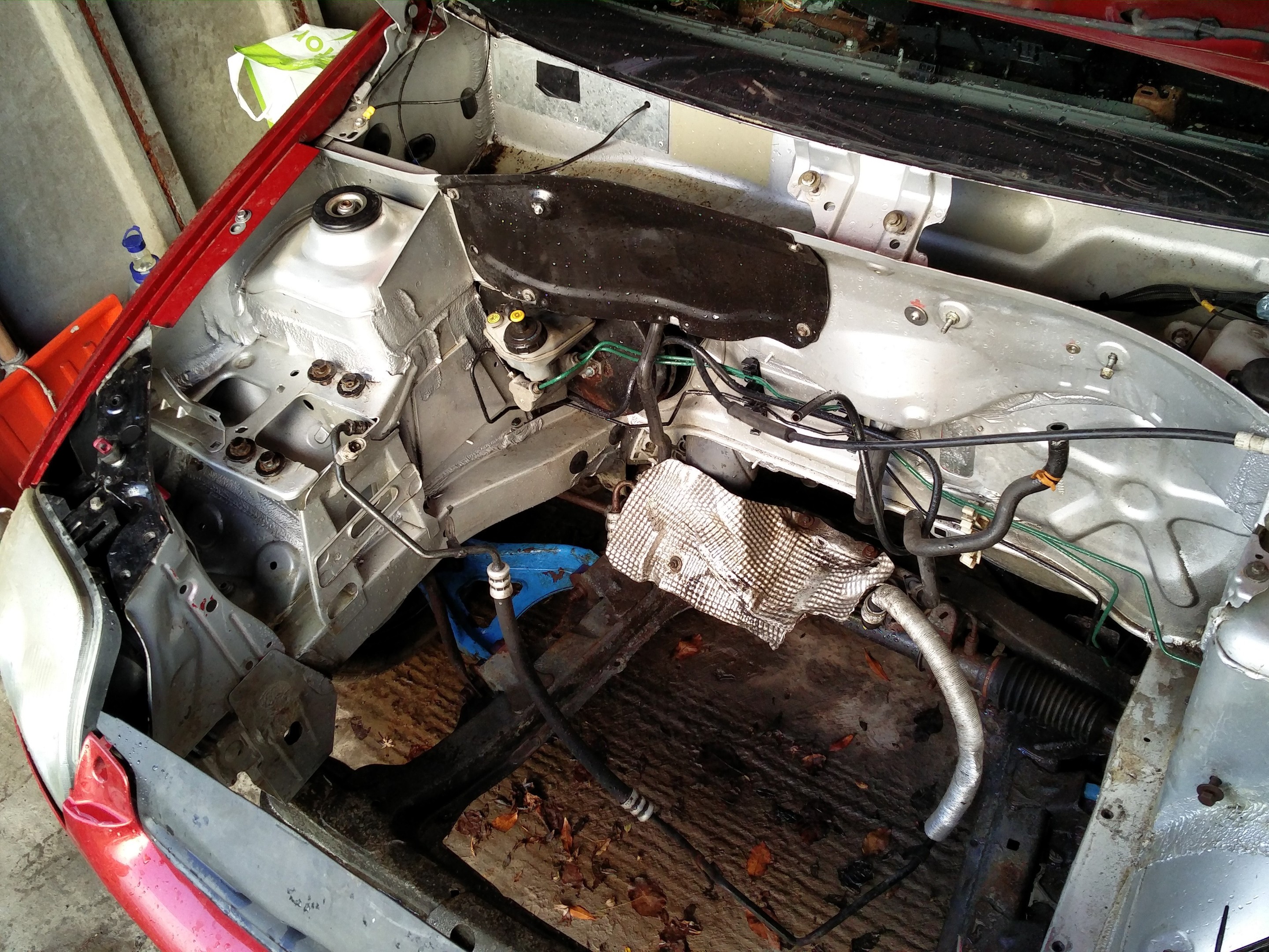

I managed the huge task of cleaning up the engine bay a bit 😂
Hopefully get more progress on it over the Christmas break. Next job is to remove all the subframe etc and give that a lick of paint, probably in some lairy colour. Then get the wings off and repaint the bay.
Once it's all clean the proper mechanical work can begin.

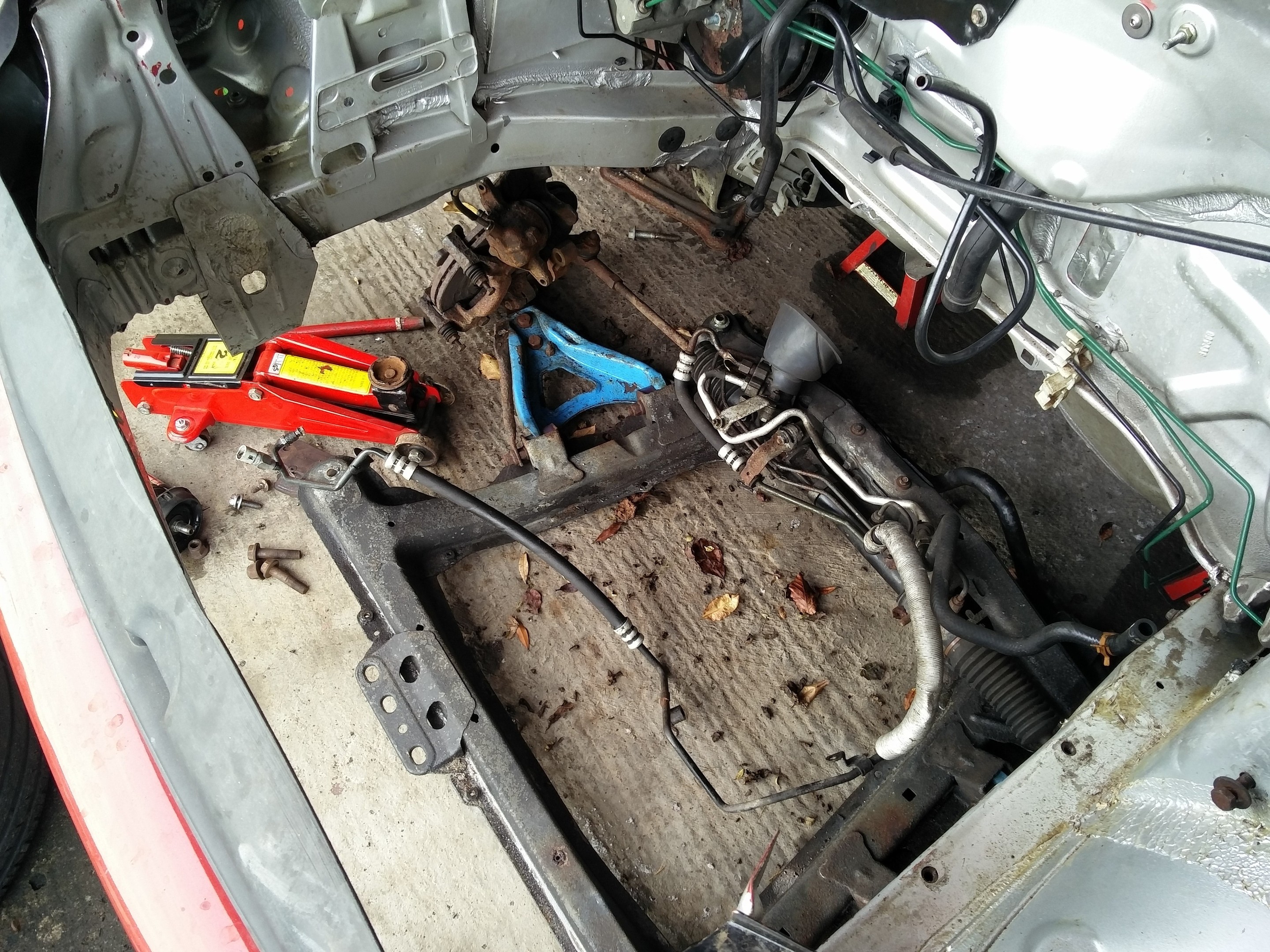

Progress!

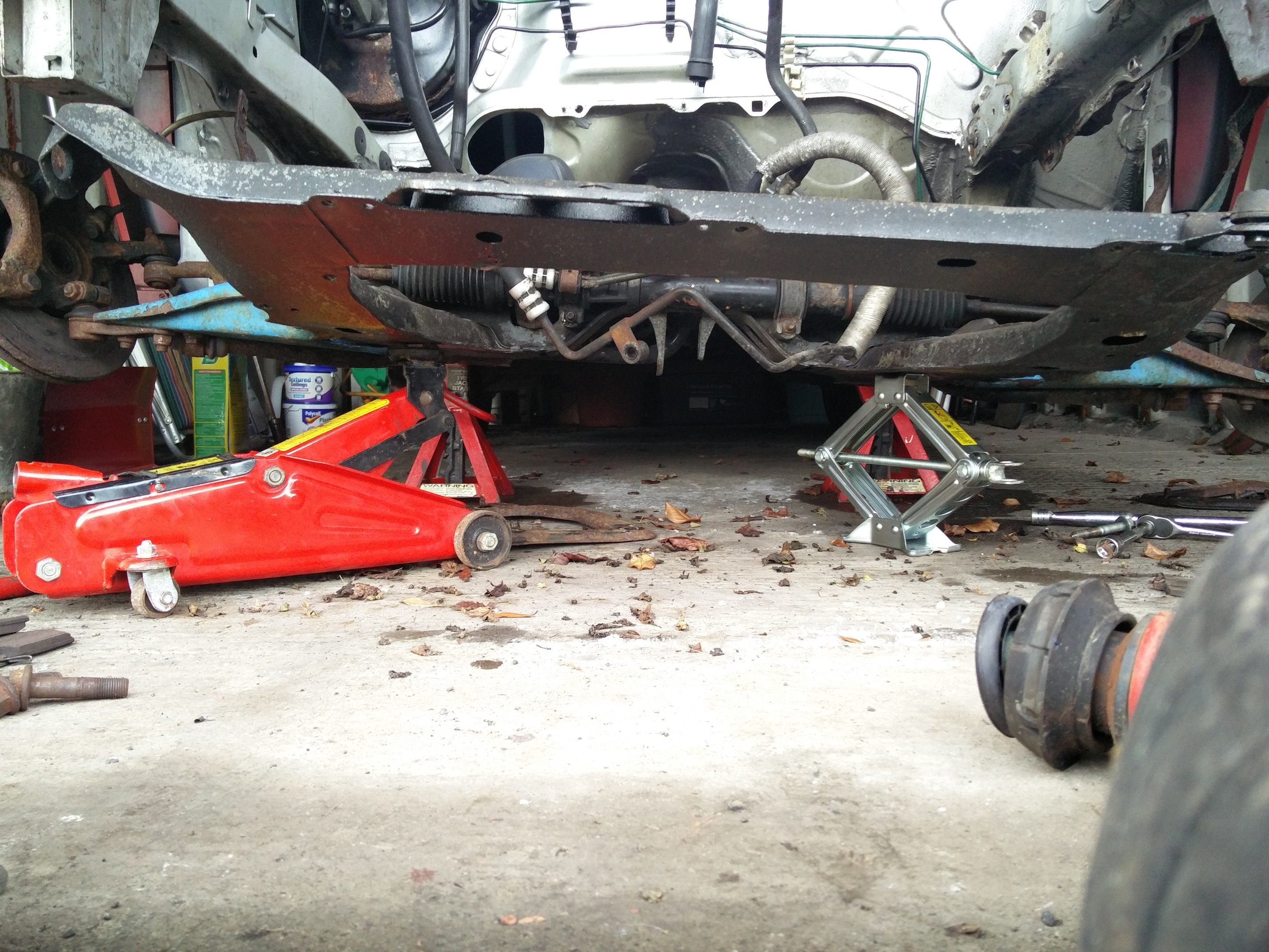

Dropped the subframe out today. Lowering that myself was an experience to say the least! Had it balanced on 2 jacks as I removed the bolts.
So now that's off its heading back home with me to get stripped down, cleaned up and painted. Not decided on colours yet.
P.s. @Djw Dave @Djw John I love the pair of you for using new subframe bolts on this. They were so easy to remove 😂

Nice shell! I'd paint as much as you can just now as I wish I'd done a bit more now seeing rusty parts coming through in the engine bay:cry:
For future reference with the subframe, put a plank of wood stretching across the middle of the subframe the the jack in the middle, easy to do on your own etc
Yeah, that's the plan anyway. Avoiding powdercoating anything though because if I do one thing I'll want loads of bits done. Cans of paint are cheaper [emoji23]
Glad you got another ph1 to replace the ph1.
Didn't even think about that! Didn't have a plank of wood at the time either to be fair though lol.

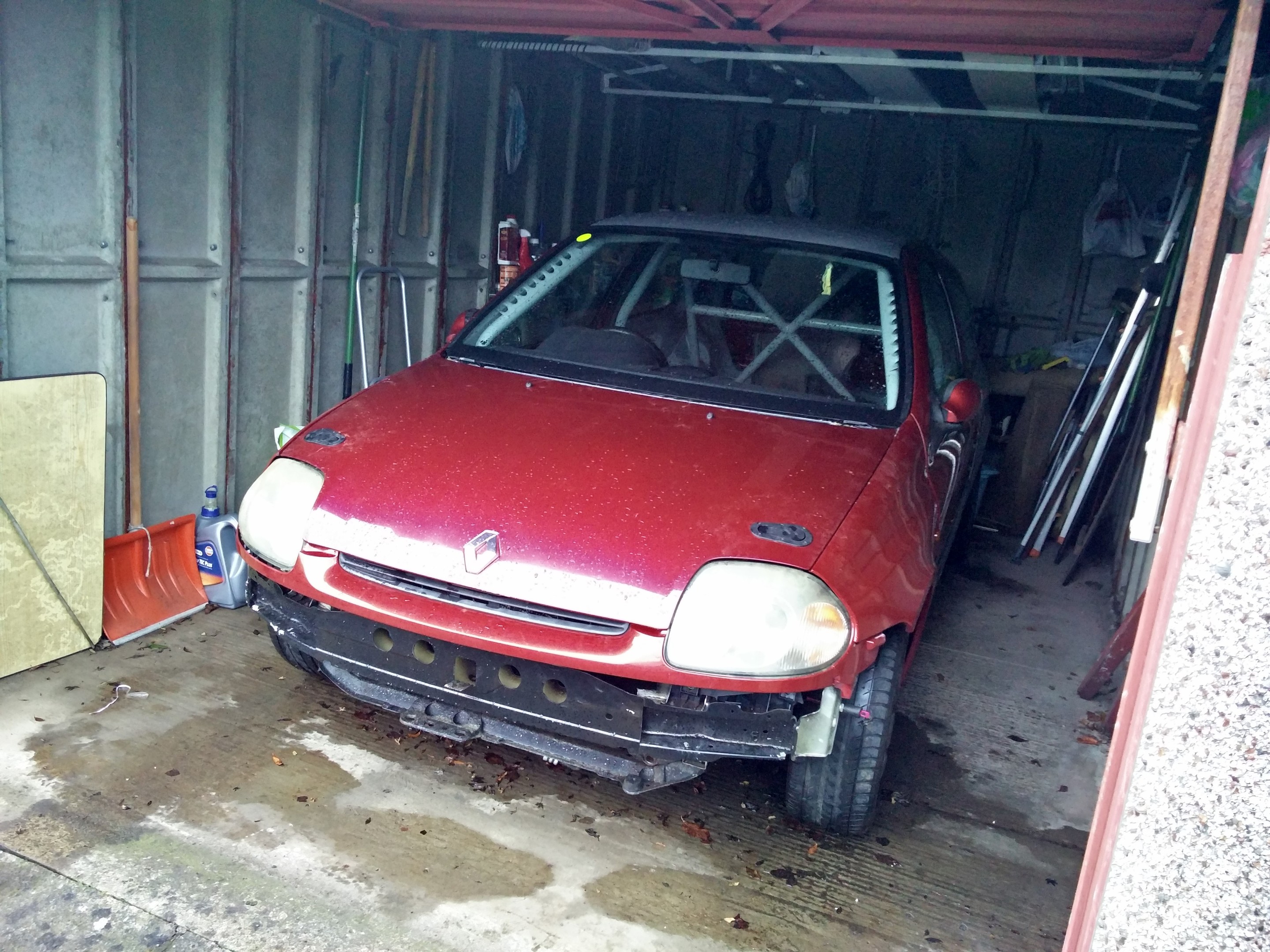

New shell is officially on its way home!
A sad day indeed.

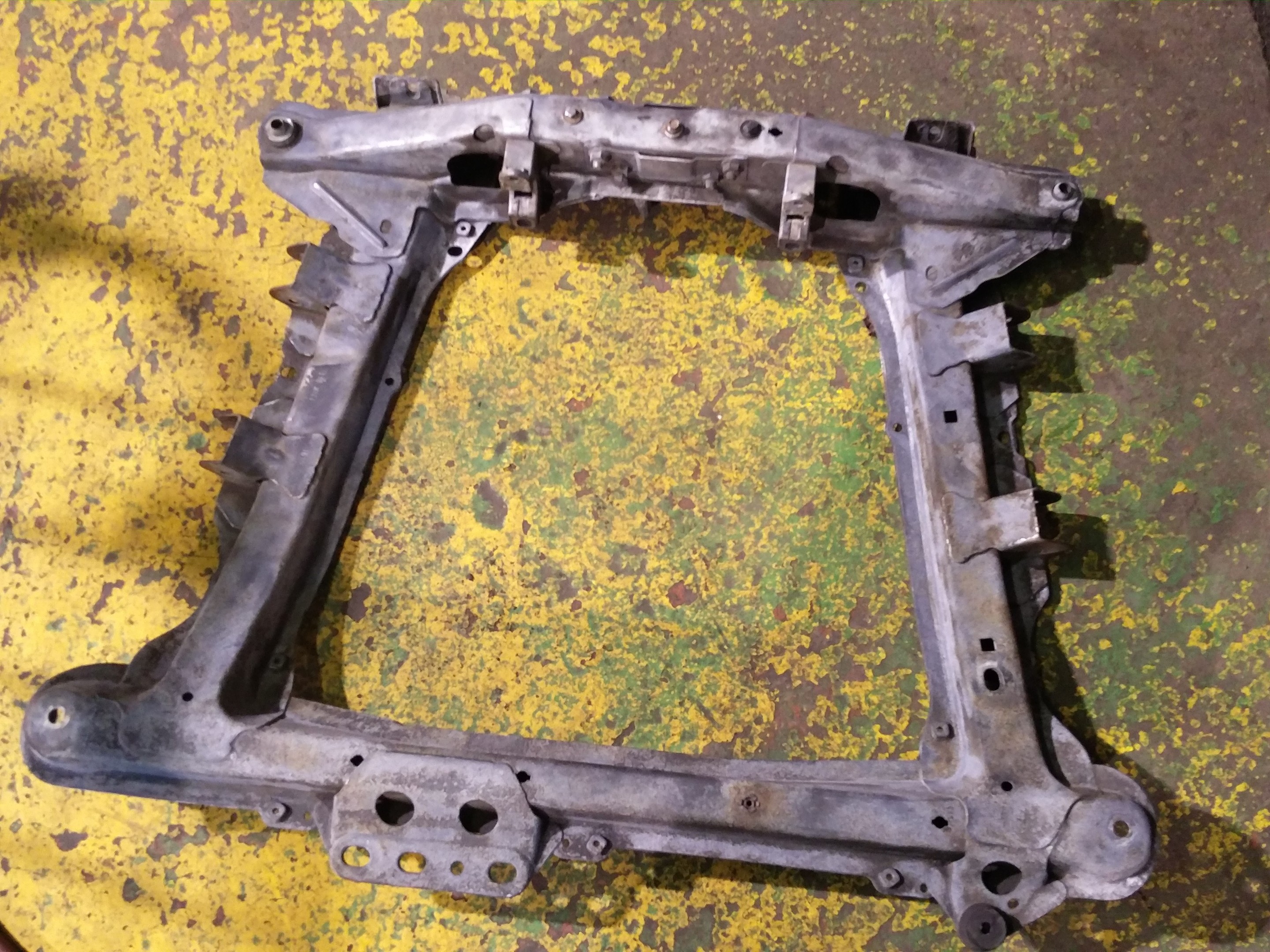

In fact, before I go about painting the subframe, I'm considering getting the wishbone mounts rewelded and drilled further out to increase track width/camber. Basically to what a cup subframe would be.
Has anyone actually done this before? I've seen it talked about but nothing more than that.

Brilliant idea to do a shall swap. I'd be tempted to do the same if a cup shell and cage came up one day. Would you not be better trying to buy a cup subframe? No-one ever buys parts like that so they much be cheap as chips. Postage would be the main killer.
I hammerited by dci subframe when I did widetrack and it's stood the test of time. Took a few coats to stop the metal showing though.
In theory yeah it would be easier to just buy a subframe, but I've not found any close by in ages and don't imagine anyone would post one. And also the fact this would be a nearly free modification lol.
Need to look into it a bit more but it doesn't sound too difficult to do so long as I'm careful with measurements!
Good to know the Hammerite will stand up to a bit of abuse. Not sure how it'll be after a few trips through the gravel on track though lol
