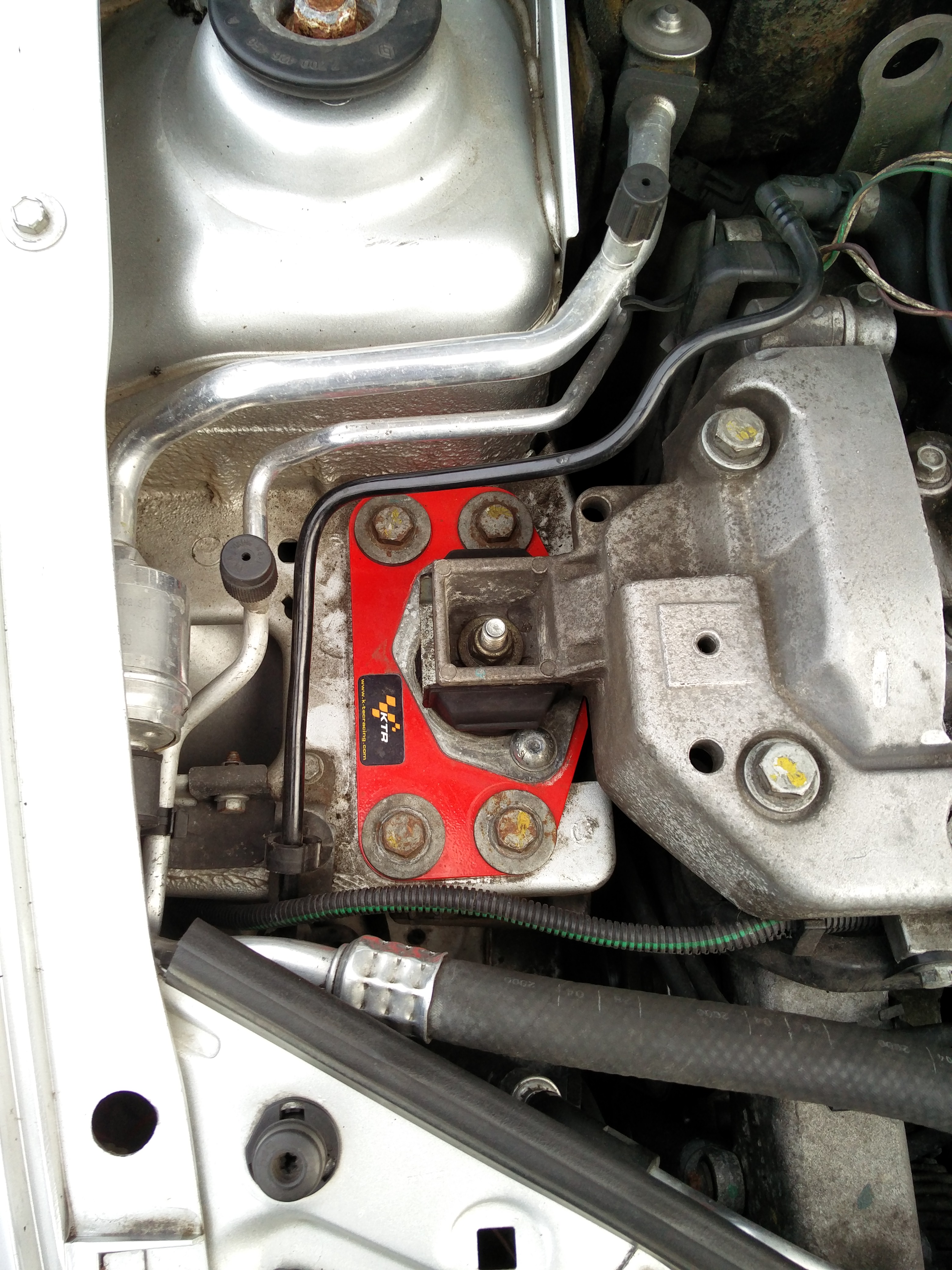

I'll more than likely fire on with fitting the engine mounts tomorrow night if it's not raining. I'm assuming they're simple enough to fit and just a case of swapping over with my old ones while supporting the engine.
sburrell93
Scotland - South

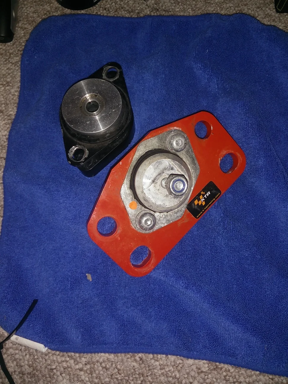

Got my engine mounts on the other night. Engine one was easy enough but the gearbox proved a pain in the arse when I couldn't find an 18mm deep socket, and Halfords etc don't sell them. Found a socket eventually though and got it done the following night.
Most things rattle inside the car now... An excuse to remove more interior panels I guess! Not as big a difference as I thought there would be but my old mounts did seem in good condition tbf.

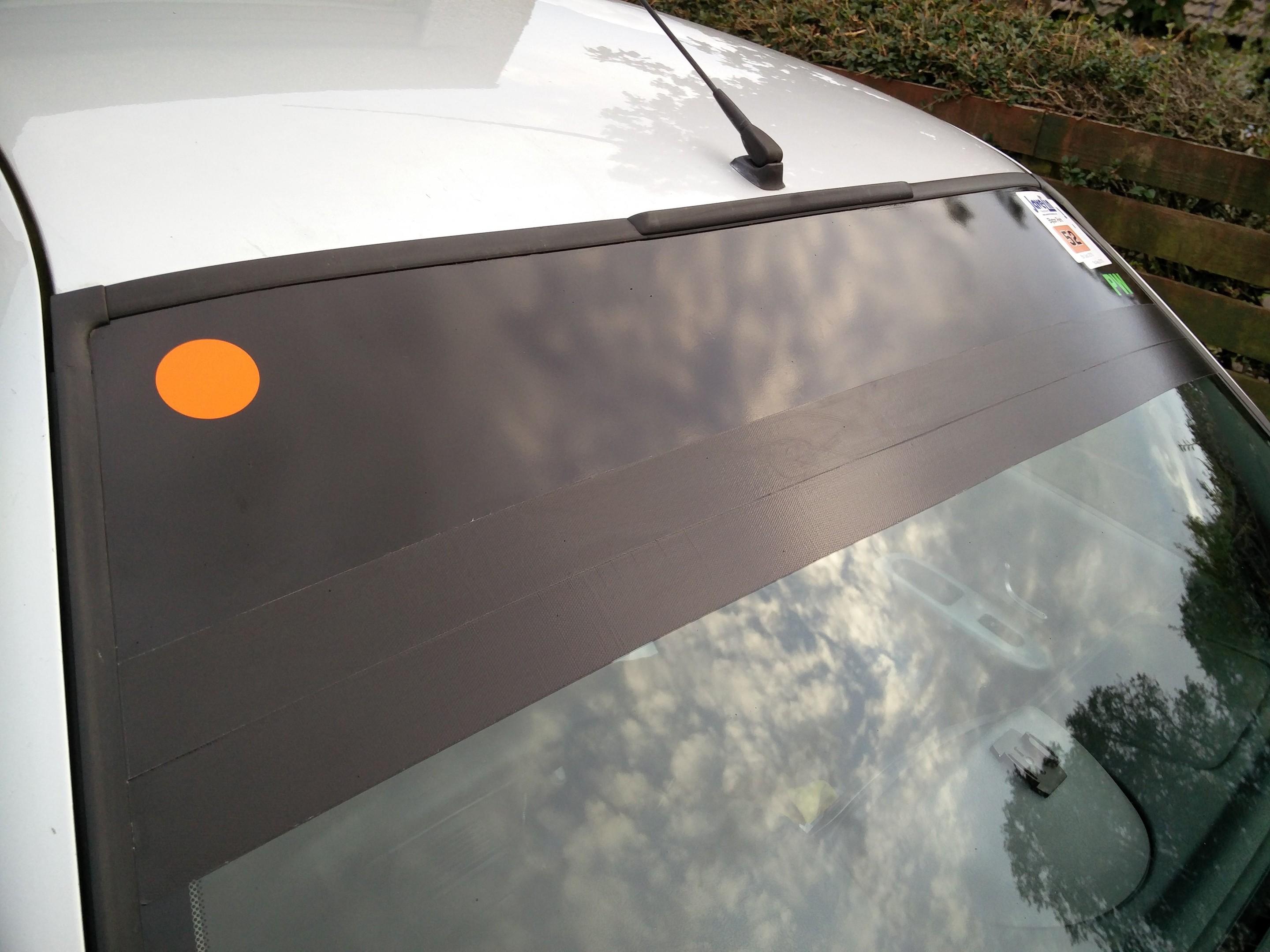

Also decided to extend my sunstrip, just because... So, duct tape... 😂
And another photo for good measure, because ASW

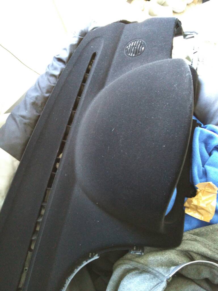

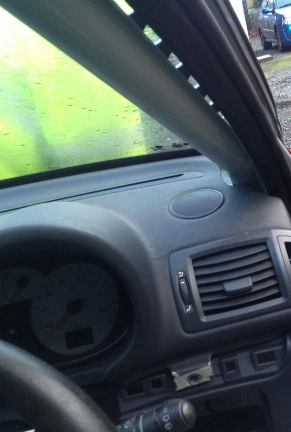

Time for a little update. My flocked dash arrived on Friday. Well, half of it. There's no centre section to it or little storage bit where the passenger airbag is. Both of which looked to be included. I did get it cheap but I'm still not too happy about it.
Freshly unwrapped!
Fitted it anyway, so it now has an unflocked airbag, and I've used my old centre bit for now.

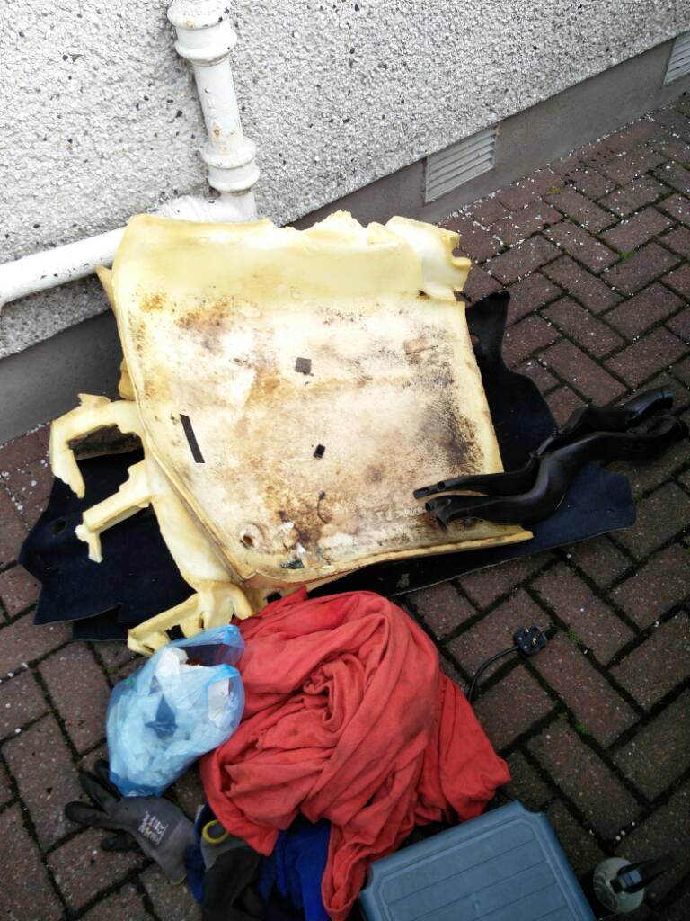

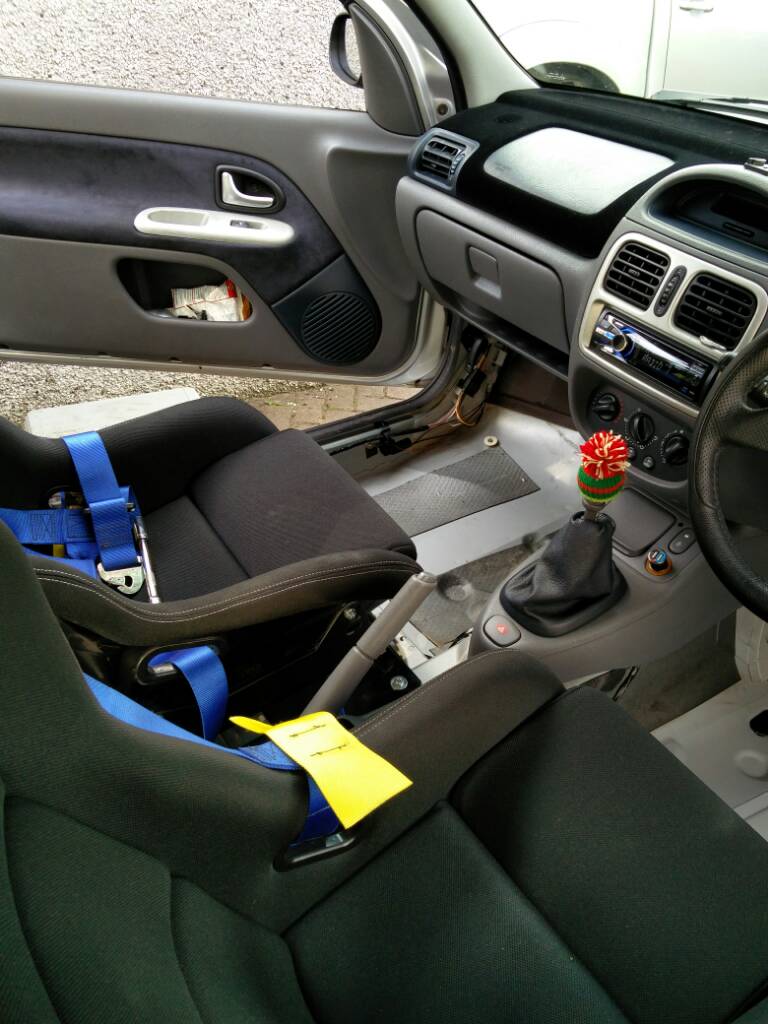

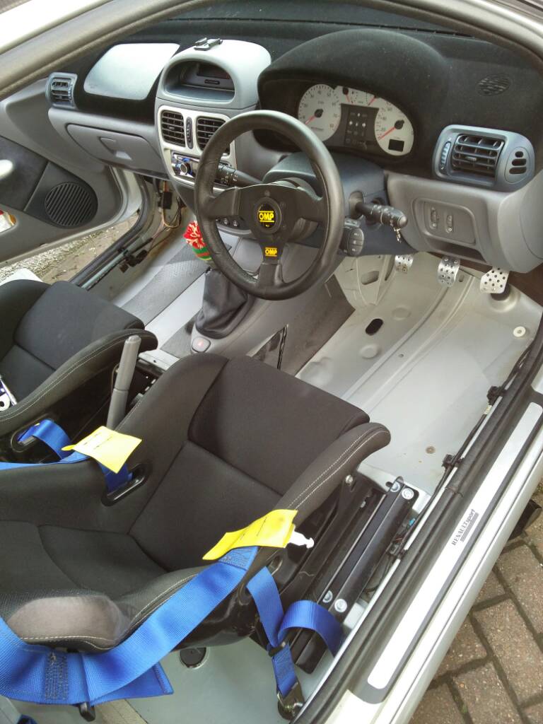

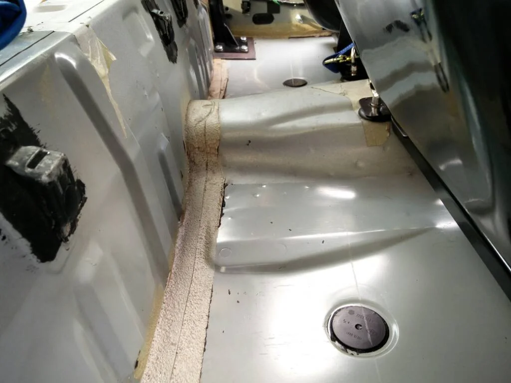

Also started removing all the tar and sound deadening in the rear, which resulted in a 'f**k it' attitude leading to me removing the whole front carpets too and starting on the tar under there.
Got a good bit done today. Just the passenger side tar left to do, and the bits on the centre console in front of the handbrake.
Nice and clean behind the seats!
Aaand the s**t ton of stuff that came out the front. Never realised how much weight was in it

How easy is it to remove the tar stuff? I need to do it on mine before I paint the interior, which I want to start later this month
Also like your attitude in removing the front carpets! That's how I removed mine, I was doing another job and decided the front carpets needed a clean so I removed them

It's not that hard really, its just a tedious job! Get a heat gun and wallpaper scraper and you'll get most of it off. Then what's left over spray with tar remover and it'll wipe clean.
Just don't burn yourself with the heat gun like I did lol! Made a point of wearing gloves after that...

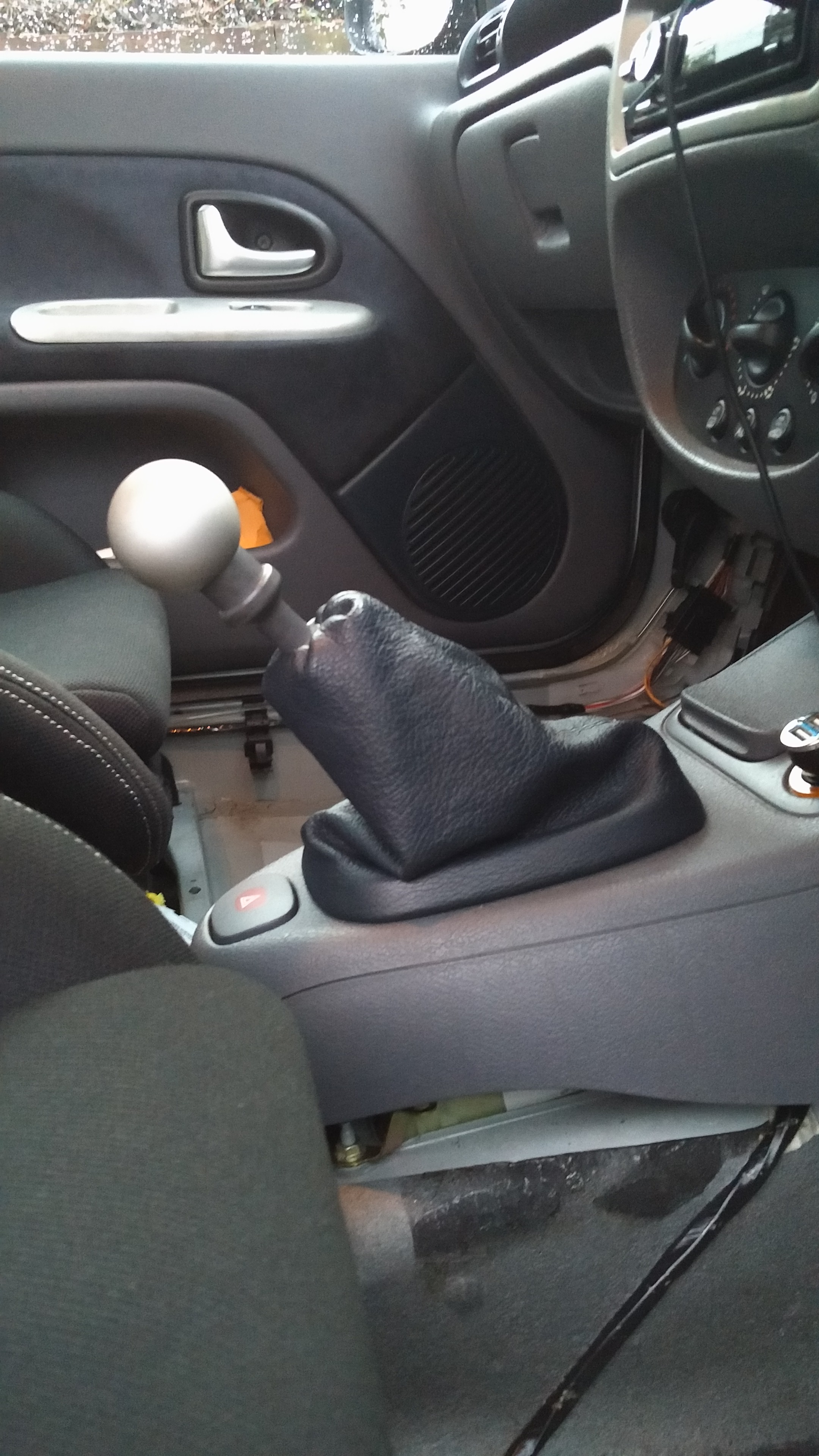

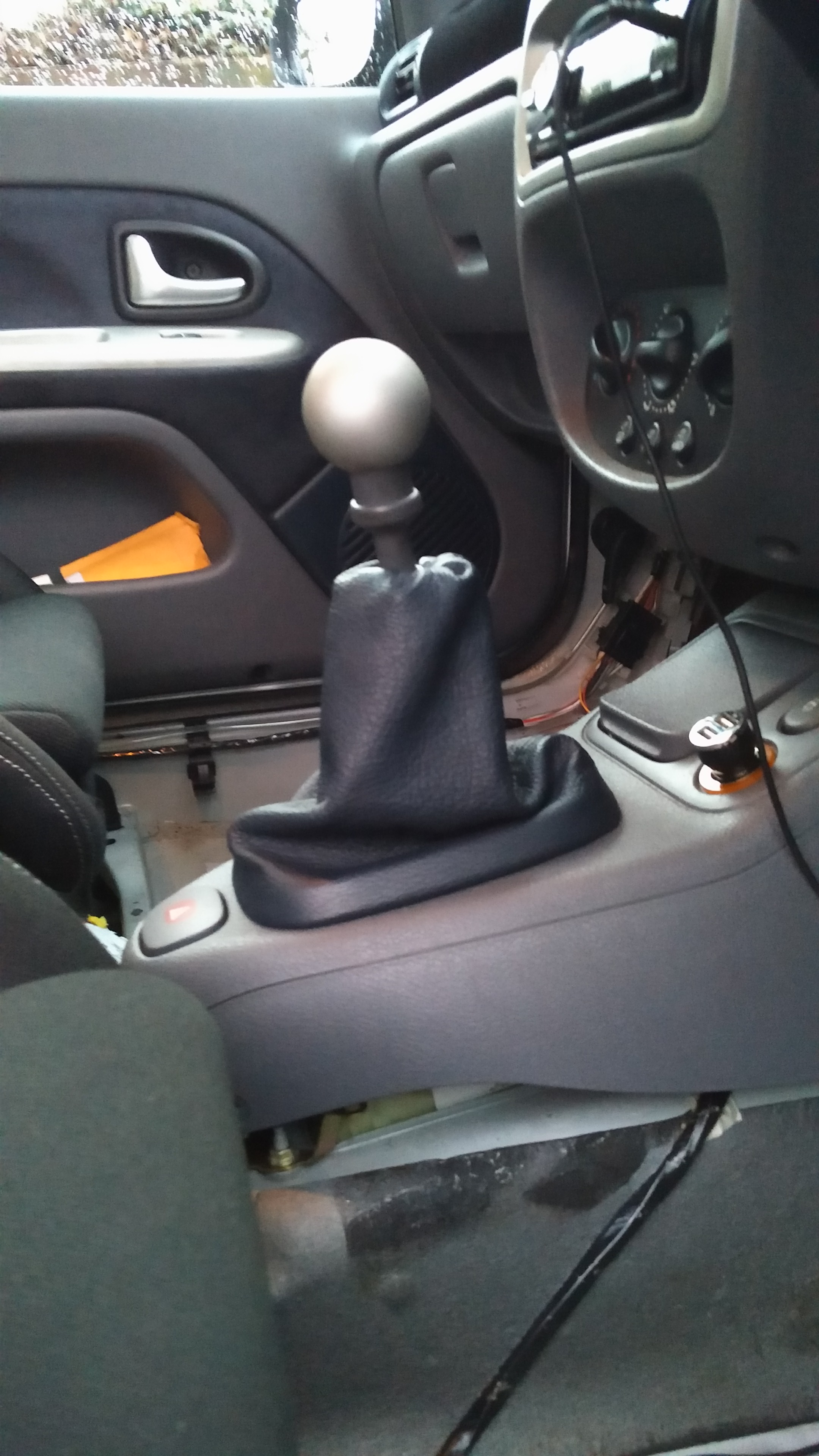

Done some gear linkage modification last night since I'm too poor to go buy a new PMS shifter and I refuse to settle for anything less unless it's free.
Cue the linkage meeting a hacksaw... Resulting in this now being 3rd gear:
And this being 4th:
Quite an improvement for 15 minutes work with a spanner and a hacksaw.

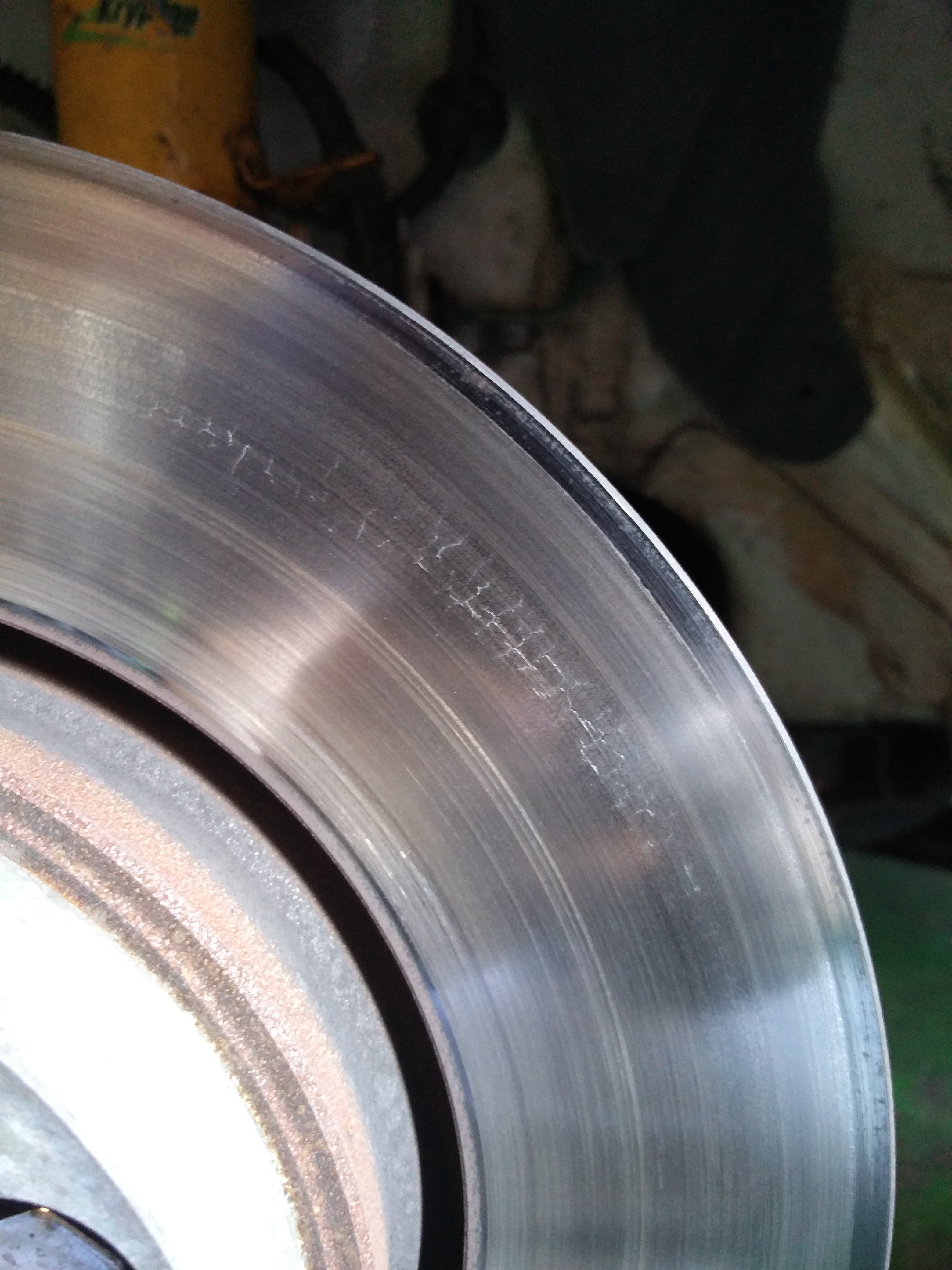

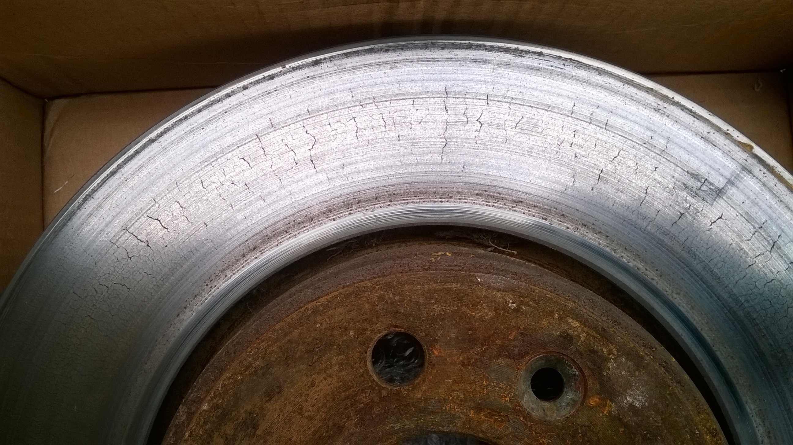

Well, today I found this :fearscream:
Was still holding out a bit of hope that I'd get a space on tomorrows track day but with that I think I'll be giving it a miss now even if I do get a call saying I have a space 😞
  Supercharged AG 200
Those will be fine, my old ones were like that over the whole discs..... You've got months of heating and cooling left in them

That's good to know they're still alright Craig, cheers! I was a little worried when I saw them haha.

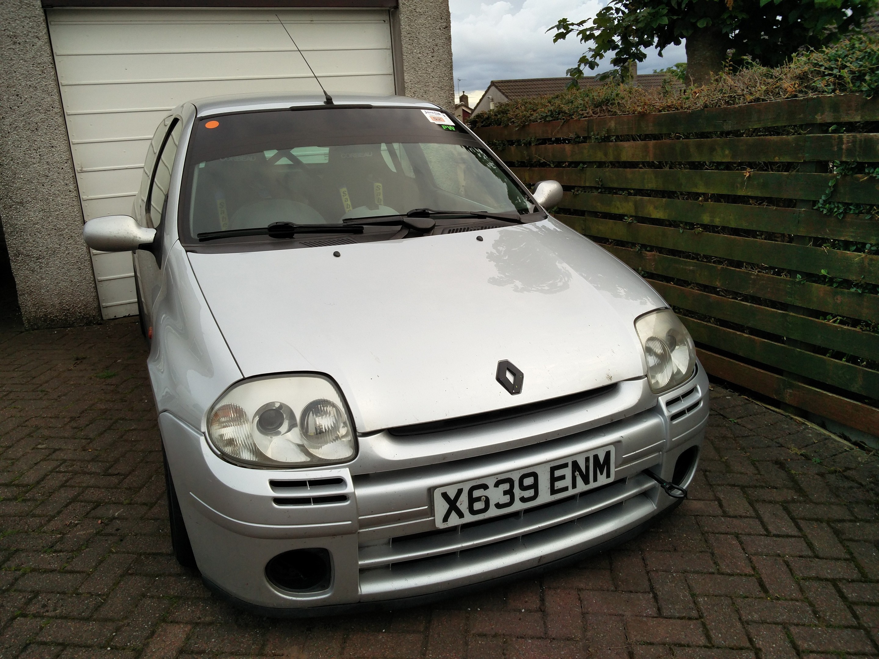

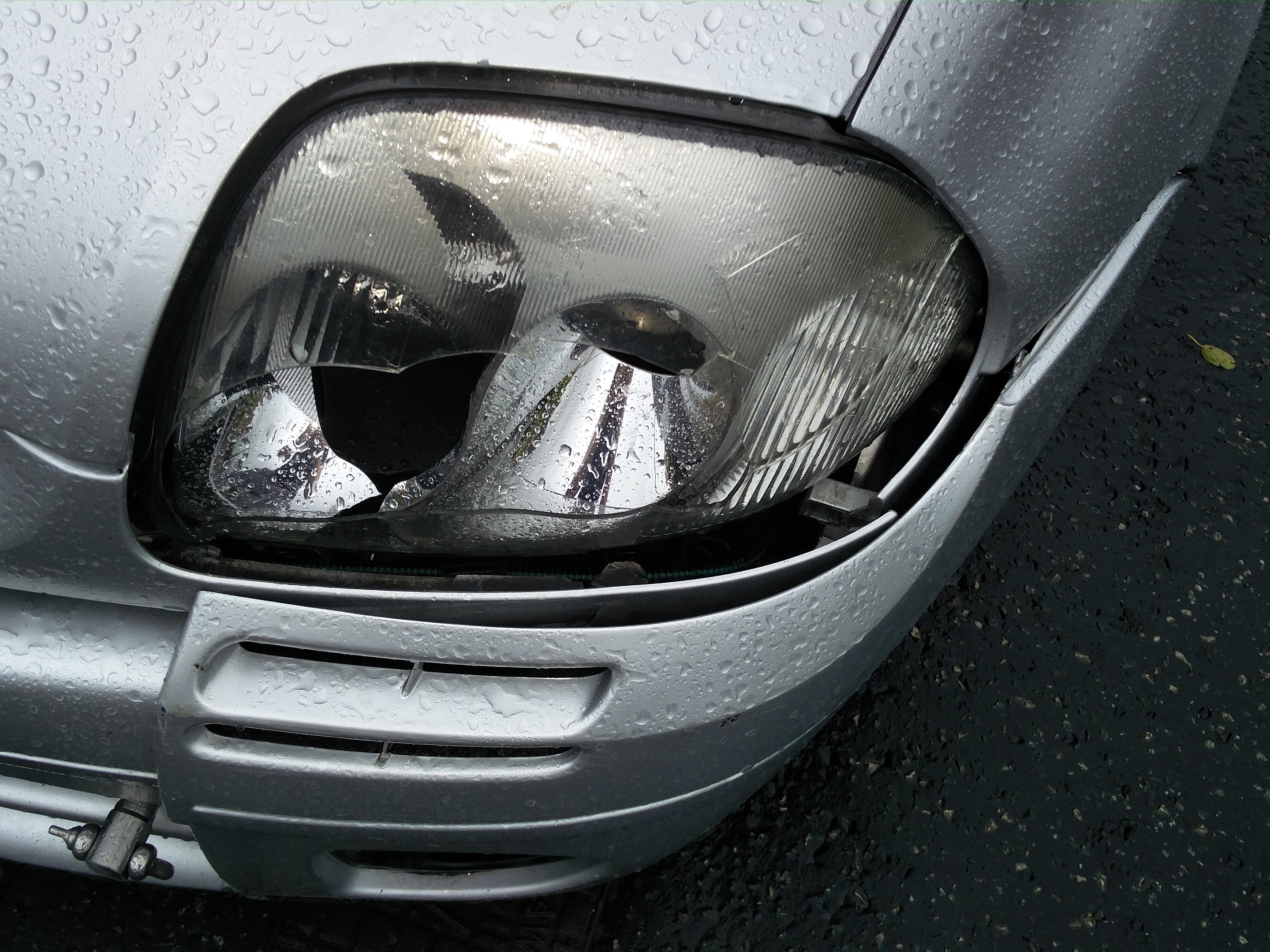

Nothing much to update. Car is currently sitting in the drive wounded after I hit a deer in it the other week. Got VERY lucky tbh, only hit it doing probably 50mph at the most and it was a fairly small deer. Would usually have been going a lot faster on that stretch of road too, but was taking it easy that night.
Damage could be worse. That's the worst of it in that photo. Smashed the n/s headlight, bonnet is dented around the diamond, popped the wing out of place, and the bumper is now covered in little stress cracks but still in one piece. Not had anything off yet to get a proper look underneath the panels but I can already see the bumper mounting brackets are completely bent out of shape. Will probably just aerocatch the bumper or something if they're fucked though! Apart from the headlight, I didn't really plan on replacing or repairing anything since it's only a track car, but an alloy bonnet has come up local, so what better an excuse than to replace one with a dent in it!

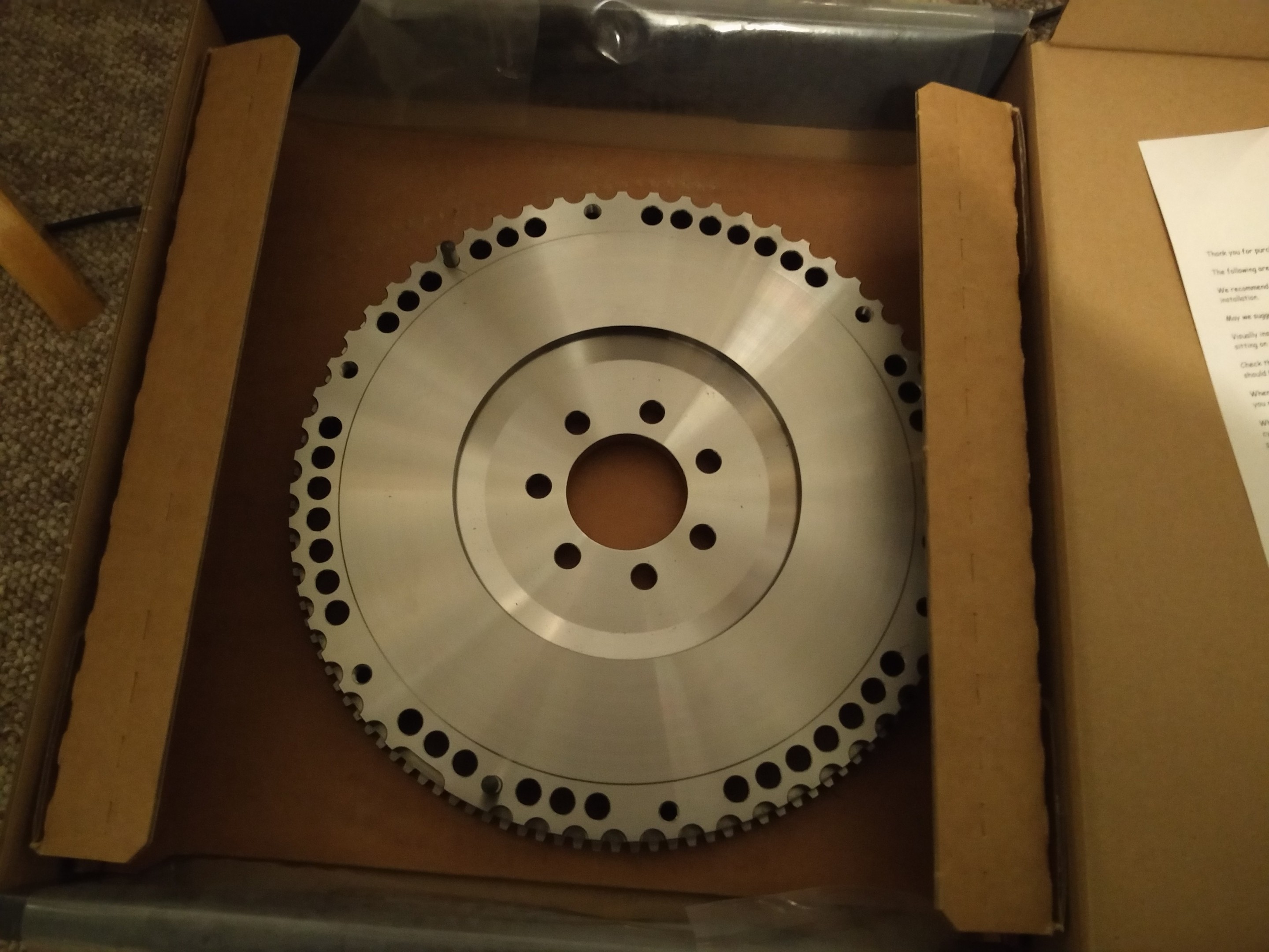

New shiny parts arrived yesterday in the form of a lightweight flywheel! Cheers to @Fraser.J. for organising a group buy for a few of us locally on this.
Trying to convince myself it was worth buying now 😂
