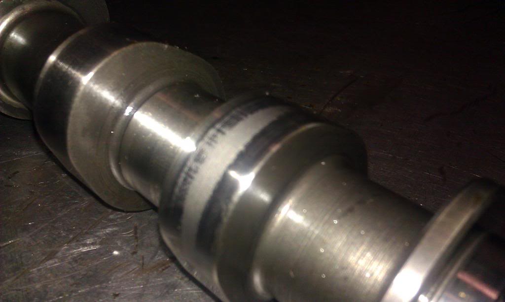

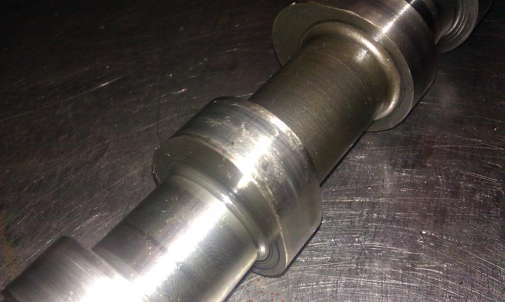

This... a guy from work had a mishap with it, i think a missed gearshift and then a full throttle after sending the rpm's skyhigh , with floating valves to follow, valves hit pistons, roller-rocker (follower?) actually broke a piece off of it and budged itself between the cam i think by the looks of them.. He never confessed to this but this must have happened. He was supposed to pick up my car left by the road with a dead alternator. This is how the car came back :S
