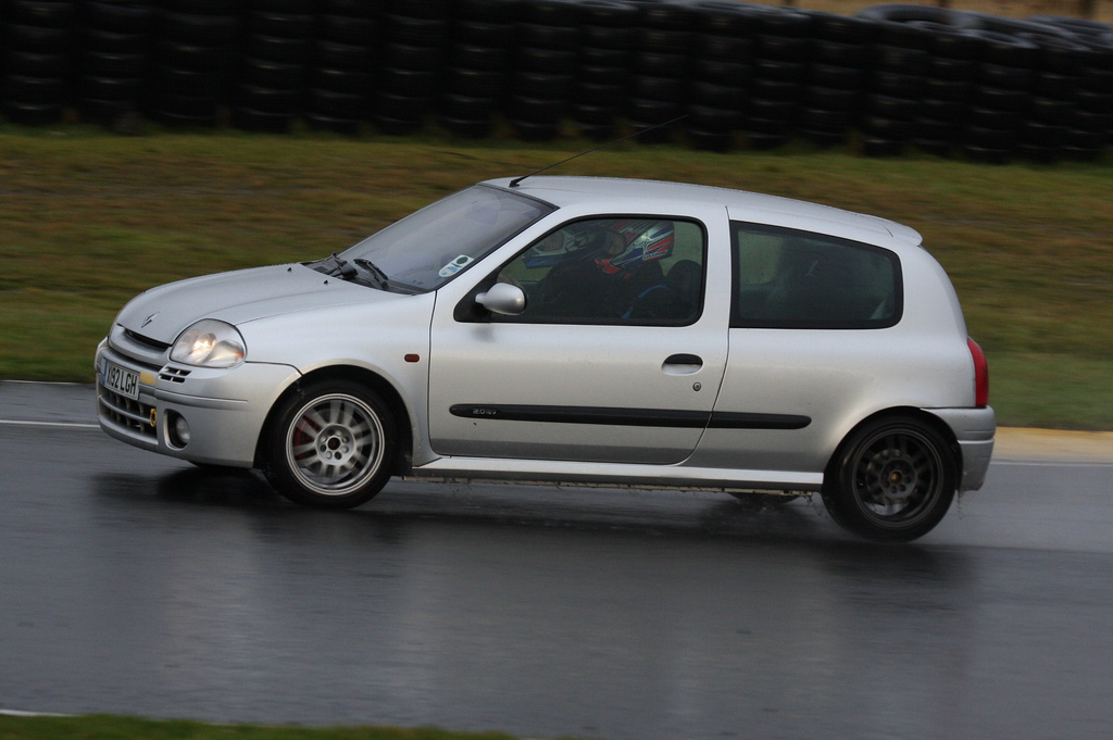

First up was a test trackday at knockhill which highlighted a faulty rev counter and knackered radiator temp switch.

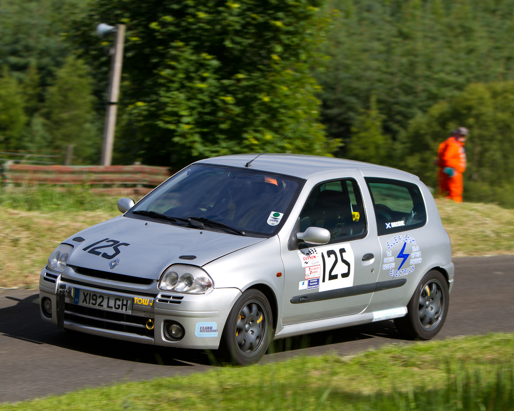

First event was Doune hillclimb where we bagged 2 firsts a 2nd and a 3rd ( I should add i've been sharing the car with my nephew.

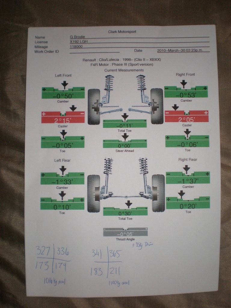

Some further testing at a local track had us changing the spring rates to stiffen the car up as we we're starting to run on the tyre sidewalls!. I went for 825lbs up front and fitted gaz coilovers with 450lbs on the rear. It was then corner weighted and setup by ex british hillclimb champ and car builder Graeme Wight Junior, The difference was amazing and we instantly had way more grip due to the tyres working as they should now.

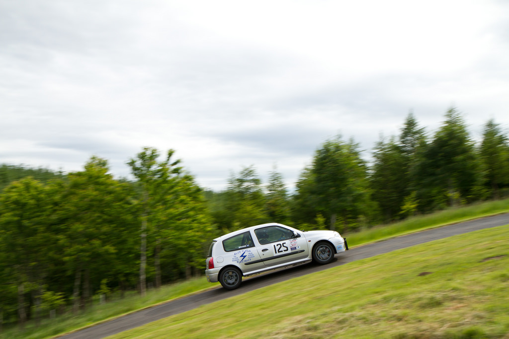

Next event was Fintray hillclimb where we again got class wins and 2nd places on both days.
