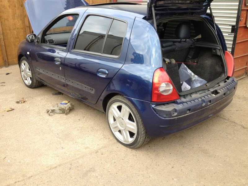

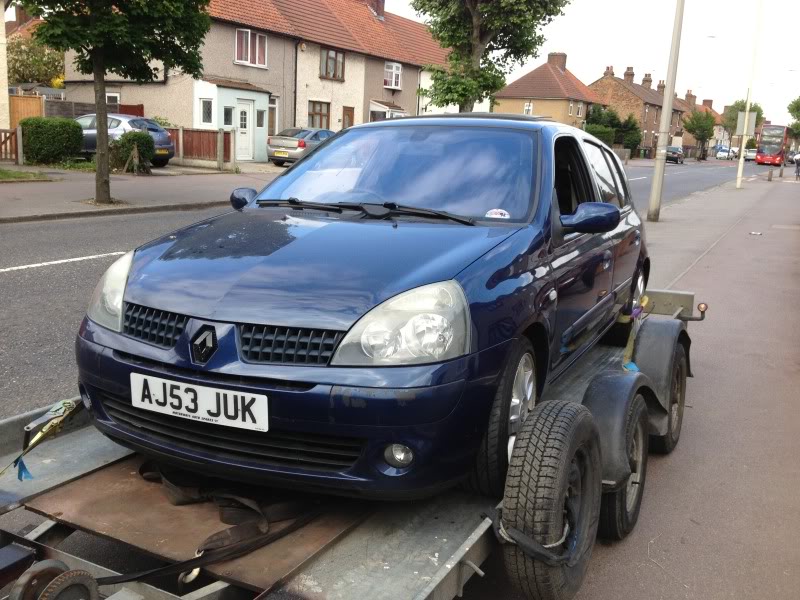

Finally picked up my old DCi that I sold to the wench's little brother nearly 3 years ago (all my cars are like f**king boomerangs). It is stupidly tatty and rough atm. Not a clue what the plans will be yet. Tidy it up and sell it. Tidy it up and use it as a unit b**ch or tidy it up and track it... It was fairly capable when I had it albeit specced a little better.

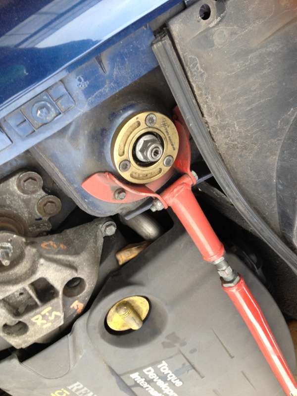

It had a 6-hour custom map from torque developments that run 115bhp on two different rolling roads so that's that sorted. Ideally if I kept it i'd like it specced how it was before 15mm spacers all round, FK Konigsports, Whiteline ARB etc. May also go for a straight through exhaust like the Toledo for the LOLs.

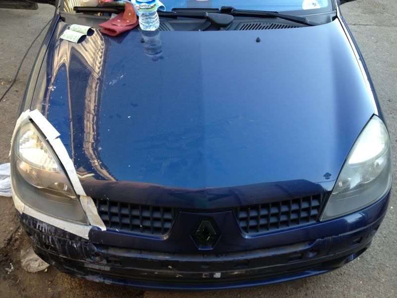

Paintwork wise it's rougher than a badgers ringpiece. Not sure whether to give it a quick enhancement detail or do it properly and wet sand the whole thing to get it as close to perfect as I can.
Parts I already have to fit are brand new wishbones, ball joints, TREs, Poly dogbone mount, Poly ARB bushes, new steering rack and DS2500s (it makes a f**k ton of noise up front). I also have all the parts I need to wide track it I want.

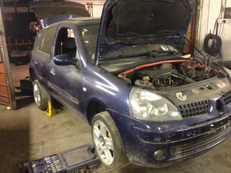

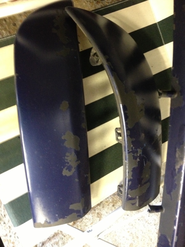

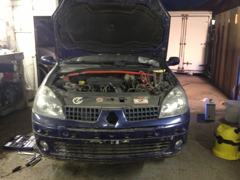

Started stripping the tatty bits off..

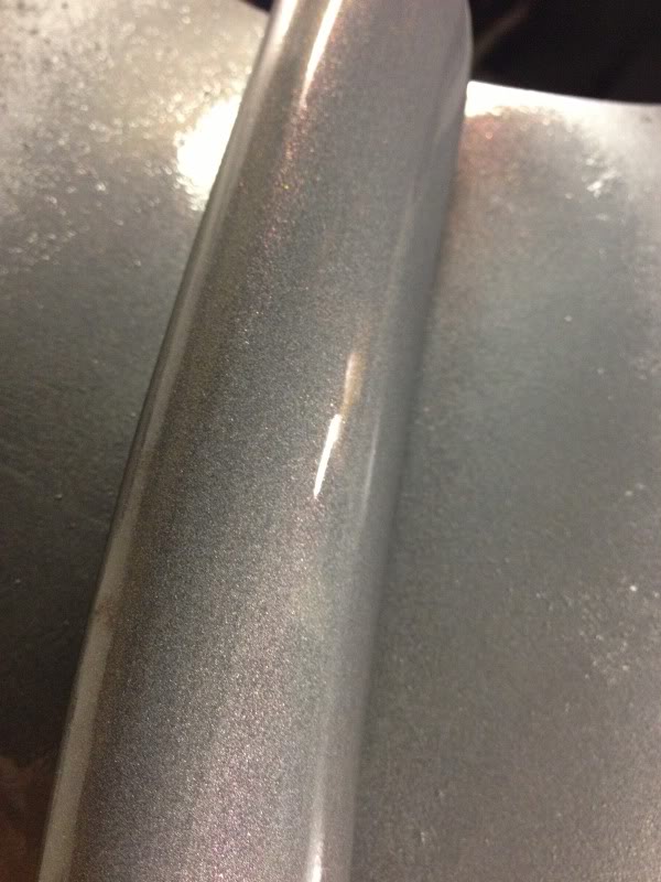

Yes, I paid £200 to have these painted years back...
I have my new air gun so i'll sort it myself this time.

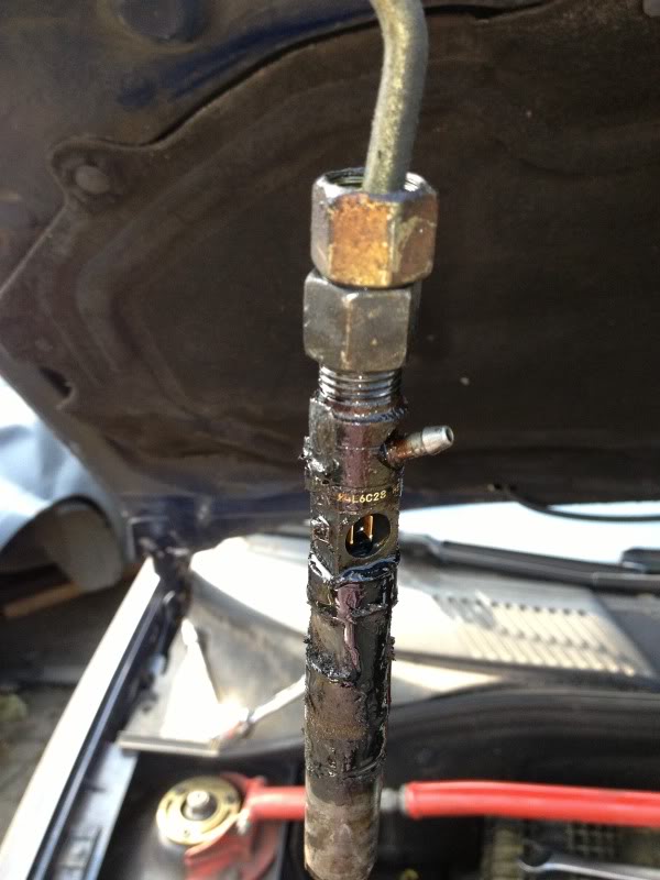

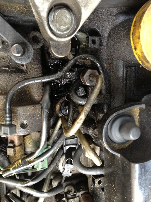

Found the running problem..f**king injector

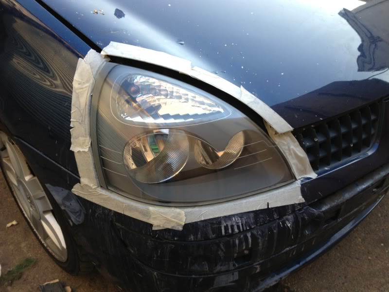

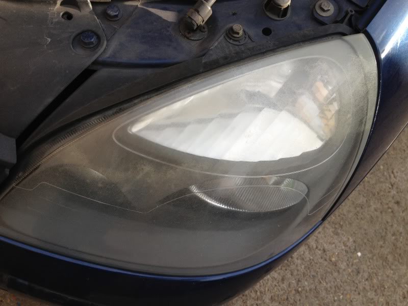

Headlights were properly murky so I sorted them this evening..

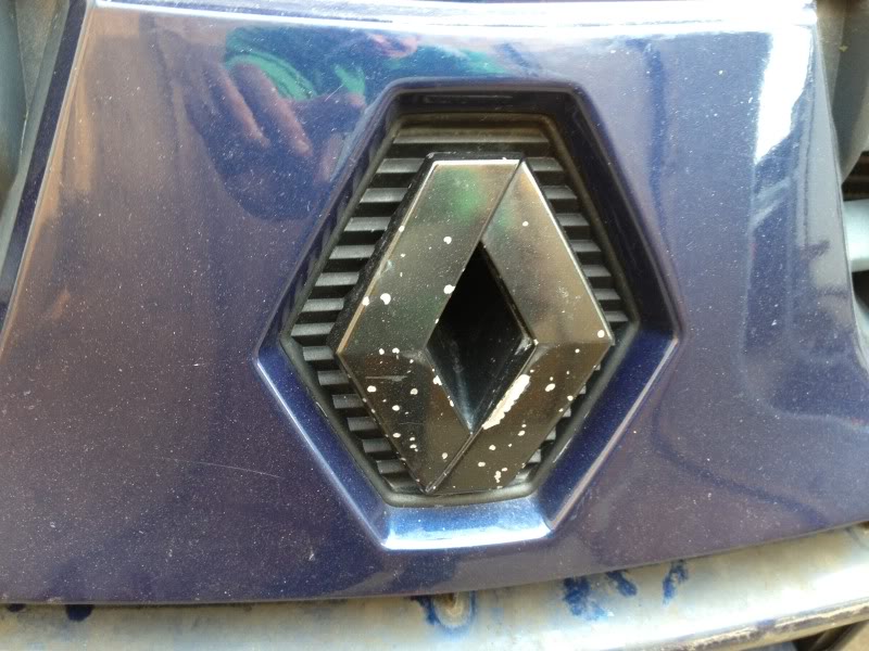

Knackered badges..

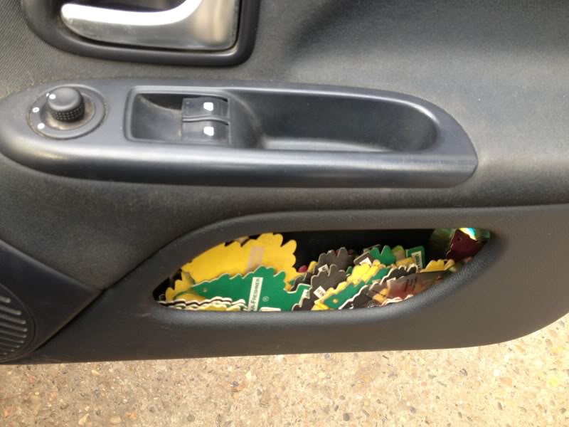

Came with a free forest..

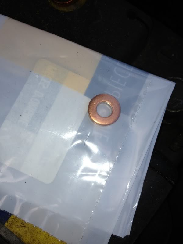

The leaky injector problem solved by four new genuine copper seals..
f**k me it was leaking a long time, took a while cleaning it that's for sure..

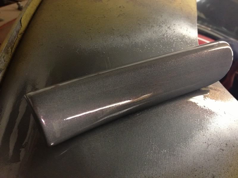

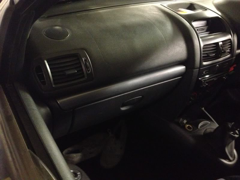

As someone had scratched all the dash inserts with a bag or something, I redone them, love this colour..
Looks a lot more sensible thatn the blue that was there before..

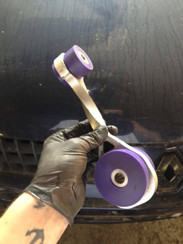

As the gear stick resembled Ozzy Osbourne doing speed on a pogo stick I realised the dogbone mount was f**ked so replaced it with this..
If you have a Dci, really don't bother, the car now resonates with the vibrations and is pretty unbearable, the video doesn't quite capture everything rattling and vibrating but..

I really can't wait to do a wetsand detail on this, SWIRLSSSSSS..

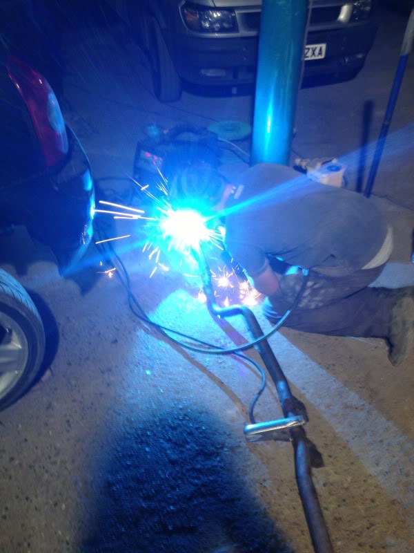

I then took the exhaust of for Health and Safety Steve to muck about with..
It sounds quite good, not too loud but really grunty and brings the turbo noise out nicely!
