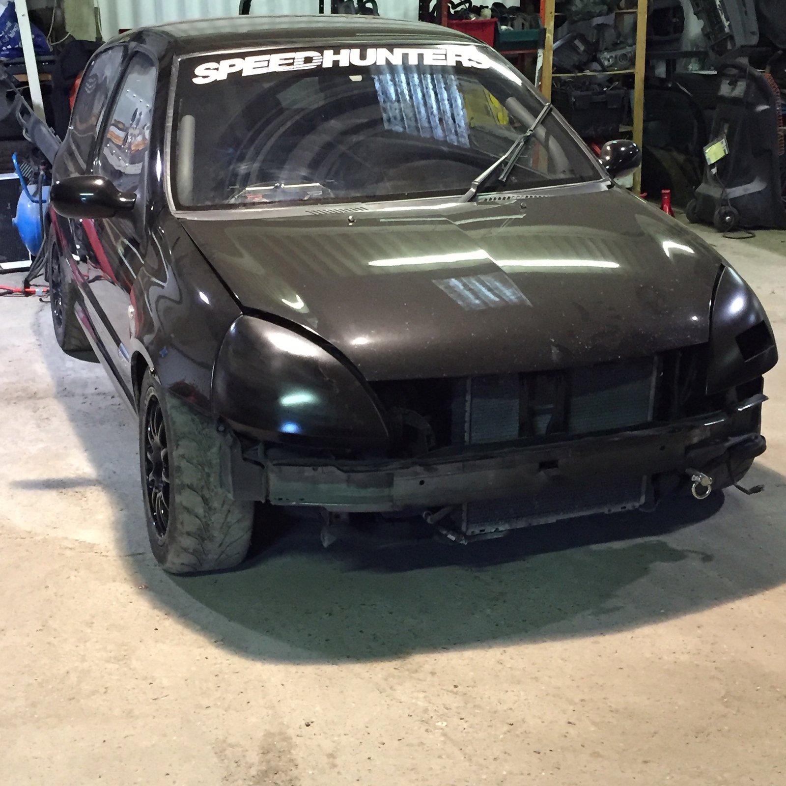

Yes mate just put the passanger side wiper onto the middle bolt so it's the drivers side arm and it still sweeps the whole screen, need a slightly smaller wiper to be perfect I think 11" but I've not bothered yet not until I need a wiper but I don't drive my car on the road so it might do your head in if you do

Won't bother me tbf haha. Doesn't the drivers side are have 2 stubs? Can't remember, trying to picture it lol

Yeah the driver side has 2 so I put it on the one in the middle and angled it as it is and it does a full sweep, I can get a pic tomorrow night for you if u like mate. P.s. Just looked through your thread on here! What a weapon engine bay looks amazing

Ahh yeah just found a pic on my phone. Defo doing that haha.

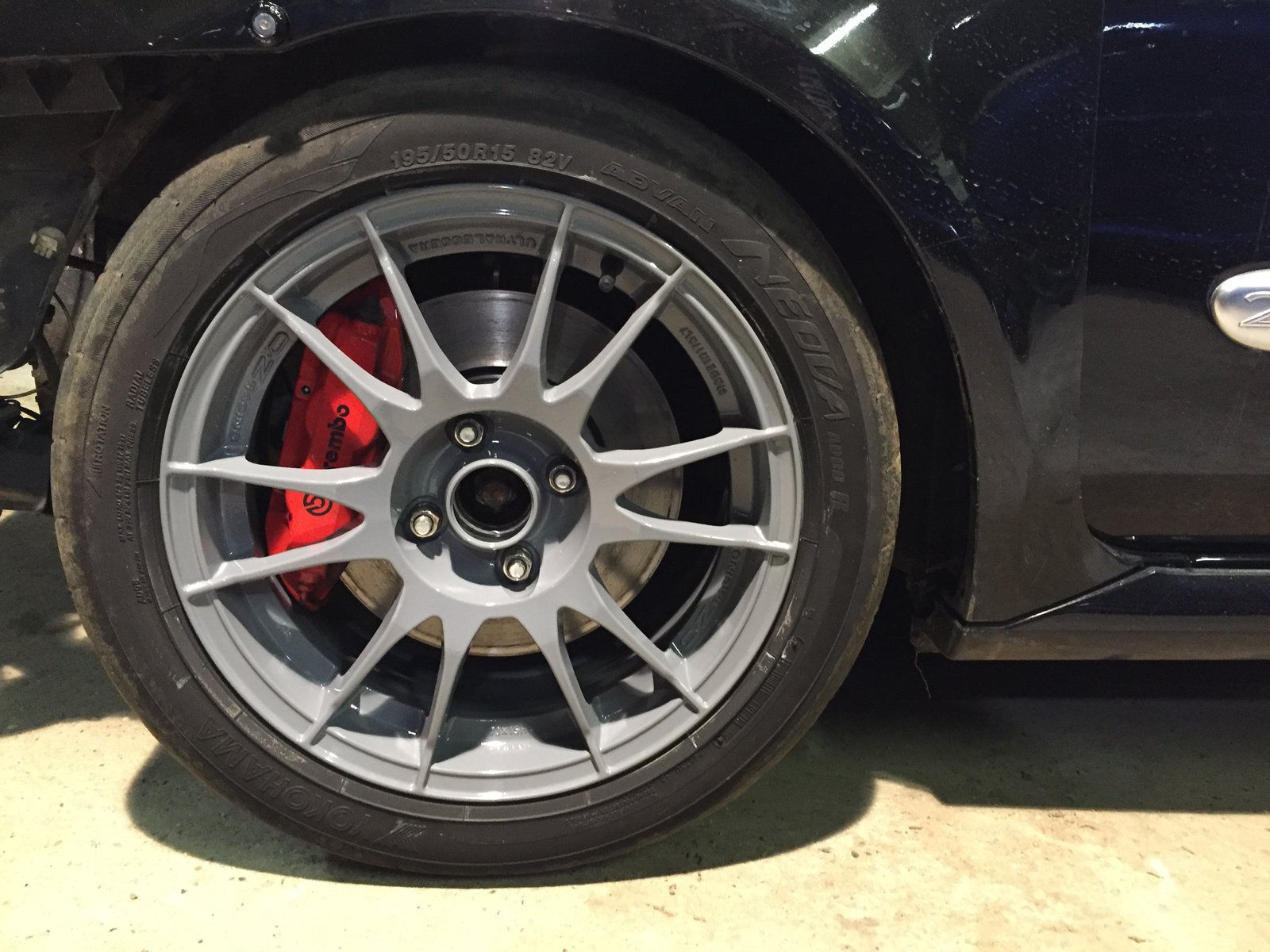

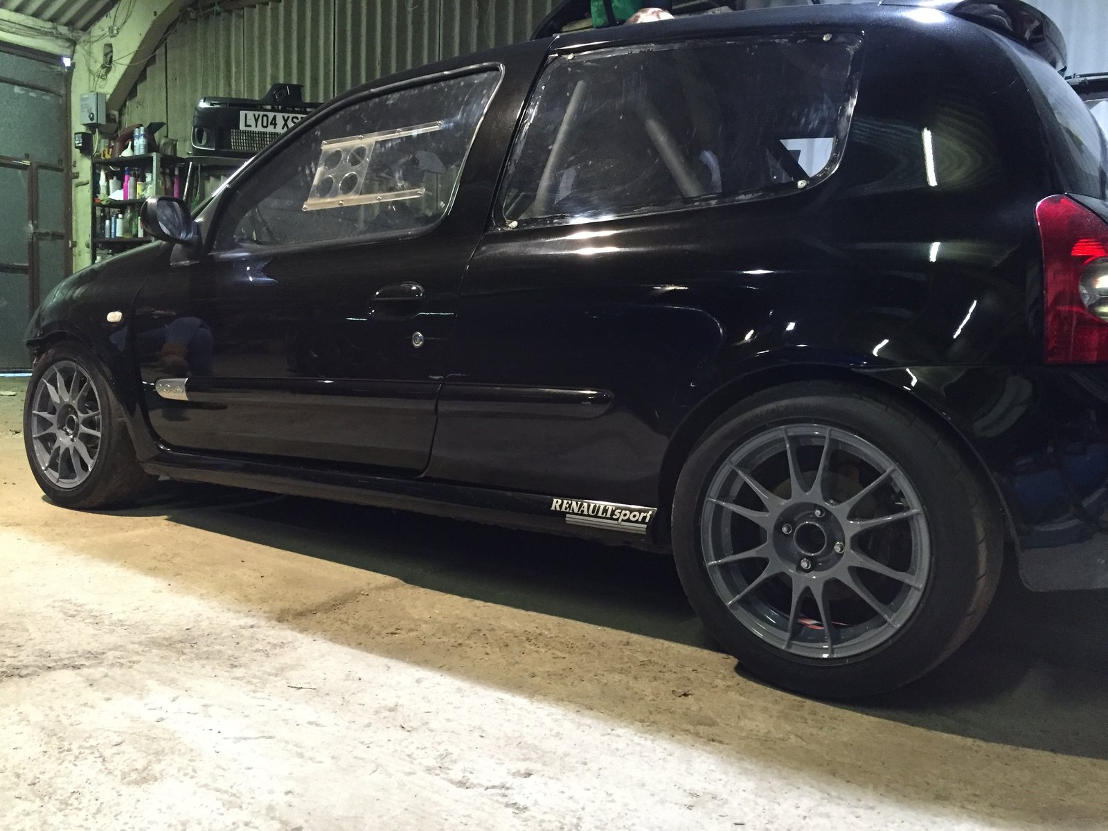

Had my wheels powder coated in Audi nardo grey (shiny primer) I love them I think they look so much better than the pinky colour they were before I appreciate its not every ones cup of tea but there we are

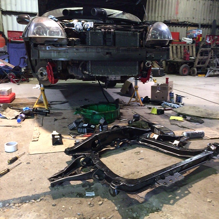

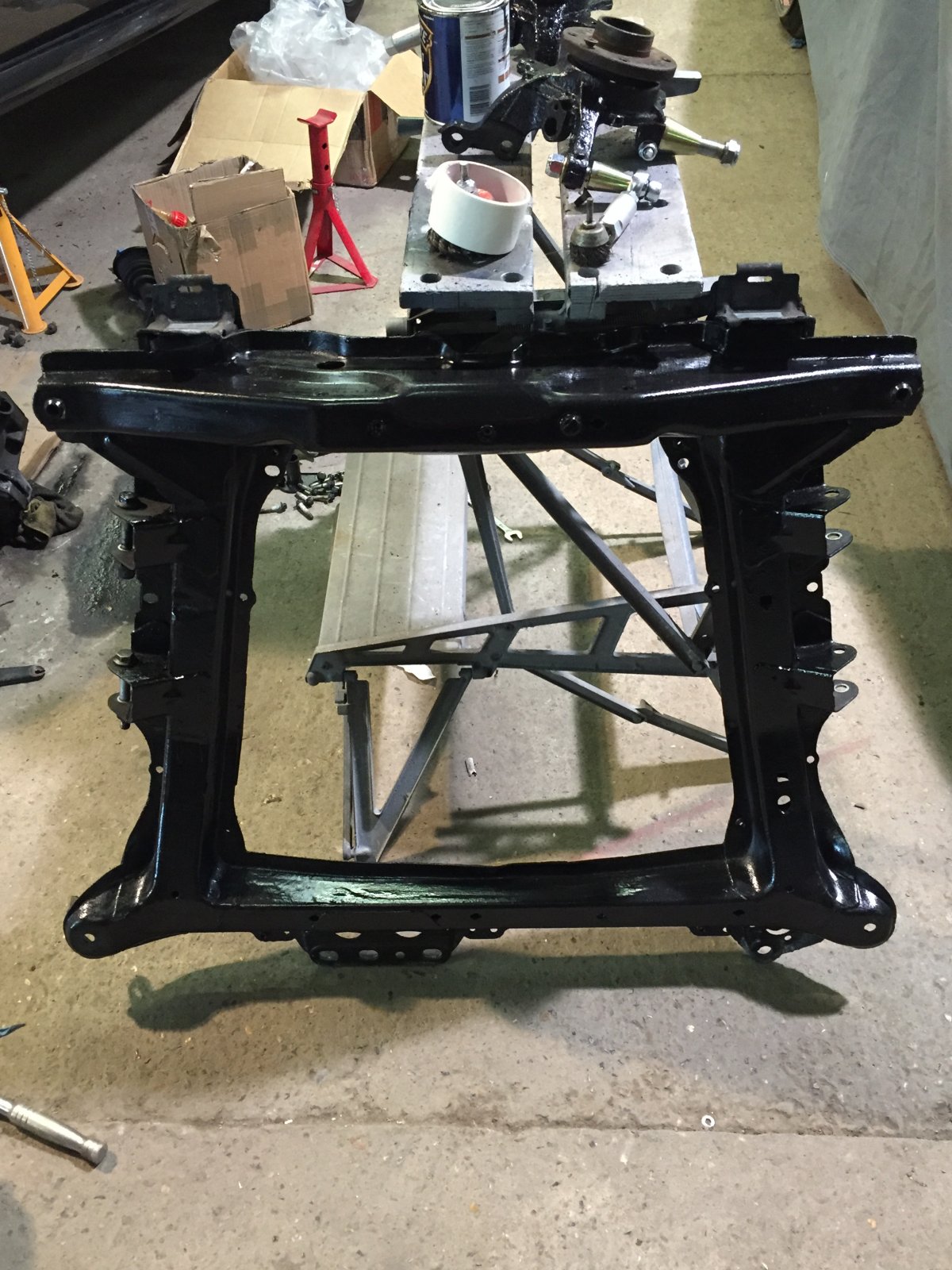

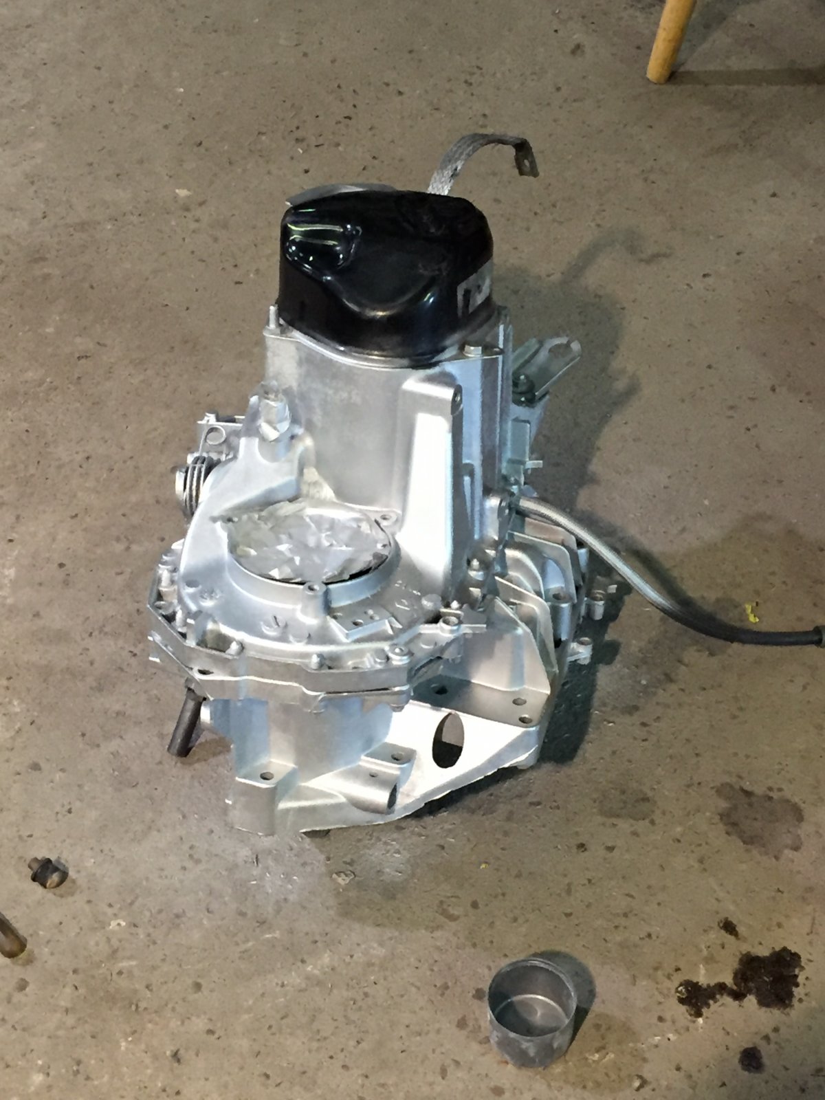

Got a bit excited with the hammerite whilst the subframe was down and on the floor today, also painted my new box what I collected this morning and arb and hubs 😂🙈
Just need the bushes to get here got a whole cars worth of powerflex black series bushes and get a clutch tomorrow and it'll be back together ready for a brands evening to try out the hubs! Can't wait!

Good couple of hours on the car this afternoon, black series buses on, subframe is ready to go back on.. When taking the broken box out we noticed the top of the sump is leaking so I'll sort that does any one know the the sump has a gasket or is just a sealer of sorts like some cars
  Teg
Can be done with subframe in place but I'd do it while subframes off if you can pal.. When I did mine I dropped the subframe a bit just to make life easier. While your buying a gasket I'd buy a handful of spare bolts too just incase.

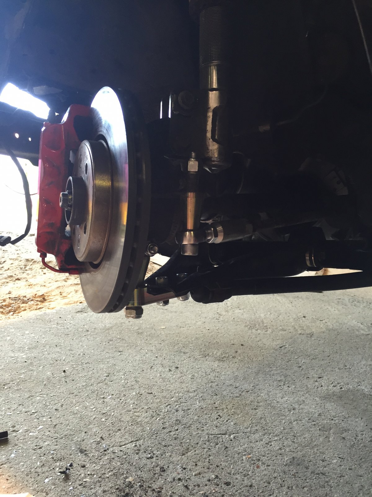

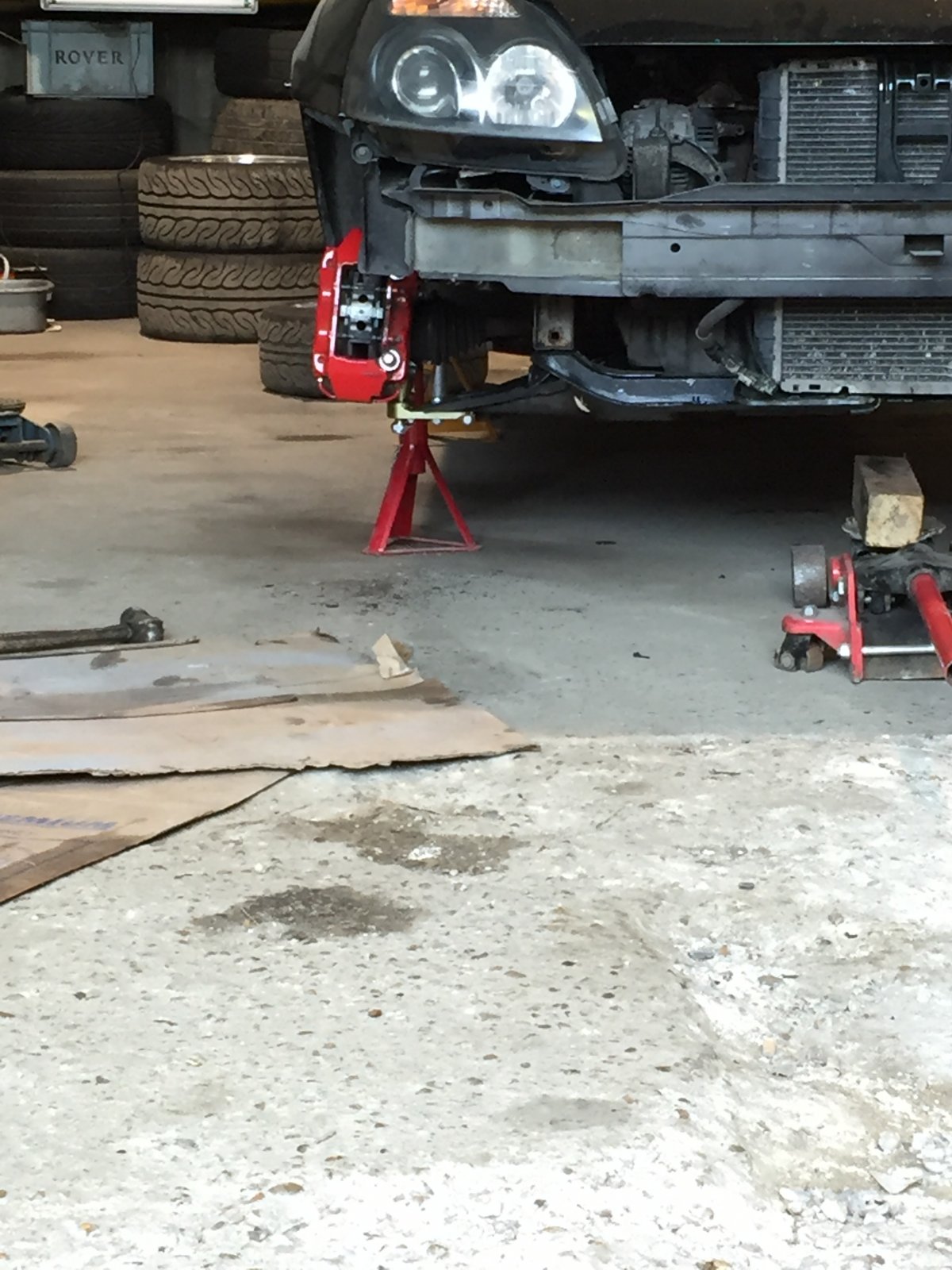

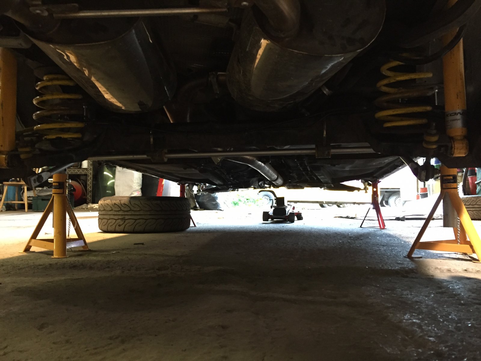

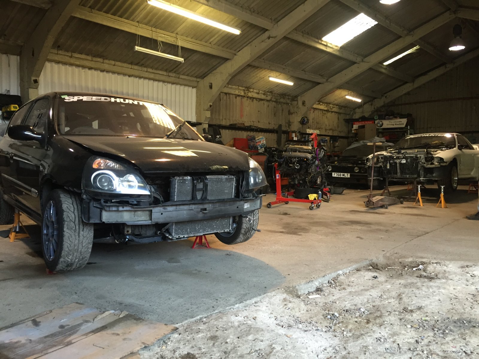

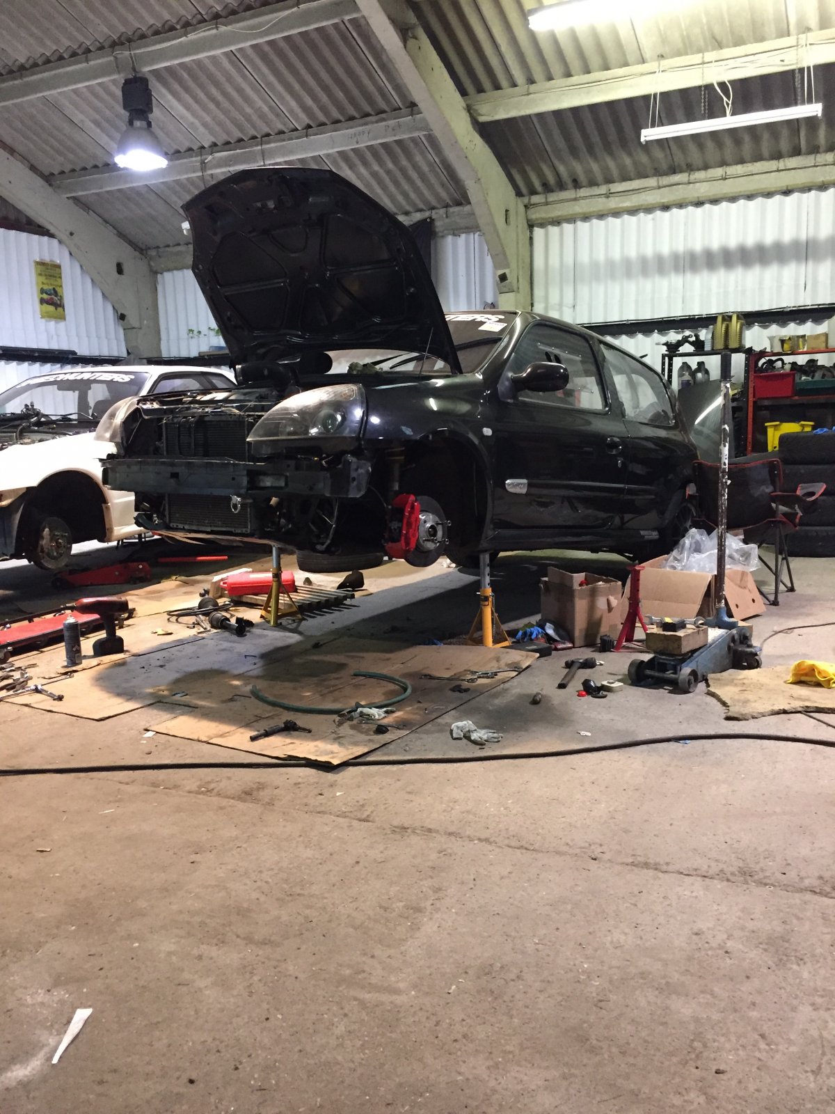

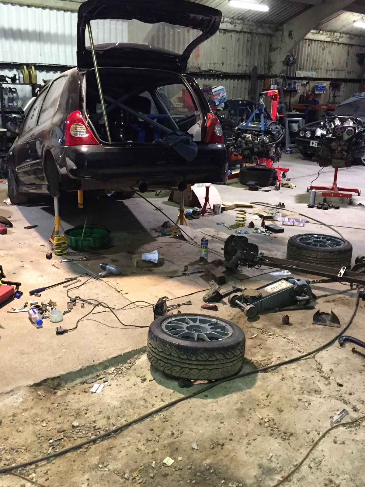

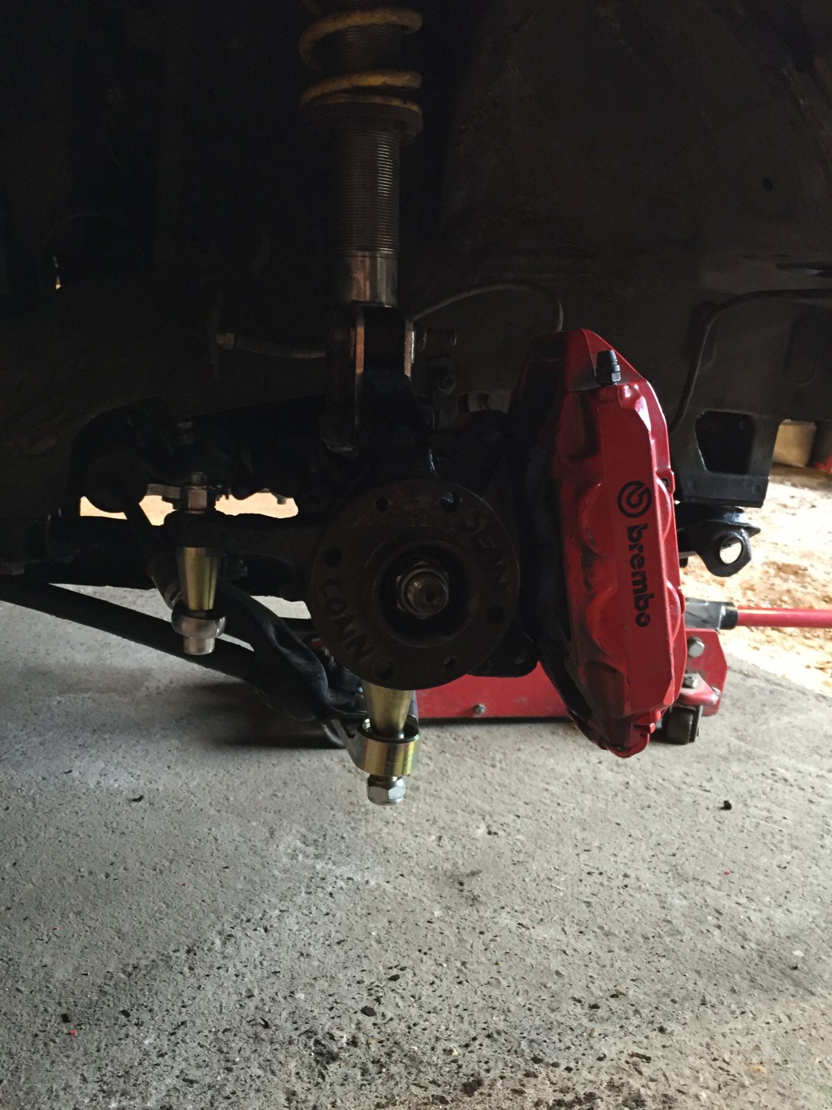

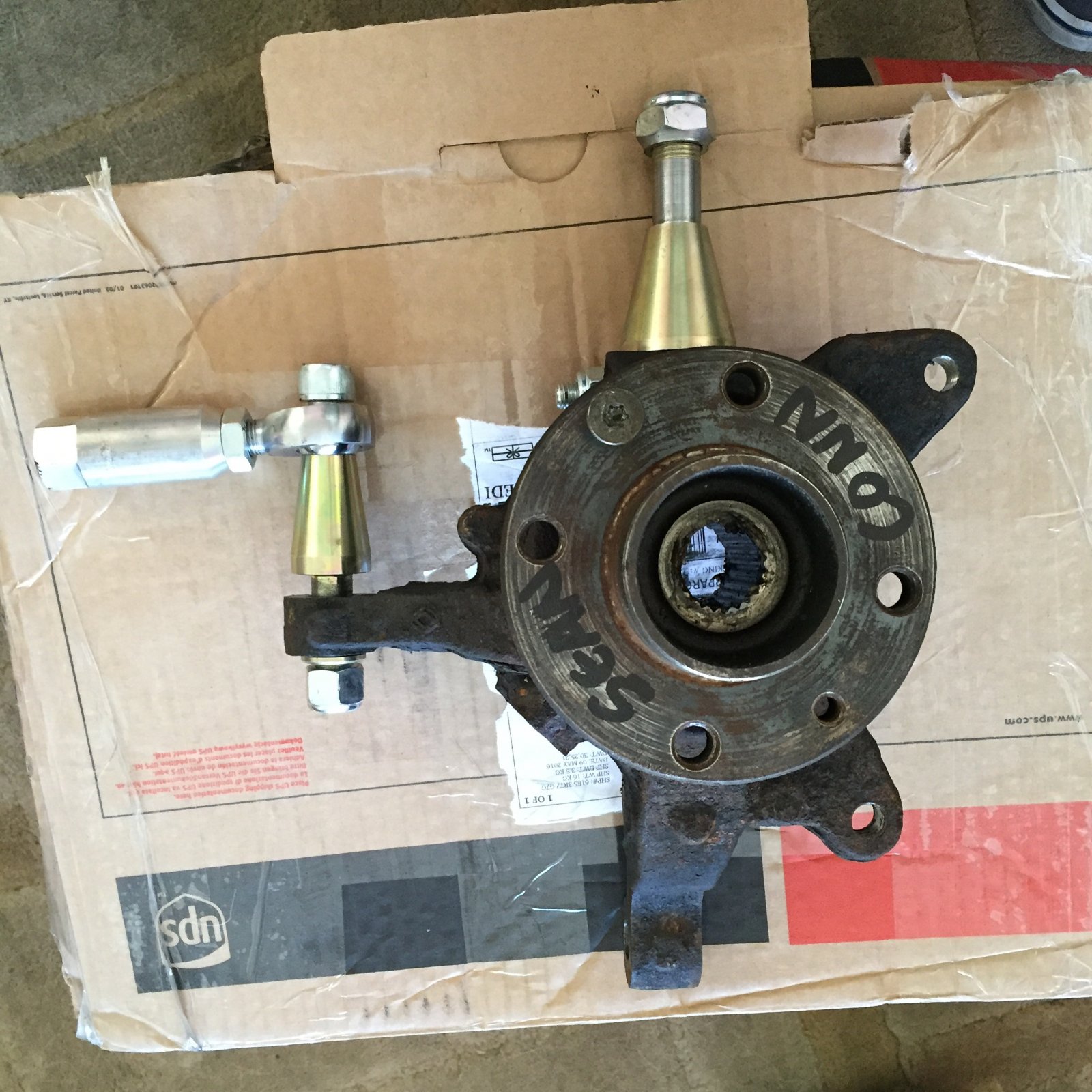

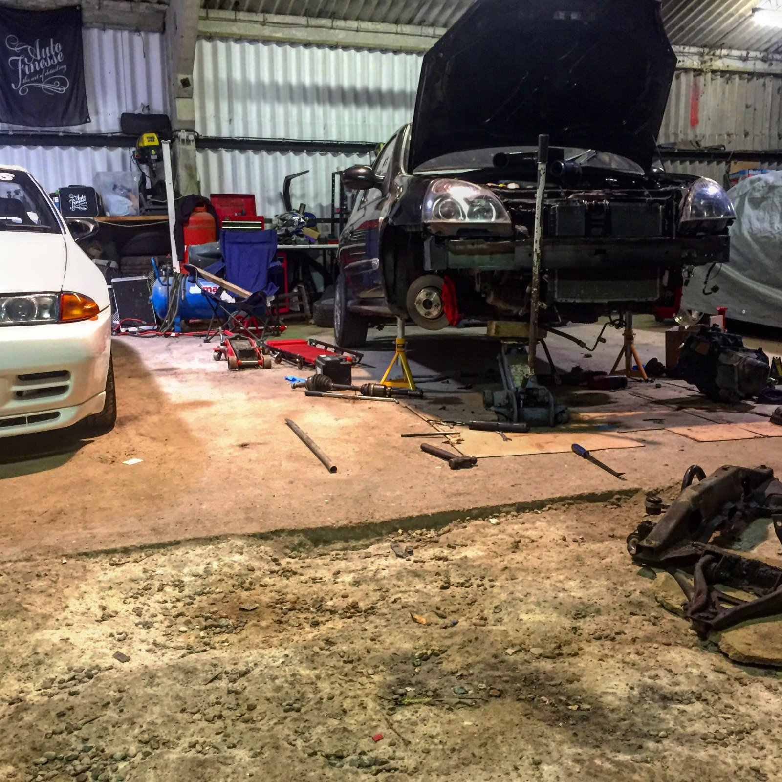

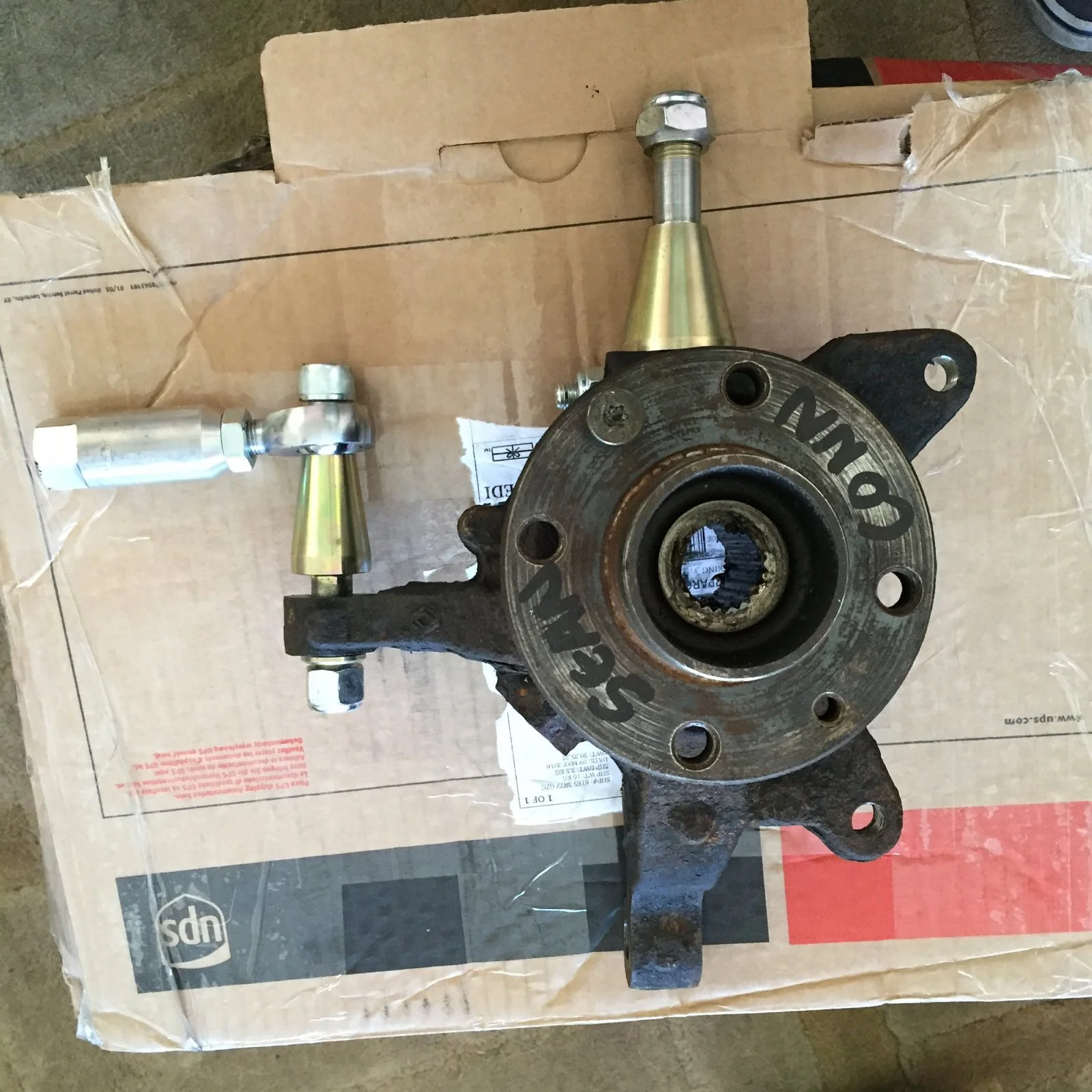

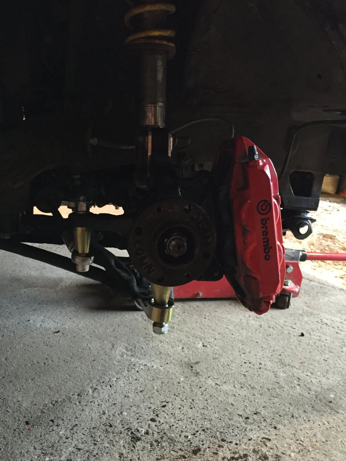

Not updated in a while but the car is nearly all back together just waiting on a new stud and nut kit and all fluids then it'll go for a set up and be driving!
Some pictures of what I've been up to ..
So to summarise what I've done to it is - new gear box/clutch/drive shafts.
full powerflex black series bushes every bush on car changed.
changed all the rear beam and subframe captive shite whilst I was at it.
tarted up my whiteline arb with a cost of silver hammerite just whilst it was off and on the floor,
and fitted @NorthloopCup amazing looking roll centre correction hubs seriously can't wait to have a drive with them on!
Thanks for reading :)

And how easy were they to fit???? Lol!

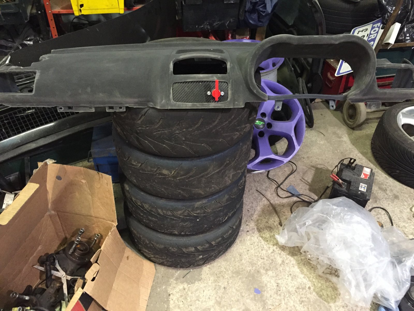

Been meaning to fit this into my dash for months finally got round to it, need to run a power lead and fit my smaller battery, I under stand I need a Longacre bulkhead through connector or something, not as simple as poking a wire through a gromit as I first anticipated lol
seanconnolly
  clio 182
Step drill bit will sort the hole put :wink:
I'll have to give it a go!

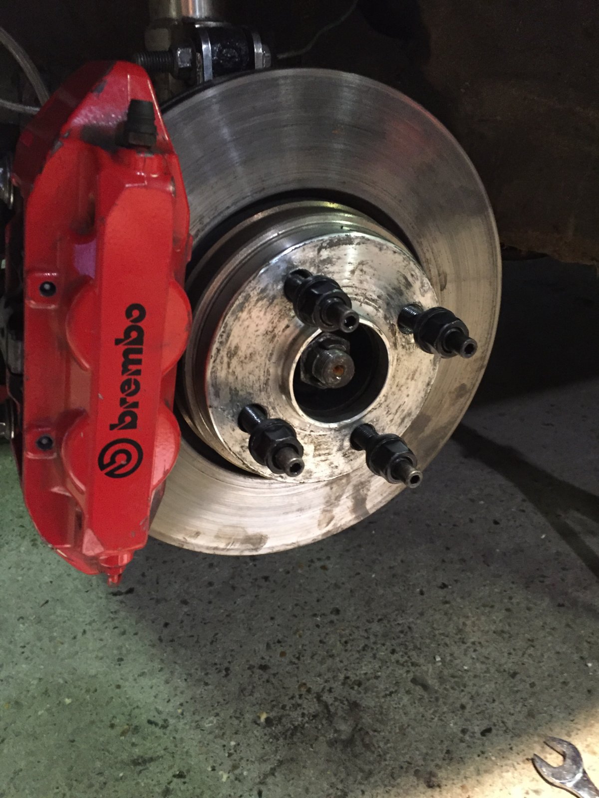

Disaster tonight as I set about fitting my new stud and nut kit the front were fine but the rear 1 of the studs is just spinning so take it the thread is stuffed... Looks like I'll be ordering new discs Monday! Doh!
Elite developments 90mm stud kit in black hopefully will look nice against the grey ultralaggeras!
It aint the discs that have the thread in it brudda, its part of the hub
