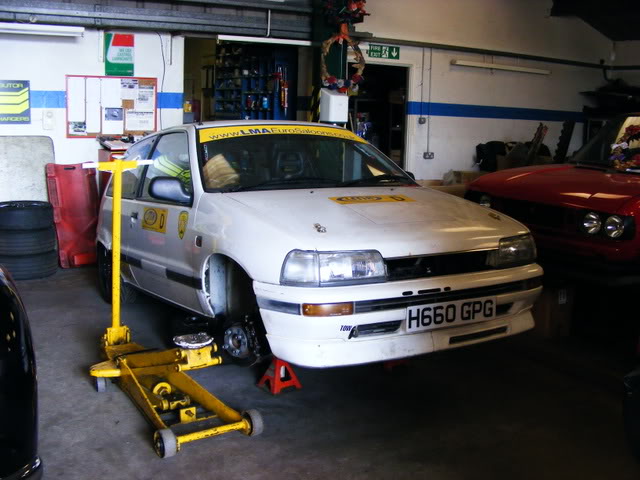

Last saturday was spent at Mark Fish Motorsport,
First we levitated the car

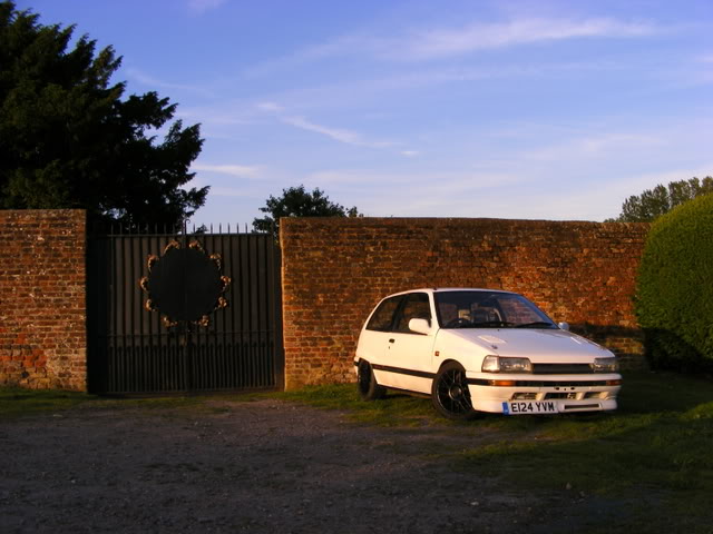

any full pics of the car? also how hard was the oil cooler to fit?
thnx. gup
Yes mate. These where taken after the engine build earlier this year. Haven't had time to do any decent shots with new cage in yet.
