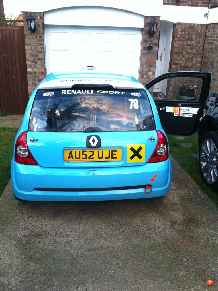

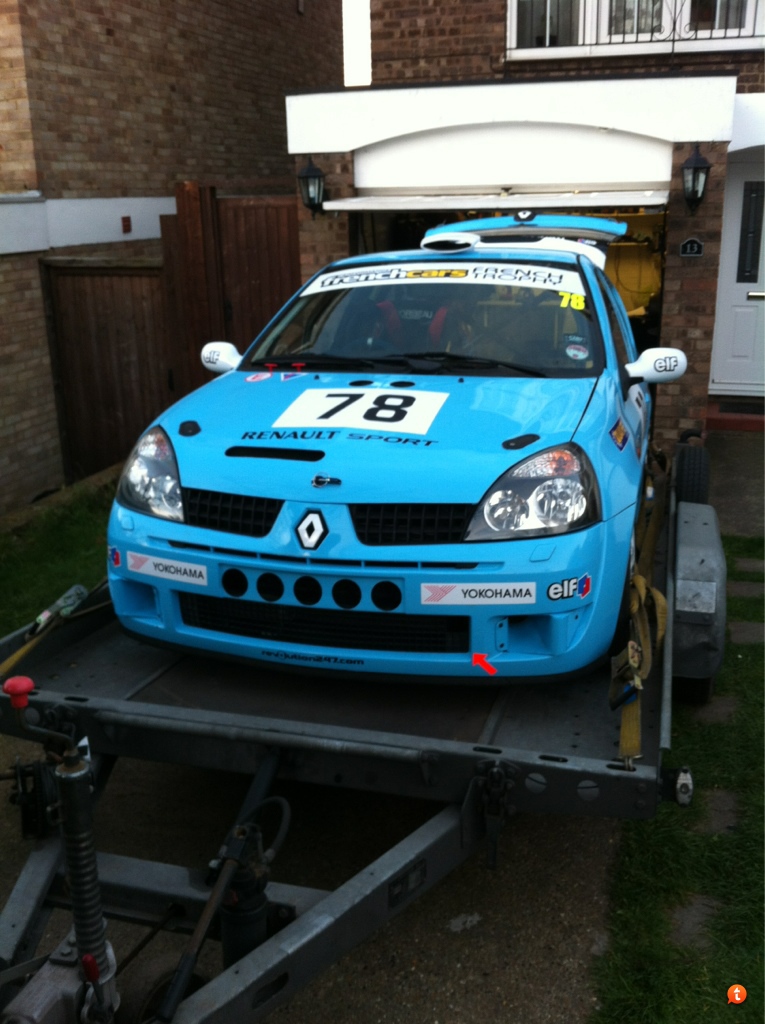

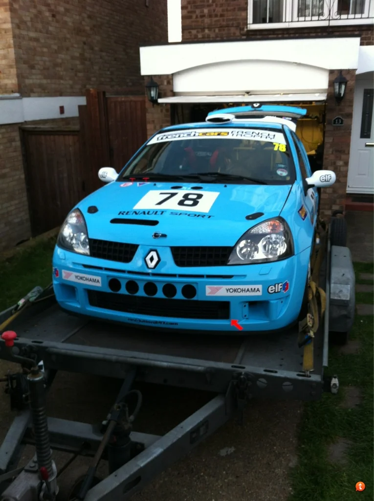

Car is all loaded up ready for tomorrow test day at Rockingham.
Past few weeks have been very busy getting the car race ready. This week I have fitted new all rounds discs and pads and now back to running spacers again, 10mm rear and 15mm fronts. Took the car for a road test drive and all seems good.
Looking forward to getting back out on track now.

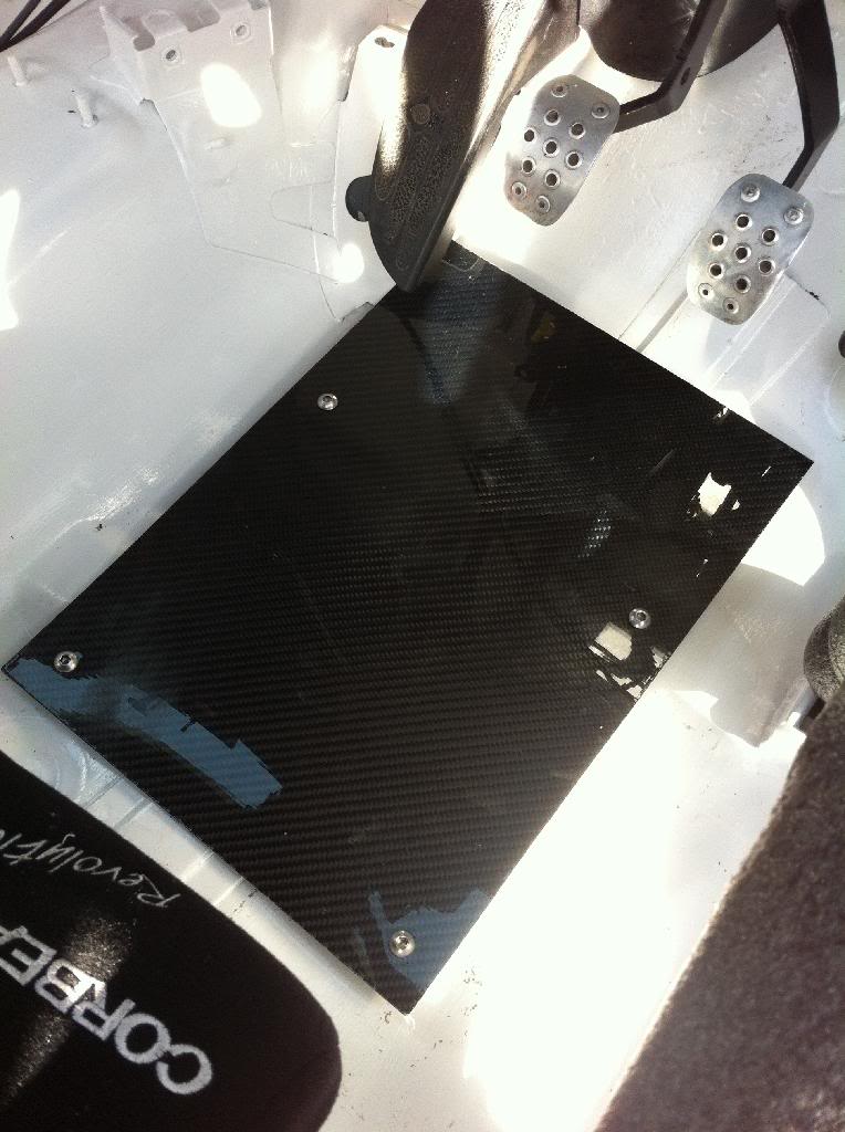

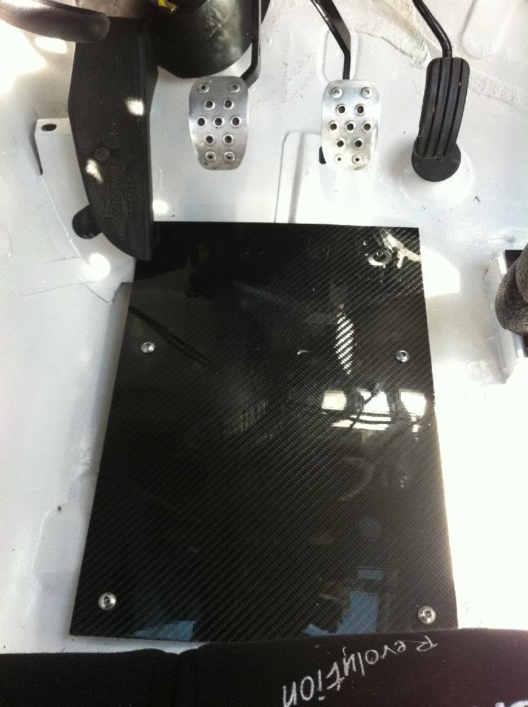

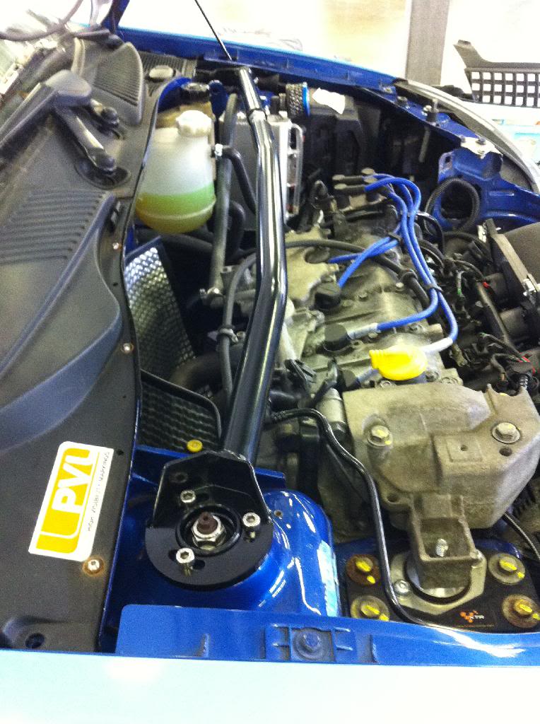

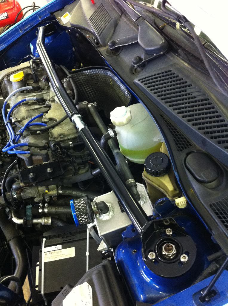

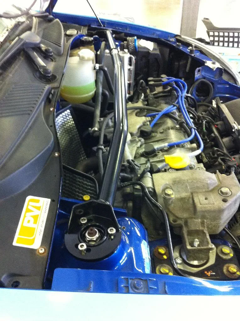

Car was fine, the new additional light weight fly wheel was really noticeable esp when it came to heal and toe and engine breaking so that's a mod im happy with. Also made a drivers foot plate to bring the heals up closer and also added the new KTEC front strut brace that bolts onto the ktec struts.

New KTEC front brace fitted
Driver floor (DIY BluePeter edition, 4 bolts, few spacers and a A3 piece of 4mm Carbon Fiber) Job done.

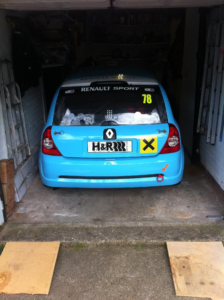

Car is now tucked away in its home, awaiting the first race meeting of the season in 2 weeks :)

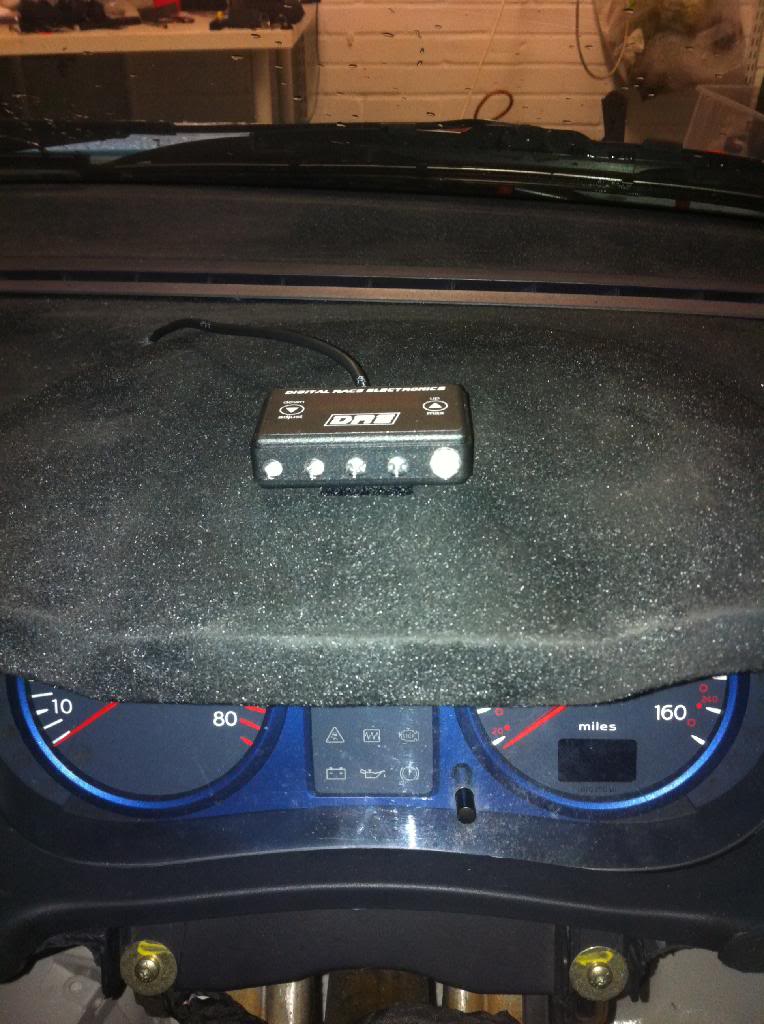

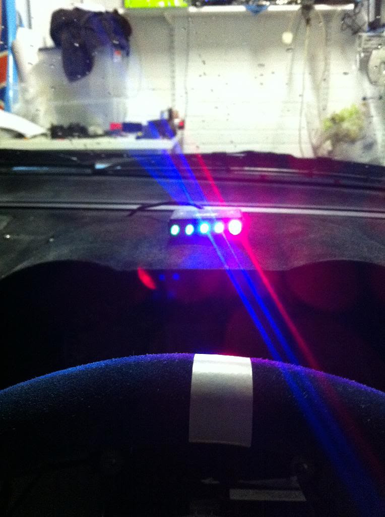

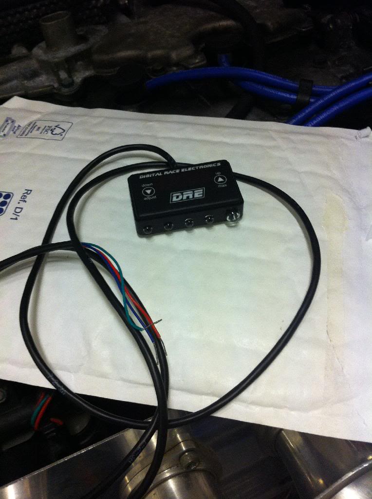

Small update, finally installed my DRE Shift light, took me a year to pull my finger out. Simple to install and set up, not tested it yet. Not bad for £80
Bright little bugger, had to turn the brightness down to the lowest setting.
