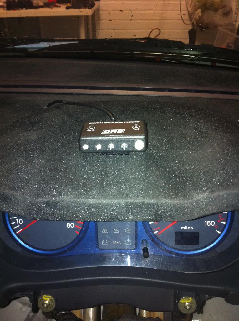

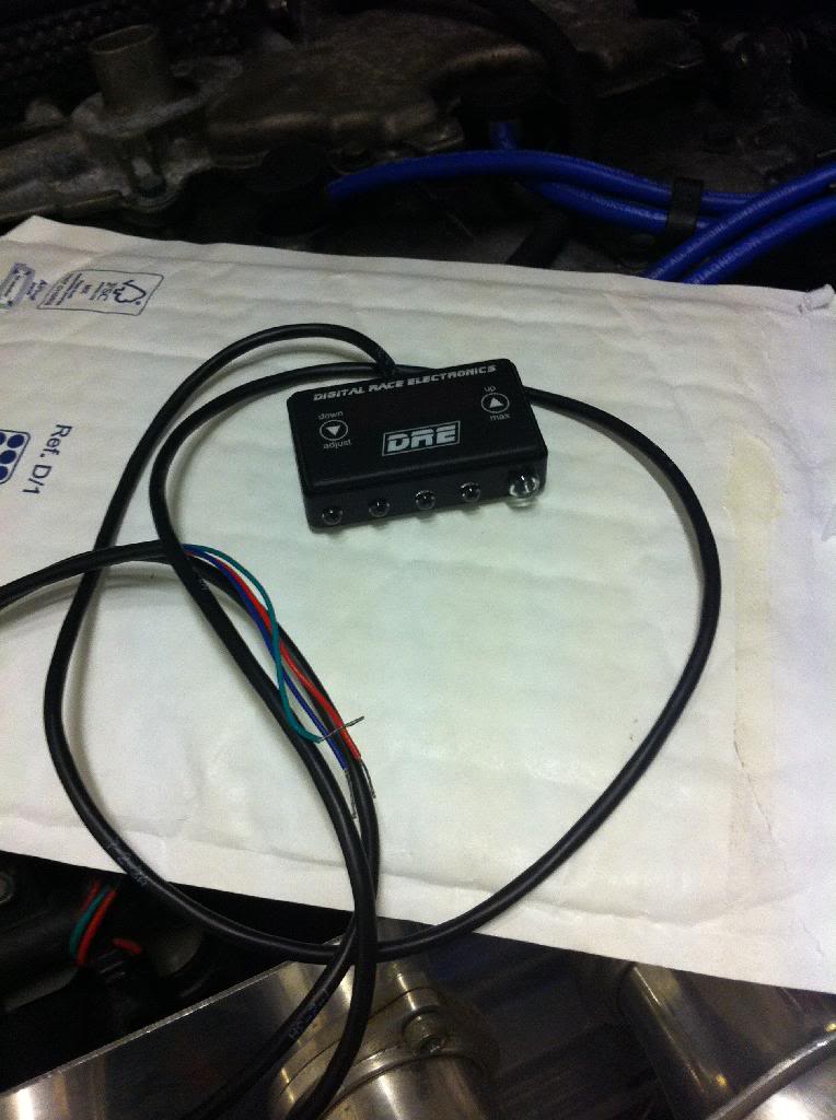

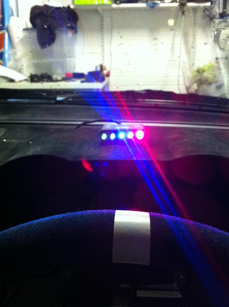

Small update, finally installed my DRE Shift light, took me a year to pull my finger out. Simple to install and set up, not tested it yet. Not bad for £80
Bright little bugger, had to turn the brightness down to the lowest setting.
Where should the tacho signal (green wire) connet please?
  Renault clio mk1 172
It connects to one of the three pins on the ignition coil plug. Think it was the outer pin of the three. If it don't work just try the pin next to it. (Im away from car so cant check it).
Thank You very much Sonny, could you please check the pin for me when you are with your car? Because I do wish to install a bigger tachometer that with shift light for my 172. Thank You!!!!

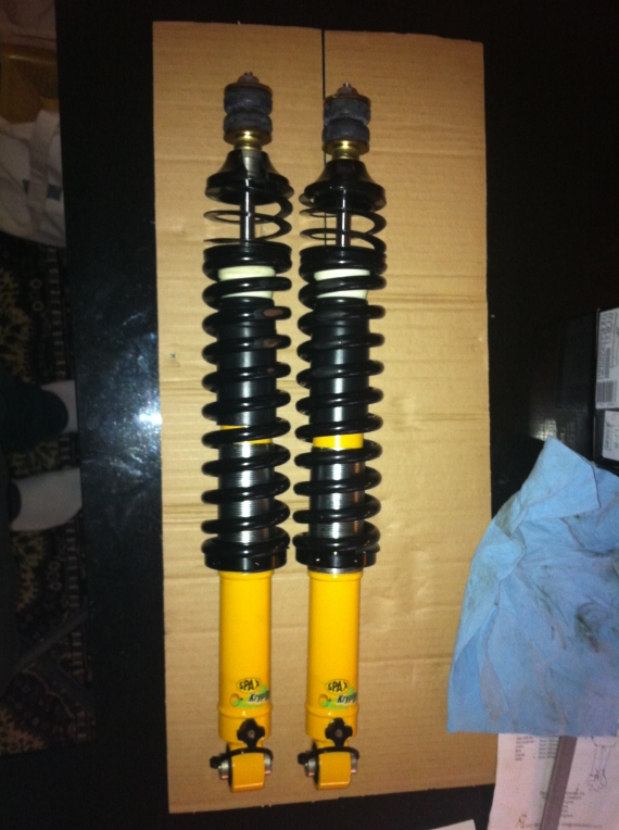

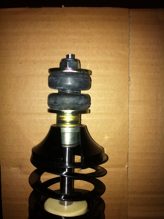

Update: Spax suspension.
So, I received the rear replacement suspension from Spax this week, unfortunately, according to Spax, the unit I had sent off to be replaced was "damaged" due to my action and not theirs, so this meant that my warranty was voided. The "engineer" who I spoke to who inspected my rear strut(s) says that a small nick/cut in the rod had caused the valve to wear and lose pressure/oil. I didn't recall seeing any damage to the part that could be caused by myself, but couldn't prove otherwise.
Spax had however offered to replace i with a newer uprated unit if I purchased one side, so I basically got the rear units for half price, so I decided to take the hit.
The new "uprated race" units do look different with a different top hat and lowering shims, also they have been re-valved to suit more stiffer spring rates (around 500lb). The rods seem thicker with beefier top mount bolts with larger bump stop and a dust cover. Maybe if they had these fitted before then this problem would never had happened.
These are designed to be used without helper springs, if using the original 10" springs. I use shorter springs and prefare to use helper springs to make life easier.
Fitted them to the car already in time for this weekends race at Castle Combe.
