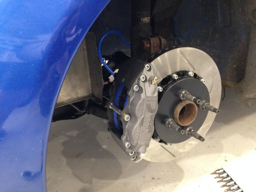

Mintex F4r absolutely superb pad. Easily the best I've used on Clio.

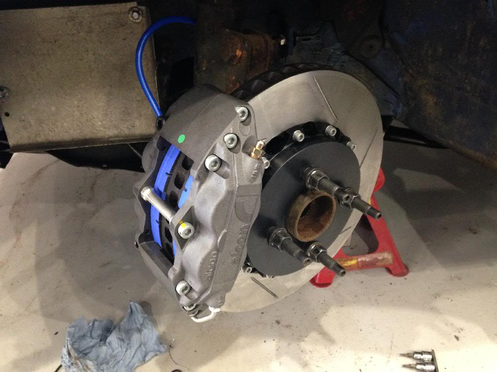

Yes, looking forward to getting the Alcons on. James picking them up today for me and fitting next week. TOTAL waste of money. I was drunk last night and standing next to the two Clios feeling out blinged. Wallet came out lol
What discs was you using with the DS3000's? was they grooved? If so the groves should clean the face of the pad, or at least keep the build up to a minimal, maybe de-glazing them after a race/track day would prolong the life? Generally im not a fan of drilled discs, as these can act like a "cheese grater" and cut into the pads, its this that normally crates the warping effect on discs.
  clio cup
Steer clear from drilled discs as the holes are a weak point which cause the disc to crack during hear cycles

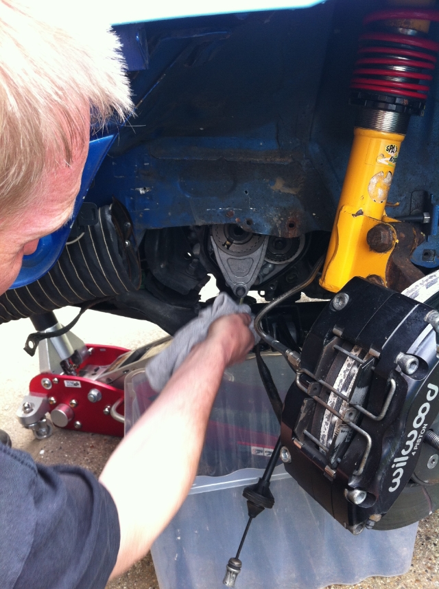

Matt from CodeRed came over today, and after having a brew, he cracked on and swapped out the 5th gear (33/37), after that we then removed the steering lock, one job I still had not got around to doing.

Is fitting the 5th gear a difficult job with the gearbox in situ?
Good luck for Saturday, which race is it?
No, not really.
Hardest job is driving out the roll pin that holds the 5th gear selector fork on.
(there is a special tool that helps remove the hub from the syncro though).

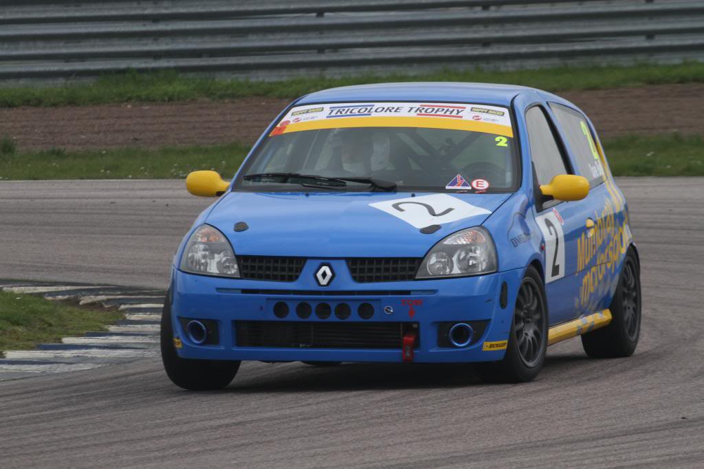

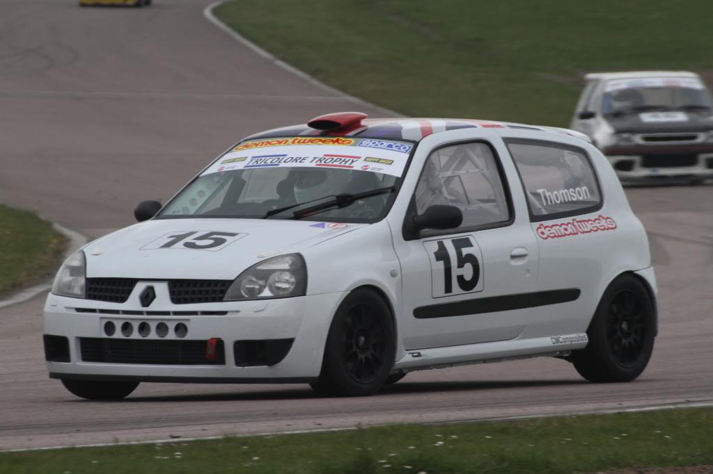

Qualified 10th (1.41 lap).
Race 1 finished 6th
Race 2 finished 7th
Overall very good weekend, good to meet up with old and new faces, you know who you are.
Being a small grid of 15 cars (dropping down to 10 in the final race) and Rockingham being a large circuit there was always the chance of an empty circuit when everyone had found their legs and had stretched out, this was most certainly the case for me, in both races, I was by myself most of the time, so this gave me the time to experiment with lines and gears through some of the corners, while maintaining a race pace. I managed a 1.41 lap in qualifying that put me 10th on the grid, not bad, I knew I would be 5 seconds beyond the fastest car (test day proved that 2 weeks ago) I hit my limit with the 1.41. Race 2 the fastest lap was also 1.41, while I actually got slower by race 2 I managed a 1.42/3.
The car performed relatively well, but the suspension was holding me back, it was not giving me the confidence to push faster through the corners, as the car felt unstable..something I need to look into. I managed to lock up a few times into turn 10 (conceived there was a spot of oil there from the R5, anyone else experience that?

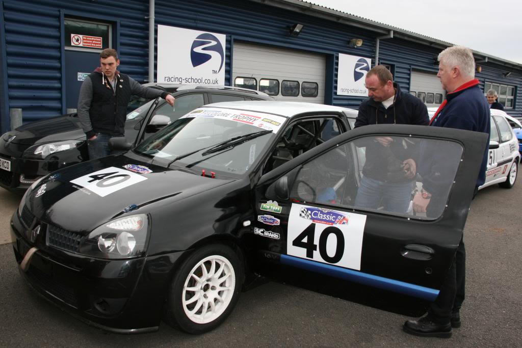

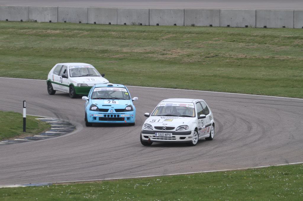

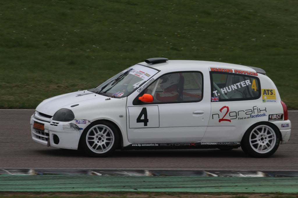

Few pics from the day
Around the Paddock
Races

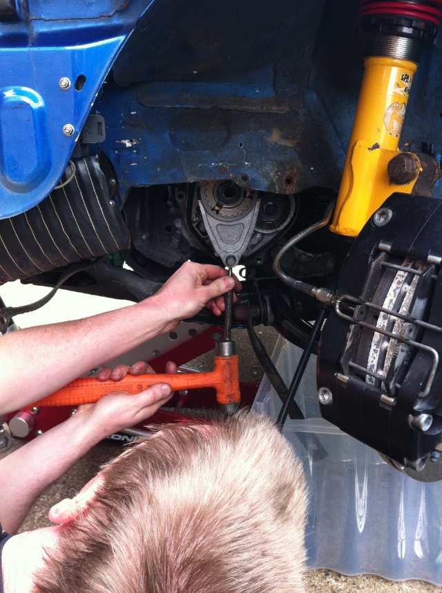

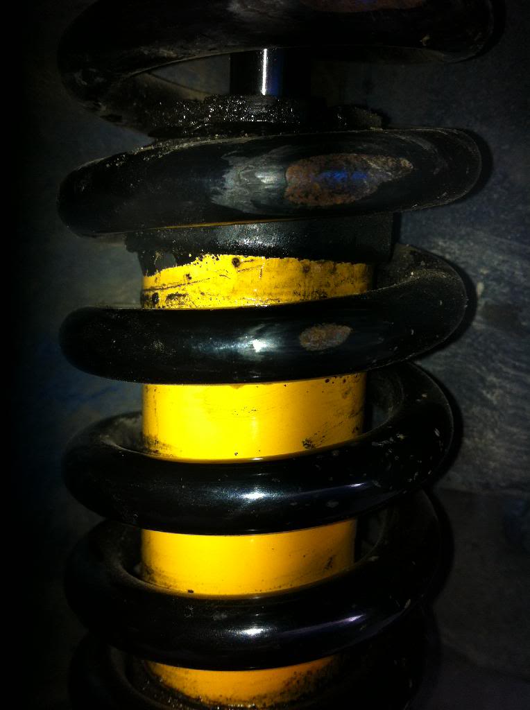

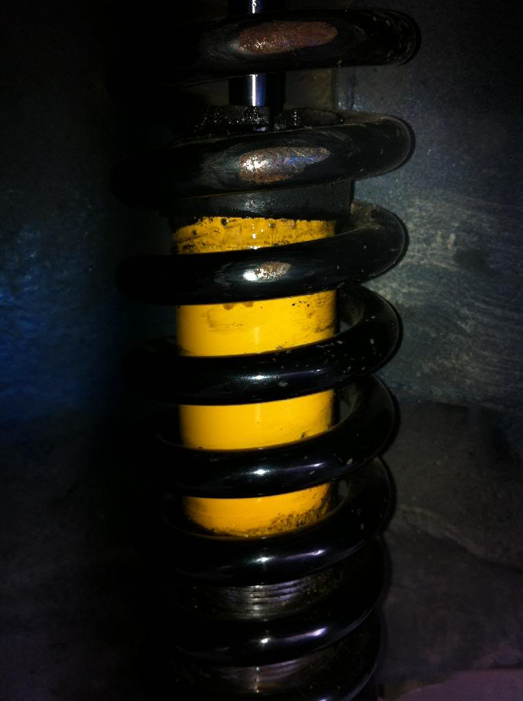

Checked over the rear suspension yesterday due to the car being unstable at the last race meeting and my suspicions was confirmed. Shock horror my Spax RSX rear strut had decided to dump its oil, on moving the arm up and down, air can be heard hissing from the strut.
So, quick call to KTEC (whom I purchased the units from) and they offered to send replacement out, however I decided to opt and deal straight with Spax to speed up the process. This week I will send both units off to be tested, hopefully they will both be fooked and I will get 2 new replacements. I may add that customer service so far with ktec and Spax have been spot on. Let shope the Easter Hols dont delay things. Always dramas :dead:
I will still go ahead with my original attentions and uprate the springs all round (outlay around £120) this will be a cheaper and quick fix to a half decent suspension set up.
This will give me time to save and order a set of ASTs, the "quick fix" stiffer springs and Spax should be ok for Castle Combe in May.
Gutted as the car was suppose to have cams fitted this week
