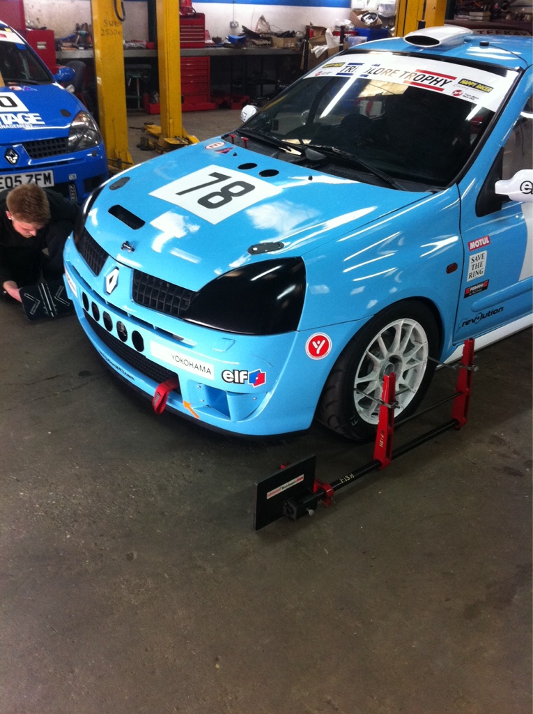

En-route to Rockingham on Friday I tool the car to Mark fish Motorsport for a full geo set up, couple hours later the car was done and we was on our way.

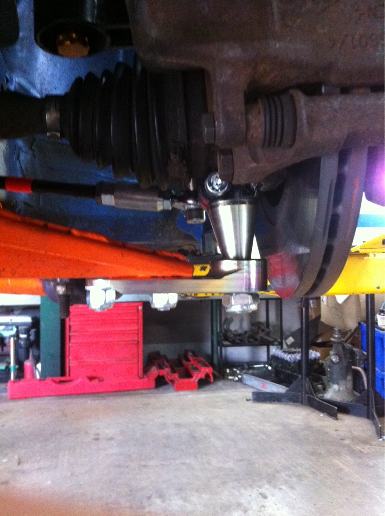

Close up of @NorthloopCup RC hubs that i fitted a few days previously

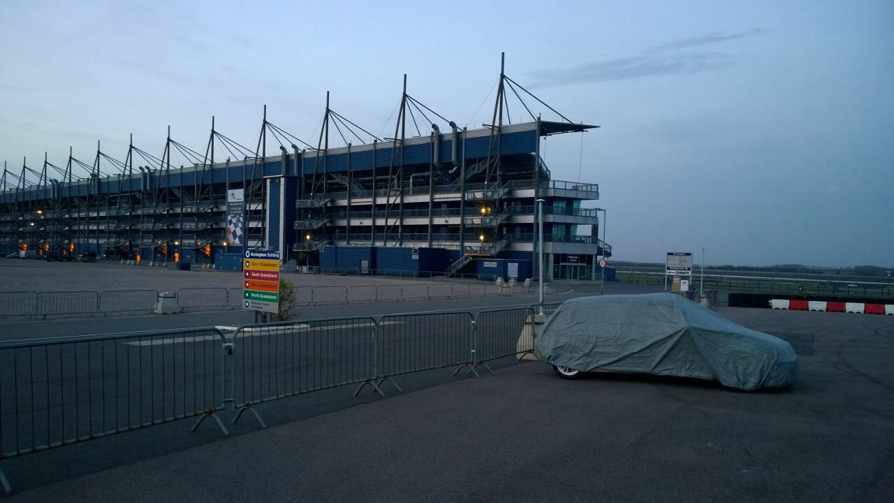

Arrives at the Rock to be greeted by Russ and Tony who had set up a few hours previously, after having a quick chat I unloaded the car and trailer and wrapped the car up for the evening as rain was forecasted.
"Here comes the rain again".....

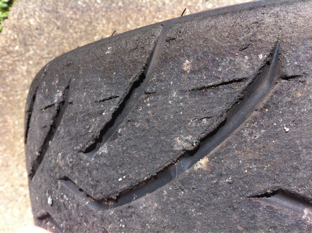

So I went out with he mindset of "its just a test session". So I stuck my R1R on and soften up the dampers a little and off I went. The car felt pretty much spot on, tyres was unless as at kept understeering with minimal steering input, so was a bit hairy to say the least, also locked up a few times as expected. I managed to put a quick lap in once I had got used to the new set up, this put me 14th (out of 27) interestingly only 6.9s away from pole, in fact due to the weather everyone was struggling and all had close times 15s separated pole and back marker. So, this was going to be interesting.

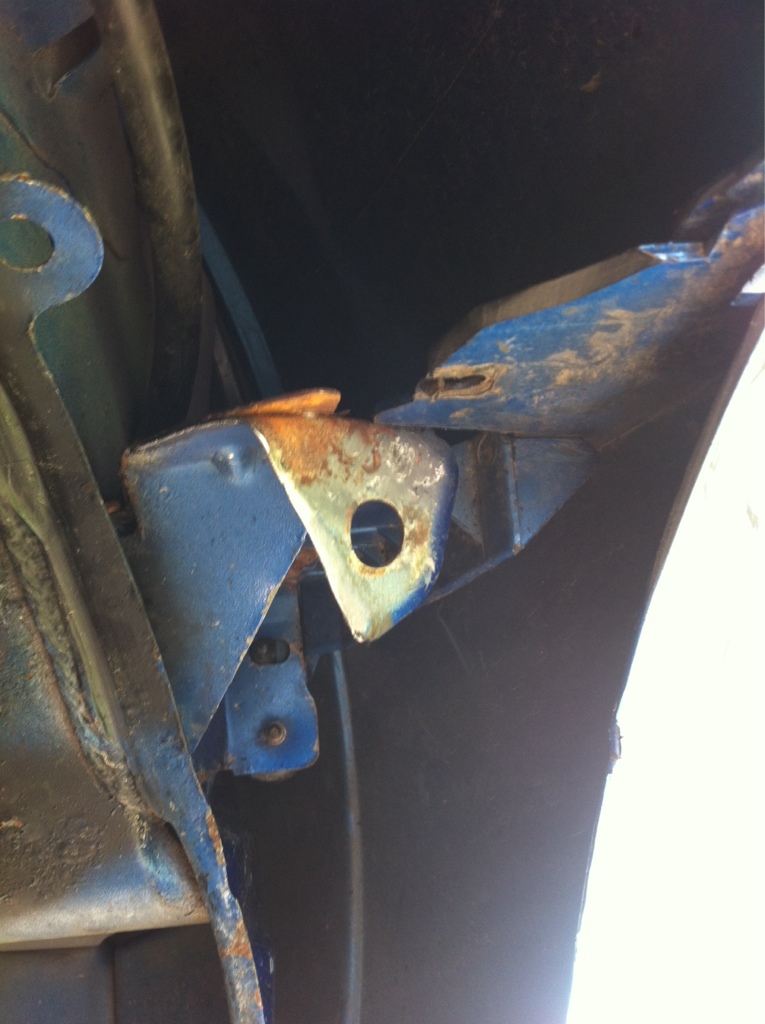

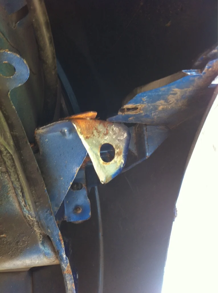

Battle damage from today was a osf bent bumper bracket, So thats going to go.

Didn't realise you'd bought James' old engine. I am heading upto Mark (Northloopcup's) to sort my RC kit this weekend. Much excite!

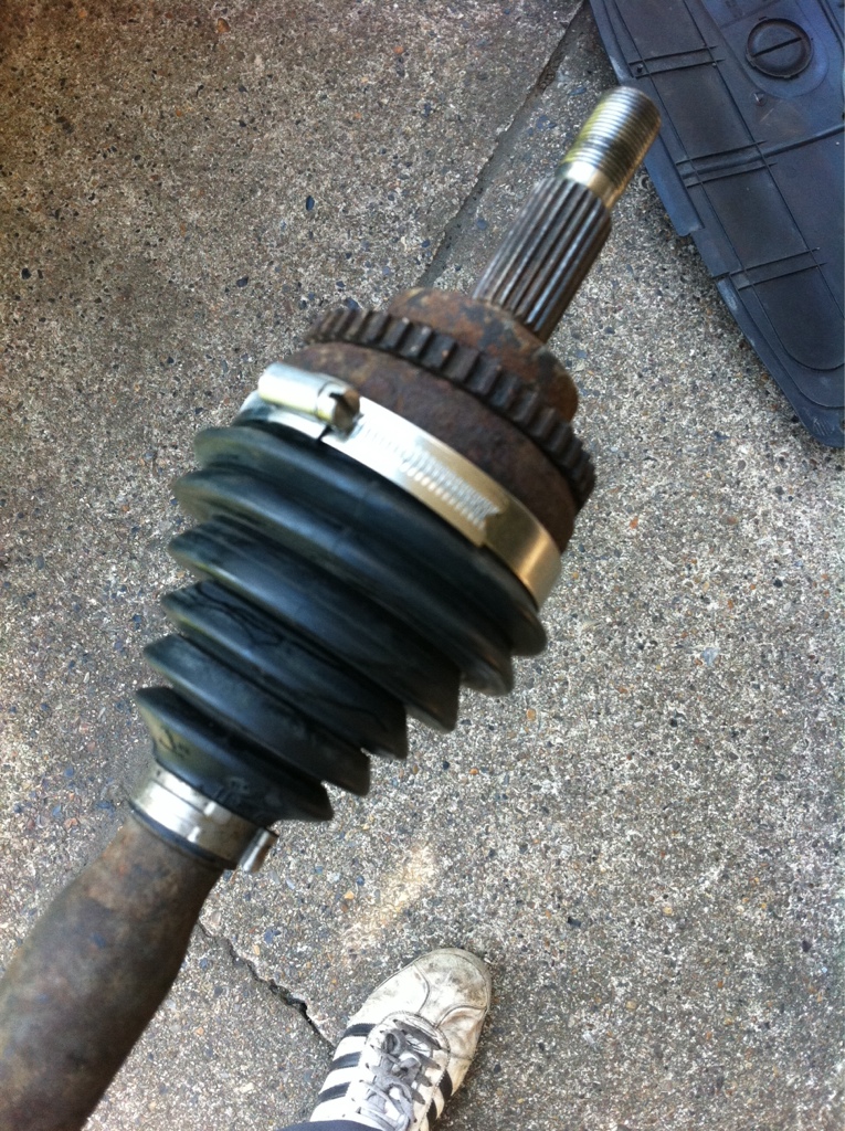

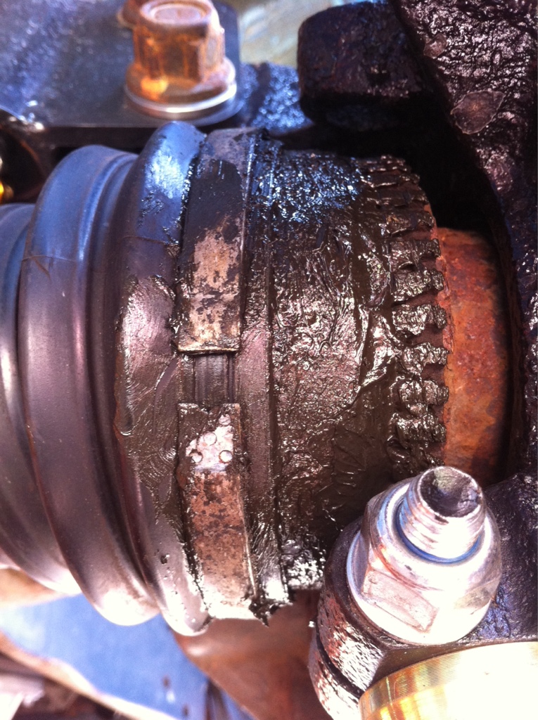

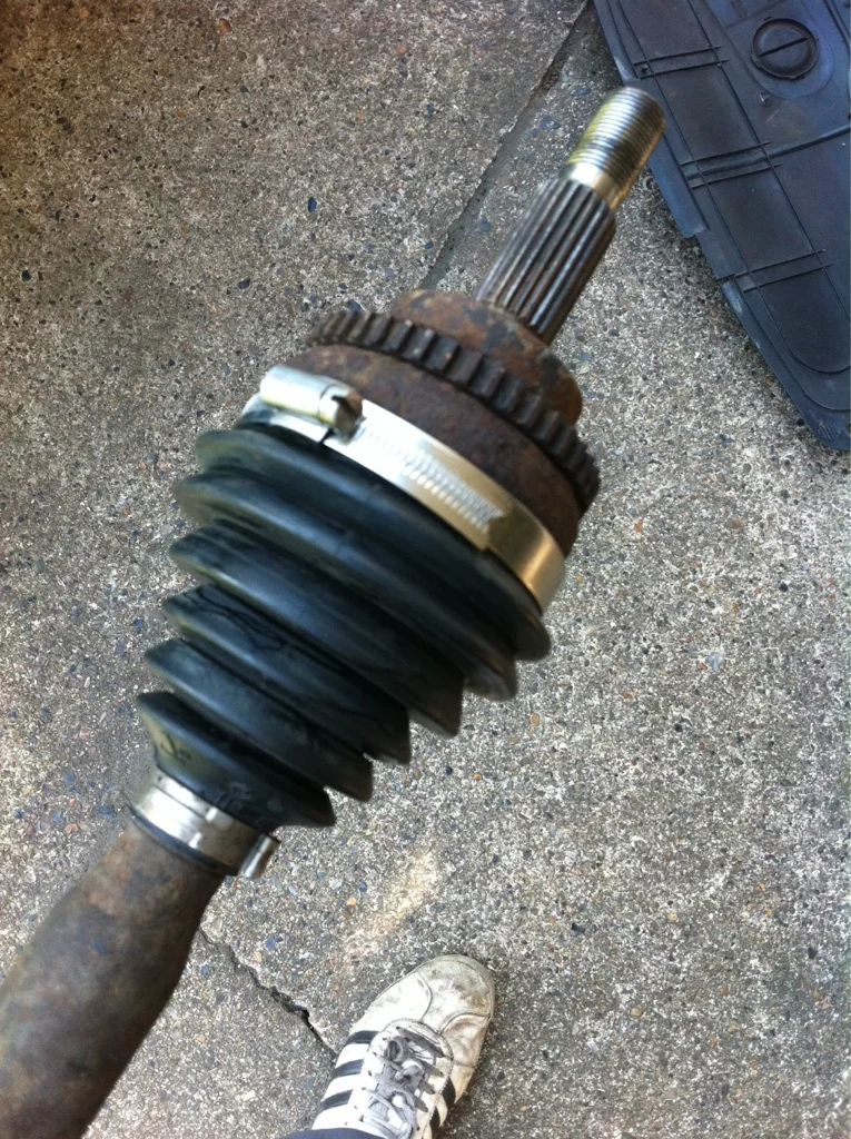

So I popped her up on axle stands and started the check, first thing I noticed was the driver side inner driveshaft boot had started to weep, I suffered from this problem last season with the original DS, im convinced its the heat from the 182 manifold as the 182 DS have a different end, contains the cv boot thus protecting it a little (just a theory)... On further inspection the outer CV ring has split too (another great CS purchase).
So I cleaned it up and popped on a spare uprated Jubilee clip that I keep in the spare box. Anyone think its too wide?

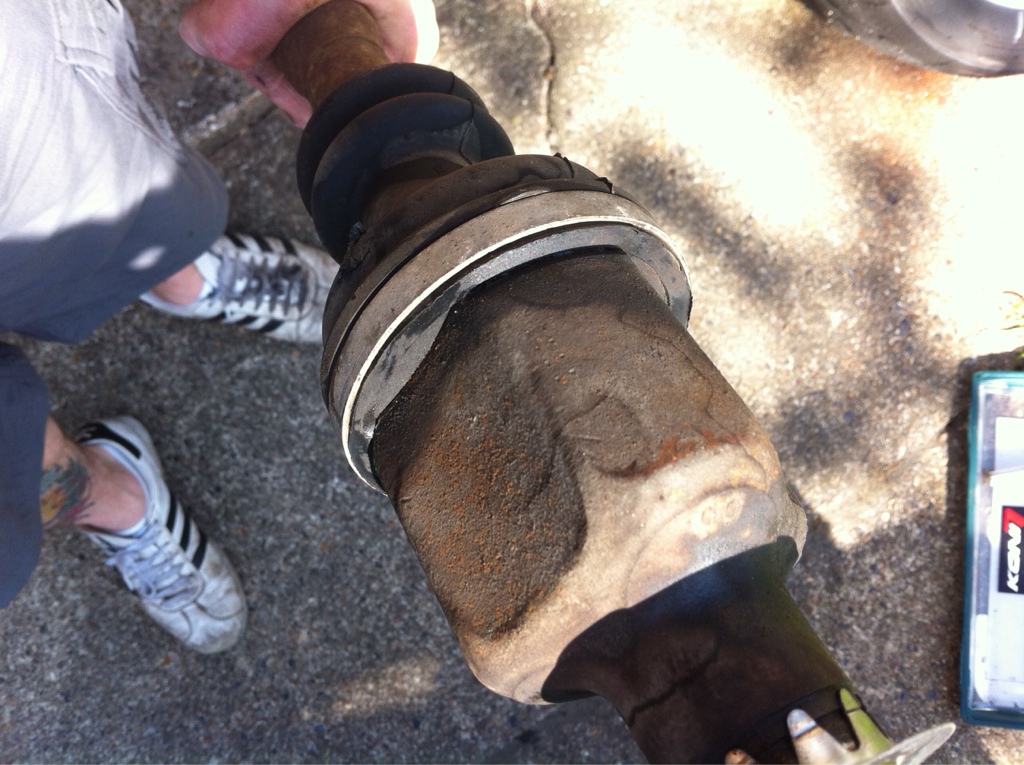

So next is to sort out the inner joint, Any recommendations? In the past I have used those tension clips but they still keep weeping.
Inner CV boot

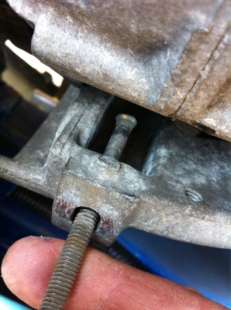

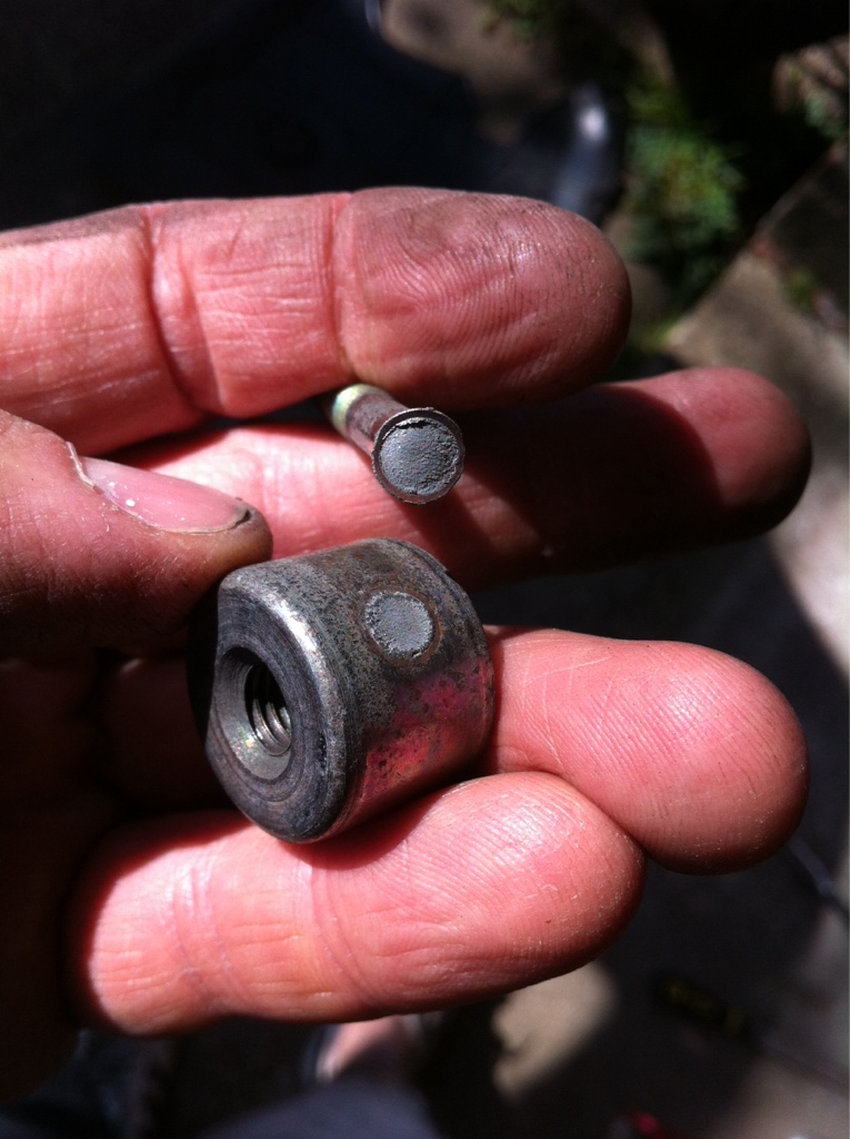

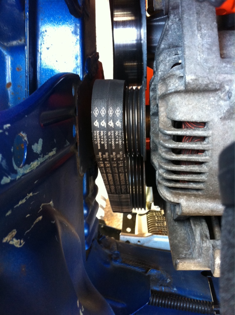

Moving on, next was a close one, noticed that the V belt has jumped 3 teeth, odd, then noticed that the alternator tensioner bolt had snapped, not sure what caused that, the 13mm bolt that retains the tensioner had gone so I'm guessing that had worked its way loose and put tension on the tensioner (so not really a good tensioner then lol)
So more parts to order...

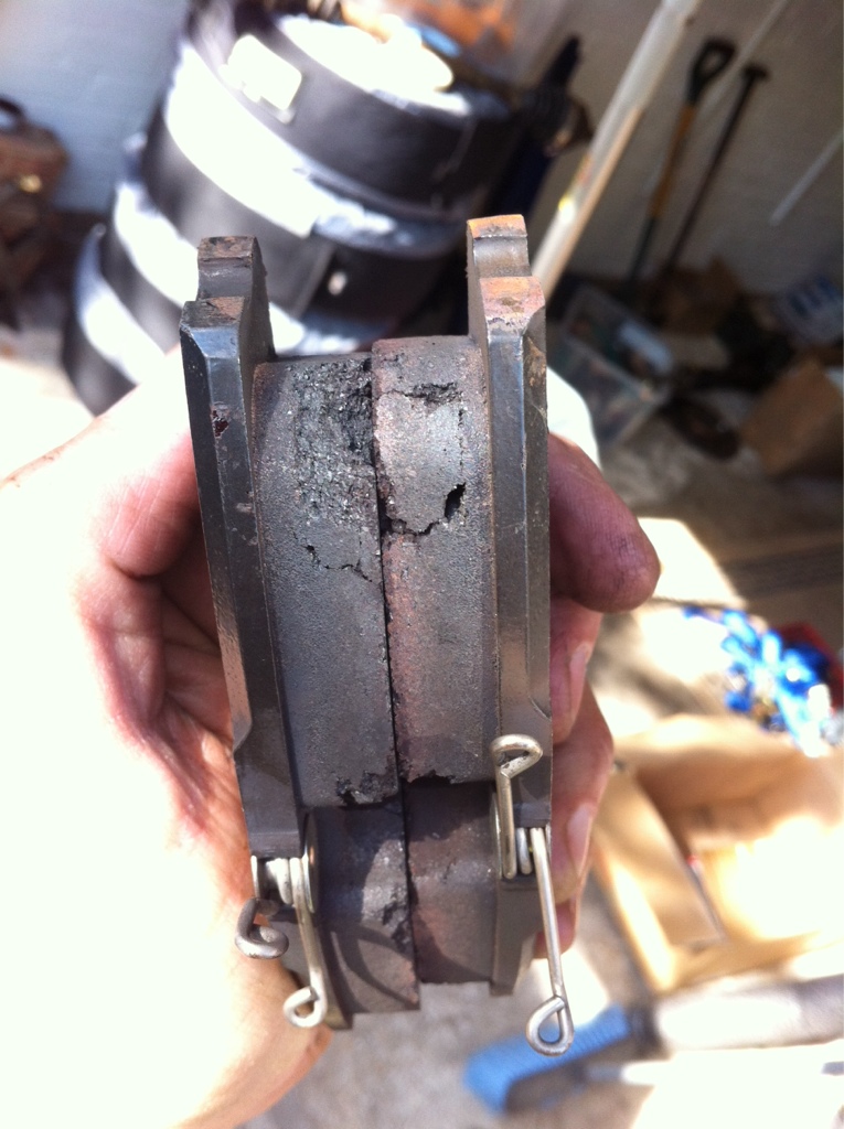

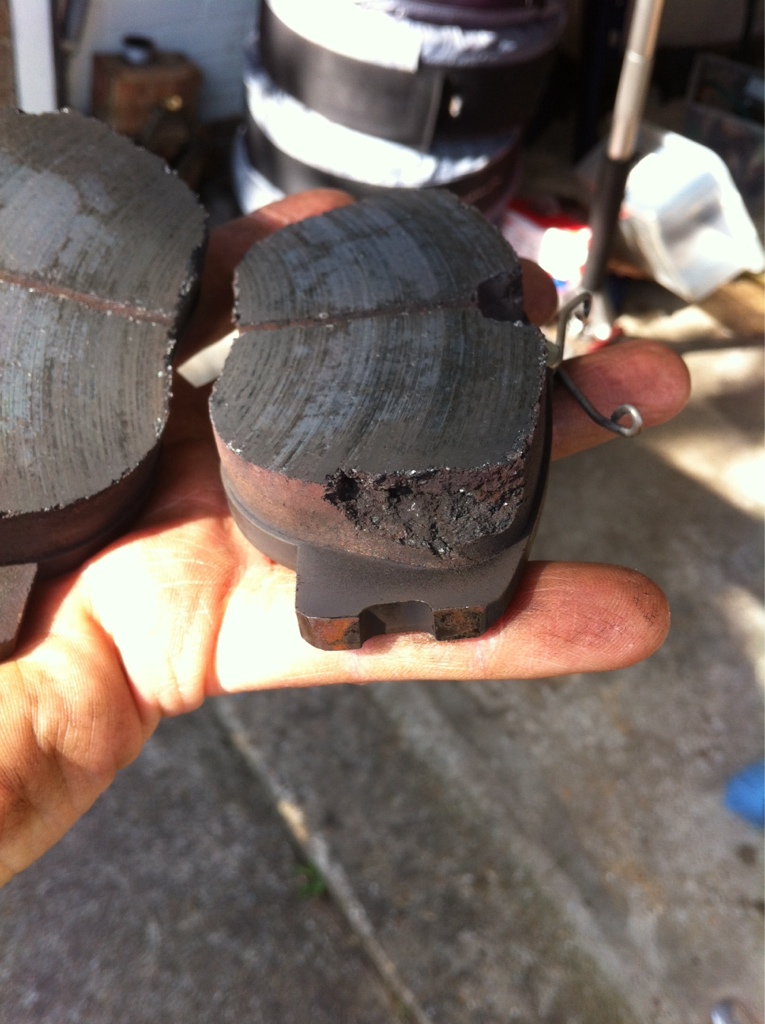

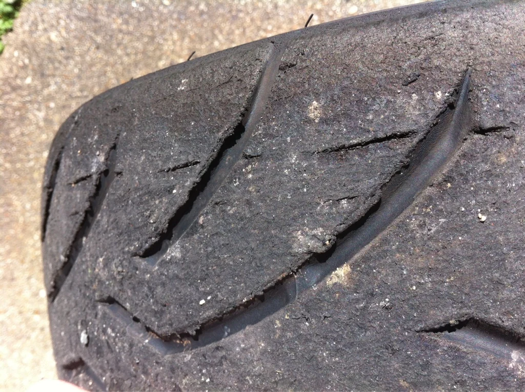

Next was the front pads, looks like my DS1.11 have finally started to give in even though they felt great. Typical Ferodo trait... Crumbling. Not bad seeing as they had covered 6 races and a test day.
I really rate these pads, but do fancy trying a different brand.

Those tensioner nuts are prone to coming loose on the cup setup, it used to happen to me all the time so I started using an extra locknut to stop it coming loose.
Shame about the pads as there is loads of meat left on them. Most race pads seem to crumble at the edges but that is quite bad.
