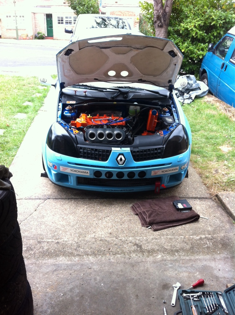

August update.

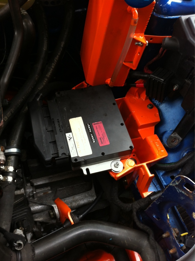

Few weeks back I sent my Gen90 off to Gems for diagnosis and repair, it was found that a R55 resistor had blown causing the interference to the CPS wires at high rpm. £110 later and the unit was sent back, iv not had time to run it up into the problem area but have been assured that this has been the cause of my current ECU woes.
The ECU is now fixed to the Upper Box mount using elevated bolt fixings (so it doesn't actually rest on the mount).

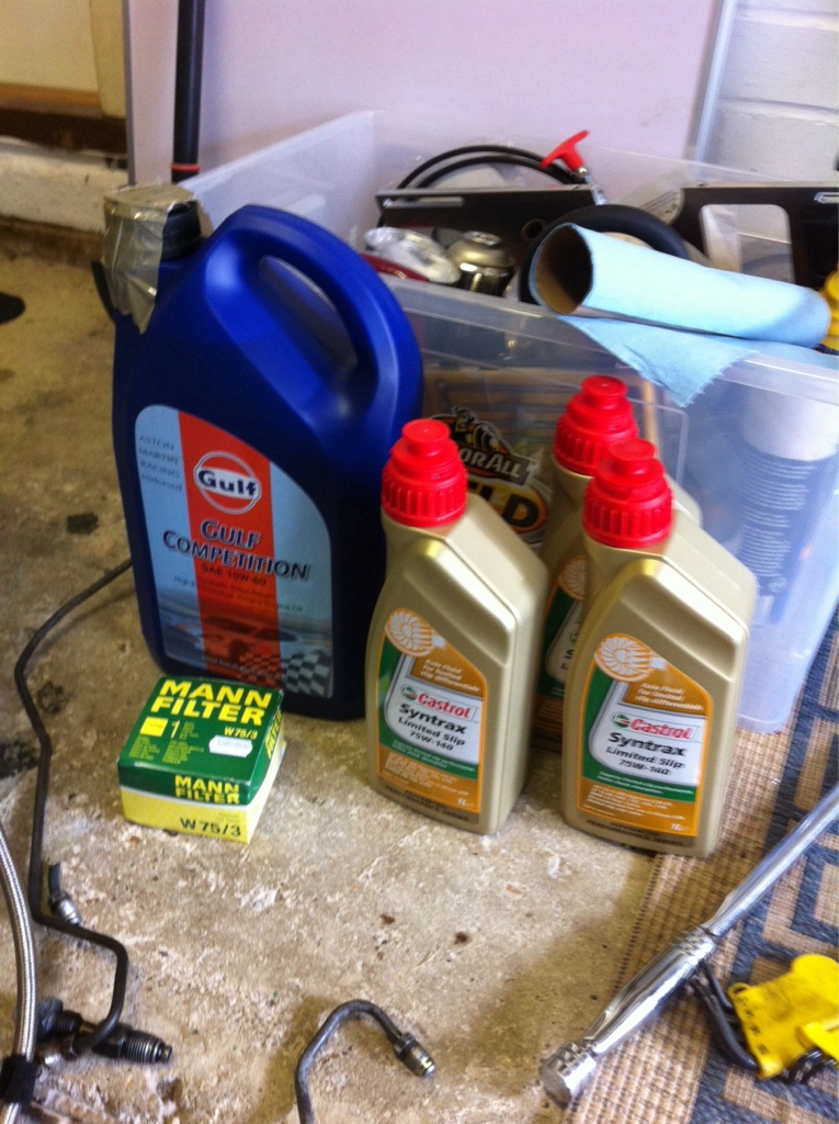

In other news I sold my Quaife LSD box and fitted a Gripper LSD with a 13/59cw+p with Megane 5th, so fitted that last week, ran the car on the axle stands through all gears and all seemed fine, I was spooked after hearing of Martins current box woes.
Changed out the engine oil and filter while the box was swapped out, checked all the discs and pads, all was fine.

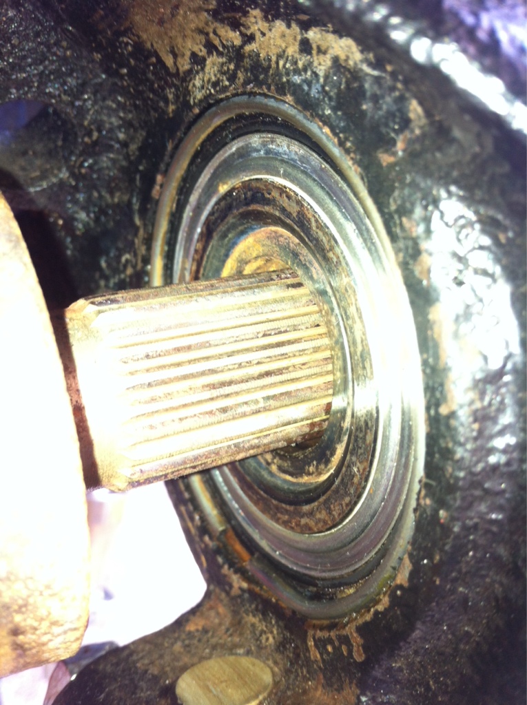

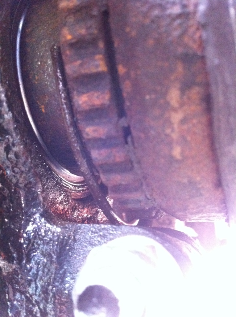

I did come across a NS wheel bearing retaining clip lose, somehow managed to have popped out, so tried to push the ring back on but would go fully in the recess, so put a dap of loctite on it and pushed it in as far as it would go. Will be keeping an eye on that. Thanks @NorthloopCup for over the phone assistance
Retaining Ring out of recess, wonder how many Clios are driving around with these missing.

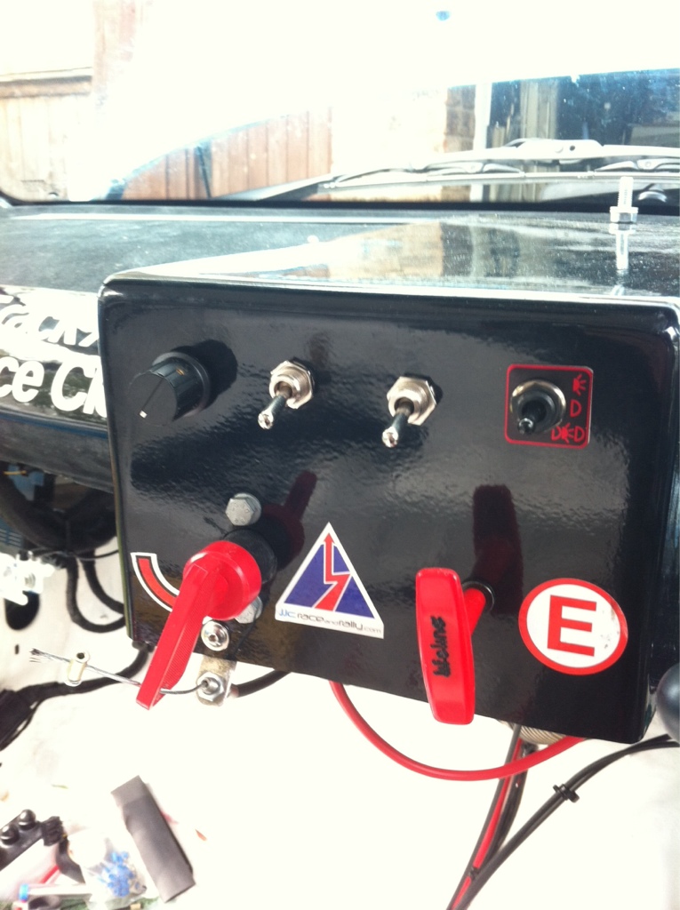

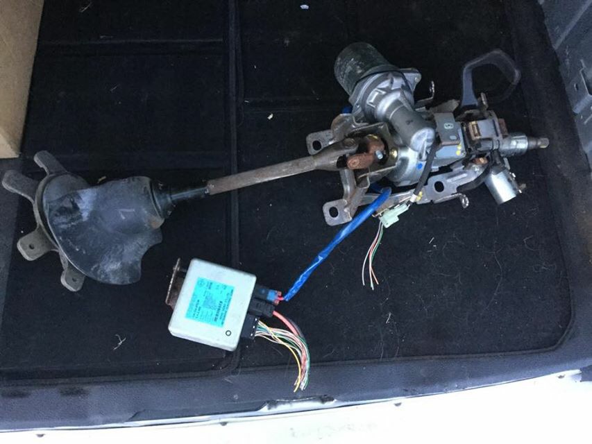

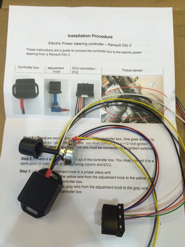

And last but not least, after 6 months I finally got round to fitting the EPAS system, all went well apart from one of the UJ had seized on the lower column, the bearings had totally collapsed, so called around and picked one up for £40 on ebay.
Located the resistance dial on the dash pods.

Do you mind me having a look at the EPAS at Silverstone, as I'm changing mine after. I want to make sure I've got all the bits before I start. And how long did it take?

We all know pics speak a thousand words [emoji2].
Here's what I have got coming .
Also I have that resistor kit from Bruno off EBay.
Of course mate, I take it you have the control pack from ebay pictures above ^^^?
Its simple and quick to swap out, longest part was trying to undo the PAS pump pulley :/
I retained the rack and just reused the original fittings but crimped the ends of the pipe so its open and doesn't creates resistance, it was a quick fix until I get some plastic screw caps. Others have "looped" their racks.
