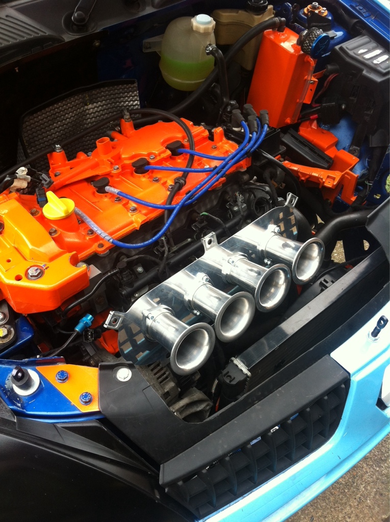

Update:
Been a very busy week putting in around 8-10 hours a day on the car trying to get it ready for todays deadline.
This week saw the subframe, box and engine go in along with a few other refreshed parts as well as a fluid refresh.
Picked up the engine from the builders, had it finished off and finally complete, So finally competing James handy work.
Spec of engine,
423 non VVT
Ported head
Hydraulic tappets
Uprated valve springs
Tagged bearings
HC pistons (83 mm to keep it legal size)
Forge rods (standard length)
Baffled sump
Blanked off VVT sensor (to minimise oil pressure loss).
DTH 45mm Jenvey bodies
90mm inlet horns
Megane 225 injectors
182 manifold PMS exhaust.
RPM will be set at 7850rpm for longevity and reliability.
Loaded the car up on the trailer This evening ready for the long drive up north tomorrow to EFI parts ready to be mapped, looking forward to seeing what she produces.
Also painted the rocker cover and a few bits orange to match the subframe, originally I was going to go with a red theme
But ended up orange due to parts purchased of James :)

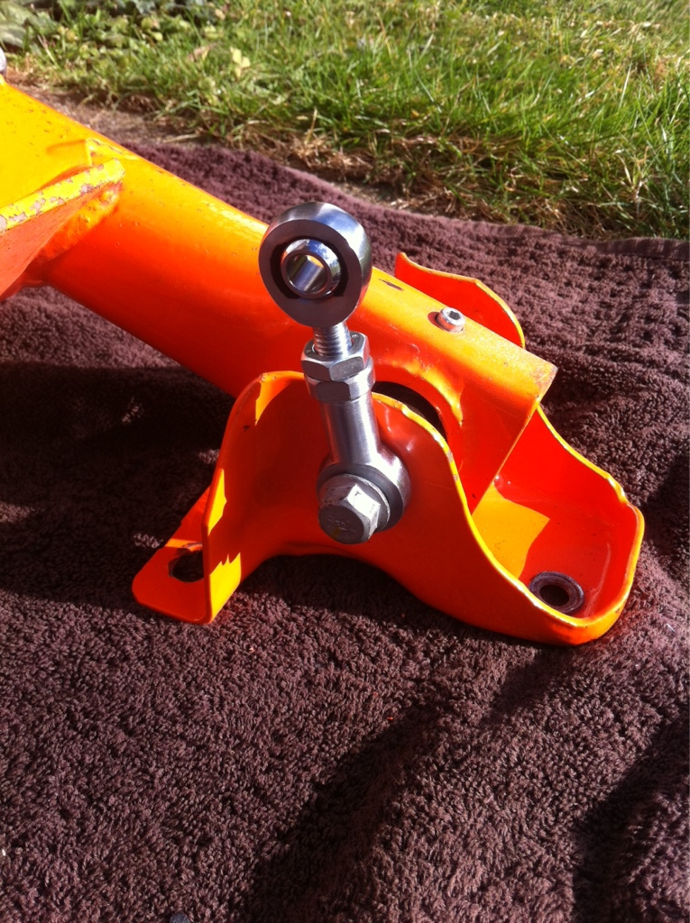

Also fitted rear beam with the PMS ARB and black series bushes.
Few pics

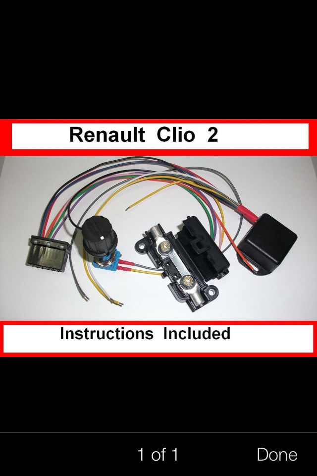

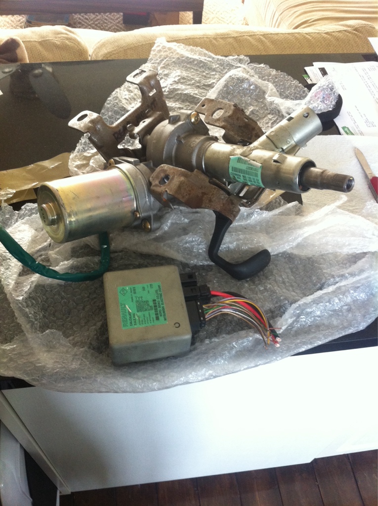

In other news, been finally collecting bits bits to install the EPAS system, picked up a epas column with ECU for £45 on fleabay, wiring ordered, just need to order a belt and will get to work installing it next week. Im going to run the standard cup rack. Epas for £100 thanks very much :)

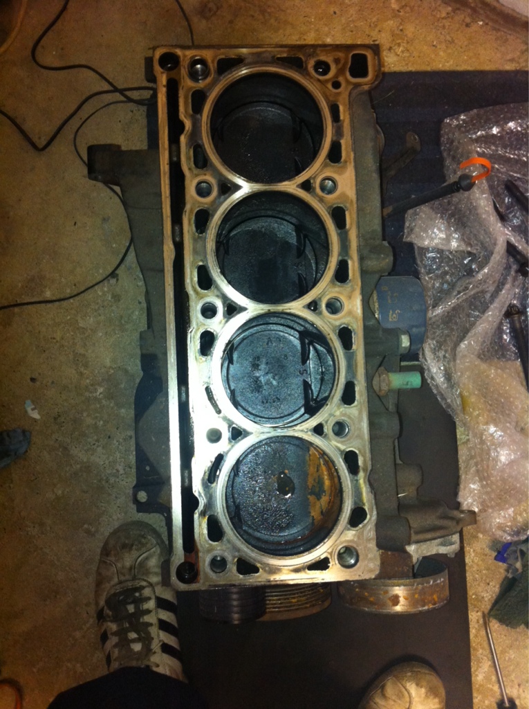

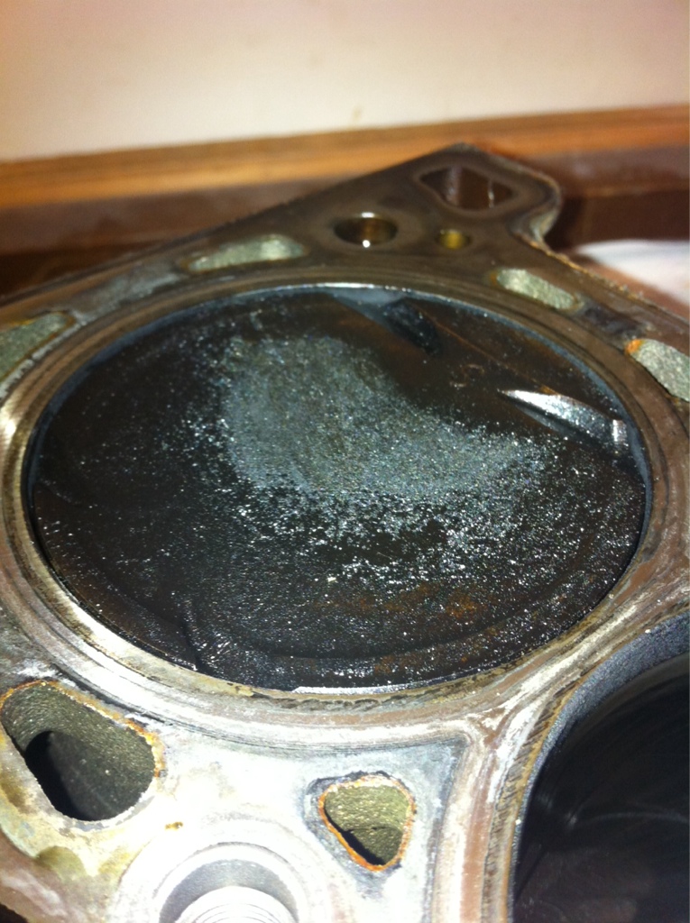

Funnily enough I stripped my old engine down that was killed by a engine mapper....

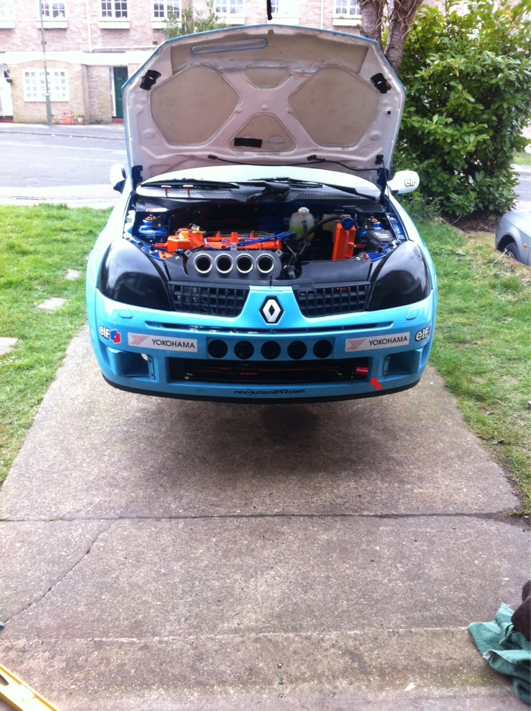

Yea deffo, im not expecting mega numbers, obviously due to the 45mm bodies, After speaking to Jenvey they suggested the 90mm length horns over the 120s mainly due to filter space, the DTH bodies are pretty long anyway, total length with the 90s on are bang on 260mm (head to horn face).

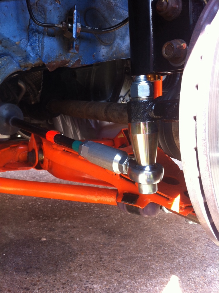

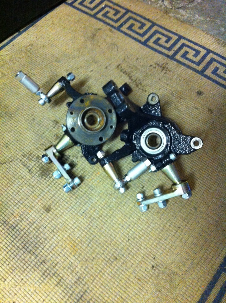

Managed to get a few more hours work on the car this week, main effort was to swap the hubs over for the RC hubs from @NorthloopCup group buy.
Looks like a great bit of kit so thanks Mark, was pleasant doing business with him and would recommend him to anyone.
I went for the zinc option with new wheel bearings.
Straight forward fit, was impressed with the torque settings and instructions :)
And fitted
