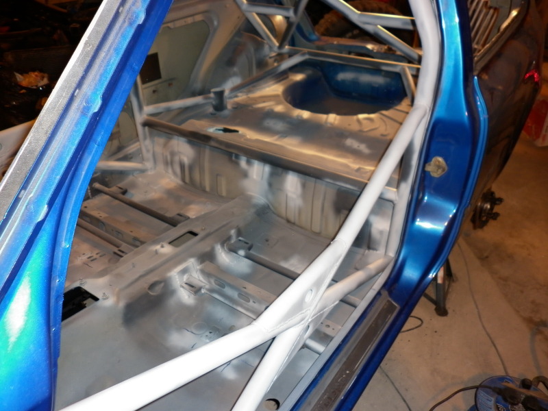

Continued update, got round to fitting FIA regulated stress plates to the eye holes for the crutch straps and inner lap belt eye.
The inner one was a bit difficult due to the curvature of the transmission tunnel, I didn't want it too far over as the lap belt would crease when fitted through the seat bolster.
Eye layout
