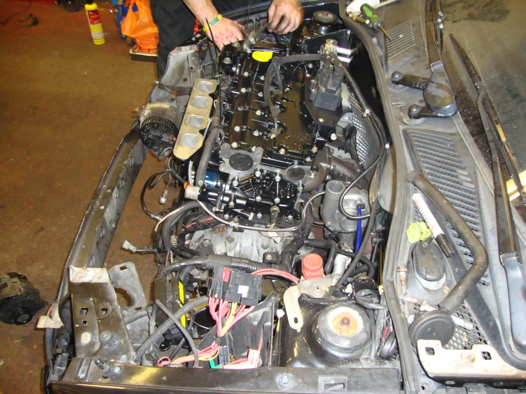

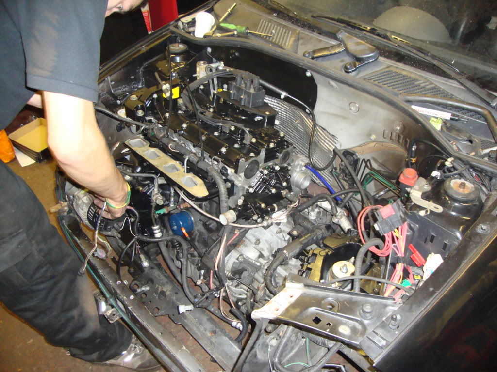

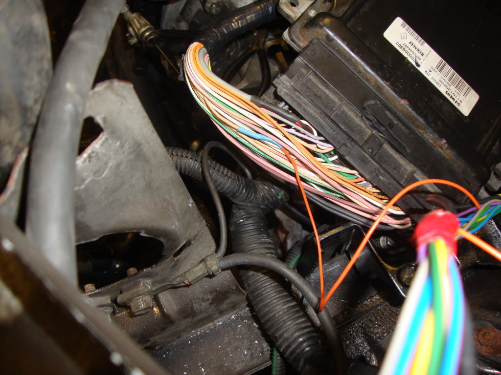

First things first was to get the engine all wired up. We had to take the upper inlet off to get all the wiring in.

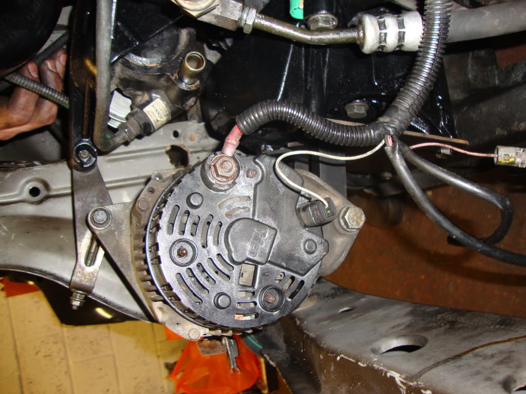

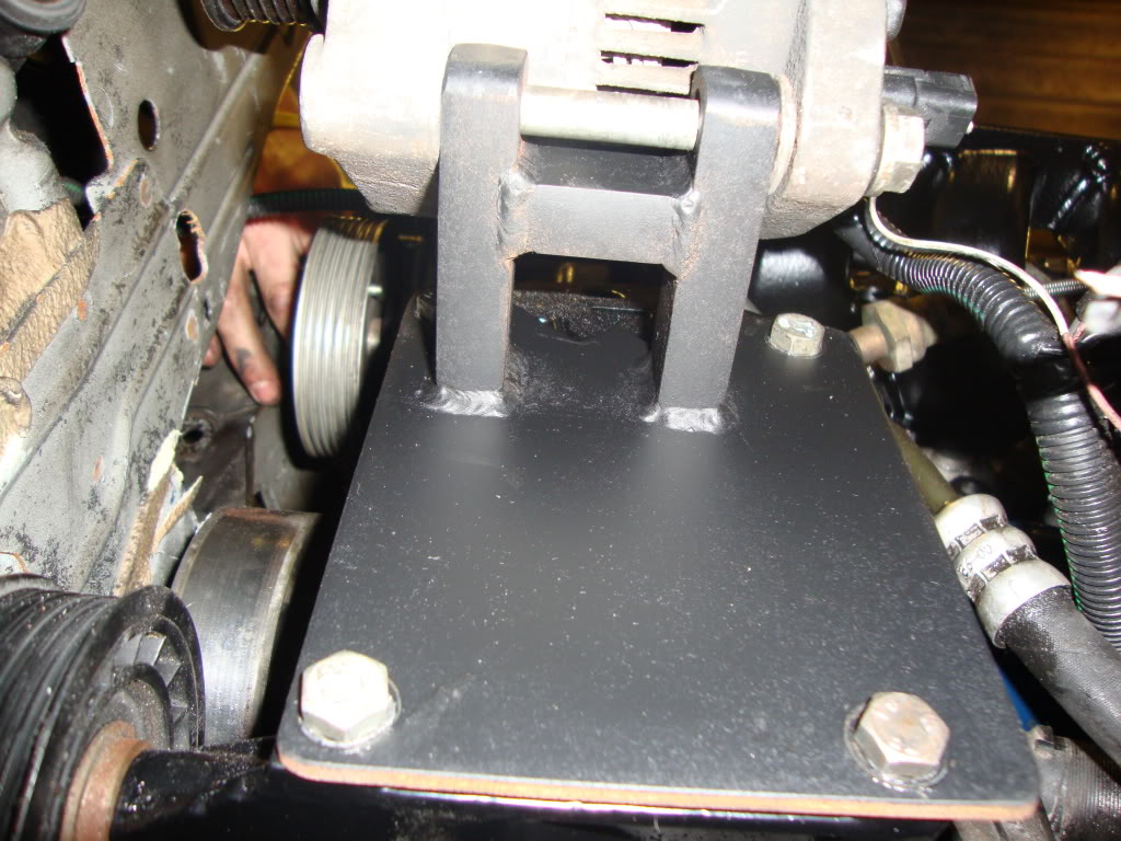

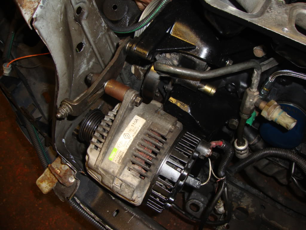

We decided last minute to ditch the air-con to leave more space for the boost pipes and inter-cooler. So out of some scrap brackets and steel from around the workshop we made this very quick air con delete kit.
We need to wait for the shop to open in the morning to buy the correct belt.

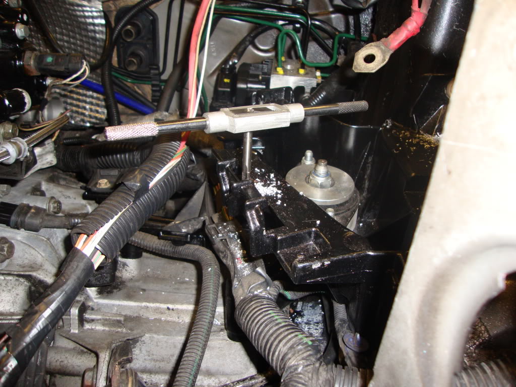

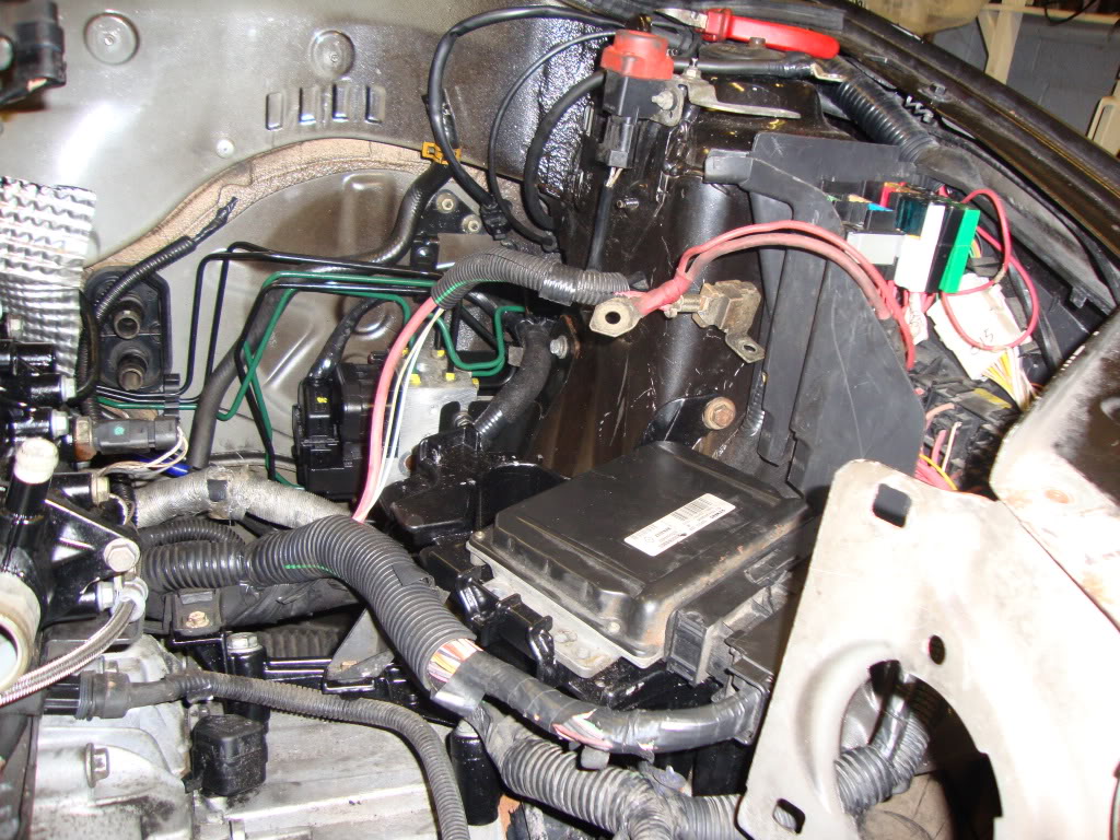

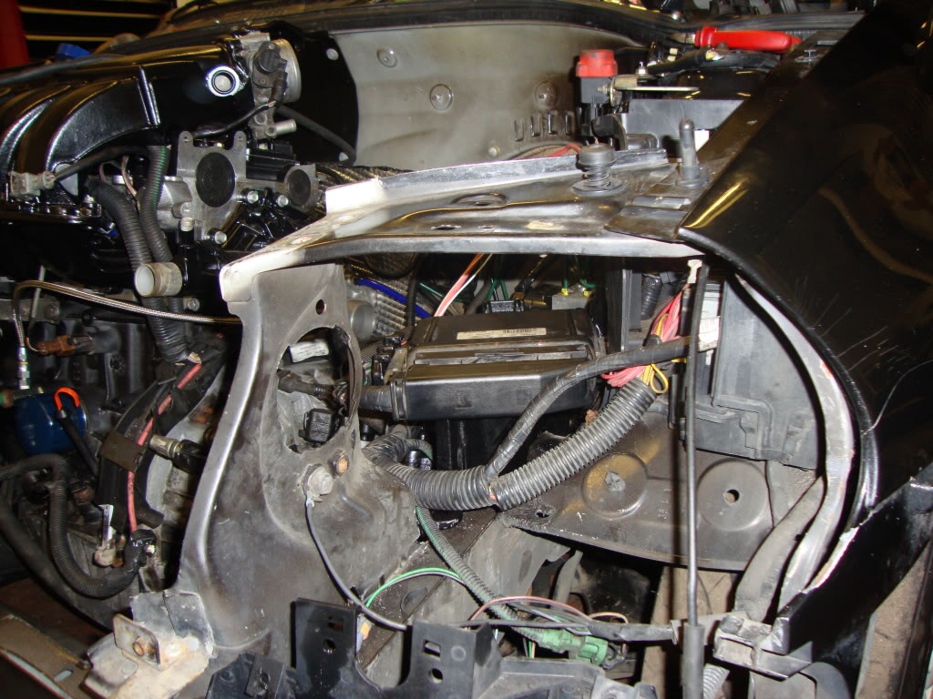

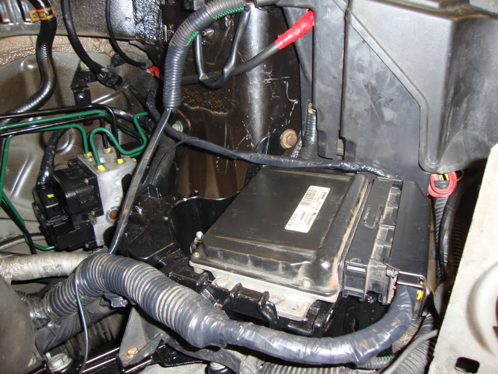

We also moved the battery to the boot and laid the ECU flat to make some more room for boost pipes. We had to drill and tap some holes to hold the ECU in place.

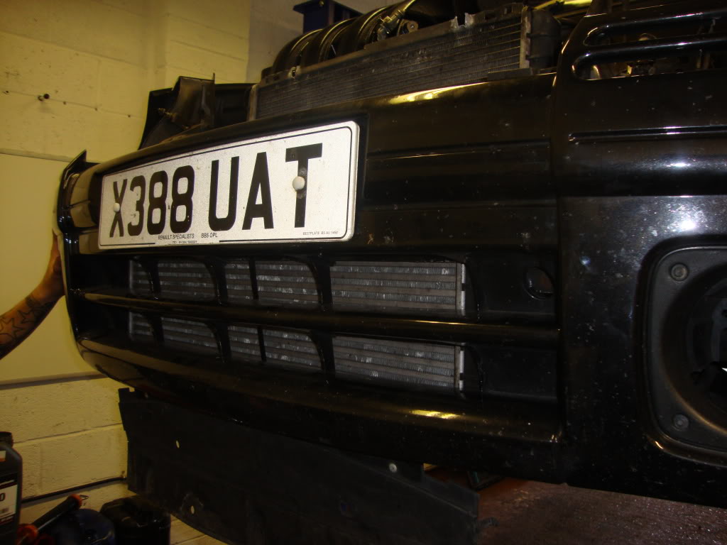

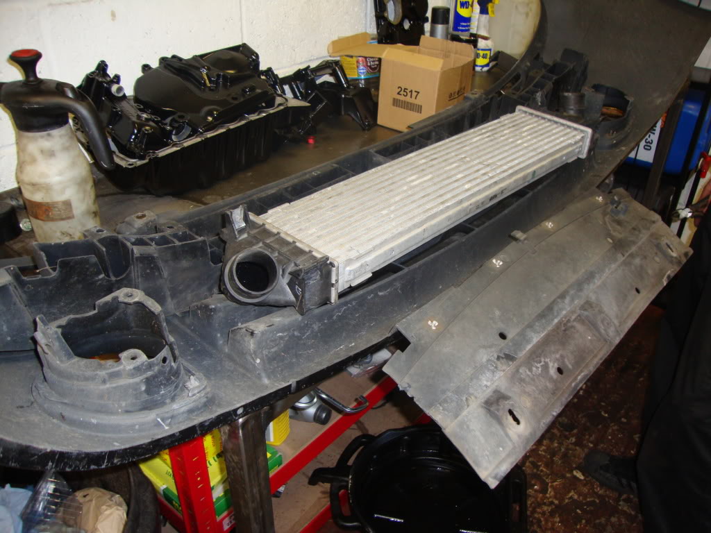

We mocked up the intercooler we are going to be using for now which is a standard Focus ST intercooler and worked out all the pipe work to get it to the turbo and inlet. One of my good mates is currently on a 250mile round trip to pick up the silicon hose’s to get the ready for mapping later.

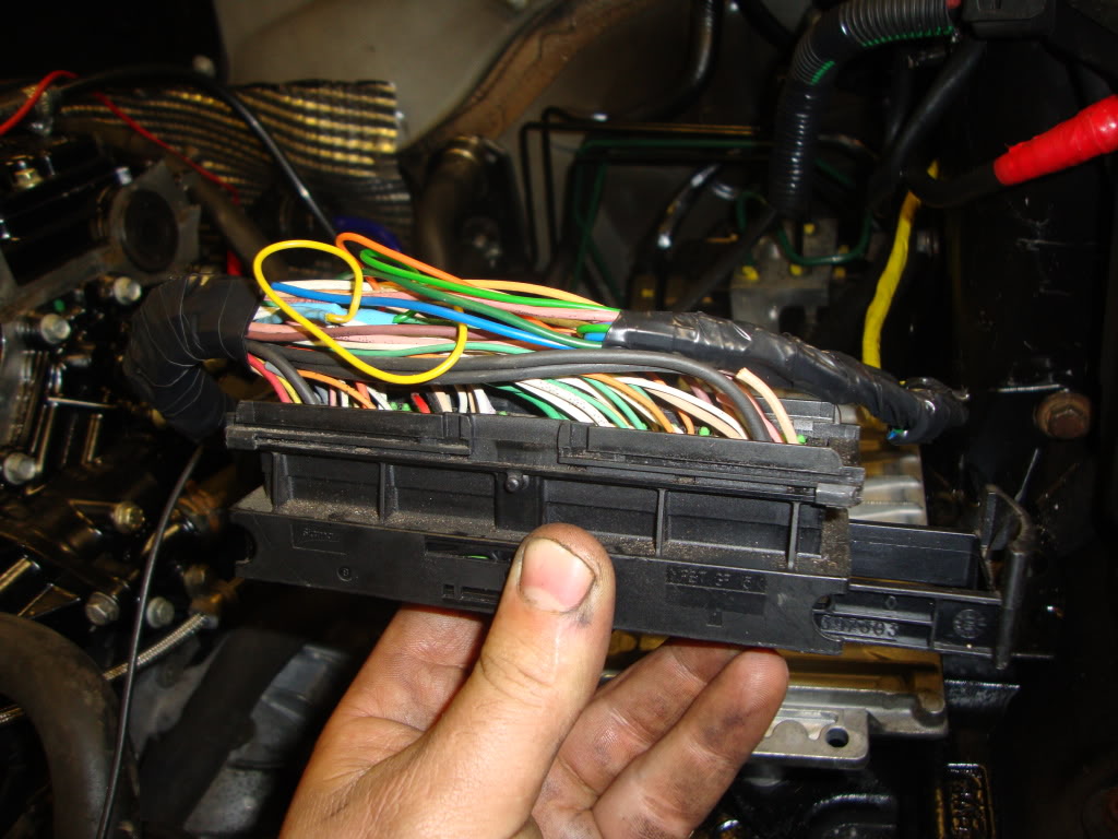

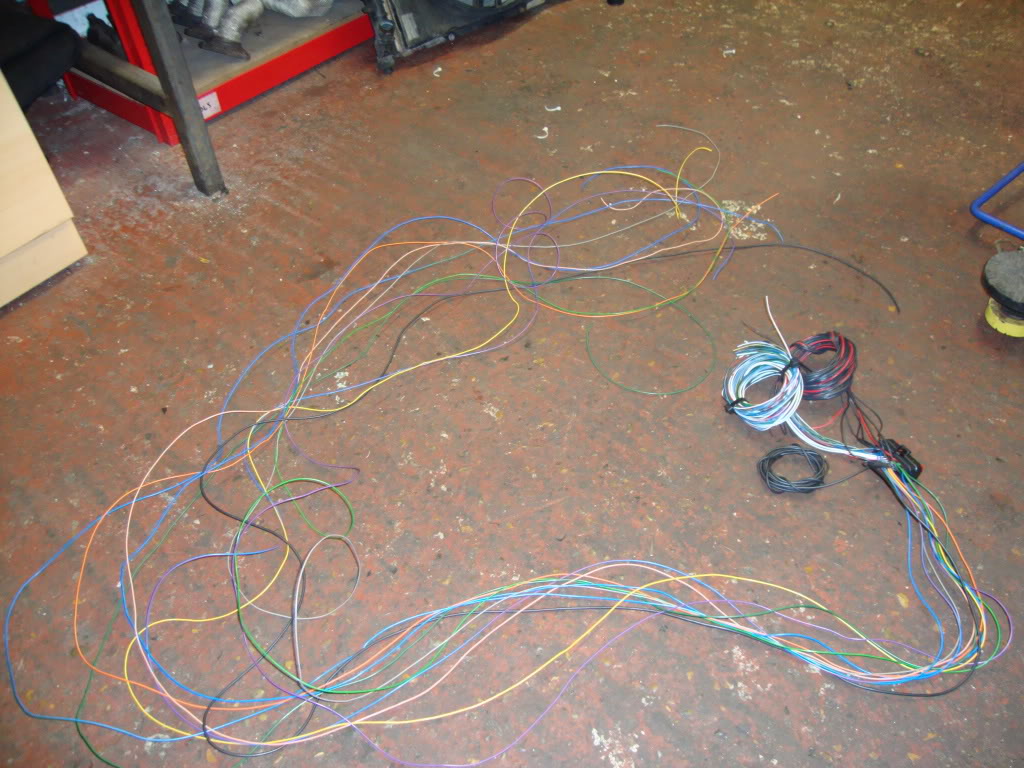

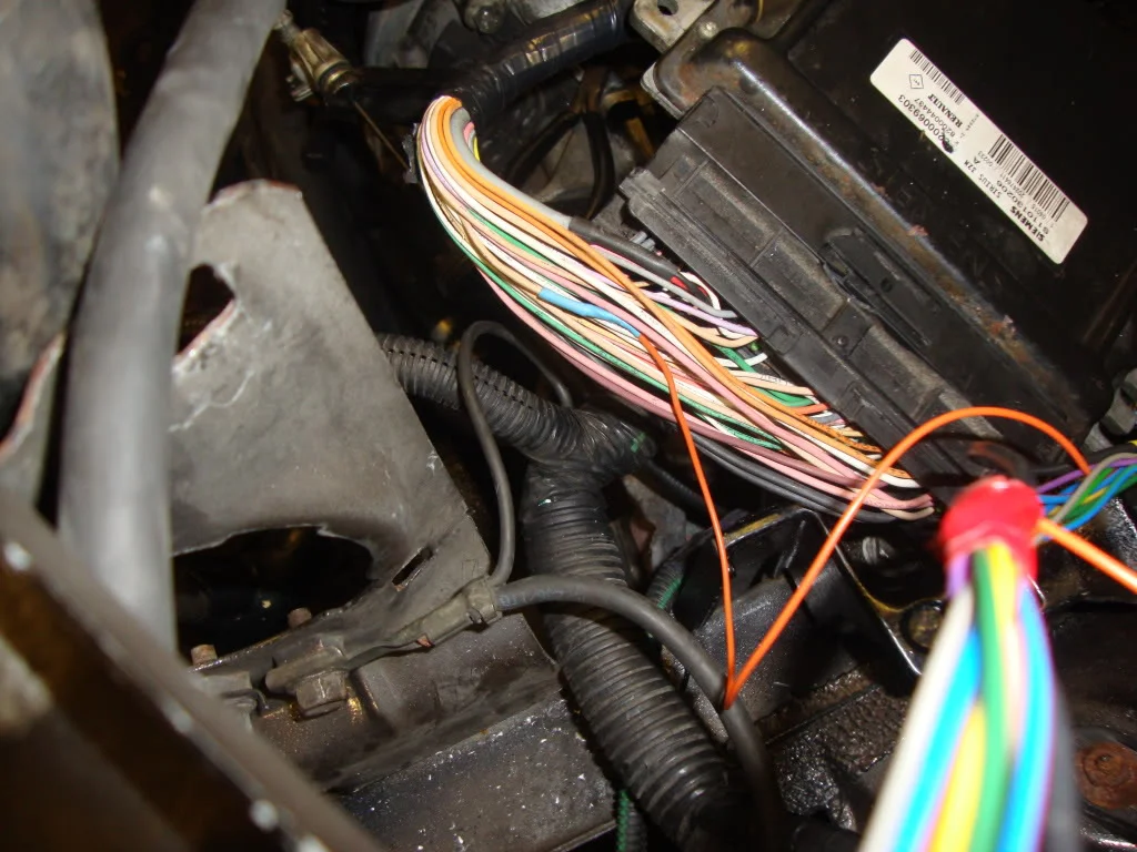

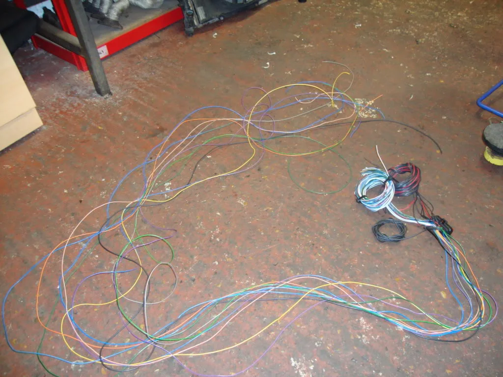

Standalone management was the next thing to go in. We have wired it in to trick the standard ecu into thinking it’s still running the engine. That way there shouldn't be any engine lights or the standard ECU interfering where it’s not wanted.
First things first was to pin out all the pins we needed from the standard ecu and let the chopping soldering and heat wrapping begin.
All completed and taped up. The loom running out the other side of the loom plug is the standalone loom.
After a slight wiring mishap on the crankshaft sensor, (I'm letting us off that one as it was 2am and easily spotted at 8am after some sleep.) She runs on the standalone!!
