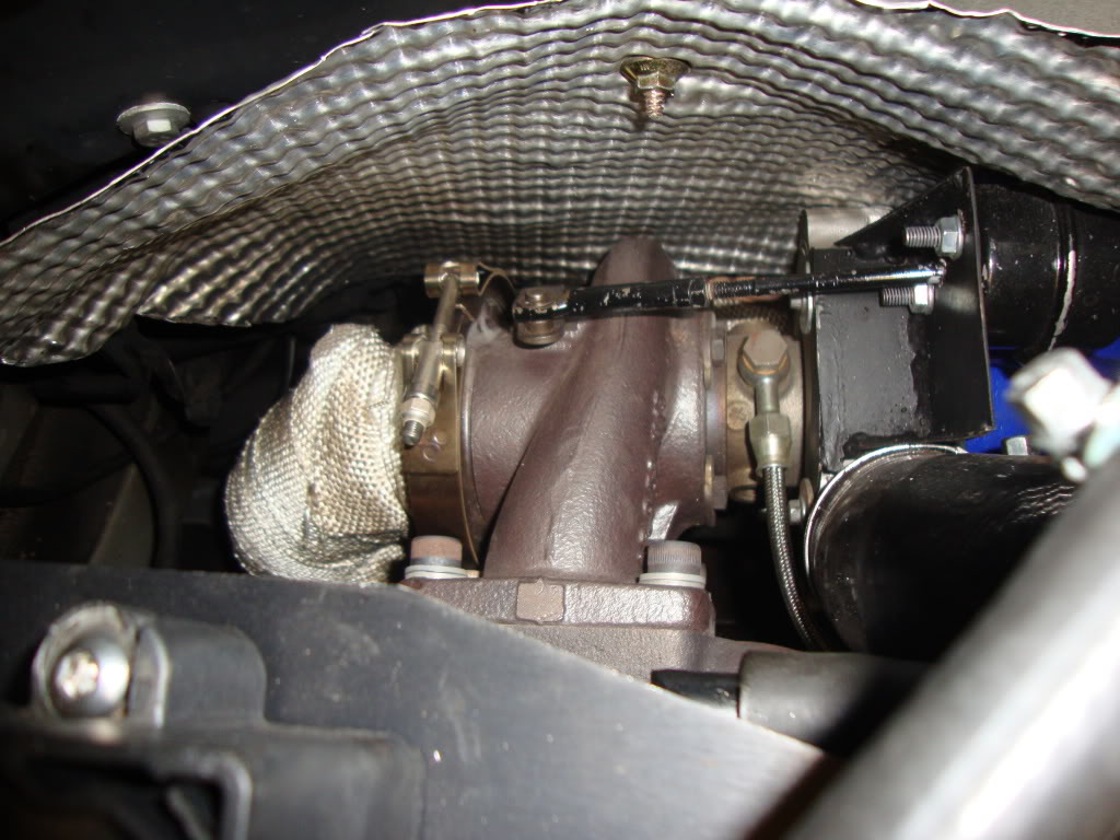

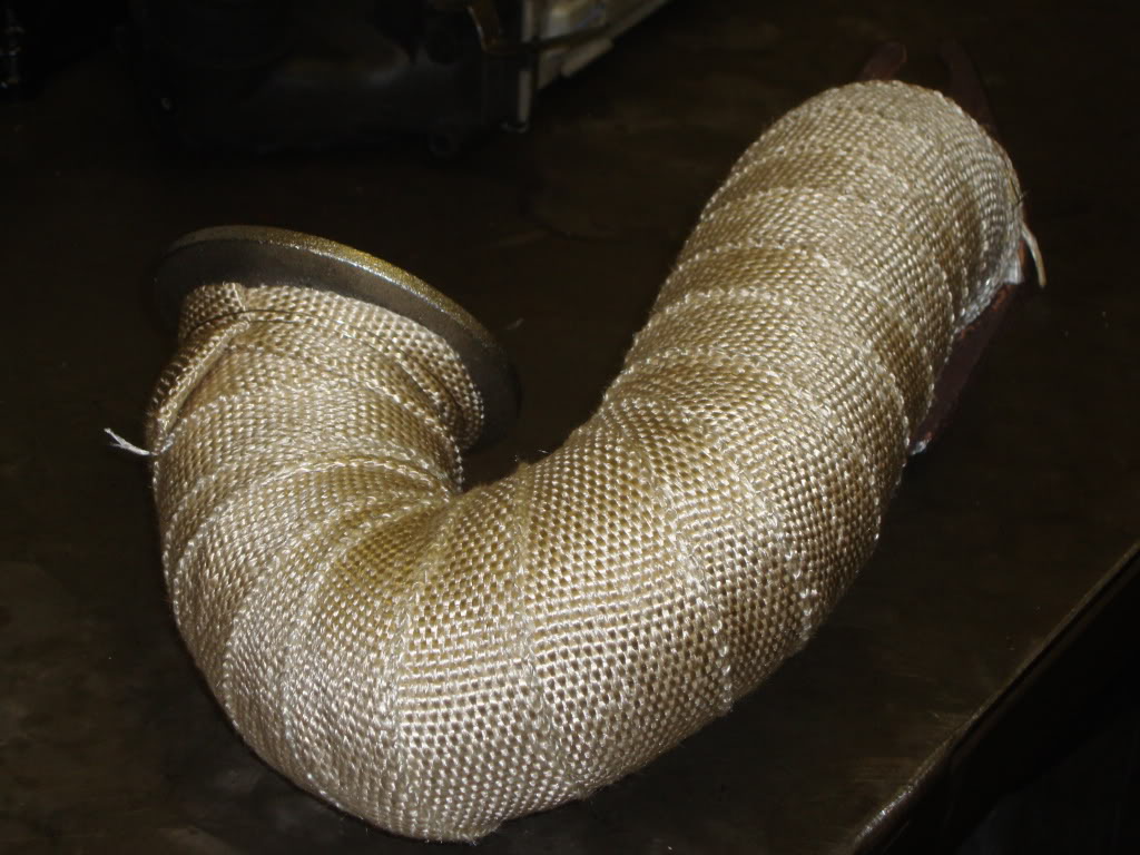

This is a picture of the custom downpipe we had made. The space behind the engine is so tight, especially with the size turbo we are using so all the power steering pipe had to be moved as the brake lines.

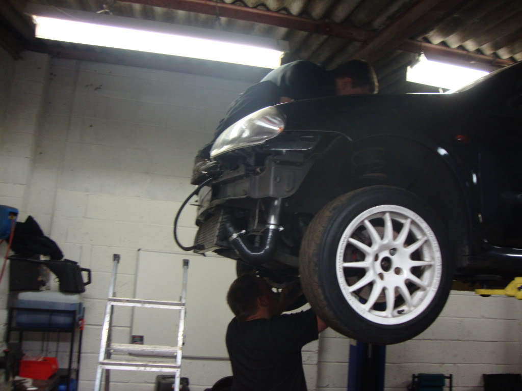

After working out the intercooler pipework the car flew back together. We started working on it at about 8pm after some food and it was all back together at 3.30-4am.

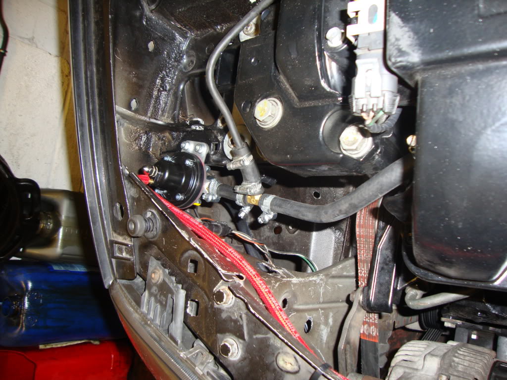

The rest of this week we have just been fixing the annoying little niggles like the fan not working and a small problem in tricking the standard ecu to think it was running the engine still. We fitted a boost sensitive FPR and an up-rated fuel pump.

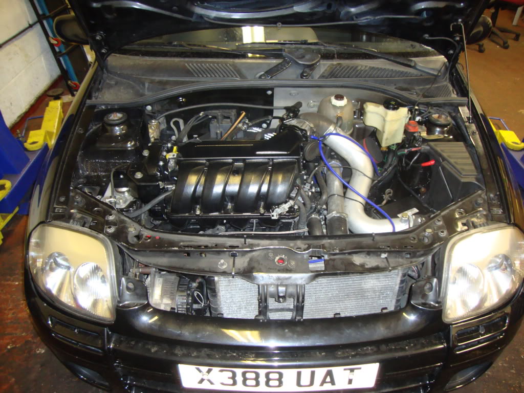

Please forgive the blue and red vac pipe, we are still waiting for the black to be delivered, Also my 5 min built actuator bracket. Were still waiting for that too, but they will both do the job so we map it.
