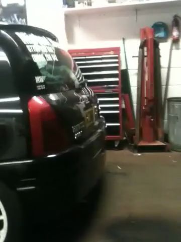

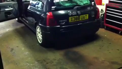

So today we got the turbo clio up and running, and I decided to map in the launch control/ Anti lag.
Let's just say the noise is addictive! The videos and poop as they were on my phone, but turn your speakers up and listen to the beautiful beautiful noise! :)

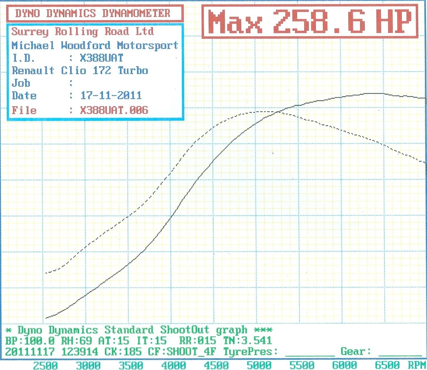

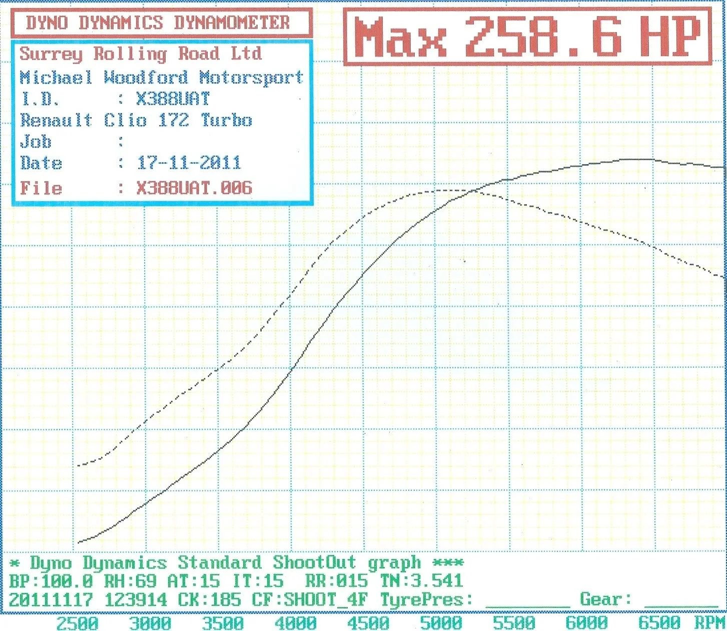

Yes. We're trying to work it out to keep the costs low. It should be a 260bhp convertion when finalised. You could run more but best to keep it there for reliability reasons.
Mission accomplished then eh mate? ;)
So much more potential left in it, but like you say for reliability on a standard bottom end, its pointless to go chasing numbers when the car performs so well as it is!
Congrats on how well its all turned out. :cool:
If you can do that conversion fully fitted for around the 3K mark I should think they'll be pretty popular, its amazing how right it feels on the move, doesnt seem like its strained at all, just smooth effortless power.
