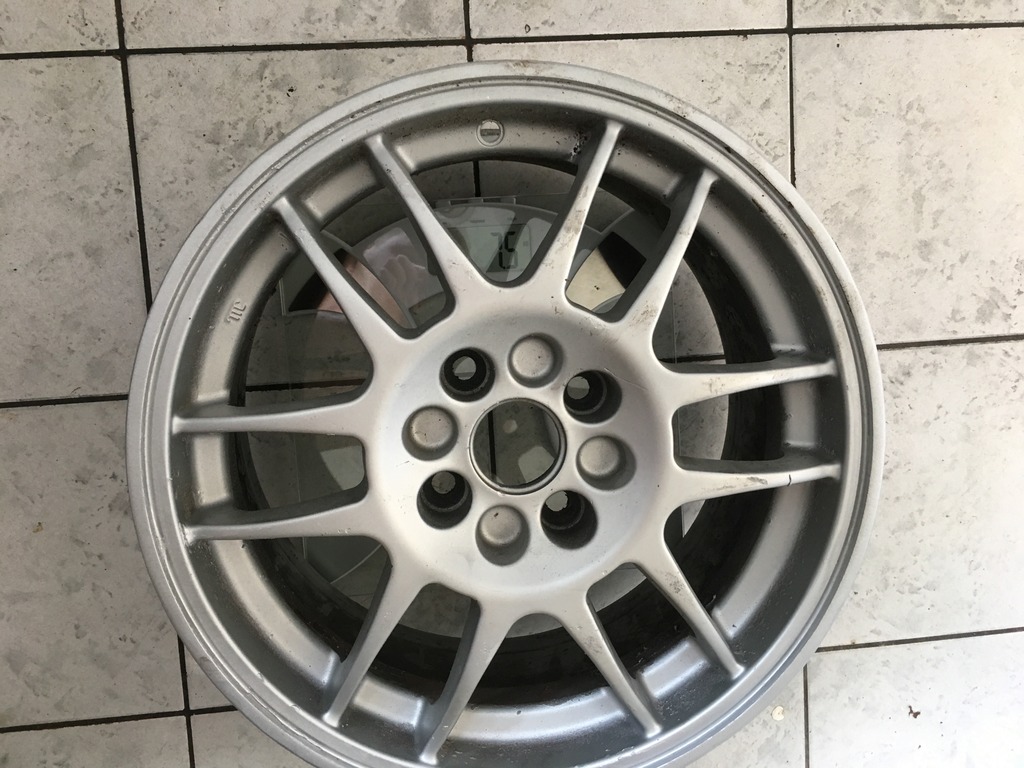

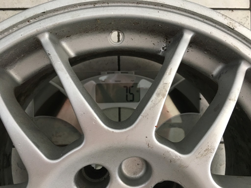

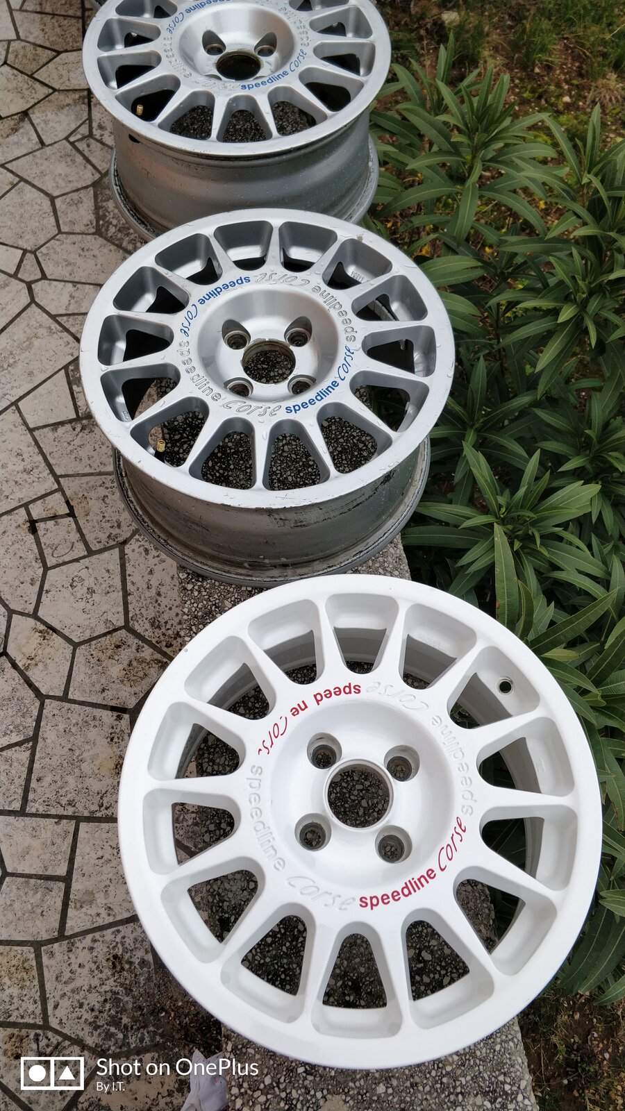

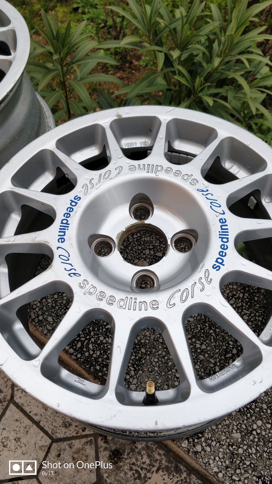

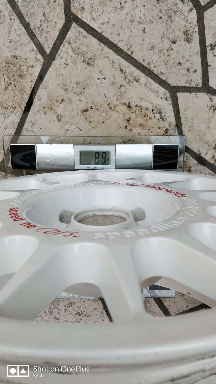

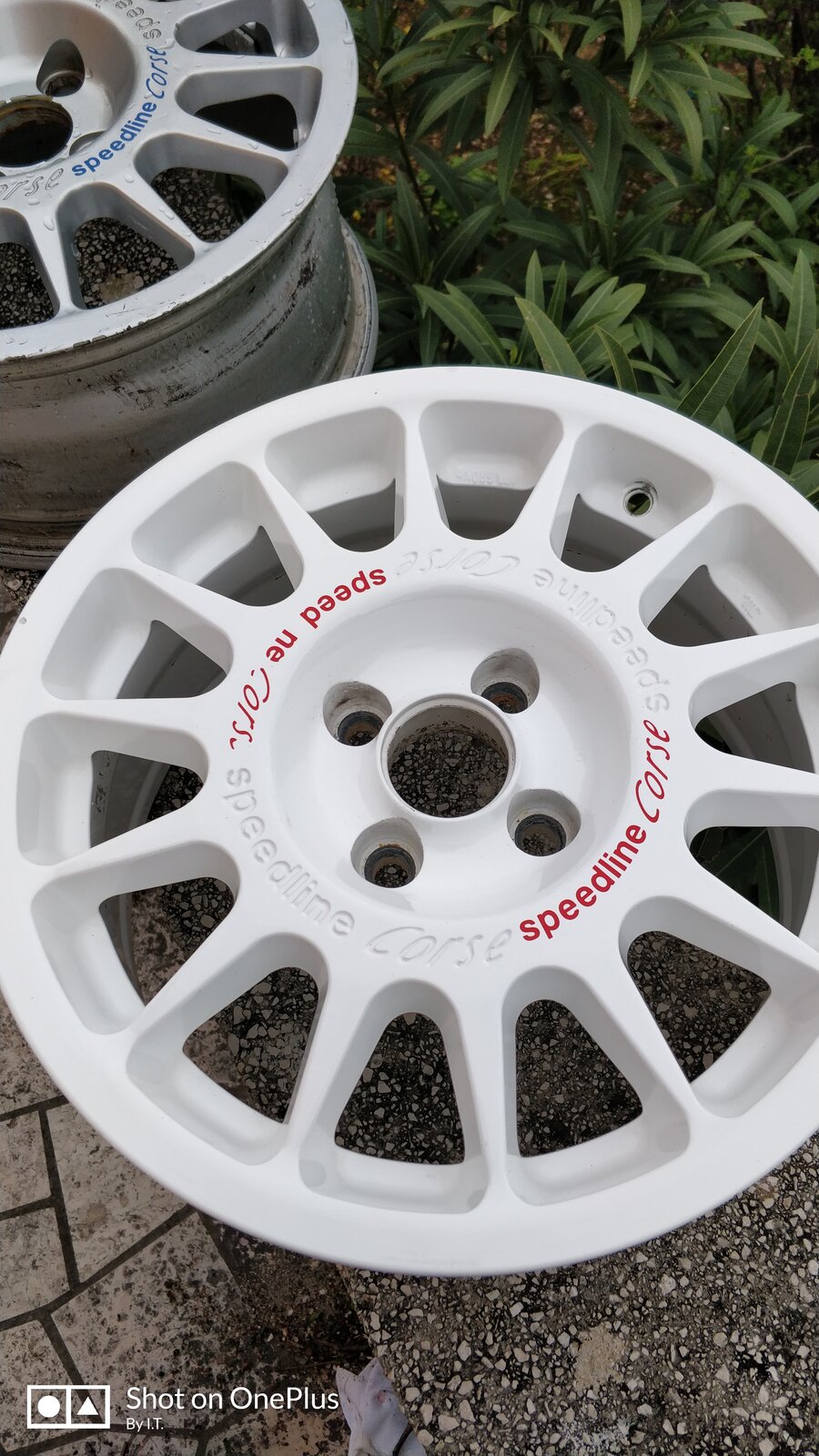

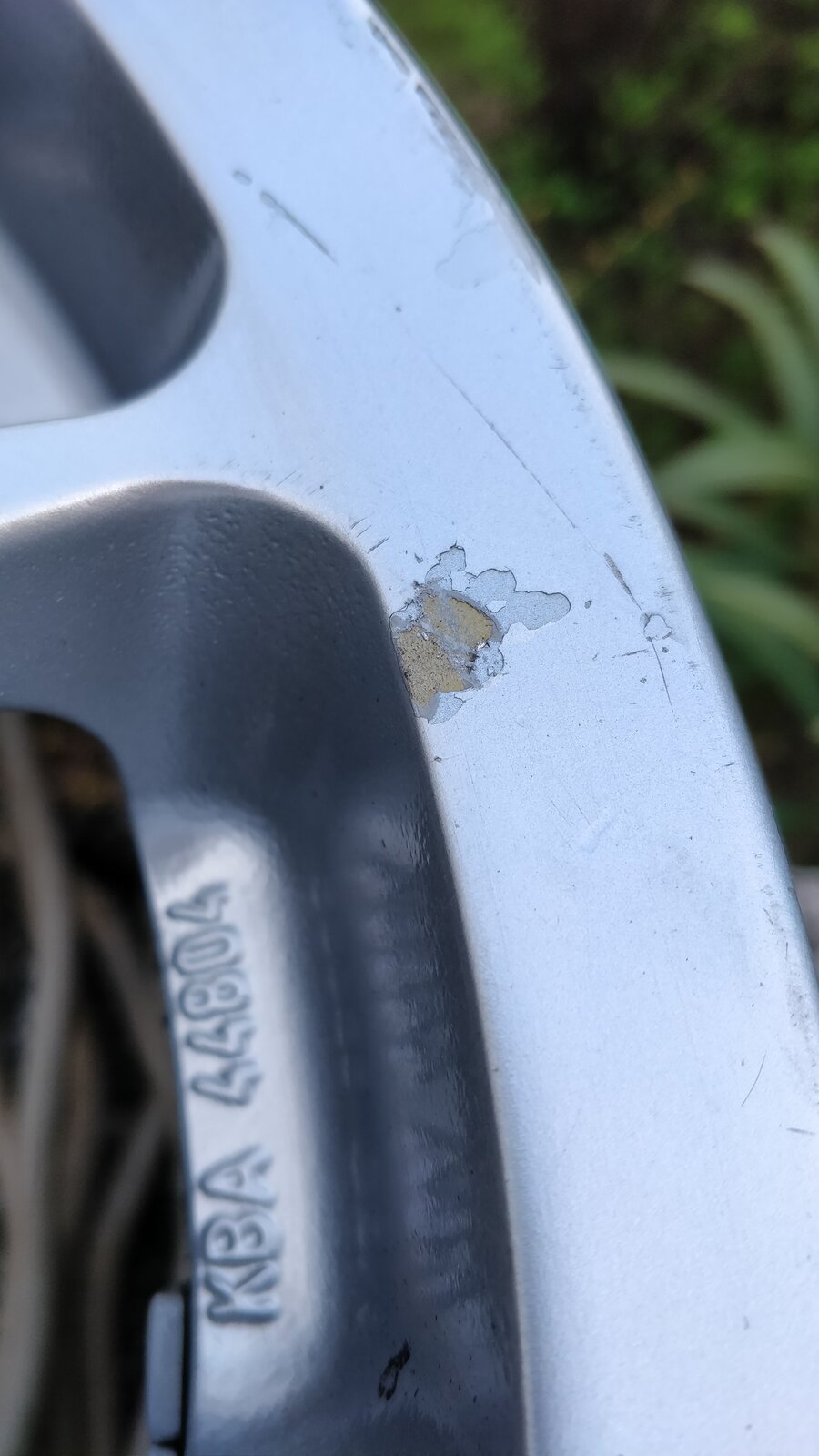

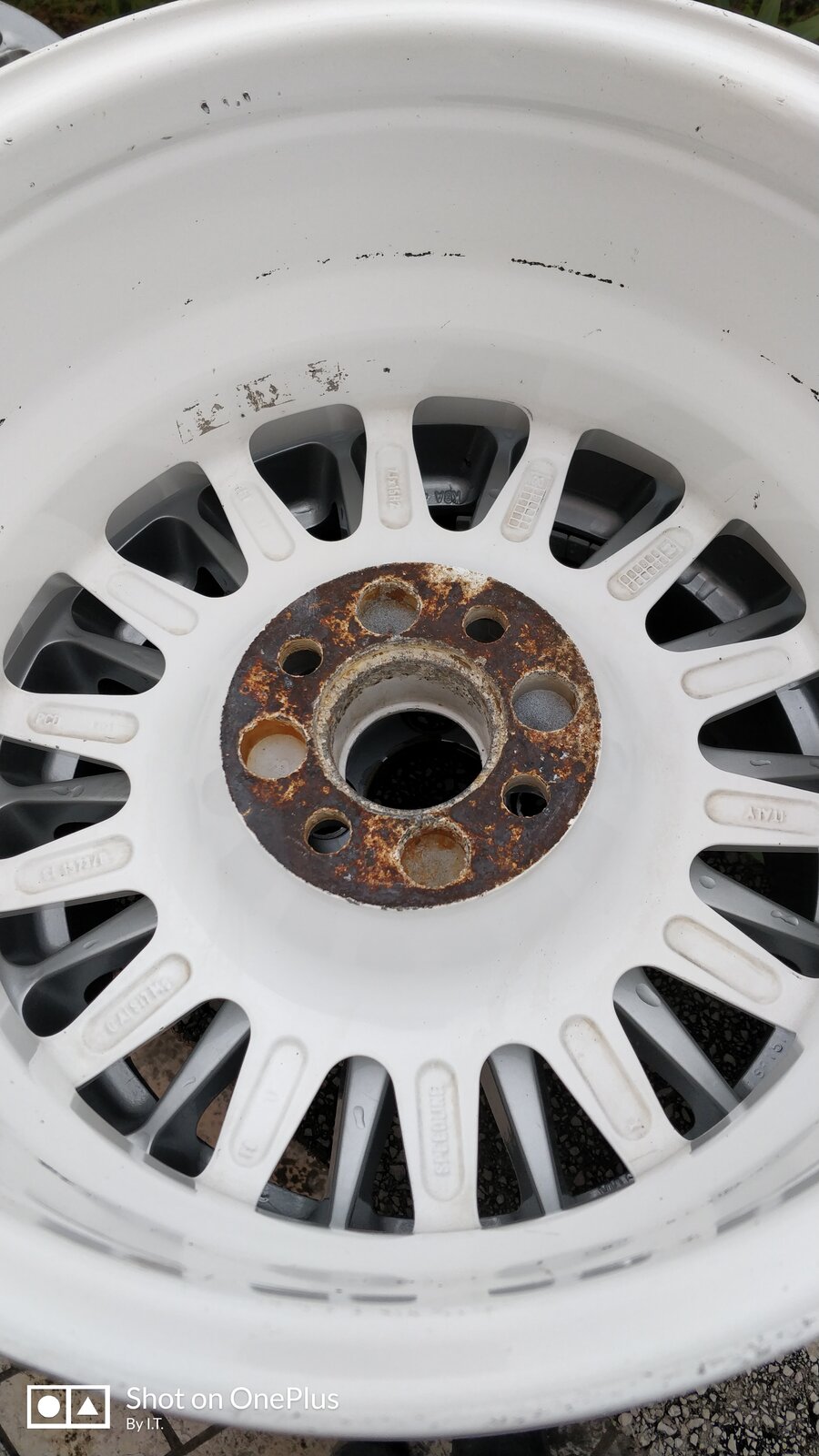

I know it's an old thread but I'm confused..
Few questions..
Both wheels are speedline 2118, the silver is et 43 and white et 38.
White has letter on the inside, the silver doesent. Why is there a centre cap prep. On white one?

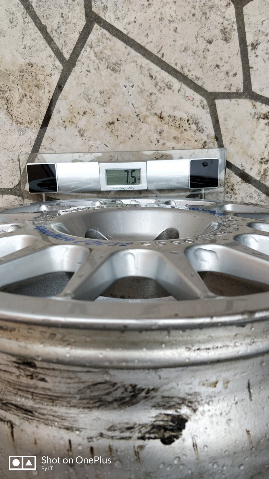

And the biggest question, why is such a huge difference in weight?
White 8.9 kg
Silver 7.5 kg
The last picture is what's beneath the paint on silver ones..
