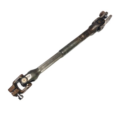

Get someone to fabricate the column mounts and extend the lower joint with a sleeve so the squib and everything moves together. Also get a twingo lower uj as its a solid uj mount not rubber
@bozothenutter
Its similar to clio epas but shorter. Im going to cut the joint and use a land rover uj. Im only doing this as my column is going to be way more closer and angled differently, so I needed another joint as there would be no articulation. I payed like 15 quid. If you were keeping same column and distance then just get the joint welded instead :)
