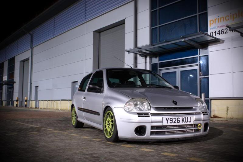

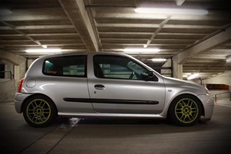

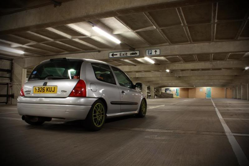

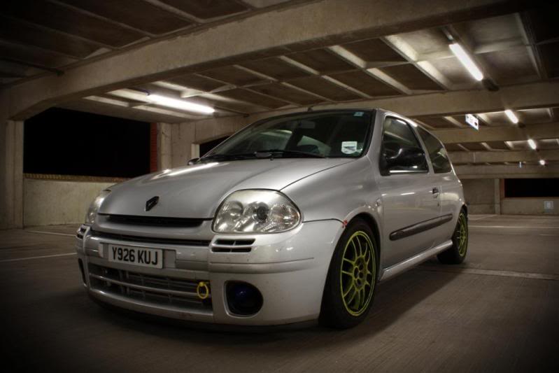

Few pics from tonight of how it stands at the moment. Currently running 0.1 bar of boost with the ocassional peak of 0.2! About 190bhp and 160 lb/ft. Different restrictor plate being fitted next week to allow it to run 250 odd at 0.6 bar of boost.

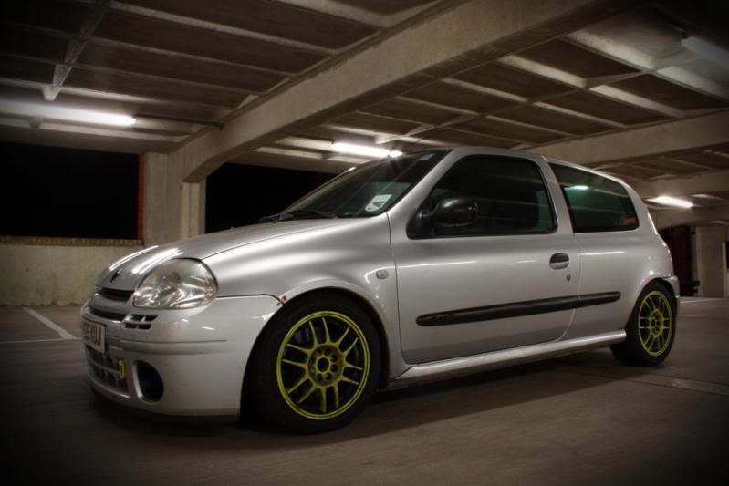

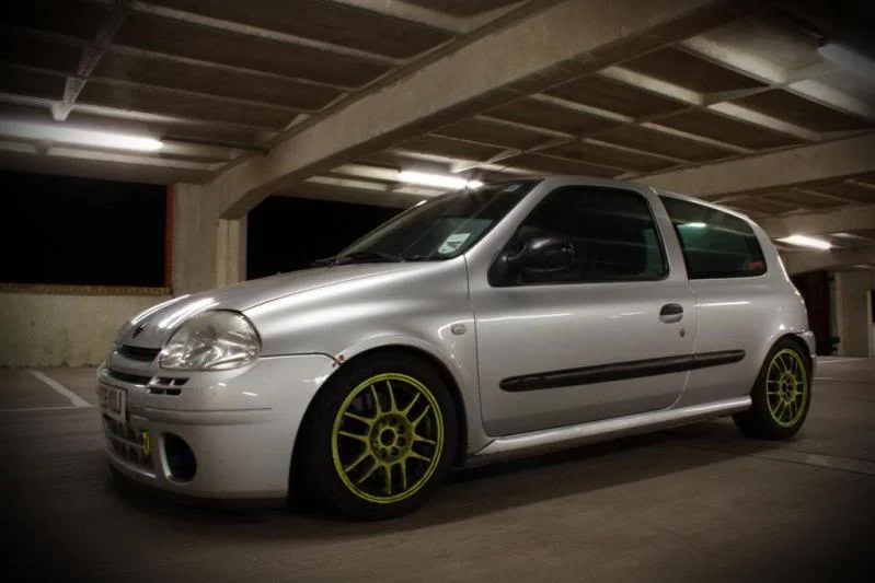

What cooour are the wheels ? (what paint did you use?) They look dirty in the pics?

They're just PlastiKot Fluoro Yellow but didn't lacquer the wheels so the brake dust is a little baked on!

Looks cool! Get that intercooler painted matt black for stealth I reckon, got some camber on the front there also!
Camber needs to be adjusted, all over the place at the moment so will do that in the morning! As cool as it looks though ;)

Was done at RSTuning in Leeds, great lads, kept me up to date on everything all the way through and were great about everything.
Its running a Ph2 engine w/
Rotrex C30-94 Charger
Custom alloy Radiator
Custom Intercooler (Bolts to rad)
Mocal Oil Cooler (Bolts to rad)
Brackets to suit charger
Bigger injectors
ITG Filter
Custom mapping
Matched inlets
Powerflow/Magnex/Ktec exhaust parts
Running around 190bhp.
Suspension is FK Konigsports, uprated engine and gearbox mount. Brakes are Ferodo DS2500 and Brembo HC Discs.

Epic little car. I'd have the wheels done black, they look tatty in that colour

The cars not meant to look pretty, it does the job its meant too. But I've another set ready to go black again and these will be trak only wheels with new legislation of semi slicks coming in
