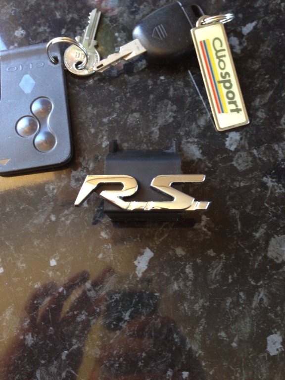

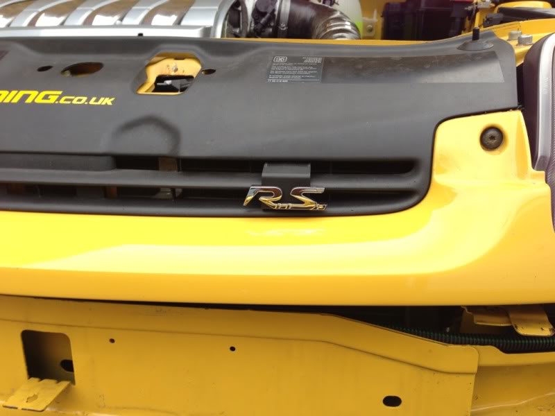

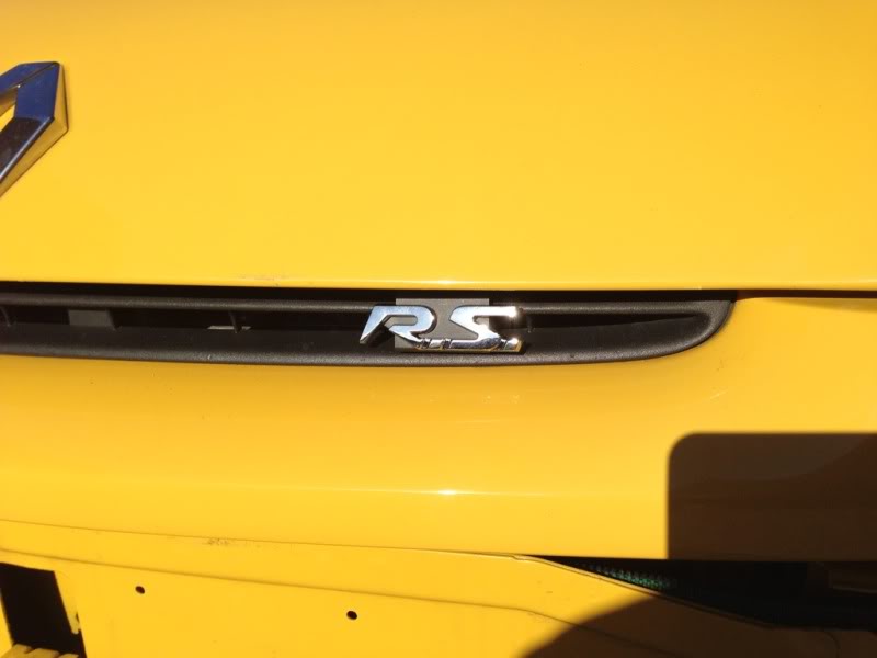

Another little addition I've done but forgot to upload a picture of it, I've fitted an RS badge to the front grill, it's the one that's off the front of a RS200, needed abit of trimming but it fits perfect & secured very well incase anybody takes a liking to it.

do you have the number part for that RS for the front grille ? tks 8)
​I don't have the packaging with the part number on now but if I get chance to take the front grill off I'll get it off the badge for you & drop you a PM with it.

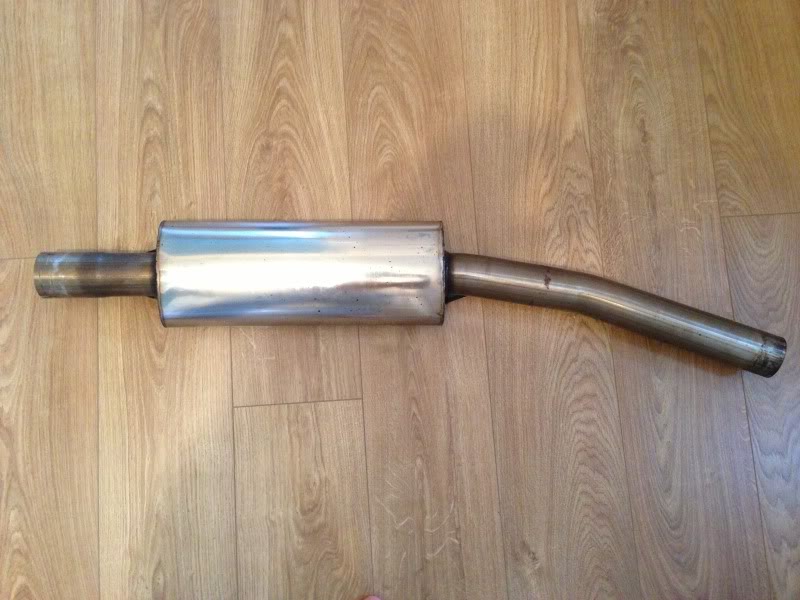

Had a delivery this morning :D a Ktec silenced centre section bought it off Chris - marinemackay2003 I'll wait till its not raining to fit it. Also getting a 182 cat off Korky ready for its MOT next month, I'll weld a flange on it at work so it fits my system.

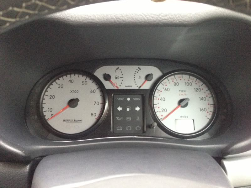

Decided the Ph1 clock surround looked a it dull so got hold of a Ph2 set of clocks & striped both down & sprayed the surround satin black to match the grab handles. Put the clocks back together job done.

Nice one, hows the new exhaust polishing up?
Its polished up like new :D

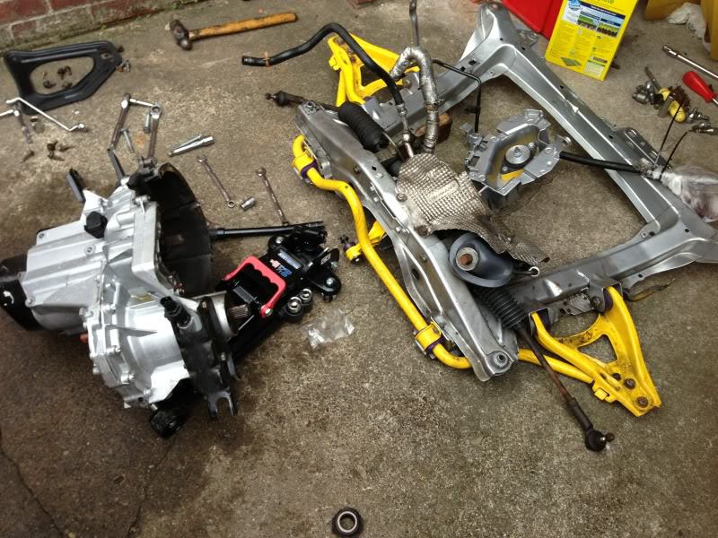

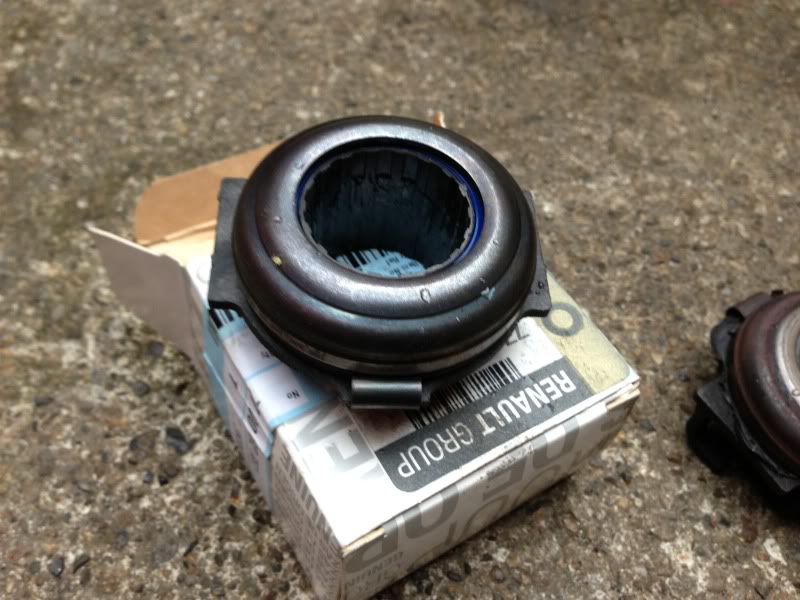

Last week the car started making a strange noise but only when the clutch was engaged so i suspected it was the release bearing, i bought a new one from renault, then set about changing it on wednesday it was the only day i had spare before my birthday weekend & CSS. Off came the subframe & gearbox, & the new bearing was fitted. The old bearing was erm fucked lol, i must have been having an off day & just forgot to change it 1st time round when i was building it up last year.

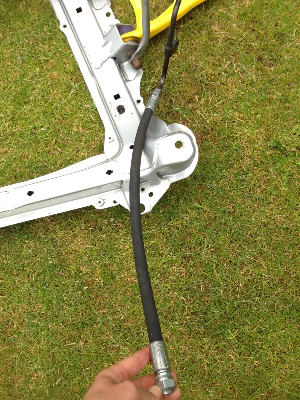

While i had the car in bits i noticed an oil leak, it was coming from the high pressure power steering pipe on the front of the engine, i took the pipe to pirtek to see what they could do & they made me a new section up.

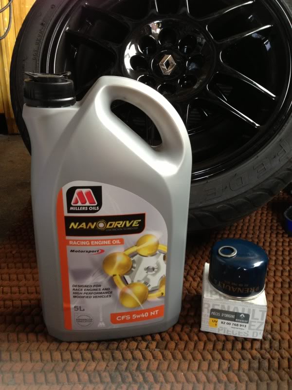

I also thought i might aswell change the gearbox oil for some Shell 75/90 fully synthetic, & fitted a new drain plug washer. I also changed the engine oil & filter & sump plug washer.
I give the subframe & everything else a good clean while it was off amazing how dirty everything has got.
