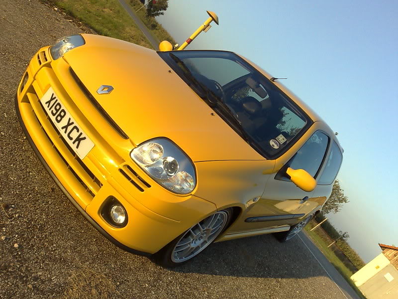

Thought id finally make a project thread about my sunflower ph1 172, ive done alot of work to it since buying it on 20/5/2010.

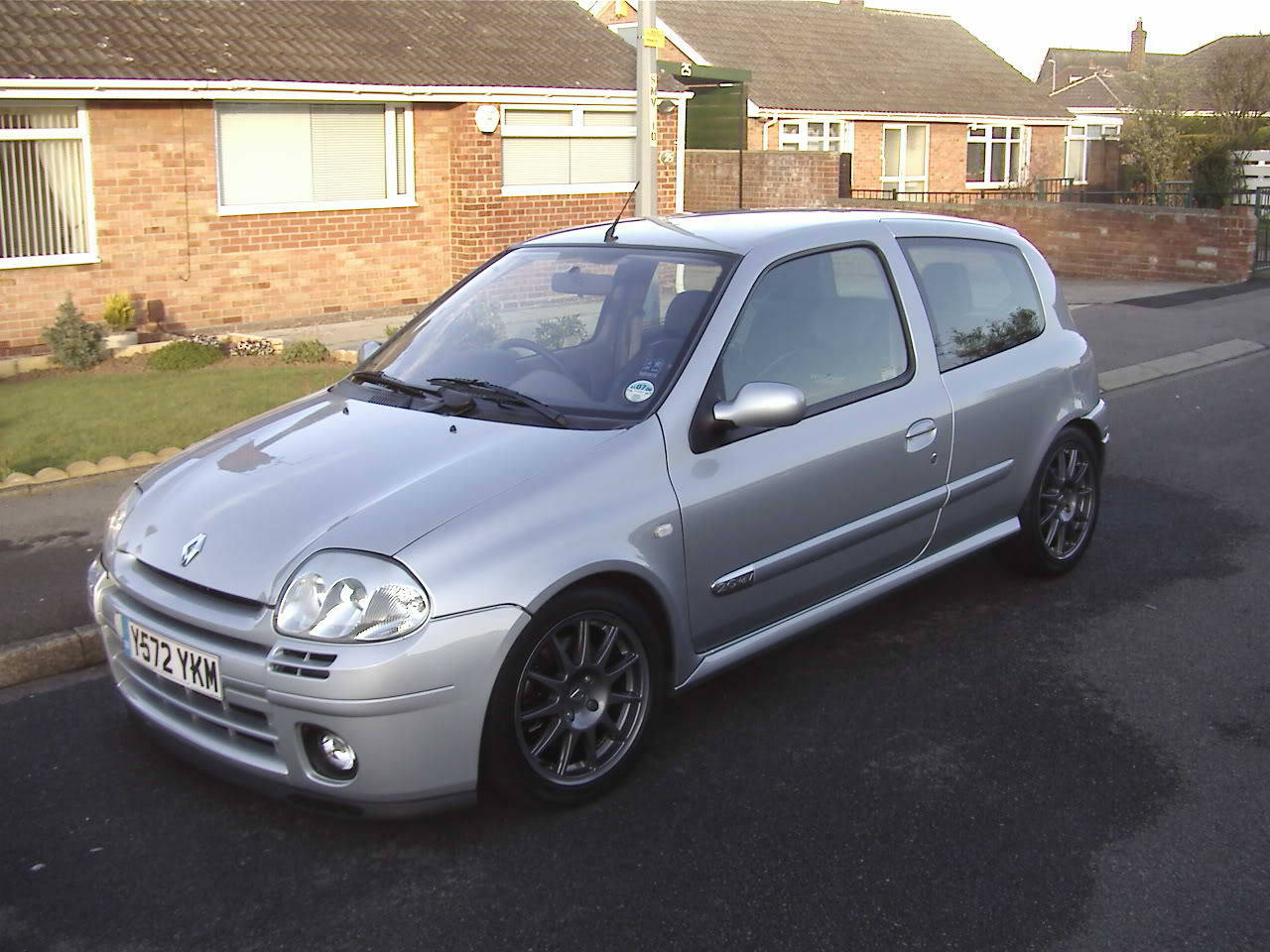

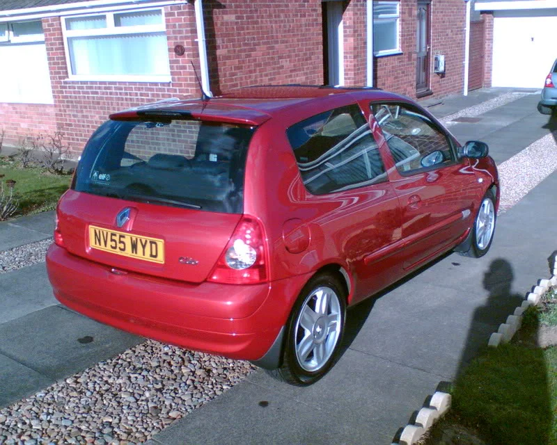

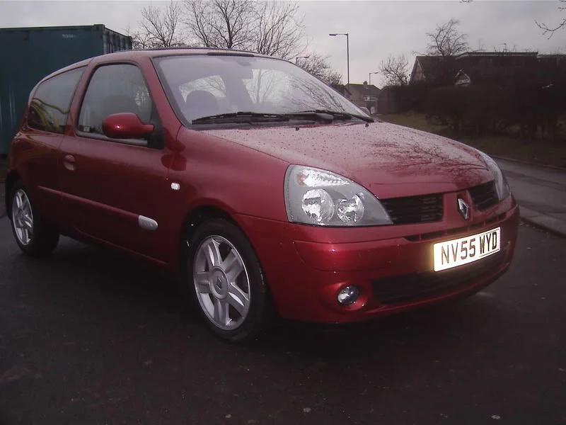

ill share some pictures of previous clios ive owned before i get started with this one :)
1st - Clio Ph2 172 (Dad owned it from new then i bought it)
2nd - Clio 1.4 16v Dynamique (Bought brand new)
Re: Supercharged Sunflower

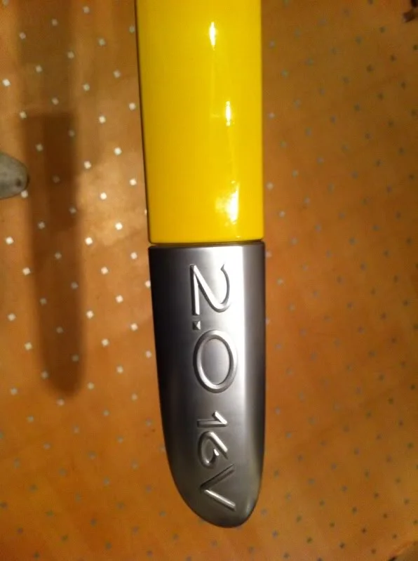

Iceberg silver engine cover

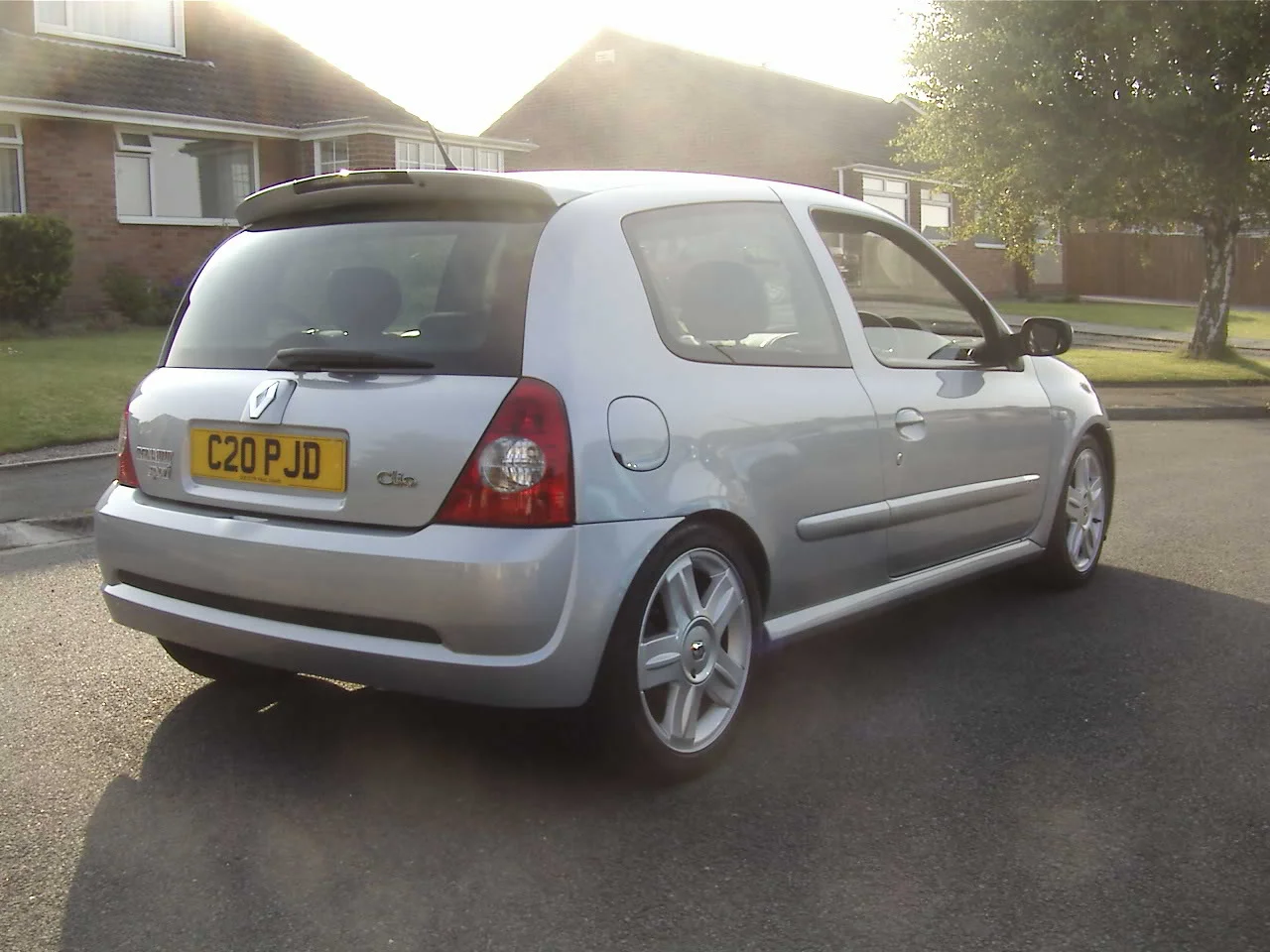

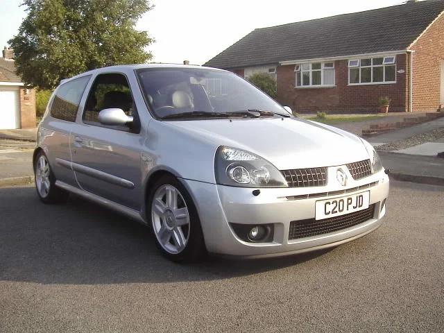

Finally sorted it for you craig lol

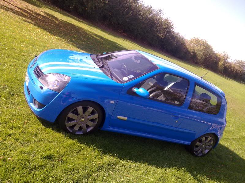

3rd - Clio Ph1 172 (iceberg)
4th - Clio Ph1 172 (Still own)
5th -182 FF

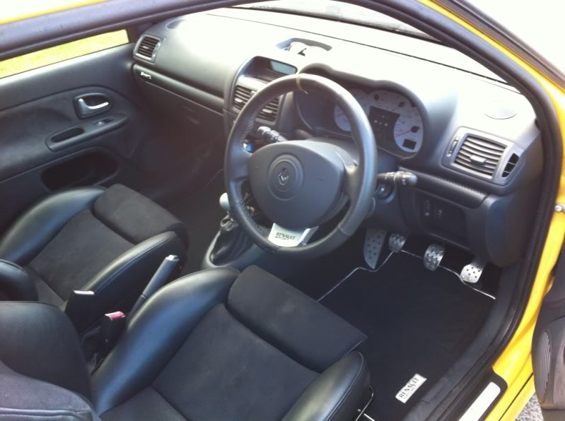

Quick snap of the interior the Ph2 dash has been fitted for about a year & a half now, 200 wheels & treadlines

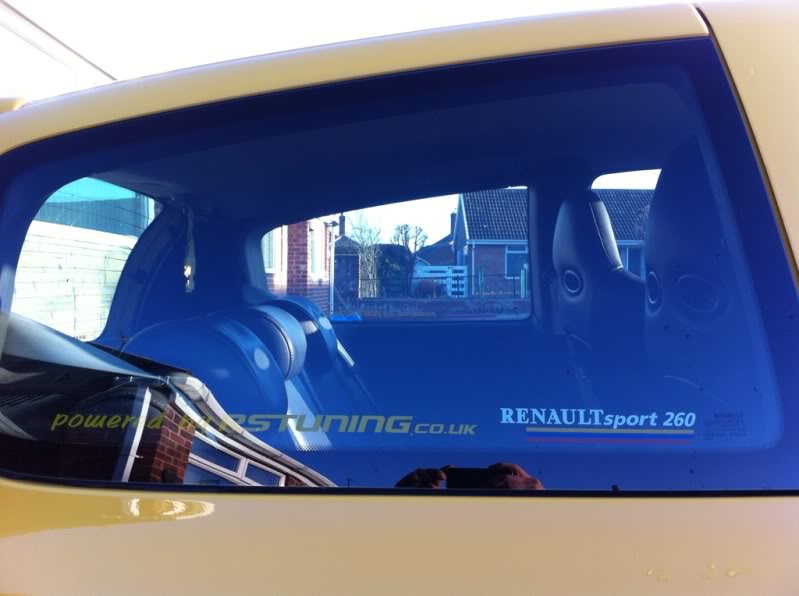

The powered by rs tuning stickers were silver when i got them off paul but a quick visit to the local sticker company they were soon yellow & new 260 stickers to replace the 172
