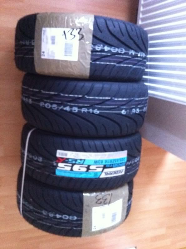

Little update. Block is with the engineering company getting bored out & balanced, should have that back next week. & these turned up this morning :-D
Federal 595 RS-R :D it was out of these, Toyo R1R & Yokohama Advan AD08s but these came in a lot cheaper & people I've spoke to who have used them rated them highly so thought I'd give them a try.

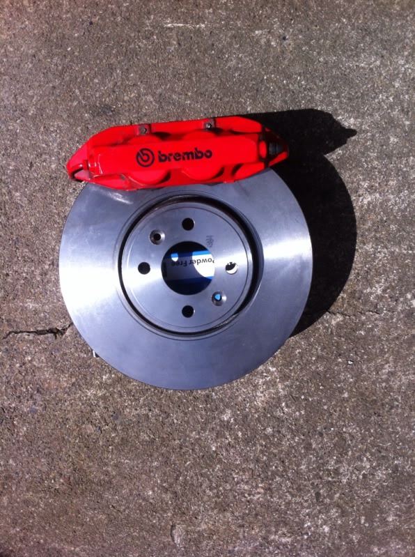

Due to using 197 brembos I've gone for 300mm brembo discs. The discs used are for a Renault scenic 4stud so perfect for the job.
Upside down picture ftw lol.

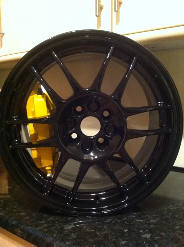

Calipers won't be staying red, I've decided to have them painted sunflower yellow to match the car with black brembo stickers so hopefully look something like this. (Wheels arnt staying the colour in the picture either they are going to be gloss black)

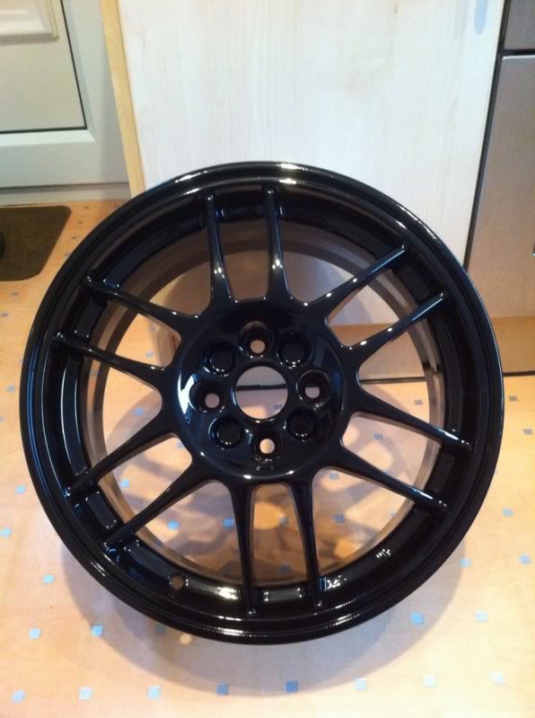

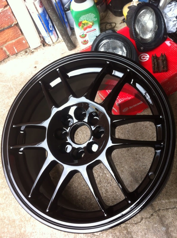

16s are now painted gloss black(again) even though I wanted them silver for the OEM look.

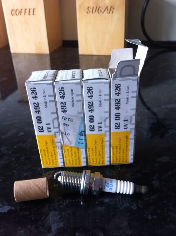

Also picked up some new Megane R26 NGK plugs.

I can't ever see myself selling it so I'm doing right & not thinking about how much it costs lol. Thanks mate I had made my mind up they were going silver to look OEM but soon as I painted this wheel black it made my mind up there staying black.

excelent car. wish mine was sunflower. were the 197 callipers a direct fit and is there any issues running 15s ?
Thanks mate. No the brembos arnt a direct fitment you need customs brackets & use Scenic 300mm discs. Im not running 15s now these are the 16" F1s as the 15s wont fit over the brakes lol[/FONT]

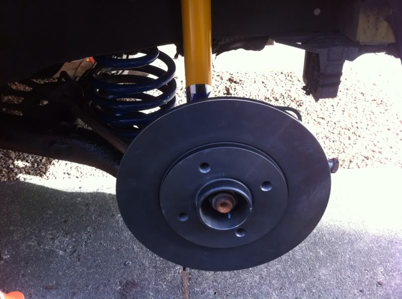

New genuine rear discs & bearings fitted.

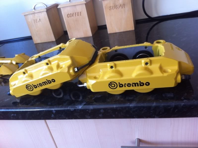

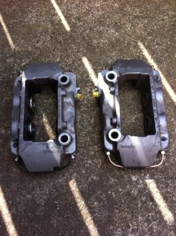

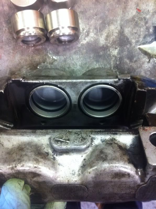

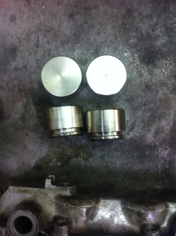

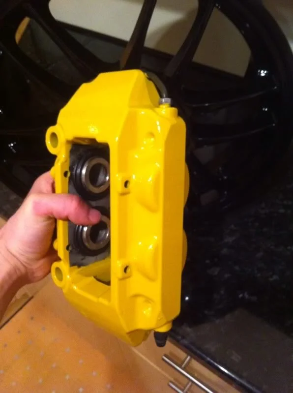

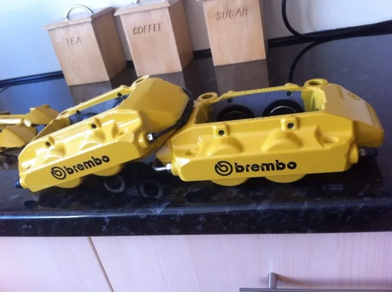

Also stripped the brembos down at work before sending them off to get painted sunflower yellow.
Replaced two bleed nipples to the caliper on the right & made a new link pipe up as it was damaged.

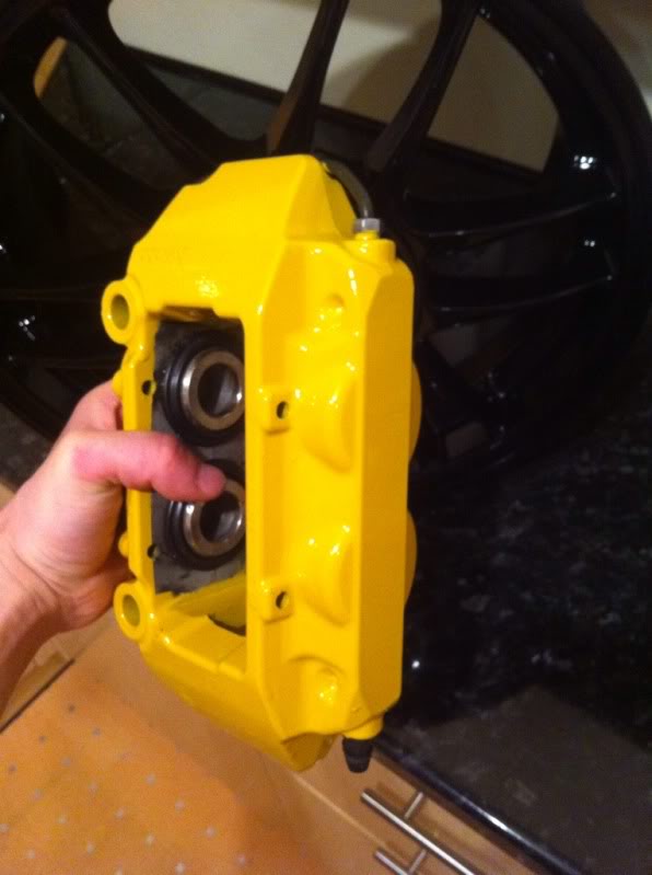

Nice work mate, what paint did you use on the calipers?
Thanks mate, I got some two pack made up & my mate painted them, he said the paint he used for the engine bay wouldn't have took the heat so got the two pack.

[FONT=Tahoma, Calibri, Verdana, Geneva, sans-serif]
Oh my!! :eek:
They look awesome Craig!
Going to look superb when they are fitted.
Nice one! :)
Thanks mate, hopefully get them fitted in the next few days just waiting for the brackets to be made at the local engineering company.
