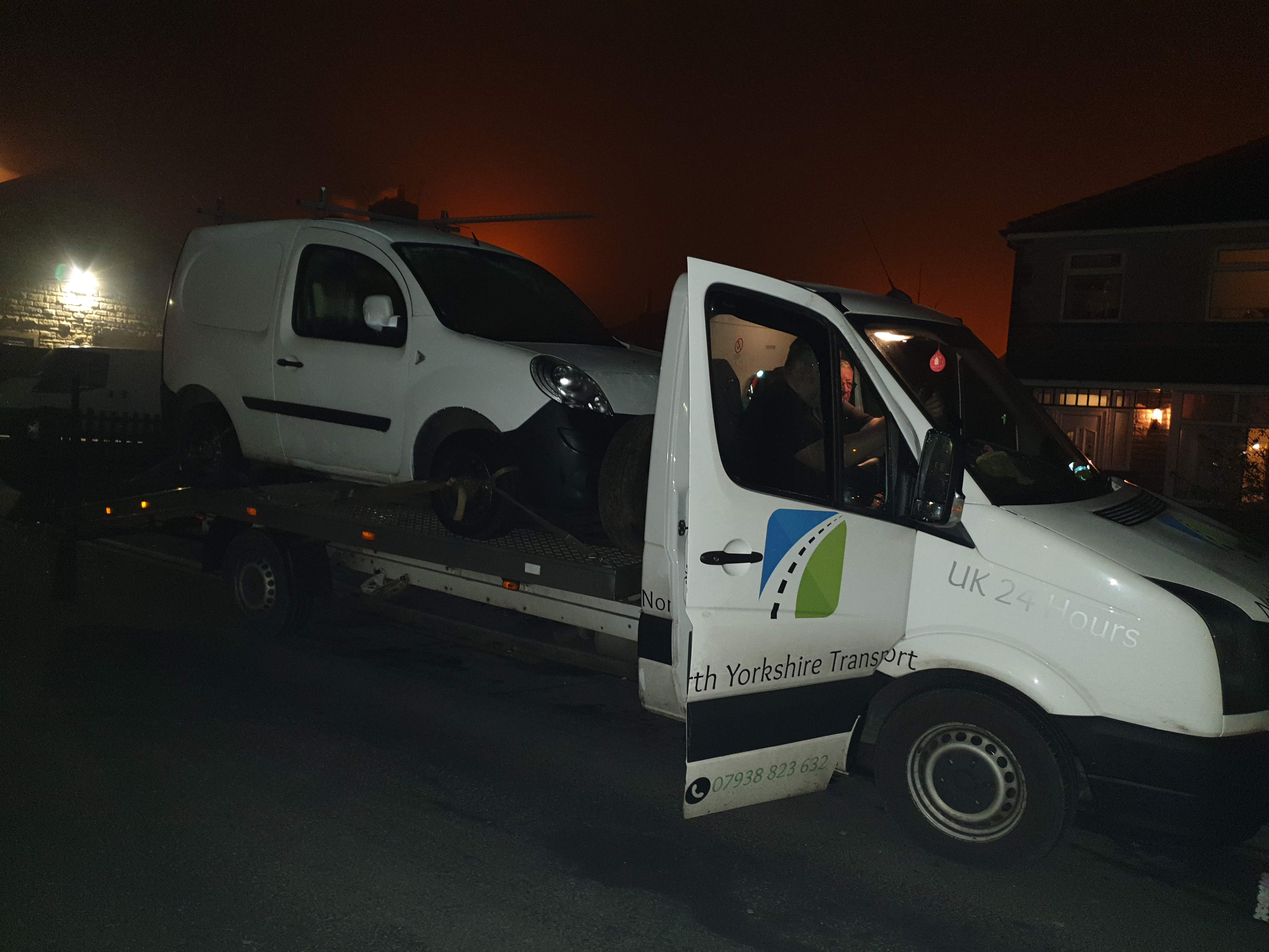

Wanted to see if the kangoo could keep with it on way back from csf. Shez said no and next thing shes off like f**k in it. Oldskool racer tricks :LOL:
shadey tactics, id watch out for her tbh :ROFLMAO:
ps don't tell her I said that, I value my kneecaps
did the van real it back in though?...

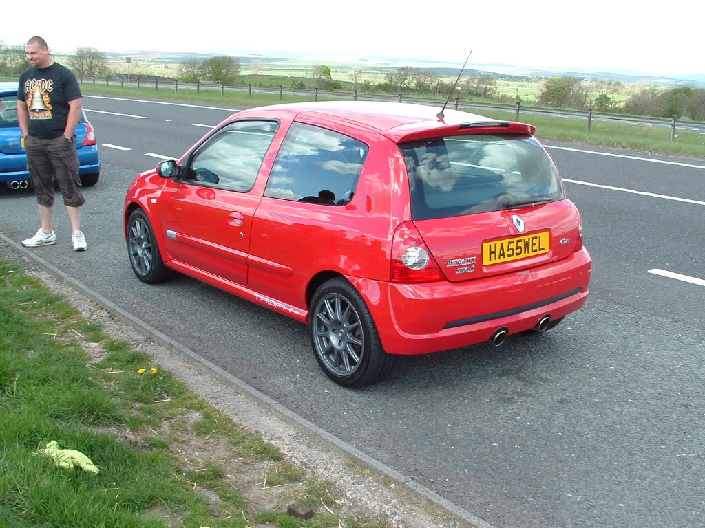

We are going back, way back from when i was a member of the Renault Turbo Owners Club forum (Rtoc) which was mostly for R5gtt's, i believe a few of you were members back in the day. This is where i first read about this Trophy, around 2008-09 iirc, Steve used to post as Speedy on there from memory. Its all a bit hazy but i recall his regular updates and improvements being posted, the car was running a forged engine, standalone ecu, log manifold with garrett gt series turbo, and made good power 330 ish then going up to 370ish.
I was more of a R5gtt fan at the time and just classed this as another modern car that i couldnt afford on limited wages, but appreciated the development and power it made, as it was leagues ahead of the shitey 1.4 turbo carburettor engines that i was working on and tuning. Injection looked like a black art to me and i was still of the oldskool carburettor tuning via screwdriver and drill bits for the jets.
A pic of the car from the early years possibly downloaded from here, on the original turini's.
Around that time the Rtoc national days were at Mallory park, i seen the car on them days and out on track. It can be seen in this pic on the left hand side, one car away from Extra van. Chris Blight's RB clio next to it iirc.
Im sure i have a pic of it on track somewhere as i used to take my dslr to the track and snap a few pics back then. Id have never thought that a decade later, it would be sharing the same garage as my Extra van.

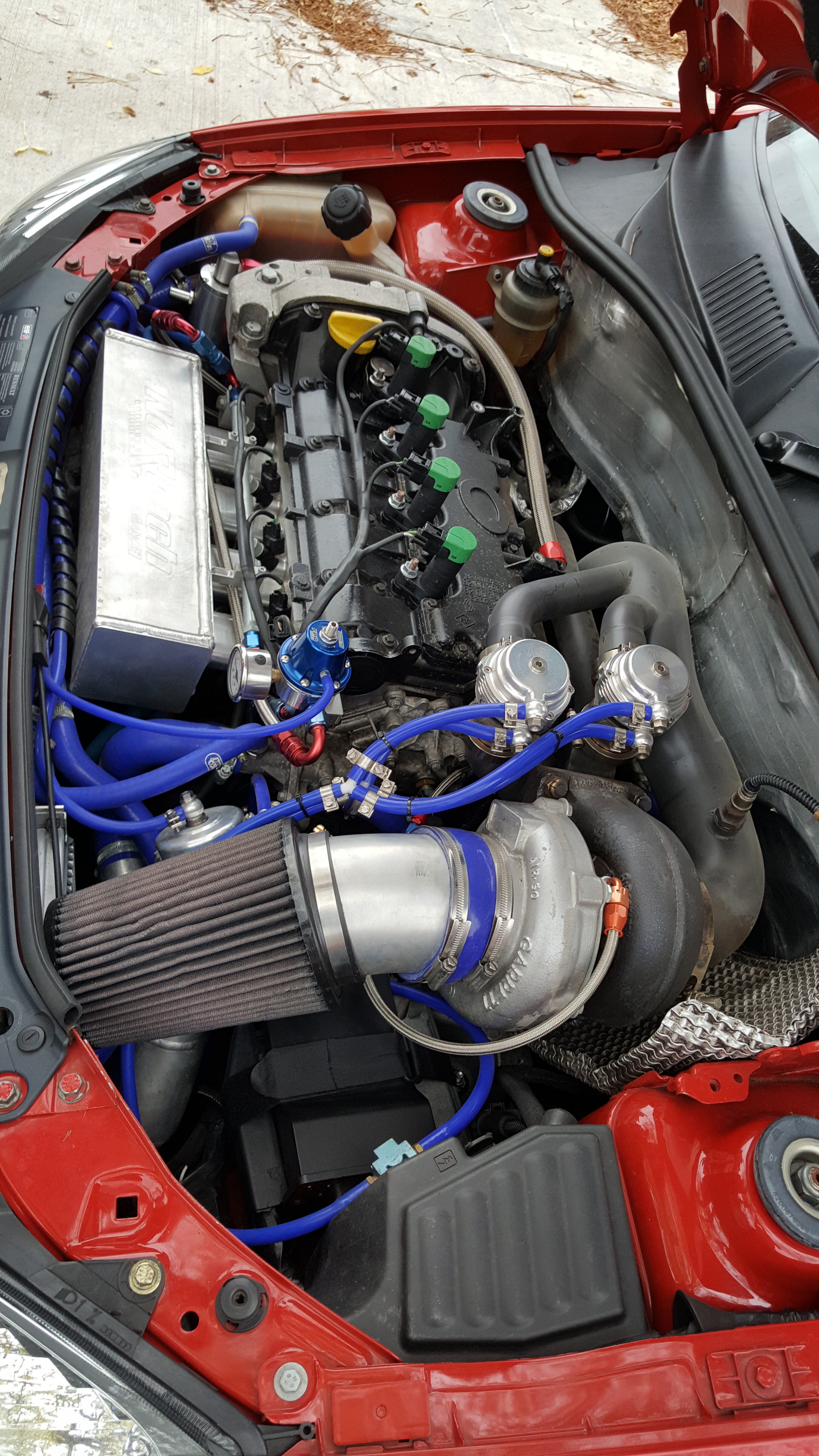

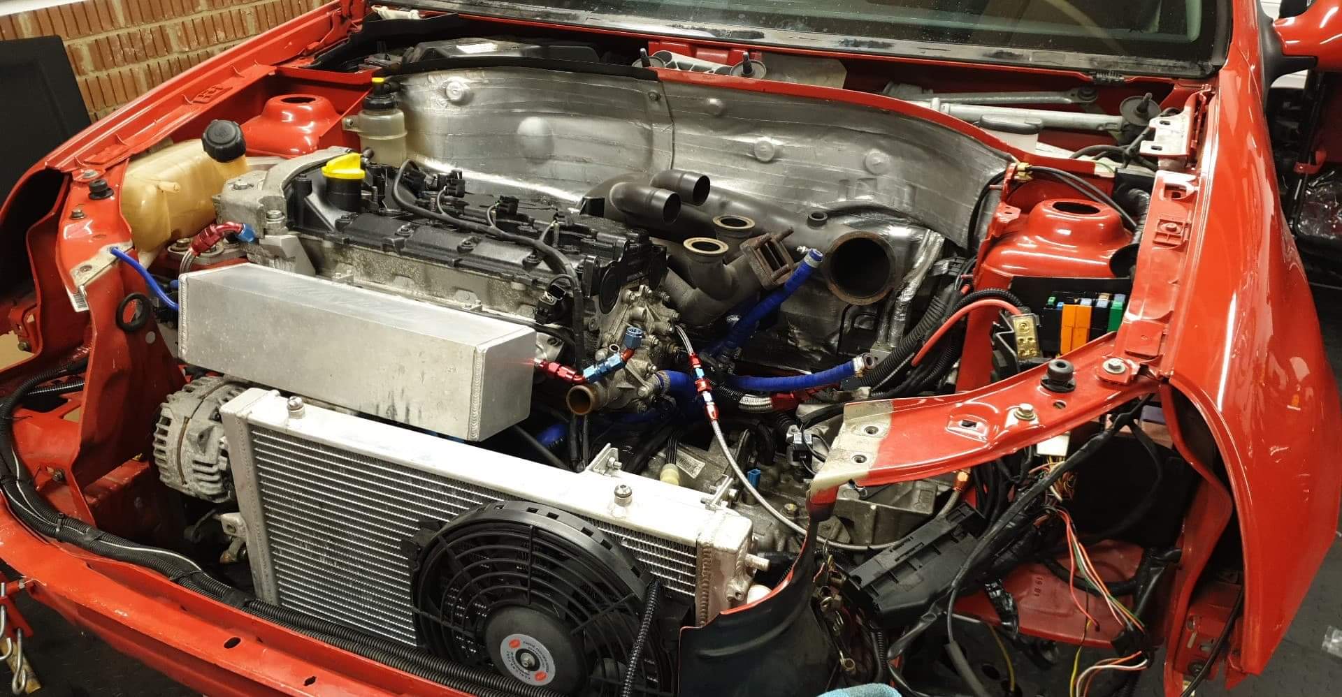

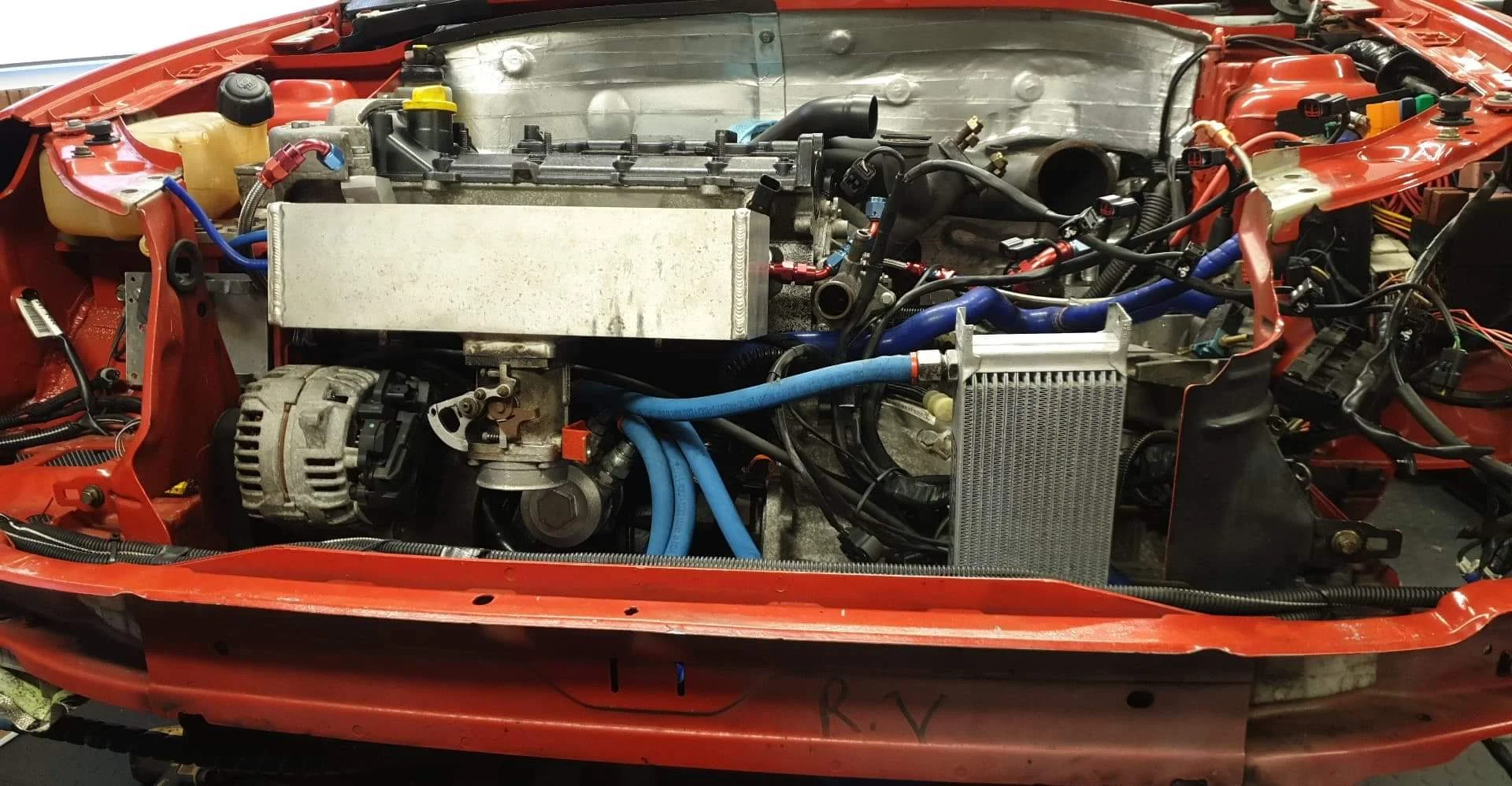

The engine bay at that point.
Tested the water at that point and asked if he wanted to sell it as was so impressed with the performance and excellent condition. Flirted around a price but he didnt want to sell, so thought that was that.

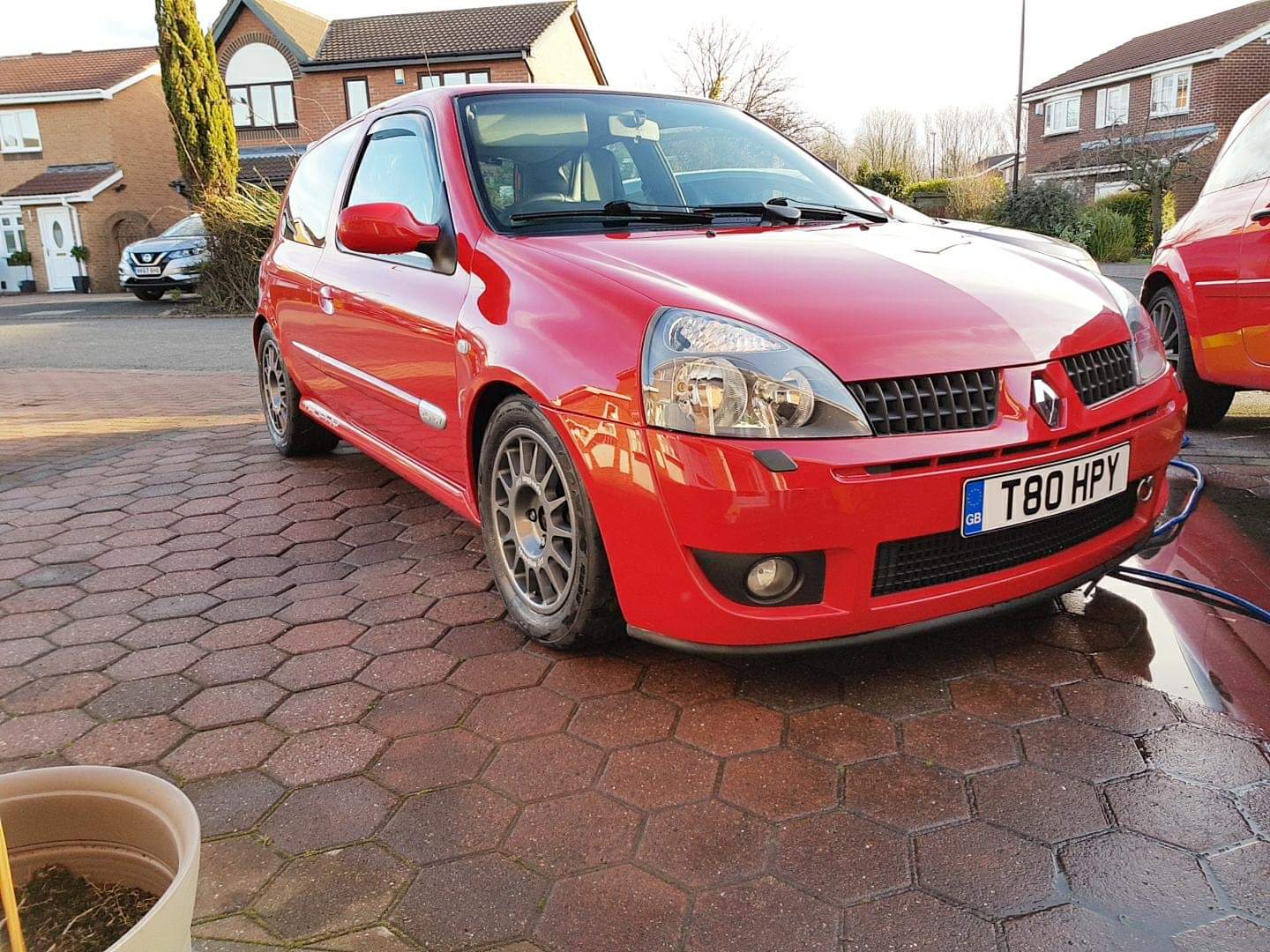

Well. Holy f*ck. 🤌
Lovely!
Yeah this was properly nice in person.
And nothing gave it away that it was turbocharged. Only when the bonnet went up, it was certainly a suprise.
It’s lovely and a real credit to you.

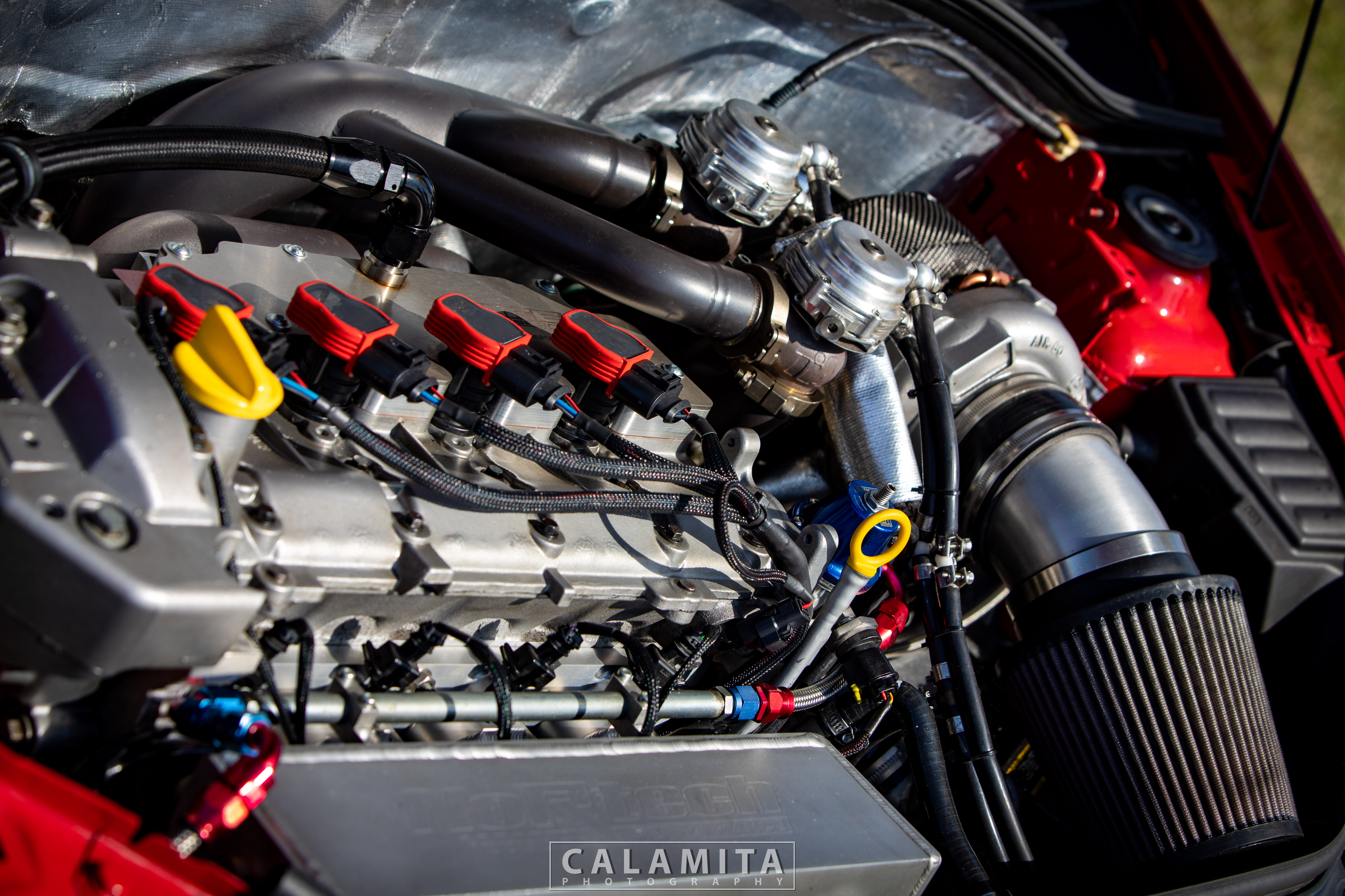

Cheers for the feedback gents, its much appreciated. Its been a long old winter in the garage putting it together, and really enjoyed taking it to CSF with it being the first one post covid.

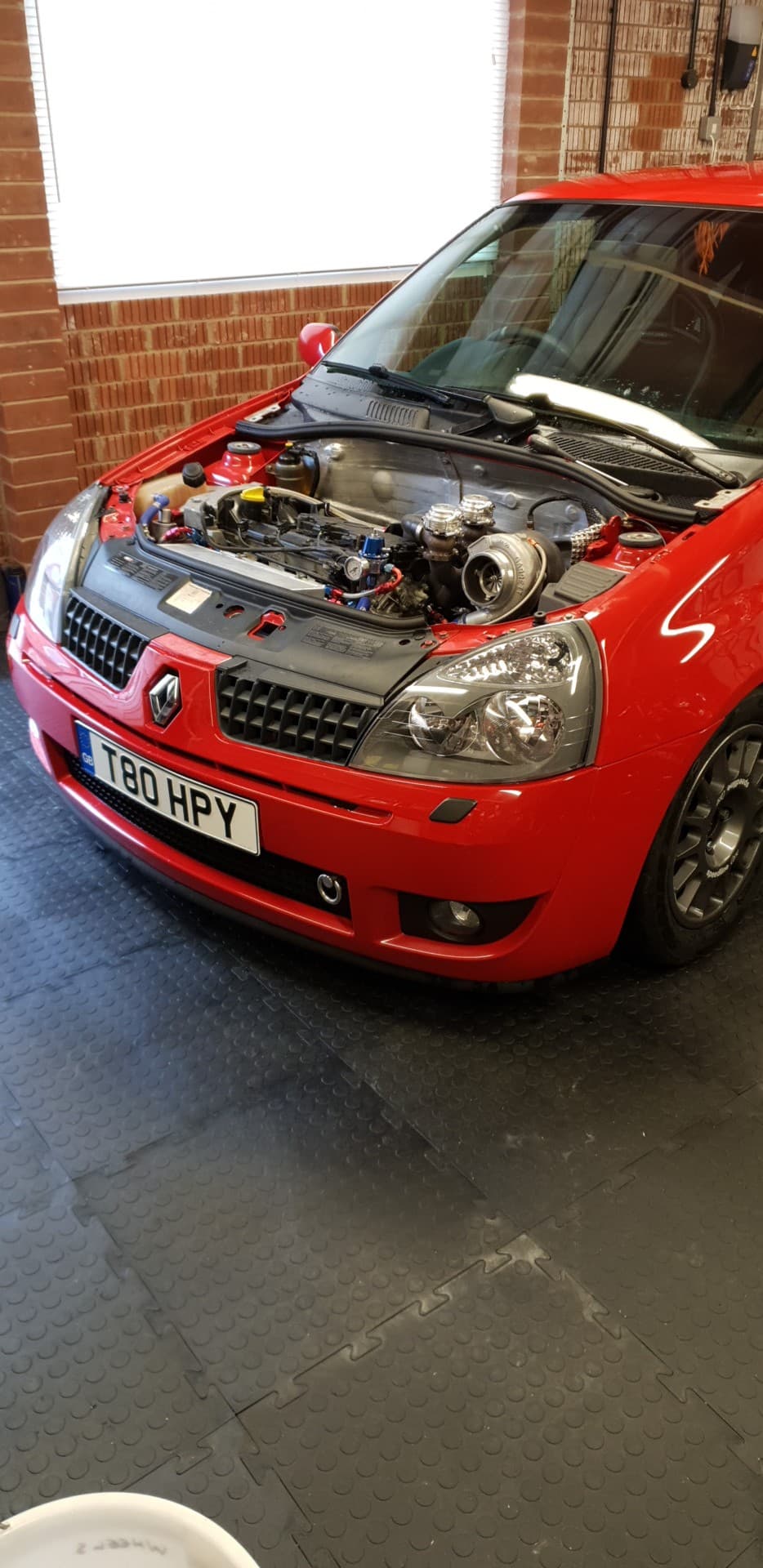

First Clio turbo ive seen that looks like a genuinely proper job. Twinscroll with dual gates, proper manifold and management as it should be. Love it :)
Cheers mate. The exhaust manifold is a nice bit of kit, Nortech have done an awesome job. The runners are not totally equal length so it has an offbeat sound like an old renault5gtt, never heard another f4r sound like it.
It runs great on ecumaster, dash works as oem no warning lights etc, drives fantastic even on 980cc injectors so perfect for street use. Mpg is great with the 6 speed ndo box when cruising at 70mph on the motorways. The run out to Leeds then Blyton and home was approx 277 miles and around 1/4 of a tank of fuel is left from full, which is great with the current price of fuel.
Sebimotorsport sort of let this out of the bag on an insta post a while ago. Looking forward to reading the rest of the updates

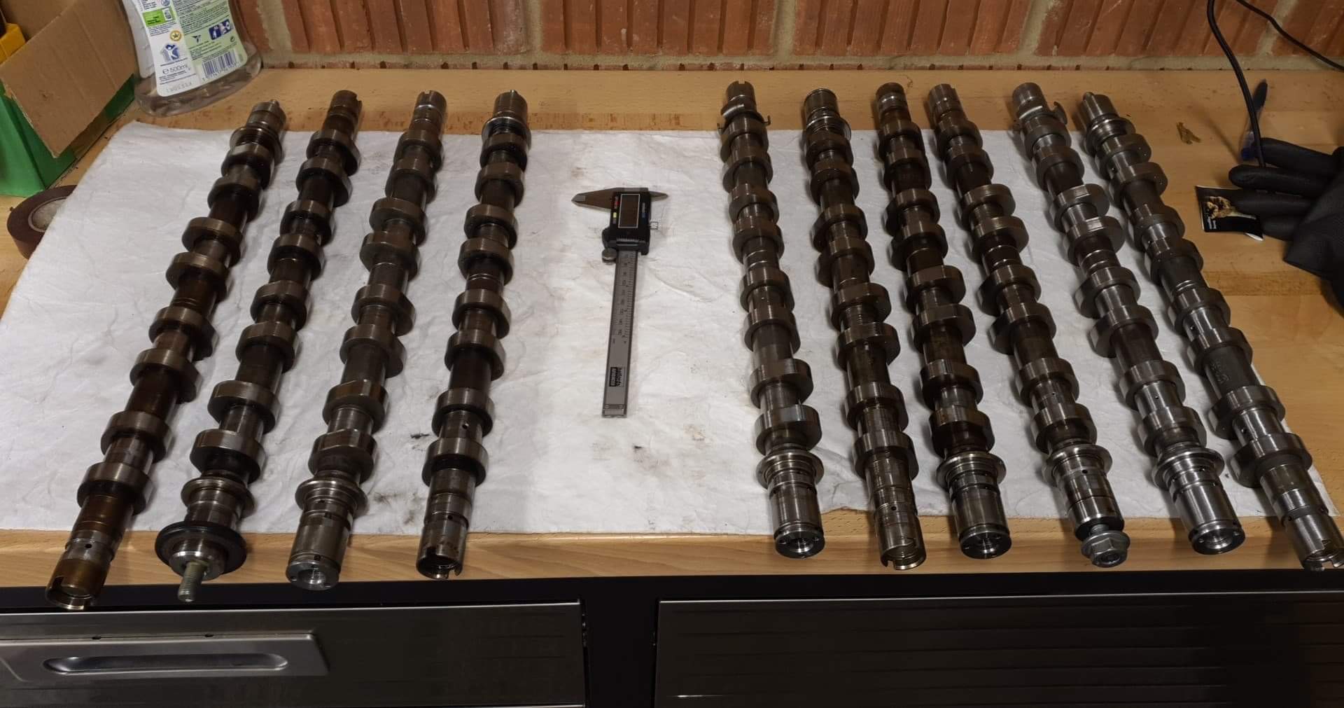

Just as an FYI, you'll get more inlet advance using a 197 dephaser pulley.
Also, would it not be more worthwhile running a 1*2 exhaust cam instead of the 197 item? It's a real minefield speccing cams for turbo motors!
Is this something that would be advantageous for standard 172 cams on Grp N timing??
NorthloopCup
Nah mate. The Grp n stuff is tried and tested too buddy.
The mk3 motors ran a similar cam timing trick to the mk2 Grp n, but you had to change one of the cams in the mk3 to get the results. They also didn’t alter the inlet cam position. It was all about the exhaust cam on that.
Renny 5
  Meg 4RS & Renault 5
Ok mate 👍🏼 I saw you did a 182 on jenveys and Grp N ages ago and tried to get similar results in my 5 once the ITB’s were fitted. I was a few hp’s and ftlb down from your figures and wondered if that was why?? Still managed to get 150ftlb at 3700rpm though.

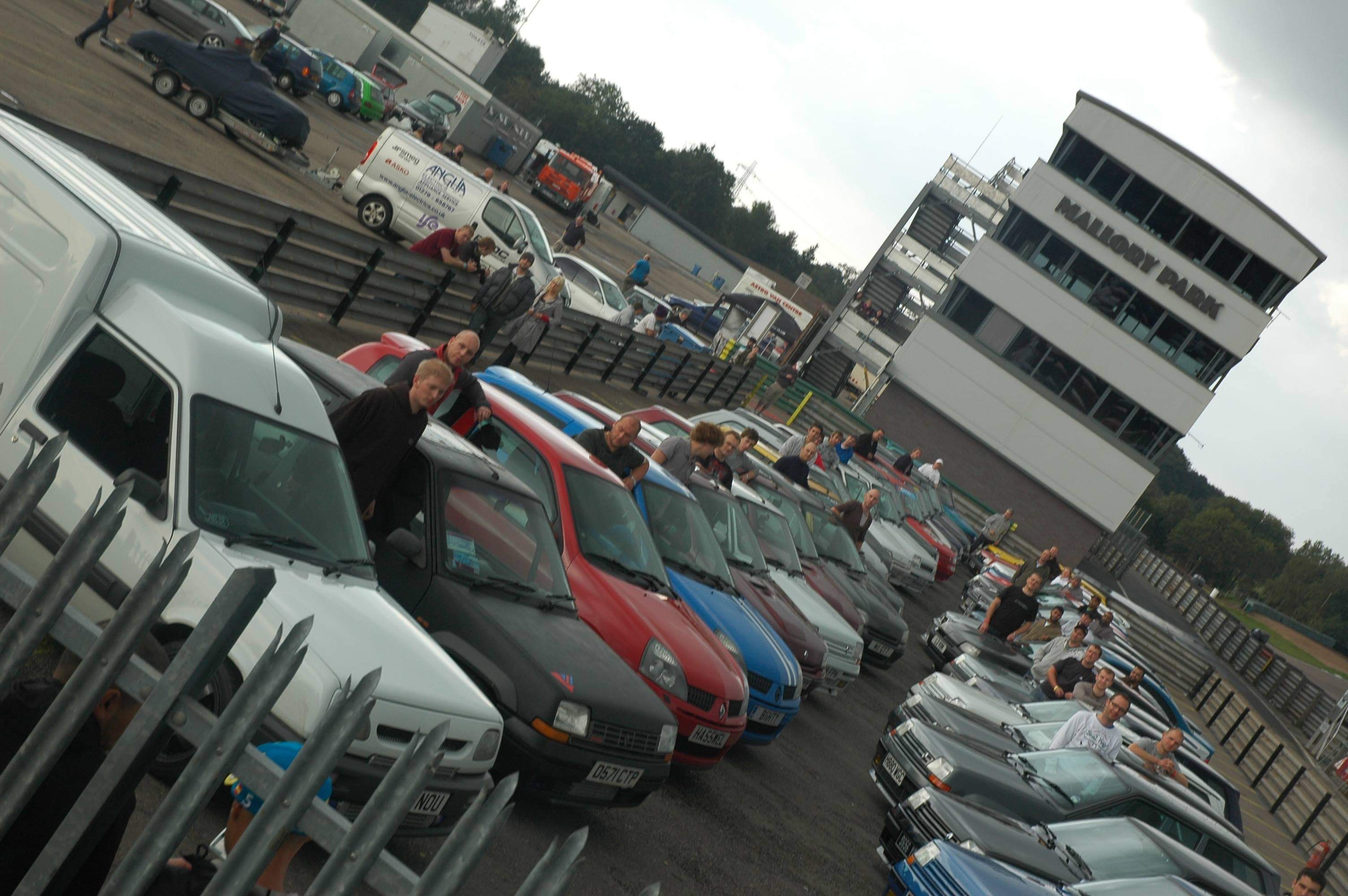

look at the RTOC national day pic! GTT was still alive back then.....sniff sniff
They were brilliant days, pretty much how I met all the friends I still have now. Helping repair GT Turbos then a curry afterwards, trackdays, rolling road days. The amount of cars that would turn up to organised events like the RR days were amazing.
I think it was 2005-6 when I came back in GT Turbo ownership in a clean Tungy with Raider seats, bar that and a Scorpion it was completely standard. I rocked up to a Southend seafront meet and the rest is history. Back then people would drive down from the Midlands to meet up and there would be hundreds of cars all lined up along the seafront.
RTOC days at Mallory, Rockingham, camping over getting battered, first trip to the Nurburbring in 2007 with a dozen GTs.

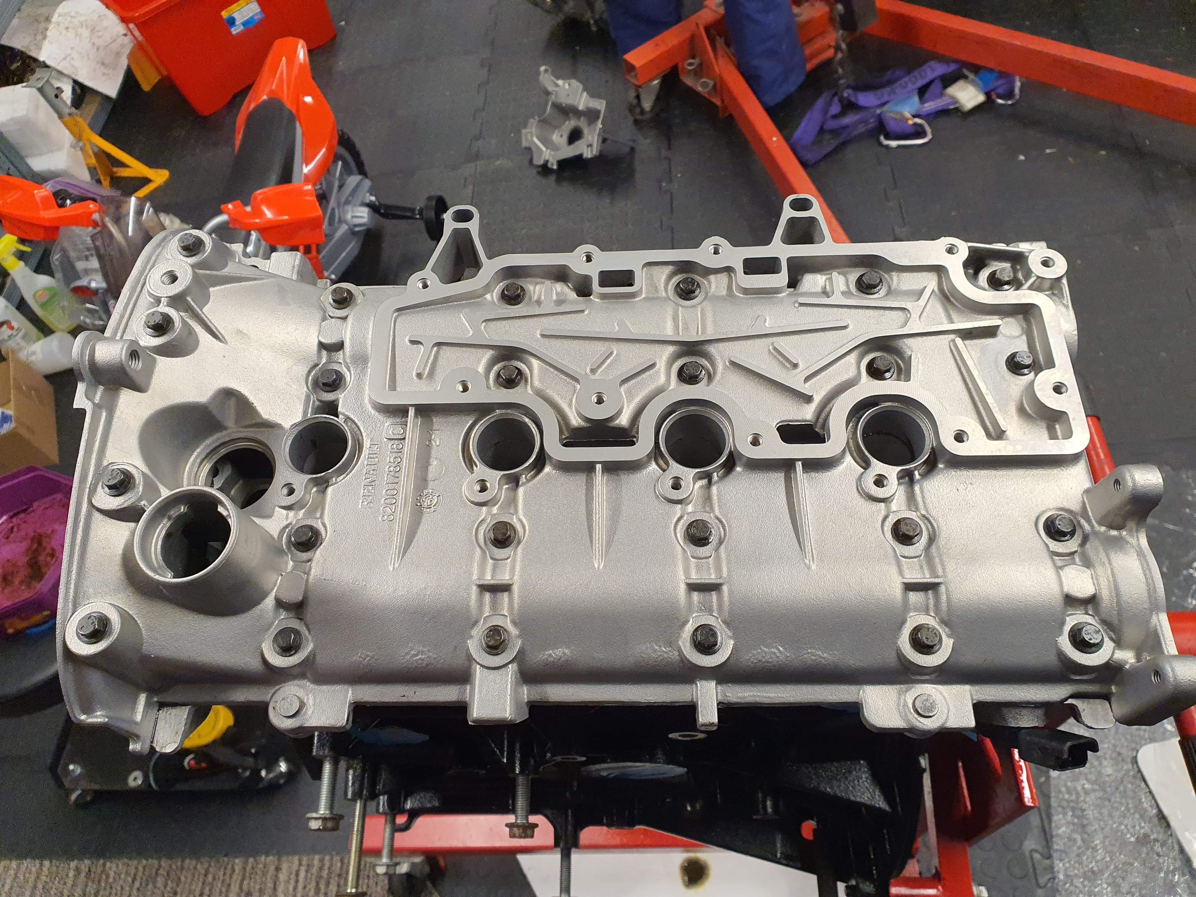

Small diversion off the thread, before i do another large update.
Current spec of the car to the best of my knowledge.

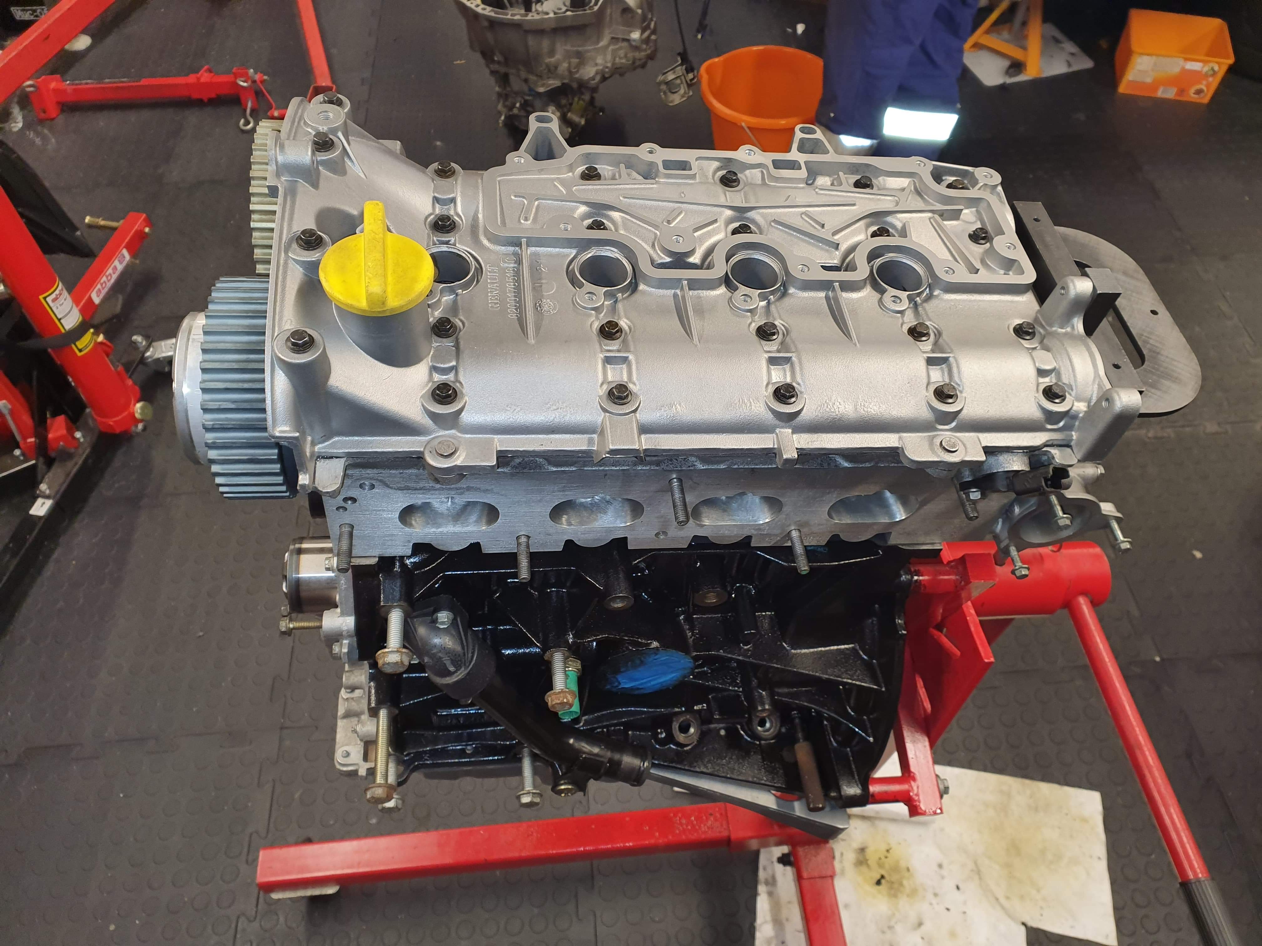

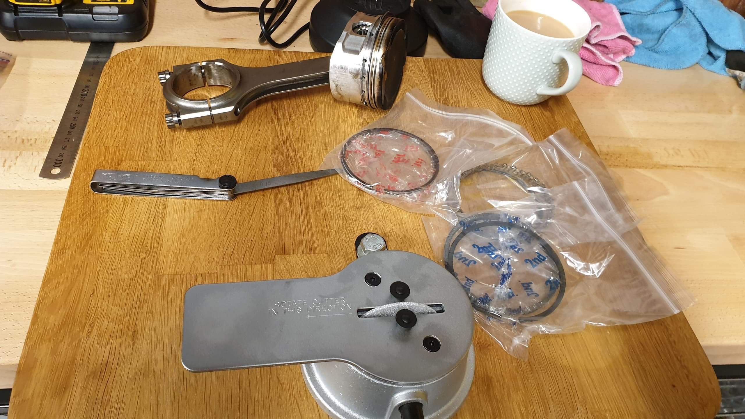

Engine/Fuel system

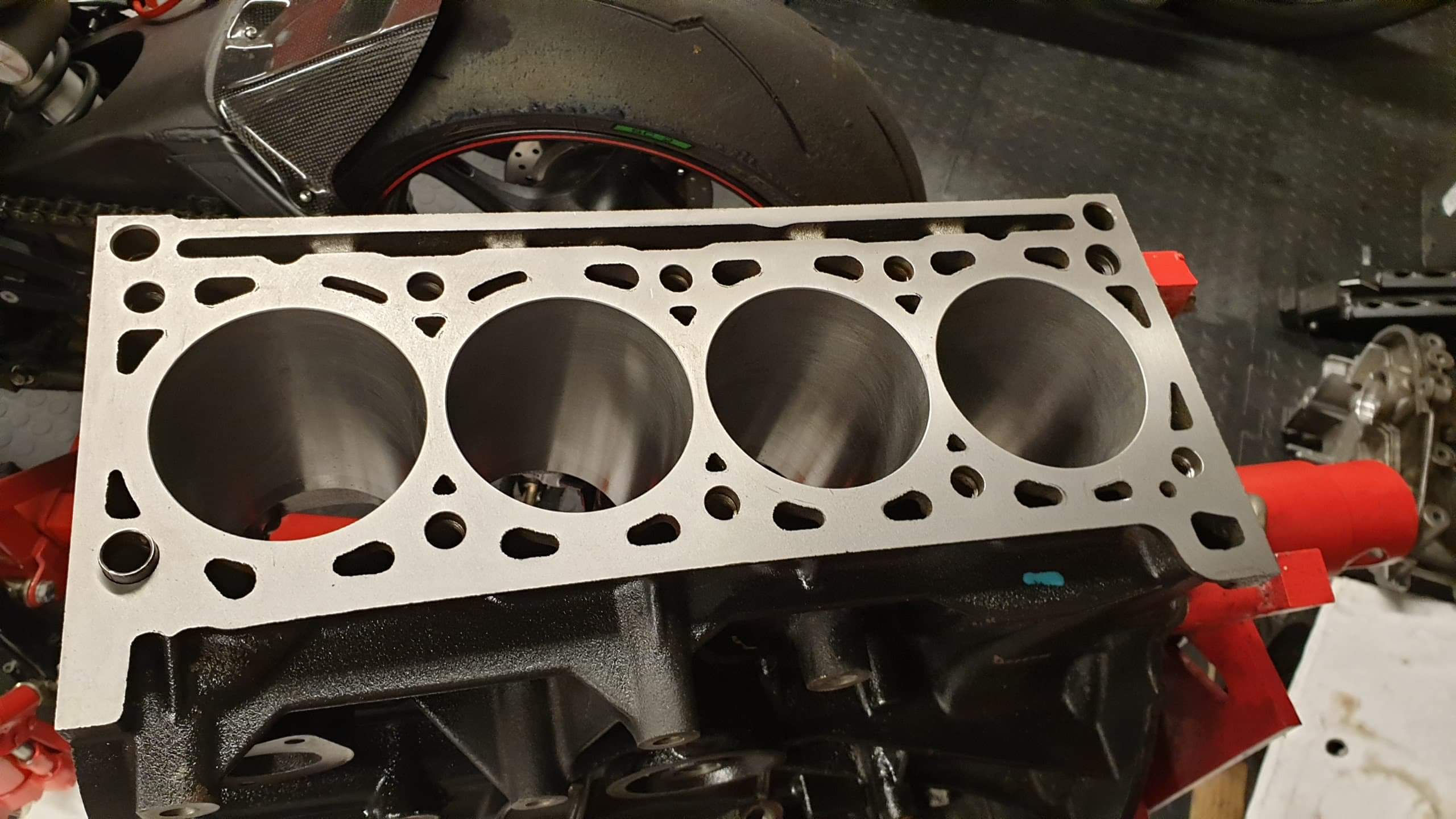

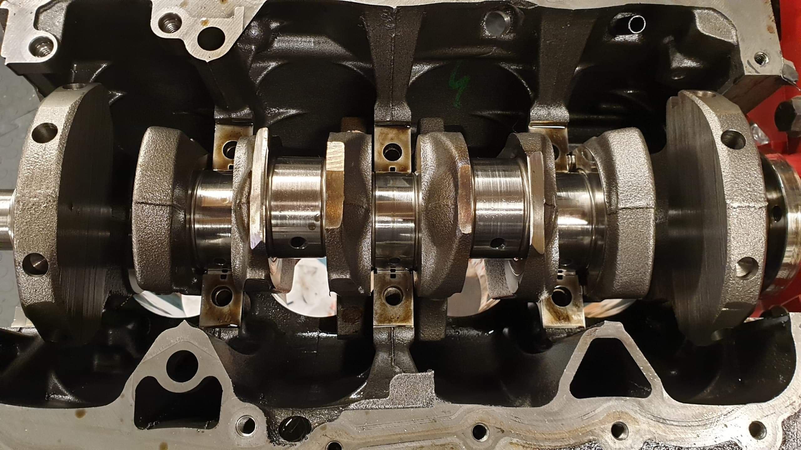

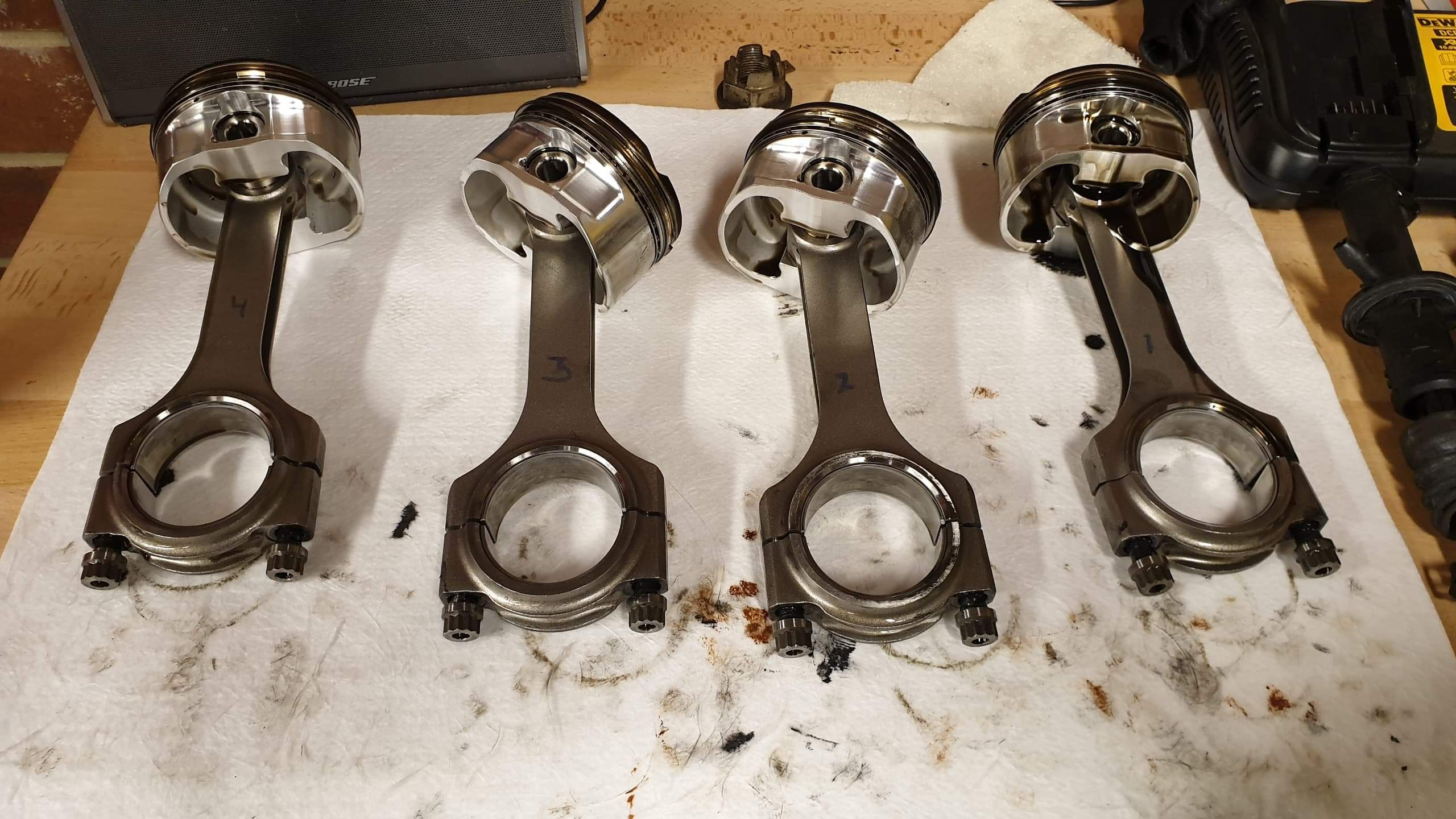

Megane 250 block, custom J.E. forged pistons (around 8.3:1 with 197 head iirc, id need Steve to confirm).
Catcams conrods, balanced crank and rotating assembly. Block prepared by AMAC, including hone and decked to suit.
Arp hardware, head studs etc.

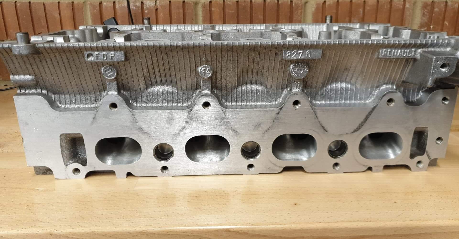

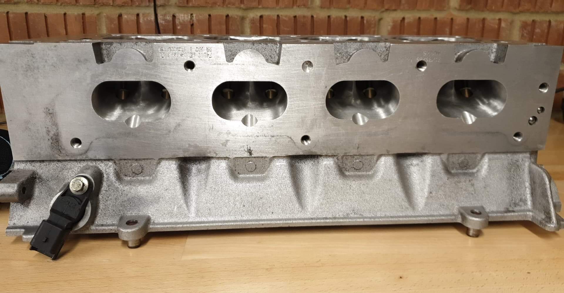

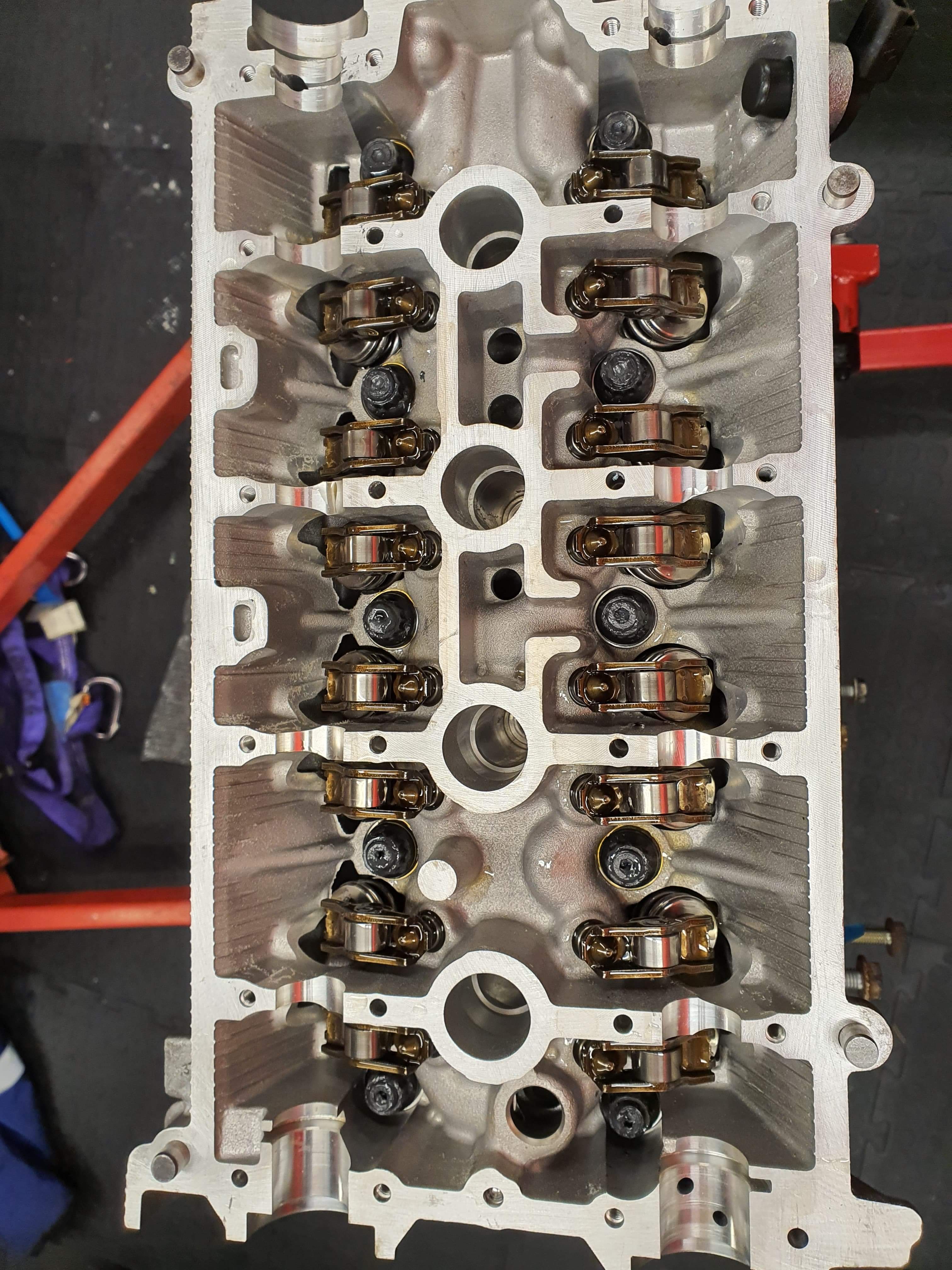

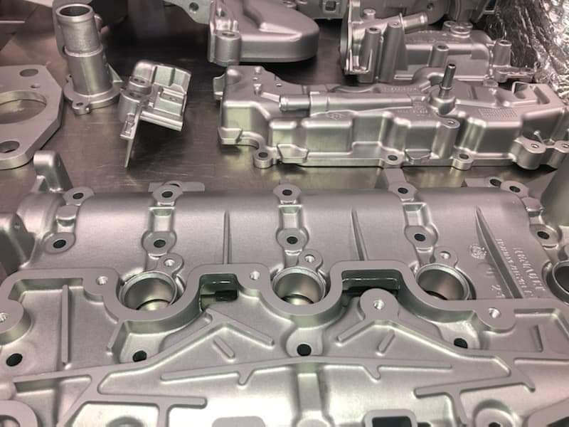

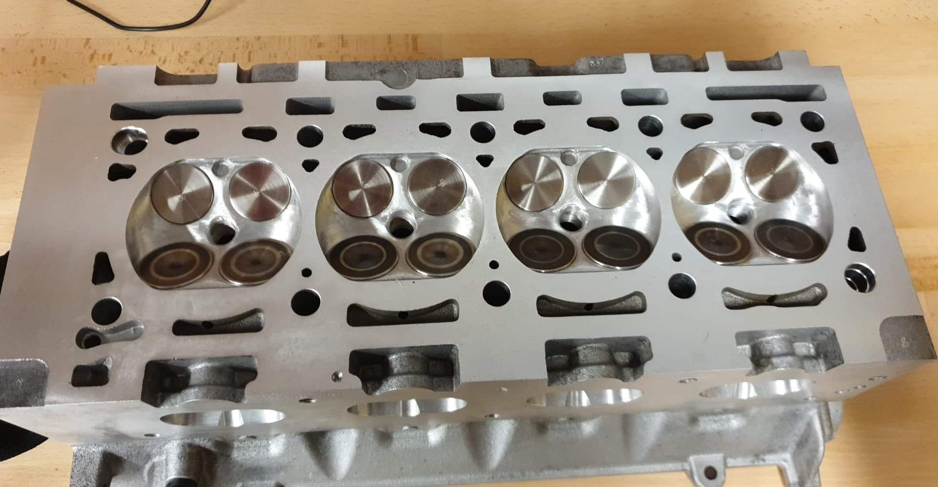

Ported 197 head done by AMAC in Northallerton, with larger Supertech valves, double valve springs (catcams?) and titanium retainers.
197 inlet cam, 182 exhaust cam using 197 vvt setup. Timing currently set to stock.

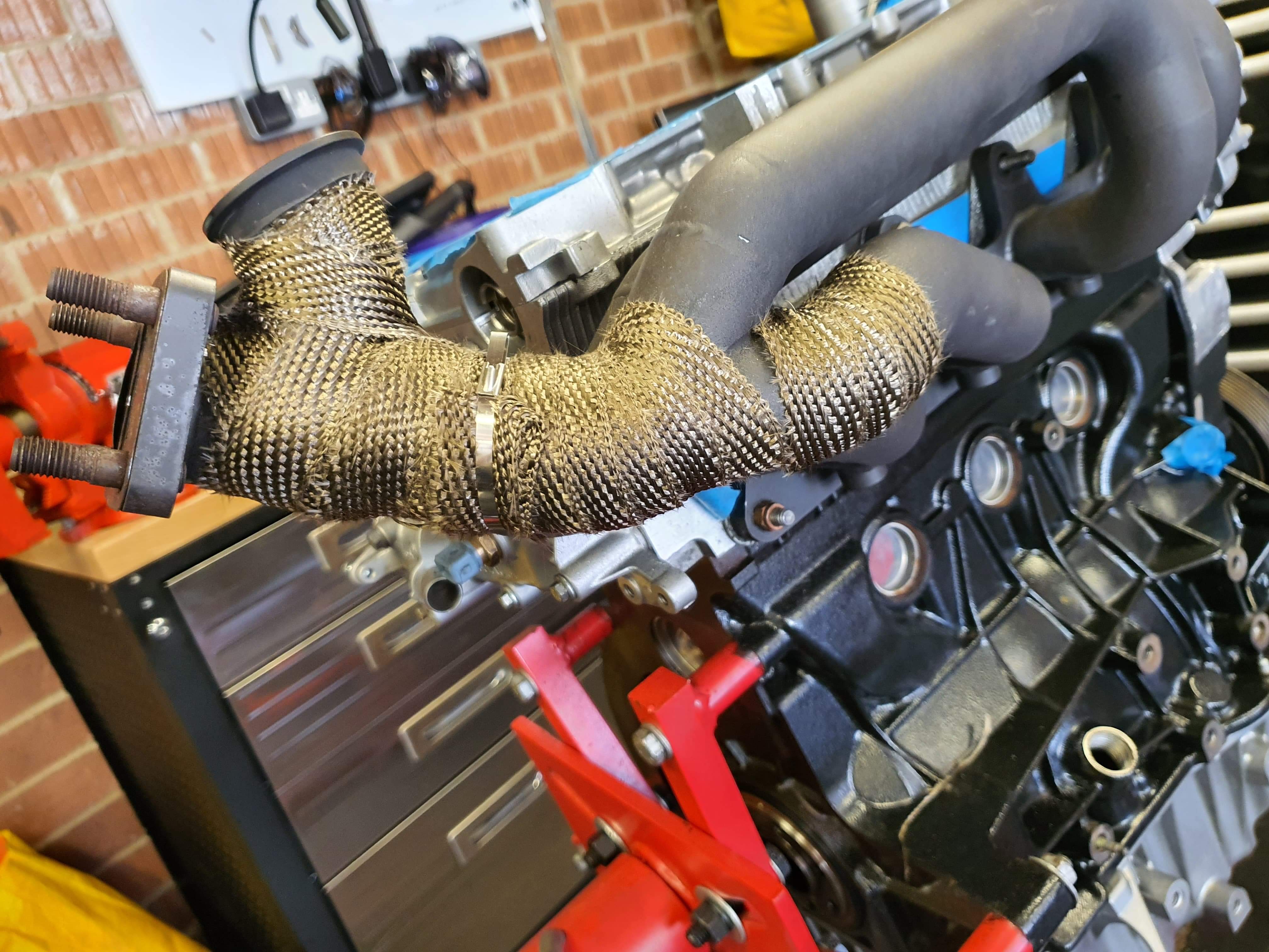

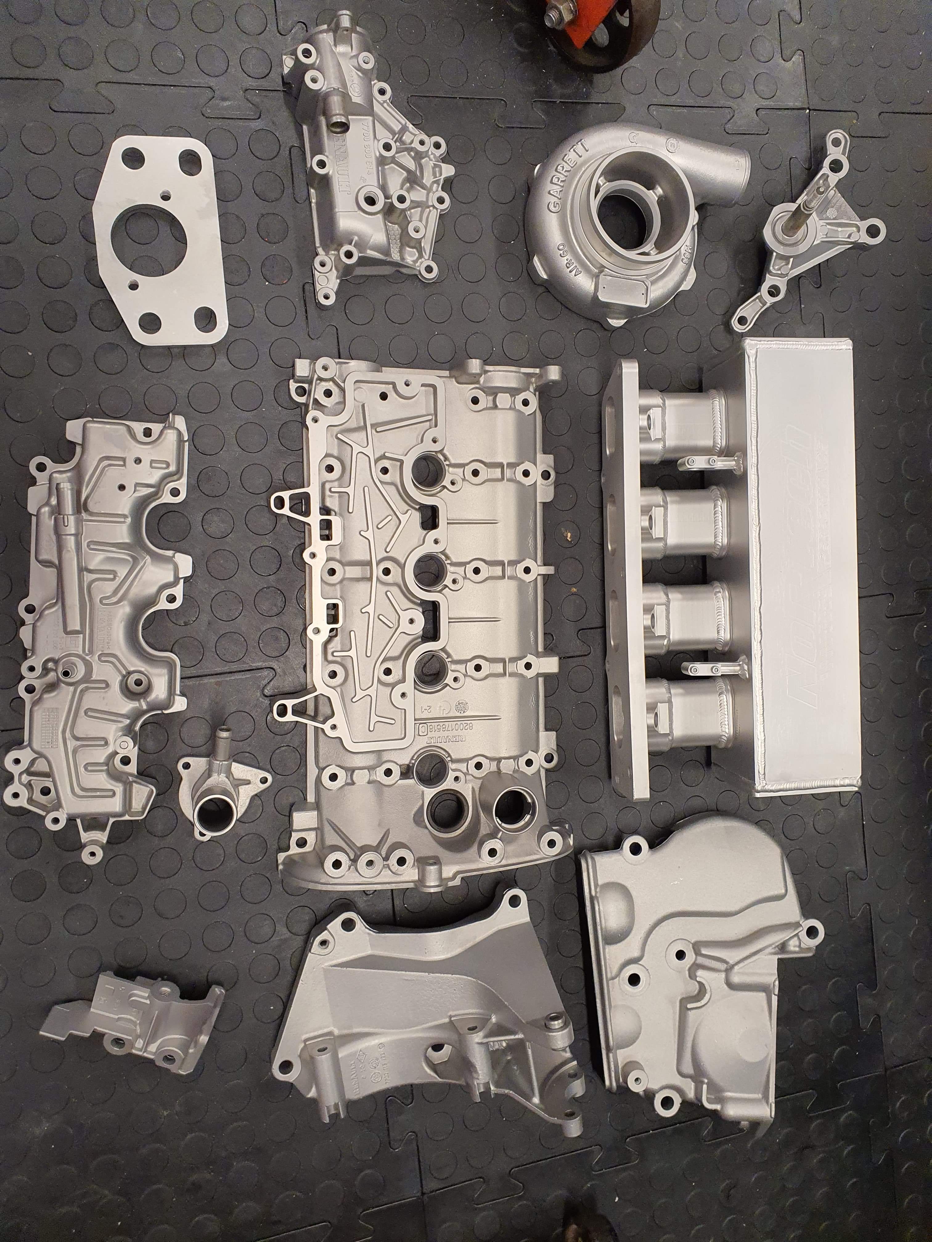

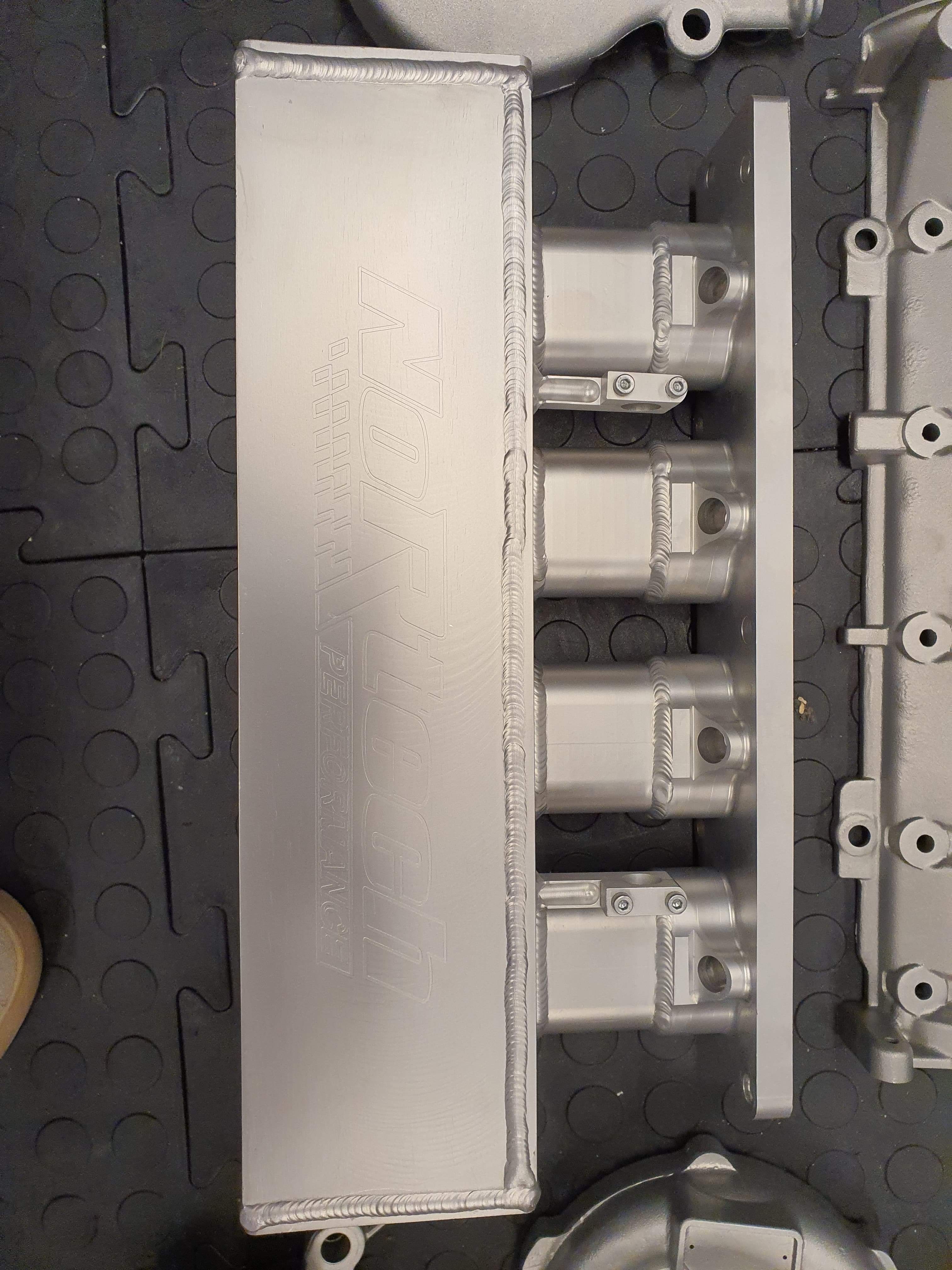

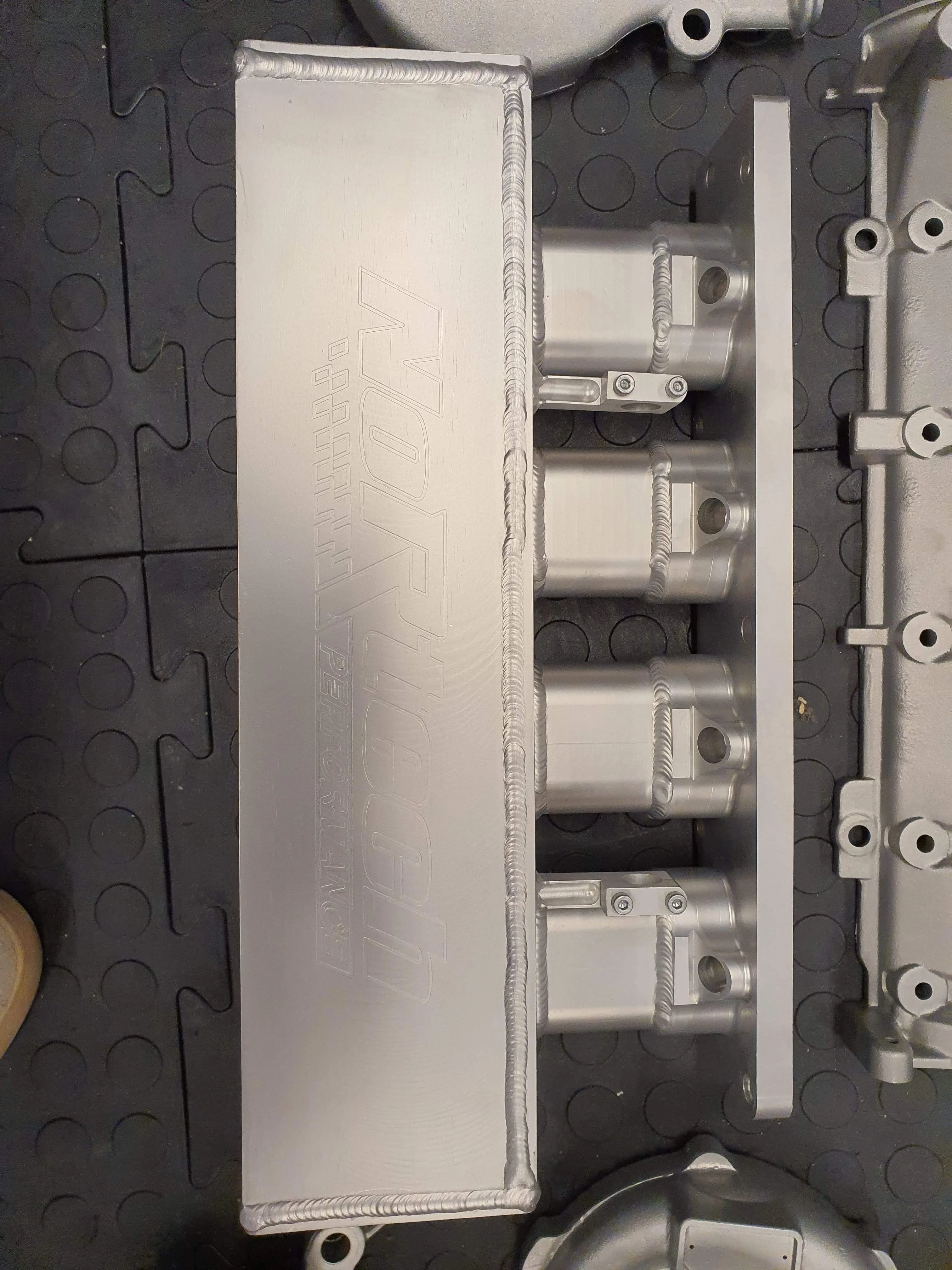

Custom Nortech inlet plenum with internal trumpets, centre fed Bosch motorsport DBW throttle. Inlet/head is dowelled to locate perfectly on the head.
Custom Nortech exhaust manifold to suit twin scroll turbo with 2x 38mm tial external wastegates for each pair of runners, venting back into the downpipe. Egt sensors per cylinder. Ceratec coated.
Garrett gtx3071 gen1 .82 twin scroll turbine housing. K&N air filter.
Intercooler/pipework is custom by Nortech, intercooler is bar and plate garrett core rated to 600hp iirc.
Direnza radiator, Mtc silicone hoses and 12" Comex high flow cfm fan. All shrouding fitted correctly to force air through rad and intercooler.
3" custom turbo back exhaust with 2x sliencers, 2.5" slash cut tips for discreet look. Possibly made by Btm/yozza would need to confirm.
Ecumaster black standalone ecu, on my own custom engine bay wiring harness. 980cc bosch motorsport long pintle injectors (flowmatched), running full sequential injection and 197 vvt on pwm so full scope of 40deg inlet advance available.
Audi R8 coilpacks and Ngk Bkr8eix plugs gapped to 0.7mm.
Egt per cylinder using Ecumaster egt to can module. Oil pressure/temp, fuel pressure/temp, wideband 02, dbw throttle and various other essential sensors all feeding back to the ecu. Mac valve plumbed in for boost control, 4x separate boost settings on potentiometer fitted in car via Ecumaster can switchboard for expansion.
Ecumaster edl1 data logger fitted in glovebox logging all ecu parameters onto sd card, and bluetooth, which displays all gauges via canbus on an android tablet or phone.
All connected up to the oem clio 250kb baudrate canbus syetem so oem dash works nice. No warning lights present, dash works as oem, stock engine ecu fully removed.
1.5ltr swirl pot fitted in boot with Bosch 044 fuel pump, sytec fuel filter, turbosmart fpr 1200 fuel pressure regulator.
-6an ptfe lines fitted front to back as return system, oem pump used for lift pump for swirl pot.
Battery relocated in boot using 50mm2 wiring from memory, maxi fuse fitted in boot, bulkhead connector and distribution block fitted in engine bay. Optima Redtop battery fitted in billet alloy tray.

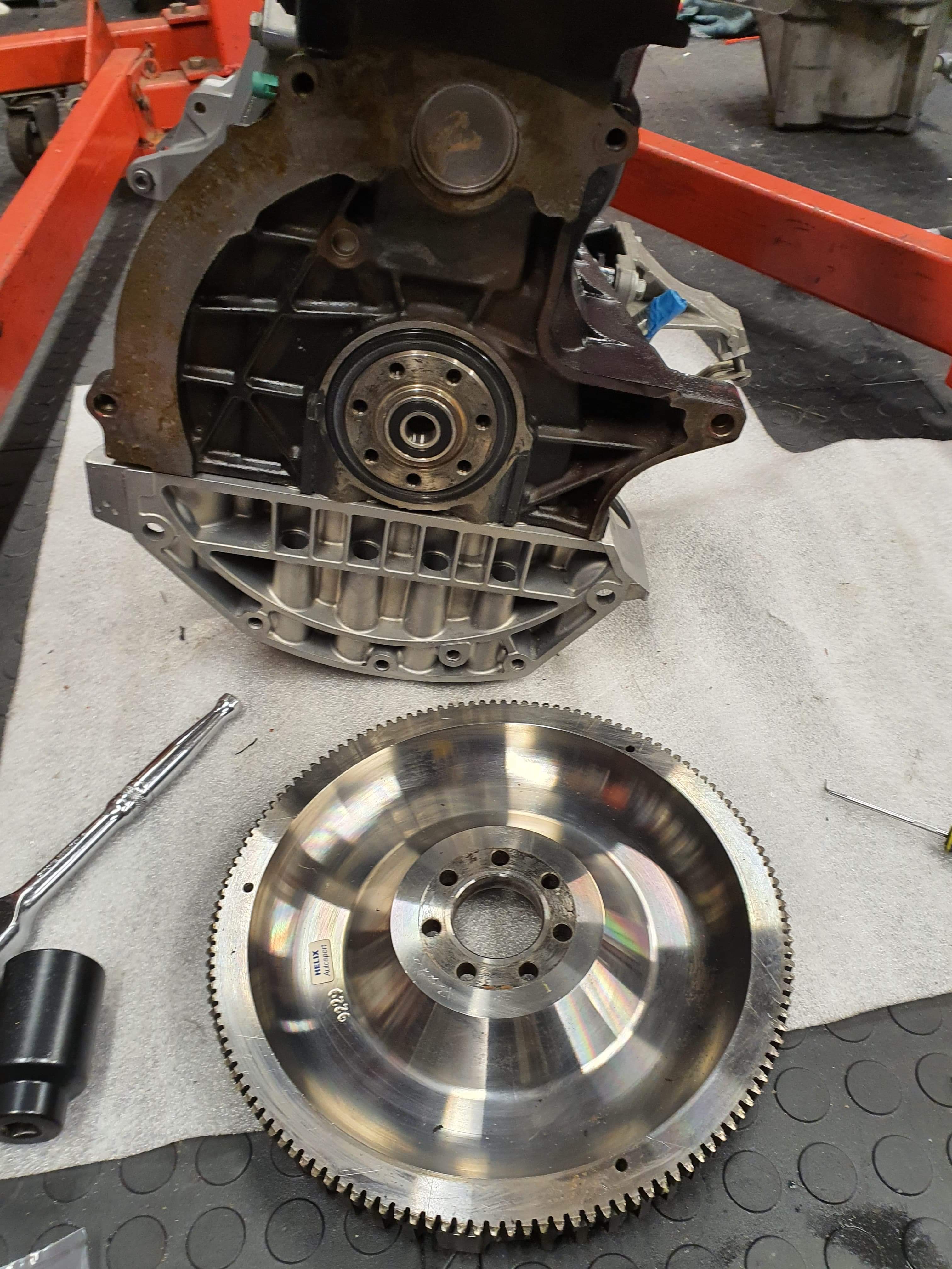

Ttv megane r26 smf flywheel, Helix 6 paddle clutch and pressure plate.

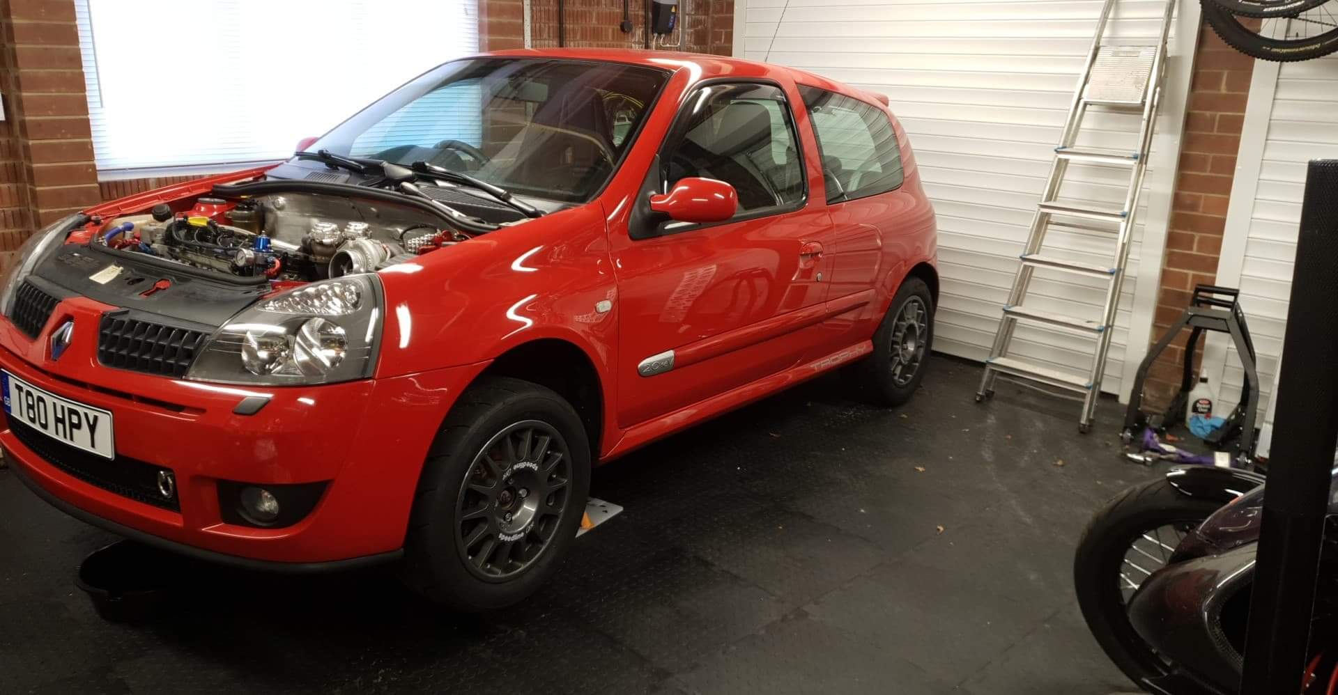

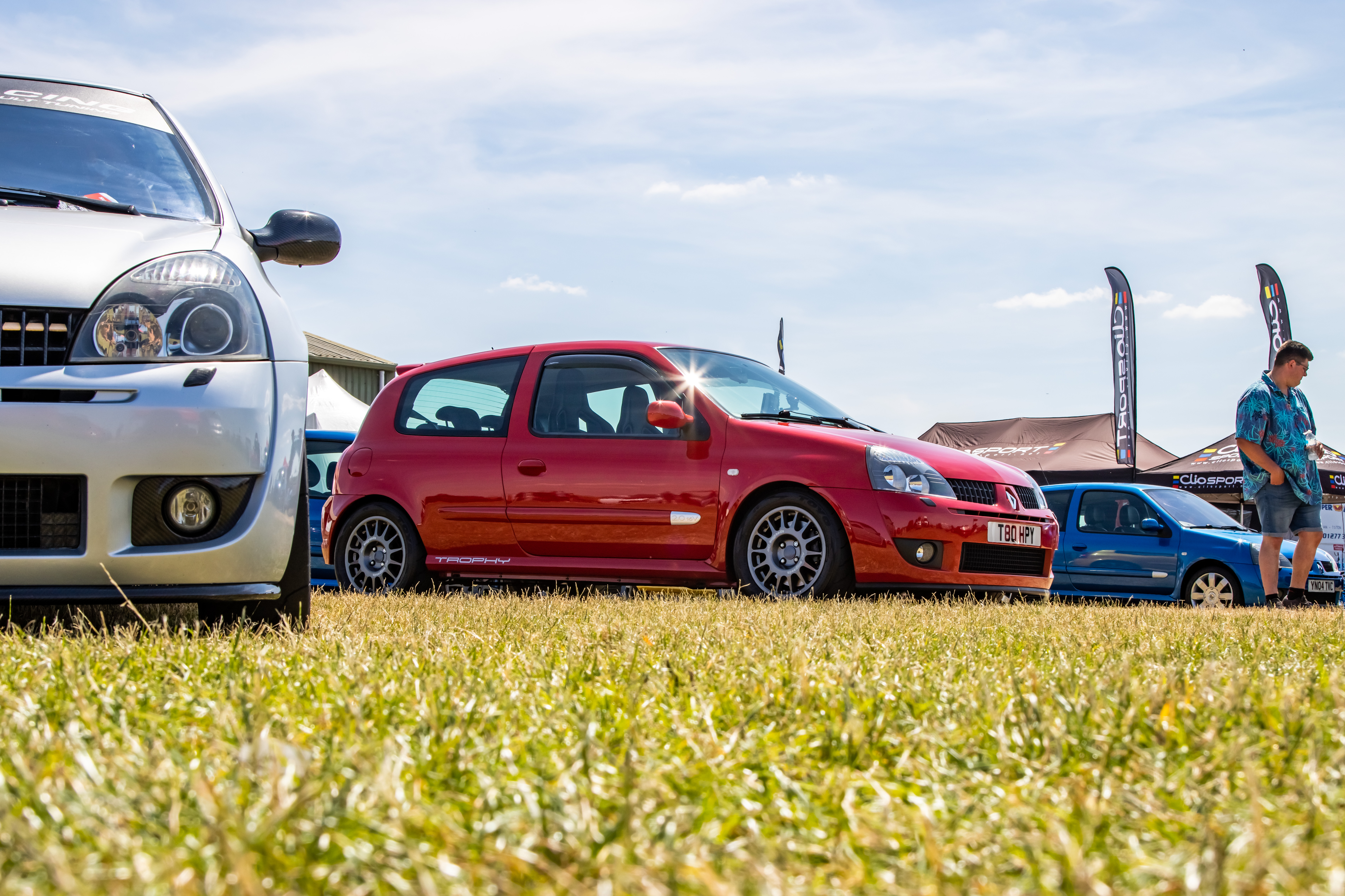

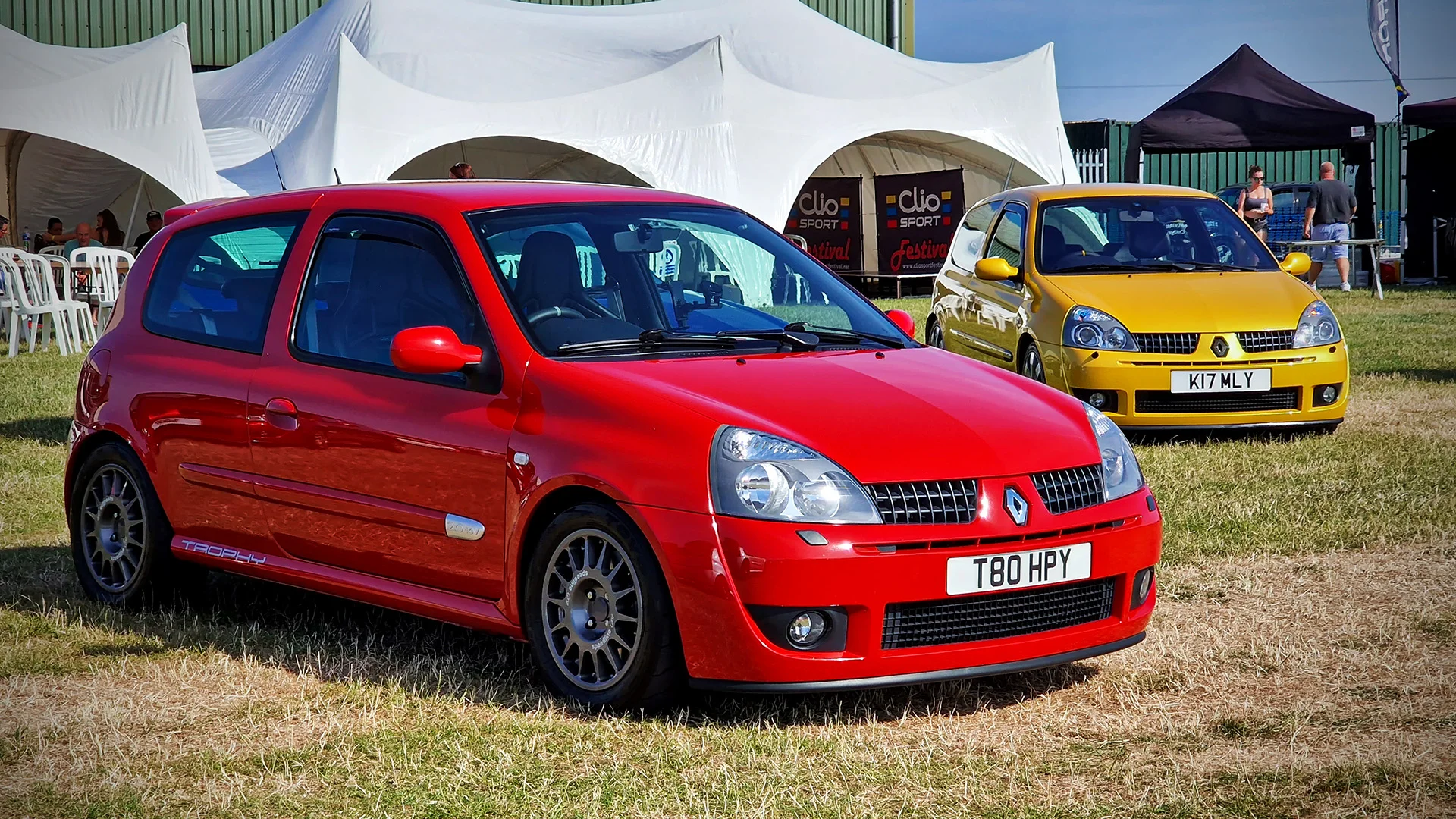

A couple of awesome pics took over the weekend many thanks for them @joshr53 @SharkyUK @Calamita
Brigsy
  T.Turbo
Thanks all 🙂 Will definitely be getting out and about in this in the dry weather, cant wait to use it and enjoy.

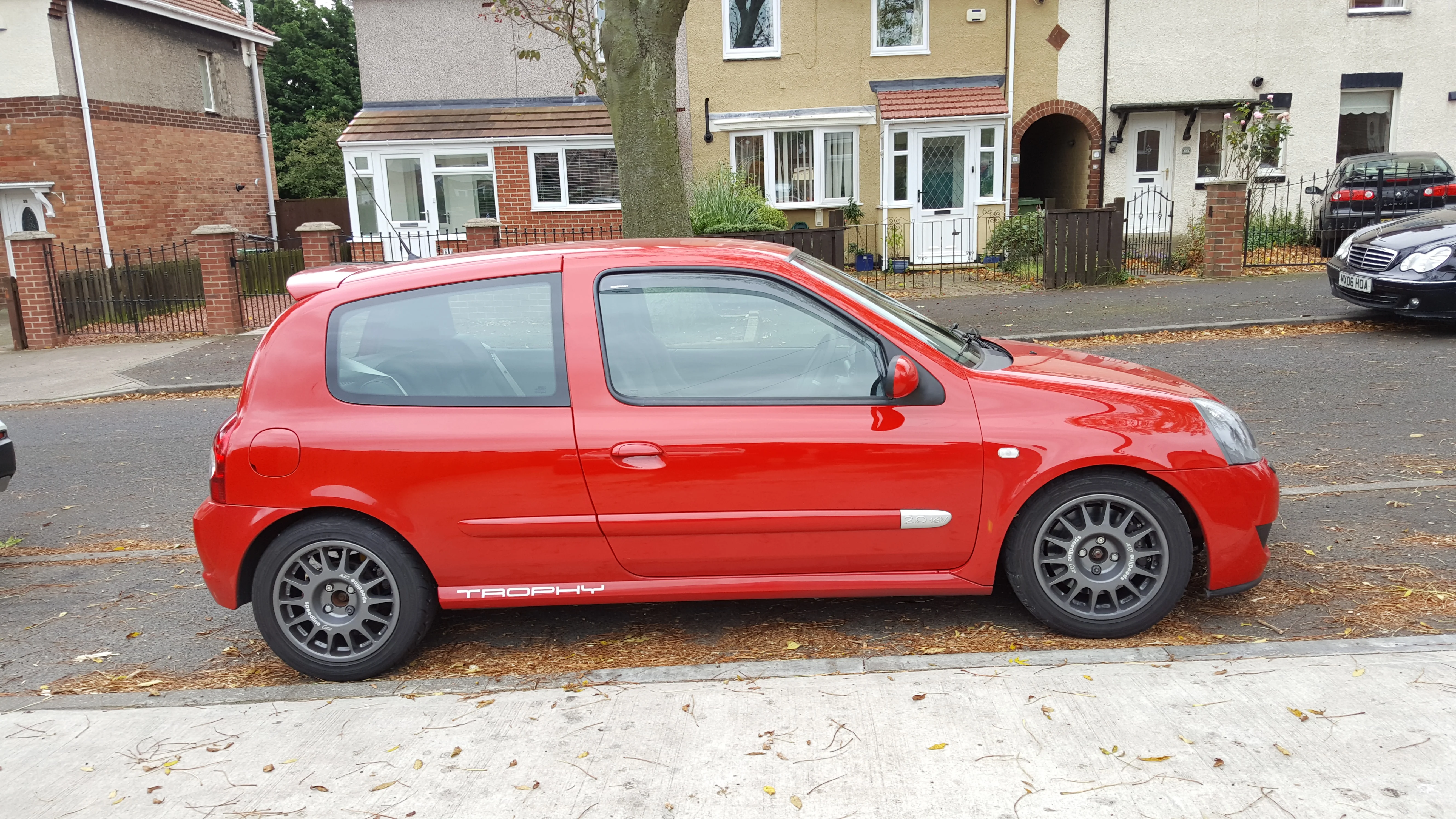

So T.Trophy is off the cards at that moment for us and we have an itch for another car. We had been looking for the unicorn that is the extreme blue meg 250 cup, in low mileage with recaros etc. After being extremely messed about with a few examples (usual Bullshit, i want to sell but dont want to take your cash even though its over the odds price wise!?)
Anyway finally get a 32k fully loaded 250cup in sport yellow instead. Its a lovely car and does everything we chuck at it with ease. Unreal looking car but just did not love it as much as our mk2 megane rs225 for some reason. Miss it looking great sat on the drive sometimes.
Anyway back to it. Im still in regular contact with Steve and having the usual banter calling the Trophy red shed and asking if hes using it or just leaving it in the garage until kingdom come.
The running theme with the car is that he books a trackday to do in the Trophy and something breaks in the runup so it never goes. Croft booked and it pisses its gear oil out all over after a clutch slave swap the day before. Croft booked again, the optima redtop battery is fucked and barely holding charge, with the fitted tray cant just strap another battery in. Its raining heavy, so lights/blower/wipers on and it cuts out before Clervaux on the sightseeing lap which is a 100 yards or so out of the pit entrance so needs to be towed in. So another day over and a piss ripping from us for the tow of shame :LOL:
It did make our local circuit Teesside Autodrome for a couple of hours on an evening session which i sadly missed.
Getting the occasional pic coming through of it sitting pretty. Note red r26 next to it that in coincidence i ended up breaking for parts for the Kangoo!
The Trophy is being used occasionally on the road by Steve. Getting updates on what higher end cars its seen off in the process, its going well at 440hp. Get an update one day saying the ndo gearbox has failed and its lost a couple of gears, 3rd & 4th gear iirc!

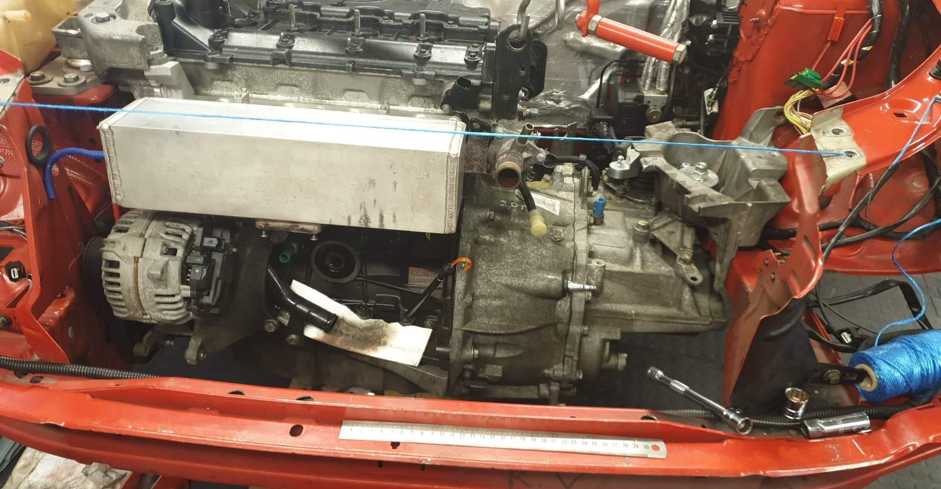

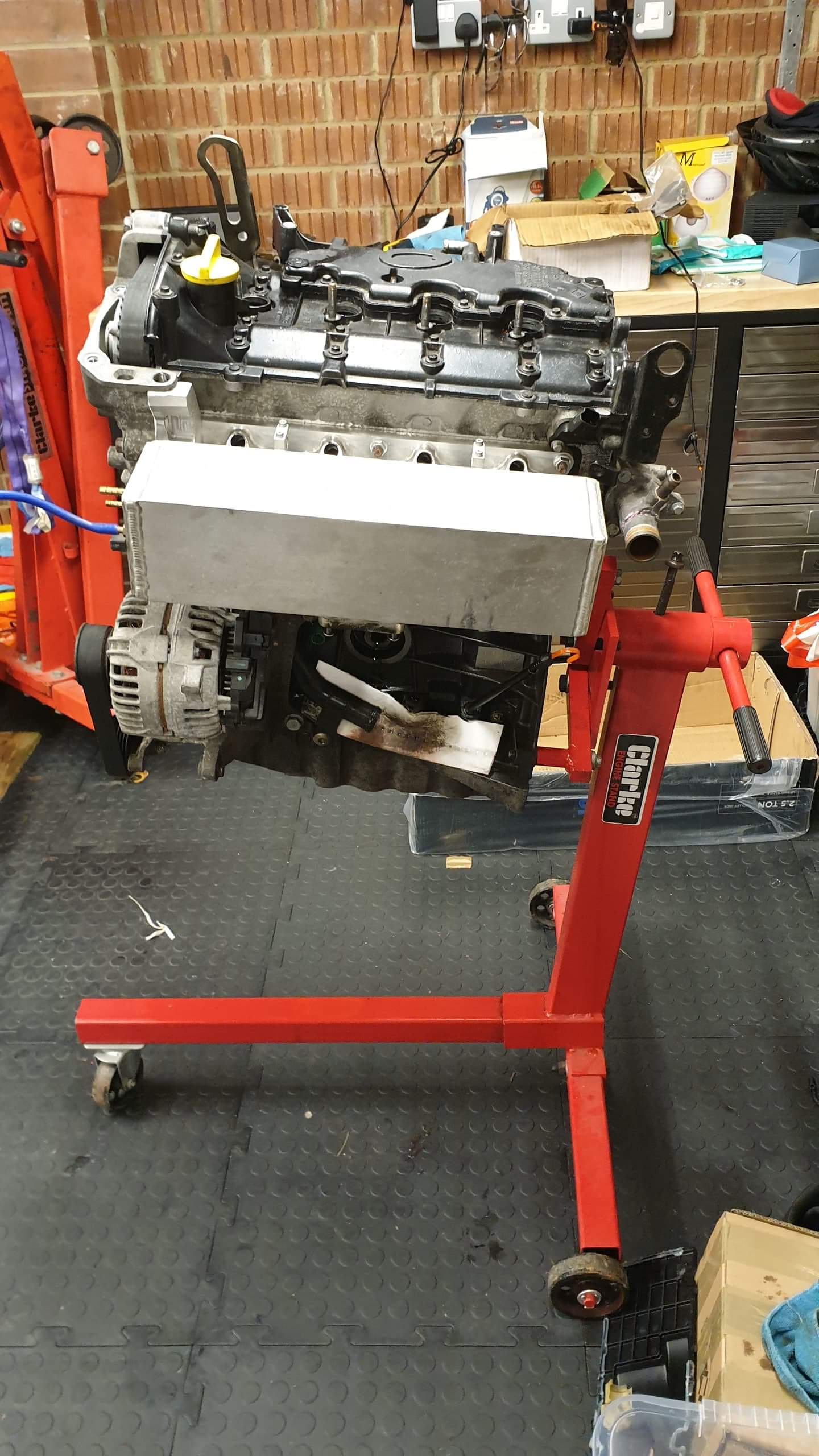

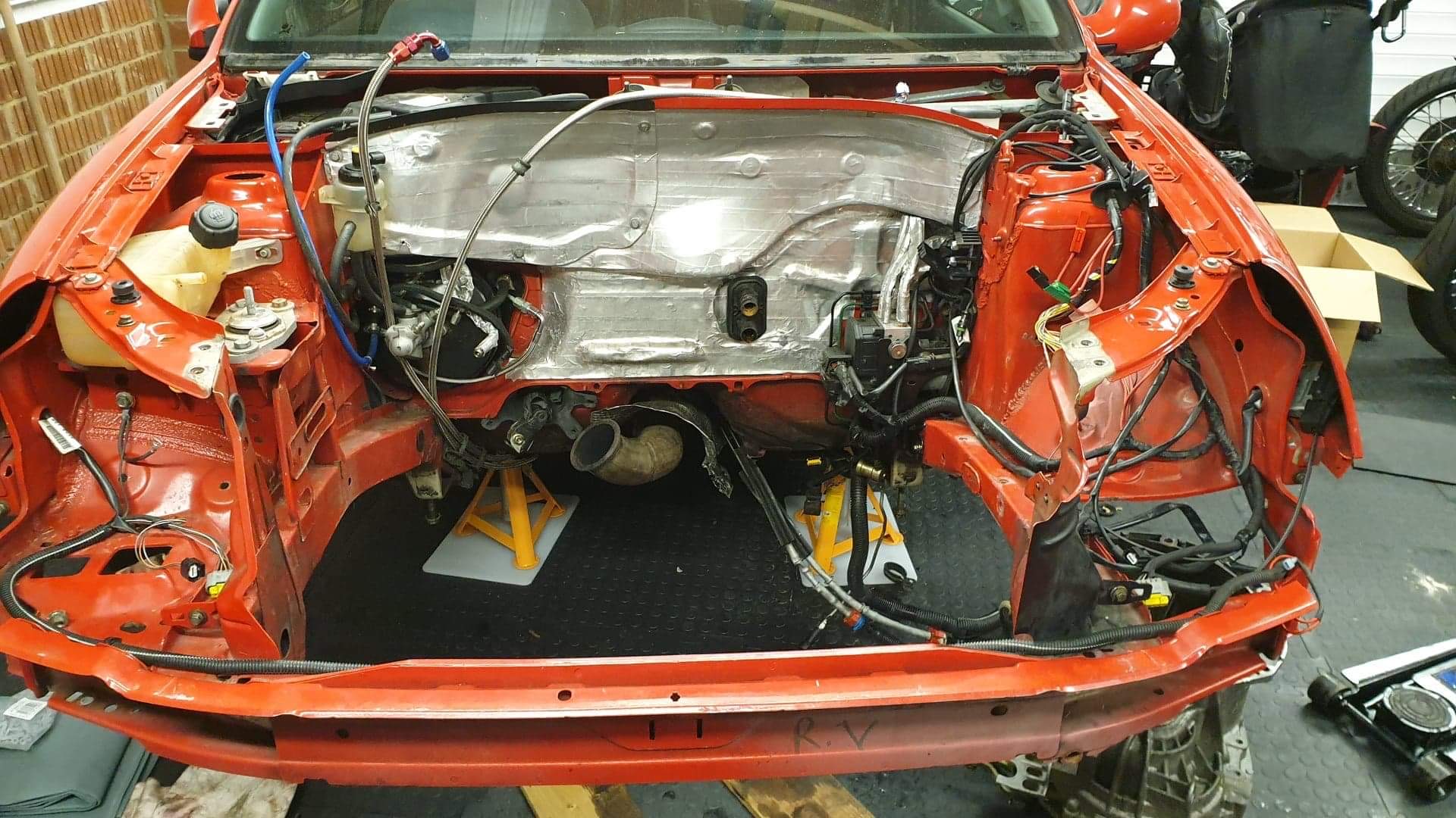

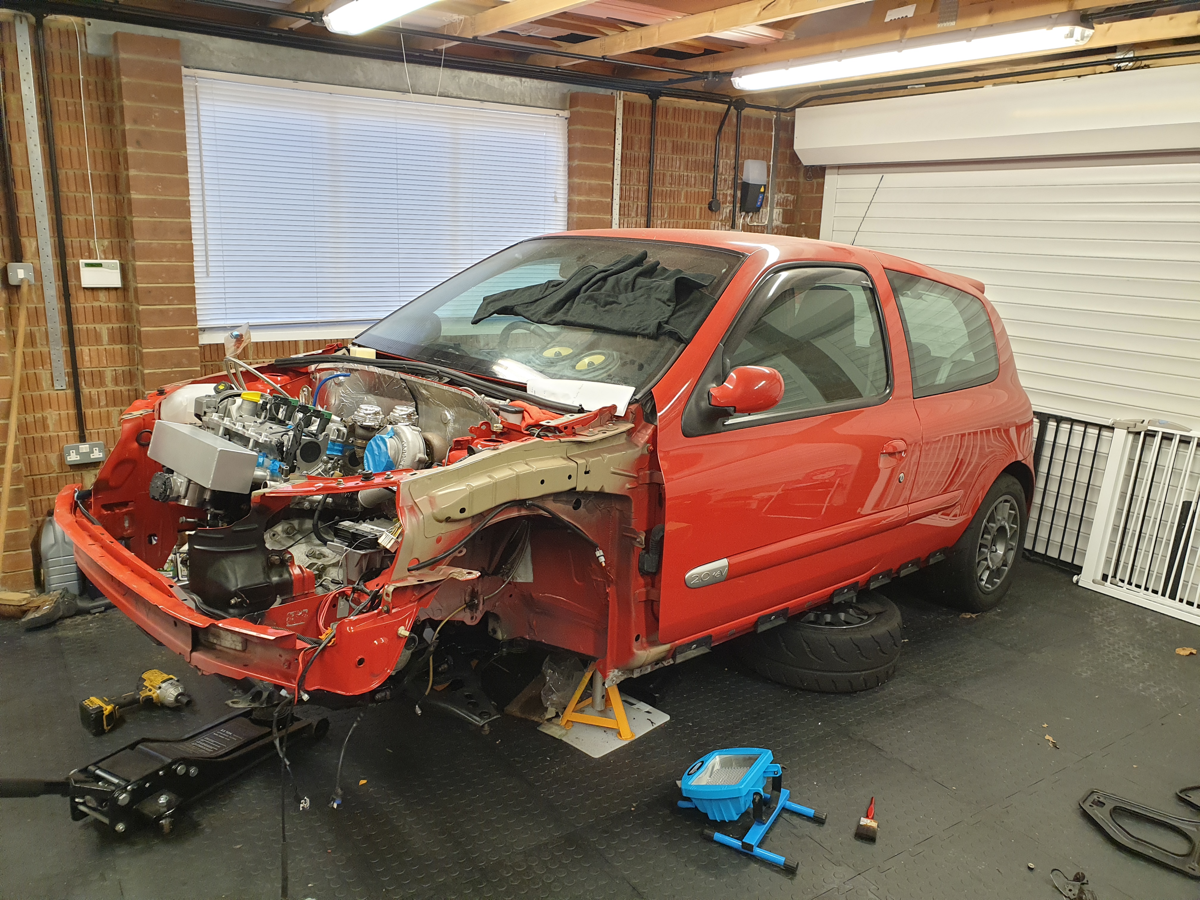

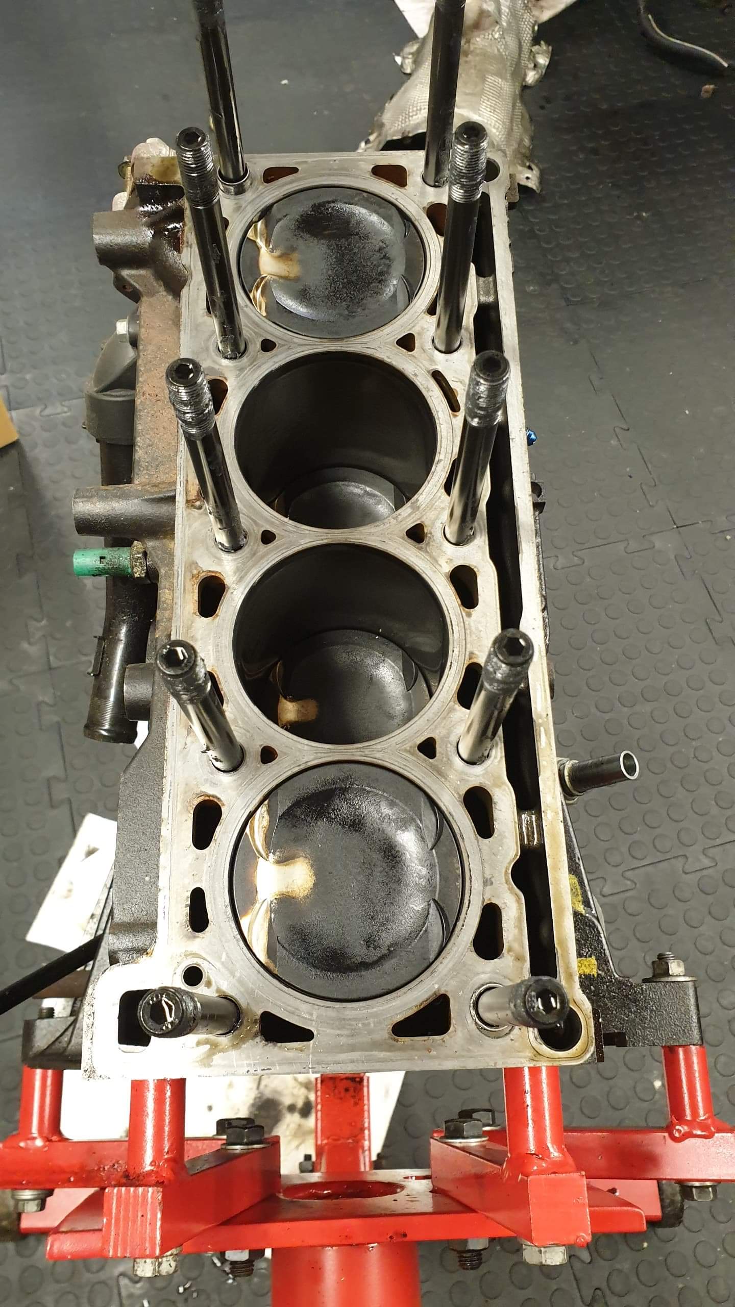

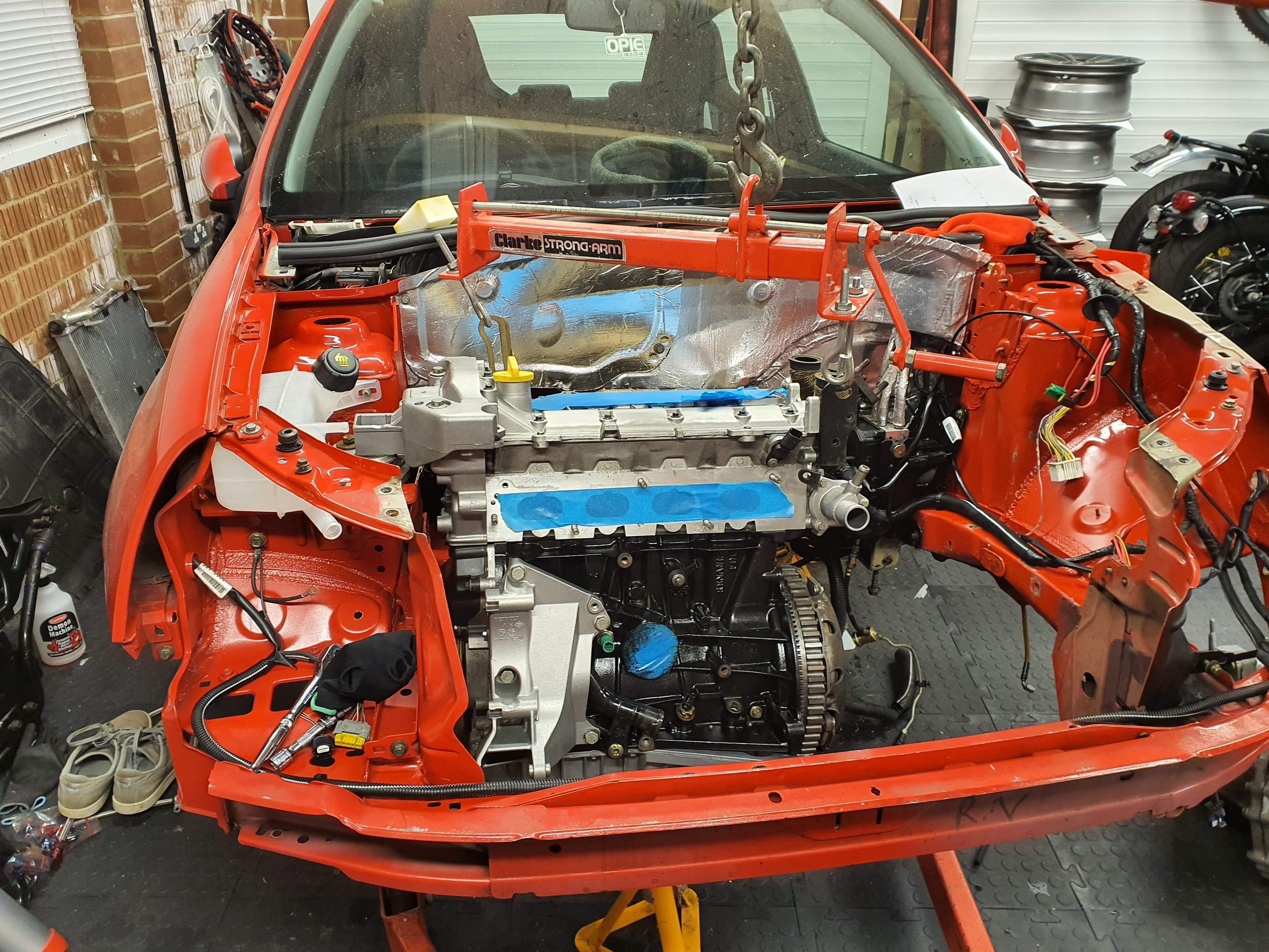

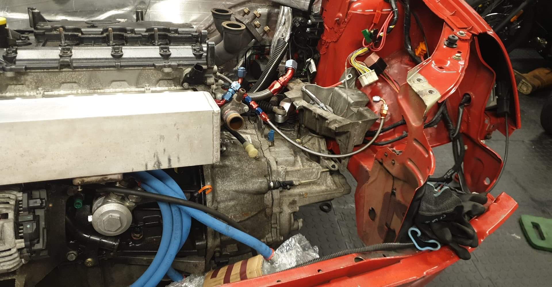

So next updates are the car has had a final wash and in the garage for repairs and upgrades aka T.Turbo 1.0

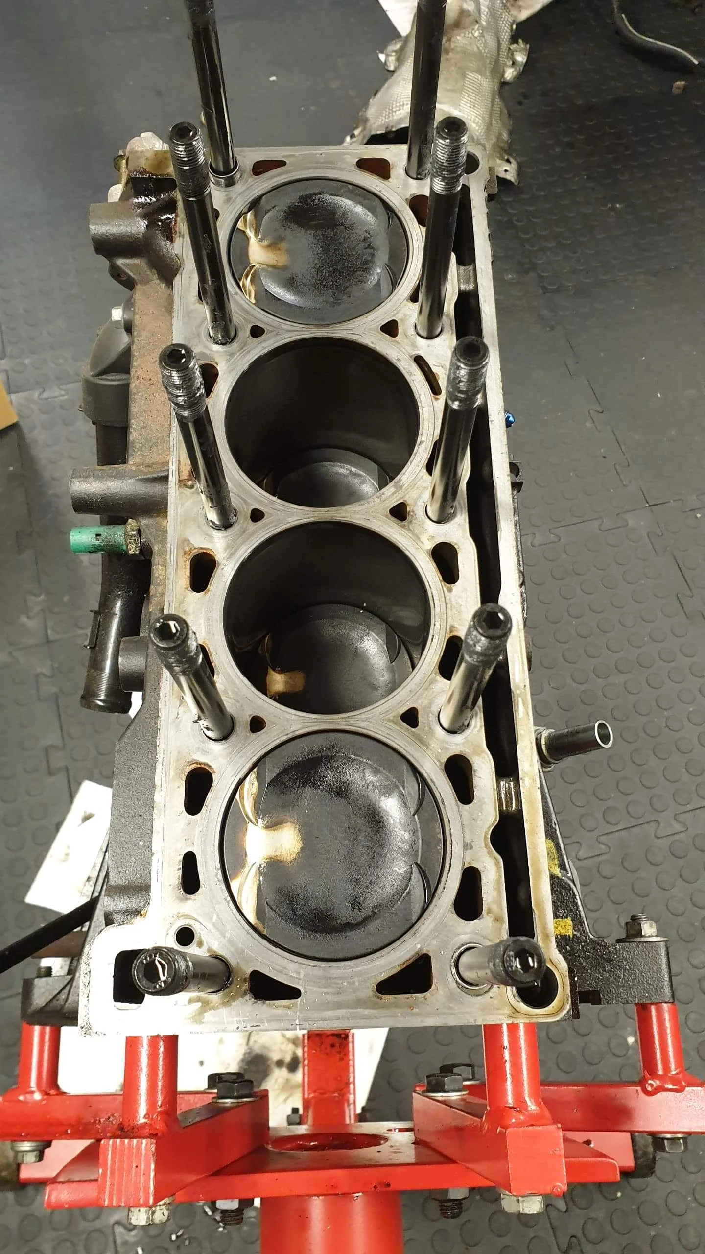

Last view of the old engine setup before stripdown.
On axle stands ready for work to commence. From memory this was late 2017/early 2018.

In our group chat i was receiving regular updates about the strip down of the Trophy for the next evolution. I recall this was early 2018.
Parts coming off.
Large oil cooler and remote oil filter setup, with view of centre fed plenum.
Ndo gearbox sat in the bay.

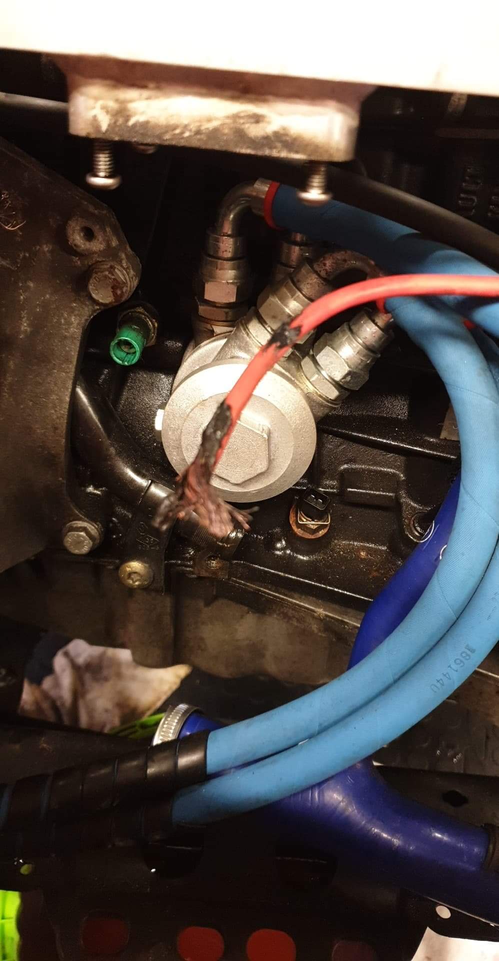

One of the issues found on the stripdown, alt wire melted poss caused by loose connections or running the knackered battery causing large current draw. Bit naughty.
Checking things over.

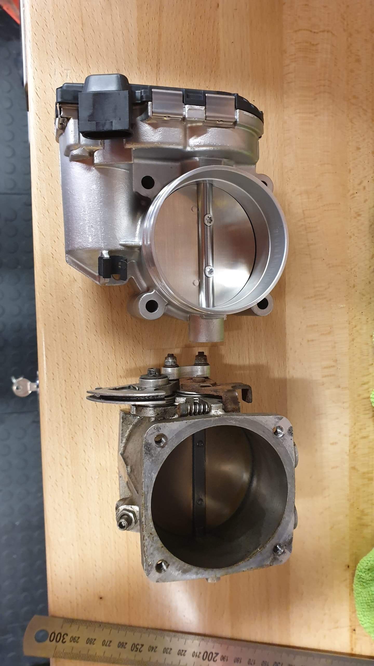

The throttle needed attention. The current setup was a cable Jenvey item fitted to the Nortech inlet manifold. The throttle body cam profile mated with ph1 172 throttle pedal worked OK, but due to the throttle cam profile ratio of the jenvey vs pedal ratio, it made for a snappy short throttle pedal.
This put your ankle in a funny position when cruising at normal speeds using low throttle openings. The other issue was wear to the throttle body. Steve explored options enquiring about rebuilding the throttle and altering the cam profile for a less snappy, linear response which Jenvey could do, but at an expensive price.
Decisions were made and it was deemed best route to take was to modify the plenum and upgrade to DBW Bosch motorsport throttle. This was decided as dbw throttle opening vs throttle pedal position could be mapped to suit a nice linear response, and cold start idle could be taken care of via mapping as the current cable setup had no idle control valve. The engine would not idle without throttle from cold on the cable throttle due to this making it a bit of a pig to drive until warmed up.
Bosch motorsport throttle vs Jenvey.

The engine ran great and no blue smoke and had only done 3000 miles, but the piston ring gaps were on the slacker side of the scale when it was built so the decision was made to strip the engine and check it over/fresh rings, sort out oil leaks, and change spec i.e cams and head work.
Engine on stand ready for stripdown.
Head off showing J.E pistons and Arp head studs.
Pistons out on the bench, for checks and cat cams conrods visible.
Balanced crank.
A new block was selected from his large stock of spares as the current one used was from memory an F4RT grand espace which only had 2 holes for ndo driveshaft bearing carrier which was not ideal.
New block was sent off to the machine shop for preperation.

New block was prepared by Amac engineering. Its a meg 250 block to replace the old espace block. Block was checked over, decked, honed and fully cleaned/prepped for fresh build.
Rings were gapped to suit which is pretty painful and time consuming if you have ever done it before.
Crank was installed with new mains/big ends, apparently this was a ballache to get tolerances right and a few sets of oem bearings were ordered until it was right. New oil pump installed at the same time.
Some pics of the head, this turned into an expensive do from memory. Steve bought a used big spec ported 197 head, when arrived turned out to be scrap as all the cam journals were scored badly. A good used standard 197 head was sourced and sent to Amac for porting, fitting supertech valves and general prep. They port matched the inlet ports and dowelled the head to locate the inlet perfectly. Labour cost was eye watering by all accounts.
Cams were chosen to suit from a large selection. 197 inlet and 182 exhaust were chosen this time round.
Head fitted with arp studs.
All the alloy parts were aqua blasted and thoroughly cleaned for the as new raw alloy appearance.
A nice clean fresh build.

Assembly continued. Cam cover sealed with anaerobic sealant from Renault as originally intended.
Note 197 dephaser fitted for full scope of 40degrees of inlet advance available.
Cam timing to stock settings using genuine tooling. Horseshoe fit video as everybody loves a vid of it sliding in perfectly :LOL:
Manifold was wrapped with expensive Dei titanium wrap over the ceratec coating. This was a great idea but sadly had to remove it, ill come back to that in a future post. Note turbo oil drain tapped for large an adaptor.

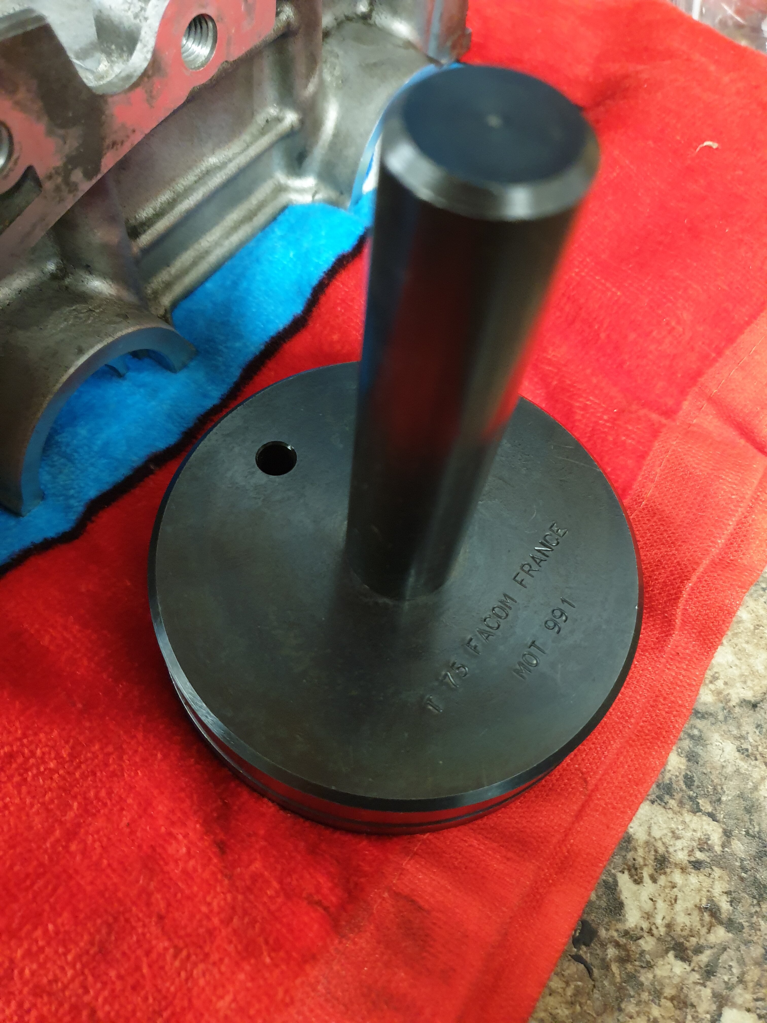

New genuine crank seal fitted with MOT 991. The pic below is from when i used it on the Kangoo, its a great bit of kit, makes the job very easy to do.
TTV smf flywheel shown. Spigot bearing fitted to crank as was missed on first build giving gearshift issues.

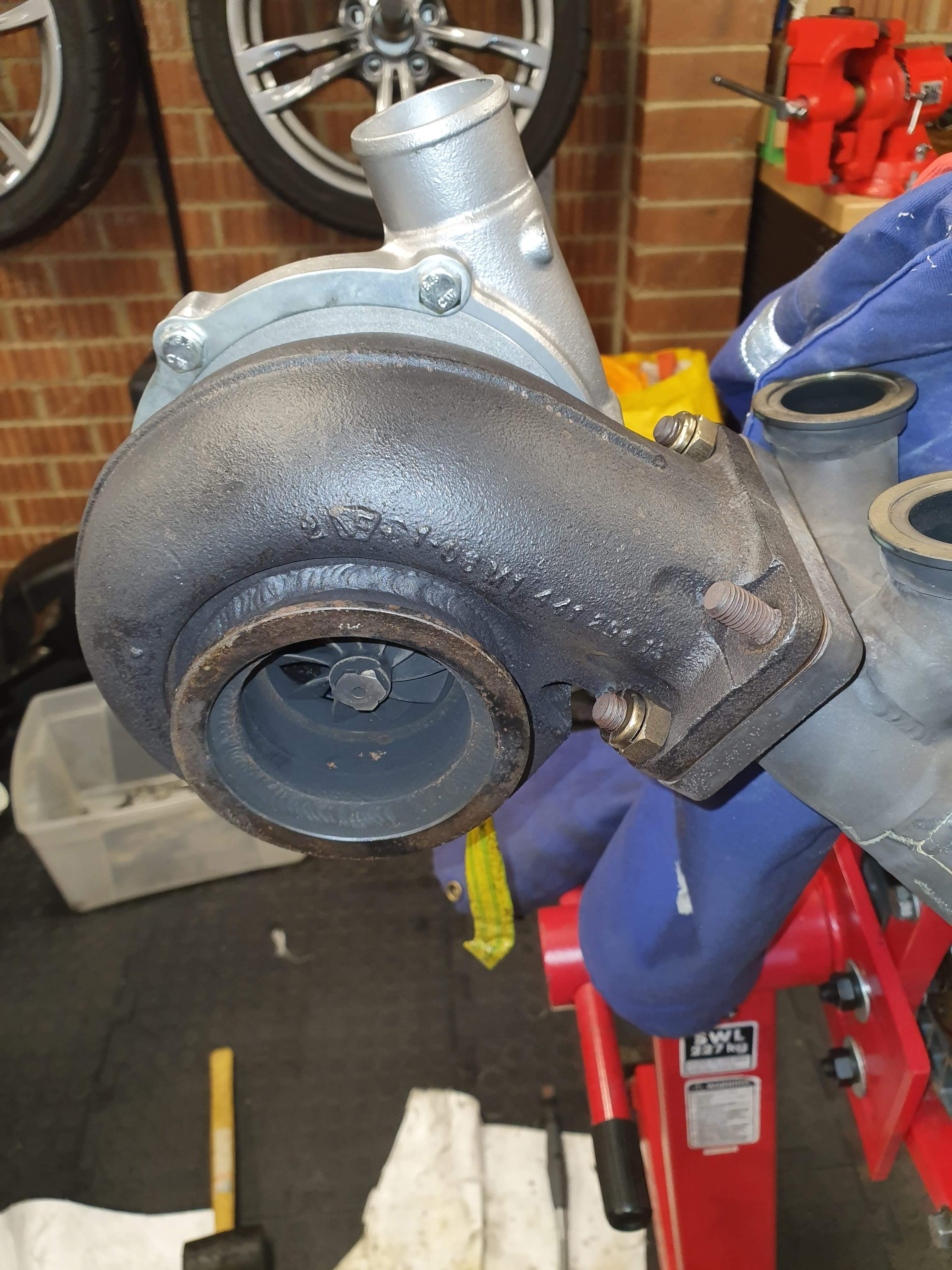

Turbine housing was also changed from the large 1.06ar twin scroll that was fitted on the old setup. It spooled up quite well on this, around 4.5-5k all in but the power and torque ramped in hard and agressive. Flows really good though.
The decision was made to change to .82ar twin scroll turbine housing. This was for more response in the mid range and hopefully help smooth out the torque delivery with good mapping instead of it all ramping in at once when finally spooling up.

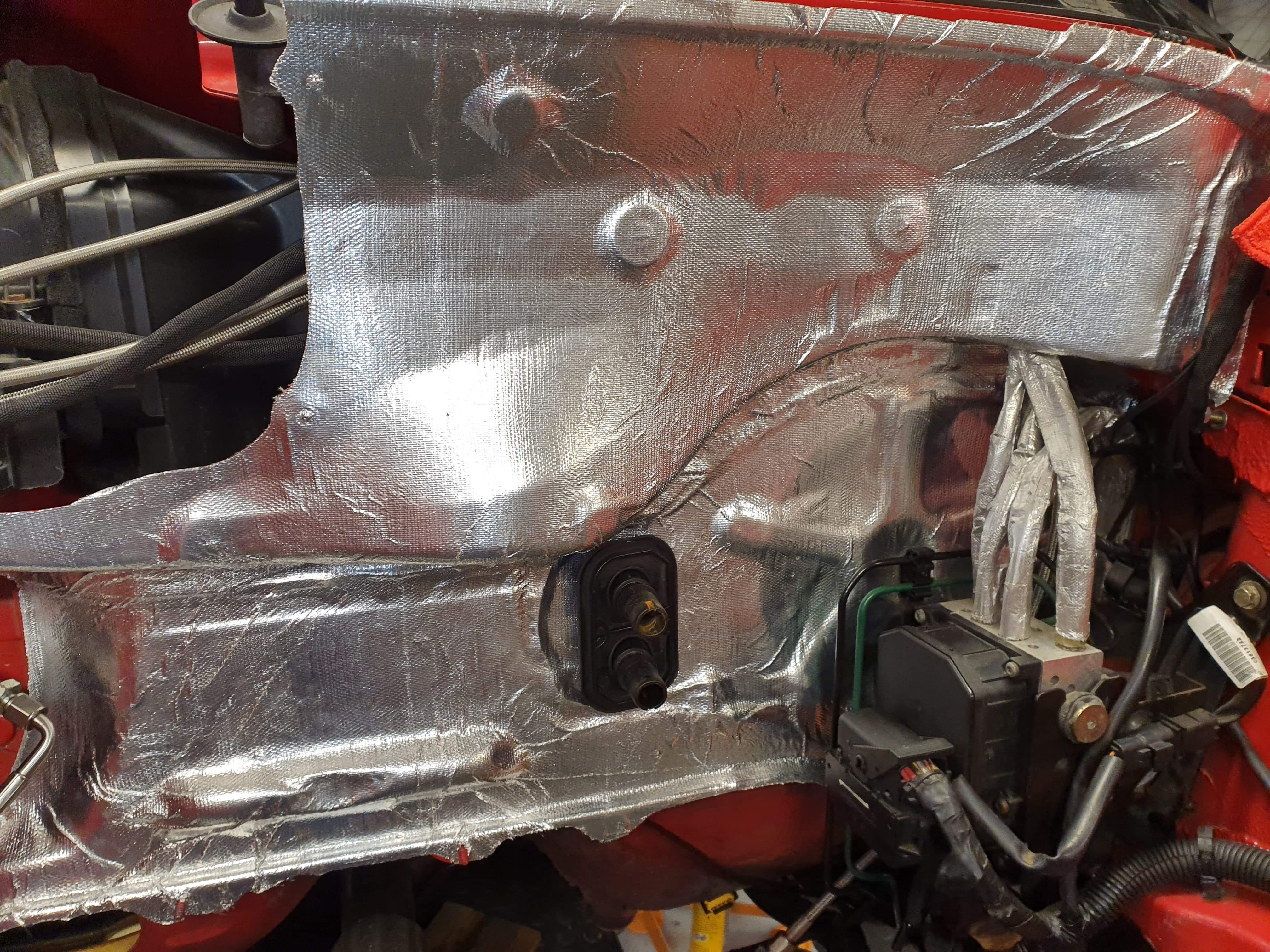

Engine bay was prepped ready for install. Note custom brake lines relocated behind bulkhead.
Engine hung in the bay. Note no gearbox fitted, as at that point a 250 cup pk gearbox was mocked up, which fitted fine but needed a custom gearbox mount making. Meg 175 dci gearbox spider mount and also 250 spider were tested, but engine was way out of level so no good, and with a new mount and new driveshafts required, the decision to go back to a refreshed megane r26 NDO020 gearbox with gripper differential was made. I ended up buying the pk 250 cup box for the Kangoo!

Manifold was wrapped with expensive Dei titanium wrap over the ceratec coating. This was a great idea but sadly had to remove it, ill come back to that in a future post. Note turbo oil drain tapped for large an adaptor.View attachment 1604823
New genuine crank seal fitted with MOT 991. The pic below is from when i used it on the Kangoo, its a great bit of kit, makes the job very easy to do.View attachment 1604831
TTV smf flywheel shown. Spigot bearing fitted to crank as was missed on first build giving gearshift issues.View attachment 1604824
Turbine housing was also changed from the large 1.06ar twin scroll that was fitted on the old setup. It spooled up quite well on this, around 4.5-5k all in but the power and torque ramped in hard and agressive. Flows really good though.View attachment 1604827
Engine bay was prepped ready for install. Note custom brake lines relocated behind bulkhead.View attachment 1604820View attachment 1604821
Engine hung in the bay. Note no gearbox fitted, as at that point a 250 cup pk gearbox was mocked up, which fitted fine but needed a custom gearbox mount making. Meg 175 dci gearbox spider mount and also 250 spider were tested, but engine was way out of level so no good, and with a new mount and new driveshafts required, the decision to go back to a refreshed megane r26 NDO020 gearbox with gripper differential was made. I ended up buying the pk 250 cup box for the Kangoo!View attachment 1604825

Late 2020, November iirc. Kangoo compact has the meg engine and running gear in so its looking good but realistically its miles away from a start up. Down to Steve's again for more parts and generally drink all his coffee and do his head in. Pop in the garage and grab the parts needed and look at the Trophy. Its looking sad, half fitted engine, no panels on and interior in a million bits.
I look at the car and i think this has potential to be f**king epic when done but needs a lot of work to put together. So we are talking about it and hes considering options, including putting back to original, which is a massive task as a lot of the oem parts are long gone. Other option is breaking it which would be criminal as the car is one owner with 43k on the clock and albeit in a million pieces, is still in great condition wearing unmarked original paint, and 90% of the parts are there to put it back together.
Seeing the Trophy and remembering what a great car it was when in one piece fires up my enthusiasm about it again. On the flip side, it would be daft or stupid (definitely financially stupid!!) to buy a project whilst ive already got a large project kangoo ongoing thats quite far off actually running.
Next thing we are asking how much would buy the Trophy as is. Its a massive jigsaw puzzle, parts all over the place. We agree a price and Steve is unsure if he wants to sell it as owned it from new, but considering selling it as ultimately its not going back together any time soon.
We shake on it but again nothing is final until its sat on our drive.
Trophy looking quite sad! A fair chunk of cash for a project. Steve repeats to me a few times i have to put it back together myself, no building it up to drive away in his garage but i can get it rolling. He says clear everything all the spares which is a lockups worth which no doubt ill be needing and best of luck rebuilding it as ill need it.
Heads spinning at this point as its totally unplanned..what have i done? Bought a load of work and hassle? Most likely is the honest answer.
