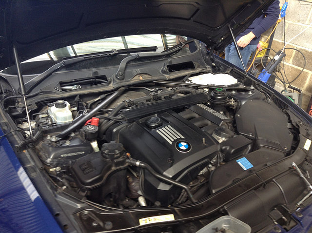

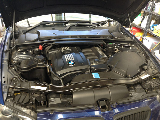

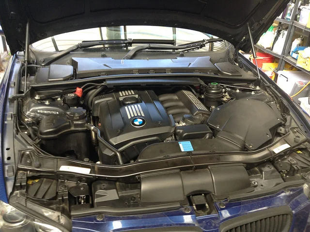

Had an intermittent misfire for a few weeks that caused a bit of hesitation when trying to gather speed quickly eg joining the motorway, and it gradually got worse to the point of it missing while idling in traffic and on occasion dropping down to 5 cylinders and showing an engine management light. Had it plugged in and it was showing a misfire on Cylinder 1, my bet was coil and and so was the guys up the garage.

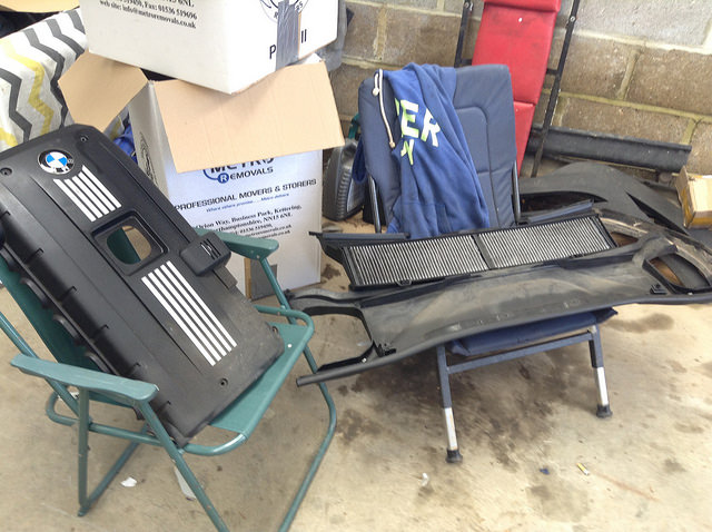

So off came a few bits...
Untitled by terry clarke, on Flickr

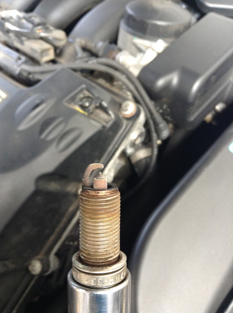

Took the plug out on cyl 1 and checked it against the others, all looked the same so assuming they're ok for now.
Swapped the coil and put it back together and it now runs sweet as a nut again. Hadn't realised how hesitant it had got until i drove it home with the new coil, nice and smooth and accelerates quickly when needed.

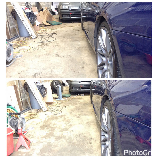

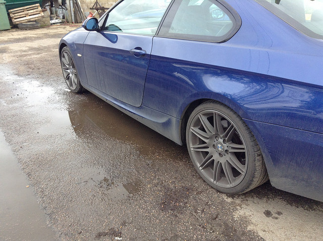

Spacers fitted, has made a huge difference in the stance for the sake of 12mm, now it really needs lowering though. Didnt get many pictures as my phone camera is pretty smashed and the pictures are well terrible as you'll see.
Before and after
Before i washed it sunday
Now
Think its really noticeable on the rear as they fill the arches now instead of being hidden from certain angles. Also fitted the k&n replacement filter and it could be placebo but I'm sure it sounds different after 4k. so now i just need to decide what spring to get..H&R? Eibach?

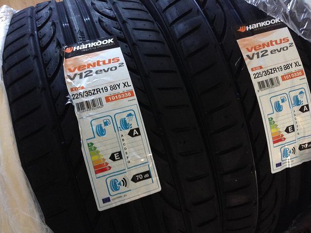

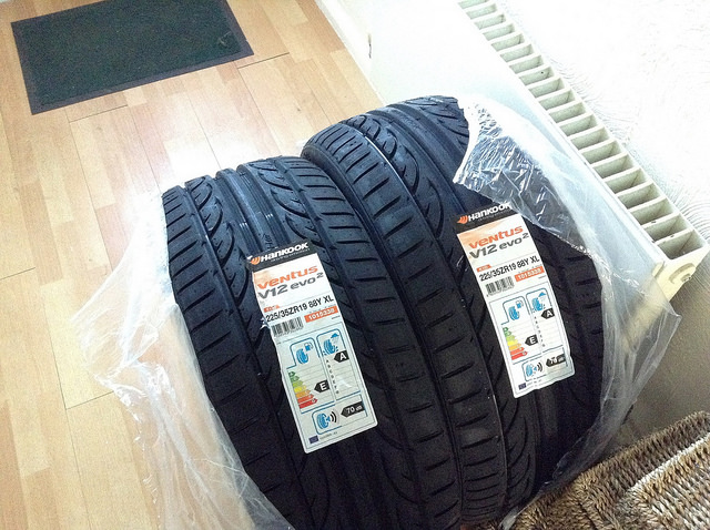

Once again ordered tyres from opeono.com and once again they arrived 2 days later, free delivery and way cheaper than anywhere else online. Car now has Hankook ventus V12s all round, been really impressed with them on rear and couldn't wait to get rid of the F1s on the front.

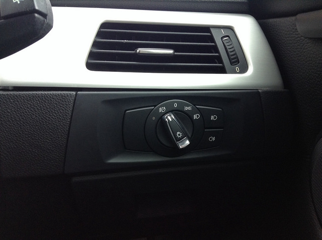

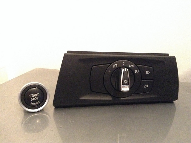

Fitted the new switches, got some BmwPerformance interior parts on order too.

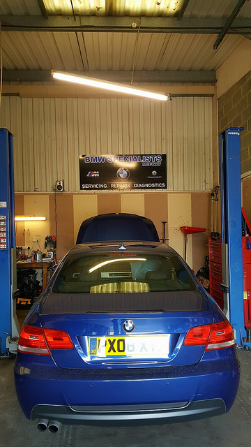

Took the car for a brake fluid service and inspection at a local specialist yesterday morning. Found out one really interesting thing... the car doesnt have a ZF autobox :neutral: its a Gm unit apparently, he reckons its the first one hes seen in an e92??
Cars in good shape overall apart from both rear shocks having a slight leak, I'll most likely change them when I fit springs in the near future. Rear pads are showing 700miles on the computer too so thatll be the next job, any recommendations for standard type pads? usual ECP brembo jobs?

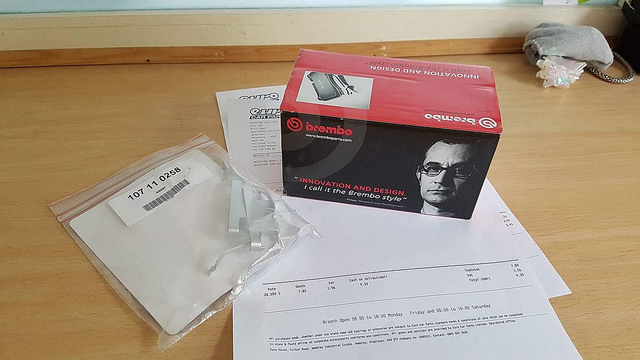

Picked up some pads and caliper retaining clips this morning too so I can do those some time during the week.

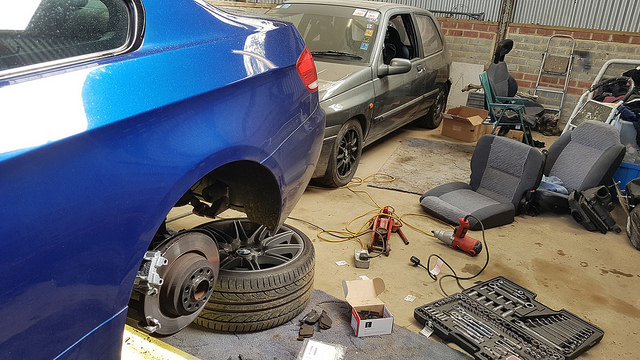

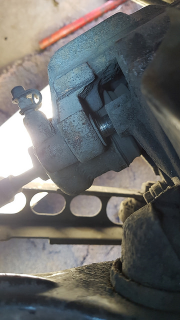

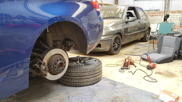

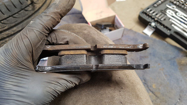

Done the rear pads yesterday, was meant to do them the day before but euros gave me the wrong ones :up:. Had a bit of an issue on the drivers side with a sticky piston, seems it had been seized out and had worn the inside pad (with the sensor on) at a quicker rate than the rest.
20170418_122141 by terry clarke, on Flickr
20170418_124724 by terry clarke, on Flickr
Gave the calipers a lick of paint while they were apart too.
20170418_131429 by terry clarke, on Flickr
This is as far as we could get the caliper on before a lot of hammering and levering of the piston, seems to be operating fine now though.
20170418_141340_002 by terry clarke, on Flickr
20170418_160413 by terry clarke, on Flickr
