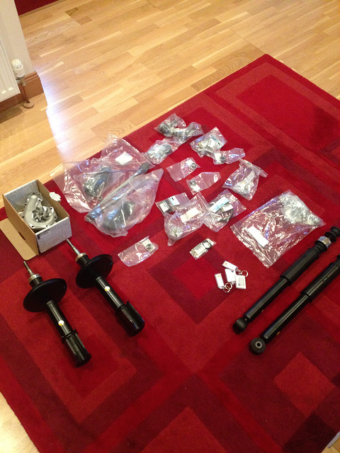

First to arrive was Cooksport springs + Lemforder lower ball joints.
Then a little order from @Renault Wolverhampton. Track rods + ends, Cup shocks front + rear, water pump, fly wheel bolts, crank seal, shock bolts, VVT seal, cam seal kit and a couple others.

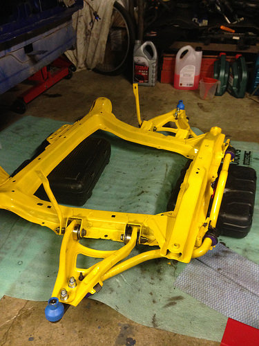

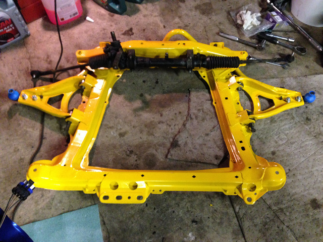

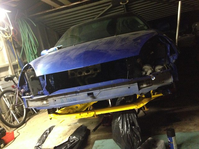

Got the Subframe built back up with all the polybushes and new ball joints:
Untitled
by Arran Bell, on Flickr

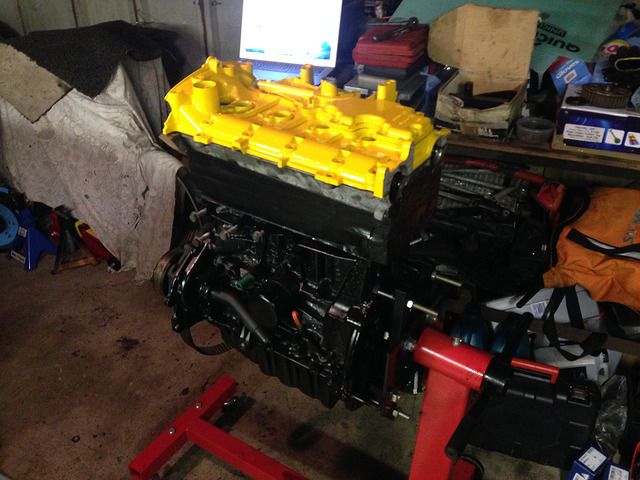

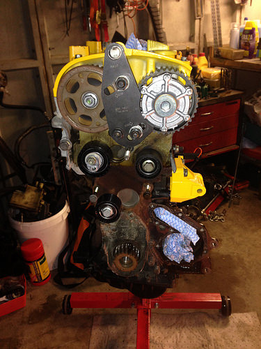

Made a start on the timing now the tdc pin arrived. Everything torqued up and dephaser replaced. Just need to fit the belt and re check.
Untitled
dann2707
Really weird seeing the subframe off the car like that! Awesome work though.
Out of interest what size are the outer ARB polybushes please? There are like 4 variants on ebay?
Rubicon_
  Defender & Westfield
Cheers pal, i think the inner bushes were 25mm and the outers were 22mm. Ktec do them and the wishbones for a good price.

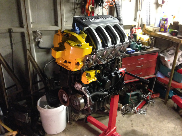

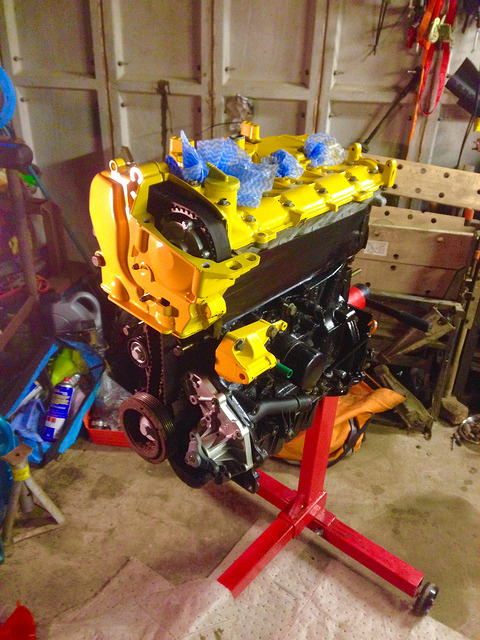

Small 'Yellow' update
Finished doing the belts on the engine, got there in the end thanks to help from @Stu. @Paprika123 and @MicKPM on Facebook. Fitted the new water pump as well, and put the lower manifold back on. Starting to take shape!
Untitled
IMG_0668 by Arran Bell, on Flickr

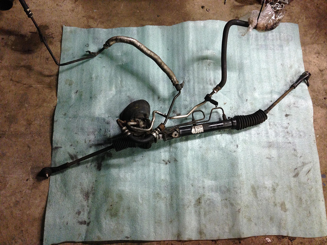

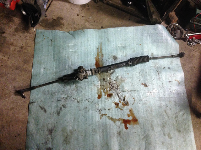

Next task was to set about the steering rack, wanted to tidy it up before the subframe went back on. Removed all the pipework, going to see if i can get some blanks made up for the holes tomorrow and try get a small pipe flared to link the middle 2 up.
So went from this:
IMG_0669 by Arran Bell, on Flickr
To this:
IMG_0670 by Arran Bell, on Flickr
Much better and less clutter in the engine bay :smilingimp:. I then fitted the Powerflex rack bushes and got it on the subframe ready for fitting.

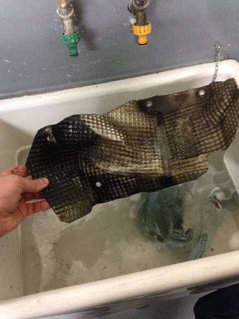

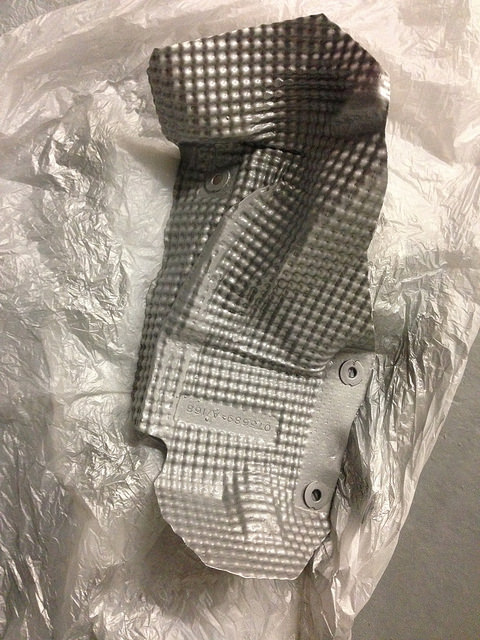

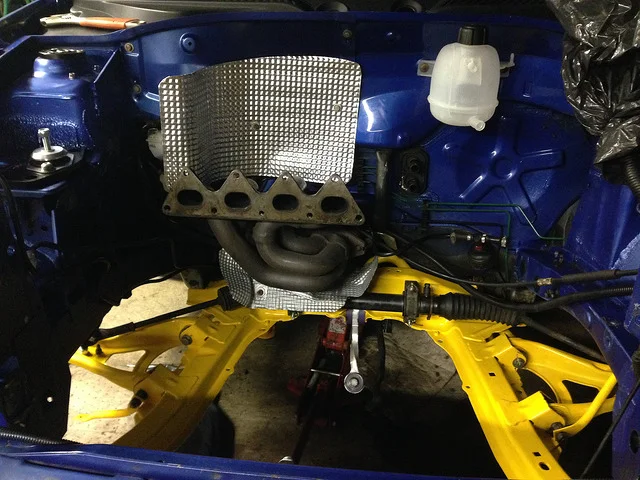

Cleaned the heat shield up and gave it a lick of paint, pointless as no one will see it but good to know its done 😂.
Before:
IMG_0676
After:
IMG_0677

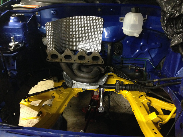

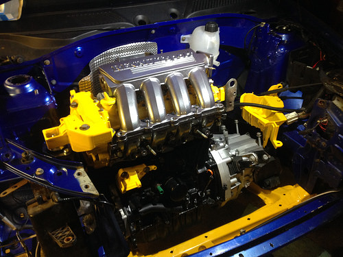

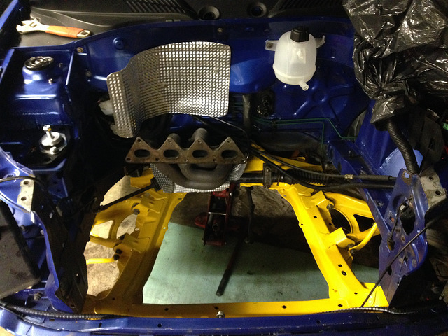

Then got the lot back on the car, so glad i done the subframe as its made such a difference.
IMG_0698
IMG_0691
IMG_0689
IMG_0699
Clutch should be here this week so hopefully have the engine and box back in some point soon.

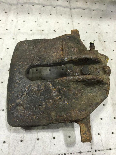

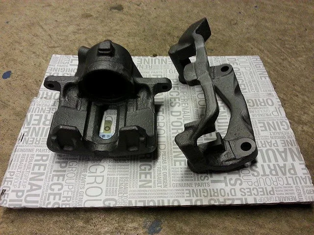

Also got my brakes stripped and refurbed by @Michaelfoz, still to order the seal kit but the job so far has been brilliant!
10846877_10203186413960740_2019991110_n
10859725_868486529852100_1978145824_n

Michaelfoz
  Clios
looking good arran! the calipers will be mint when they are finally built back up.
im contemplating doing mines as i didnt removing the casting marks and stuff on mines.

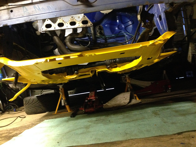

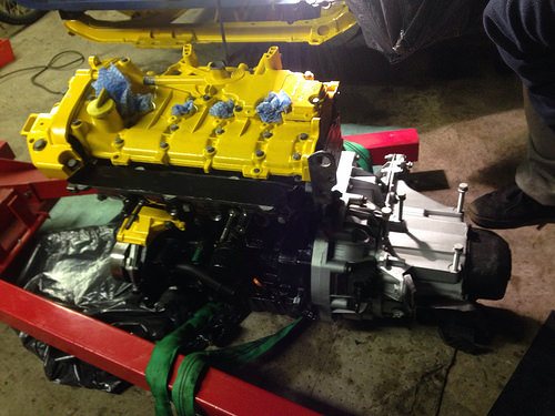

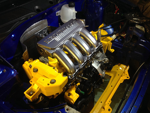

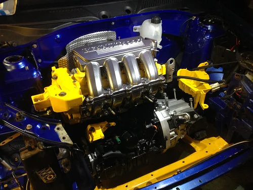

Productive day, got the crank seal, Flywheel and new clutch fitted and put the gearbox back on. All pretty straight forward which was good.
Untitled
Then slinged it up and dropped it back in the car, still waiting on exhaust manifold gasket so still to be moved a little but couldn't resist seeing what it looked like! Some difference from page 1.
Untitled
Untitled
Very happy with the results!
